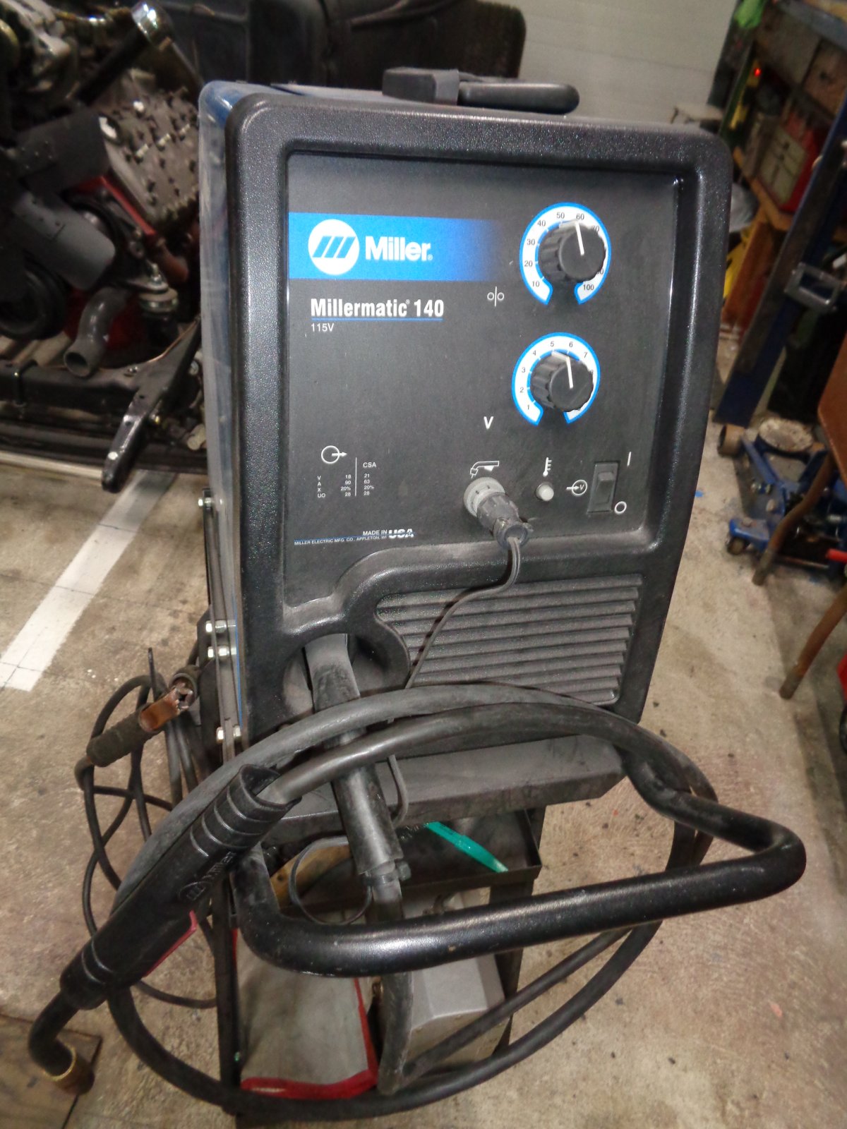

    I'll be interested in today's equivalent 110V machine for light sheet metal to 1/4". This 140 Millermatic has been doing it well for 20 years using mostly .023 wire. When it goes ***s up, I'll be looking to Miller for the closest to it available today. I have others but this is my favorite that is so easy to regulate with just the basic wire speed and heat dials. Very predictable and reliable. DSC07782.JPG
