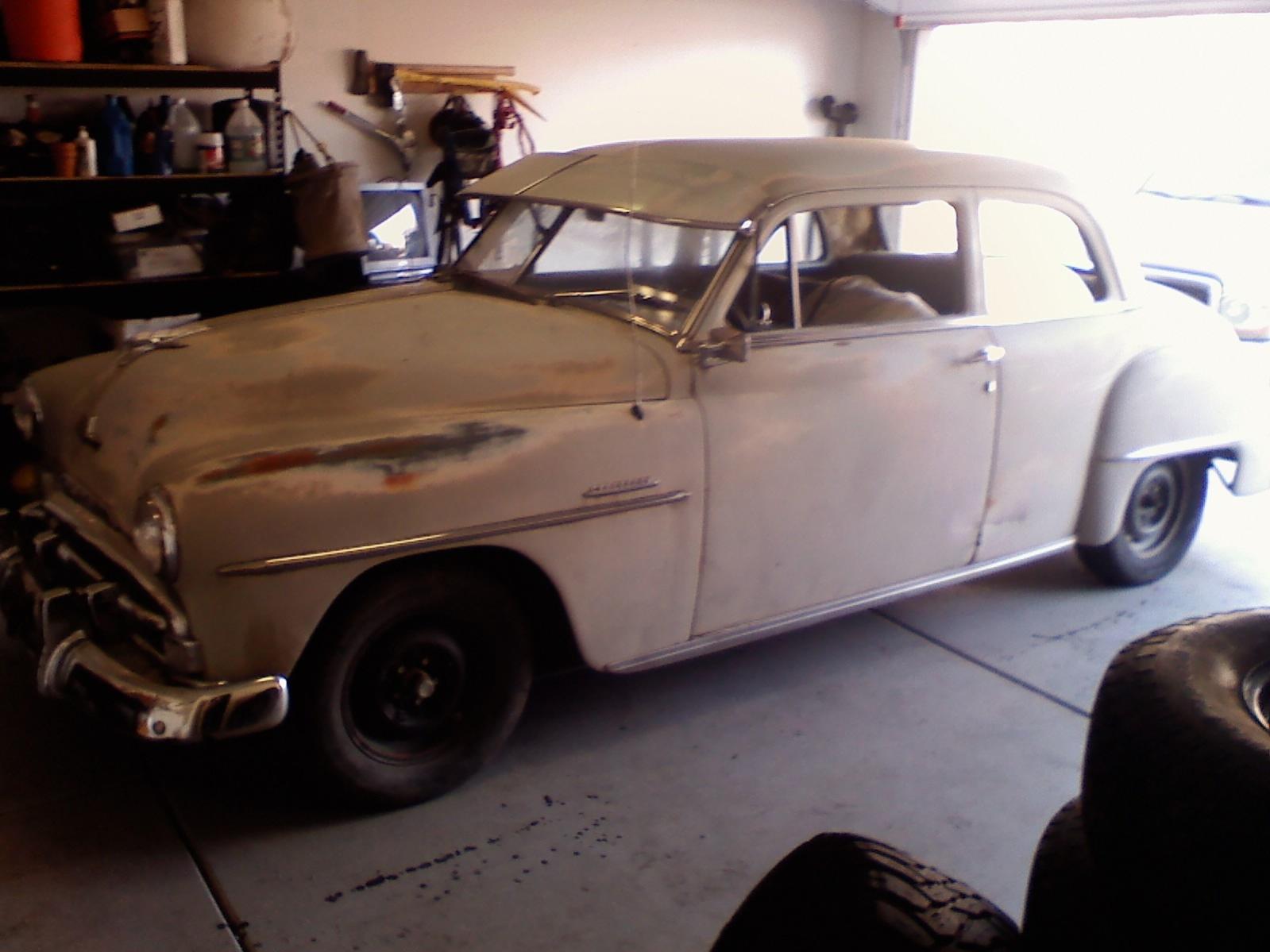

    Well the car looks a little different in pictures. It hasn't been registered since the early 80's. The floors are toast and the motor is a mess.

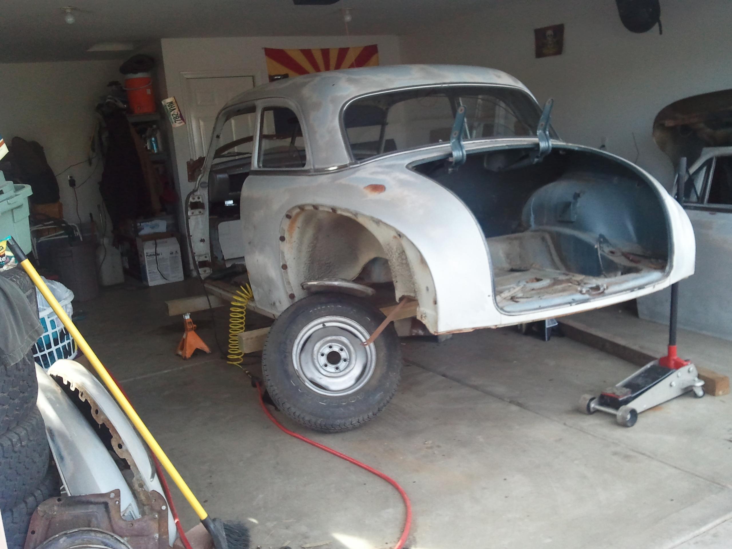

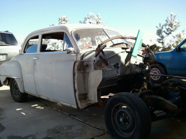

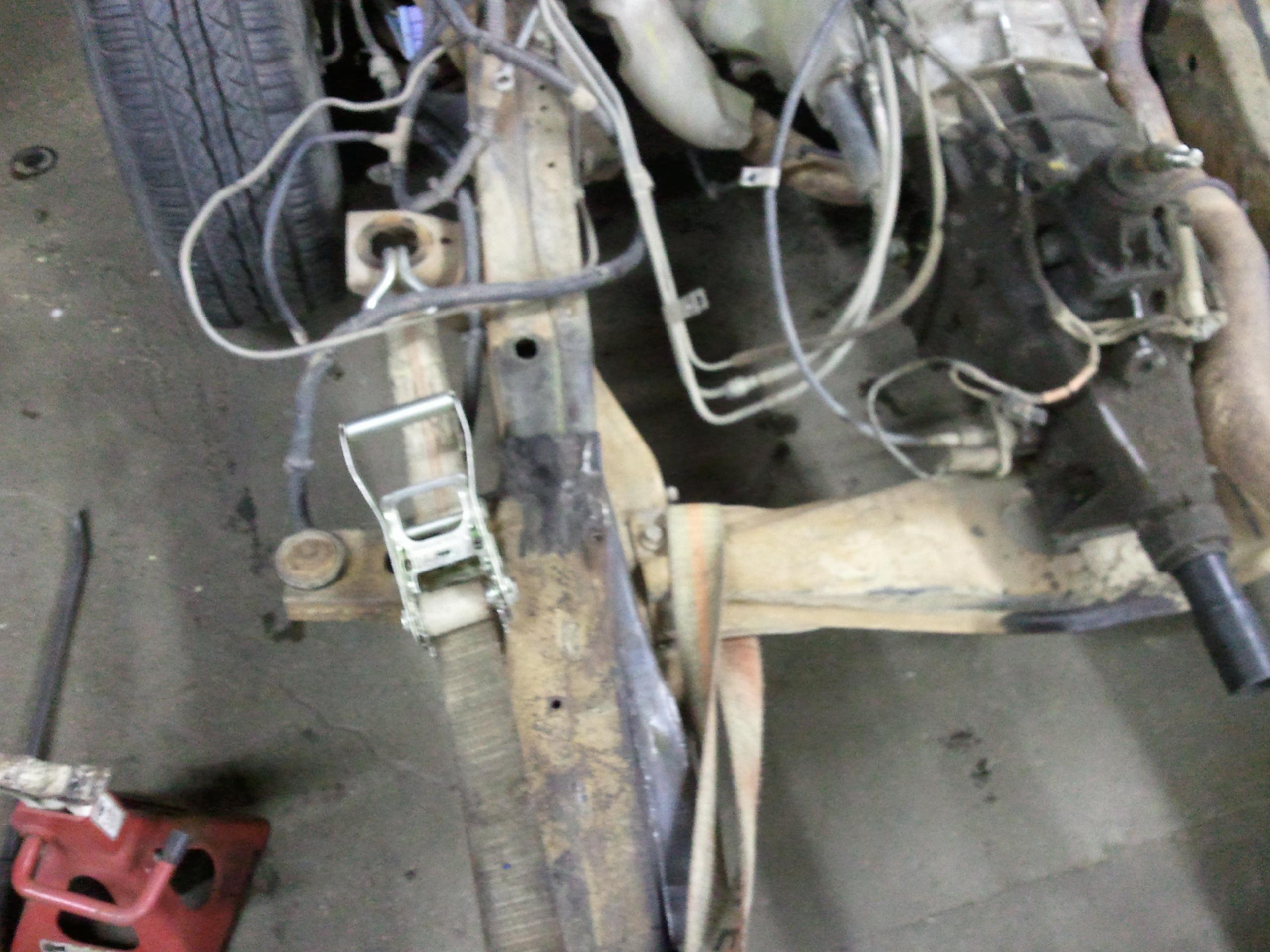

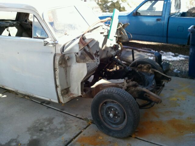

    Ok, here they come. no particular order. The body and chassis are seperate right now.
  10. berickson
    Joined: Jan 15, 2011
    Posts: 30
    berickson

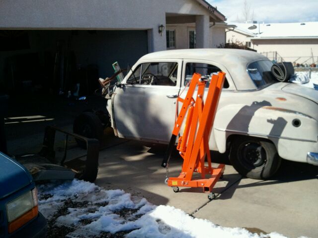

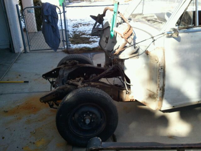

    Here are some more.

    So here is the scoop on this project. We are going to use the front of the dakota clip, and the dakota 3.9 V6 and 5 speed for now. I realize many guys out there get bummed out when they hear about not staying original but i really am looking for driveability and thats priority numero uno. Any feedback would be greatly appreciated. But brute strength and awkwardness did end up getting the body off of the chassis. We did it in the garage and there were four of us, we ended up taking all 4 wheels off of the chassis and rolling it out from under the body. It worked well. Without a lift, i would do it the same way again.

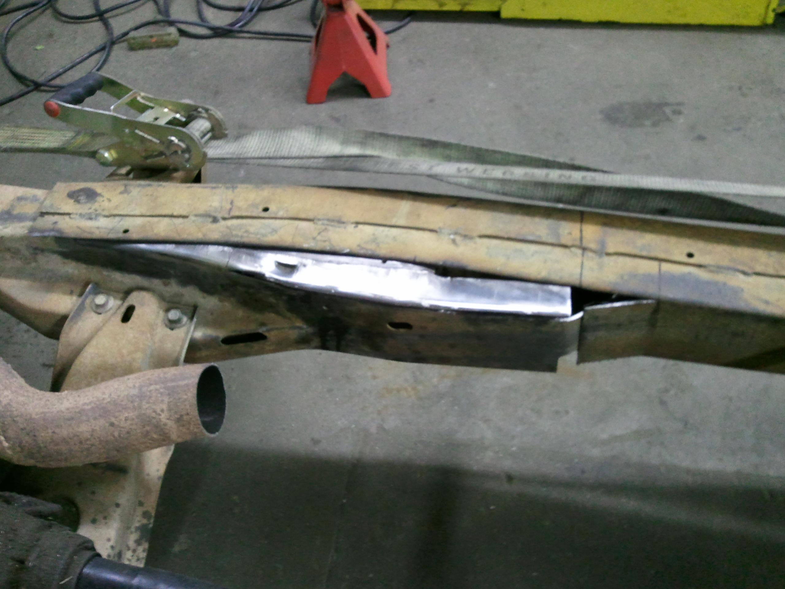

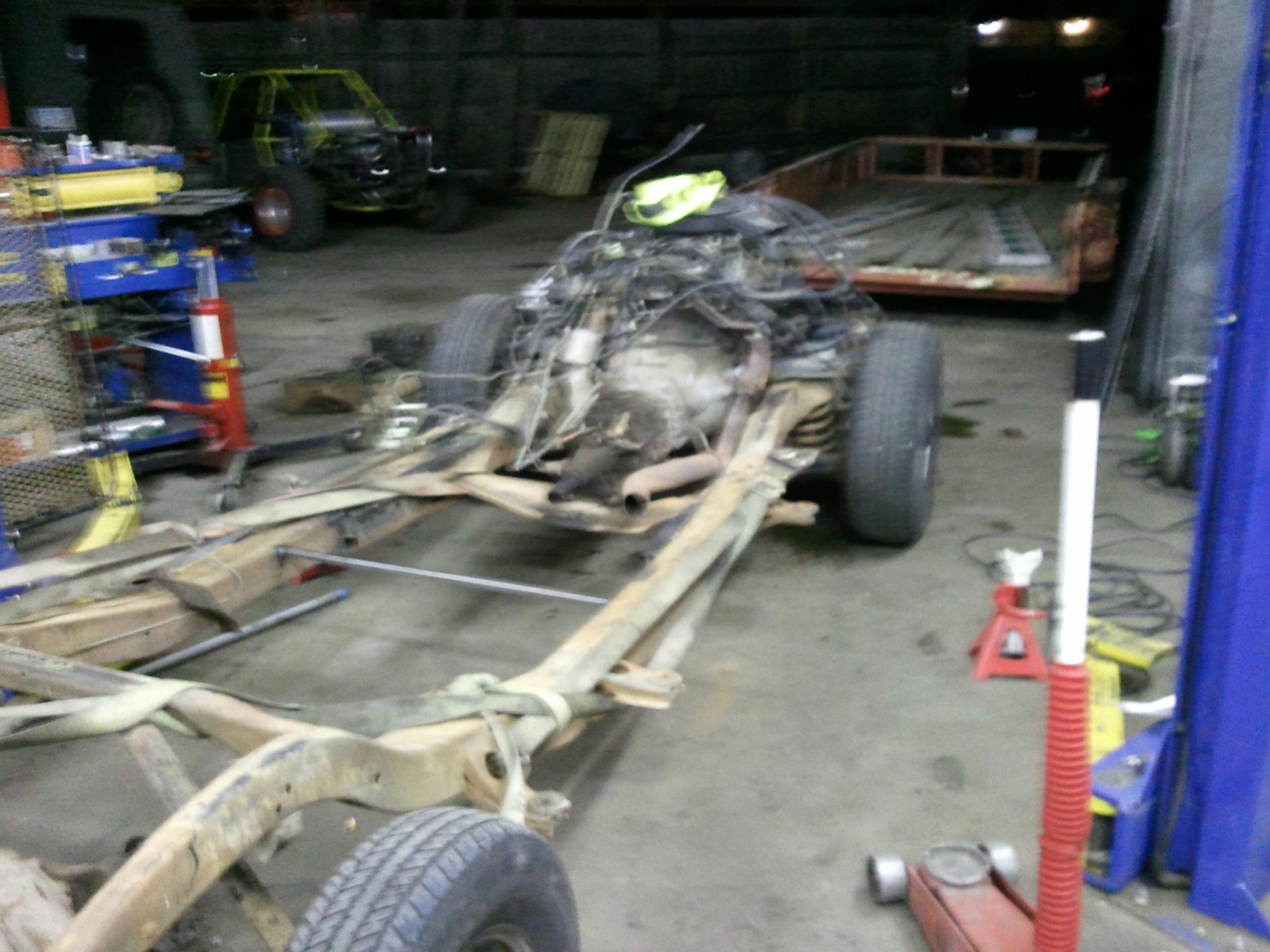

    Ok well here is an update on the progress. Tuesday night we made the final cuts on both chassis ends. i am at lunch right now so i will follow up with more detail on that later. Everything went well. Tomorrow we will be lining everthing up just right, and tacking the finished product in place. the chassis will then go to the alignment shop next week to get the green light.

    Greetings! Am in the process of installing a Dakota clip on my 49 Wayfarer, the previous owner had stripped all the suspension components from the car so going back original wasn't an option, I wish I had though of sliding the Dakota frame rails inside the original Dodge frame, I cut mine off square and butted the two halves together, used fish plates on sides and a cap on the bottom, (it was a bear to get centered and square). I also cut the original Dakota rack mount off, rotated the rack rearward so the rack stub now points at the firewall, not straight up, then notched the crossmember for clearance and fabricated new rack mounts. I still have to modify the front frame horns and fit the front sheetmetal/bumper but I can see light at the end of the tunnel. This particular frame clip may be inexpensive but turned out to be a ton of work, Good Luck, Mike.
