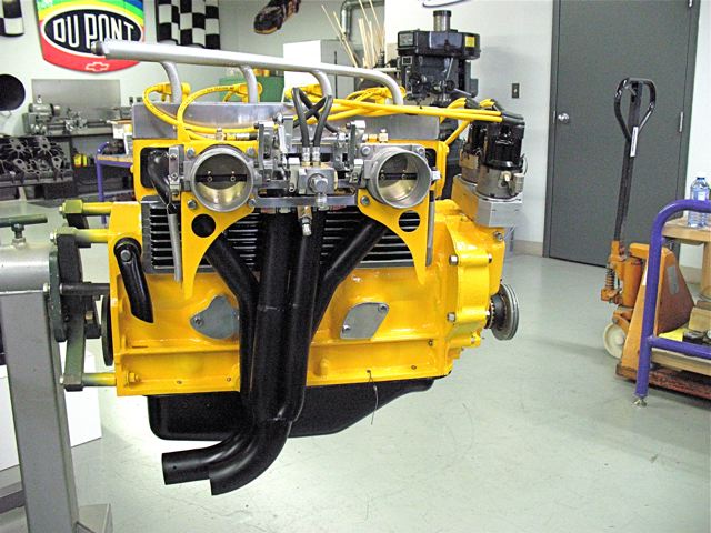

    Taking the risk of being accused of hijacking this thread I wish to point out that a "New" mechanical fuel injection unit came out 2 or 3 years ago. It was featured in both the 12 port news and the Bonneville Racing News. I made one for my car and one for another guy with a 261 to try out. Mine worked OK. He never got his car running. Then I made one for a Buick straight eight that is expected to run at Bonneville this year. We'll see. And I made another one for my new Banger (pictured). Didn't really turn out to be a life changing experiance for me.

    Damn Rich, the banger sure looks great though!!

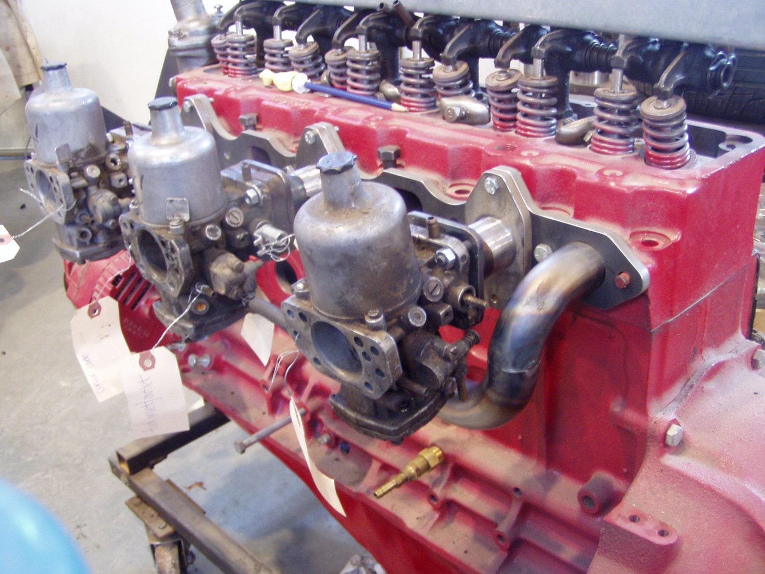

    Babyearl come through with my intake pieces, so that is done and almost completely mocked up. I have the balance tube and linkage to go.
    I have a pair of carbs but am still short 1 (or 2) to match them and get all the linkages worked out.
    The front header almost done, and will hopefully start on the back one this week. With any luck I can get them all tacked together and trial fit soon.

  25. 6inarow
    Joined: Jan 24, 2007
    Posts: 2,476
    6inarow
    So far....
  26. I like that!
    Will that fit the HF SU's? Those are HIF with the internal floatbowl.
