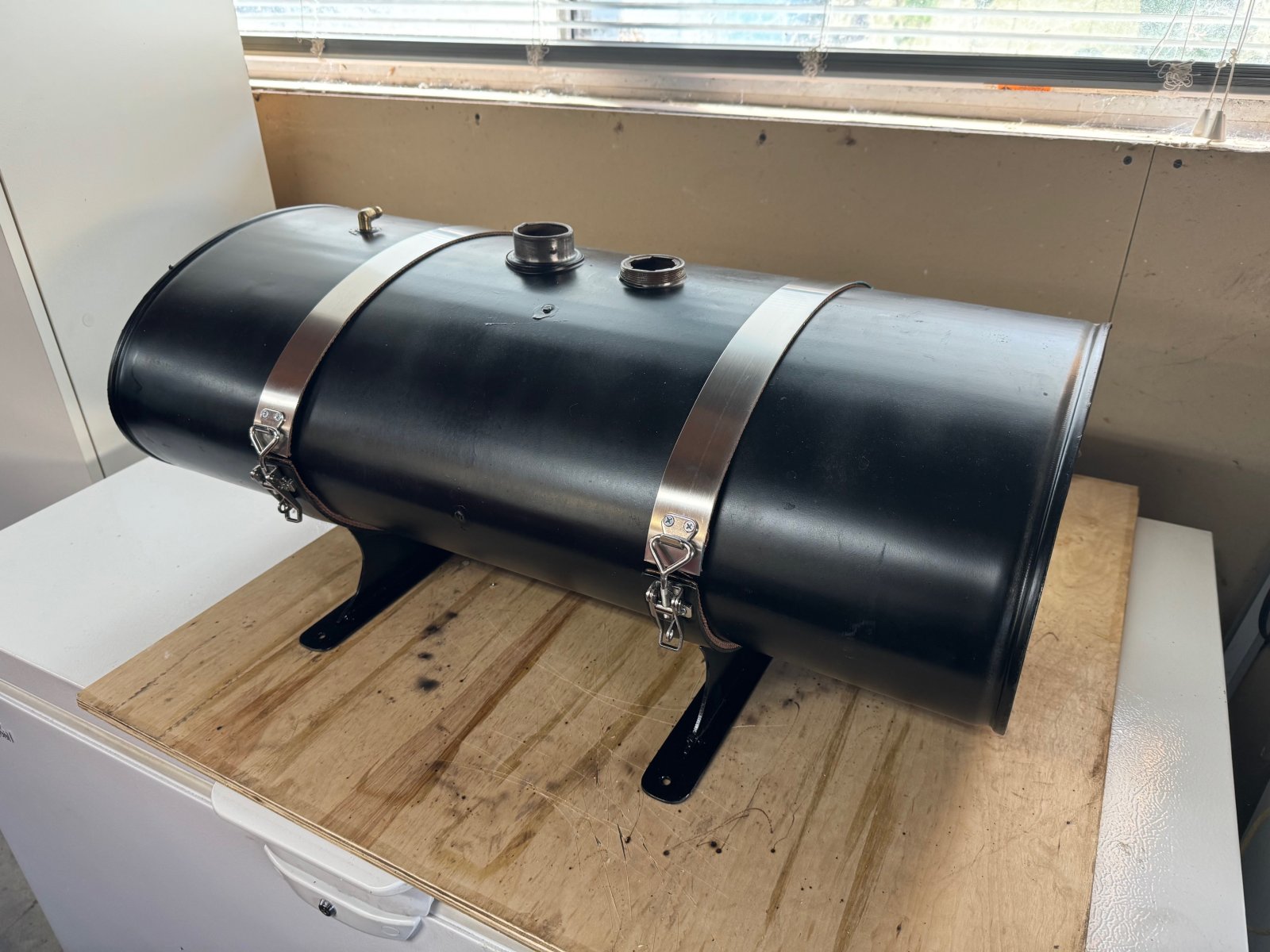

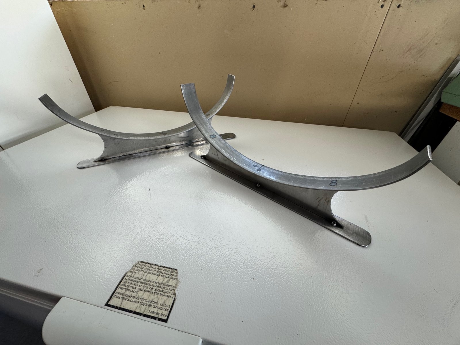

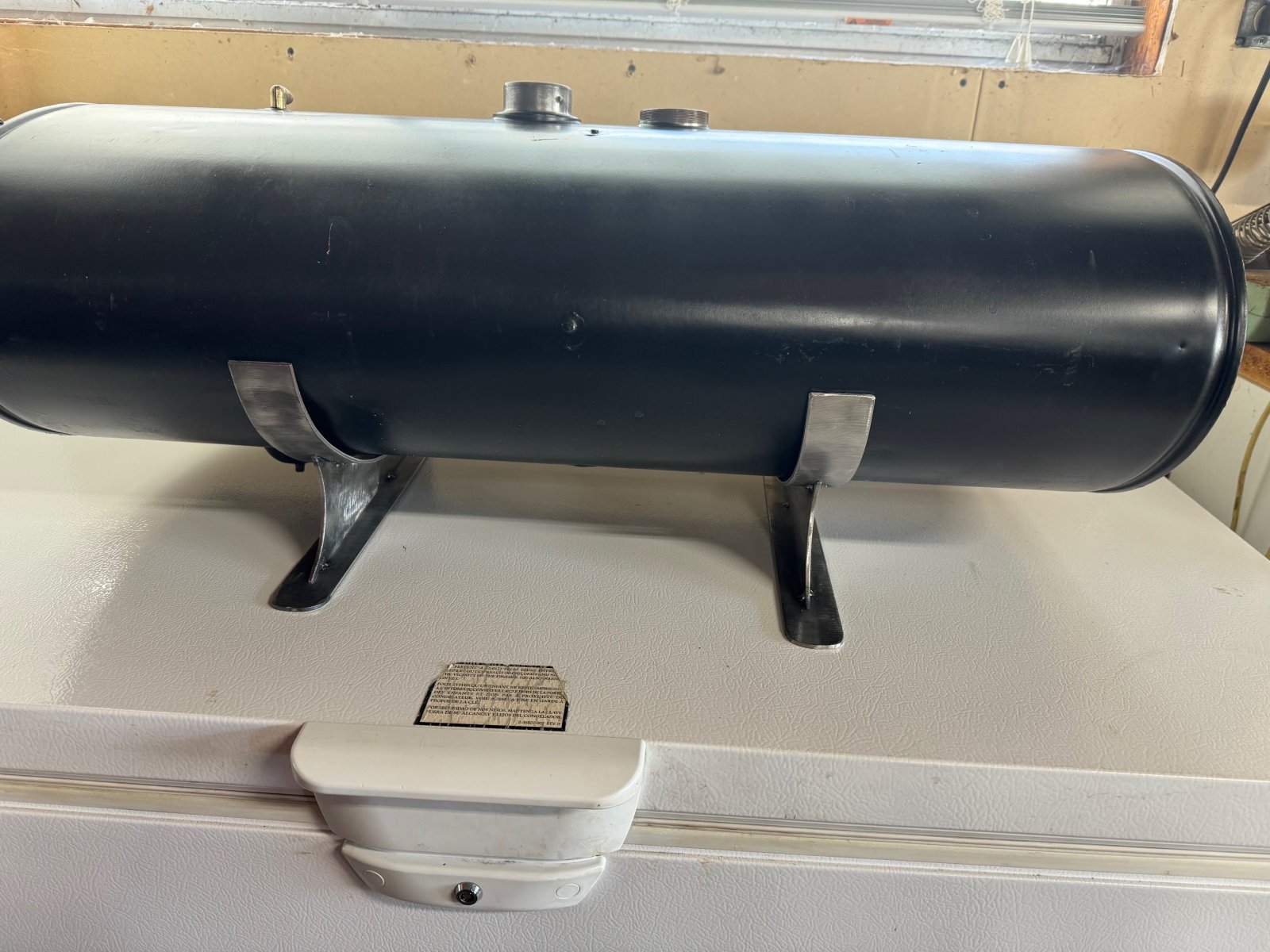

    Got the tank done. May need another coat of paint at some point, but that can wait. IMG_3950.jpeg

  2. CSPIDY
    Joined: Nov 15, 2020
    Posts: 1,284
    CSPIDY
    Very stylish

    Thank you. I like it. Since it will be hidden in the trunk, nobody will see it, but that's fine with me. I'm like that.

  5. Your fuel tank looks great!

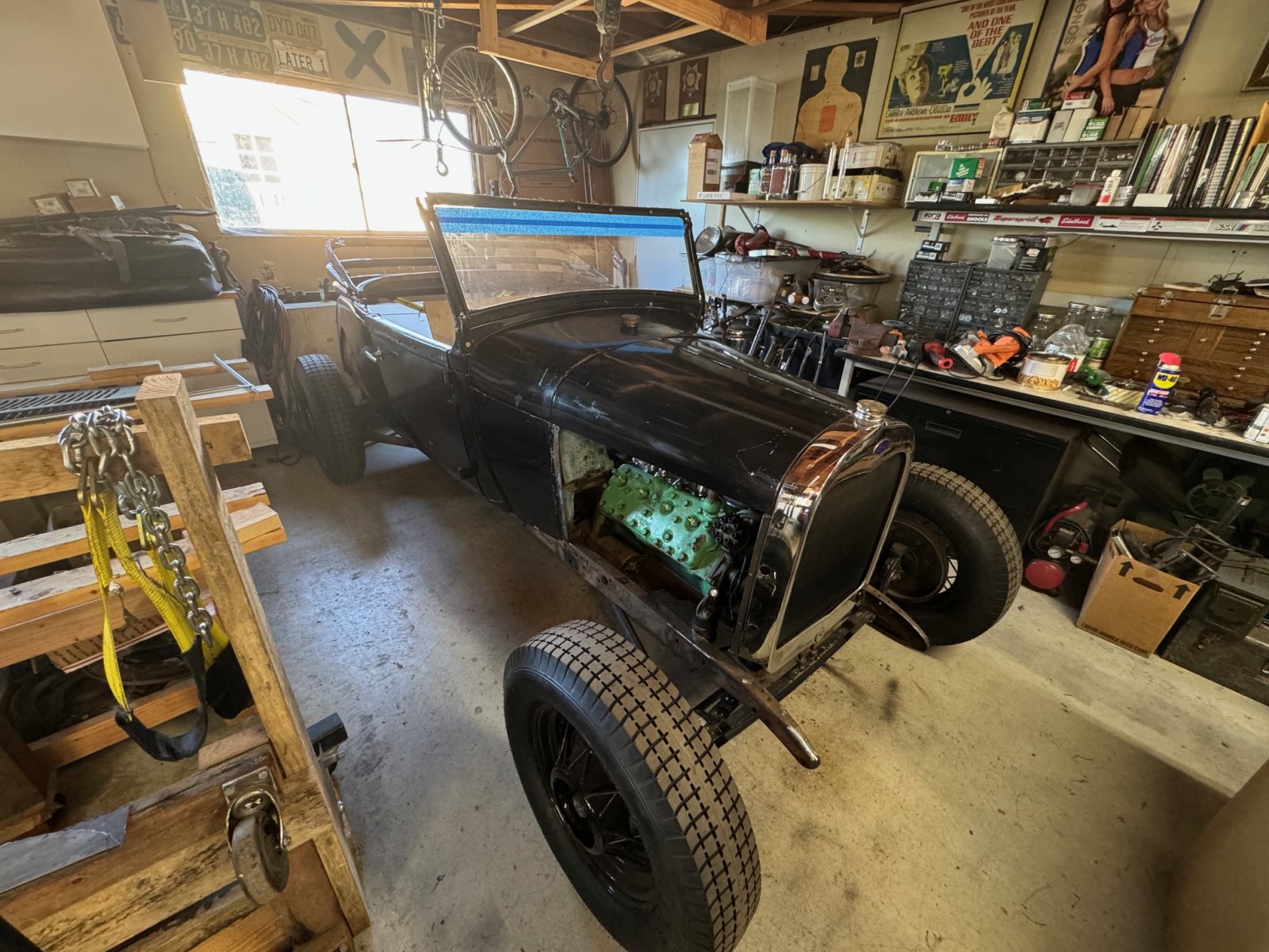

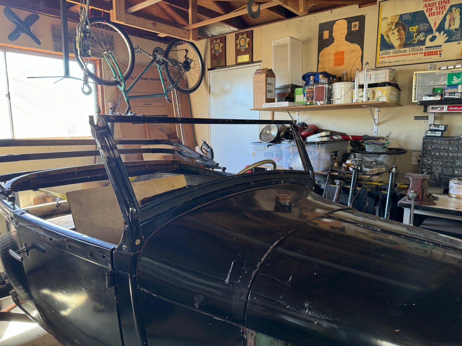

    Put the body back on to check steering column, pedals, and windshield chop. Also had the wife sit in it to verify steering wheel location and seat height. Seems to be all good. Chopping the windshield soon. Then the top. IMG_3959.jpeg IMG_3961.jpeg

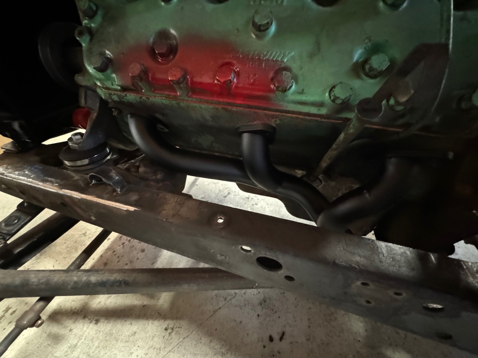

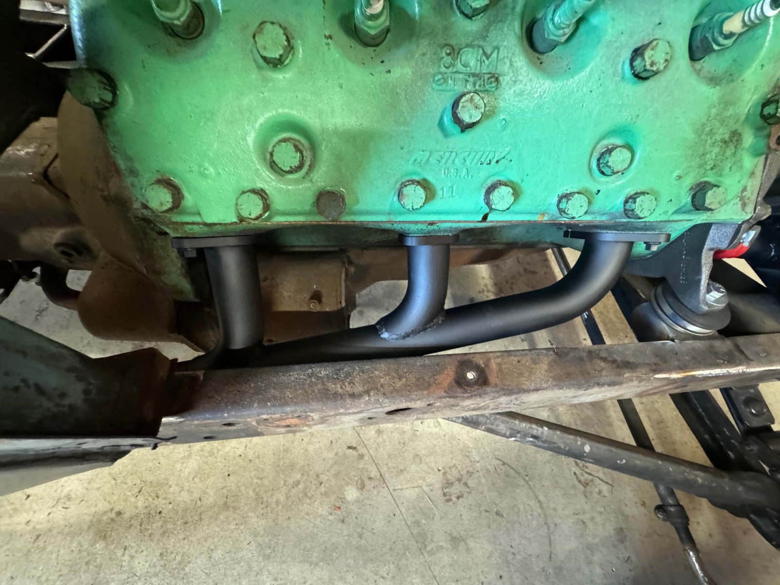

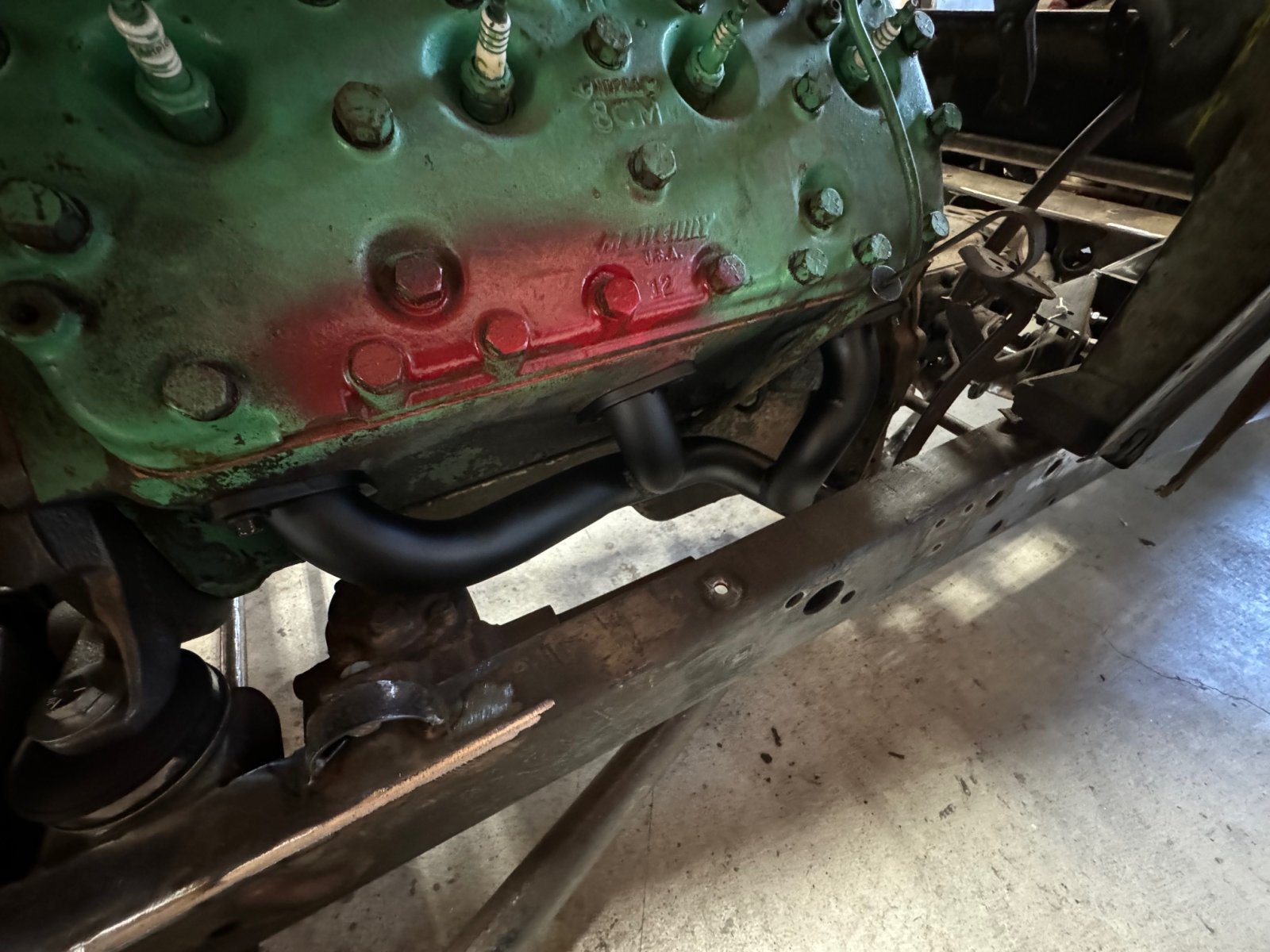

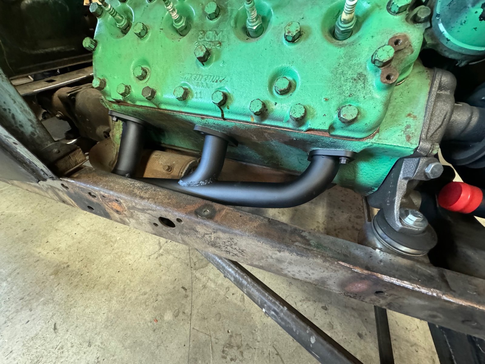

    IMG_3966.jpeg IMG_3969.jpeg IMG_3968.jpeg IMG_3970.jpeg I decided to go with headers inside the frame so I can later choose to run with or without a hood. They fit perfect. I’ll probably put them on my truck after the test fit, and buy another pair for the roadster once it’s rebuilt.

    While waiting on other parts and things, I decided to chop the windshield. You can see the tape in the previous pictures. That was a 3” haircut. I decided to go 2”. I like it. IMG_4022.jpeg

  15. hotrodA
    Joined: Sep 12, 2002
    Posts: 7,790
    hotrodA
    Great build! Thanks for the updates.
    BTW, who makes the headers? They look like they will clear the steering box great.
  16. Jeff34
    Joined: Jun 2, 2015
    Posts: 1,468
    Jeff34
    Thanks! Those are just the cheap Speedway headers. It was suggested that I use these so I wouldn't feel bad if I needed to mangle them to get them to fit. I got lucky with the clearance to the steering box. I welded the mount in before I had the headers, so it was just dumb luck that it clears (and only by a tiny bit!)
    https://www.speedwaymotors.com/Spee...thead-V8-Exhaust-Headers-Raw-Finish,1727.html

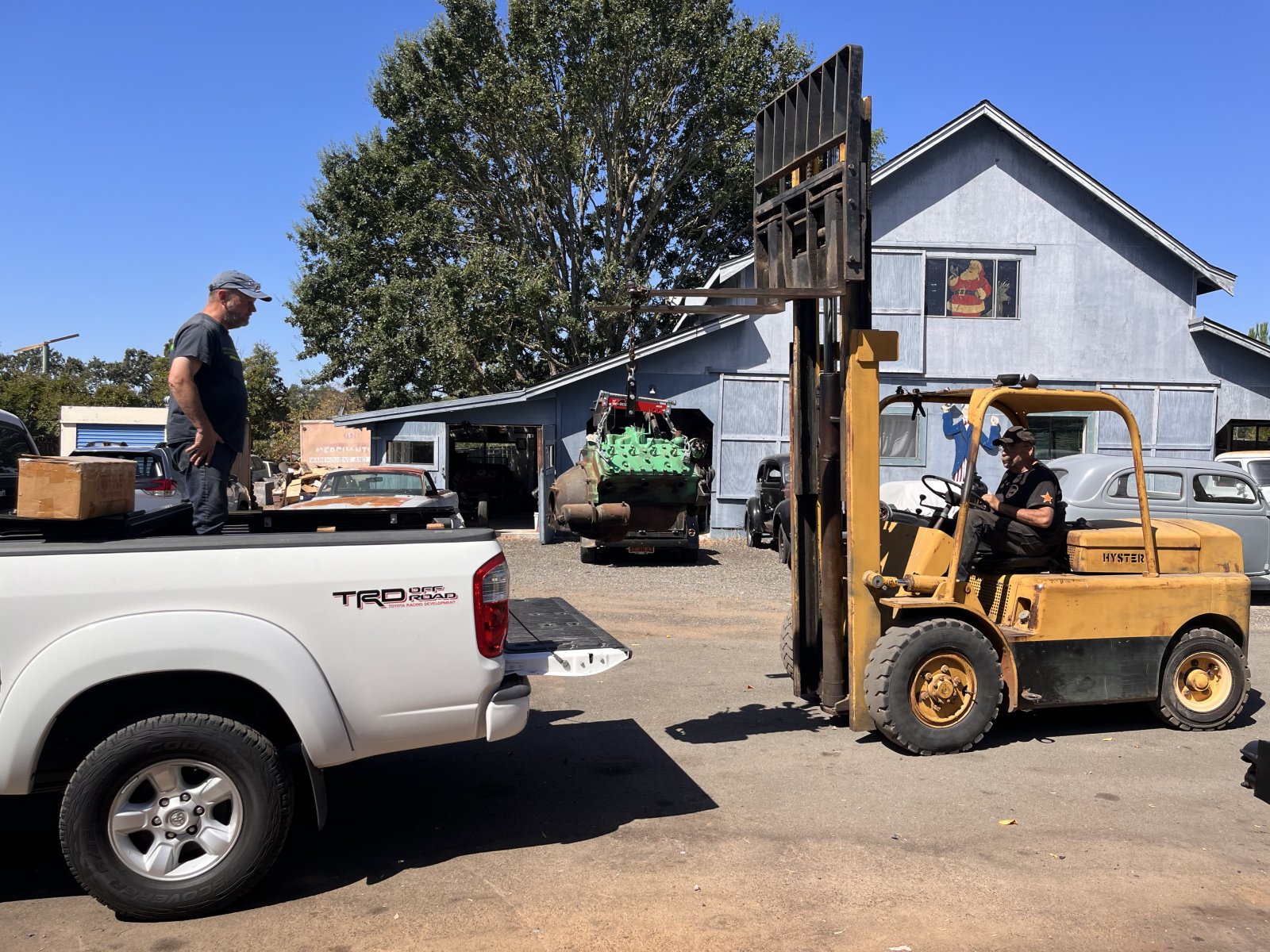

  19. Jeff34
    Joined: Jun 2, 2015
    Posts: 1,468
    Jeff34

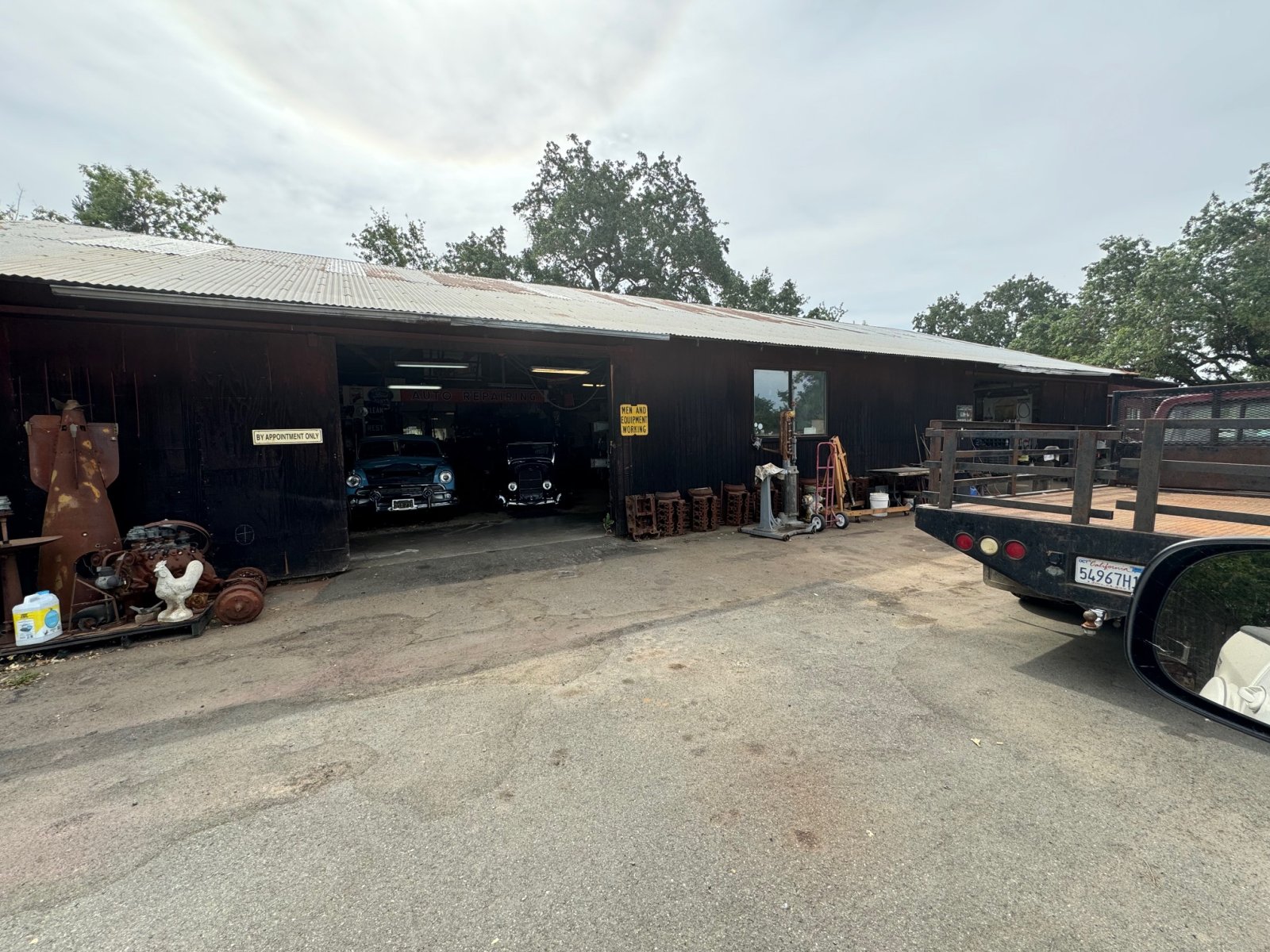

    Dropped off my Merc with Vern yesterday. He’s thinking 3 months to get it done. IMG_6802.jpeg IMG_6793.jpeg IMG_6799.jpeg

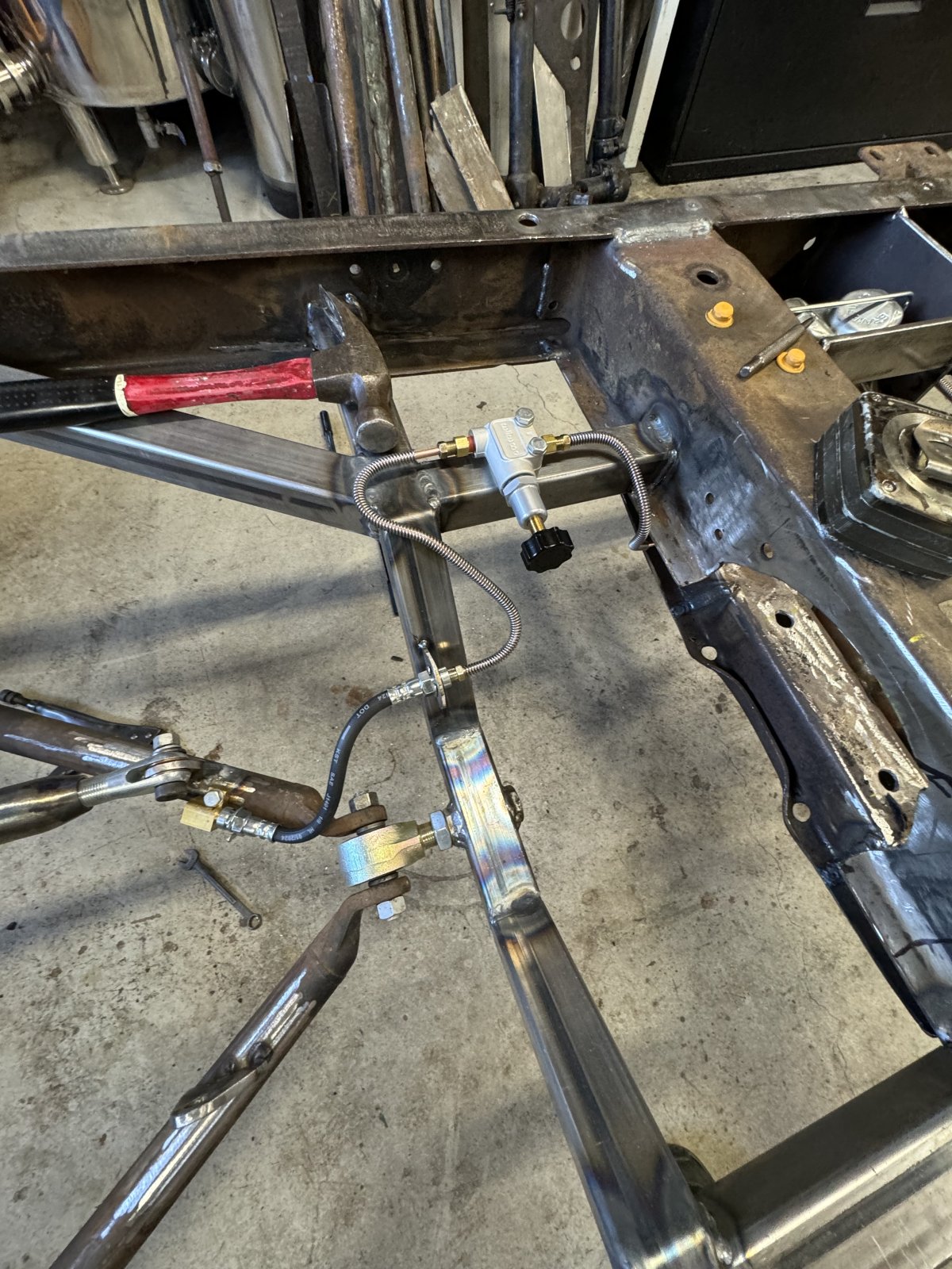

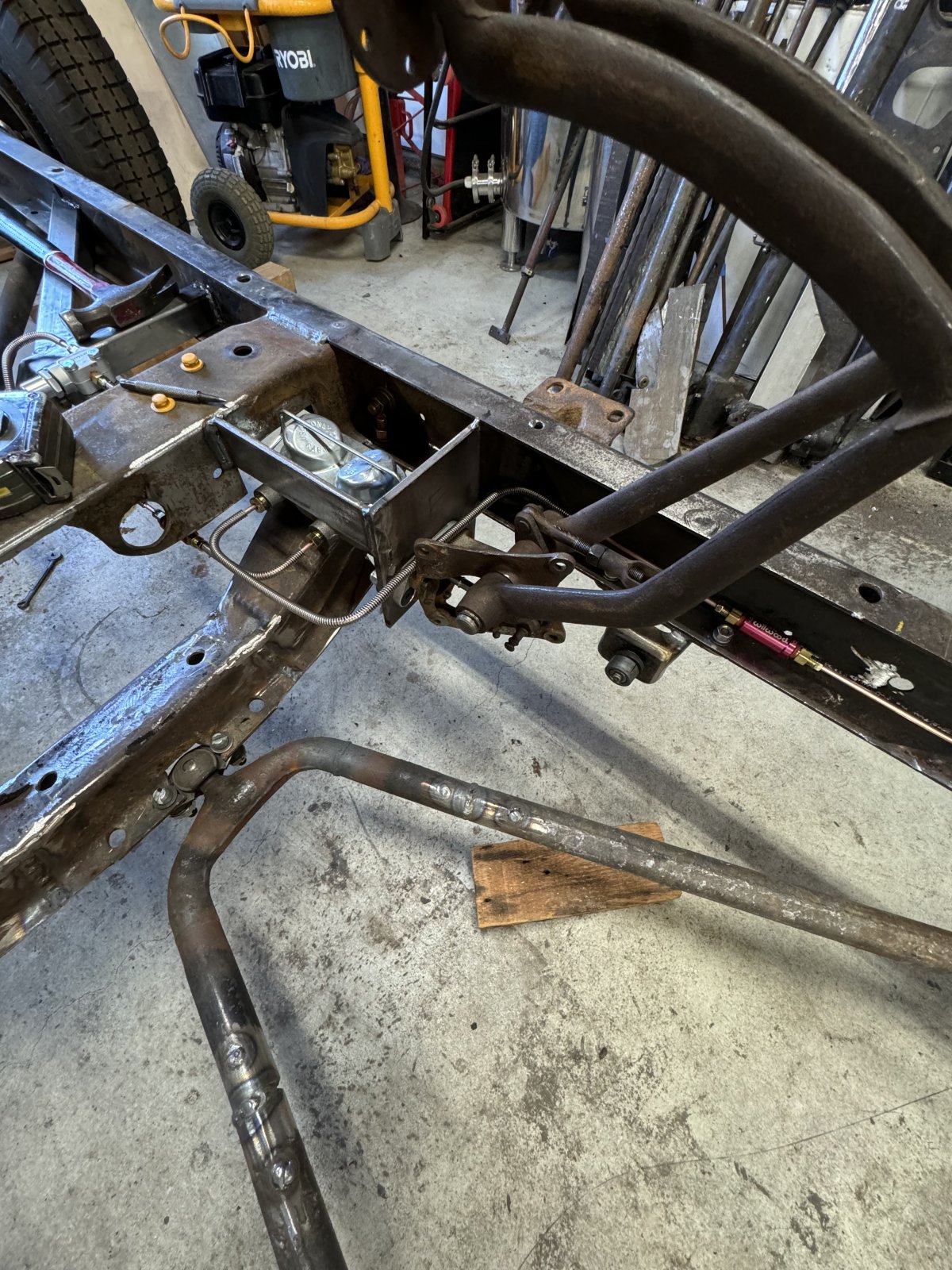

    And I got most of my brake lines made and temporarily installed. IMG_4150.jpeg IMG_4149.jpeg
  21. Outback
    Joined: Mar 4, 2005
    Posts: 4,030
    Outback
    from NE Vic, Oz
    Nice work, 3 months to get it ready to fit up for the final time? :p

    So cool that Vern's doing the engine. The brake lines are looking great!

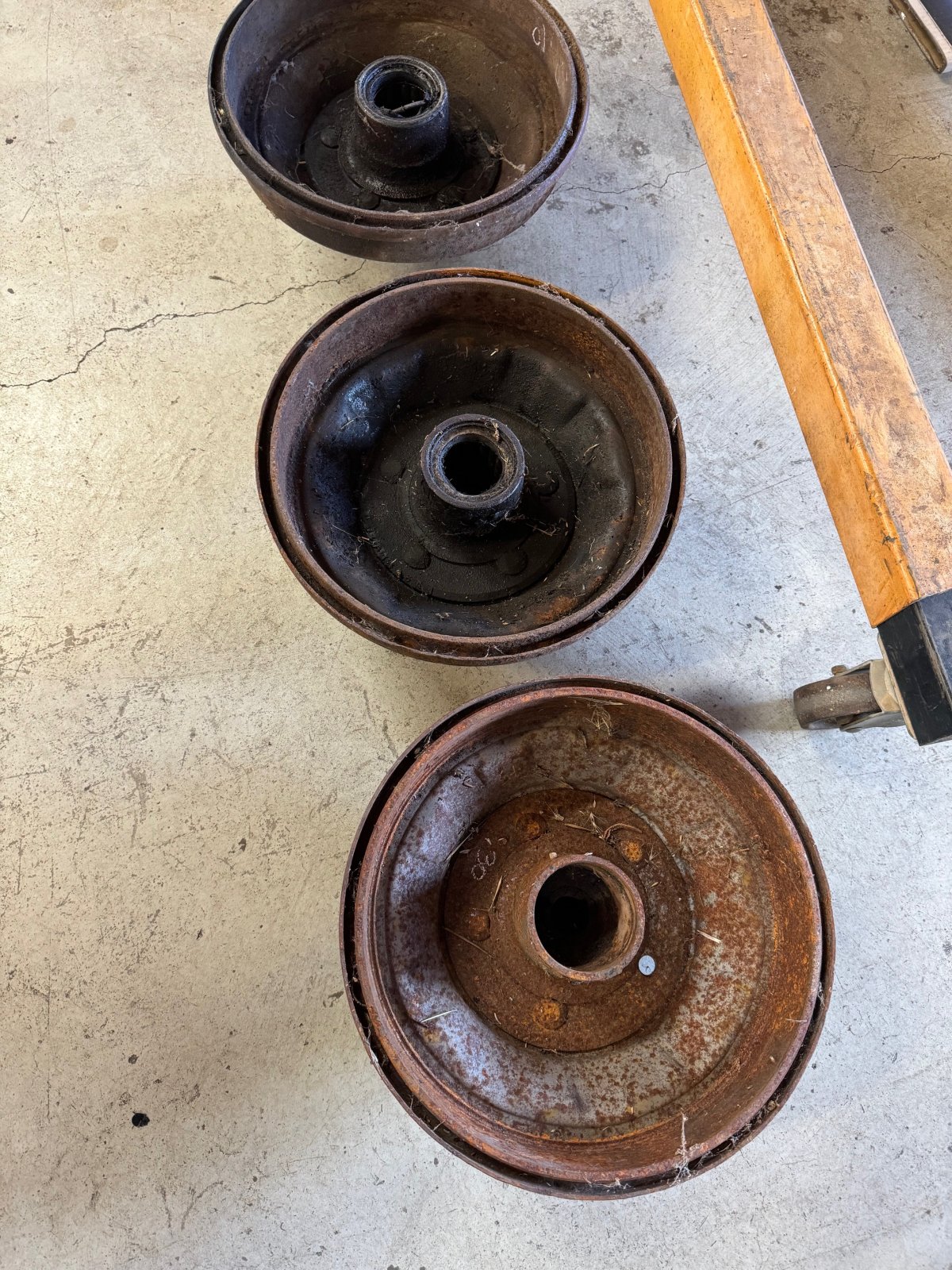

    IMG_4154.jpeg Got a text yesterday about some ‘40 drums. Went over today to pick them up. They are .01, .02, and .03 over. Should be enough meat to turn them! So happy to have these.

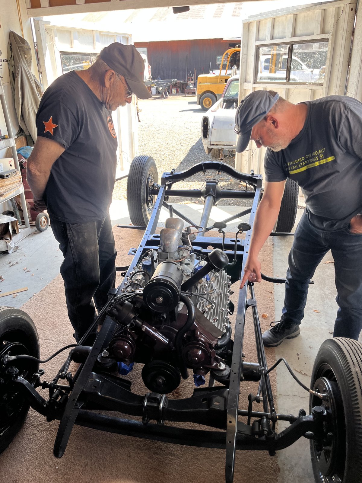

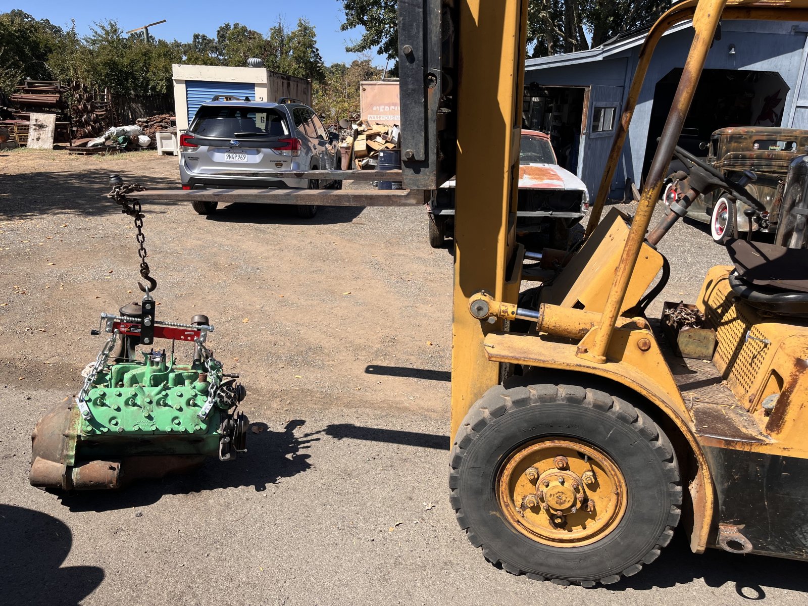

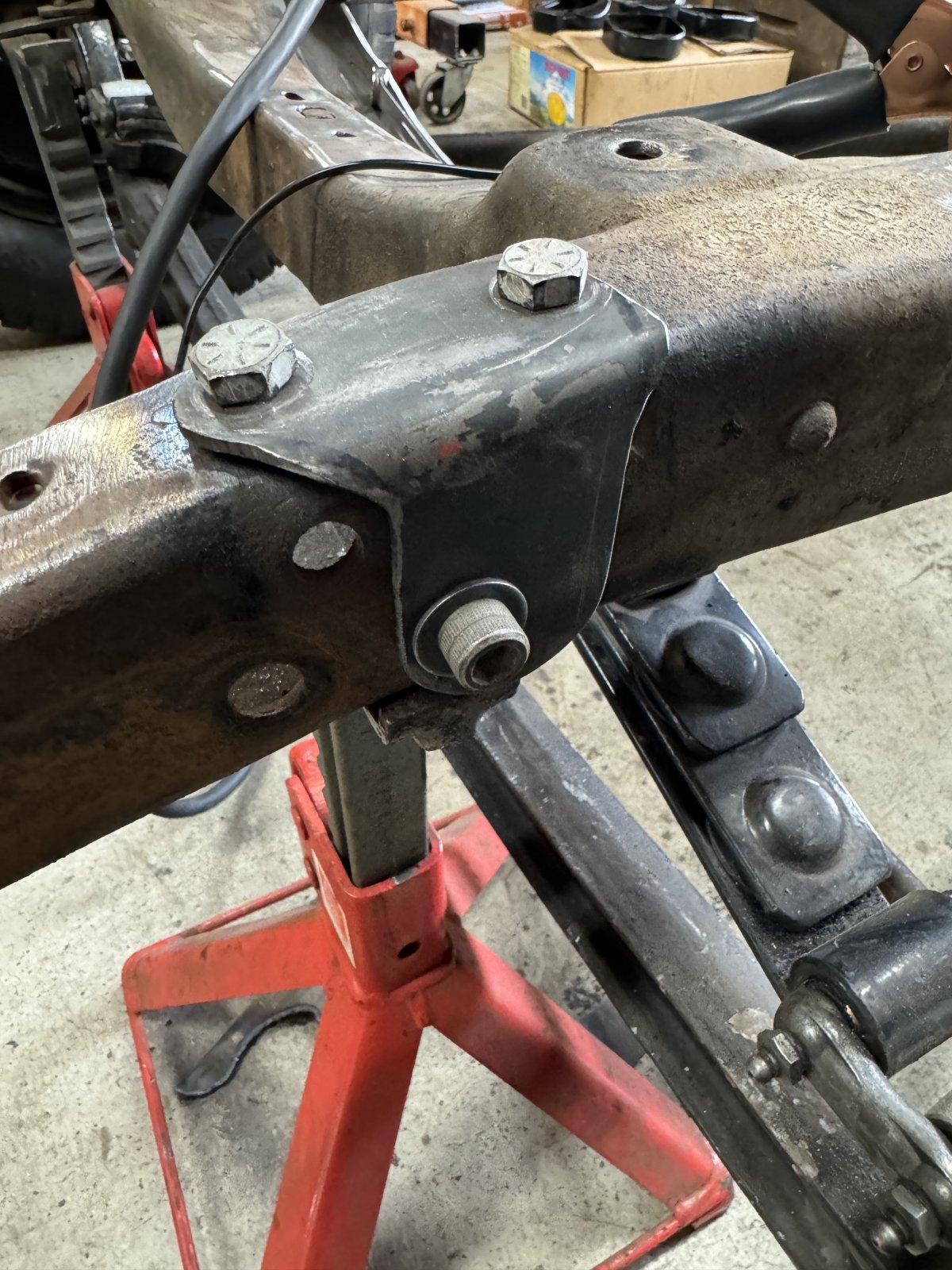

    Quick Saturday afternoon update on the roadster. I went up to Vern’s place on Friday. He had the Merc torn down. He said it’s the best block he’s seen in a long time. No cracks, not even where we may have expected them. Stock bore. Everything was in great condition.
    Vern did talk Mike Bishop into coming out of retirement to help do some porting work on a couple of flatheads, including mine. I met him yesterday while I was there. I couldn’t be more excited to have two Northern California legends building my flathead.

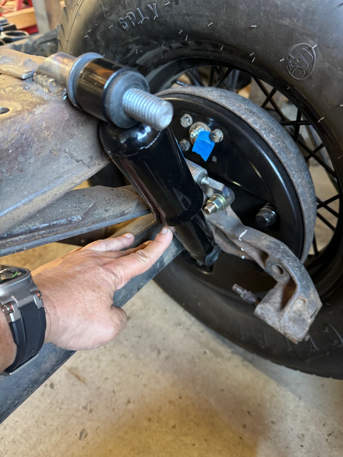

    In the garage, I built my upper rear shock mounts based off what I saw on a ch***is yesterday. I’m going to mount the lowers on the radius rod extensions. More on that later. I also figured out how I’m going to mount my front shocks. More on that later as well. Here’s a few pics from today. IMG_4177.jpeg IMG_4178.jpeg IMG_4179.jpeg

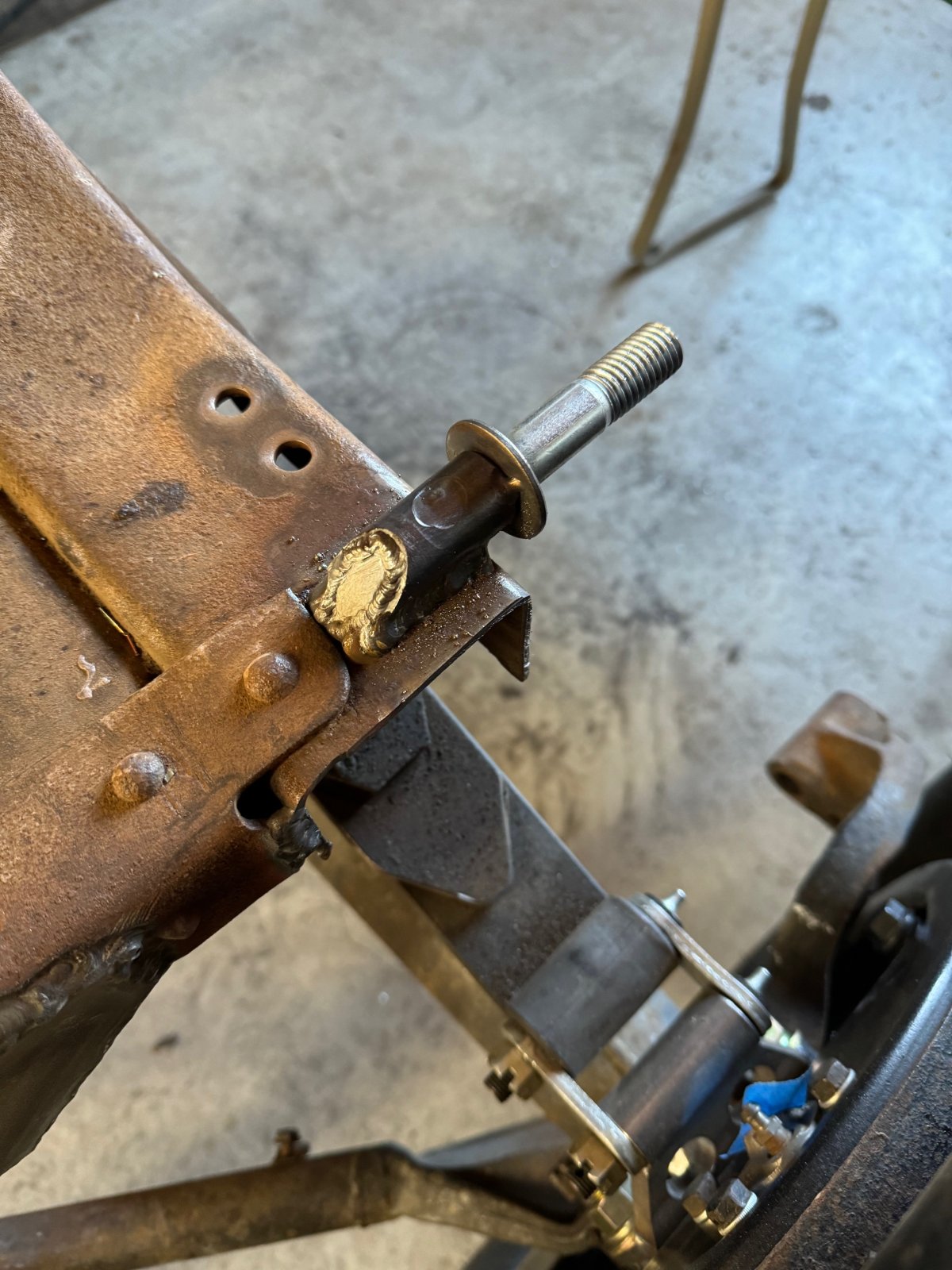

  26. Jeff34
    Joined: Jun 2, 2015
    Posts: 1,468
    Jeff34
    IMG_4184.jpeg Working on the upper front shock mount. Not sure how this will work out. May need a few revisions to get it right. I may need a bit more space to the front of the lower hole for a bolt IMG_4184.jpeg

  28. J.Ukrop
    Joined: Nov 10, 2008
    Posts: 3,977
    J.Ukrop
    SUPER MODERATOR
    I like the look of that! Interested to see how you go about connecting the front shock. Oh, and those backing plates are looking niceeee

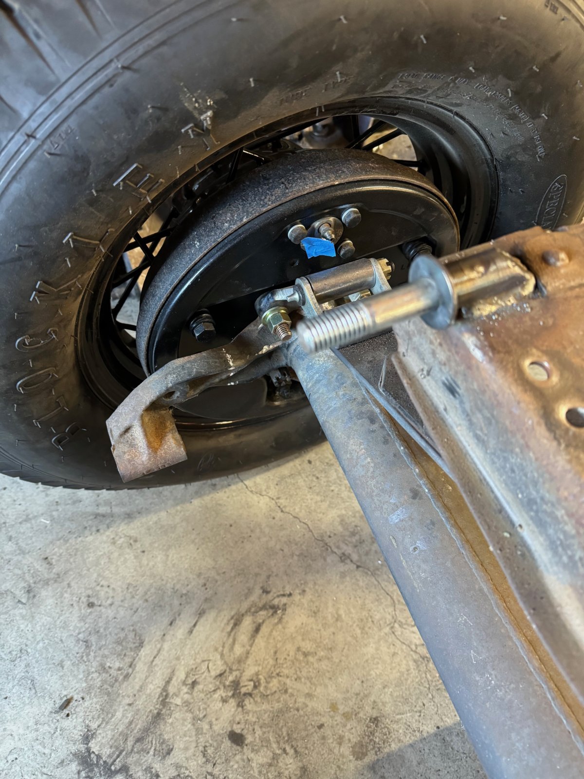

  29. Jeff34
    Joined: Jun 2, 2015
    Posts: 1,468
    Jeff34
    Thanks, Joey! I had to go a bit of a different route. I wasn't really diggin' the way those were working out. I'll post pictures soon, but I ran out of Argon, so I couldn't finish welding them up. I'm bolting a mount to the three holes where the fender brace would have mounted.
  30. Speedway Headers: You might want to look down the pipes and see how they cut the holes in the main tubes (for the middle and rear tubes). I saw a set where they just did a crude cutting torch hole that was nowhere near the size of the actual pipes. Caused a heck of a restriction for the rear 3 cylinders of each bank.
