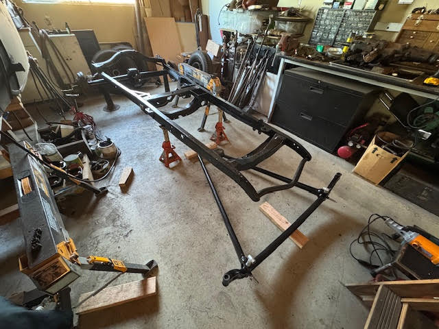

  8. Jeff34
    Joined: Jun 2, 2015
    Posts: 1,472
    Jeff34

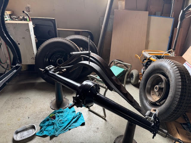

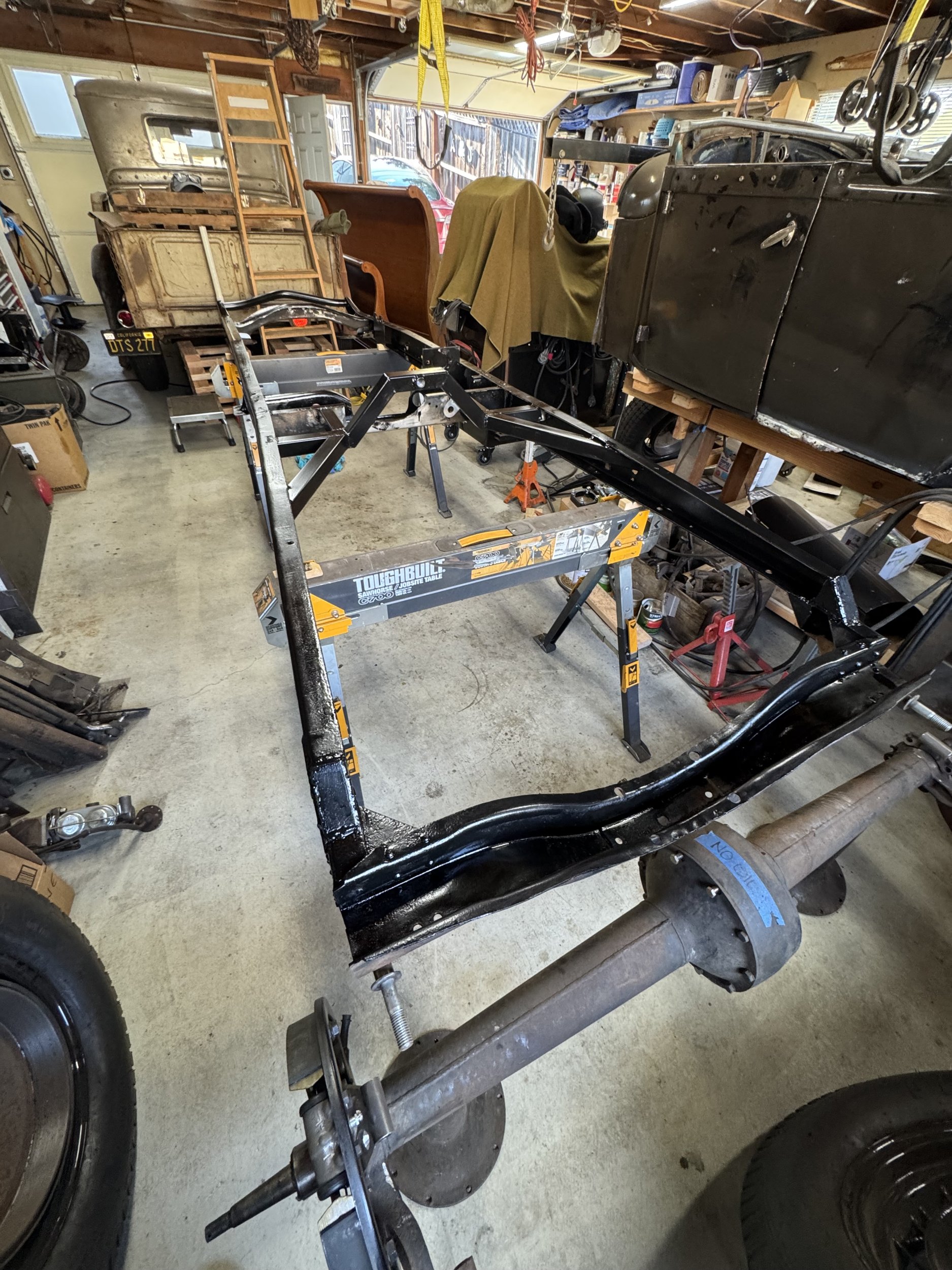

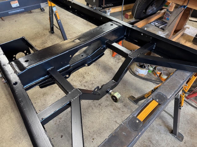

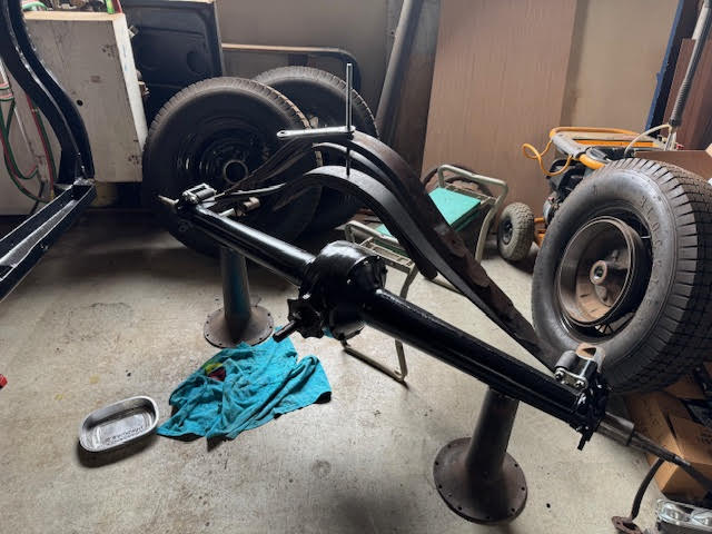

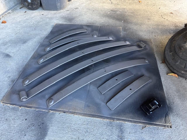

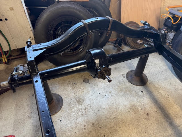

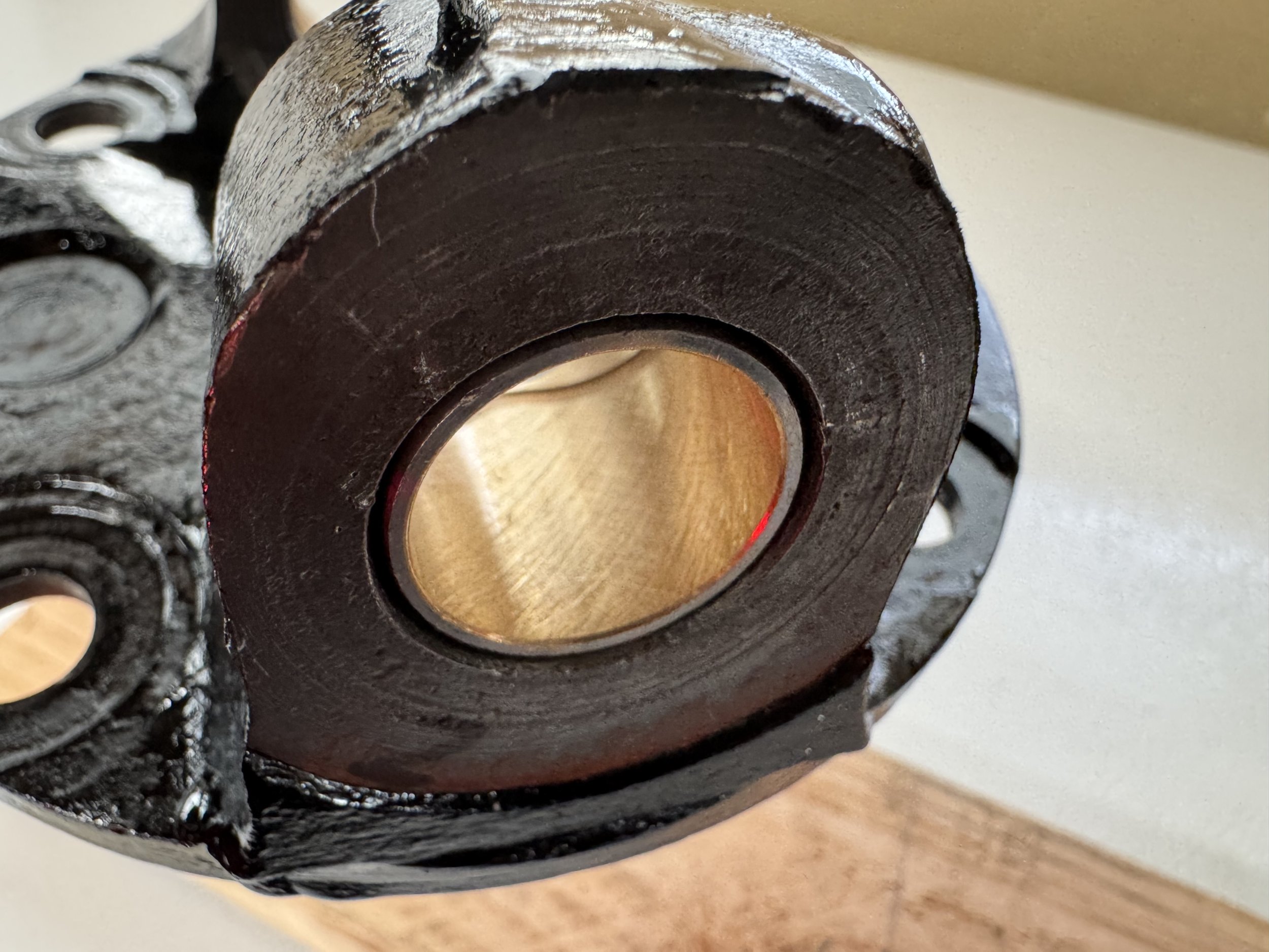

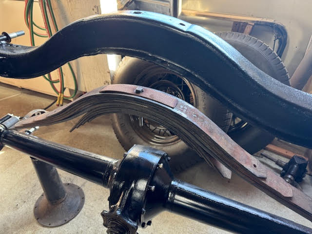

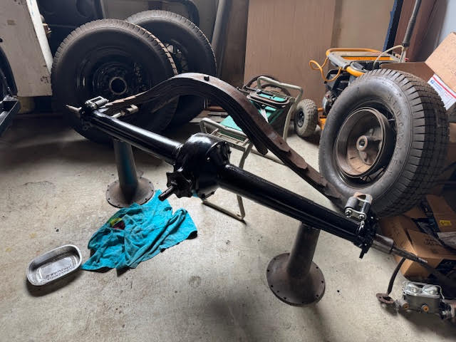

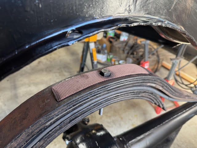

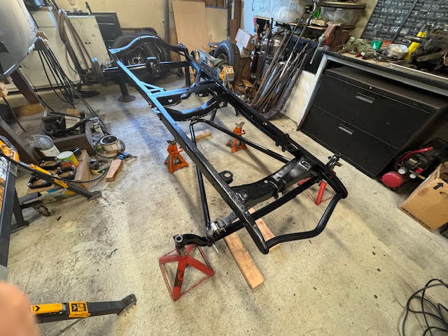

    Got most of the ch***is put back together today. I need to take a week hiatus for some house projects, so I'll be out of this for a bit. Wanted to get this much done. Pics aren't in order...sorry. frame 0.jpg frame 1.jpg frame 2.jpg frame 3.jpg frame 4.jpg frame 5.jpg frame 6.jpg frame 7.jpg frame 8.jpg frame 9.jpg
    Okie Pete, brEad, Tim and 2 others like this.

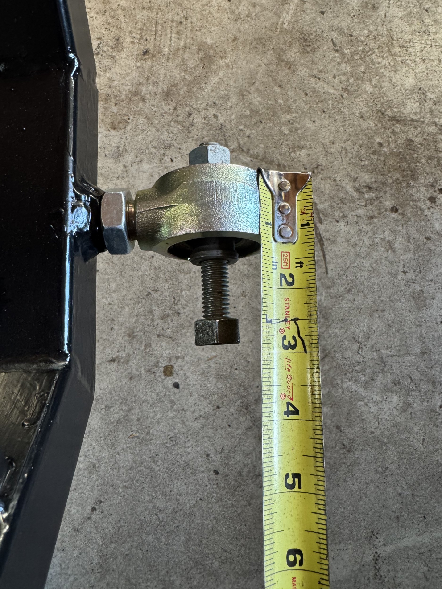

    Looks like large heim joint for Henry designed front suspension. What size is heim?
  10. Jeff34
    Joined: Jun 2, 2015
    Posts: 1,472
    Jeff34
    Front is stock Henry. Rear has a Rock Johnny joint for the radius rods. Does that help?
  11. AmishMike
    Joined: Mar 27, 2014
    Posts: 1,567
    AmishMike

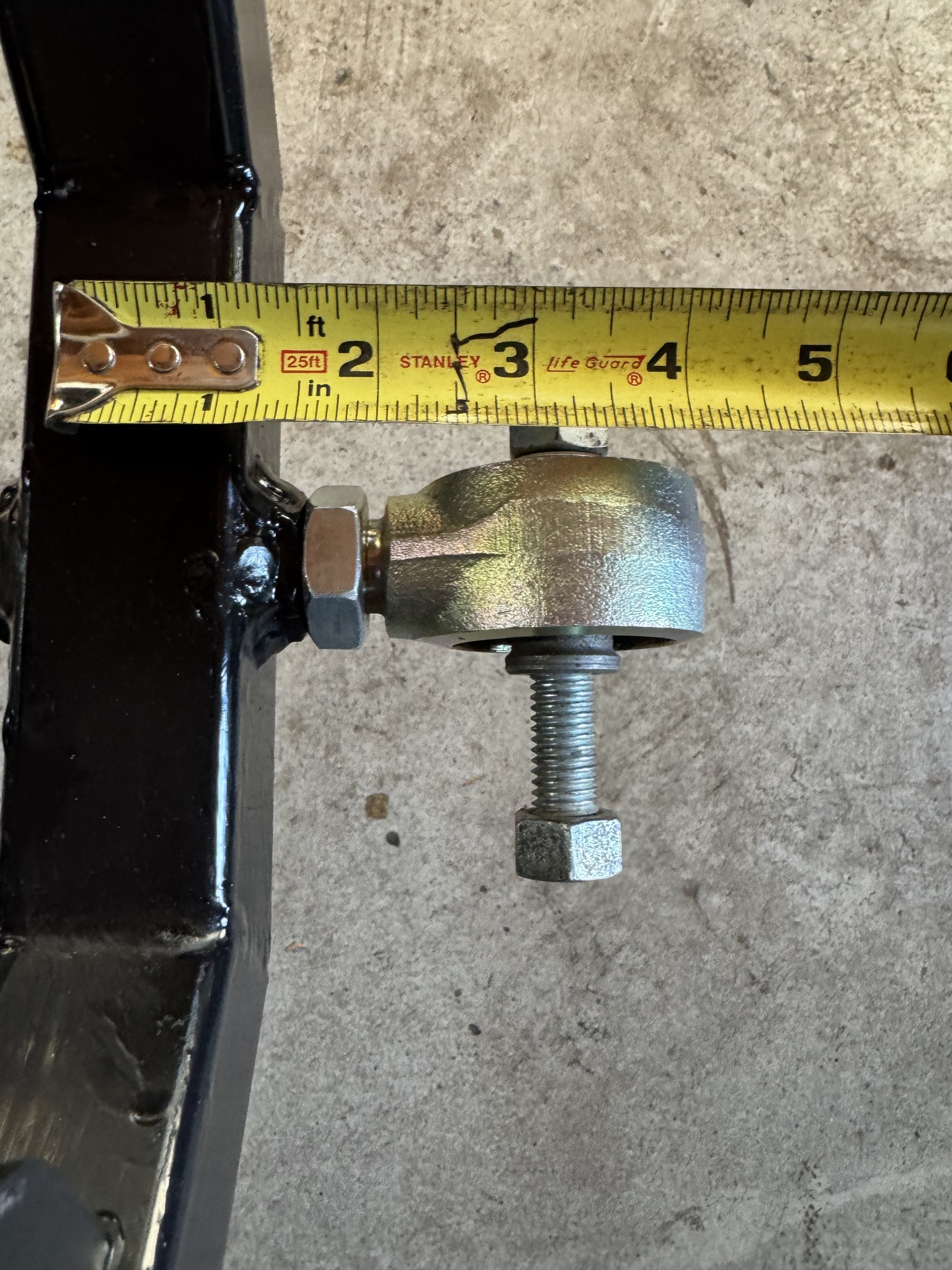

    Johnny joint to some, heim to others, what size? Tks
  12. Jeff34
    Joined: Jun 2, 2015
    Posts: 1,472
    Jeff34
    I'll have to double check, but I believe the ID of the sleeve is 1/2", and the threaded part is 3/4"
    AmishMike likes this.
  13. A Johnny Joint is a good choice for your front mount for the rear radius rods . . . much better than a typical heim joint. Also, most of them can be rebuilt with new urethane inner bushings.

    Johnny joint vs typical heim joint. I thought different name for same thing. Maybe need explain “typical”. Maybe I missing something. Help
  15. Jeff34
    Joined: Jun 2, 2015
    Posts: 1,472
    Jeff34
    My understanding is that a Johnny Joint is a metal spherical ball inside a rubber mount, while a Heim Joint is metal on metal. Please smack me if I’m wrong. Here are some pictures of mine with a ruler for size reference. It is a 1/2” they hole. 3/4” thread.
  16. AmishMike
    Posts: 1,567
    AmishMike
    Some heim ball has plastic or other between other metal. Do not know about rubber. Tks for size

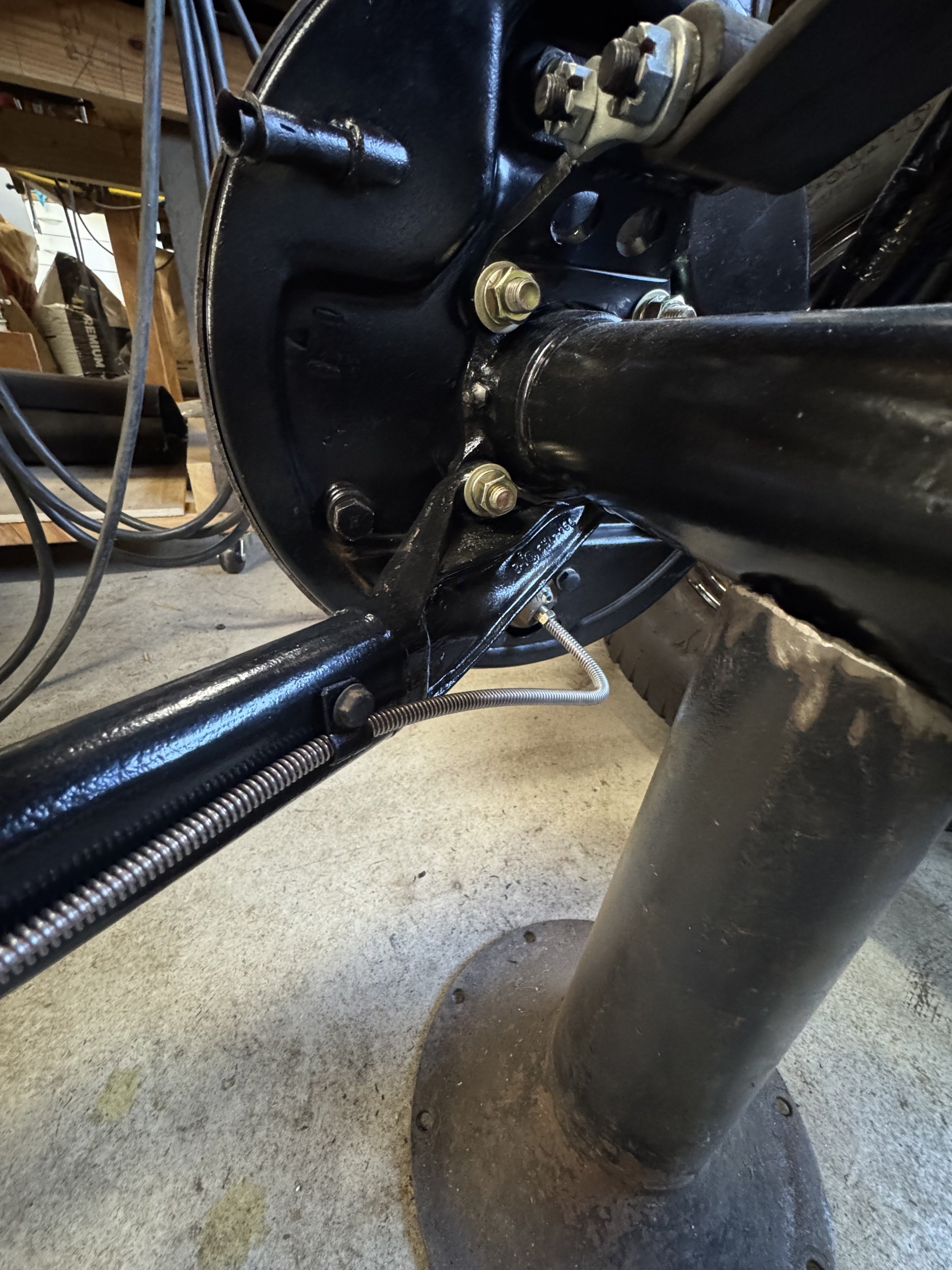

  17. Jeff34
    Joined: Jun 2, 2015
    Posts: 1,472
    Jeff34

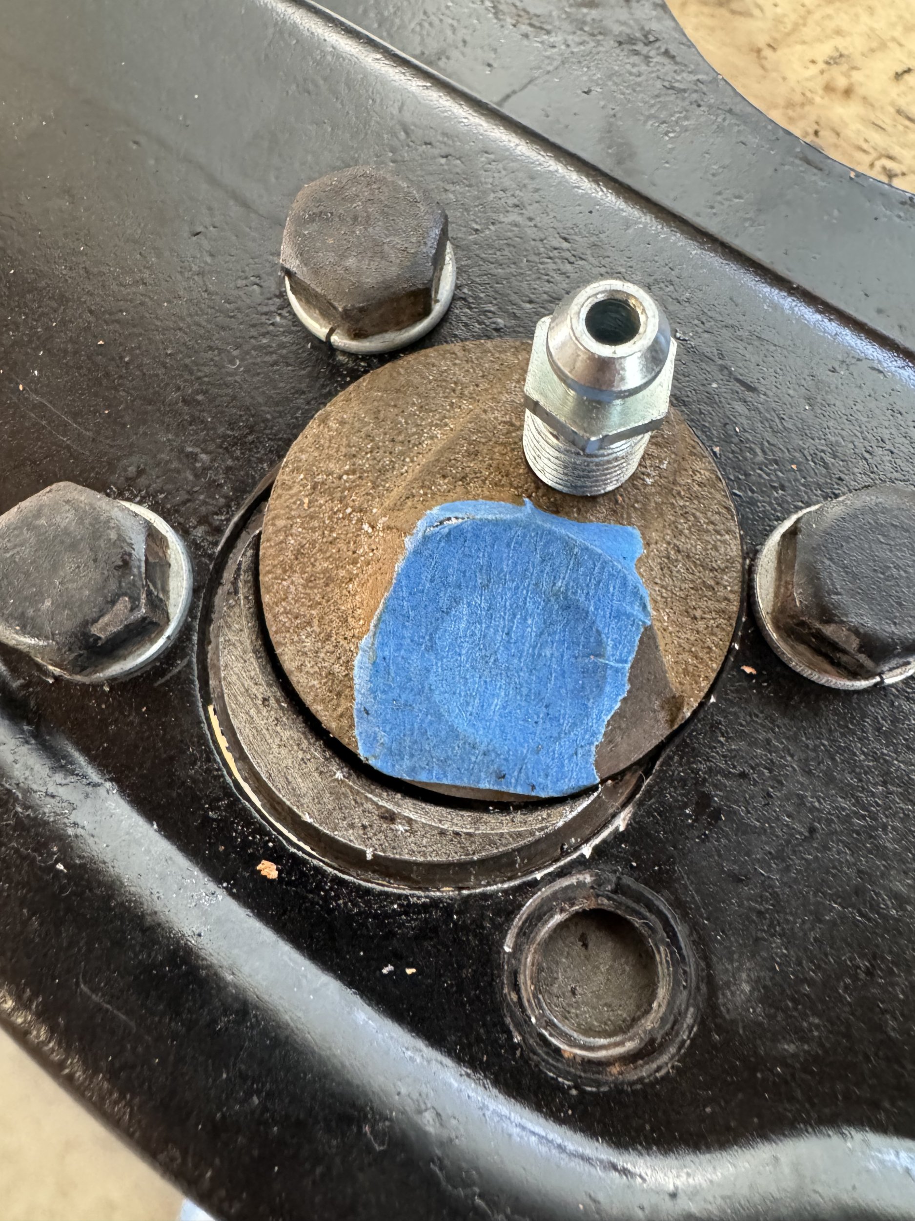

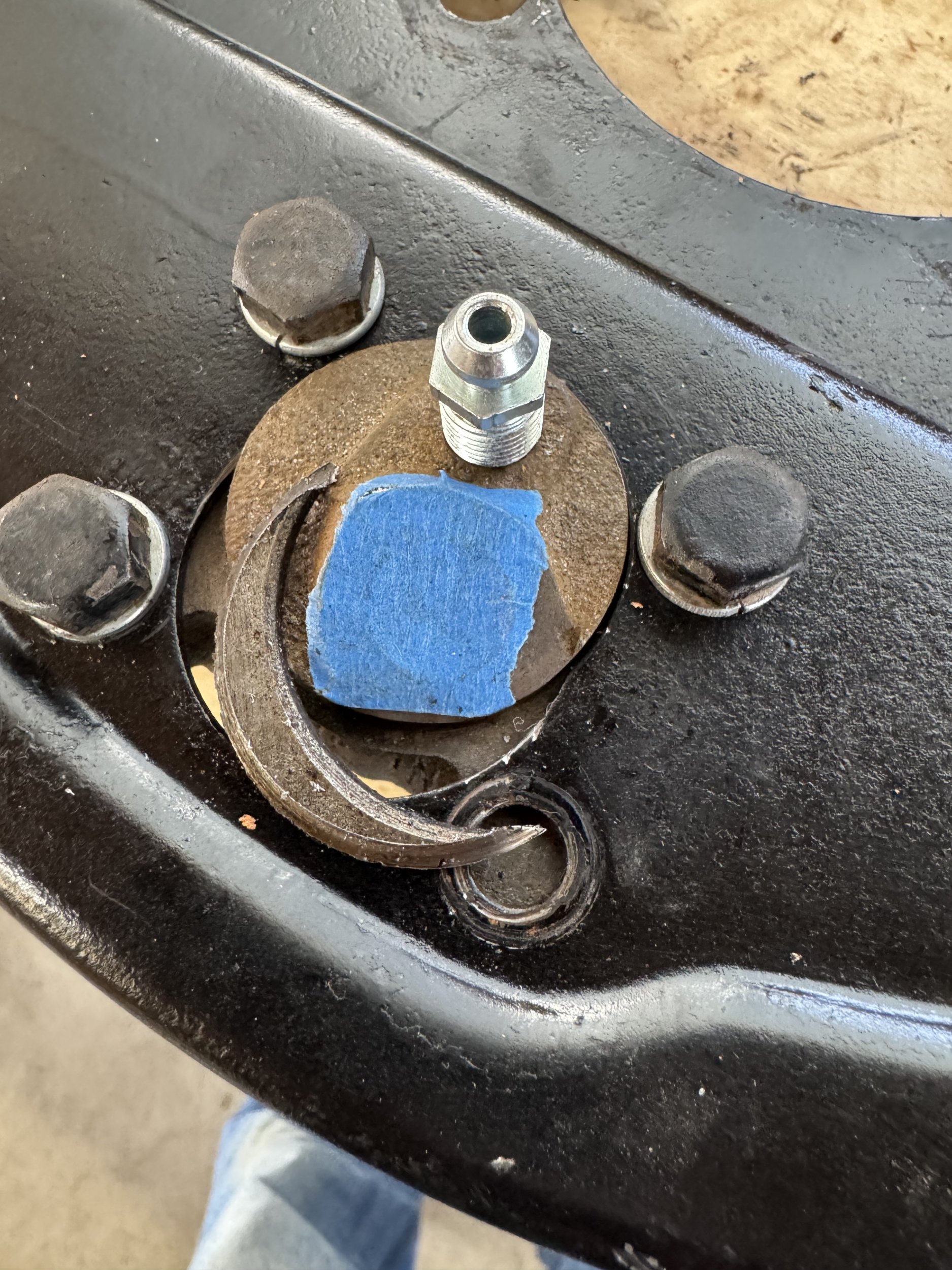

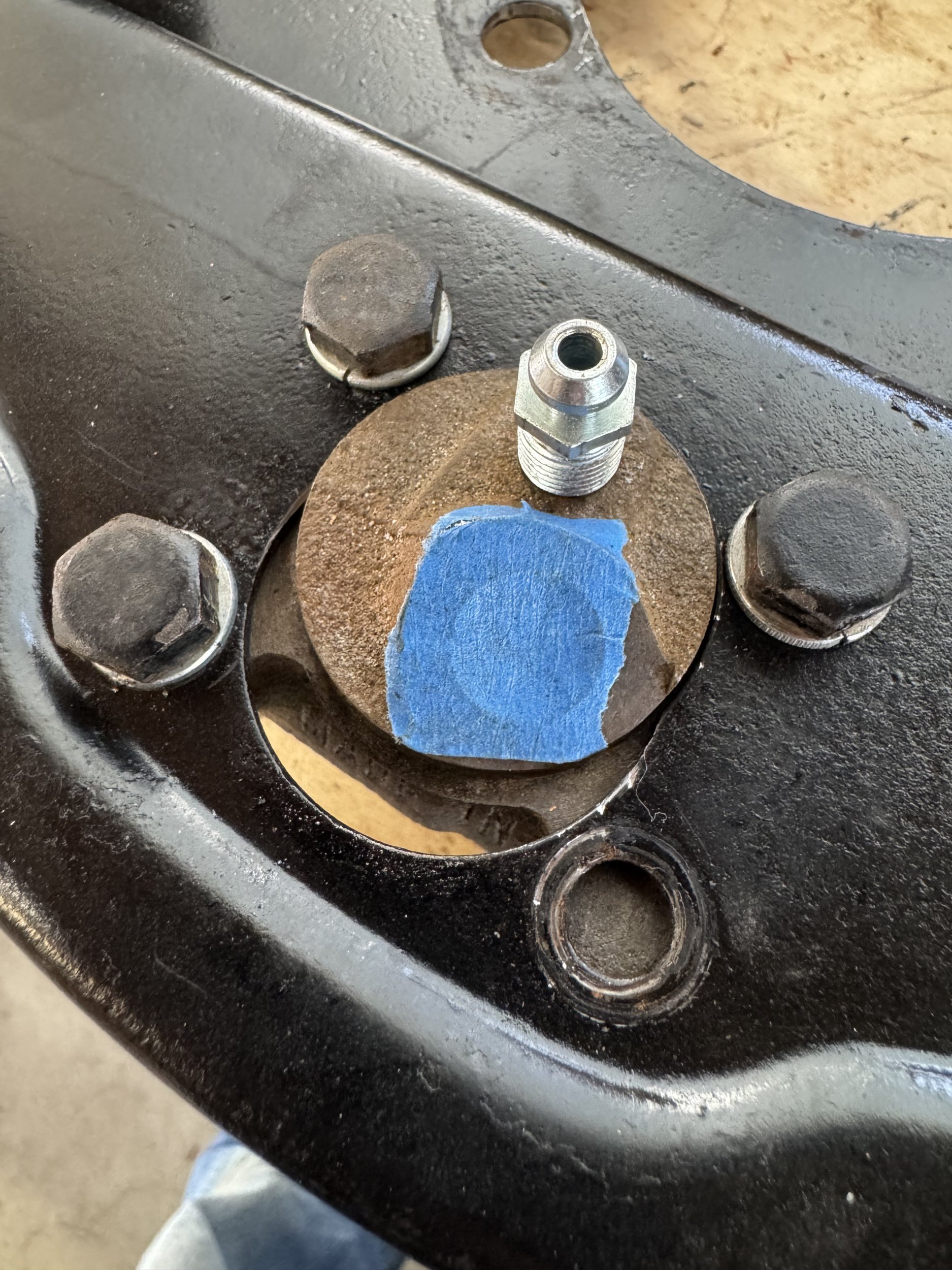

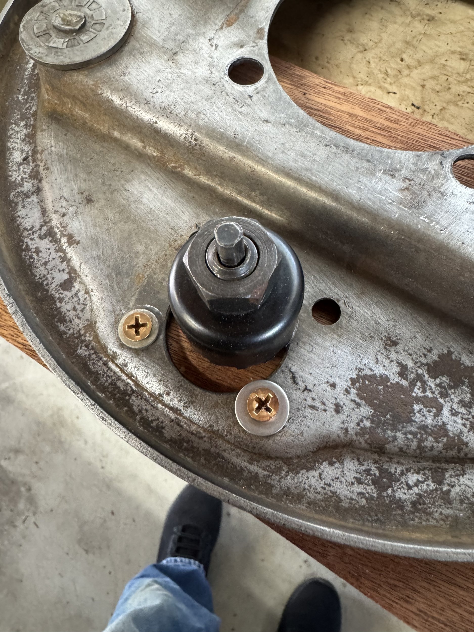

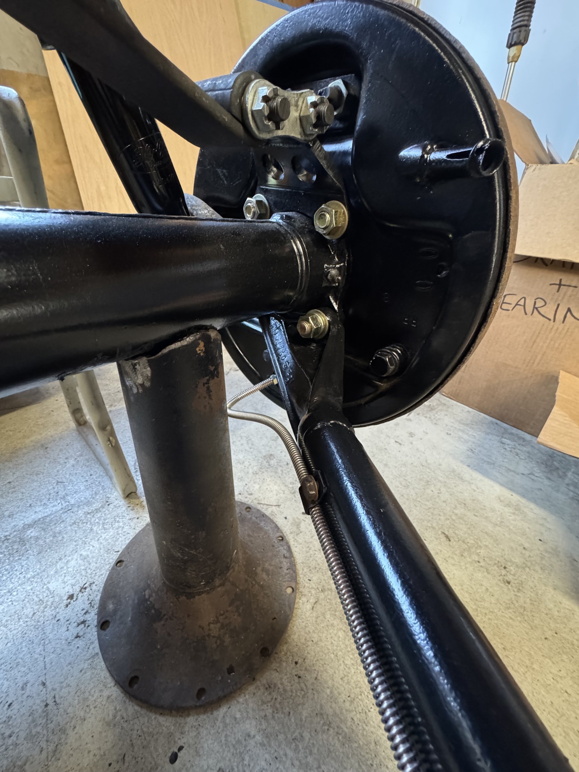

    IMG_4626.jpeg IMG_4627.jpeg IMG_4629.jpeg IMG_4630.jpeg IMG_4631.jpeg Flipped the backing plates ad mounted upside down for brake line clearance. Kept the crescent pieces Not sure if I’ll weld them into the gap or not. Built a nice little jig with a drill bushing I had to cut the crescent. Re***embled the backing plates and put them back on the rear end.

  19. Jeff34
    Joined: Jun 2, 2015
    Posts: 1,472
    Jeff34

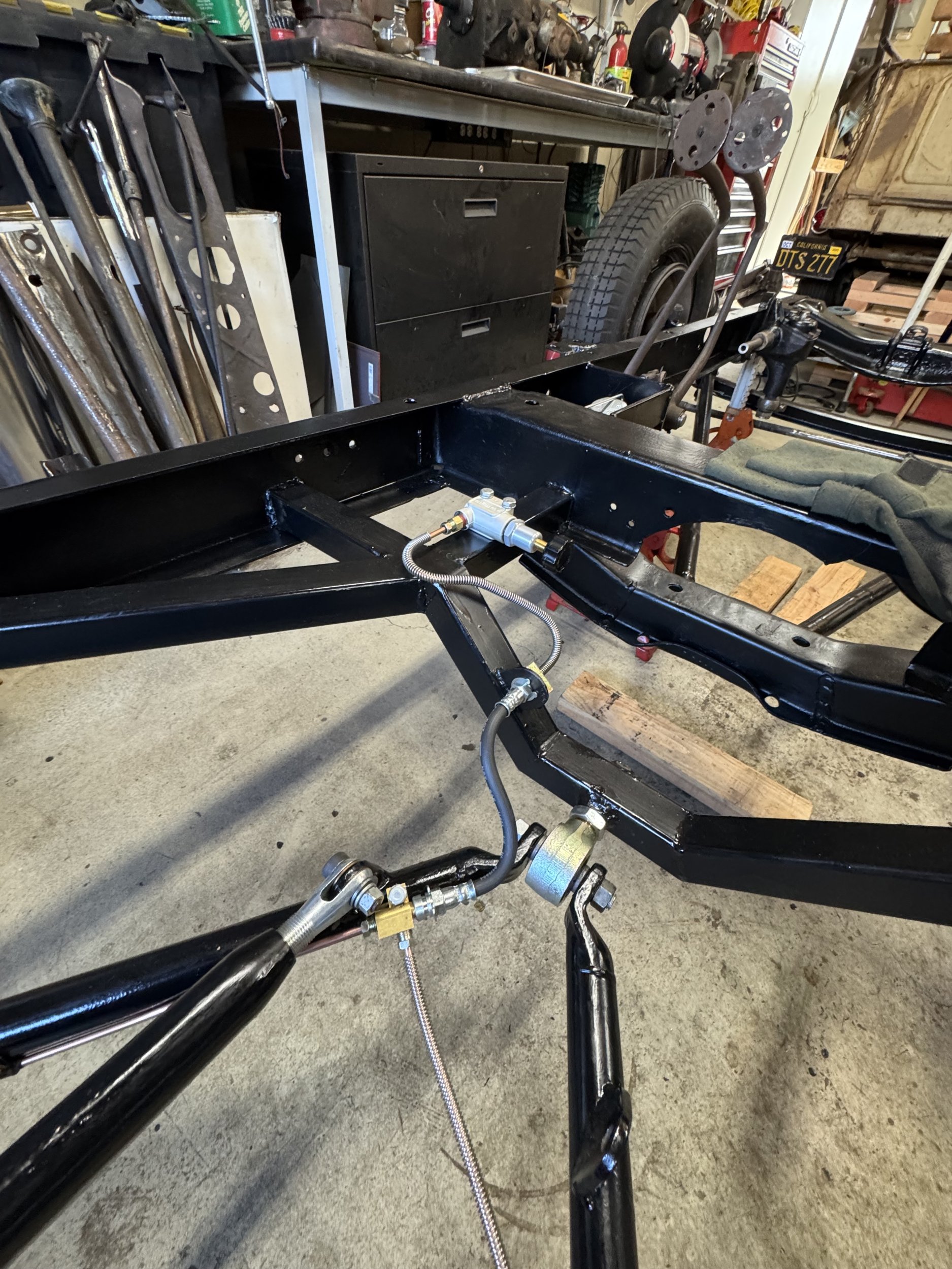

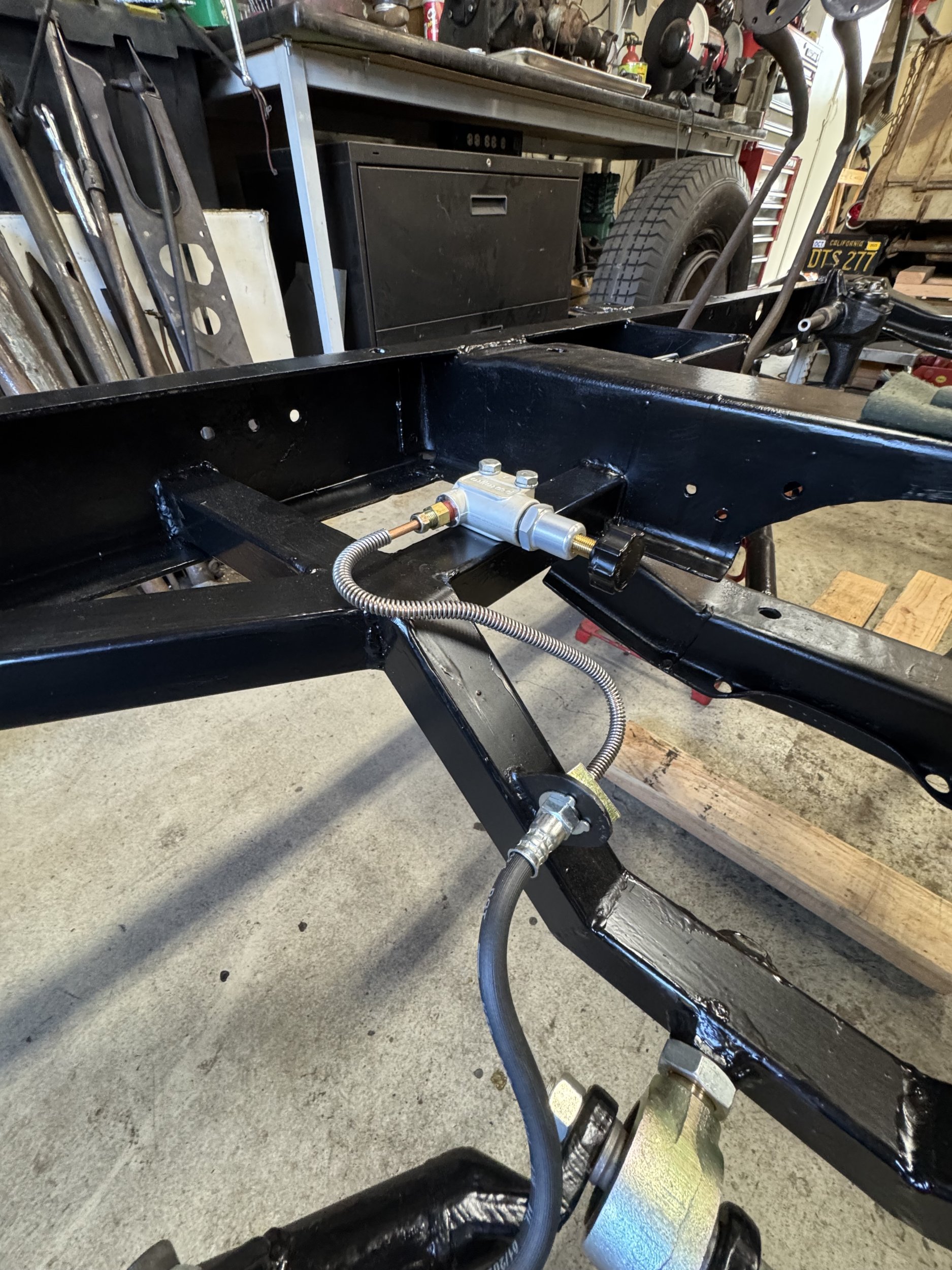

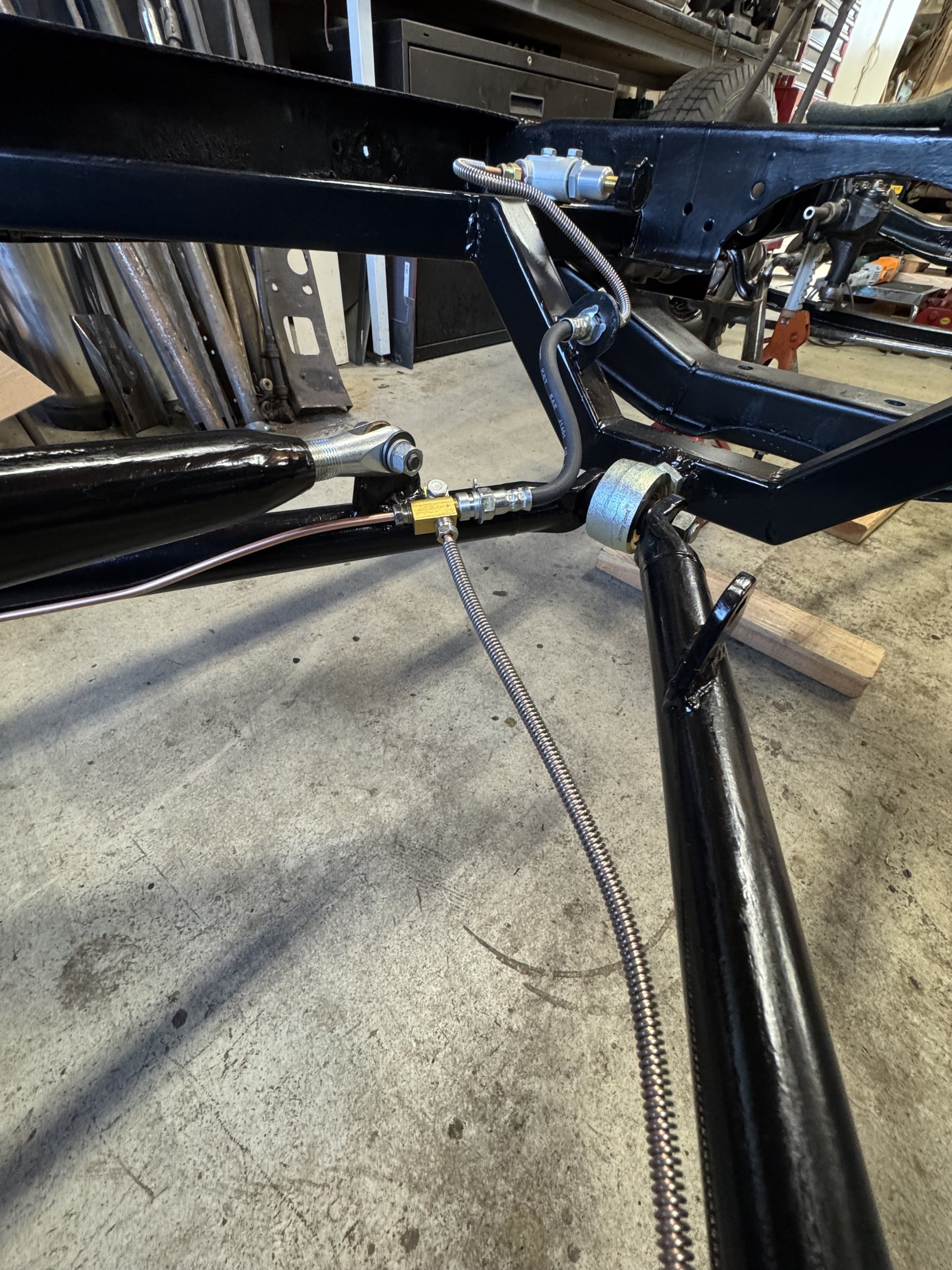

    Got the plumbing finished on the rear. Need to do my kingpins in the front before I install the backing plates. More to come. IMG_4690.jpeg IMG_4691.jpeg IMG_4692.jpeg IMG_4693.jpeg IMG_4694.jpeg

  22. Jeff34
    Joined: Jun 2, 2015
    Posts: 1,472
    Jeff34
    Because I flipped the backing plates, there’s only one screw hole at the outer edge of the wheel cylinder. I have the drum retention brackets, but with one hole I can’t mount them there.
    Should I just forget about them?
    I could mount them 45 degrees back from vertical on a flat spot on the backing plate if we think I really need them

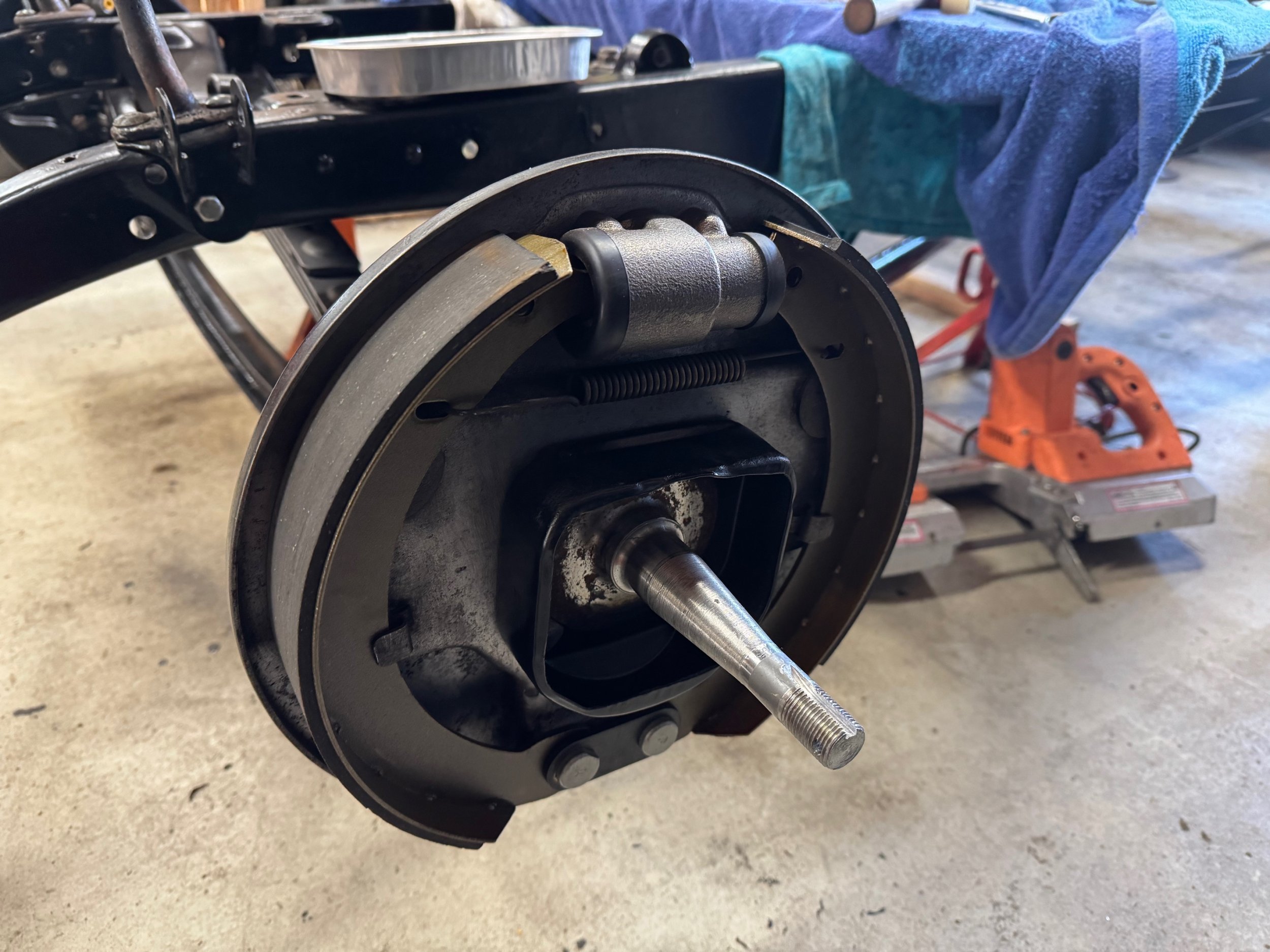

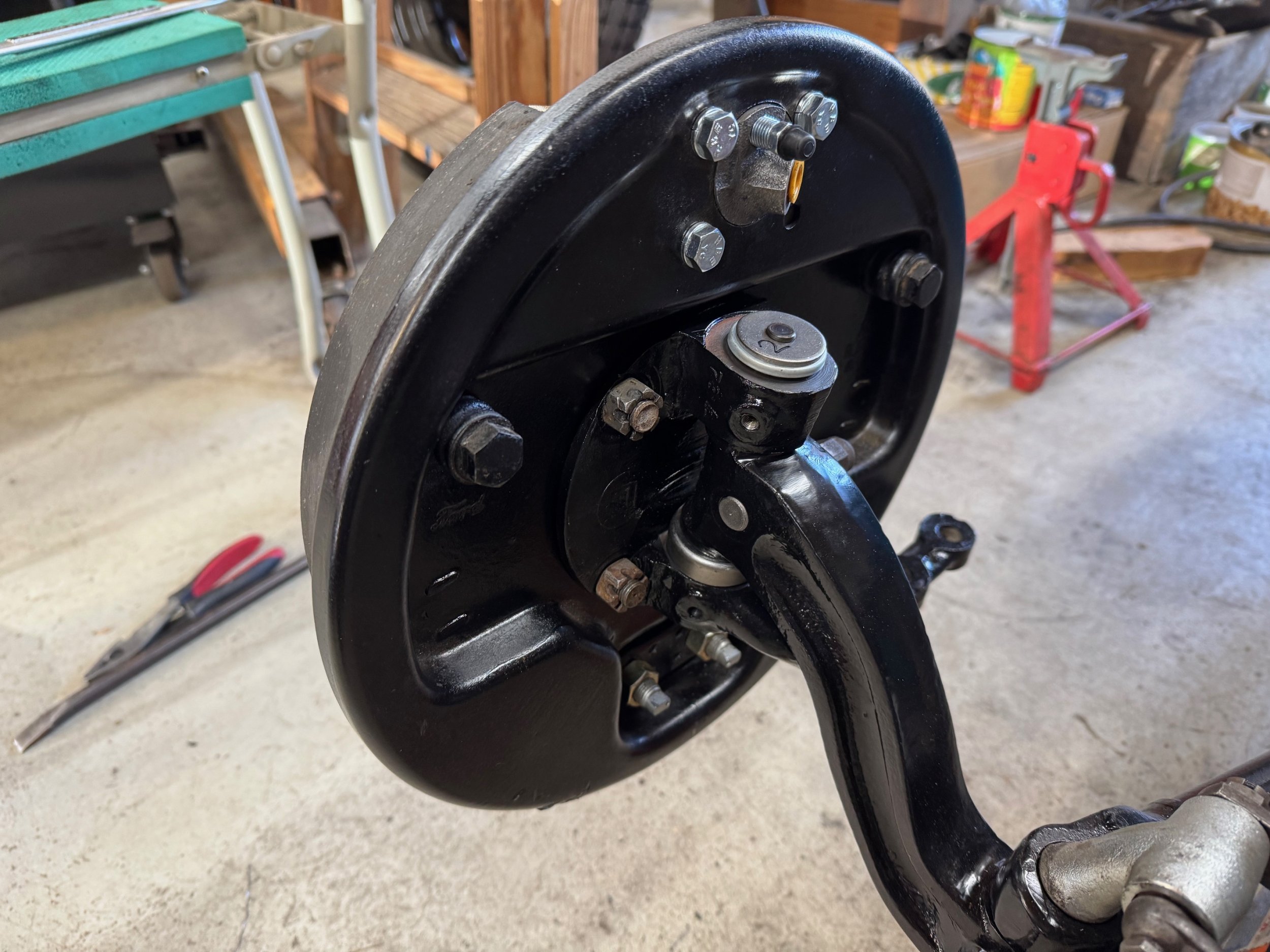

    IMG_4714.jpeg IMG_4715.jpeg Quick update on the roadster. I replaced the king pins. Thanks to Norm Jr. at Norm’s for replacing the bushings and honing them to size. Also got the backing plates and grease shields back on. I’ll have to upload the pictures later

    More pictures of the front spindles and backing plates...
