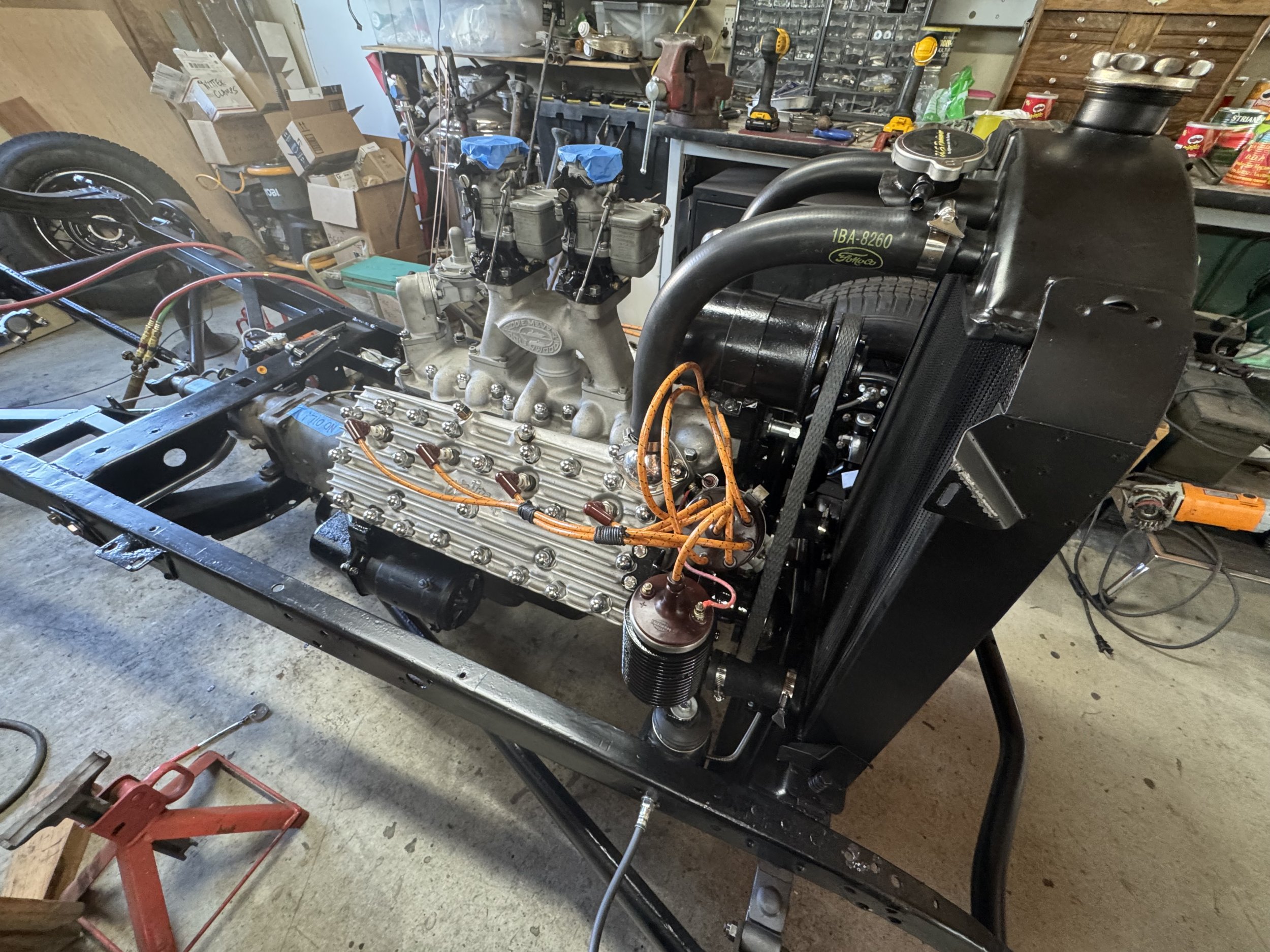

    It’s home! Apparently Mike hid the bell housing somewhere and we couldn't find it, but that's fine since I've got some travel scheduled next week and won't be able to spend much time on it. Can't wait to get it in the ch***is and keep going on this damn thing... FH.jpg

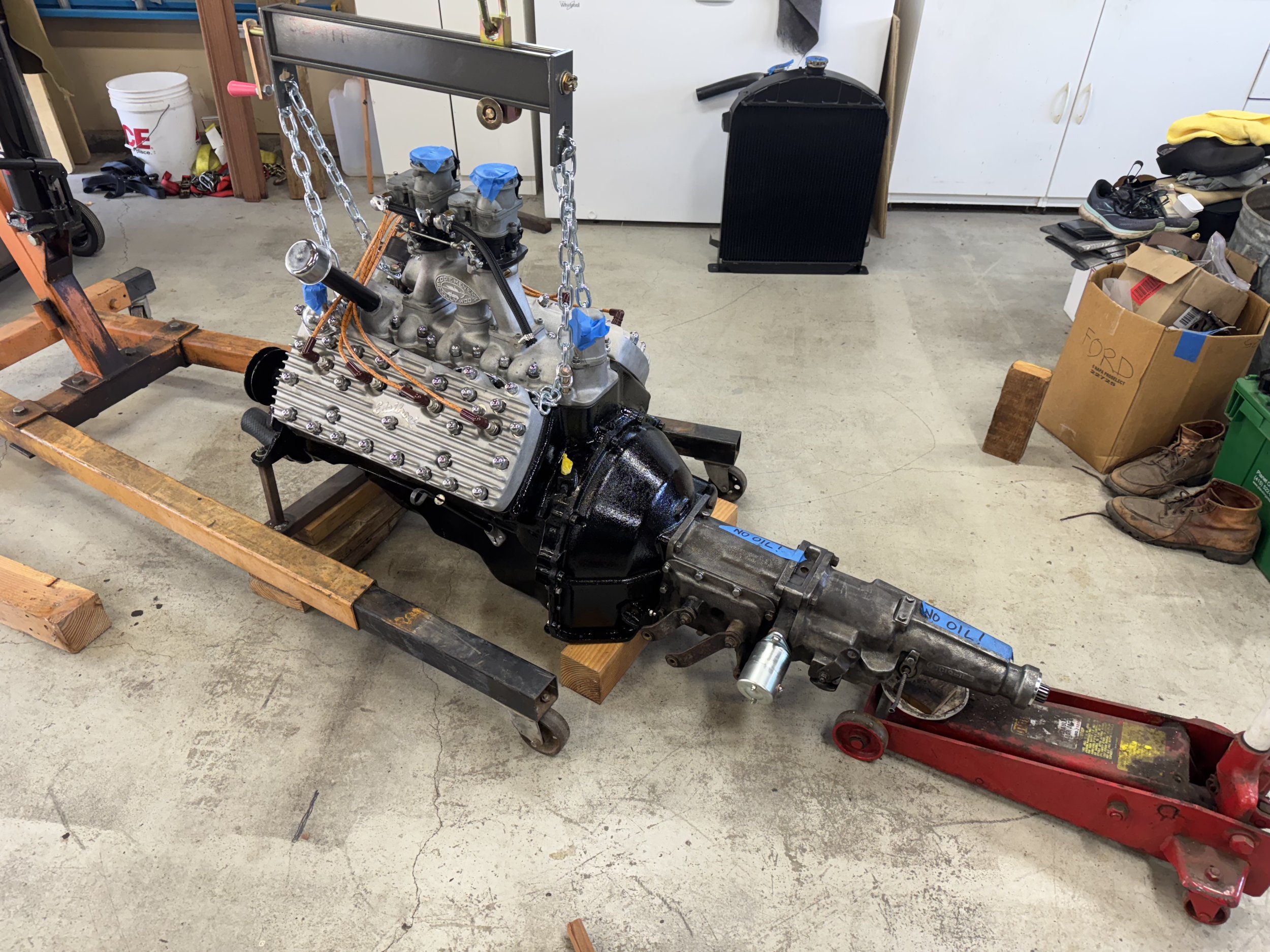

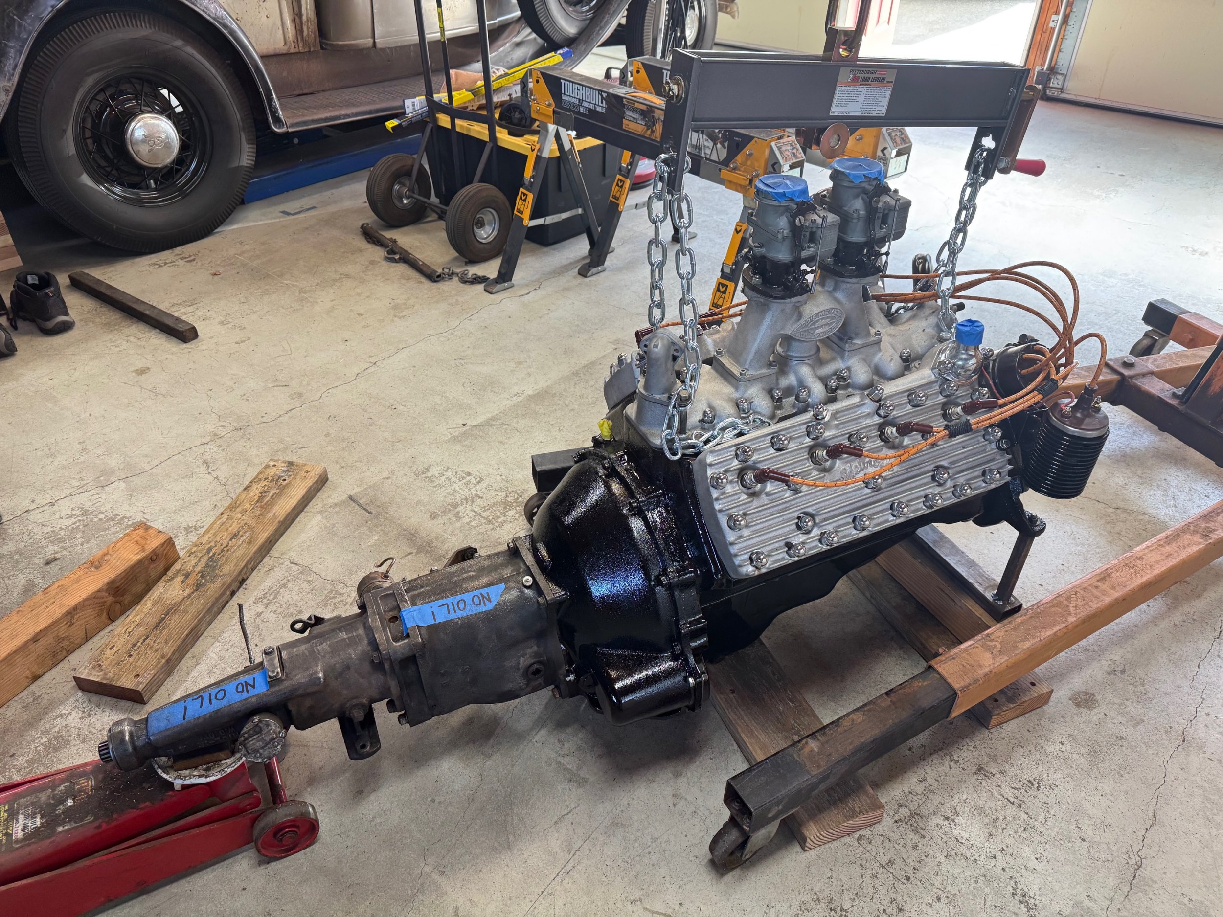

    IMG_4864.jpeg IMG_4866.jpeg IMG_4867.jpeg Got the incorrect pilot bushing removed (bread trick worked great) and the new bearing installed. Put the clutch and rebuilt pressure plate on. Then the bell housing with a new throw out bearing and carrier. And finally put the transmission back on. Just have to add the starter and I can put it back in the frame this weekend

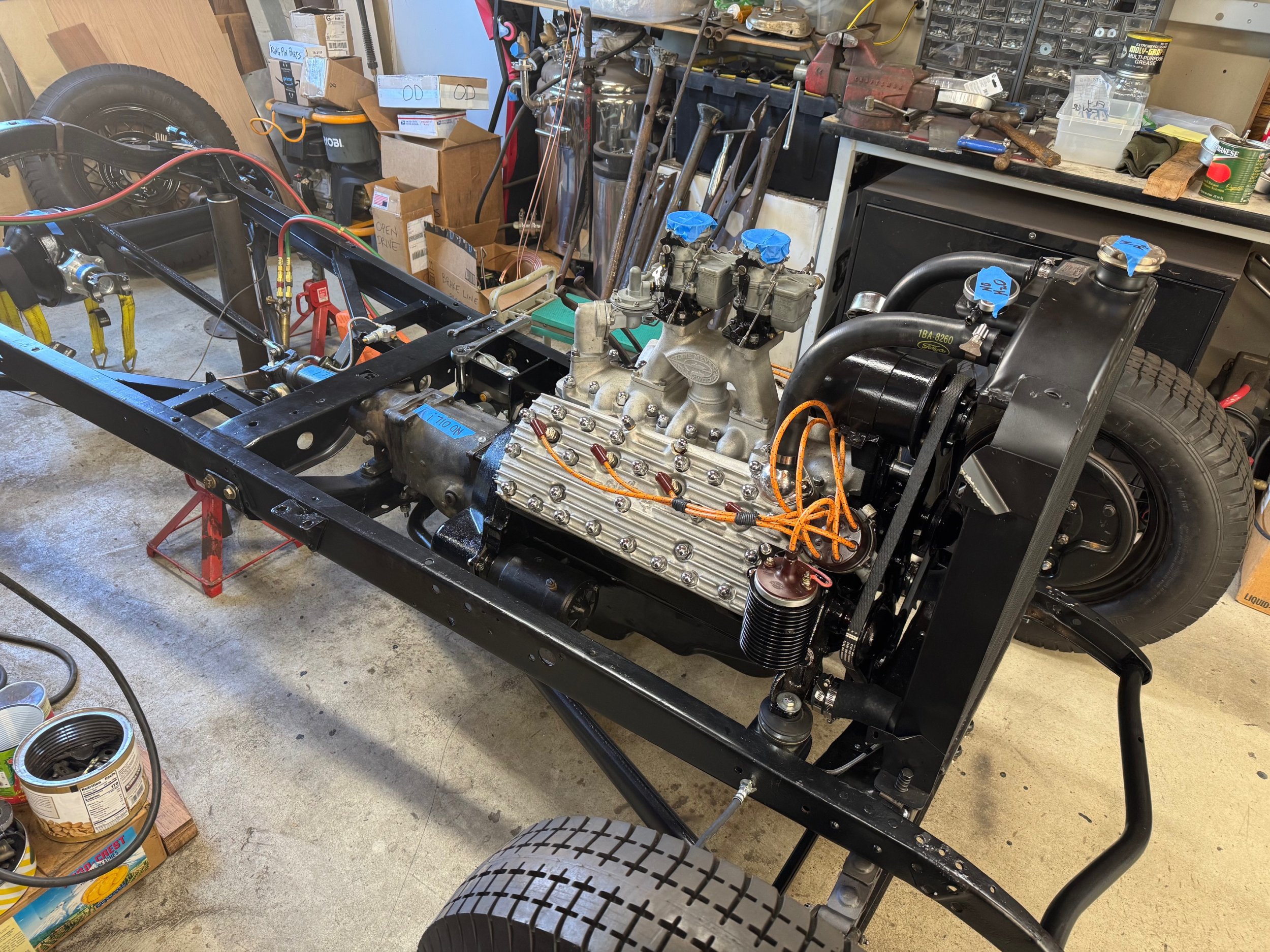

    IMG_4876.jpeg Got the engine back in the frame and some of the other stuff connected. Next is a drive shaft

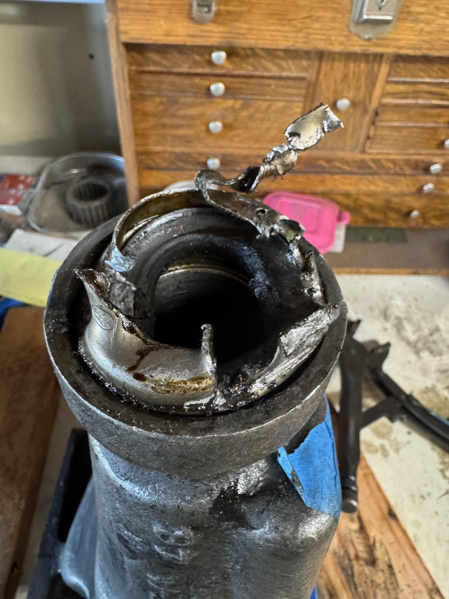

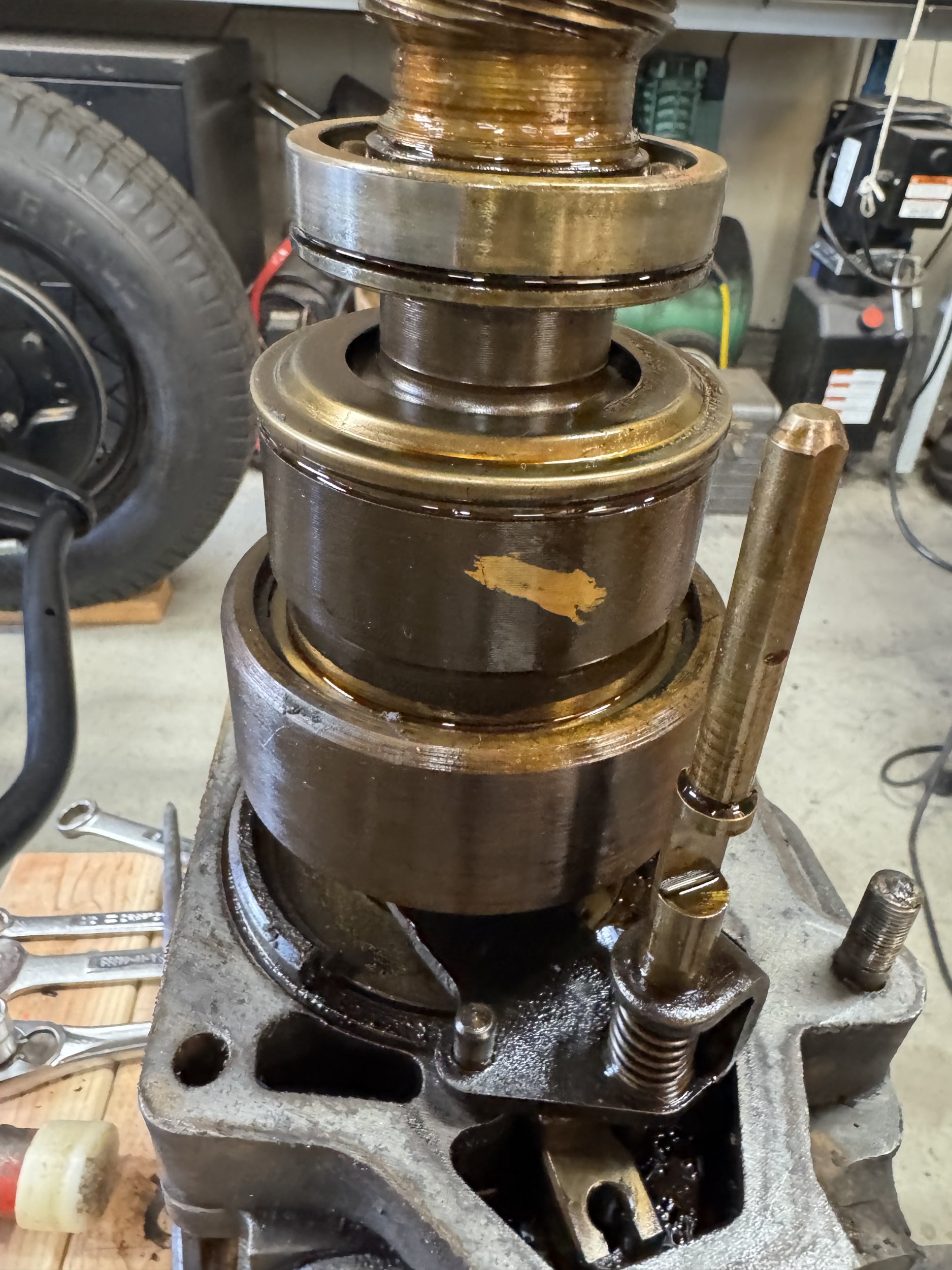

    Yesterday, I did something that I didn't plan to, and didn't really want to, do.
    I had planned to measure for the driveshaft last week, but when I went to put the yoke in the transmission, it got hung up in the tail housing. It went through the seal, but then got tight in the bushing. I knew it was snug, but not that tight. So, in reluctant denial, I pulled the engine and transmission back out of the car.
    The task? Remove the tail housing from the BW OD transmission and figure out what's wrong. I've never worked on one of these before, so I read everything that I could to see where this could go south. I also worked very slow and took pictures so I had the best chance of getting it back together.
    I thought there were 2-3 possibilities. One: the output shaft spline is twisted, preventing the yoke from sliding on any more. Two: The spline is damaged. 3) The bushing is undersize.
    I removed the reverse lockout lever pin and pulled the lockout lever, and unbolted the tail housing. When I removed the tail housing, several cylindrical bearings fell to the floor. I quickly located all of them and put them in a safe place. Next, I removed the tailshaft from the housing and inspected that. The yoke slipped on the output spline very smoothly. No binding or catching. Great! Next, I put the yoke through the seal and into the bushing. Stuck. Went in about 1/4 - 1/2" and got tight.
    I decided to hone the bushing slowly until the yoke just fit. Once that was done, I thought I would put it back together, but I don't have the gasket. Dang.
    Turns out that's O.K. I need a 12VDC solenoid for the OD anyway, so I'll call VanPelts tomorrow and order the gasket, and 12V goodies I need for the conversion. Hopefully it goes back together as easily as it came apart...

    Those roller bearings are for the sun gear
    I did one when I was 13 yo, old guy told me to pack them in grease and rap a rubber band around them
    Reinstall the housing and letter rip. The oil will dissolve the rubber bands
    It worked for me
    Wow I just realized I’m the old guy now

    I saw a pic using the rubber band. I just put a little grease on them and slid the tail shaft on before they fell out...worked fine.

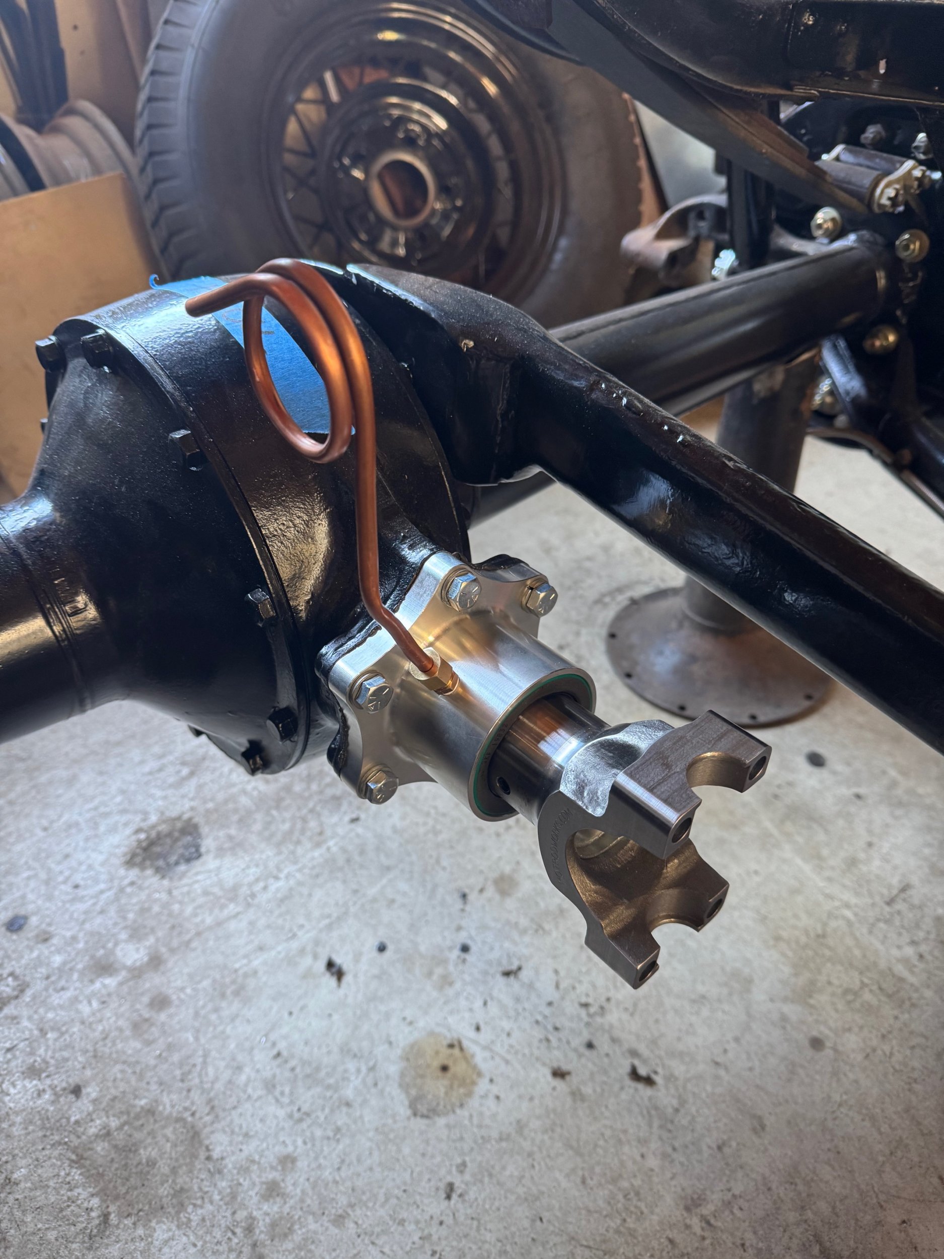

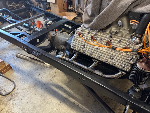

    IMG_4943.jpeg IMG_4944.jpeg IMG_4945.jpeg IMG_4934.jpeg I got more done this weekend. Trans was put back together. The snap ring was a bit of a challenge but I got it figured out. New solenoid installed. Engine and transmission back in the car and bolted down. Measured for the driveshaft. Installed a vent on the open drive conversion rather than the banjo. I was worried about metal chips in the rear end. This seemed like a good solution. Also installed the headers and mocked up the exhaust location. Moving forward.

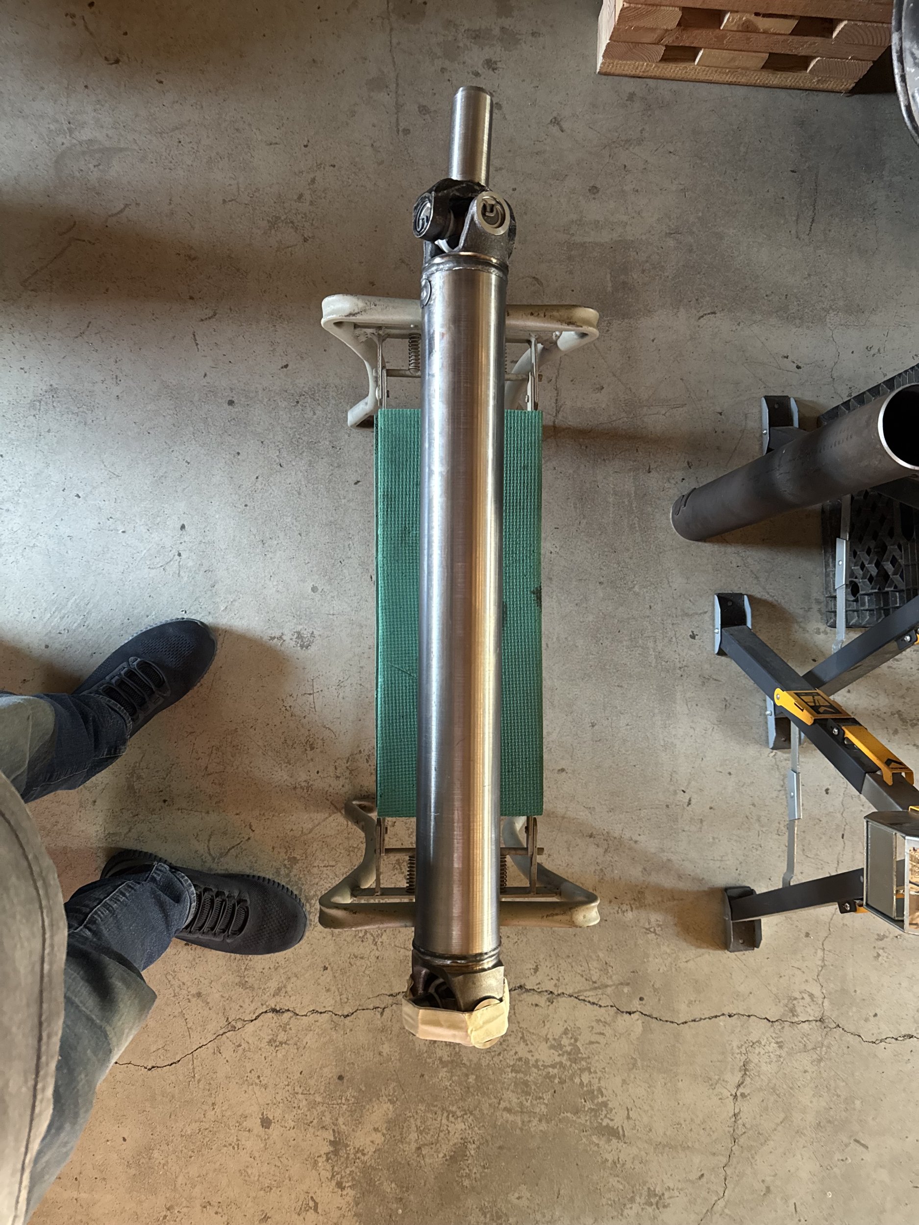

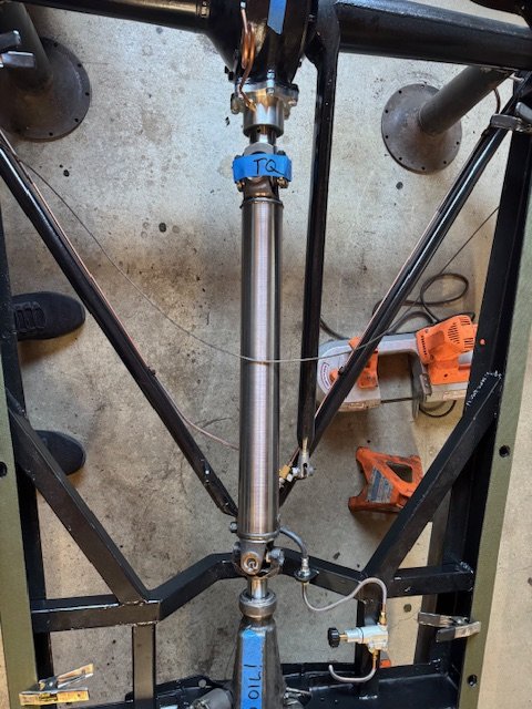

    IMG_4979.jpeg I had Greg at Santa Rosa Drive Line Service build me a driveshaft. He did an awesome job. It’s 3” diameter tube. Should be strong enough for a flathead

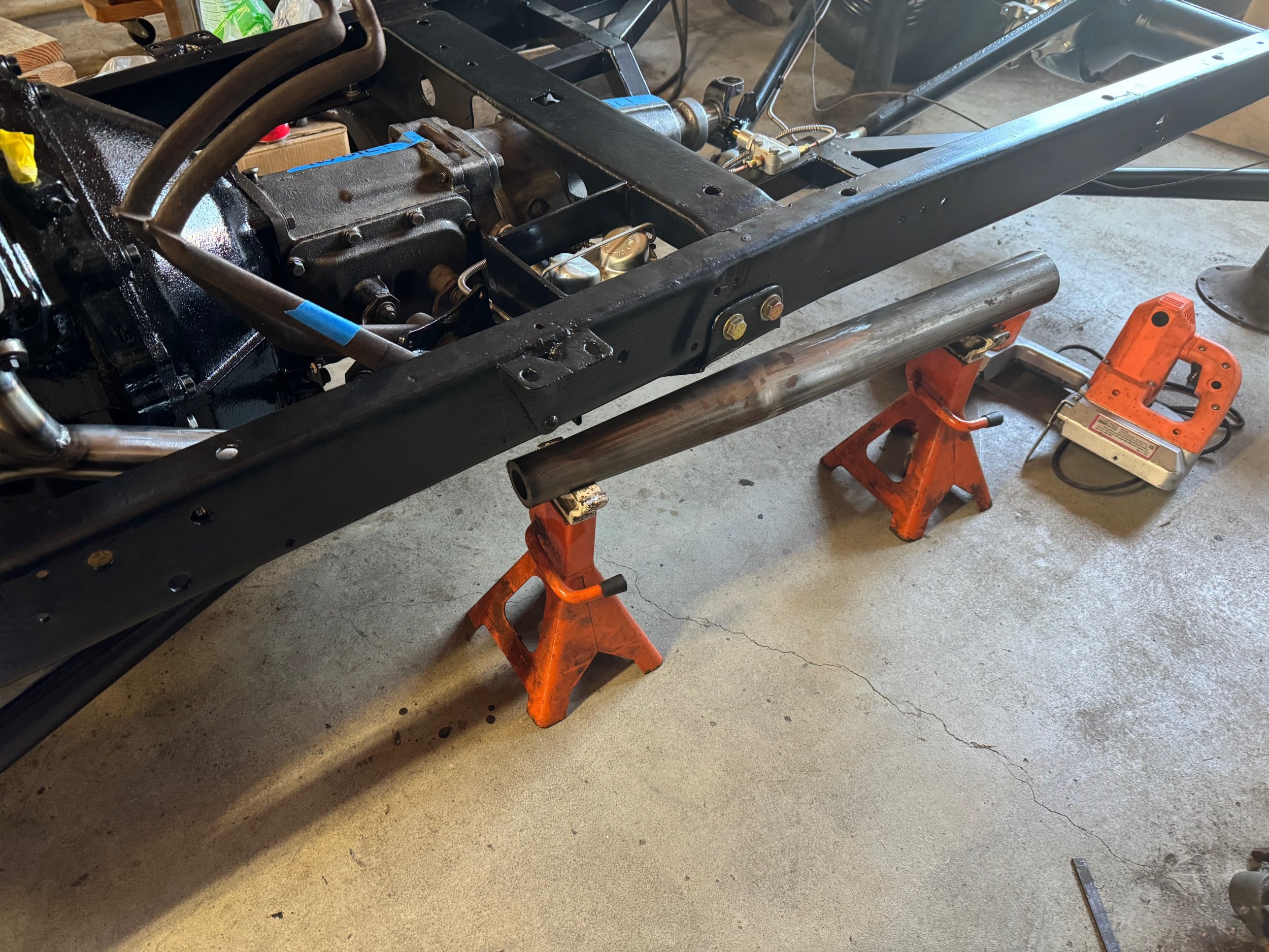

    Installed. Perfect fit. Now to make a hoop. I’m going to add a second torque arm on the other side to attach the hoop to. I will also use that as a place to route the E brake cable. IMG_4980.jpeg

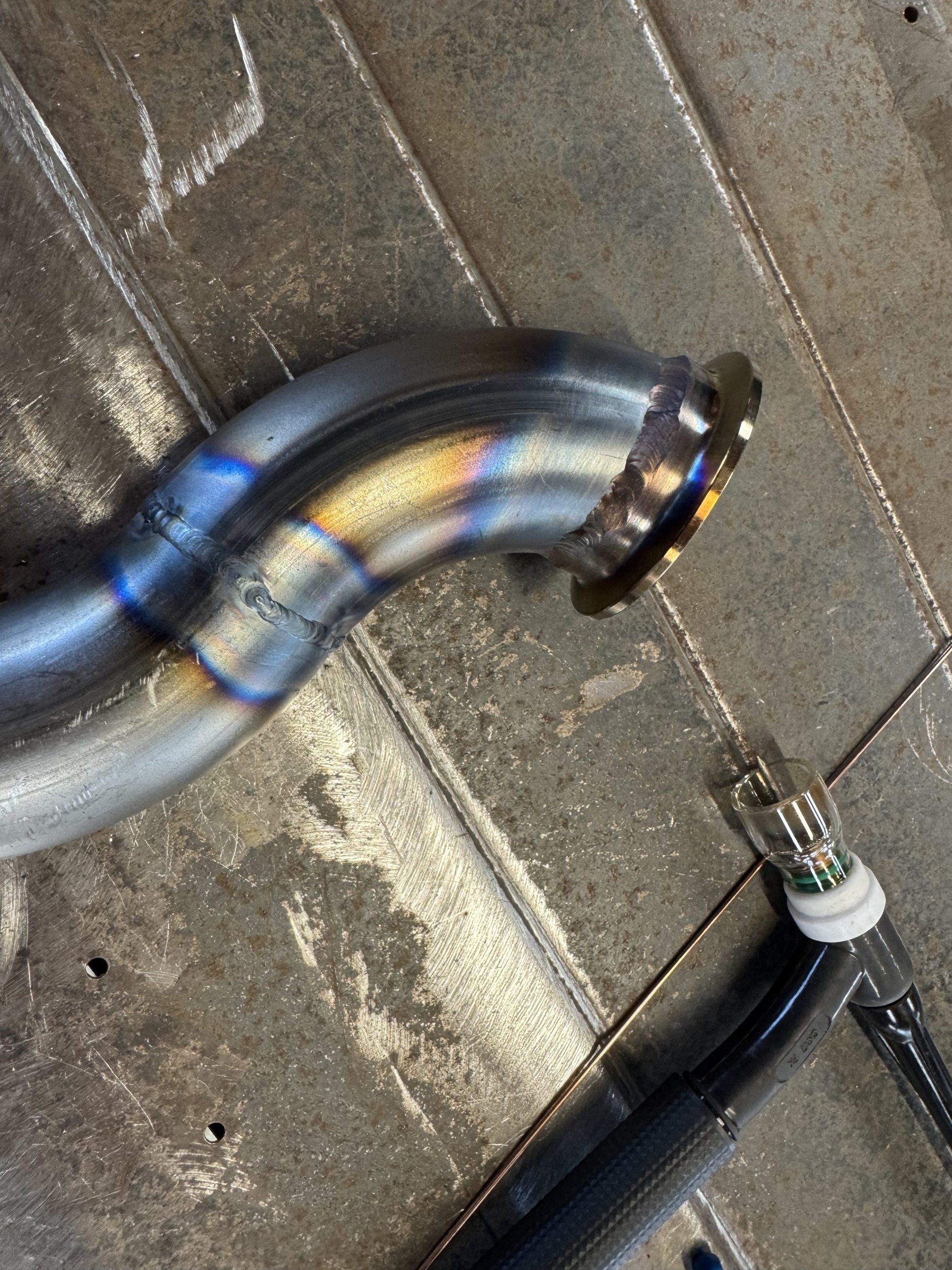

    I got most of the exhaust welded up and fitted this week. Still need to add one more bend to get them to the pipes, but it’s close. Plan to fire it up in the ch***is next weekend! IMG_5027.jpeg IMG_5028.jpeg IMG_5031.jpeg
