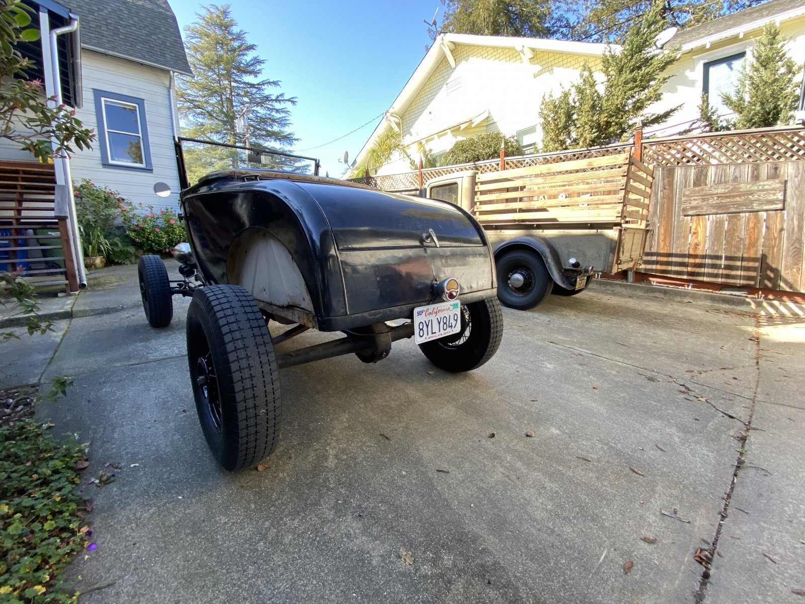

    Tail.jpg Also got the tail light mount cut down to size and mounted to the back with the plate.

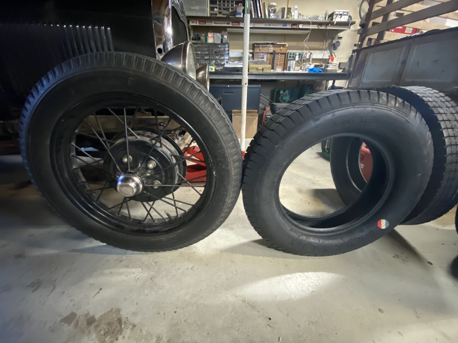

    I got my 16” wires back from powder coating last week and found these on my porch yesterday. 16x6 F and 16x6.5 R. I’ll get them mounted and installed and get you more pics. Excited to see these Blockley’s on the roadster. AB3413CB-DCCC-4F3B-8D07-69A708AC617F.jpeg 55905F65-6BA8-4338-A17B-E728C02FB798.jpeg 640B0A41-A334-49B3-A024-FC729FFFCFE2.jpeg

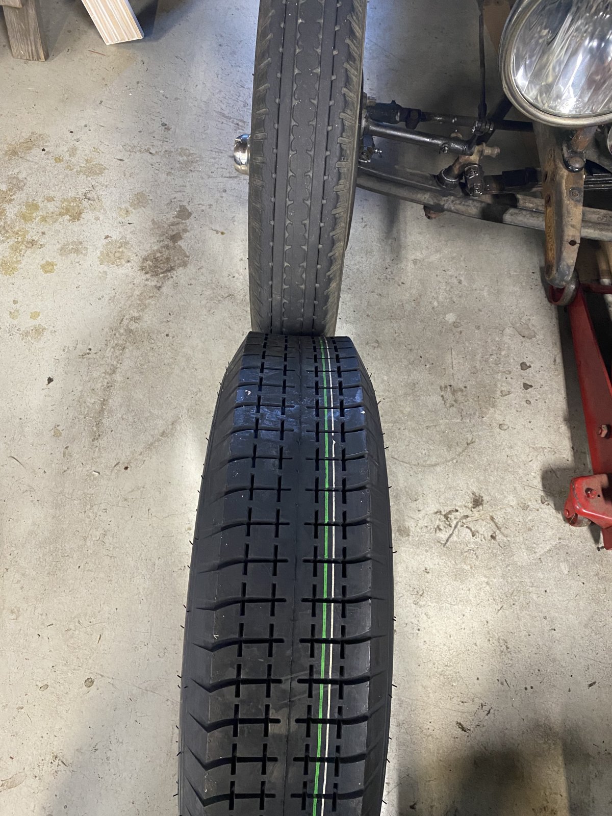

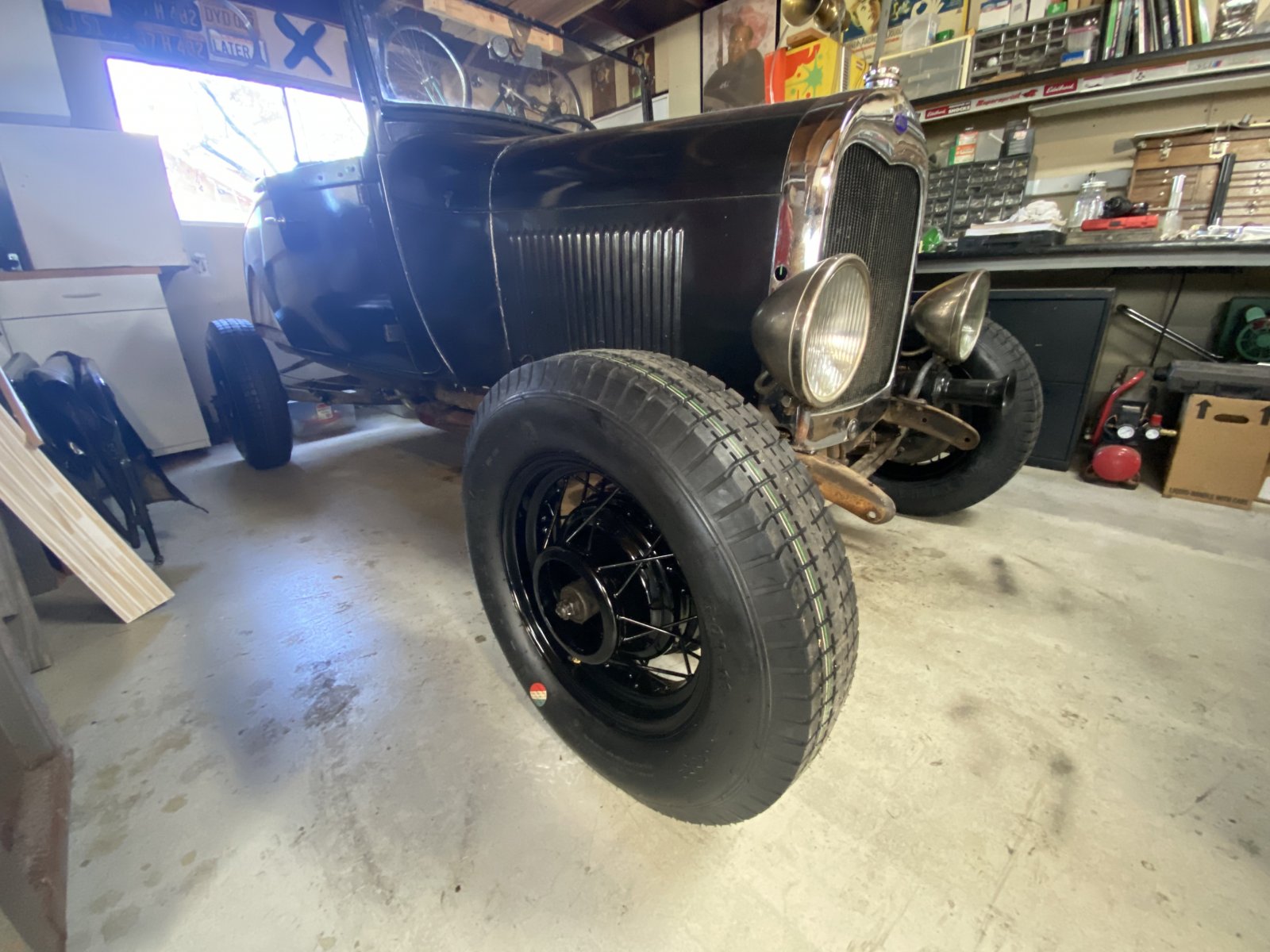

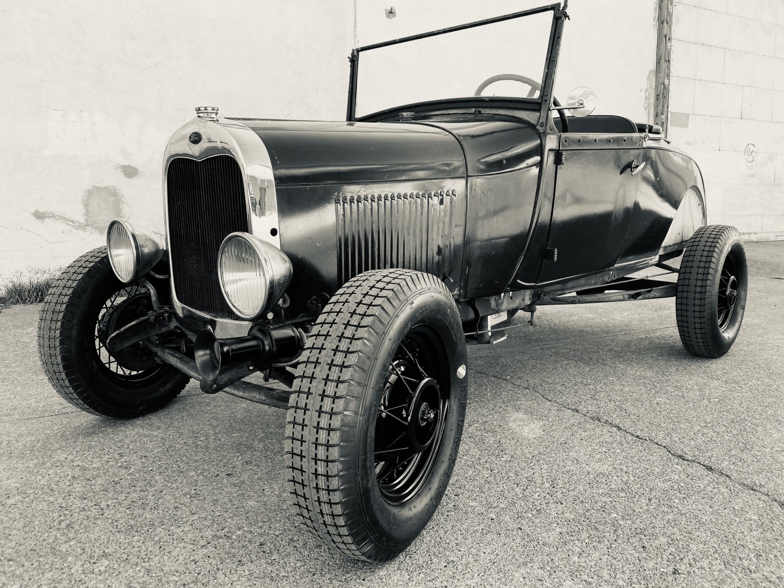

    851D183C-38F6-436E-88FC-85528930E532.jpeg Got my tyres mounted and installed. Me like!
  24. Nobey
    Joined: May 28, 2011
    Posts: 1,517
    Nobey
    Man, that's a good looking tire. Time for a test drive.....

  25. Jeff34
    Joined: Jun 2, 2015
    Posts: 1,474
    Jeff34

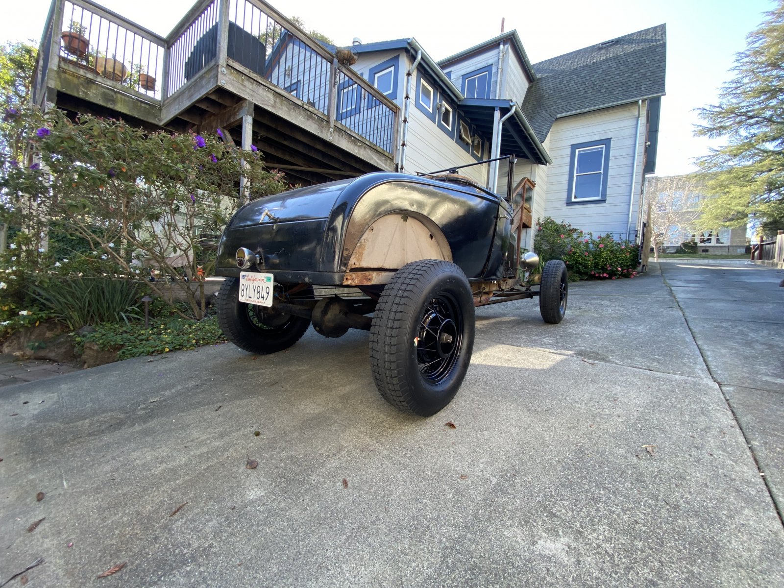

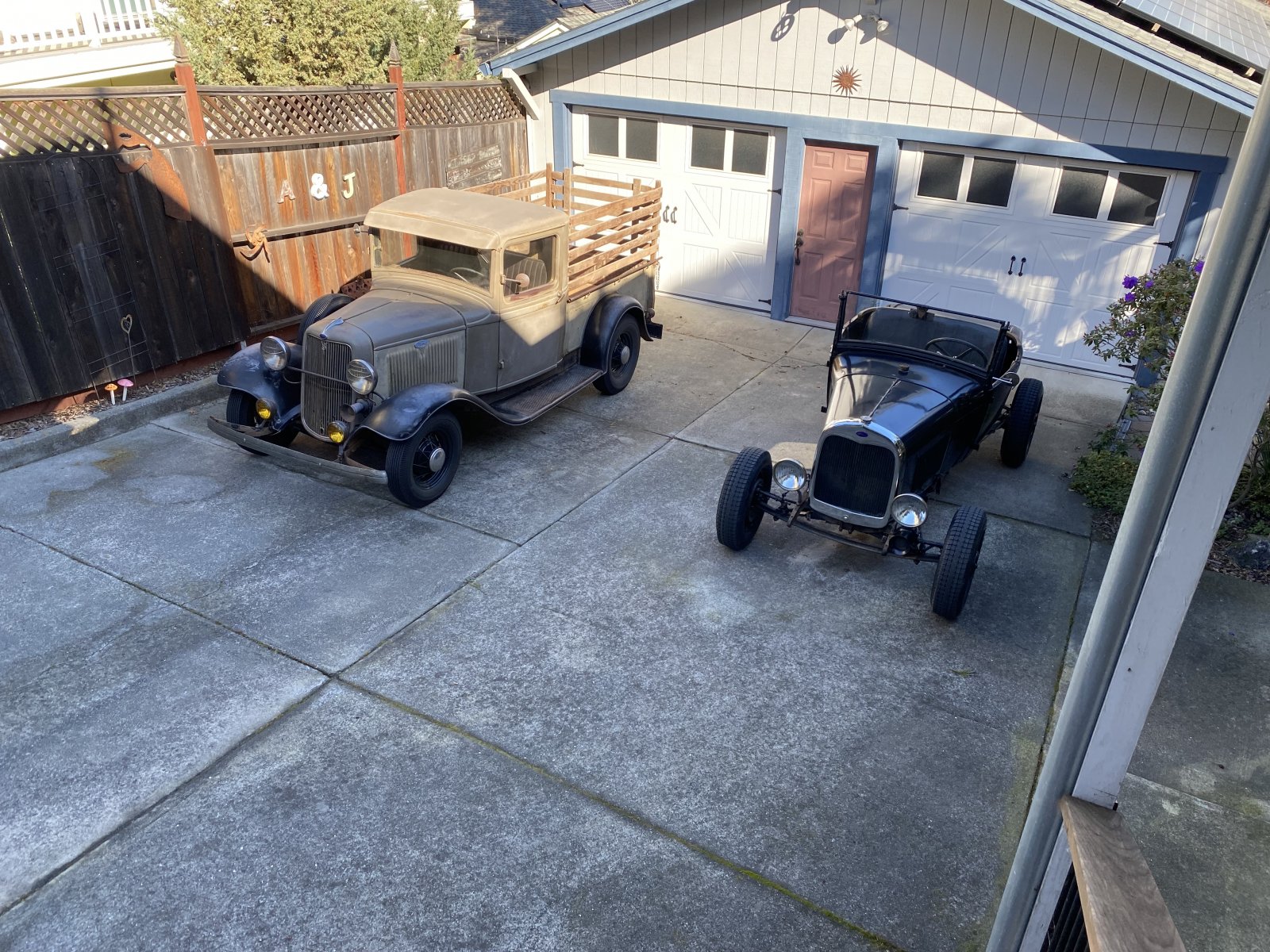

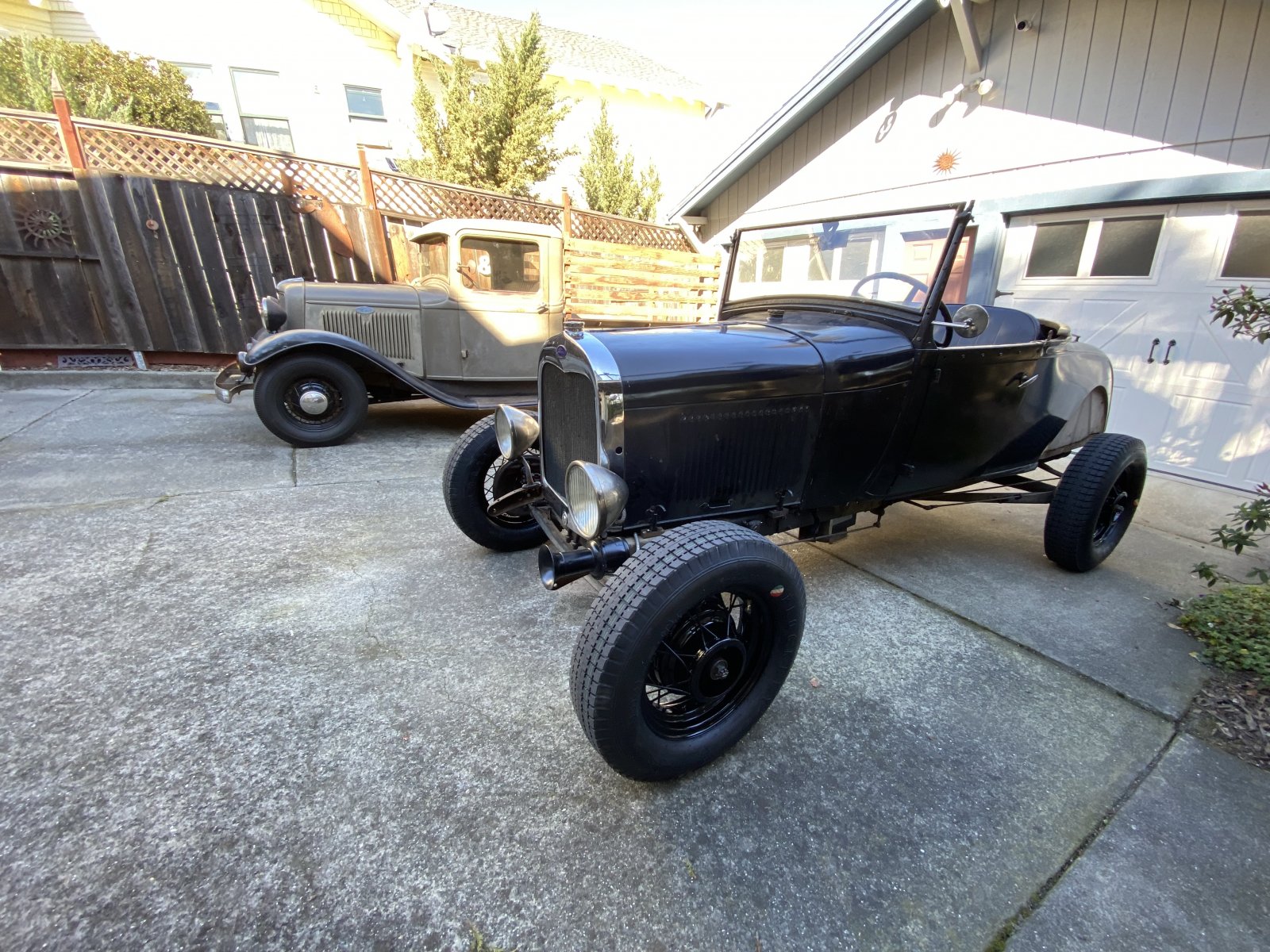

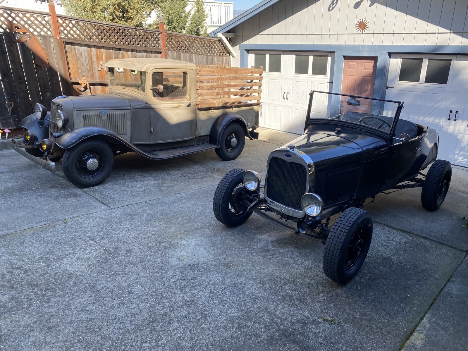

    done! Drives and tracks much better than before. I have caster now and it feels good. Still going to straighten the axle. Took some pics of the stable mates earlier today. 029284D5-4454-41C8-B9B9-B5146A738CF7.jpeg 34E11BD5-2341-4ED3-9B00-62922C709E63.jpeg 20590E89-C5EF-411C-B4D2-673227AFA926.jpeg 403FD80E-37B6-4D5F-9627-D1C82B0B3CDB.jpeg F4B92F89-4D7E-4D4B-AEF7-2EF76813AB83.jpeg 74AA0B4C-E4E8-4D68-BC14-4749A752F1FC.jpeg A215047A-70C7-411E-B09B-2761CFB7C4A1.jpeg

  26. Sweet little Jitney now.

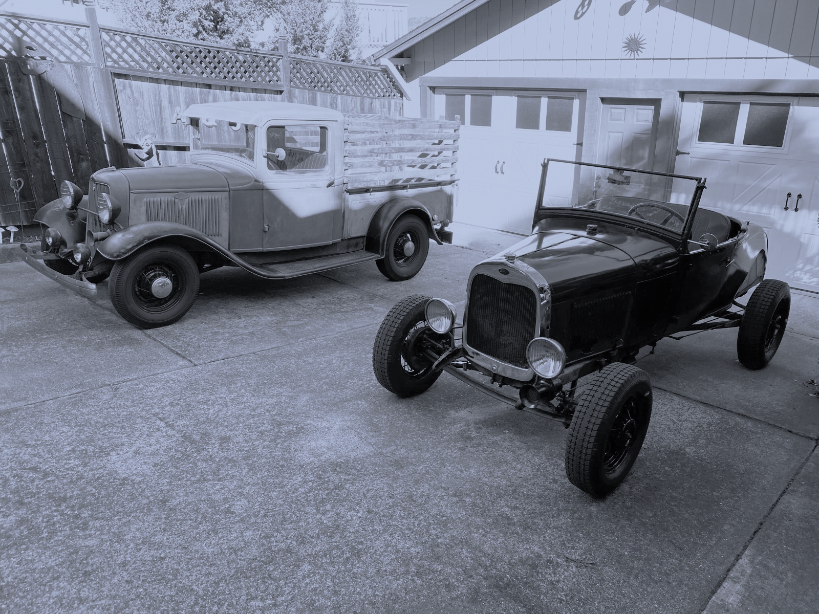

  27. Nobey
    Posts: 1,517
    Nobey
    If you put a couple of those shots in black and white, it would look like 1940 Wow..... We must be related Jeff,
    in my barn is a 34 pickup and a Model A roadster. Only difference is your A is running. Ha!
    Jeff34 and Stogy like this.

  29. Jeff34
    Joined: Jun 2, 2015
    Posts: 1,474

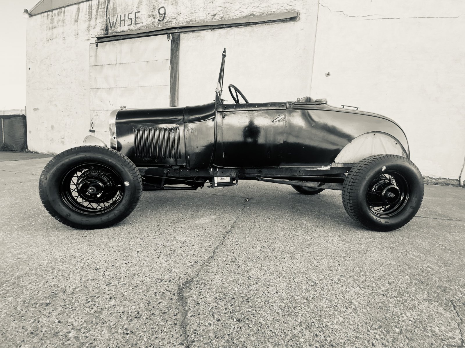

    Jeff34

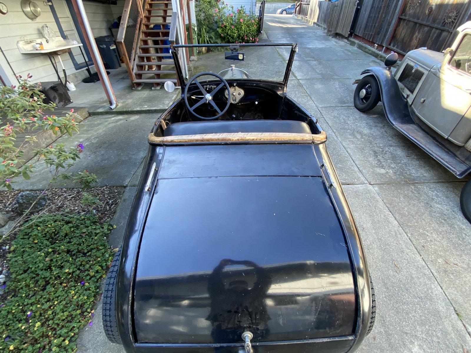

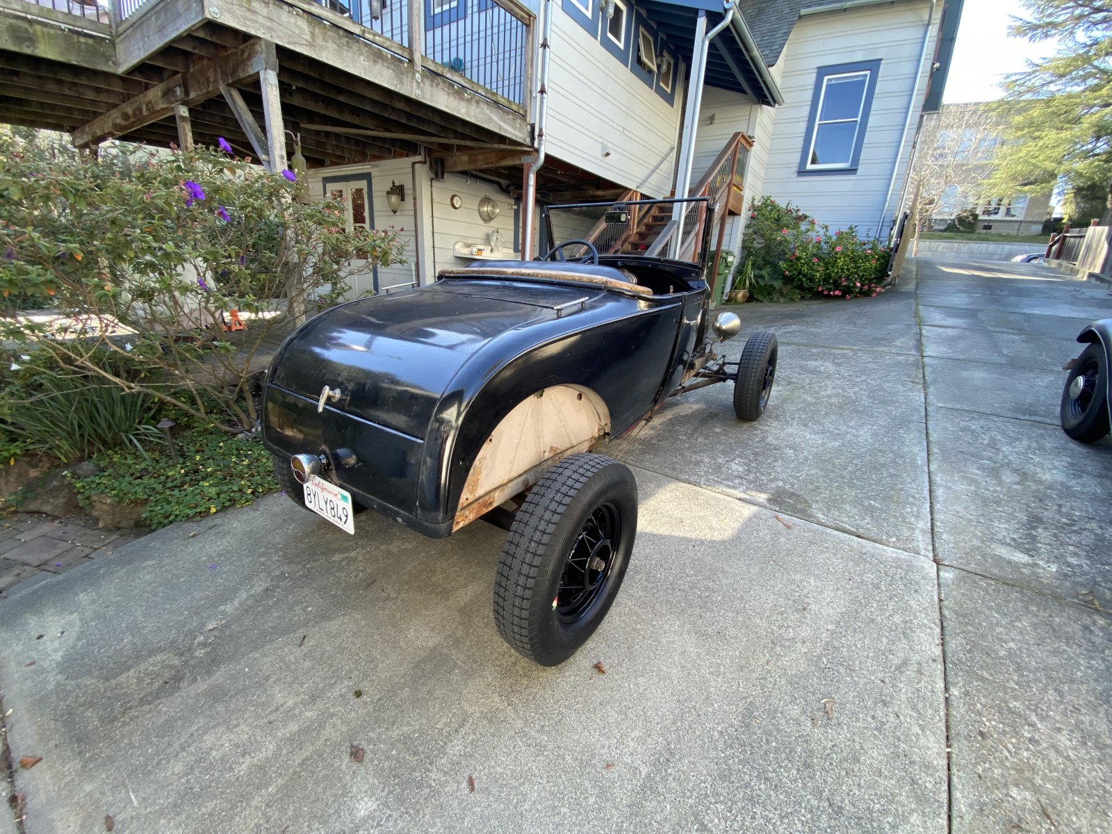

    Had the roadster out for a drive today. Went to the warehouse district for some pics.
    F6AFCAA6-9CCC-4285-8D92-7473F46C60D9.jpeg B7985F2A-DDE2-4311-8F78-1D9B1F0ABD86.jpeg
