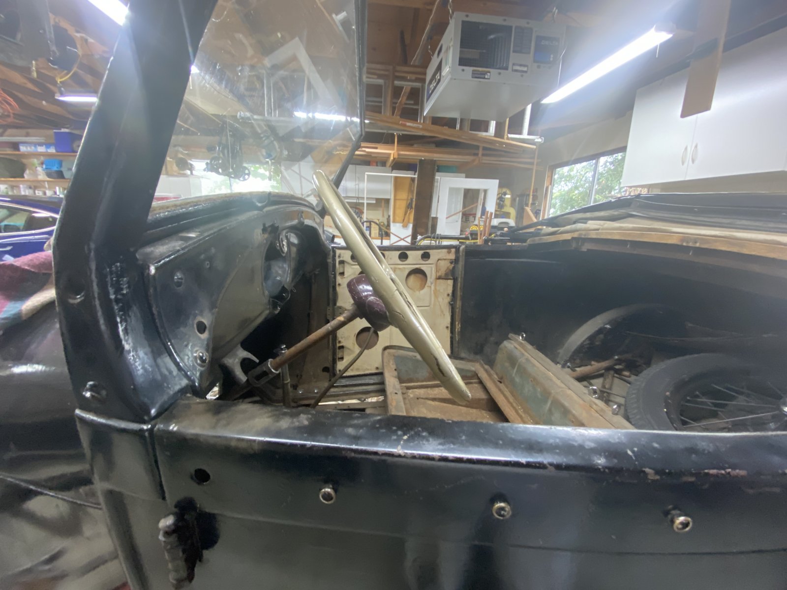

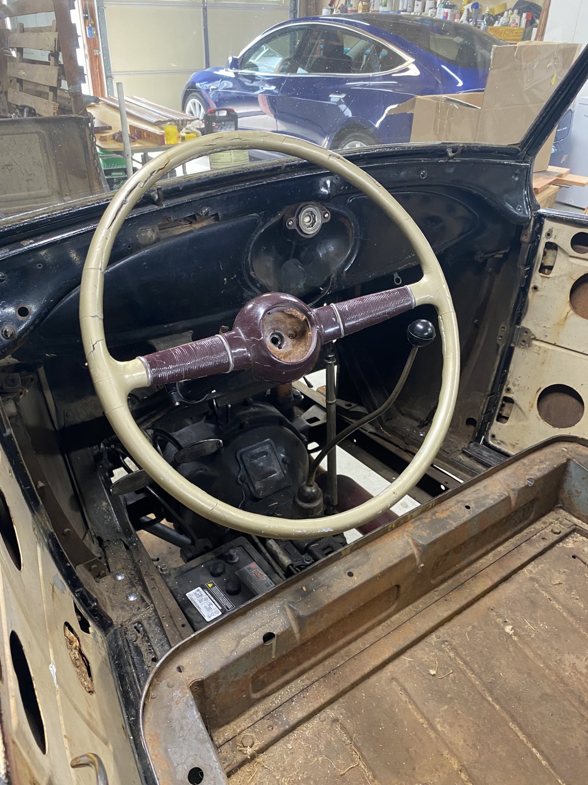

  3. Jeff34
    Joined: Jun 2, 2015
    Posts: 1,475
    Jeff34
    D71FB5F4-5BC6-45C8-89BA-ADC1B211FC0F.jpeg DBDC3314-6E94-46F4-A051-347E32927263.jpeg 7D4A5400-F27E-47E7-B042-E051375FA3C8.jpeg 9930F9A2-EDCC-4229-B47F-9A6EB78D16F5.jpeg F0685F1A-2677-4CD7-8582-7A35A6969CFD.jpeg Finally got the steering wheel off. 6 hours spent trying to remove this. Tried everything. Finally built a custom puller and it took about 3 seconds. Also fitted the 40 box and column to see how it fits. Need to bring the flathead down to mock it all up. Body comes off next.

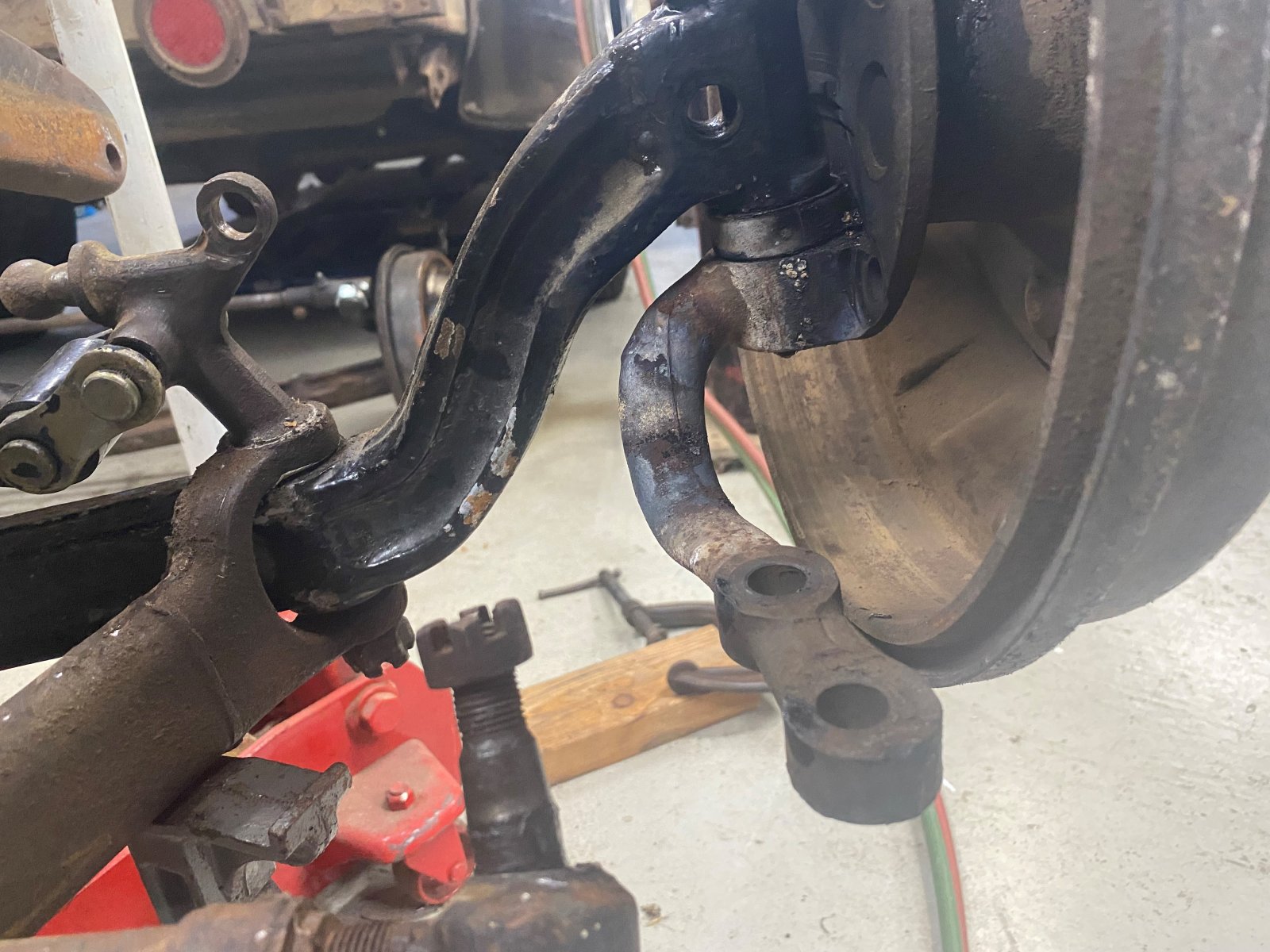

    Got to sneak out between meetings over the past two days to modify the steering arms on the '40 spindles so they don't bang into the drop axle. Tie rod fits nicely now. Also got the front wishbone cut (I'll get pics later) and I'll try to get that put on the front axle this weekend. I still need to find time (and space) to get the motor down her to see how it all fits together.

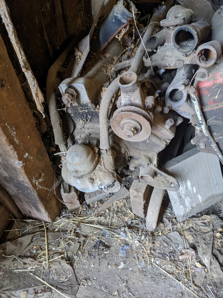

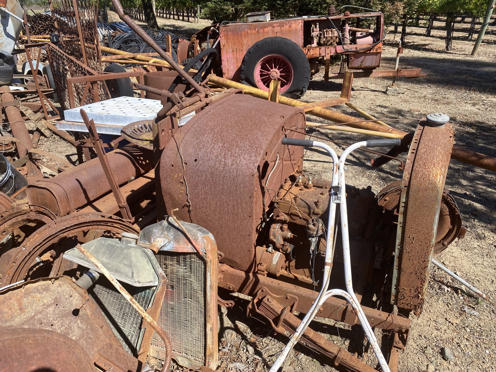

  13. Jeff34
    Joined: Jun 2, 2015
    Posts: 1,475
    Jeff34

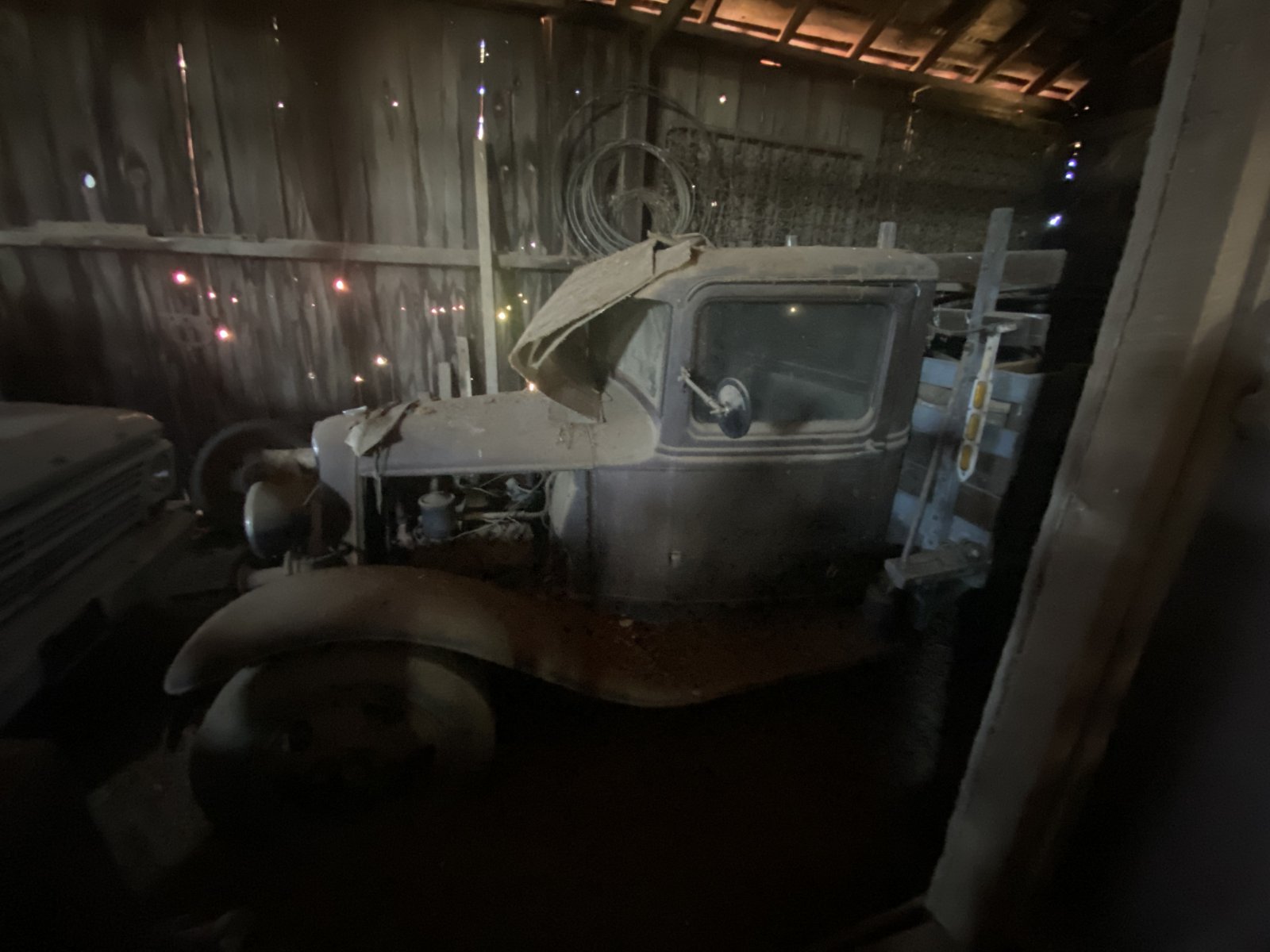

    Drove up to my cousins house in Healdsburg yesterday. He found the original’34 engine from my truck. He asked if I wanted it. Not sure if I do or not. Probably just occupy space. The ‘48 in the truck is a much better engine.
    Also took a peek in the big barn and the ‘35 flatbed is still there. Hasn’t been run in over 60 years. Also snapped a pic of a doodlebug sitting in the yard.
    it was a good visit.

  15. atch
    Joined: Sep 3, 2002
    Posts: 6,767
    atch
    That's an interesting quarter elliptic setup on the4 doodle bug. The leaves are stacked in the proper order (short on top etc.) but appear to be arched upside-down. At least upside-down to "normal".

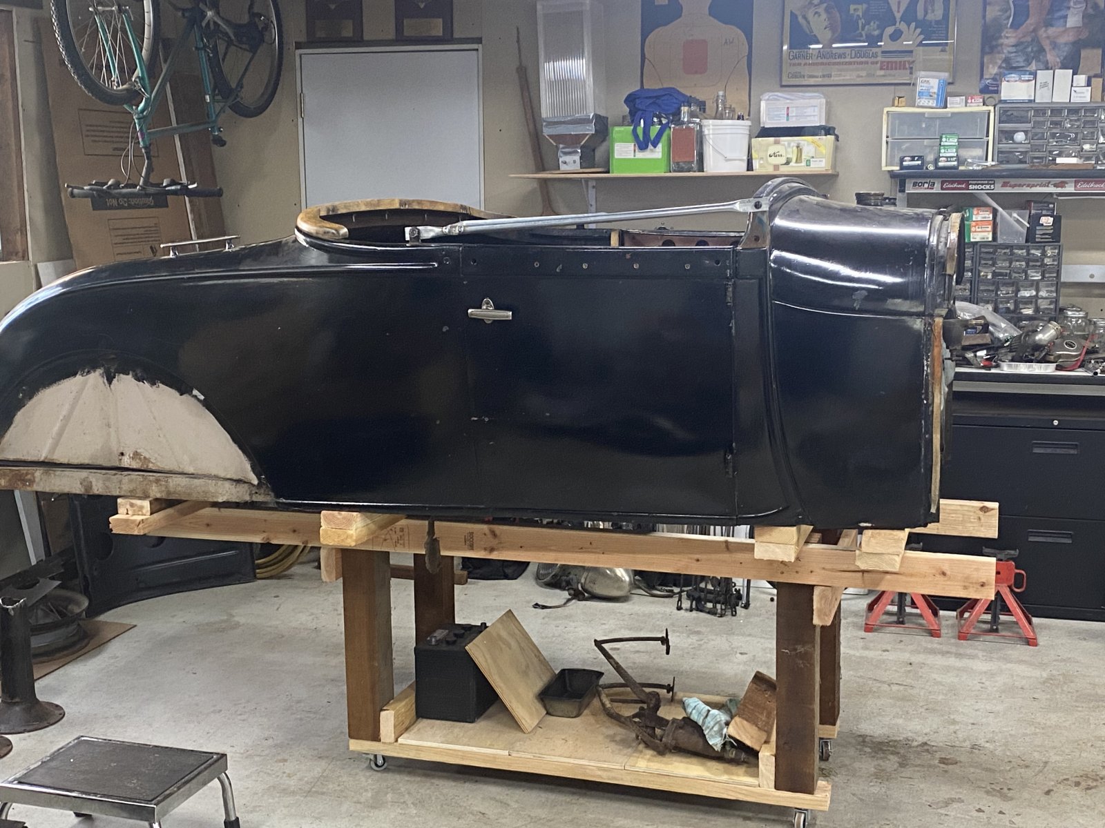

  19. Jeff34
    Joined: Jun 2, 2015
    Posts: 1,475
    Jeff34
    Got a body dolly made this weekend between working on the kitchen and the yard. Hope to get the body off tomorrow. 6952783A-FCFF-4B5A-B1C3-2970F072379A.jpeg

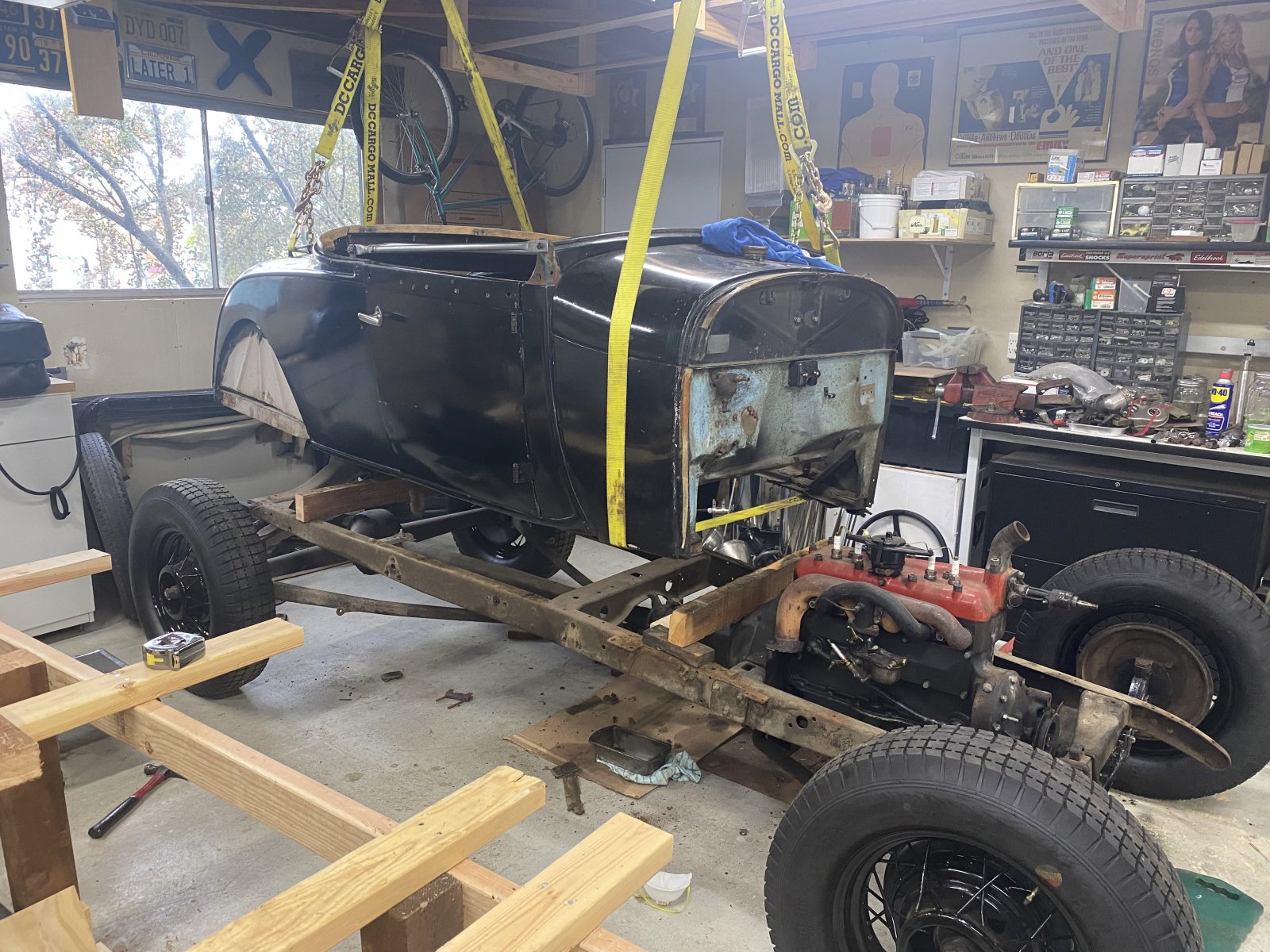

  24. Jeff34
    Joined: Jun 2, 2015
    Posts: 1,475
    Jeff34
    Got the body off the frame Friday. Hoping to sell the engine/trans tomorrow and bring the Merc down for fitting. 8085EAC7-9247-40C4-B7EE-CCDDDD458302.jpeg D48D1C45-7579-4257-BE4B-CCCA5F09BA43.jpeg D651F08E-26CC-450D-91AF-86204908F28F.jpeg 7C1E075D-6995-449C-8EF6-39429771AA85.jpeg

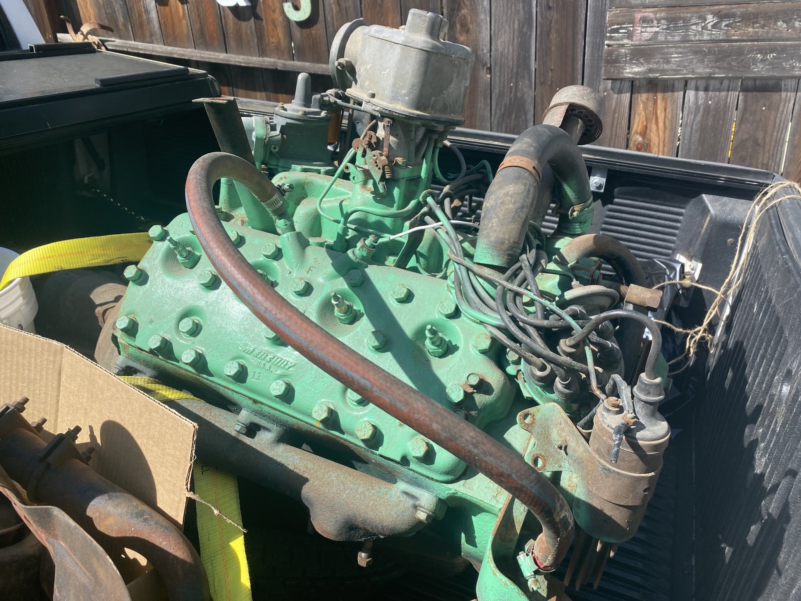

  25. Jeff34
    Joined: Jun 2, 2015
    Posts: 1,475
    Jeff34
    Engine and transmission are sold and gone. Going up to get the Merc soon and start to see how this goes together F65B3CB9-5901-4DB8-B18F-2E4ABFC4A978.jpeg

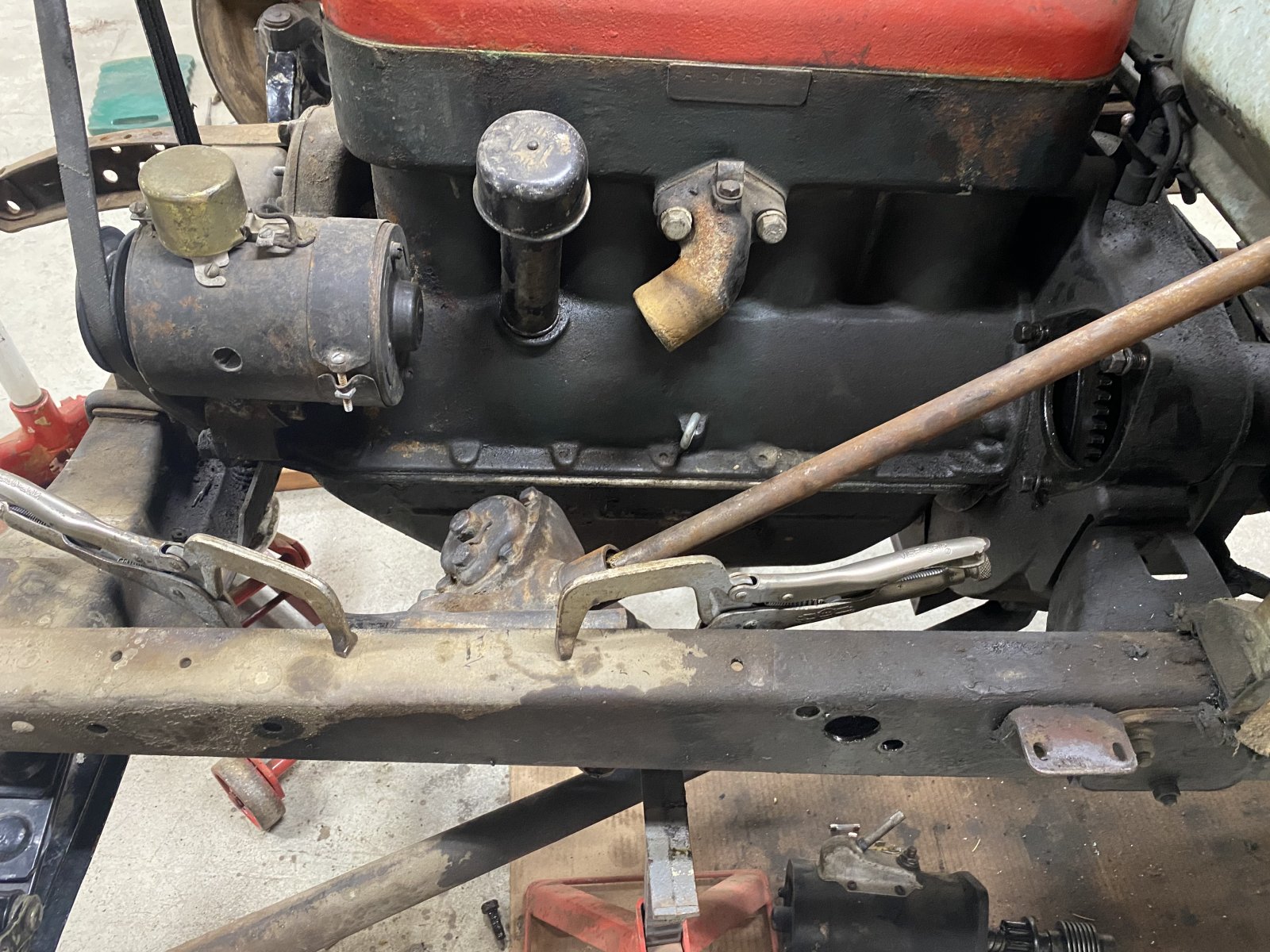

  26. Jeff34
    Joined: Jun 2, 2015
    Posts: 1,475
    Jeff34
    Question about cross steer and drag links. I clamped my motor mounts where I think they will go, and clamped the steering box in place as far forward as I can. The RED lines represent the drag link and tie rod where they would be currently. I can probably move the box forward by another 2" by modifying the mounting bracket. The GREEN line shows the angle of the drag link with the box moved forward. The picture is a bit distorted from my camera, but it give you the idea. Question is: Is it important that the drag link and tie rod are parallel? I can't make them parallel unless I move the motor mounts forward, which pushes the motor forward into the radiator. I plan to run hood top at least, so I'd rather not move the radiator forward.
    Thanks!

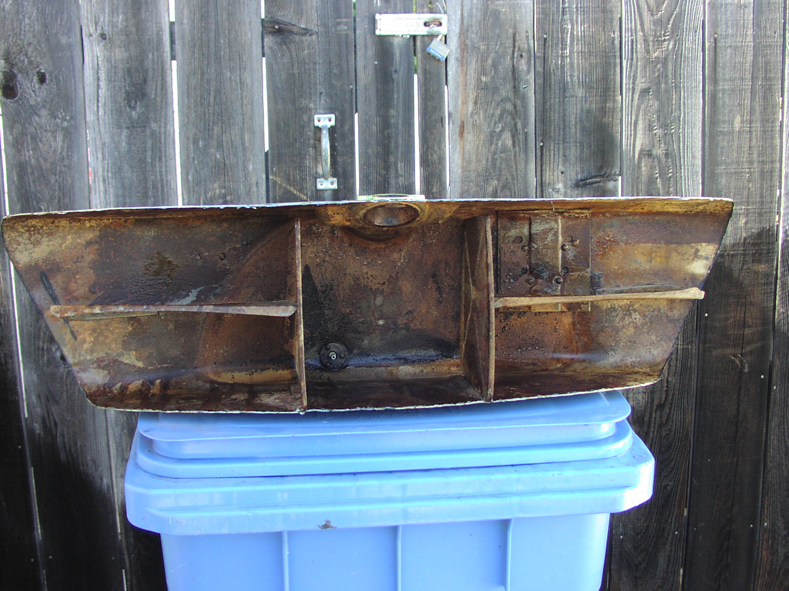

  27. Jeff34
    Joined: Jun 2, 2015
    Posts: 1,475
    Jeff34
    Since I plan to put the gas tank in the trunk, I removed the cowl tank today. That was a lot more difficult than I thought it would be. IF there's a market for these old '29 tanks, I'll plan to sell it when I'm done with the build. If NOT, I'll just hack it up and make it more usable for what I'm doing with the car. I hate doing that, but buying the cowl top and upper firewall is probably more $$ than I'll get for the tank, unless I can trade somebody.

    I have to ask. If that tank is good, why not use it?
    Rivie63 and Spooky like this.

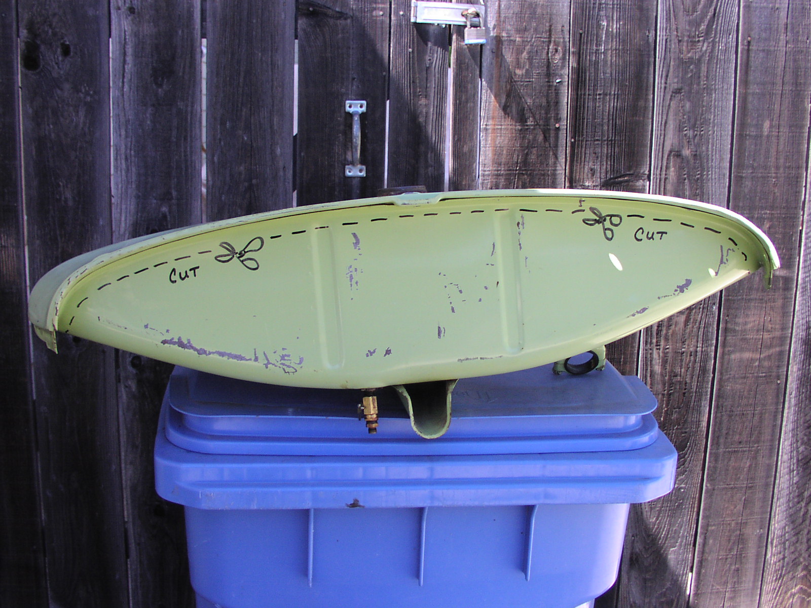

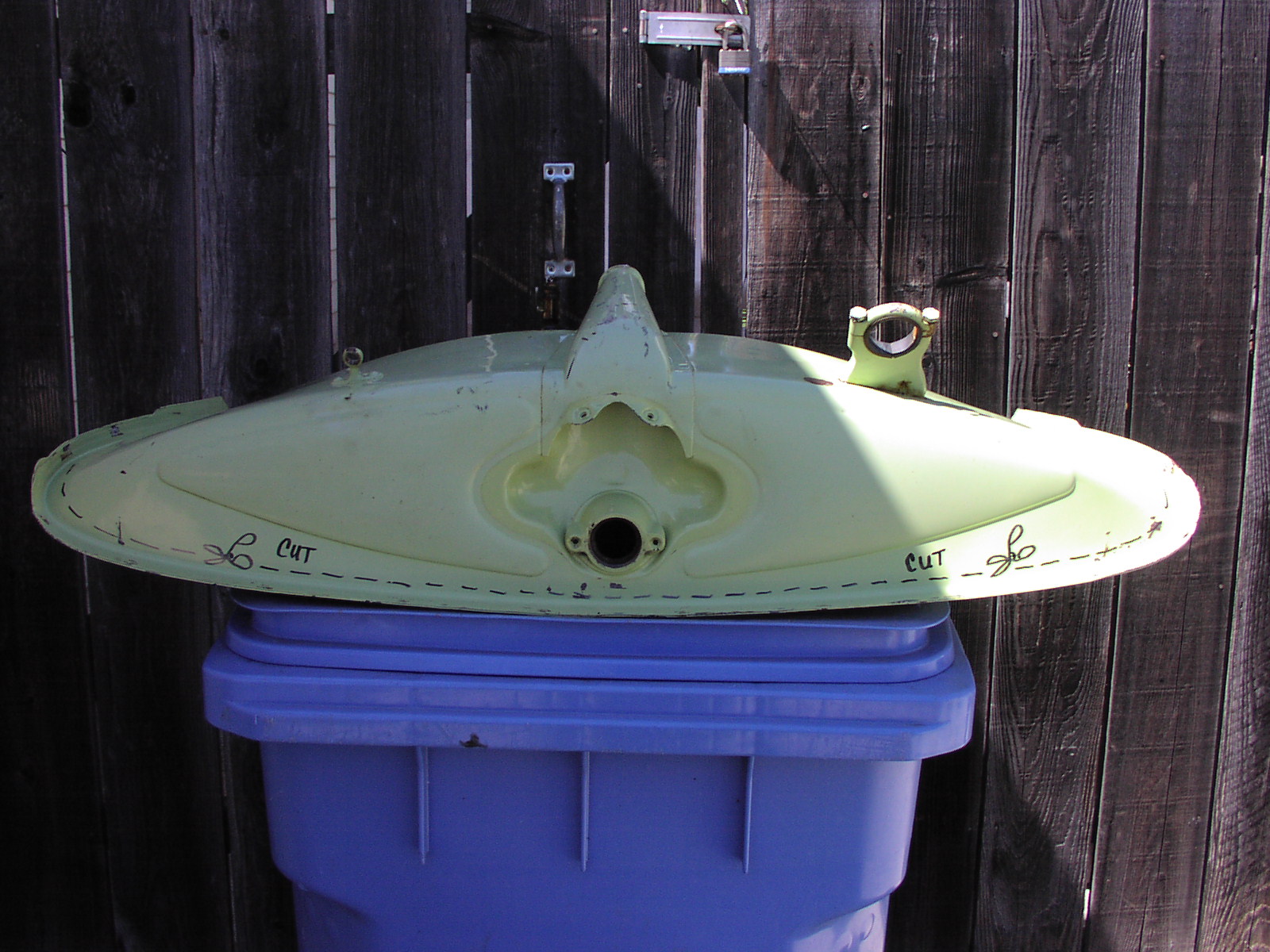

  29. Craig Owens
    Joined: Jun 28, 2006
    Posts: 468
    Craig Owens
    Hi Jeff...the cowl tank on my Model A coupe was full of old tank sealant a previous owner had put in it decades before I got the car. The **** kept clogging the fuel line so bad I finally pressed a 1" long piece of hardline into the intake of the fuel pet**** for a stand-off, which fixed the problem until I tore the car apart to make a hot rod out of it. I advertised my tank for sale hoping to get enough for it to buy a Brookville tank top, but I had no takers so I ended up cutting the tank out to make room for under dash electrical and put a tank in the trunk like you're planning to do. In hind sight, I'm glad I wasn't able to sell my old cowl tank because the paint is the same as the rest of the car and I actually like the look of the gas cap up on the cowl even if it isn't serving a purpose anymore.
    My Model A pickup still uses the cowl tank, and it's just fine, but if it ever starts leaking or shedding anything that clogs the fuel line, I won't have any hesitation about cutting it out and putting a Moon tank in the bed. I could've used that under dash space when I wired the truck, but I could still use that space for something.
    LCGarage likes this.
  30. Craig Owens
    Posts: 468
    Craig Owens
    Here're pictures of the process:
