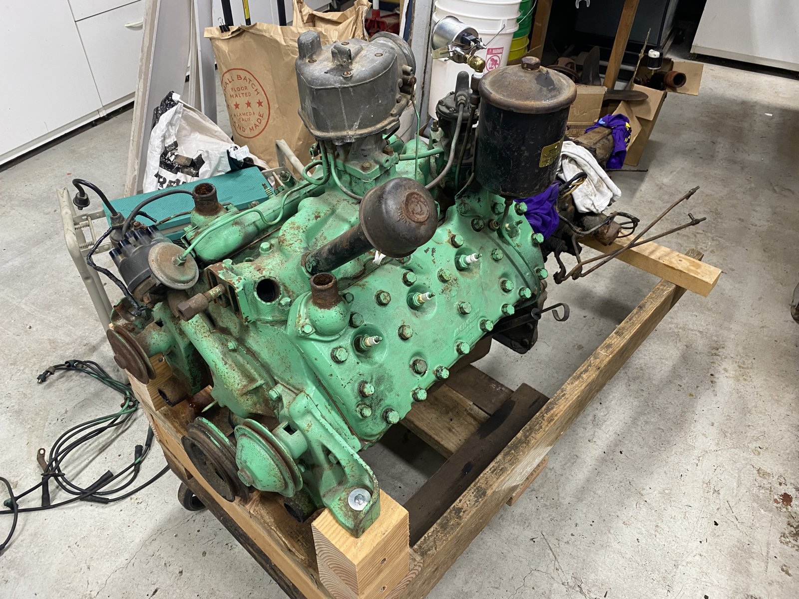

    Got the engine moved down to start fitting. Buddy loaned me a furniture dolly to move it around. Might modify it into a test stand. D4565938-5D2F-426D-AEC2-A6ABBFDE8263.jpeg 5DE5174A-BA98-4023-9128-6DB7D06E7464.jpeg

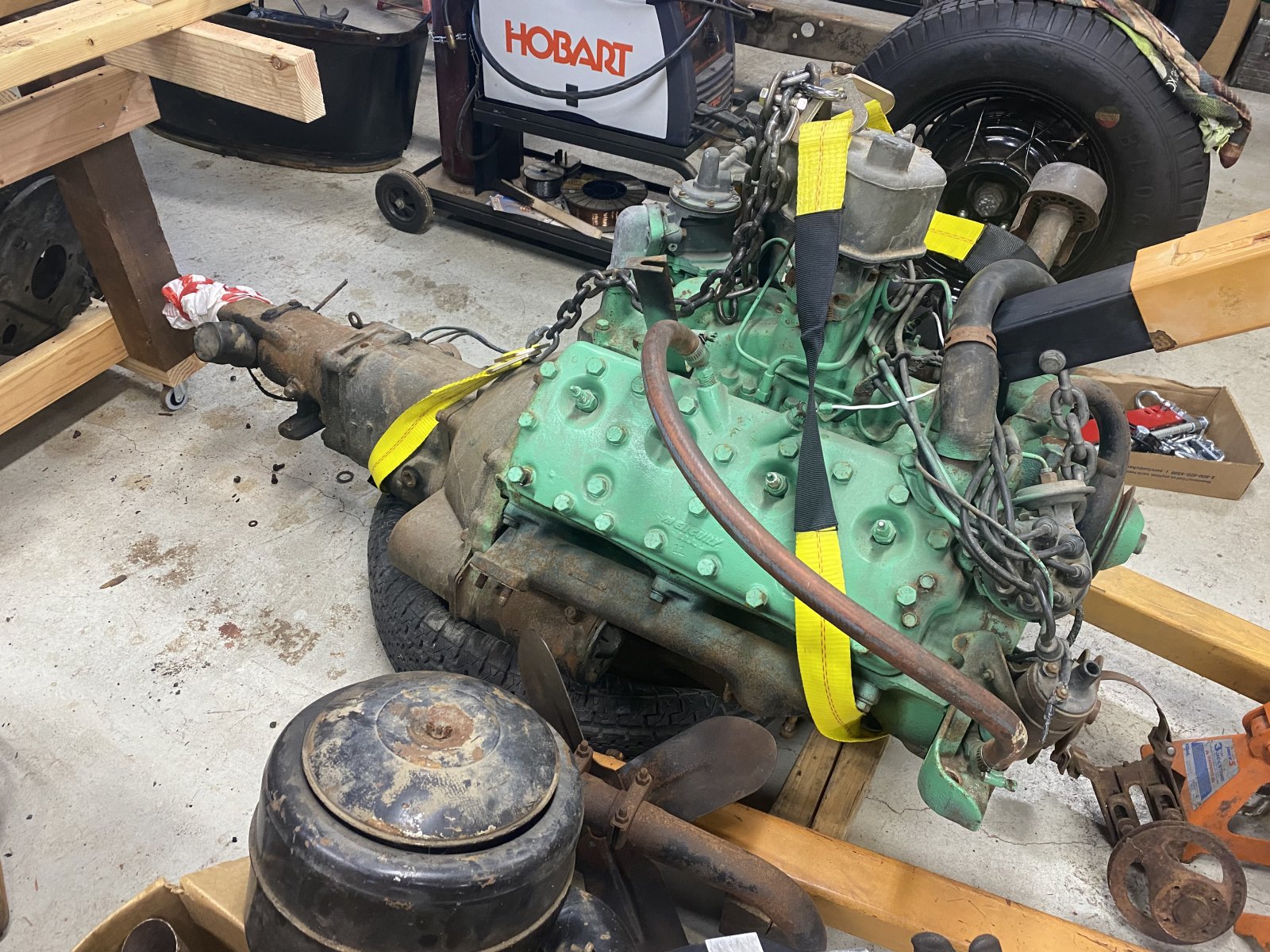

    I couldn’t resist an early test fit on Christmas Eve. BBDC4E53-234F-4B85-BA93-4154A315A188.jpeg

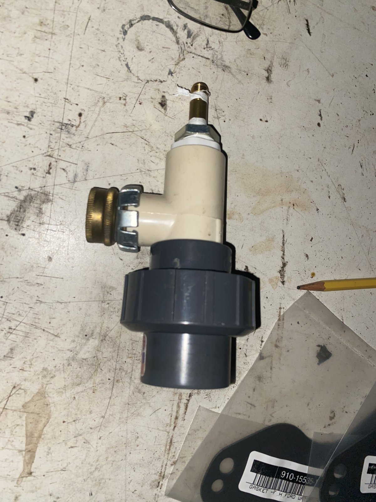

    found the flush thingy. I mad this so I can fill the block with water and then blast it out with air. Works OK.
    I connect either the lower or upper hose to the union, clamp it on, fill through the hose port with the garden hose and then blast away with air from the threaded br*** connector at the end.

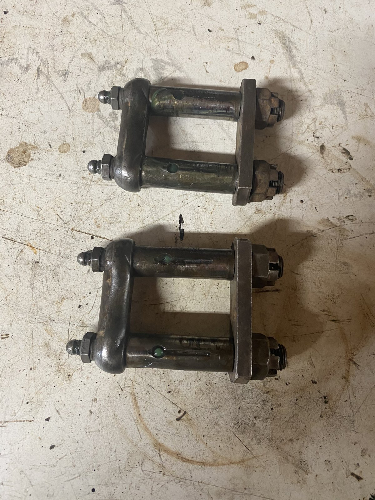

    Question: I’ve got these shackles that I would like to use for my build. The diameter of the shafts is .560. The perch and spring ID is .750. Is there a bushing available to make this work??? I know I can buy new plastic bushings but these are pretty cool. 8CCCC8EE-A786-4E6C-963C-60BE1EA30A5A.jpeg

    They are missing the shackle bushings. In theory you should be able to purchase just the bushing. They are "original style" if you're looking for them. Check the A restoration places. The plastic **** is street rod garbage.

    exactly! I’ll have to call the A places to find these. I agree that the plastic stuff is **** and also don’t look right.

    I looked on Mike's A-fordable. I think these are what you need. A whole whopping .65 cents. Screenshot_20230218_185232_Chrome.jpg

    They were only .690 OD. I need .750 OD. Still looking. Also harvested more parts from the donor car today. 7E63D2AB-2CF0-4E4B-B370-967198788ED9.jpeg BEB03C89-6A68-4D2B-805D-787F3F662466.jpeg

    Try the bushings for the Model A rear spring, they have a larger OD. They are also longer than the front spring bushings but are easy to cut to length. A lot of the bushings available are rolled flat stock so they have a seam in them. One piece, no seam bushings are available from Bratton's Model A parts and won't distort like the seamed ones can.

    know anyone with a lathe? make em.......
