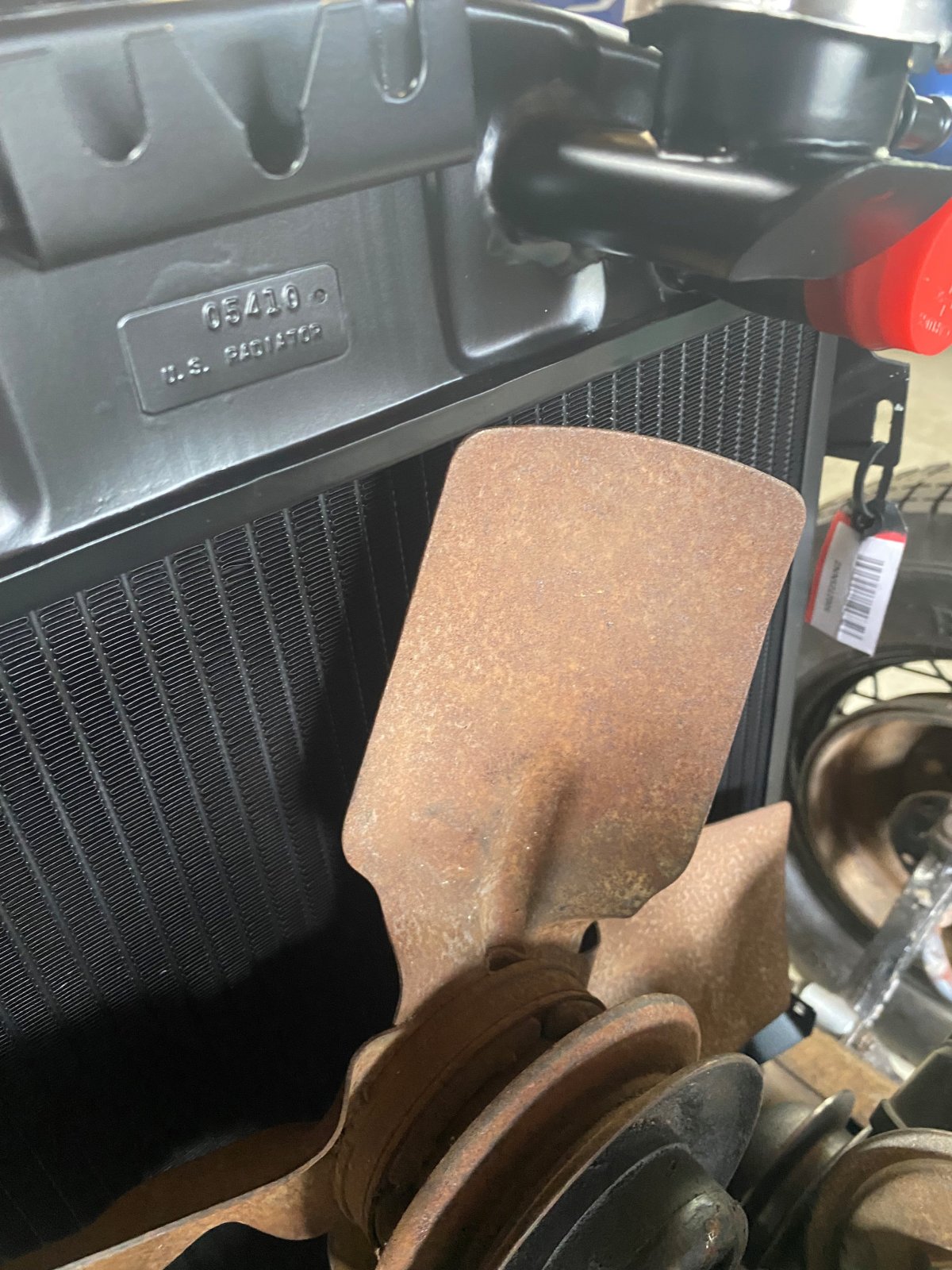

    Looks like if I mount my fan like @Aaron D. did in his coupe, I can fit the radiator in the stock location and run a hood top and/or sides. I got the radiator today and it leaves a small space between the fan and the radiator. Not much, but it should be enough. This means I'll need to run the generator on the drivers side head, so I'll look at making or buying a mounting bracket for that and fashion some form of fan mount bracket next...
    The fan touches the bottom of the top tank by a smidge now, so I'll need to drop it a bit, which shouldn't be a problem with a custom bracket. I'll just make what I need. I will only run one belt with this setup driving everything. Anybody see that as a problem?

    You can make a little template and trim the fan blades down a bit if you can’t get it low enough.

    Like J Ripper said, trim the blades. I have an 8BA in my 34 and it's close to the radiator and the top tank. My fan lost about a quarter inch off the blades and it works well.

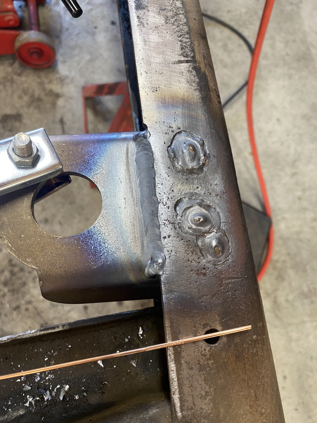

    Pulled the engine and front end to make it easier to weld in the engine mounts. Comments on my welds, please. I practiced for a week with my new TIG machine before doing these. Weld pool looked good. Made one p*** on the seam and put more heat into the mount which is thicker steel. Did two plug welds and filled an extra hole on top just because. Beat one of them with a hammer and it sounded solid and didn’t crack or budge. IMG_3049.jpeg

    Hi Jeff, I've got 3,000 miles on my single belt fan pully system with no problems at all.
    Your welds look fine to me!

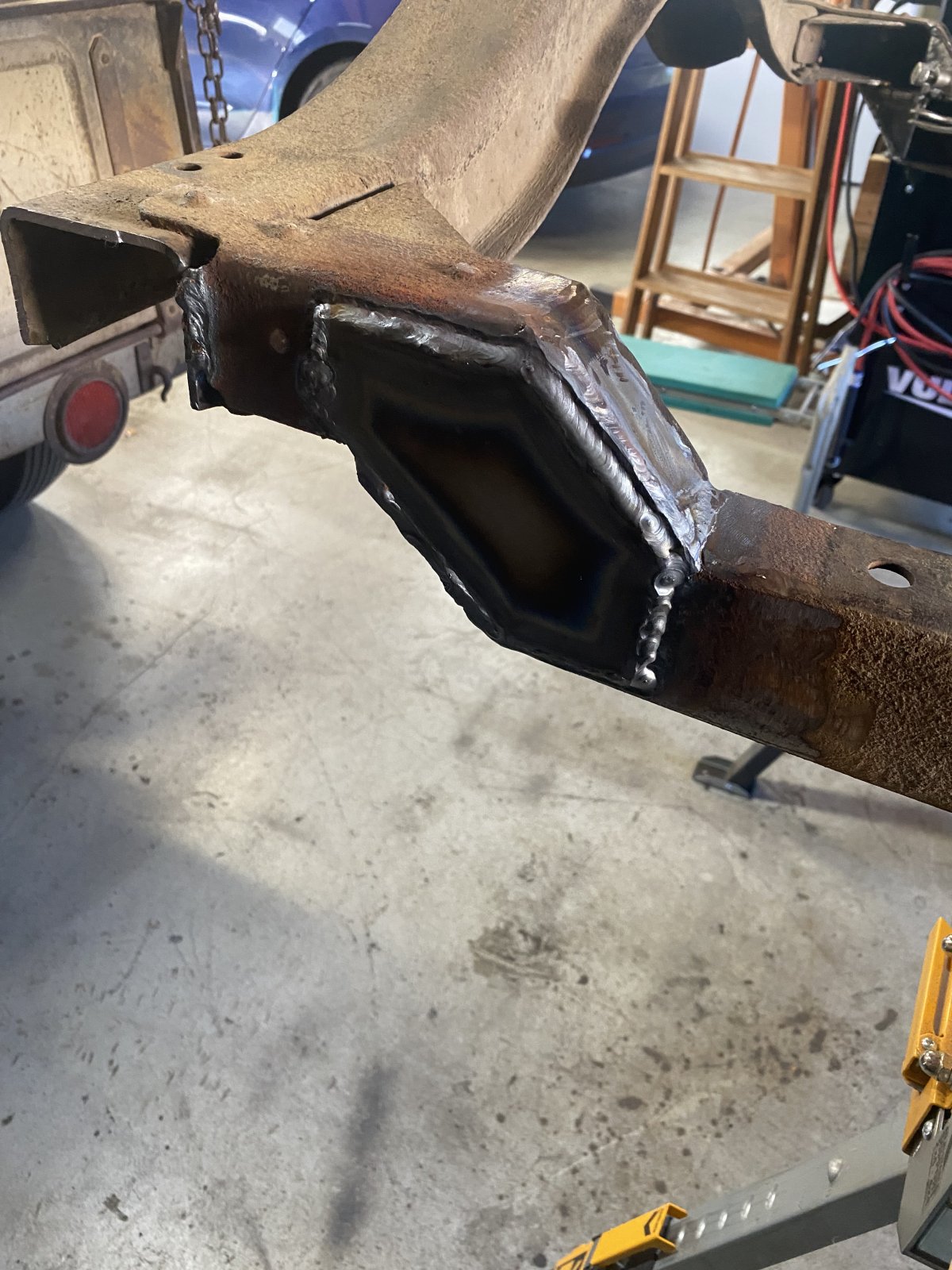

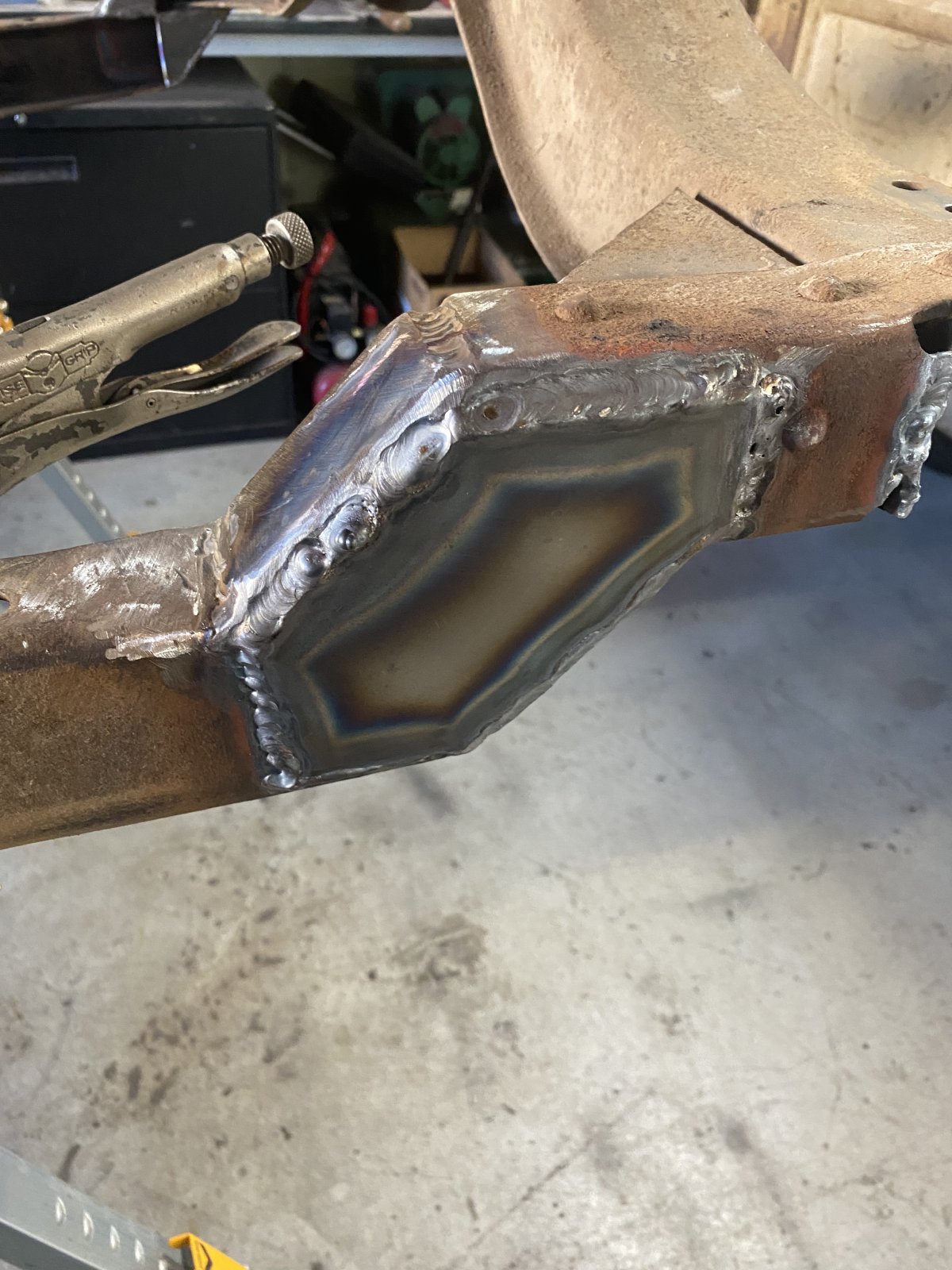

    IMG_3082.jpeg IMG_3081.jpeg Finished welding the fish plates on the step. Not great but the welds are solid. Really liking TIG over MIG even though I’m still learning.

    Was having trouble getting the main leaf reversed (going slow so I don't break it), and at one point I heard a "tink". When I looked closer, I saw a crack in the leaf. ****. Oh well, I gave it my best. New main leaf ordered. I also got the crack in the front cross member welded up yesterday (dang was it HOT in the garage) and the front end back under the frame. once the new rear main leaf gets here, I'll get the rear in so I can get this moving forward.

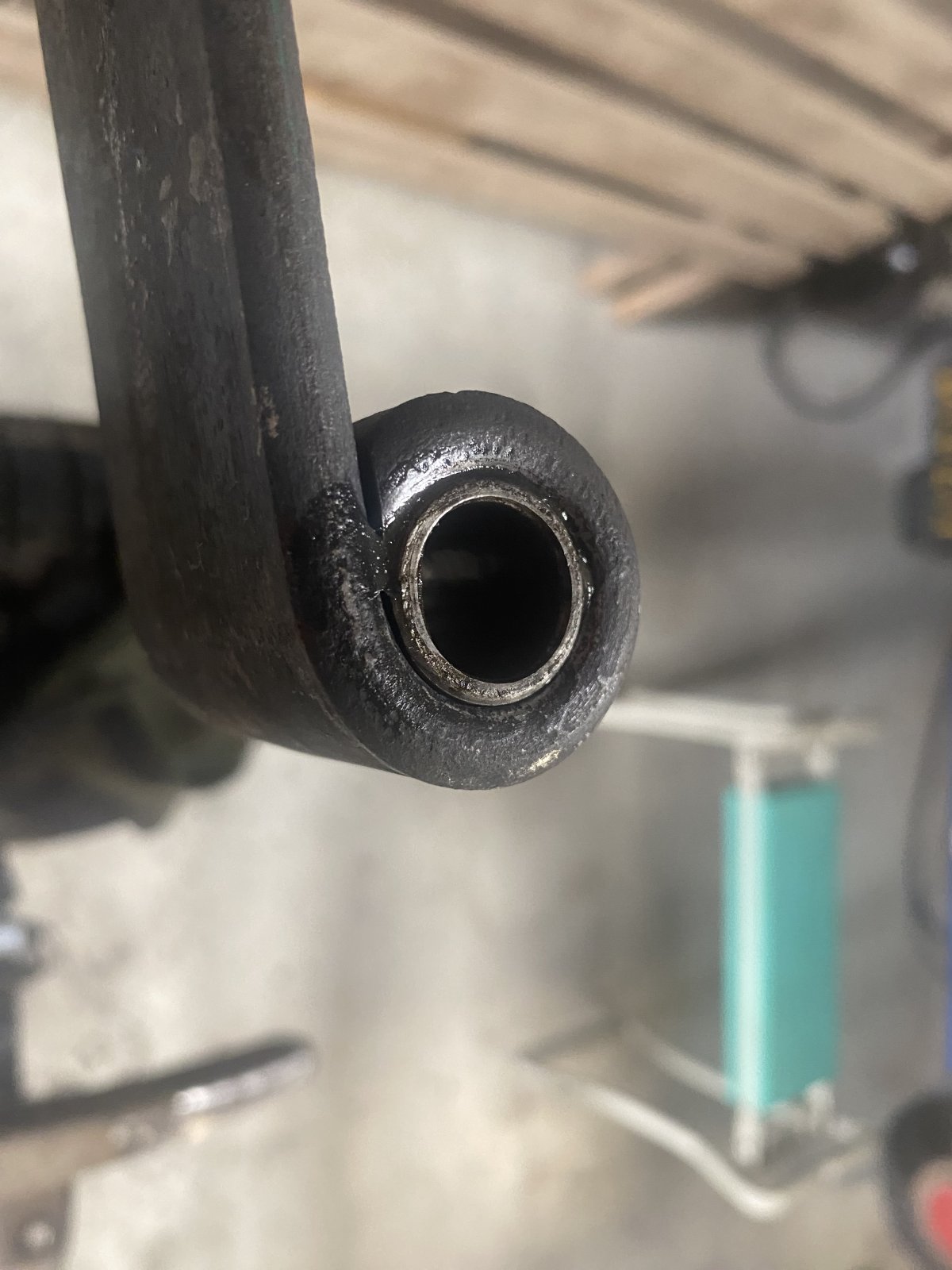

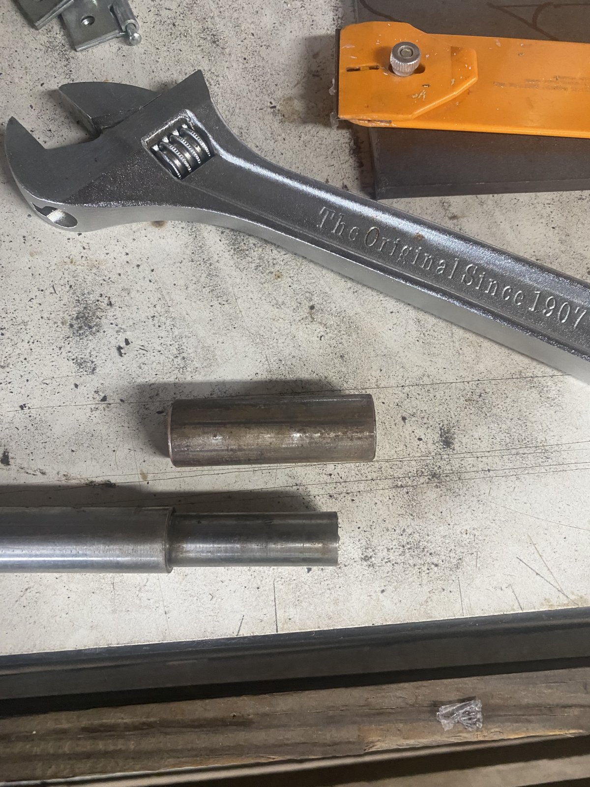

    Last week, I got my new rear main leaf from Millworks. Today, I planned to get the rear end re-***embled and back in the car. I forgot that the new spring had no bushings, so I had to use the ones from the old spring. I found a punch in my toolbox that I’ve had for over 20 years and didn’t know what it was for. Turned out it was the perfect size to drift the bushings out of the old spring and into the new spring. Who’d a thunk it. With that I put the leaves back in but found that the second leaf is now too long with the reverse eyed main, so I have to trim it. Temp in the garage got too hot so I gave up for the day. IMG_3120.jpeg IMG_3121.jpeg IMG_3122.jpeg IMG_3123.jpeg IMG_3124.jpeg IMG_3125.jpeg IMG_3126.jpeg
