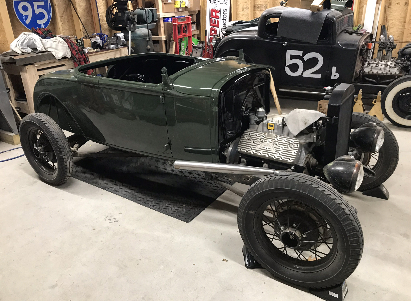

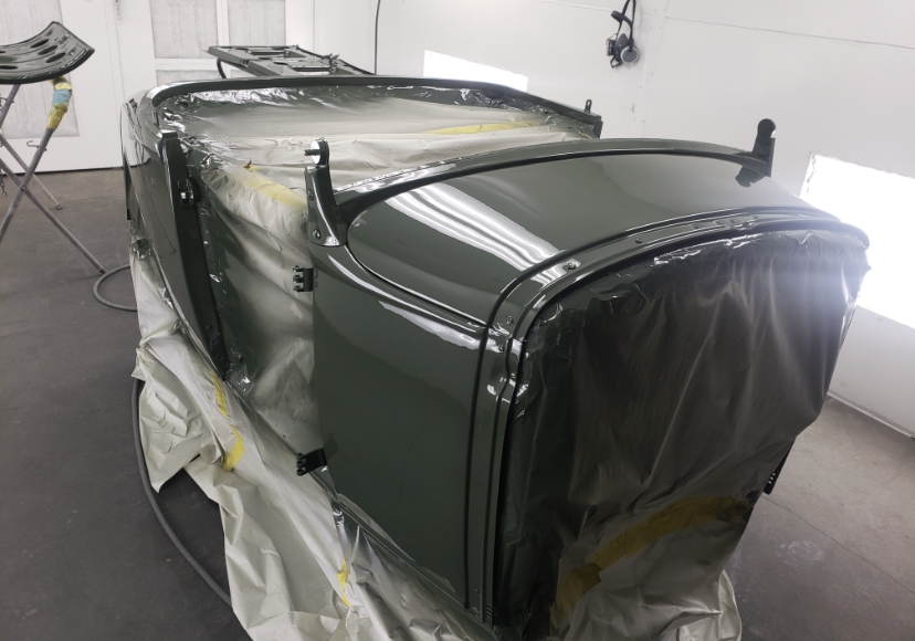

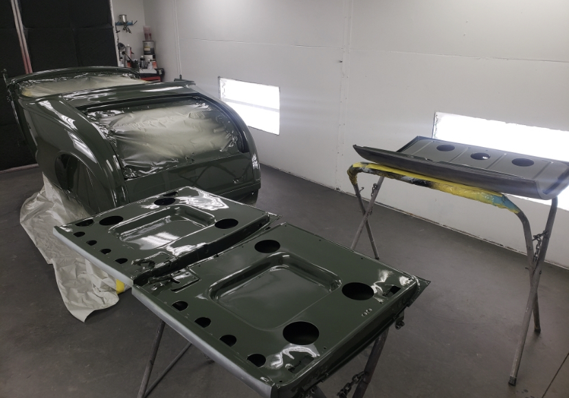

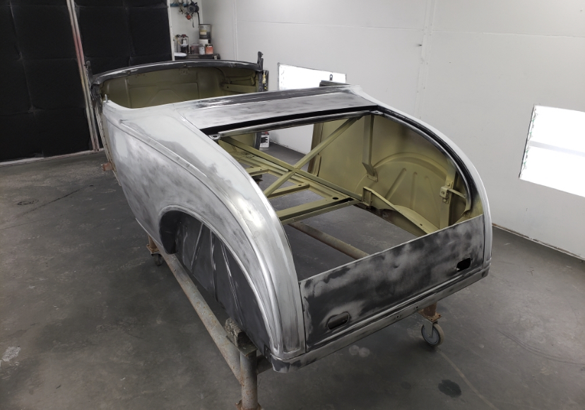

    68FC8988-994C-47F6-8BF3-9FB19FCAC40E.jpeg 54CA906A-38E7-45E8-A4A1-1E6B4411E771.jpeg Mike finished his shop, tools are situated so work has commenced.

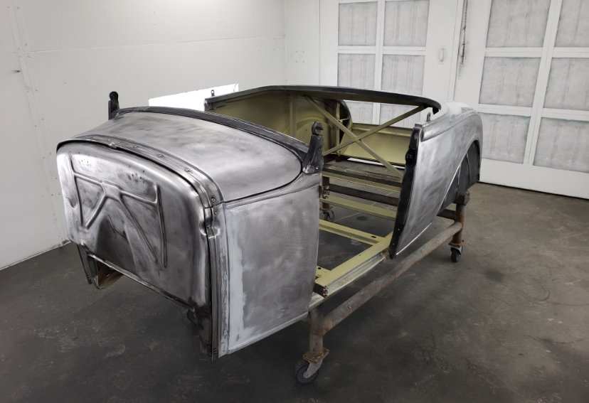

    With the ch***is 80% set up the body was removed and sent to Traditional Speed and Custom in Pittsfield NH for some minor body and paint. Mike picked a dark green,,,,green looks good on anything!!
    Eli shrunk some panels, bumped out some low spots than sprayed it.

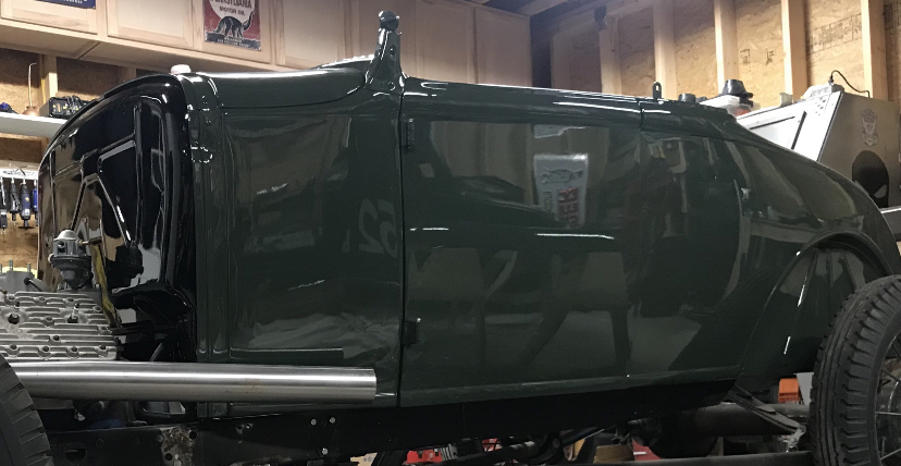

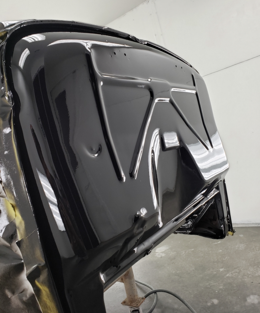

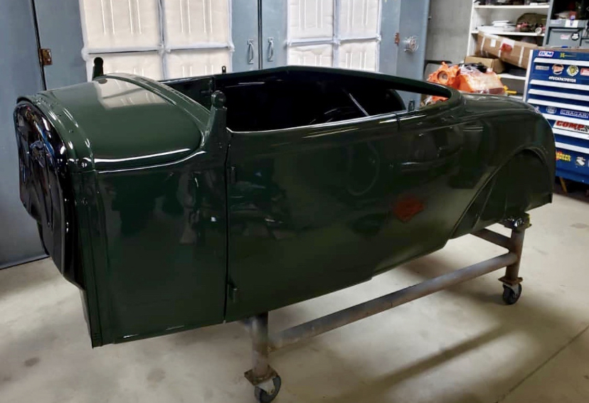

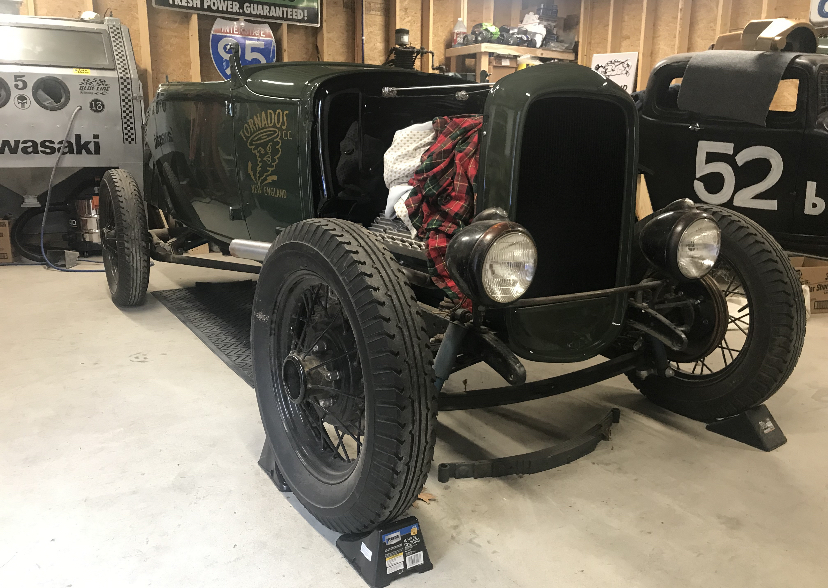

    4668E9B2-1719-4787-B8A3-7C373E8411B5.jpeg 944B169E-075B-40AE-B0C6-6BBDF2D2DF21.jpeg 1DC72EAD-20DF-4DFD-BFD2-4815B5C8CEFB.jpeg E4B3EE36-F382-4324-A2AF-30164AE9409E.jpeg The black firewall and Green body look awesome.

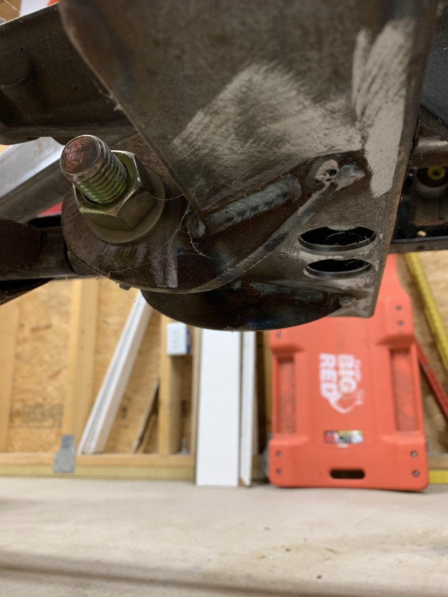

    39EE5688-EA46-48BC-8701-B417BAE9BB86.jpeg 01D51792-D729-4FC2-93A7-5F5BABBAB973.jpeg F4DE9A42-4E45-40A7-85F8-5CC0178EA66D.jpeg 3980BA8A-F608-4CFF-ADDE-AC17EA9DB3F7.jpeg We got the body home and dropped it on the ch***is one more time. We had to re adjust the pinion angle and installed a double toque arm.

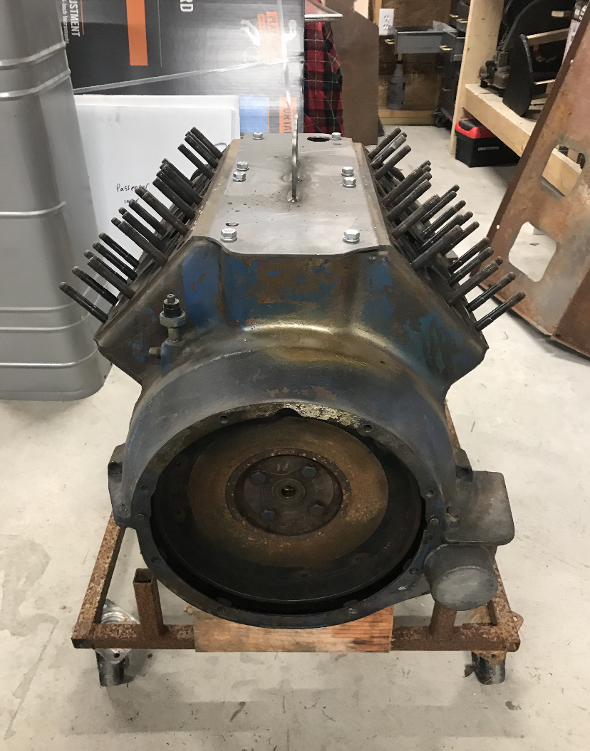

    Mike has a fully rebuilt 59a going in, oversized pistons, adjustables and a Potvin cam.
    17D8A0F7-CAC9-42D6-9343-72408D5CA44B.jpeg 5CF86838-7109-4985-9456-F4F7F5AFEBA0.jpeg

    I'm digging that double torque arm!
    Jeff34 likes this.
  14. Pete
    Joined: Mar 8, 2001
    Posts: 4,792
    Pete
    If ones good,,,two’s bettah!

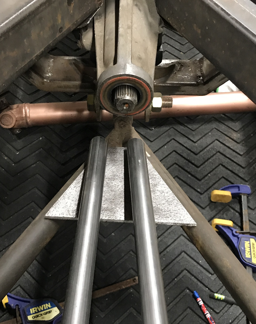

    Nice work on the torque arm brackets!...I scrolled thru 100's of ch***is tabs on Epay looking for the ideal one that could be easily modified for the situation. Milled some out of 3/8 aluminum but was concerned with strength. And they just didn't look right. Little thing as such are sometimes the biggest hurdle.
    -Ron

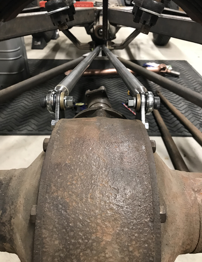

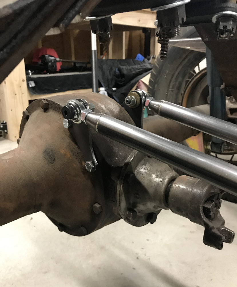

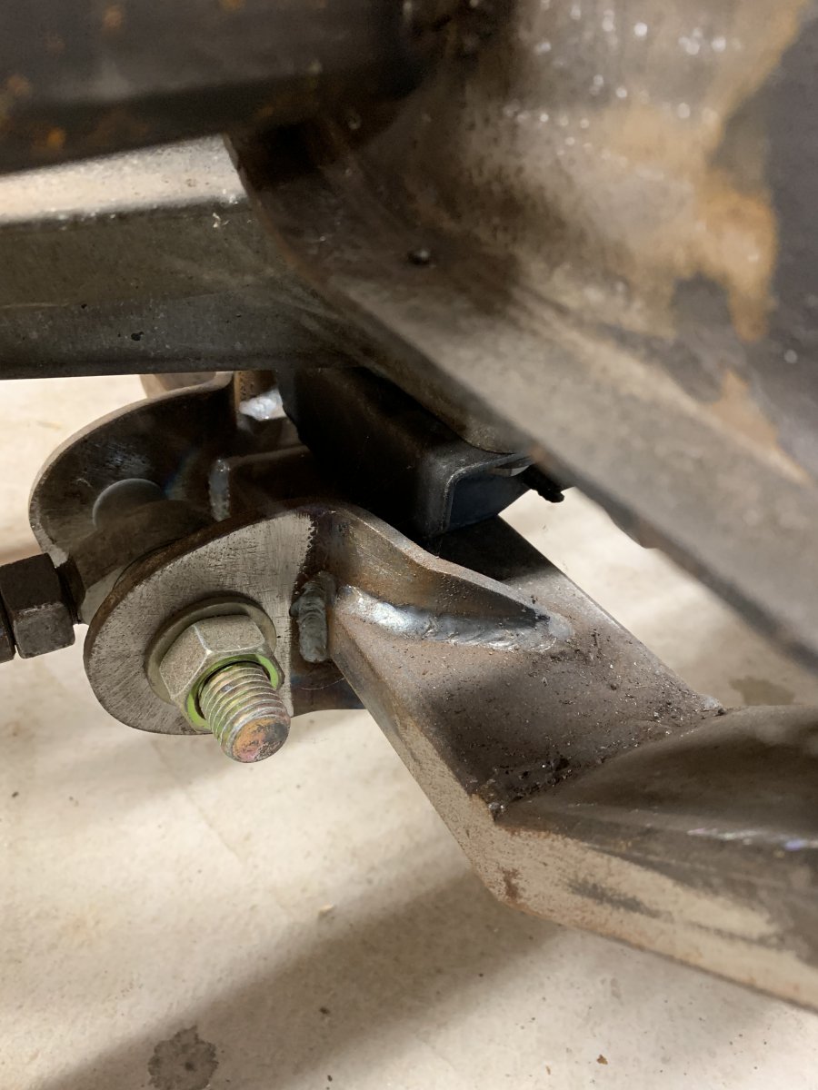

    Here’s a few pics of the rear wishbones. They meet isn a stock configuration and pivot on a 7/8 Heim joint. This lets the rear end move with no stress.
    98ED9346-E098-41F2-BEFB-432BC3D084B3.jpeg 8882F618-F35B-4203-A10F-6D5034D90CE1.jpeg
