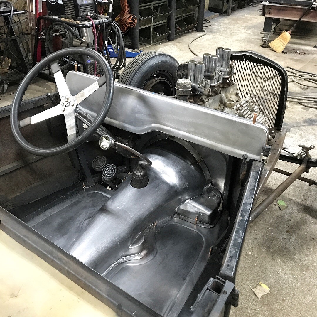

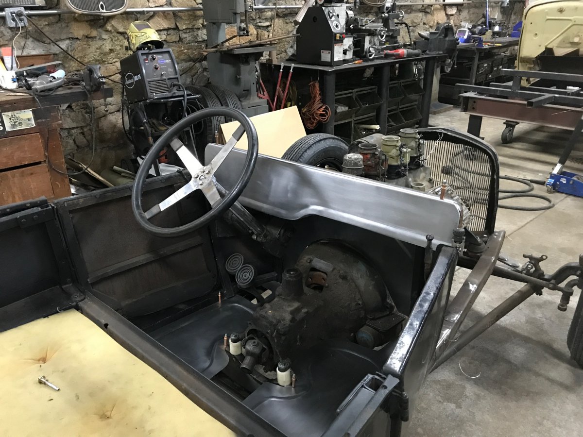

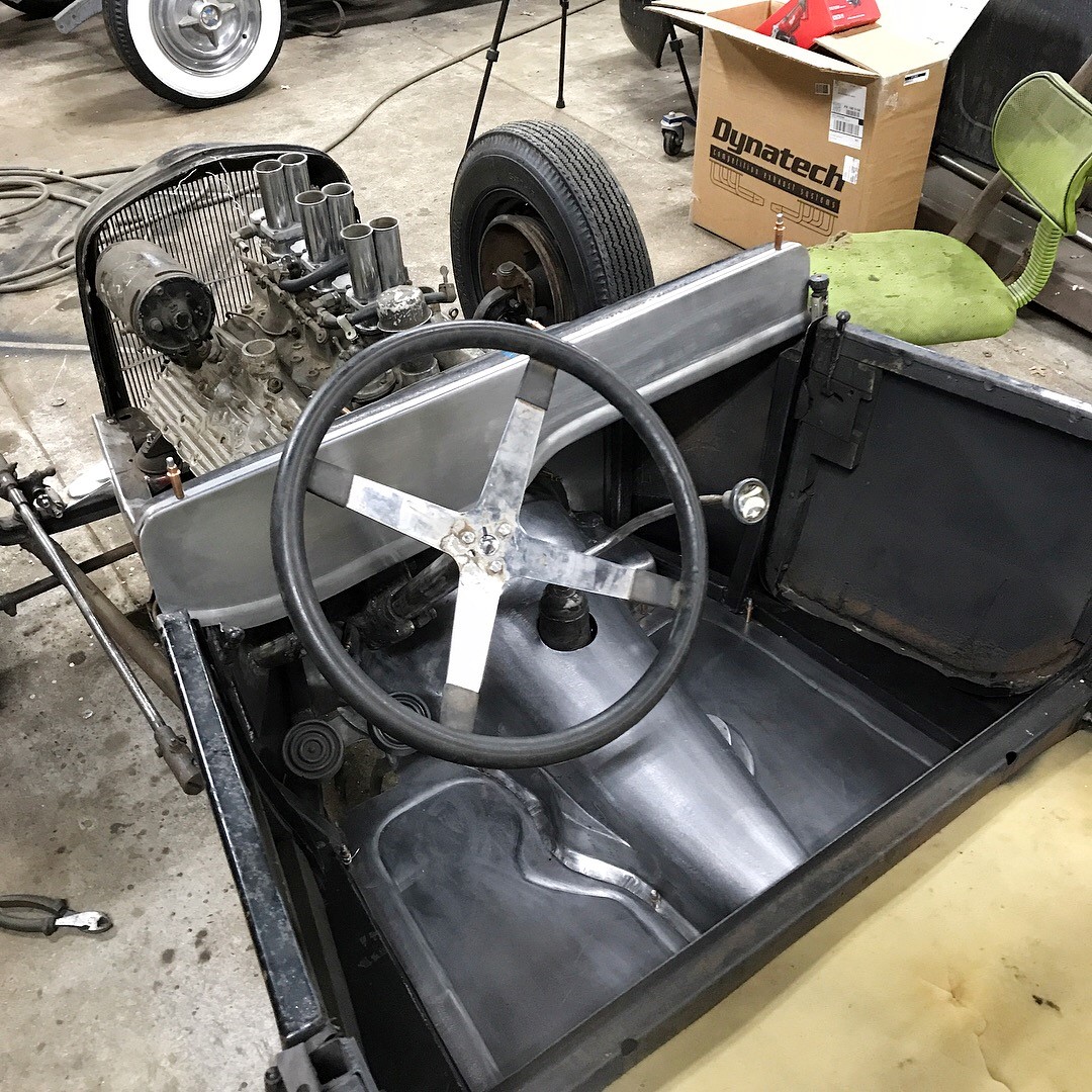

    Took forever, but the tunnel is basically done in the free T. I need to make/extend a s**** pedal to squeeze in next to the brake pedal. I think I can make it all work with out sitting my foot on the tunnel. I think I'm going to move on to making headers next so I can take a week or two off from staring at the inside of the car. Video coming next week of the tunnel building process.
    jerseyboy, Jet96, brad2v and 14 others like this.
  2. Vanness
    Joined: Aug 5, 2017
    Posts: 411
    Vanness
    Banging work on the floor.

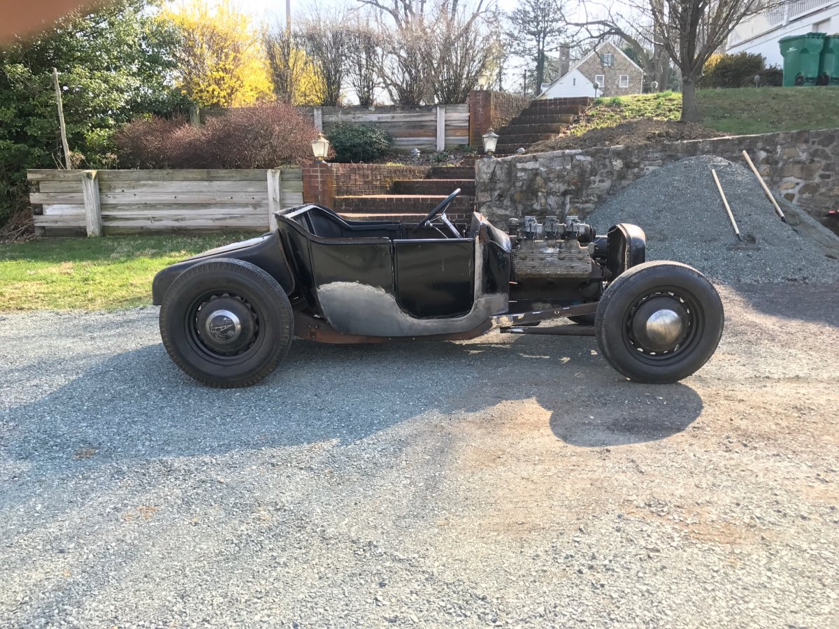

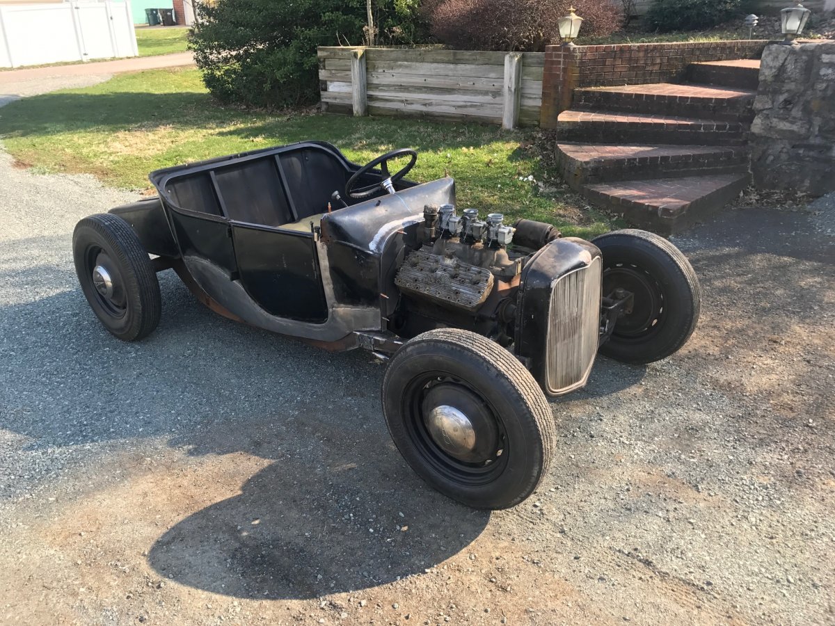

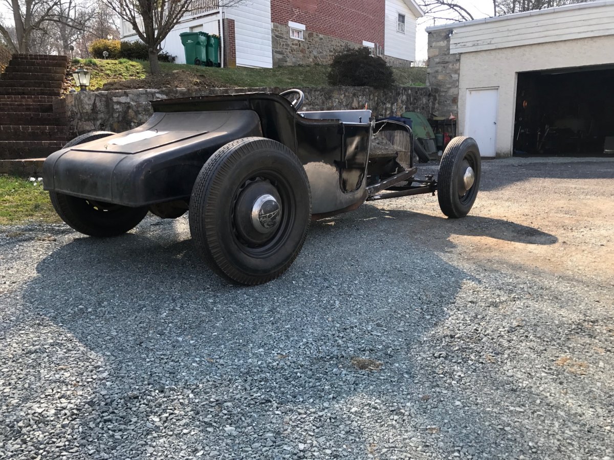

    They're 55-56 Dodge Lancer caps. I finally got a few minutes to mount the rear tires/wheels this past weekend and I snapped a pic. Hope that helps!

    Shadow Creek
    Thanks man that does help! That’s an awesome roadster, my wife’s sedan will be built in a similar style. Is there a thread on it?

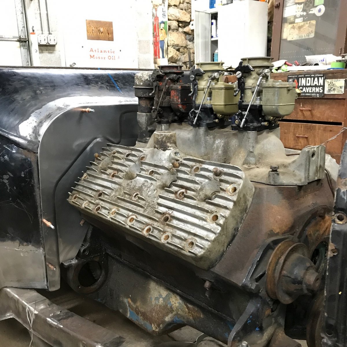

    Working on headers this past weekend. Not my favorite thing to do, but good practice.

    Final version all tacked up and with no clamps/magnets. Ended up shortening it up a little as it was sticking too far out from the car in the back when it was longer. Now to duplicate on the other side! header_welded.jpg

    Got the rear wishbones split, modified, and mounted to the frame. I'll make some sort of panhard bar once the car is blown apart for final welding. I decided to sit in the car with the final ride height/pinion angle correct and the rear frame re-radiused for axle clearance. I think it sits just right.
    I also got the majority of the drivers side header mocked up late last night. Should have that ****oned up this week and can move on to making the door skins.

    Got the other header all tacked together last night. Been burning the candle at both ends. I can start moving back to some sheet metal work now and send the engine off to my engine builder next weekend. Planning to build some doors from scratch for the car now.
