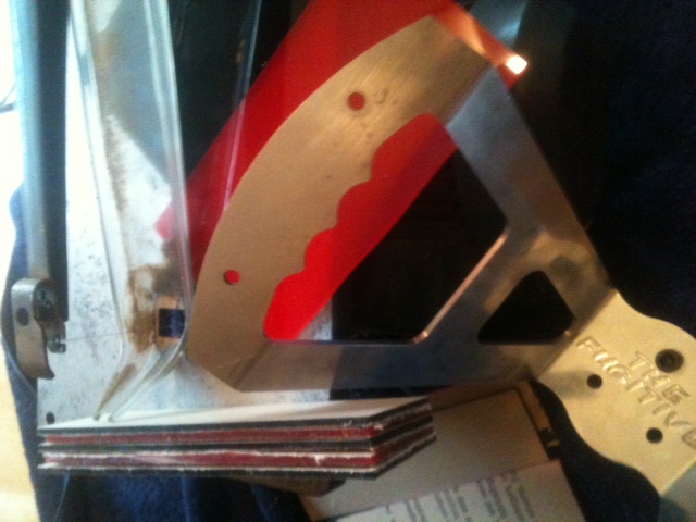

    Things are going along great found a guy in cali with nos magnesium outer halfs for my rear wheels. Going over my list i needed a steering wheel butterfly dragster style. looked at the wheel thread on the hamb and decided to build my own sat down on sunday and drew up a cardboard template stopped at my buddy joes machine shop transfered the template to his cnc machine and made my own wheel it came out fantastic for grips im using layered laminant plastic to give it that 50's hot rod look Red and Black.here are pics of the wheel prior to being bent.

    The butterfly wheel fully formed only thing left are the grips

    Cut the blanks for my grips from colored lexan used a scroll saw with a fine blade used part of the steering wheel layout on my friends cnc machine and are going to attempt to mill the grip shape.

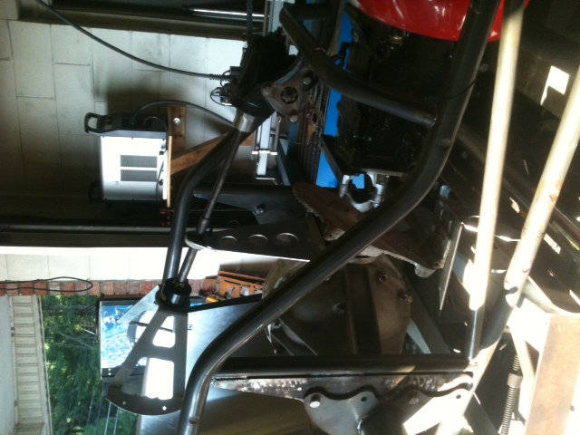

    steering box mounting bracket for my reversed corvair box. cut out on a plasma jet. here is the box installed. David Beard of dragster supply produces these brackets right in his shop in a cad assisted plasma jet. the quality and finish for a one off part is amazing.

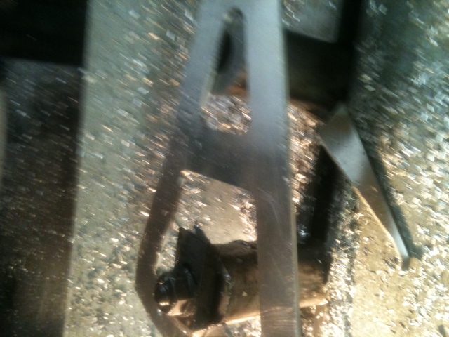

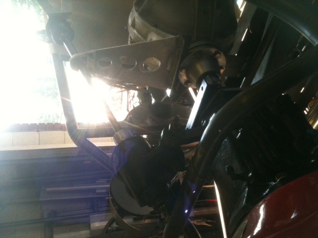

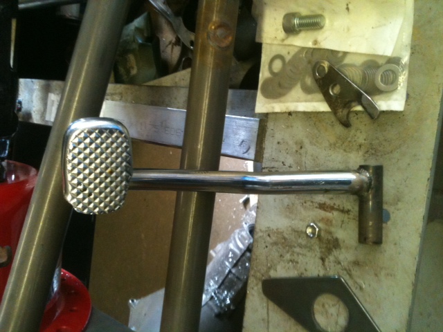

    Spent the last few day at David Beards shop helping get my dragster together fabricating parts and fitting the car ,pedals rollcage to fit me. check out the engraving with his plasma arc oustanding for making brackets in steel and aluminium how do you like my 750 honda brake pedal as a clutch pedal , cool steering support vintage moon pedal

    Check the rules , But I do beleive that the clutch can you are using is not legal in an open cockpit chassie, Reason being that the opening for your clutch fork is not enclosed and even though the likelyhood of a clutch comming out is minimal the rules state the there will be no openings that are not covered.
  14. Ricci32
    Joined: Jul 30, 2010
    Posts: 416
    Ricci32
    It seems that a naturally asperated car with a single or two disk clutch can have a slot for a standard clutch fork as long as the slot is behind the plane of the rotating assembly.

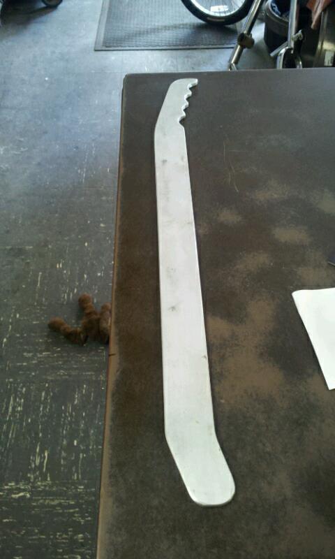

    Cut out the brake handle from 1/4 " aluminium scrap. Once again used the plasma jet . It will get the same grips as the steering wheel.

    Hey I remember in talks that they upped Brake handle material to 3/8".
    Is that just for the 7.50 and faster? Have to check the rule book now.
    Luke
