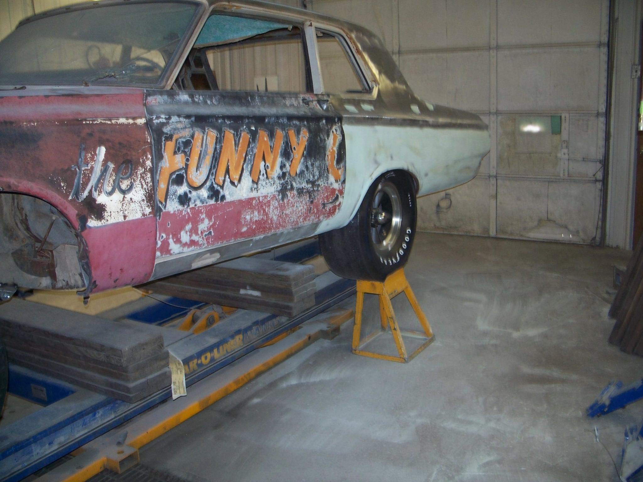

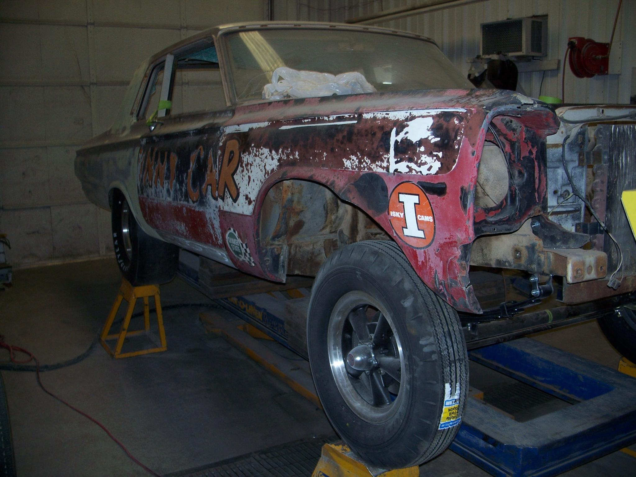

    And stripped the shell so I can start on the body work.Found a little surprize on the right quarter that I will need to weld and make better.

    Fitting the fibergl*** parts and body work,long boring proccess.45 year old gl*** parts don't fit any better then the new stuff.

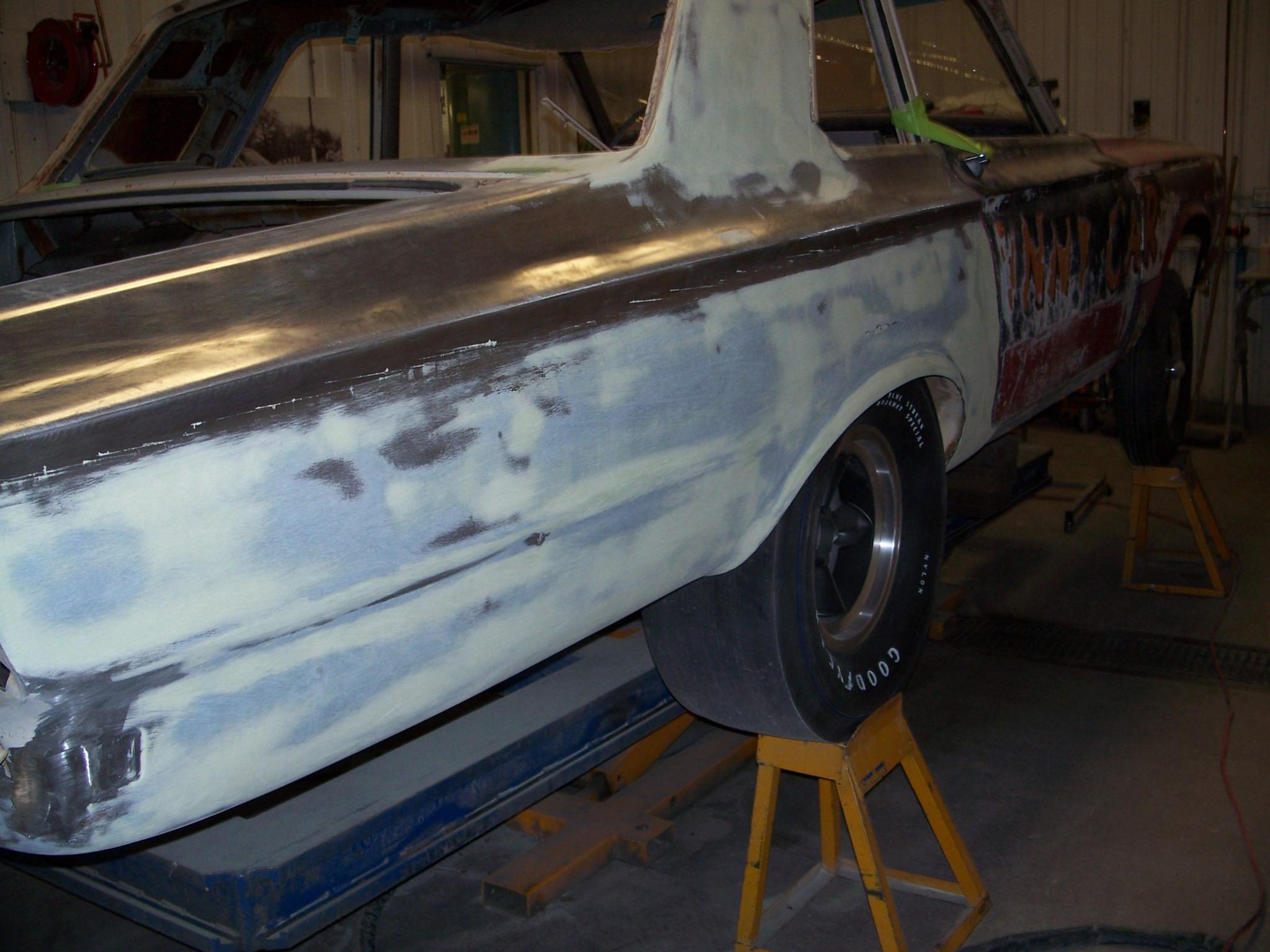

    Getting closer to primer on the shell!About 90% done with the quarters the rest will go faster.

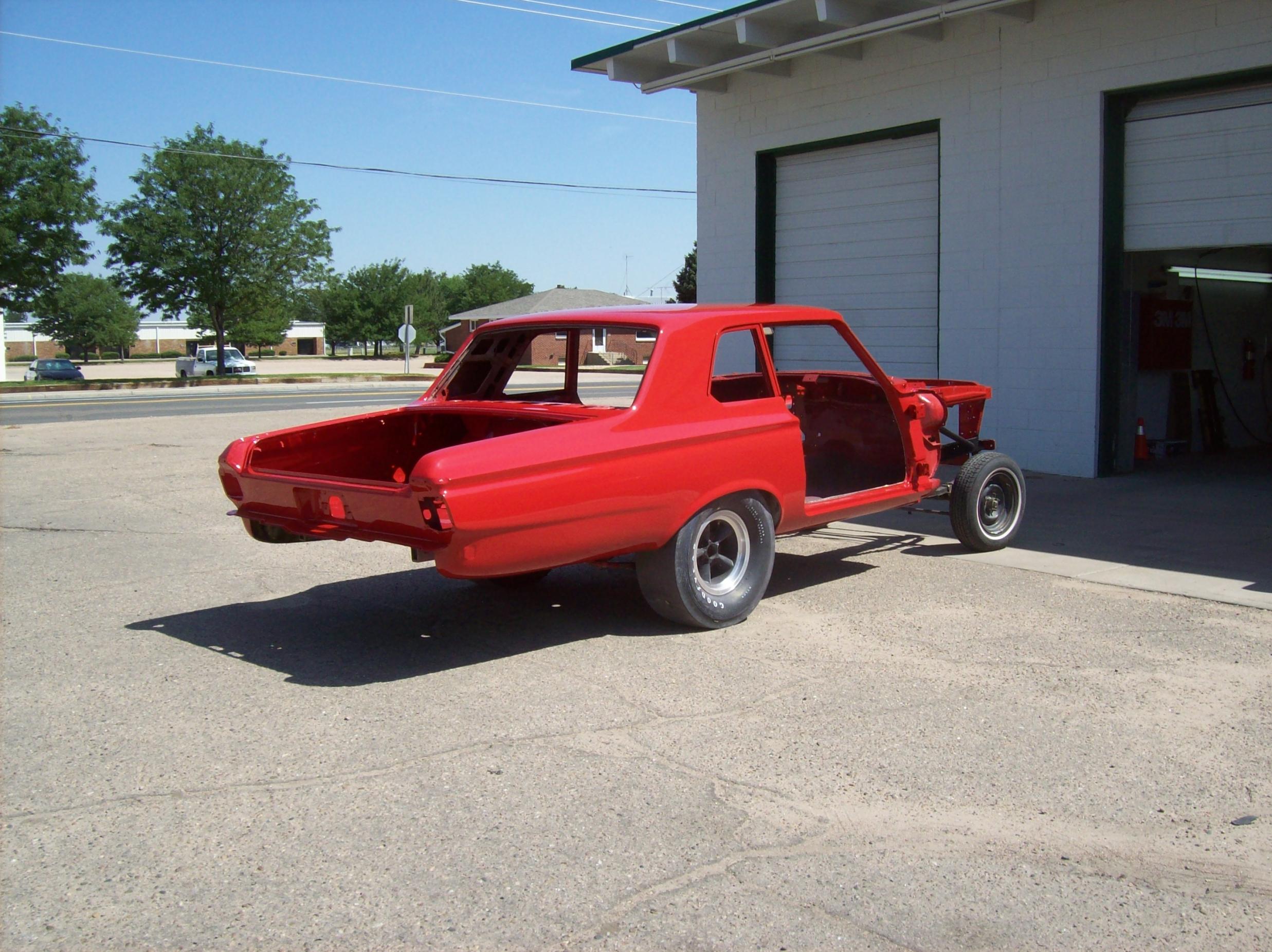

    Finished the bodywork on the shell today.Rolled it out so I could clean the shop.First time outside so I took some pics.

    Primed, and got the floor trimmed.Next up new floors and fixing the fibergl*** panels.

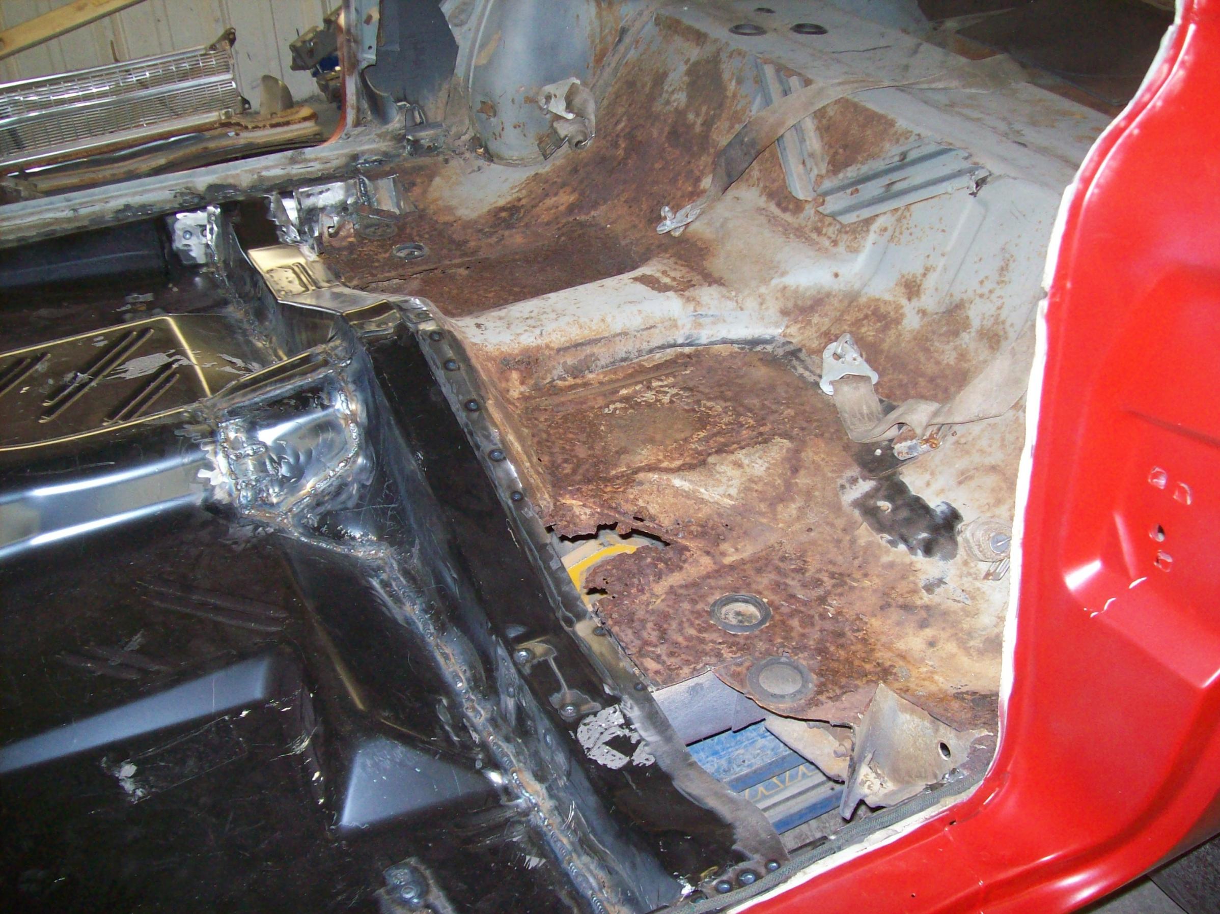

    Front floor pans are in.I'll tackle the areas under were the rear seat would have been this weekend.For some odd reason no one makes replacement panels for this area?I'll have to fab my own.

    Floors are done,finally.

    I took a month off but now I'm back at it.Got the inner fenders cut out like the original car had.Added diagonal braces to beef it back up.Fabbed up some shock brackets and mounted my super *****ing N.O.S Cure Ride 90/10 shocks.welded the front end in solid were it needs to be.Stripped the undercoat from the inner quarters and got it blocked out and in final primer.I plan on getting it to the sand blaster this week so I can get color shot on the interior and engine bay.

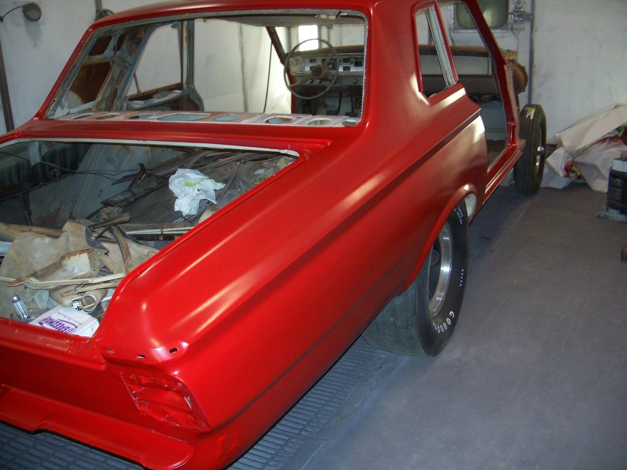

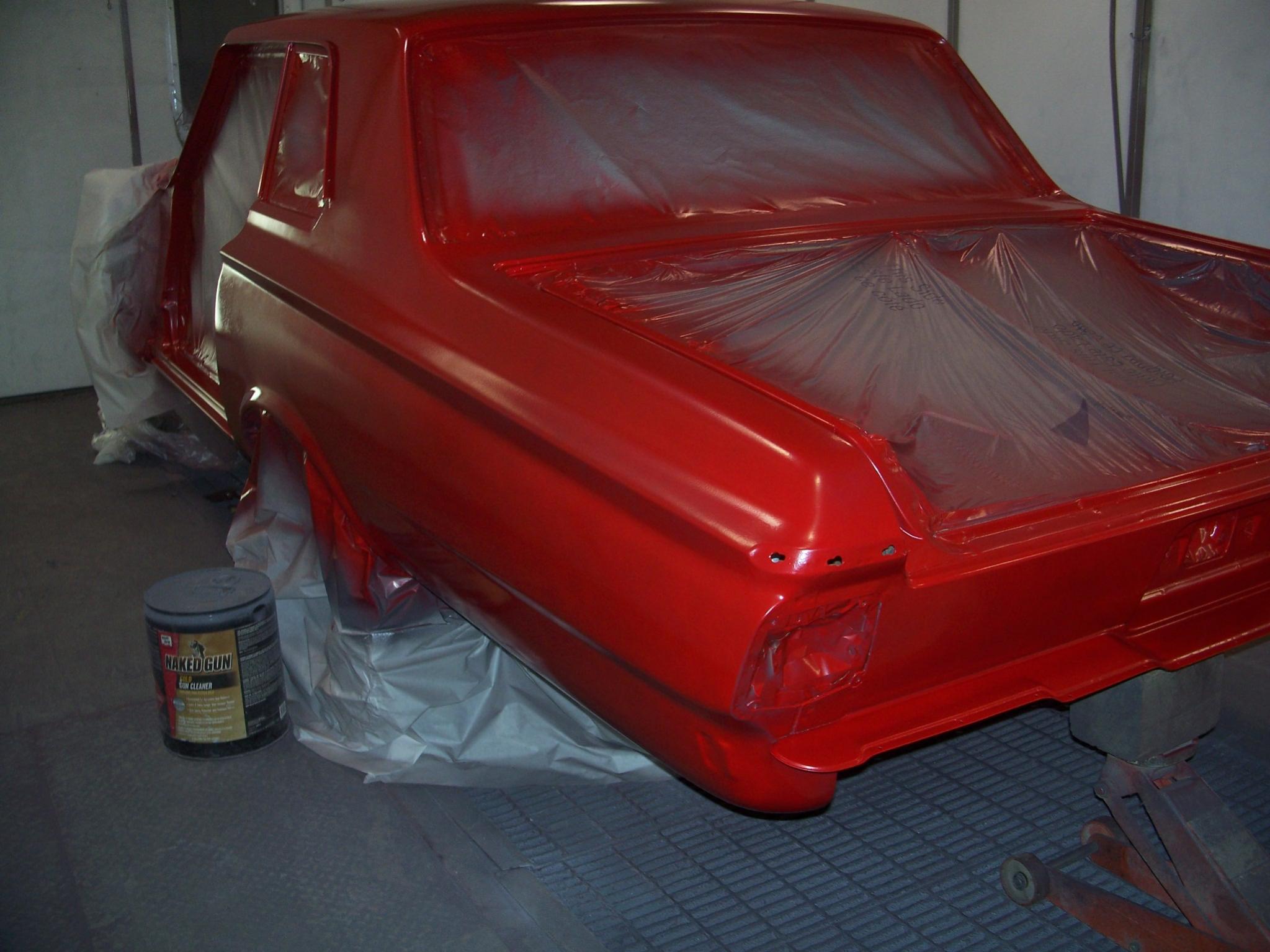

    Got the big chunk painted red today.
  26. FunnyCar65
    Joined: Mar 11, 2007
    Posts: 2,096
    FunnyCar65
    from Colorado
    Now it's red and white.Ready for lettering.
