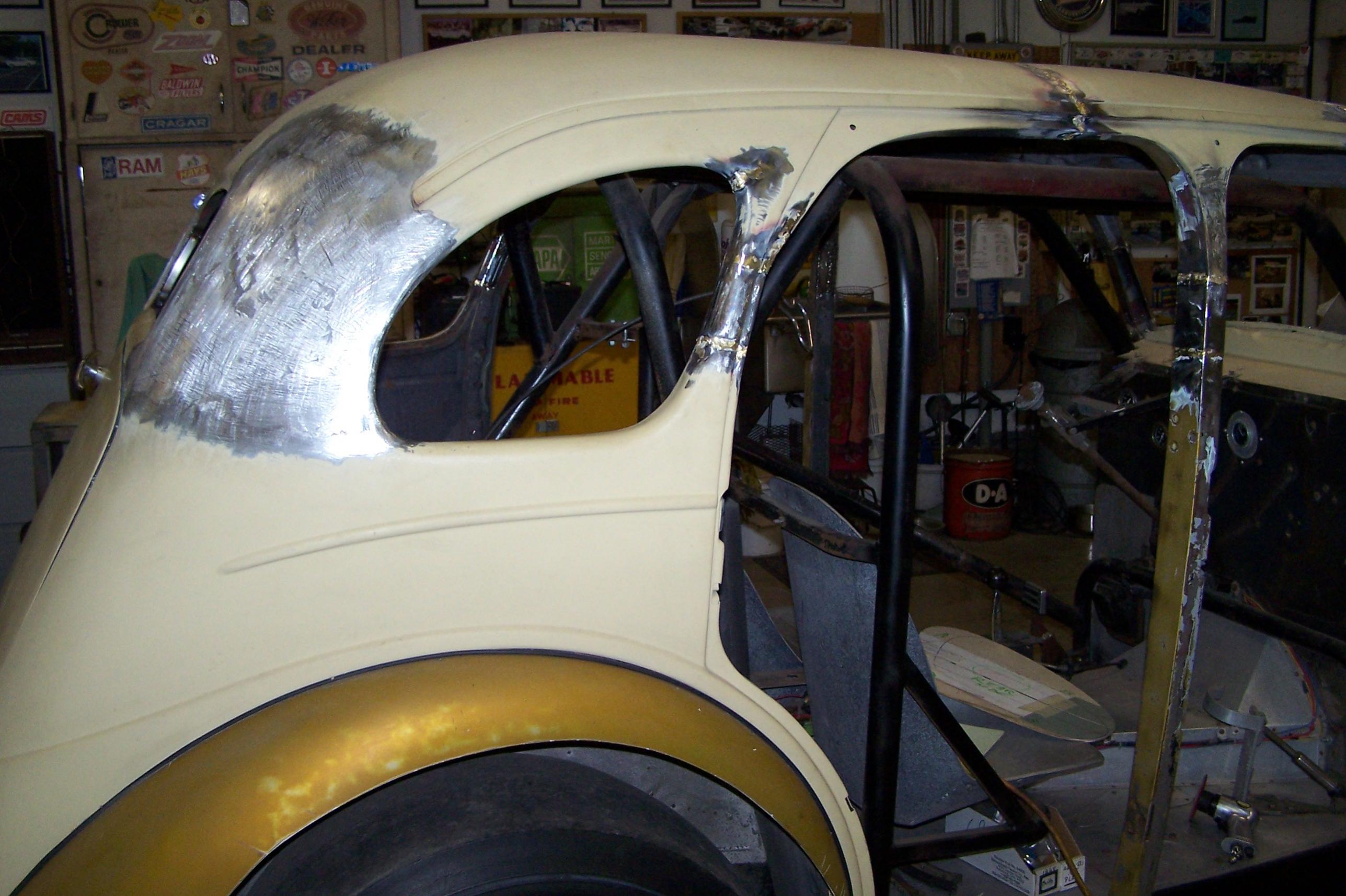

  12. careyohio
    Joined: Jun 6, 2008
    Posts: 410
    careyohio

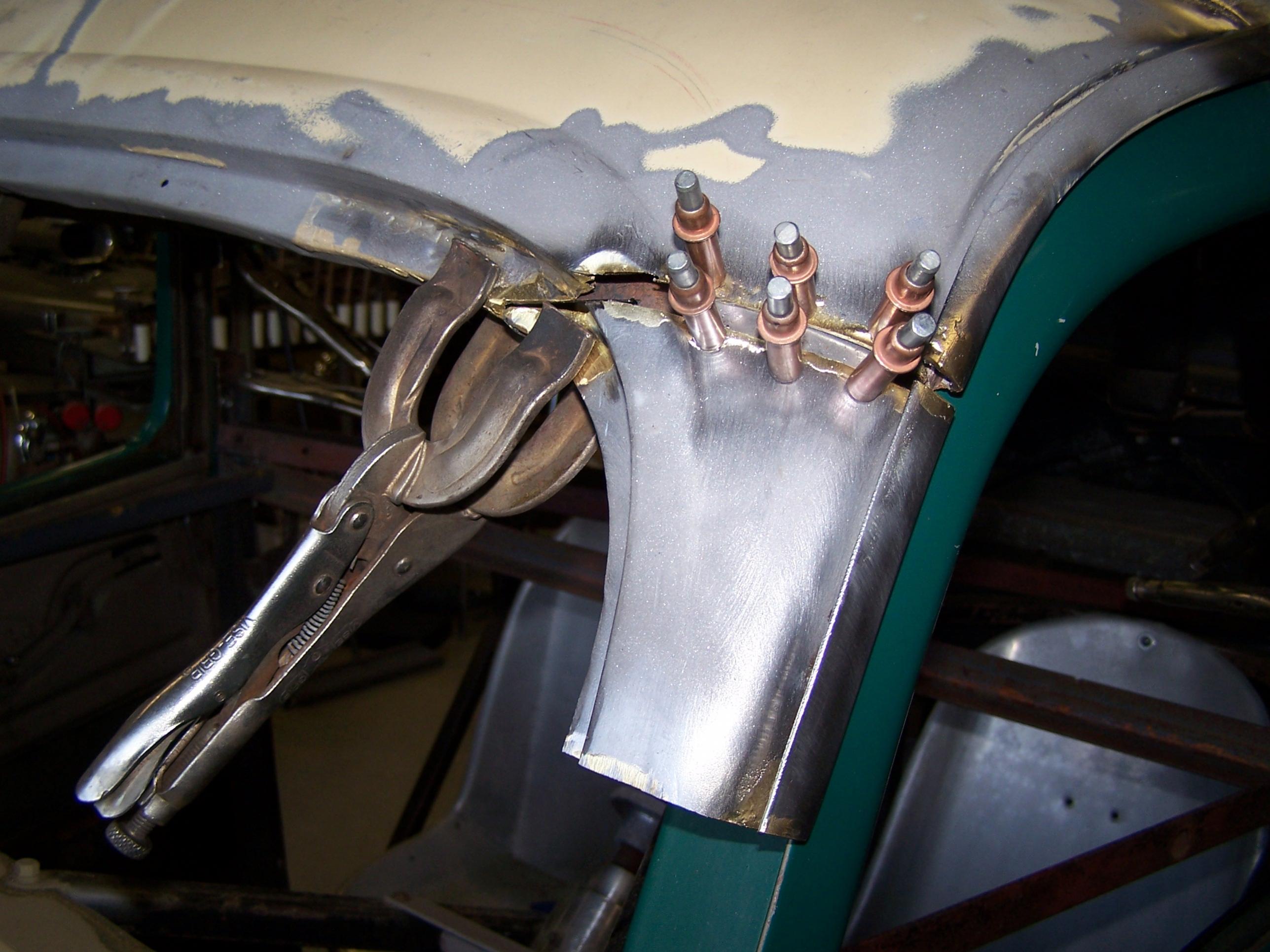

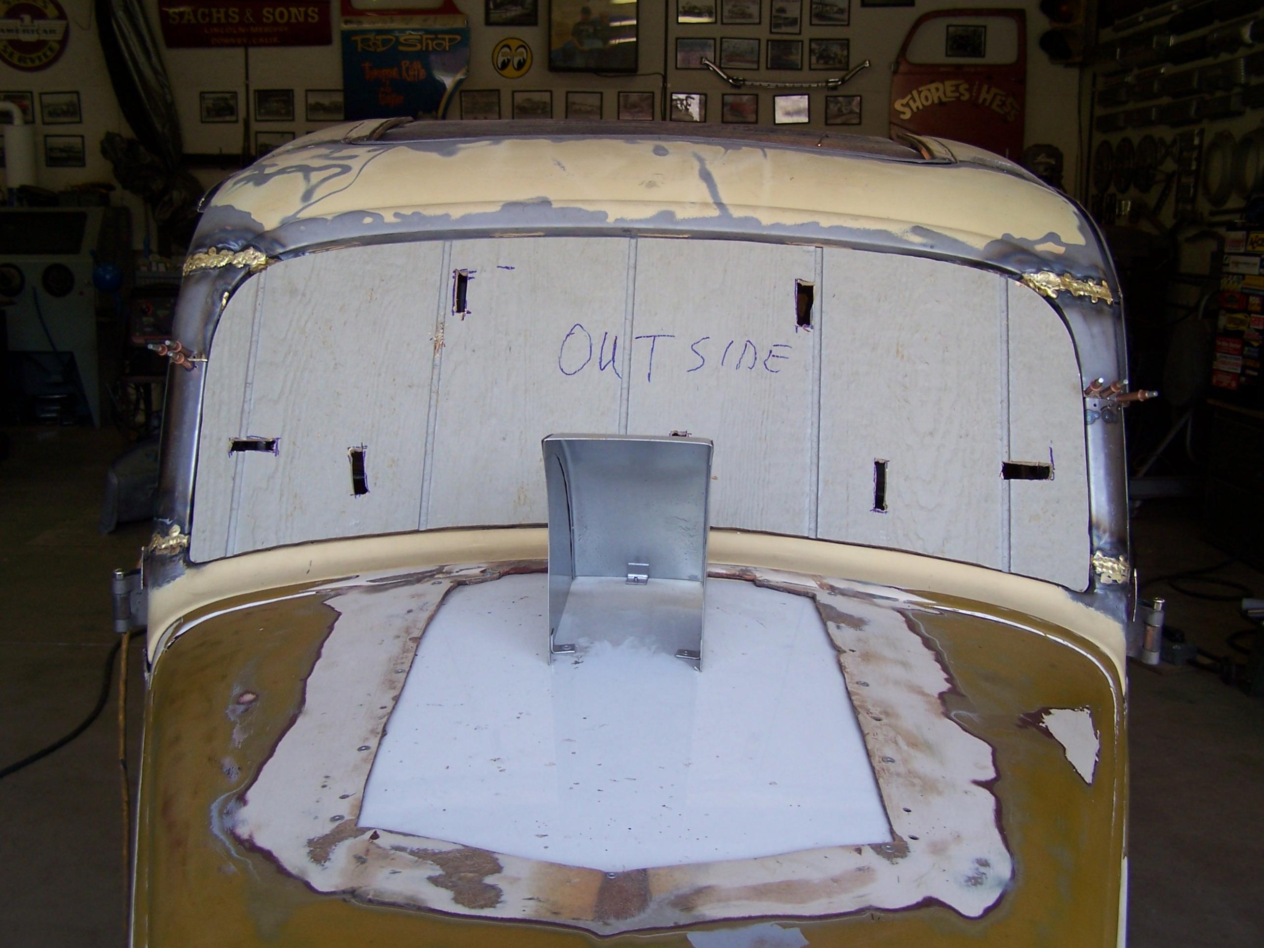

    Leading in the rear chop......

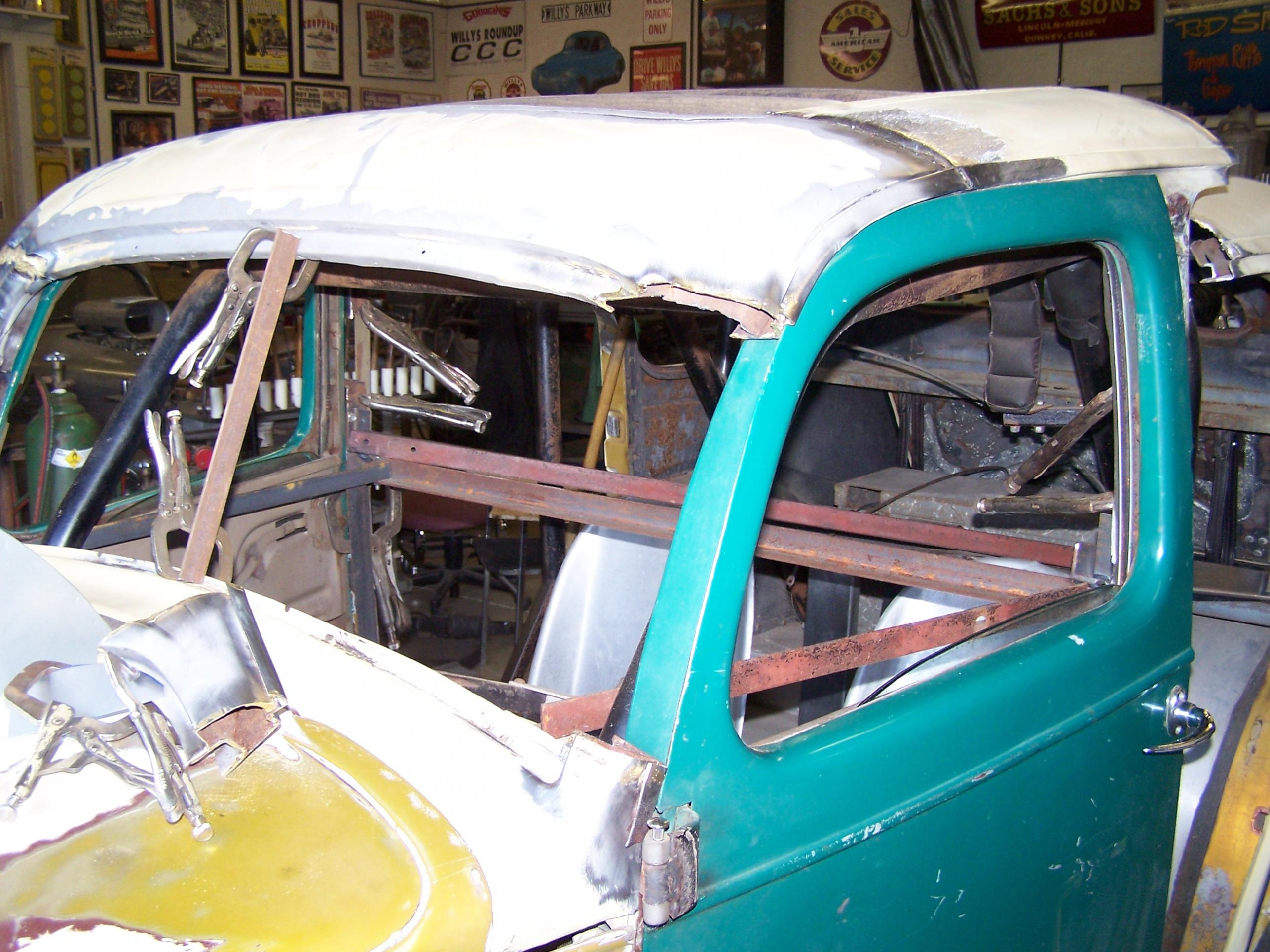

    Leading the rear roof section.....

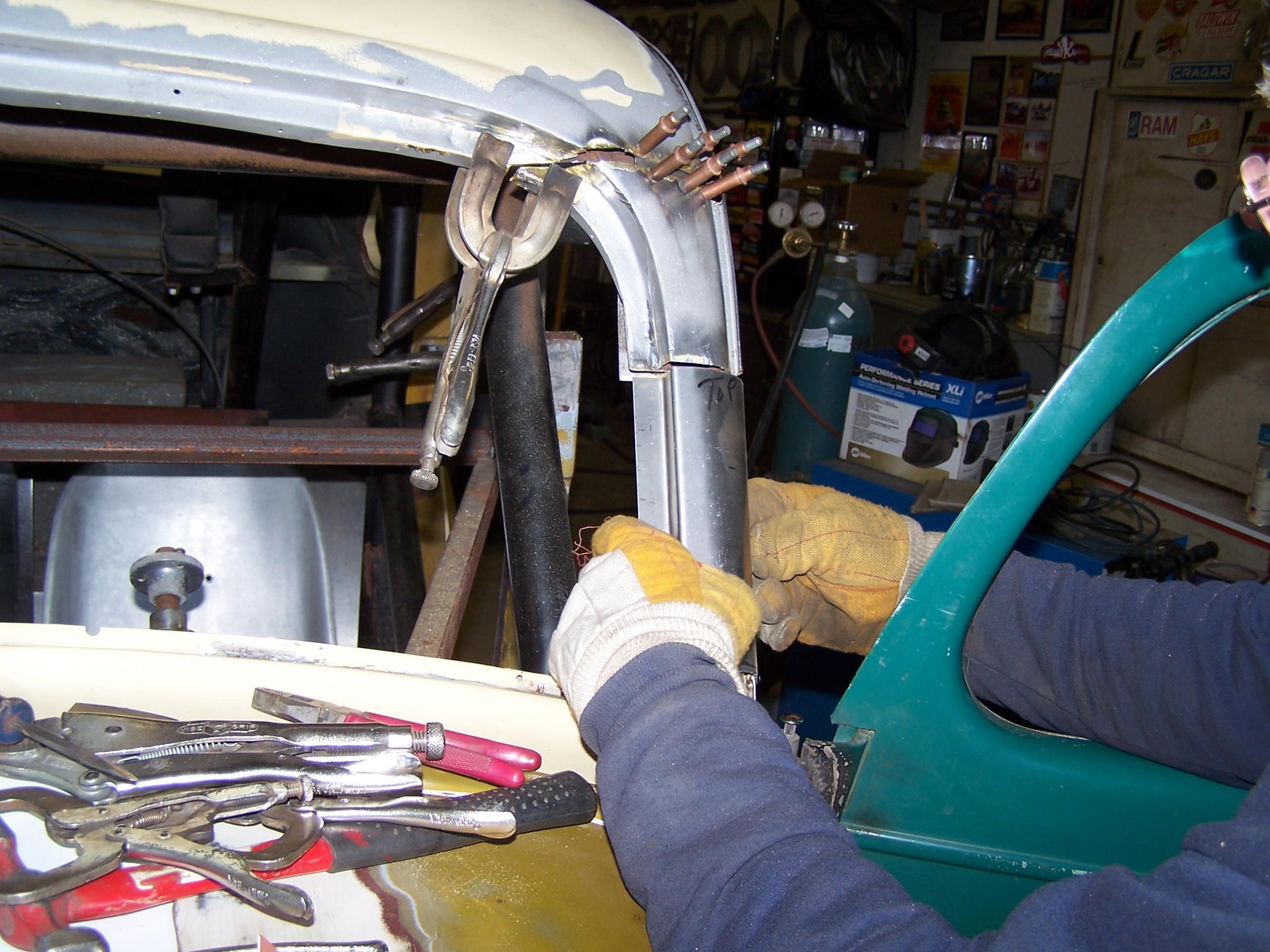

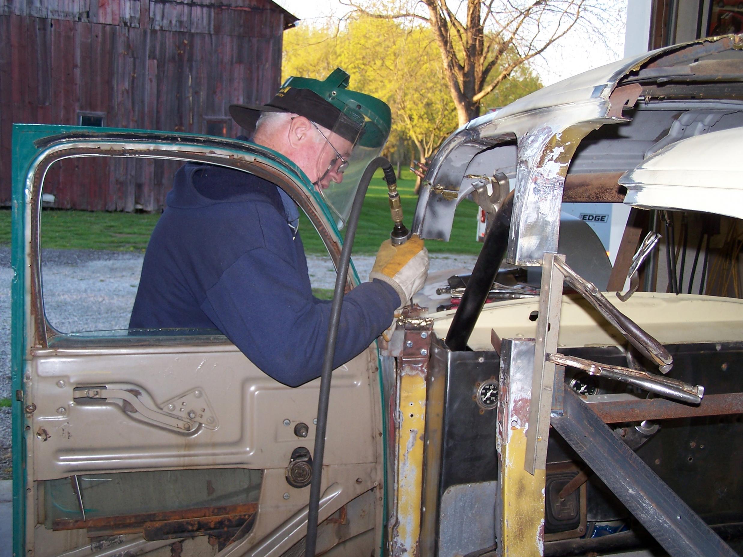

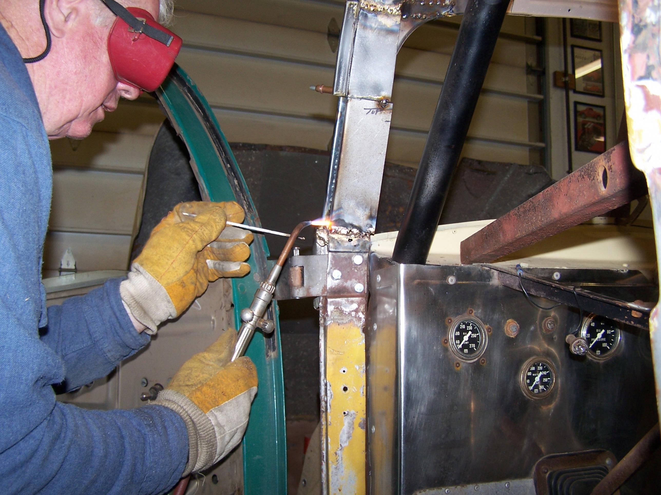

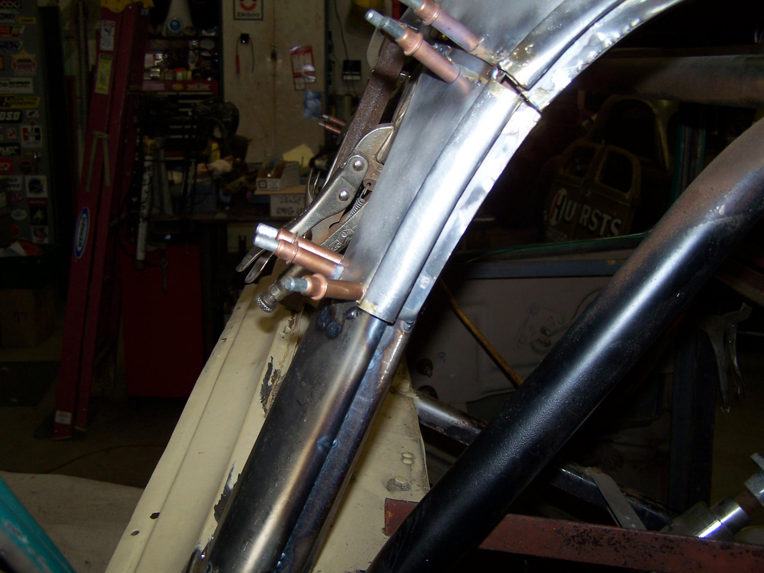

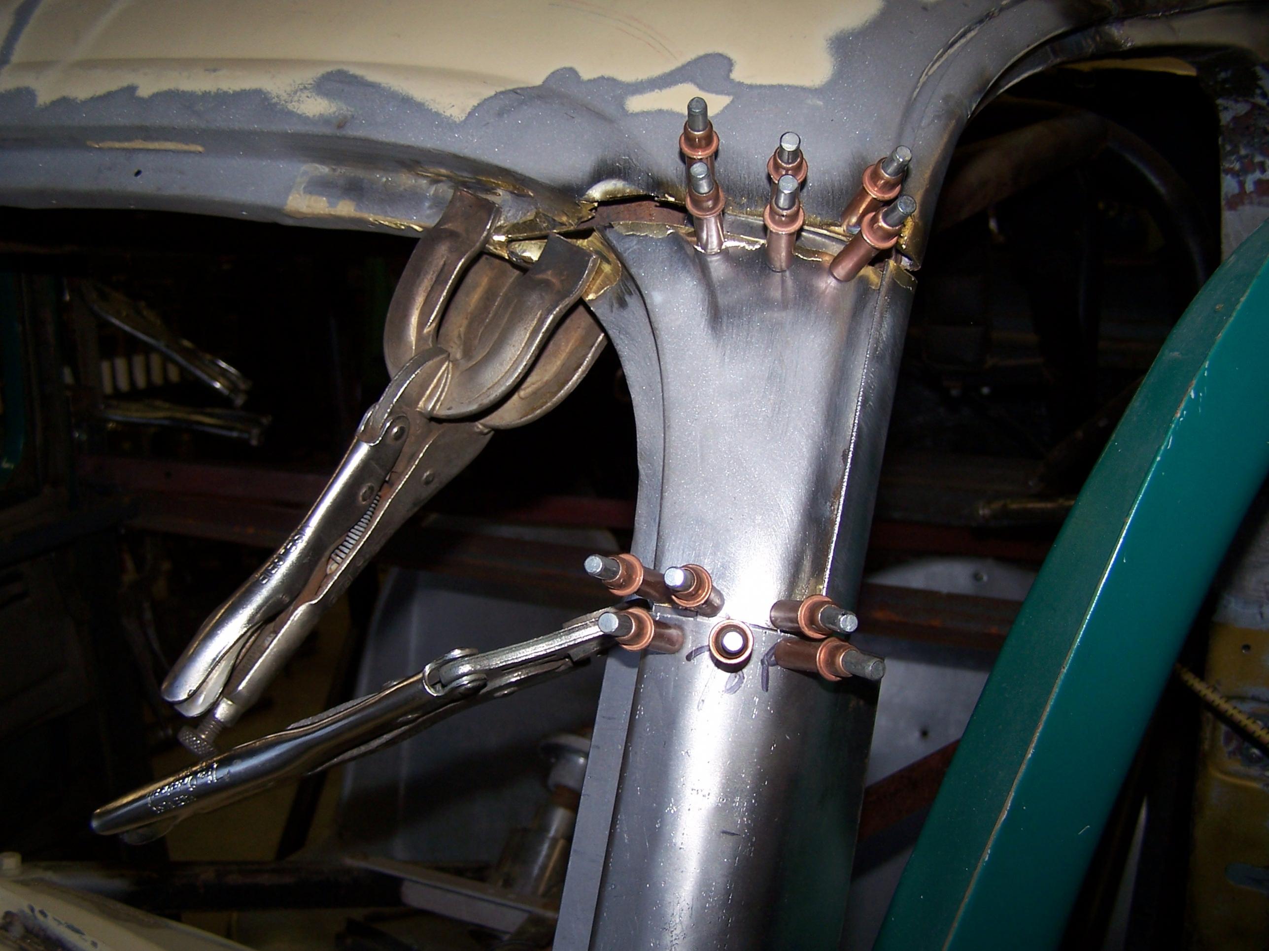

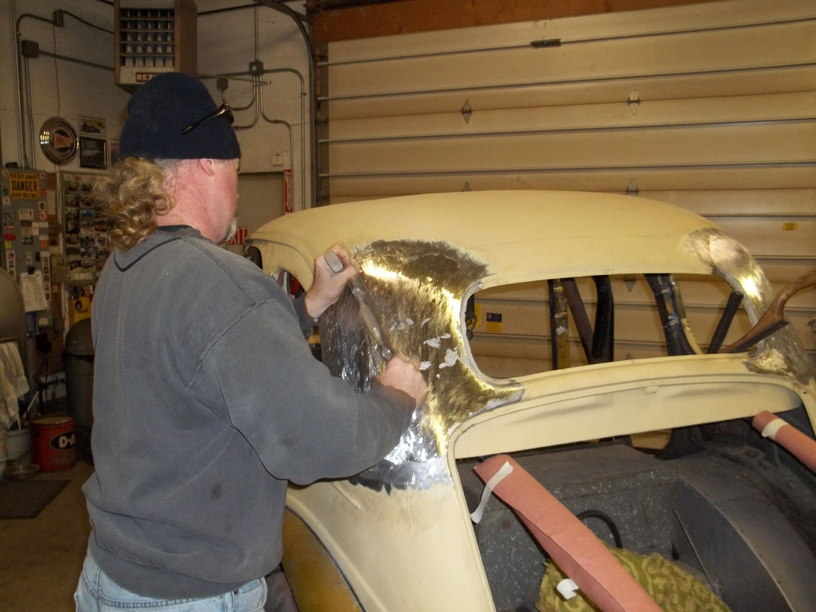

  17. careyohio
    Joined: Jun 6, 2008
    Posts: 410
    careyohio

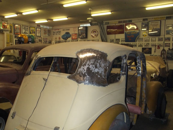

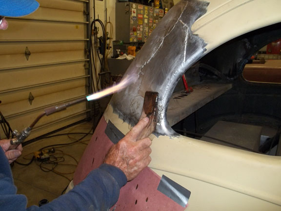

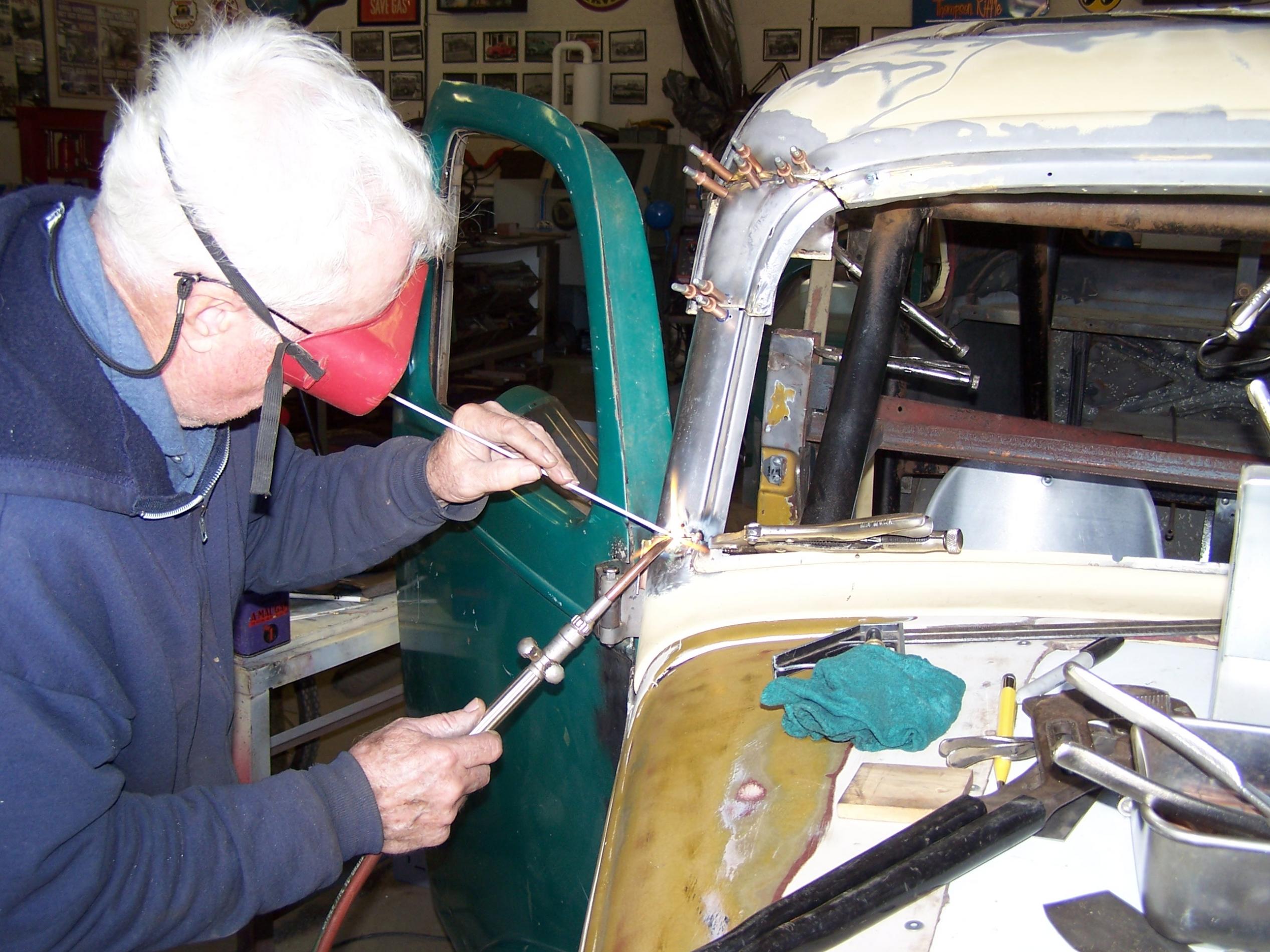

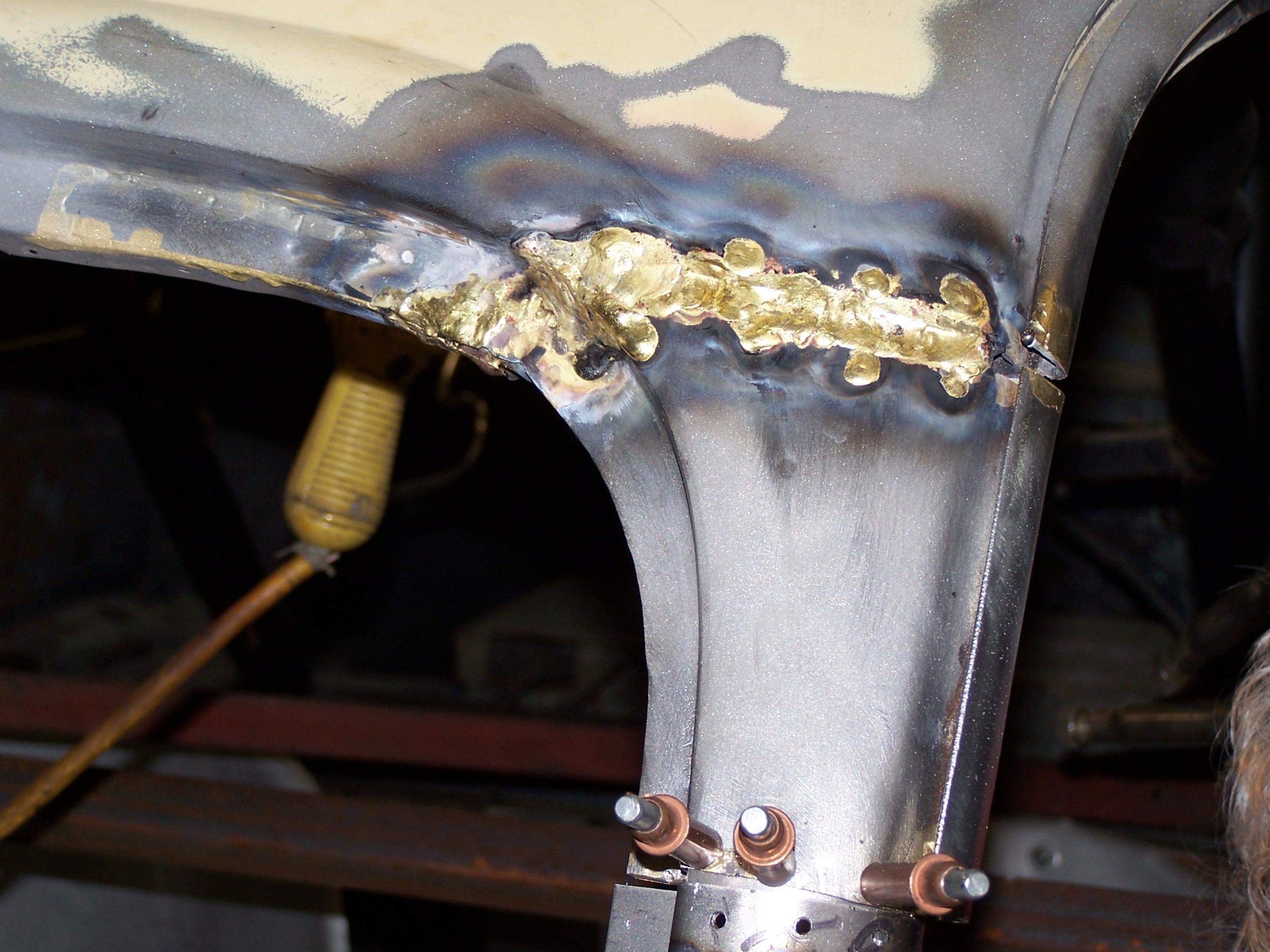

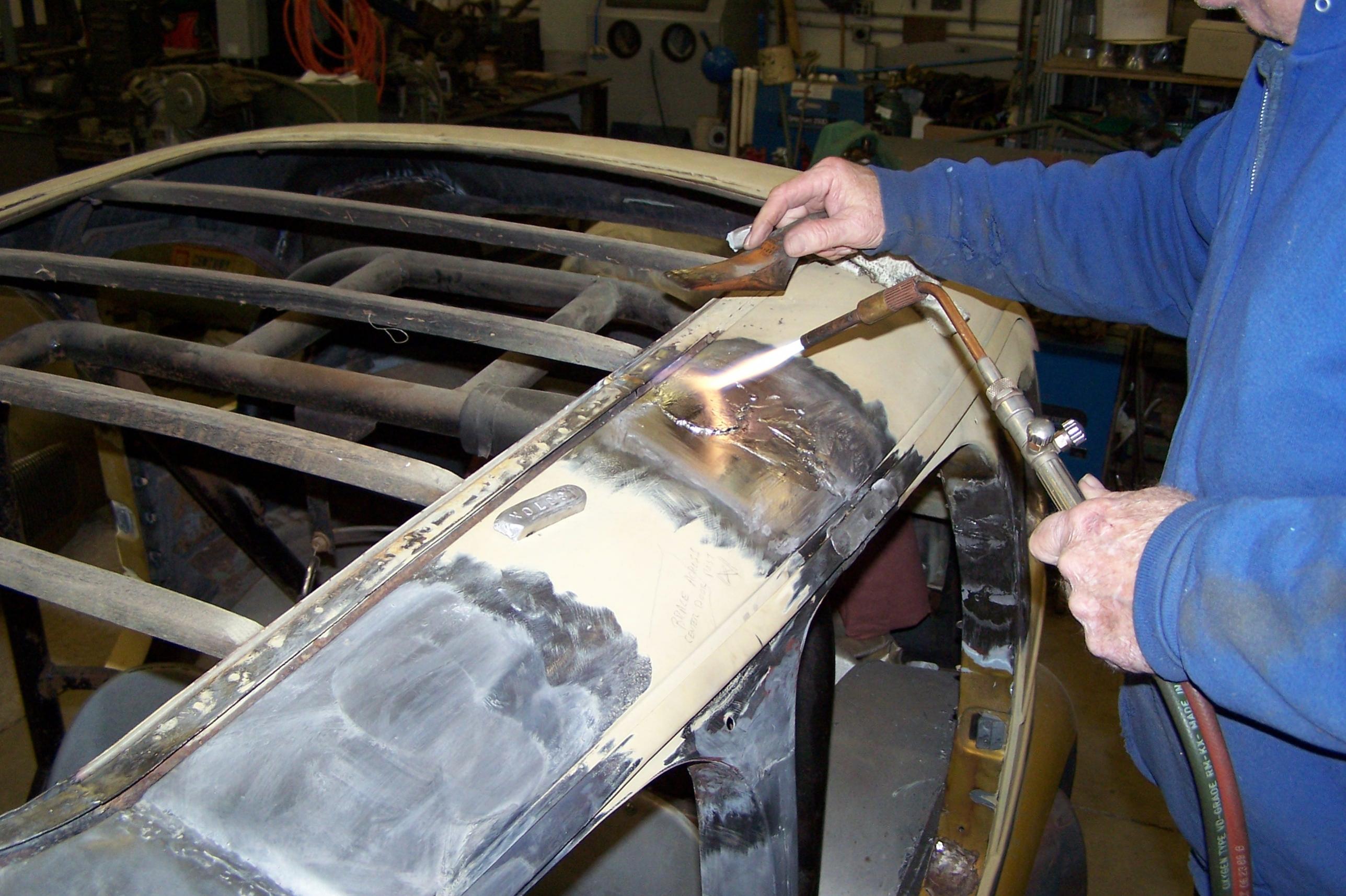

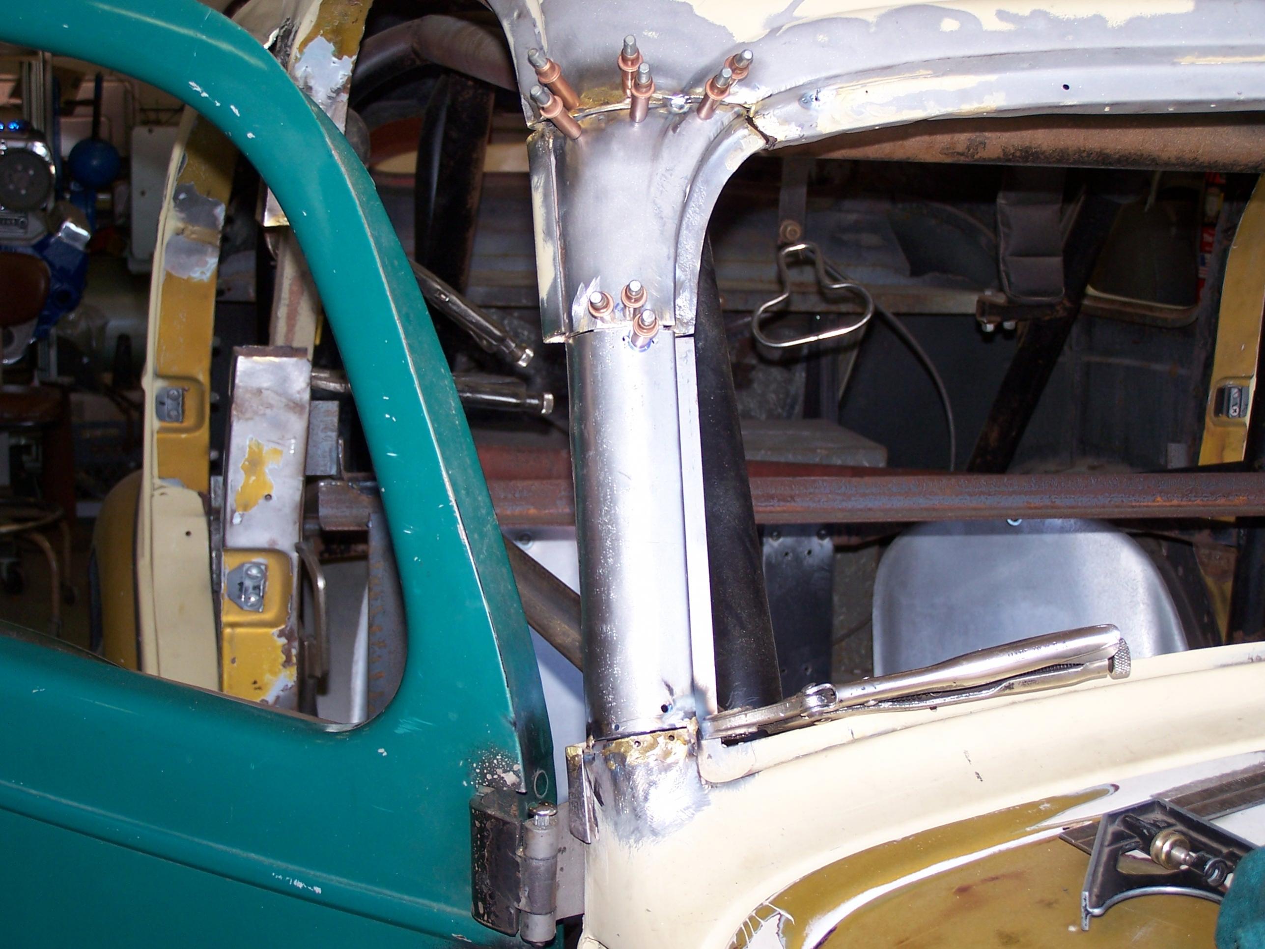

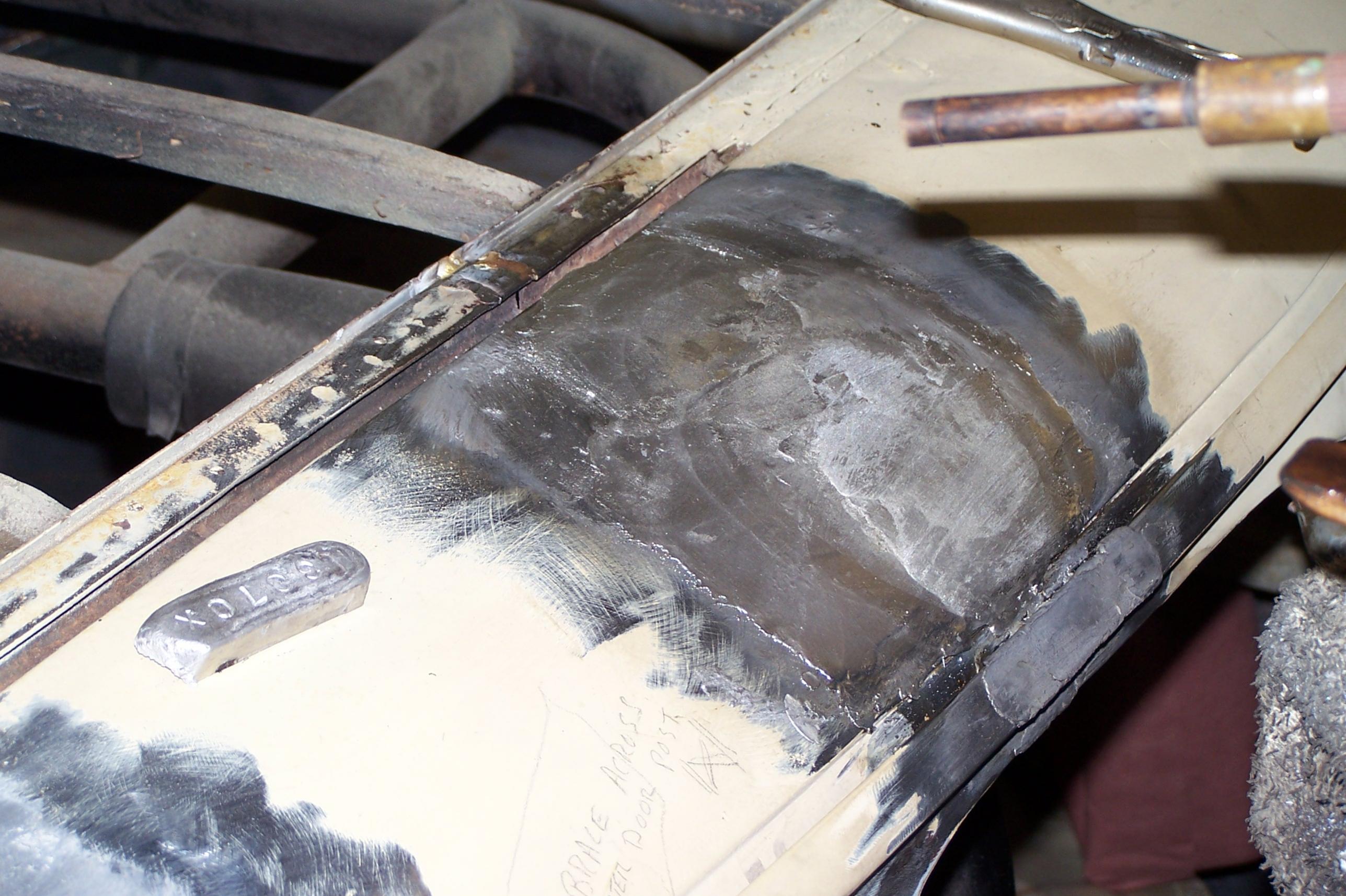

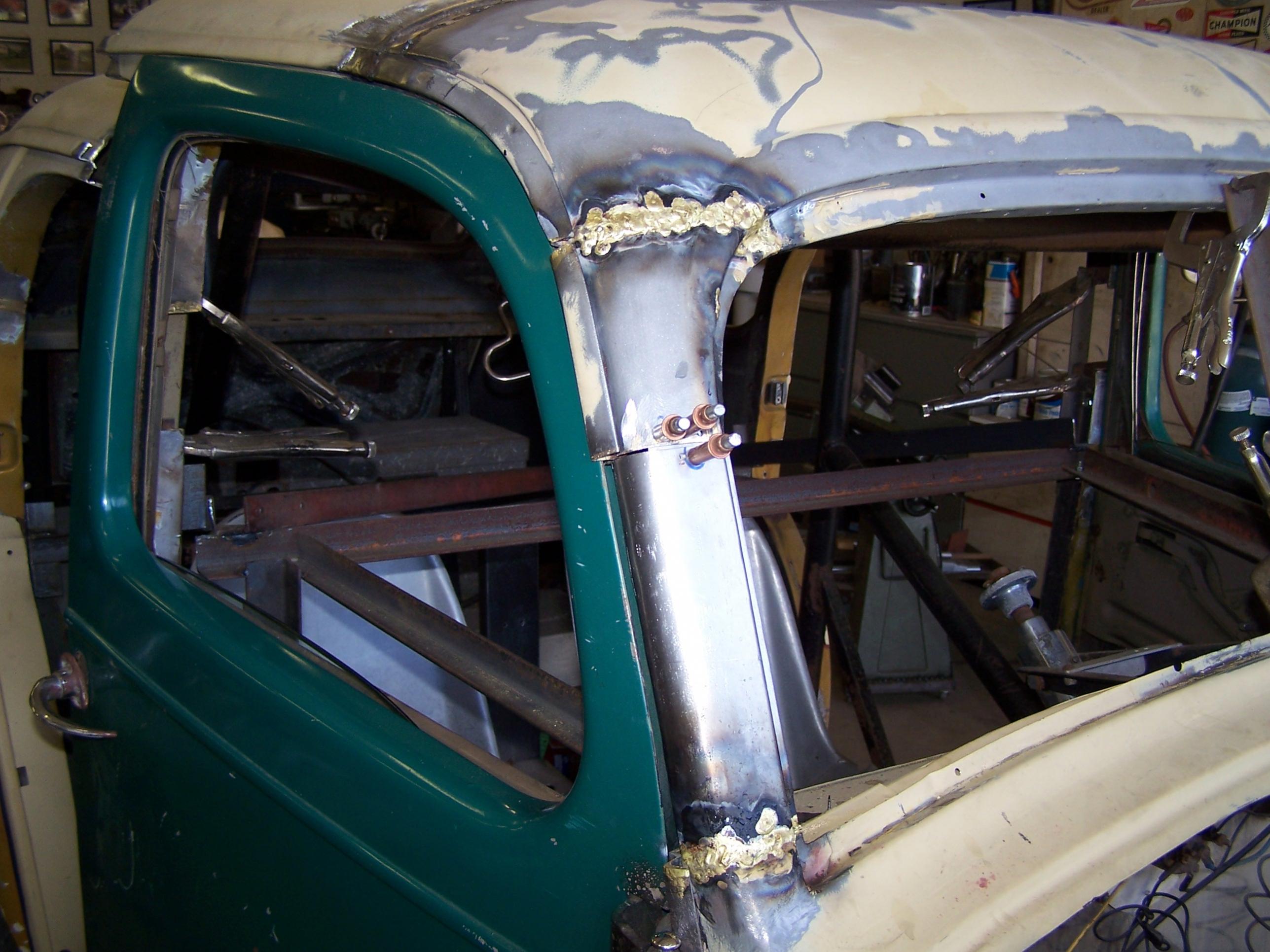

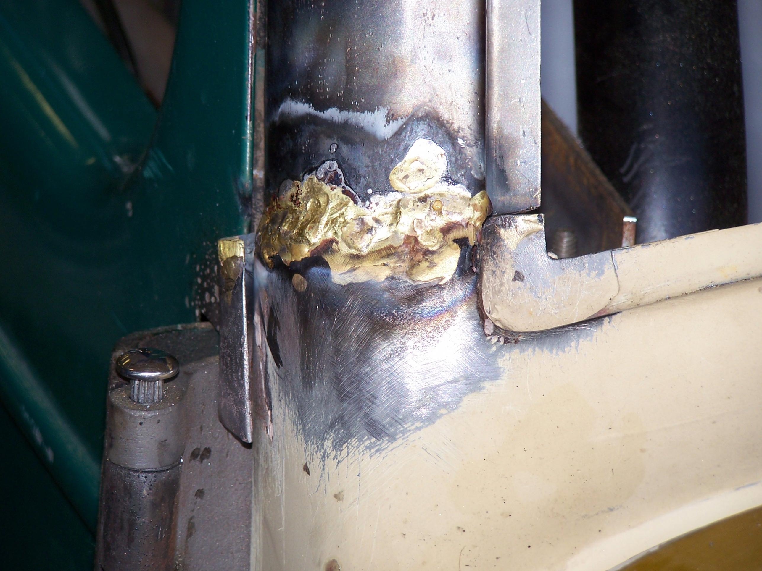

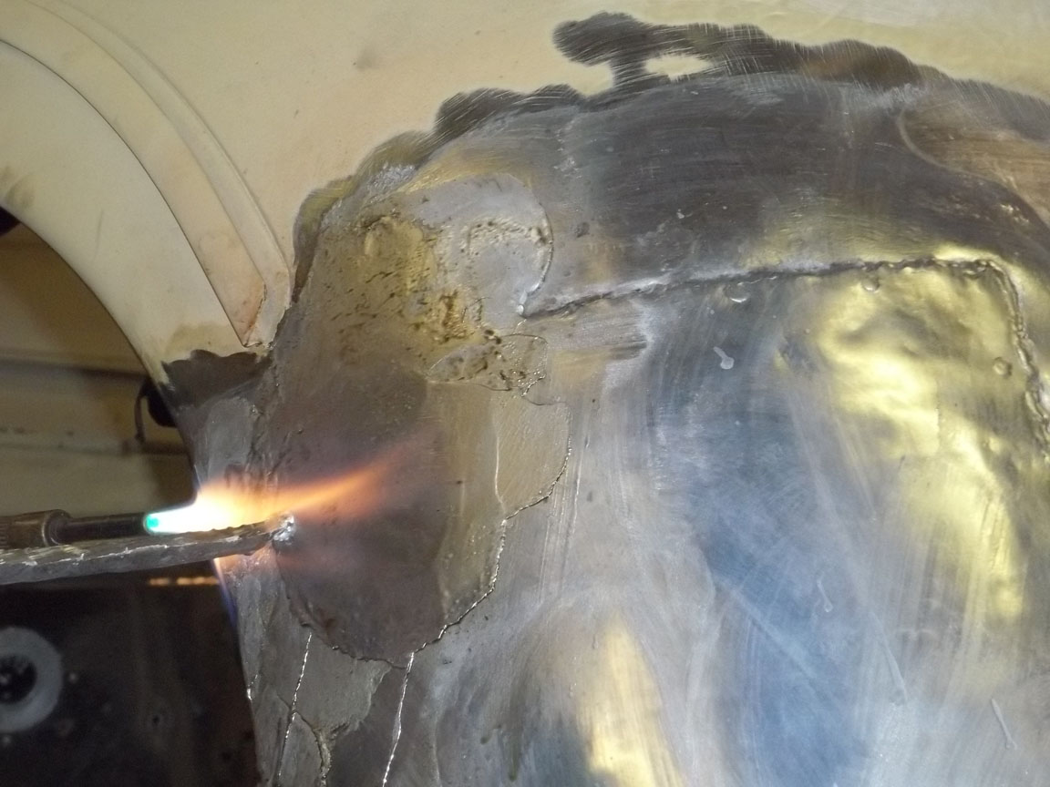

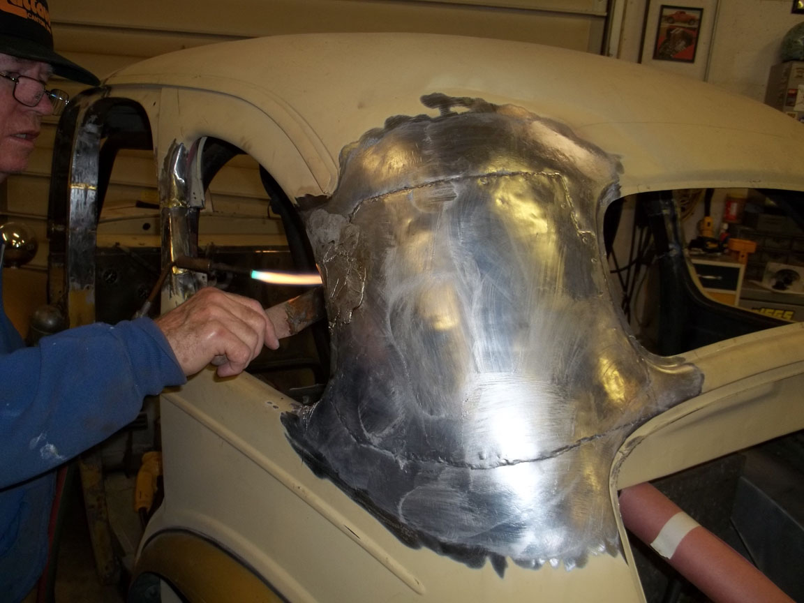

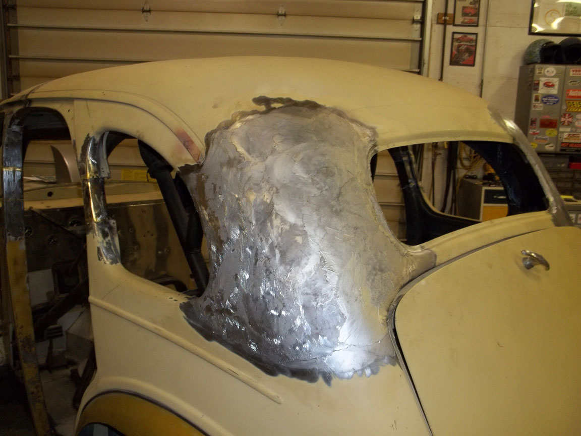

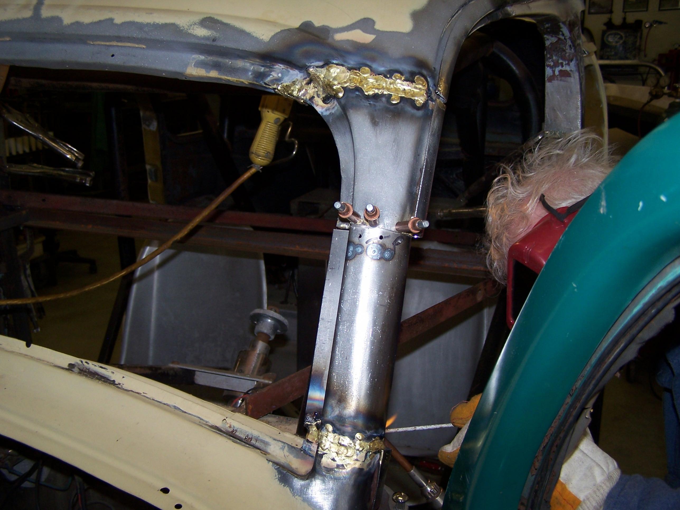

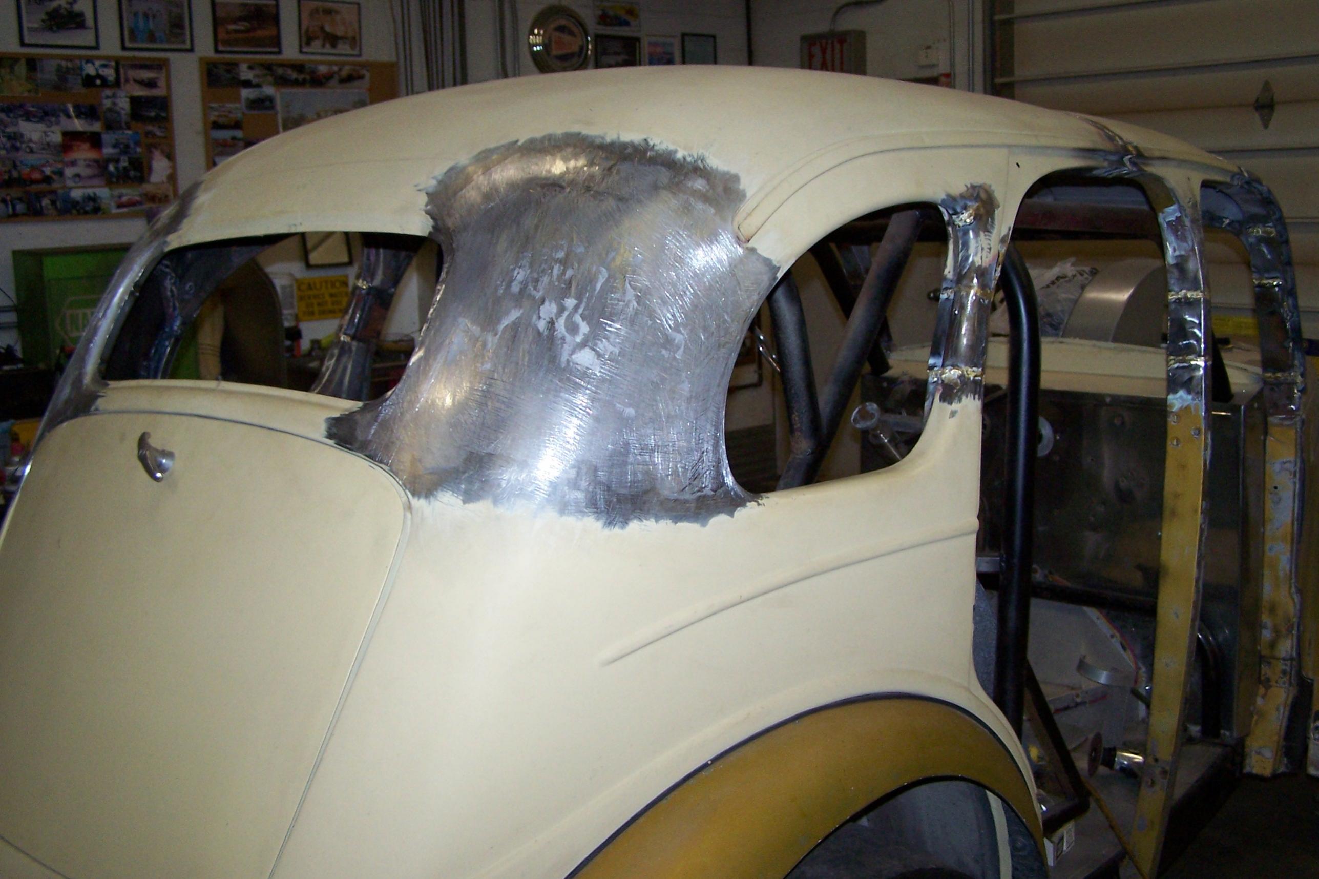

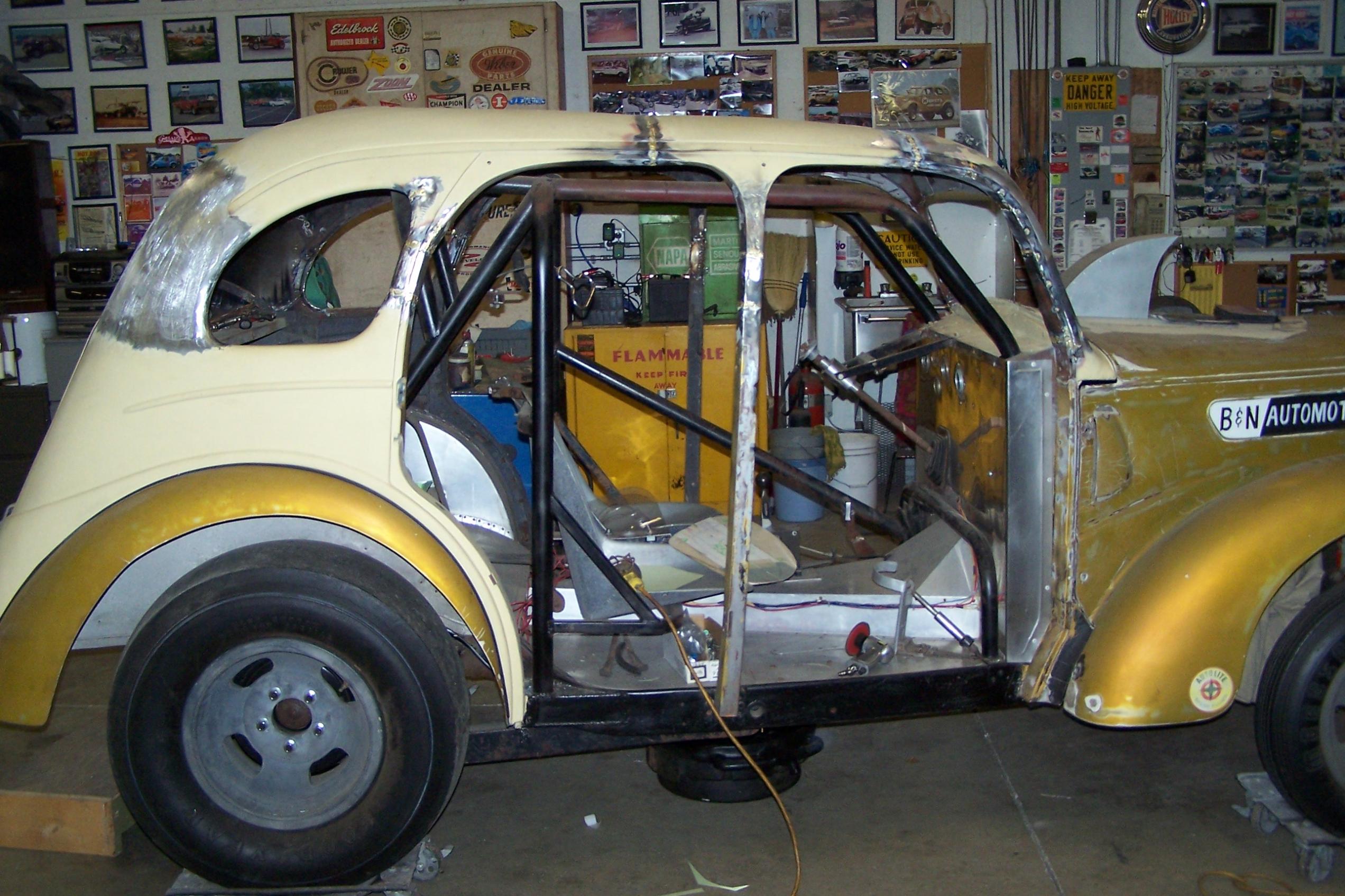

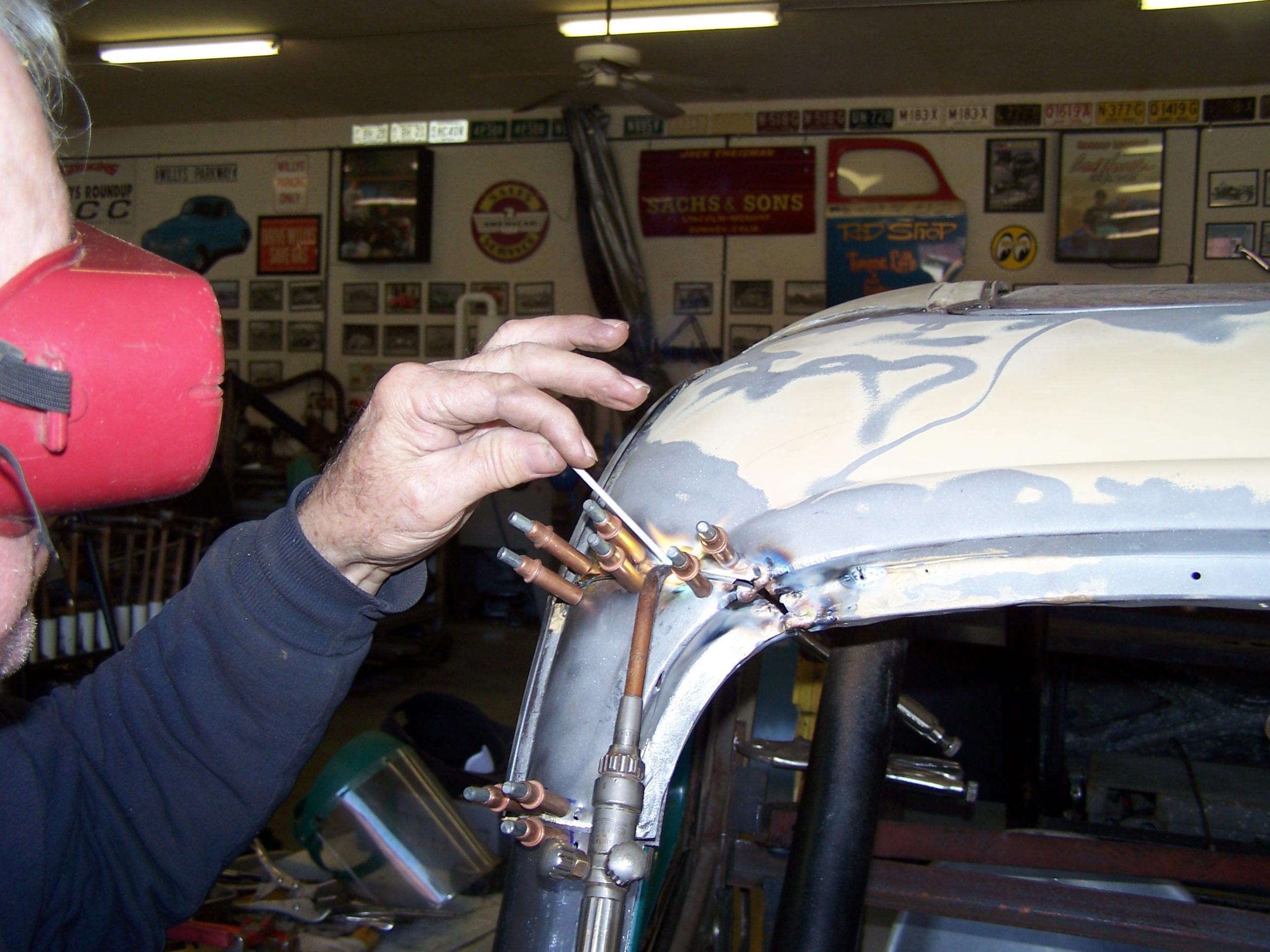

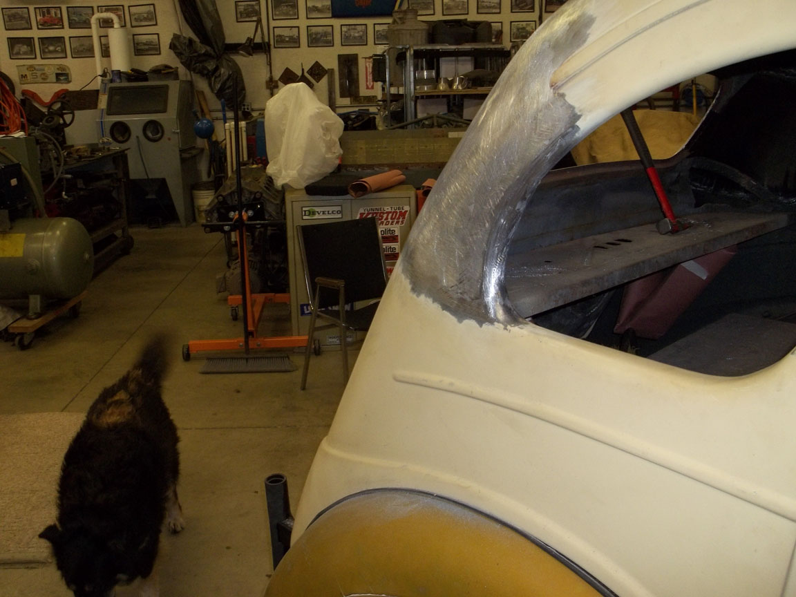

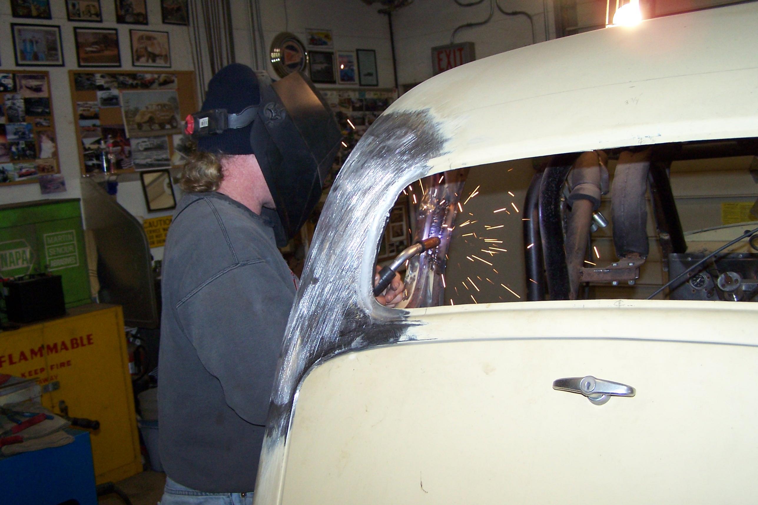

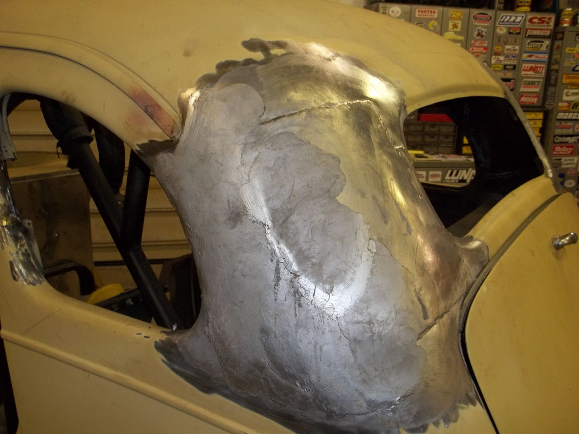

    We got the last of the welding / brazing done today. Next job is to finish lead work and then apply the primer. We'll unchop the fibergl*** doors later.

  23. loudbang
    Posts: 40,346
    Looks much better already. Better watch out some people are saying in another thread that paint will never stick to brazing LOL. We old timers know that is not always true.
  24. careyohio
    Joined: Jun 6, 2008
    Posts: 410
    careyohio
    Thanks.
    Almost all of the brazing I have ever done has been covered with lead or tinned or carefully treated with metal conditioner. I don't recall any problems I have ever had painting over an area that I brazed in the last 50 + years that I have been doing body work.
    Even the paint that was put on over the brazing done to chop the top, to turn the car into the GOLD GETTER, was still holding tight when I blasted it off.
    BUT , you have to get ALL the brazing flux off before painting. I use a wet rag while the metal is still hot to pop it off. Then a wire brush on a drill to get into the low spots.

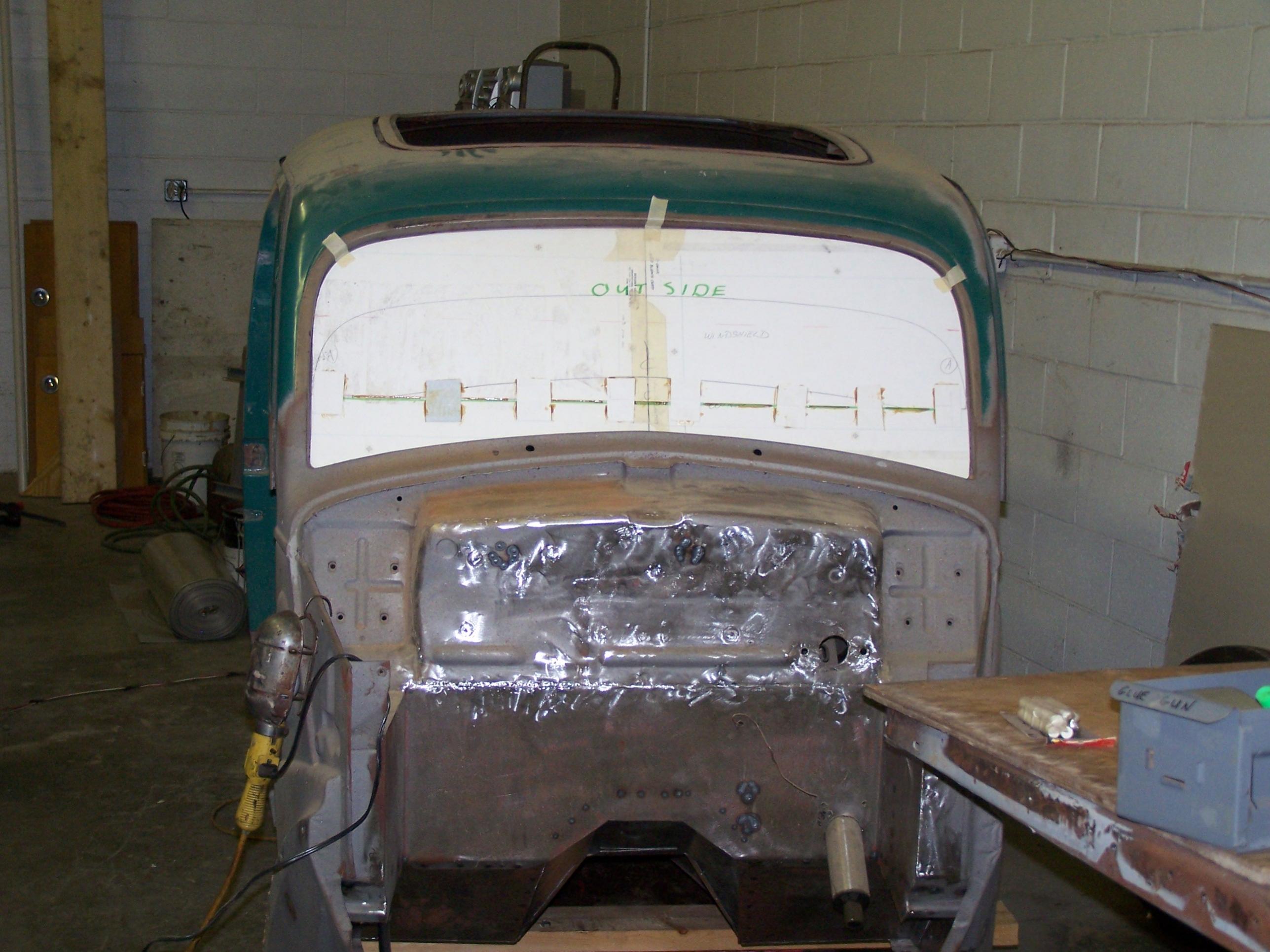

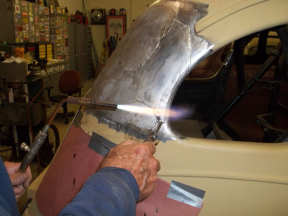

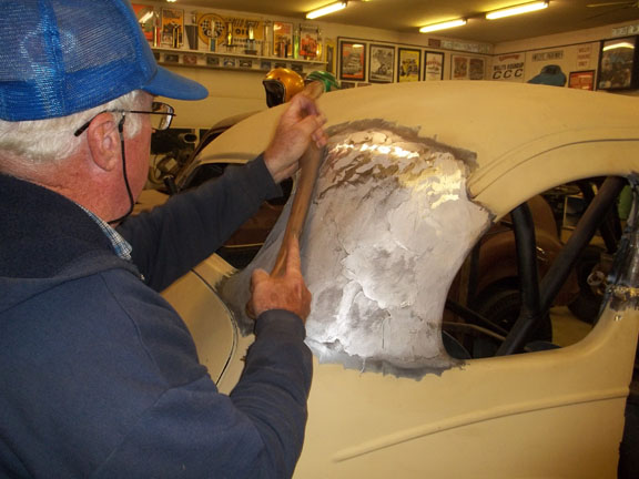

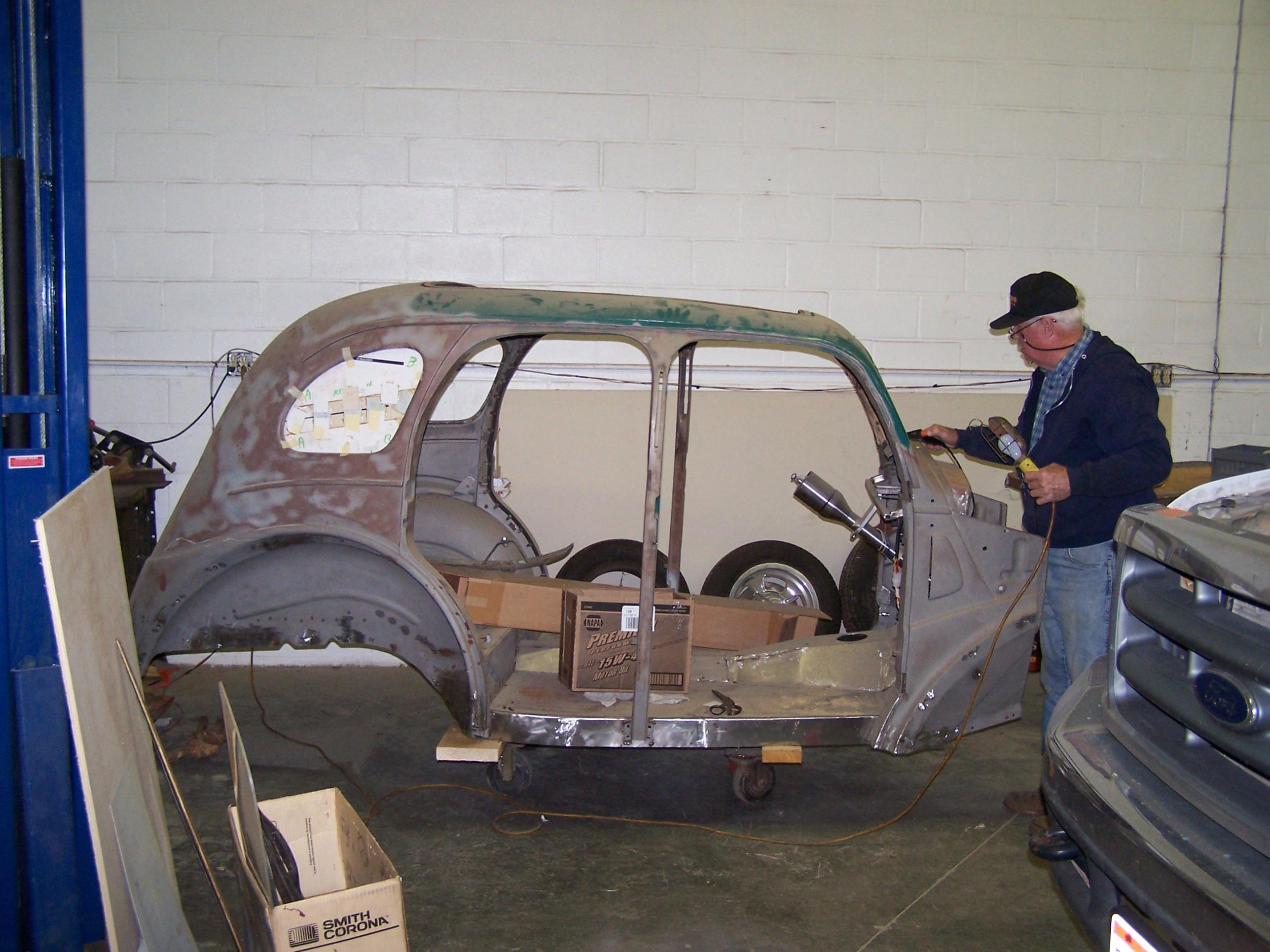

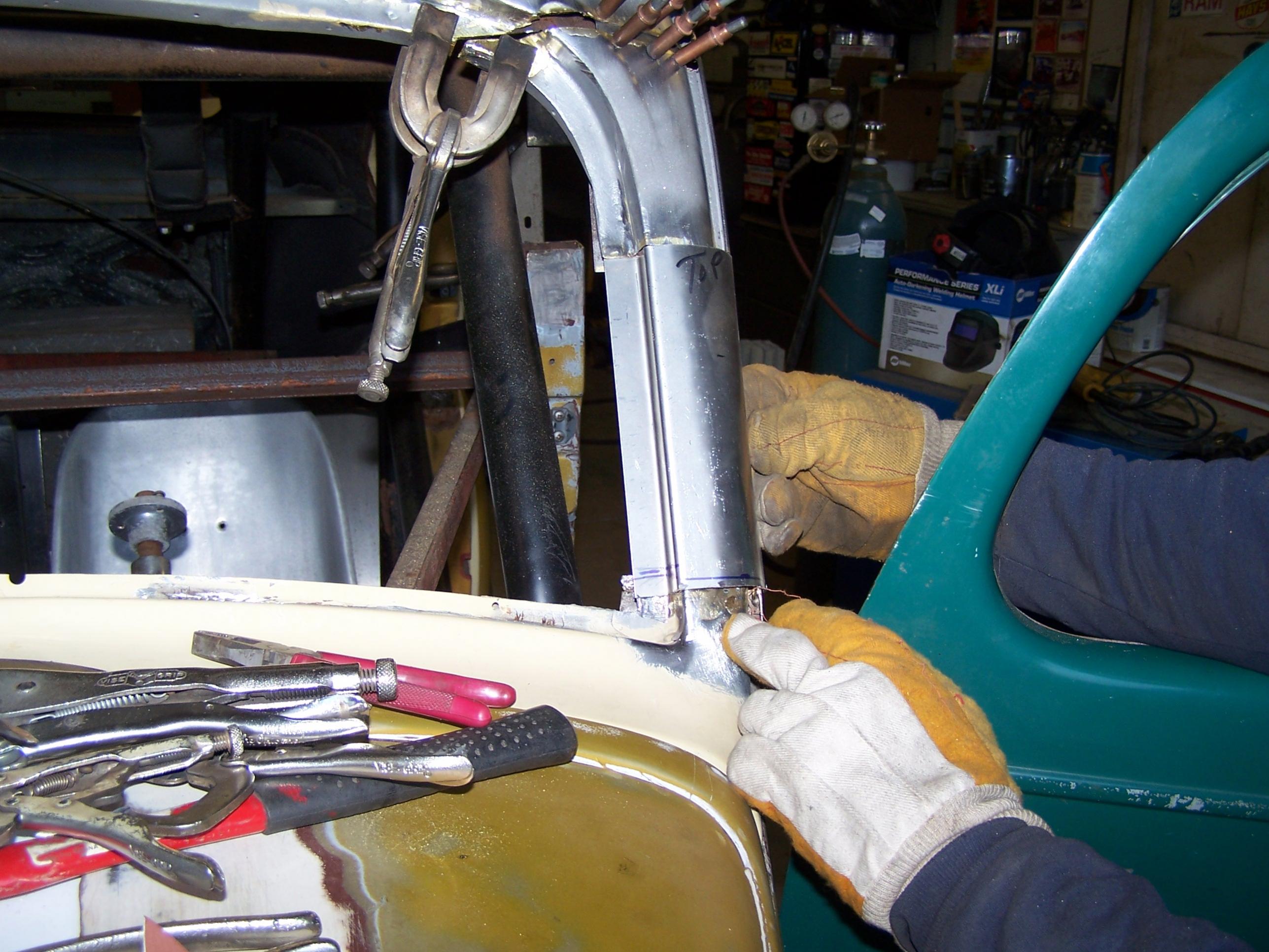

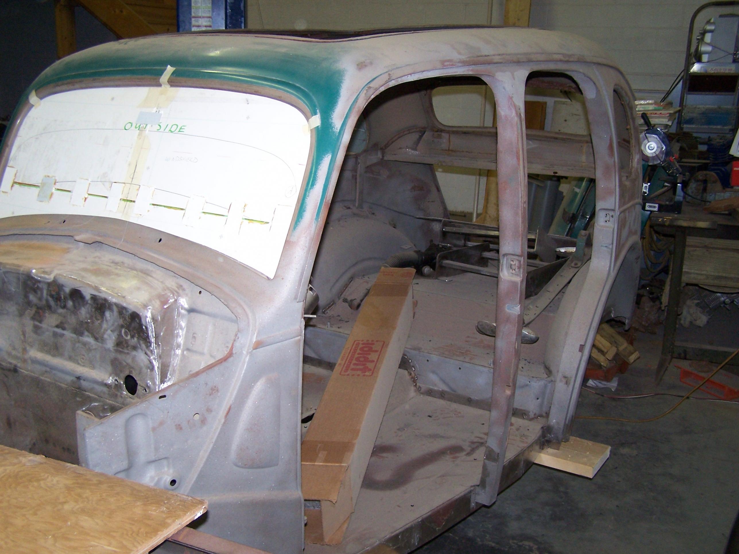

    I'm going to back up for awhile as I found some photos, on another camera card, from the early start of this project.
    The following photos are from Jim Nell's Prefect when we made the window patterns . First we made patterns from Robs car, then cut them in half. Then made tabs that we hot glued to the top and bottom half after fitting them into the full size openings.
