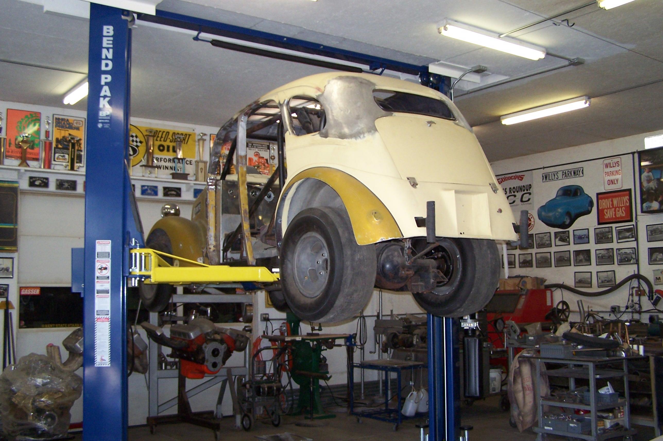

    Tested the lift with the G***er P***er........I don't think the lift even felt the weight...

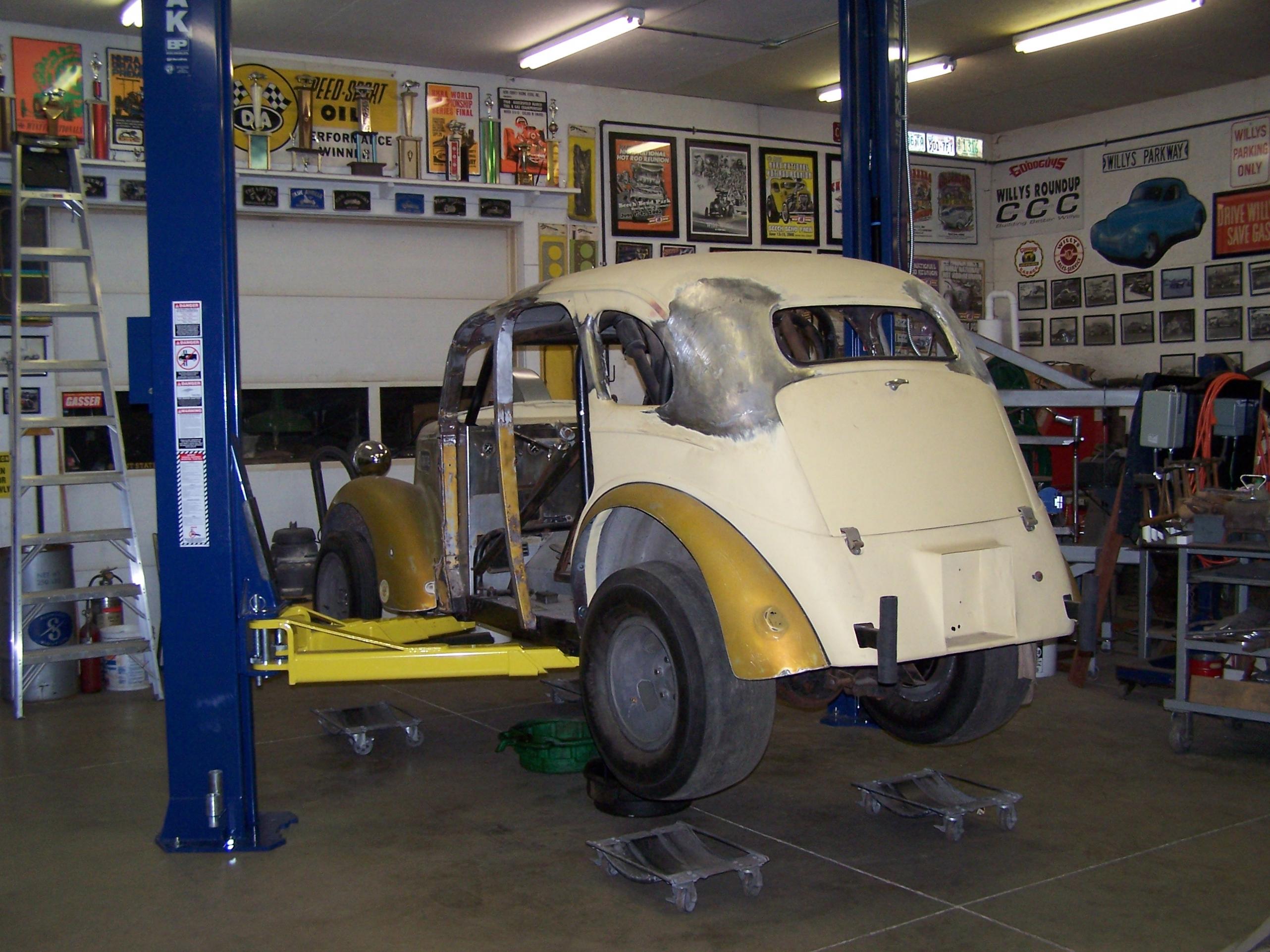

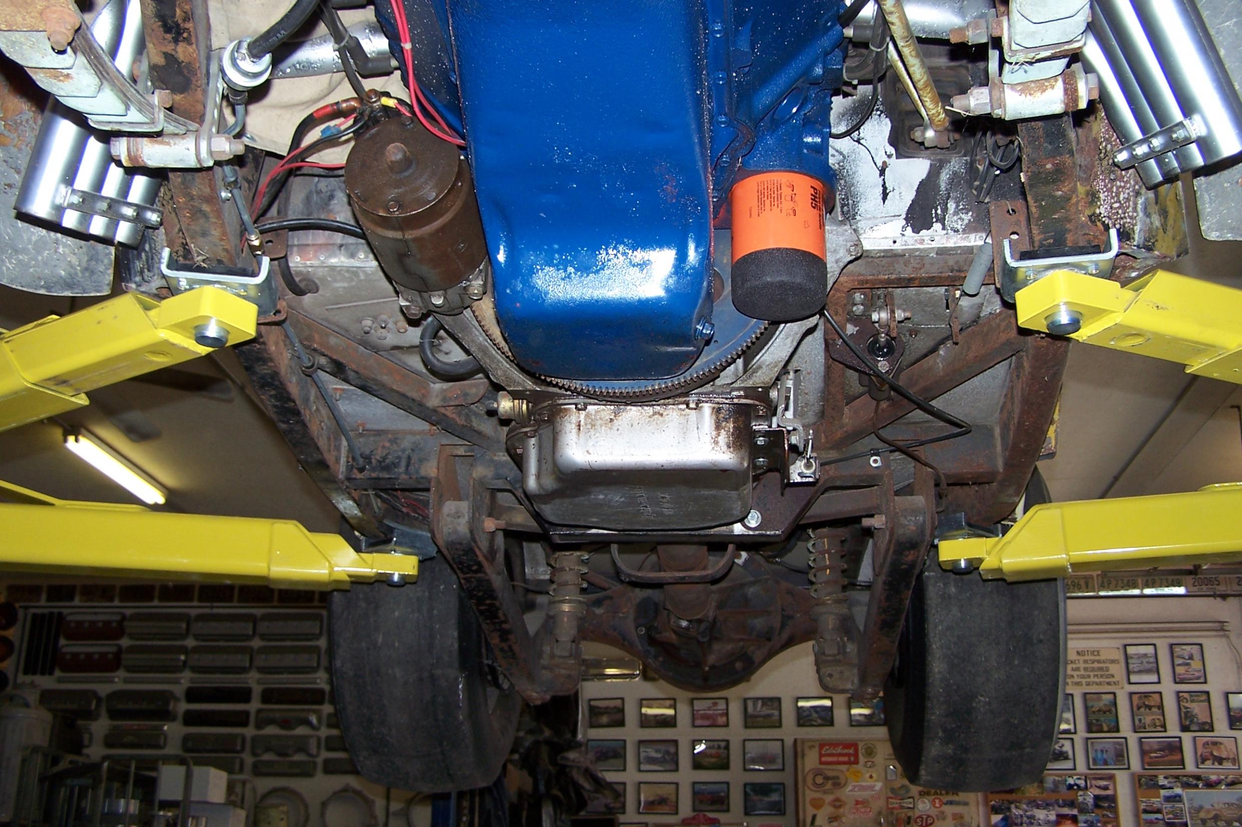

    Got the G***er P***er all the way up on the lift today and thought some of you might like to see the underside.....

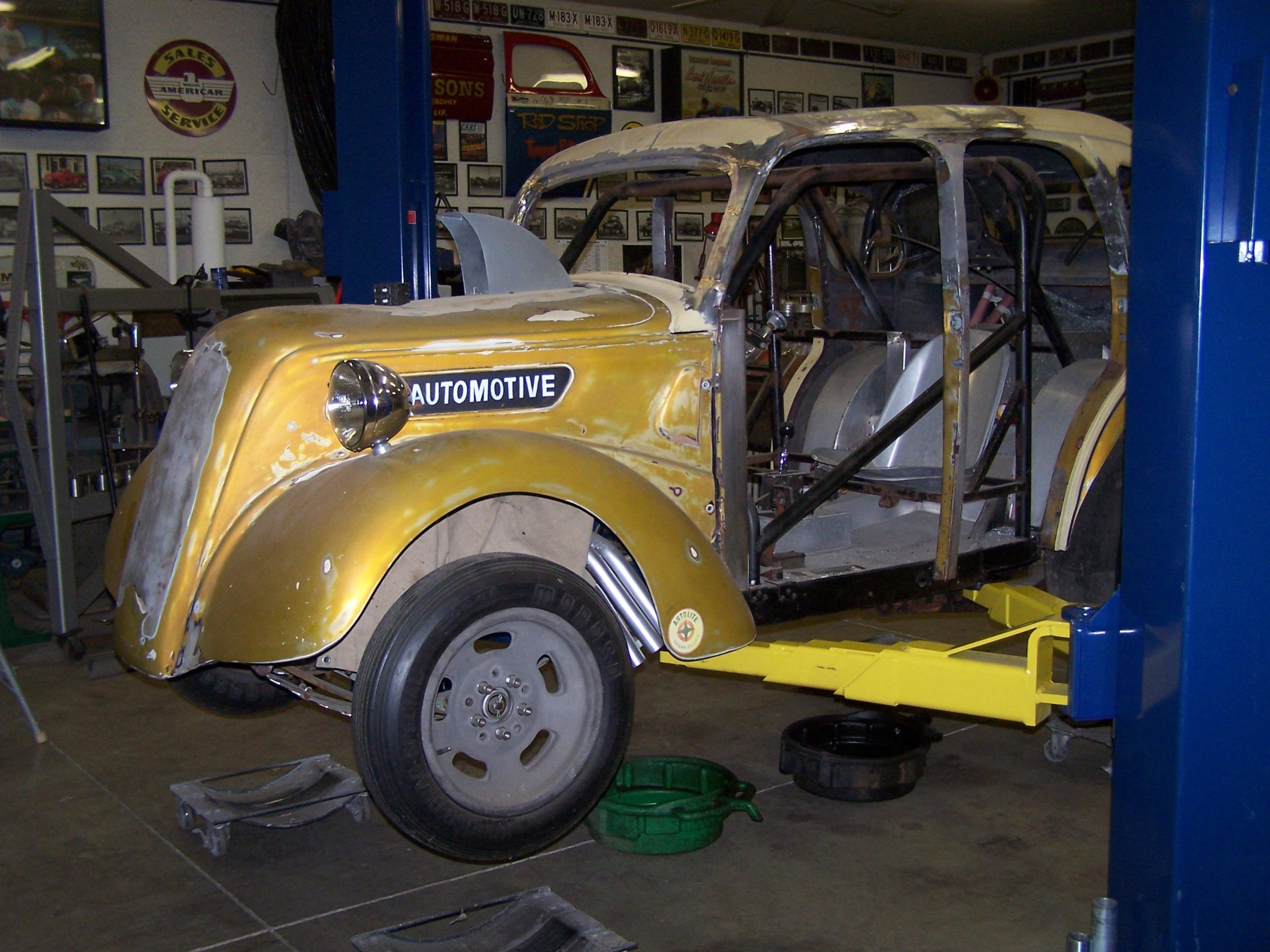

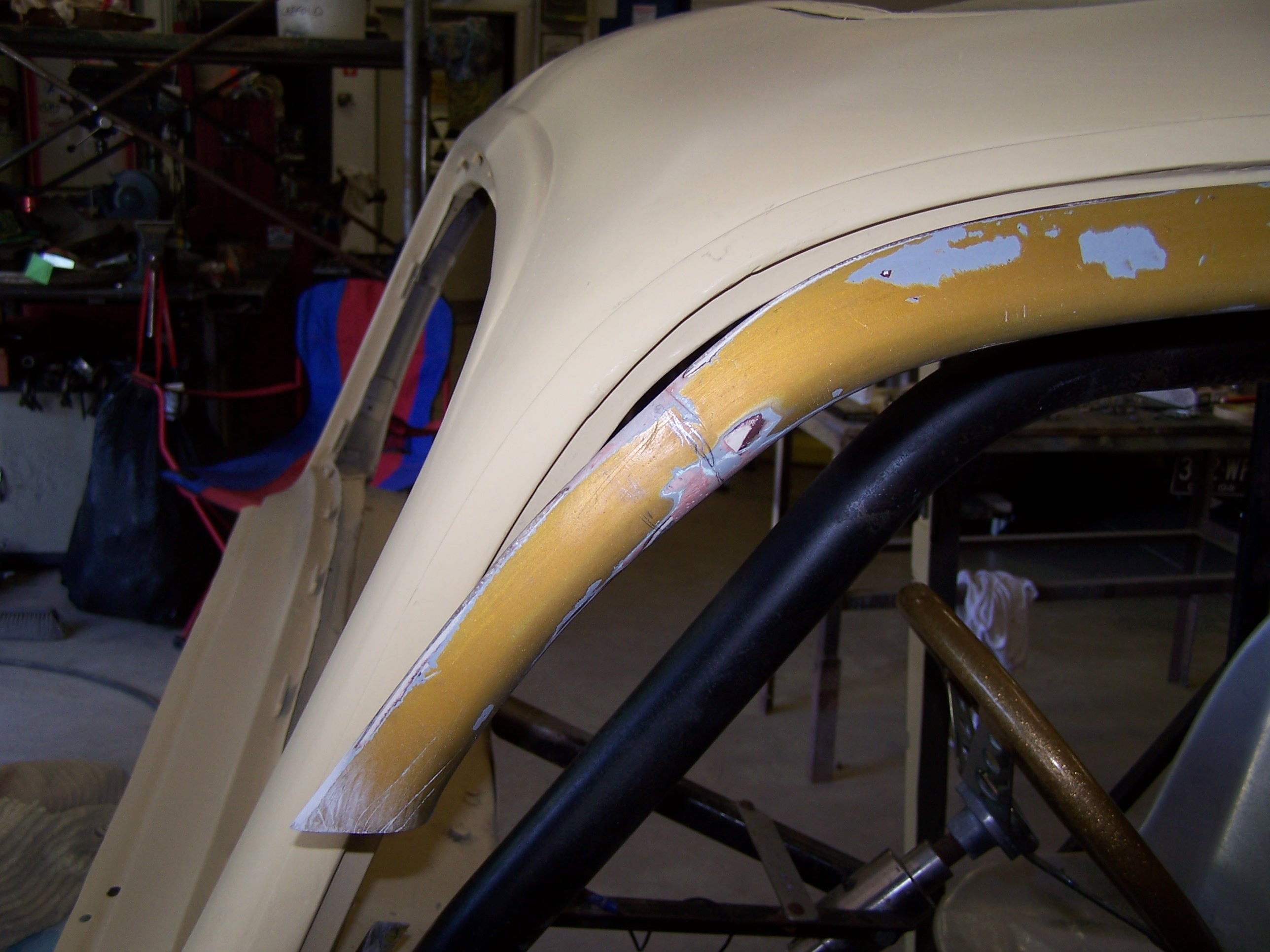

    Finished the work unchopping the top today and ran it outside to blast some areas that needed more cleaning... Tomorrow we prime it...then we start unchopping the fibergl*** doors.

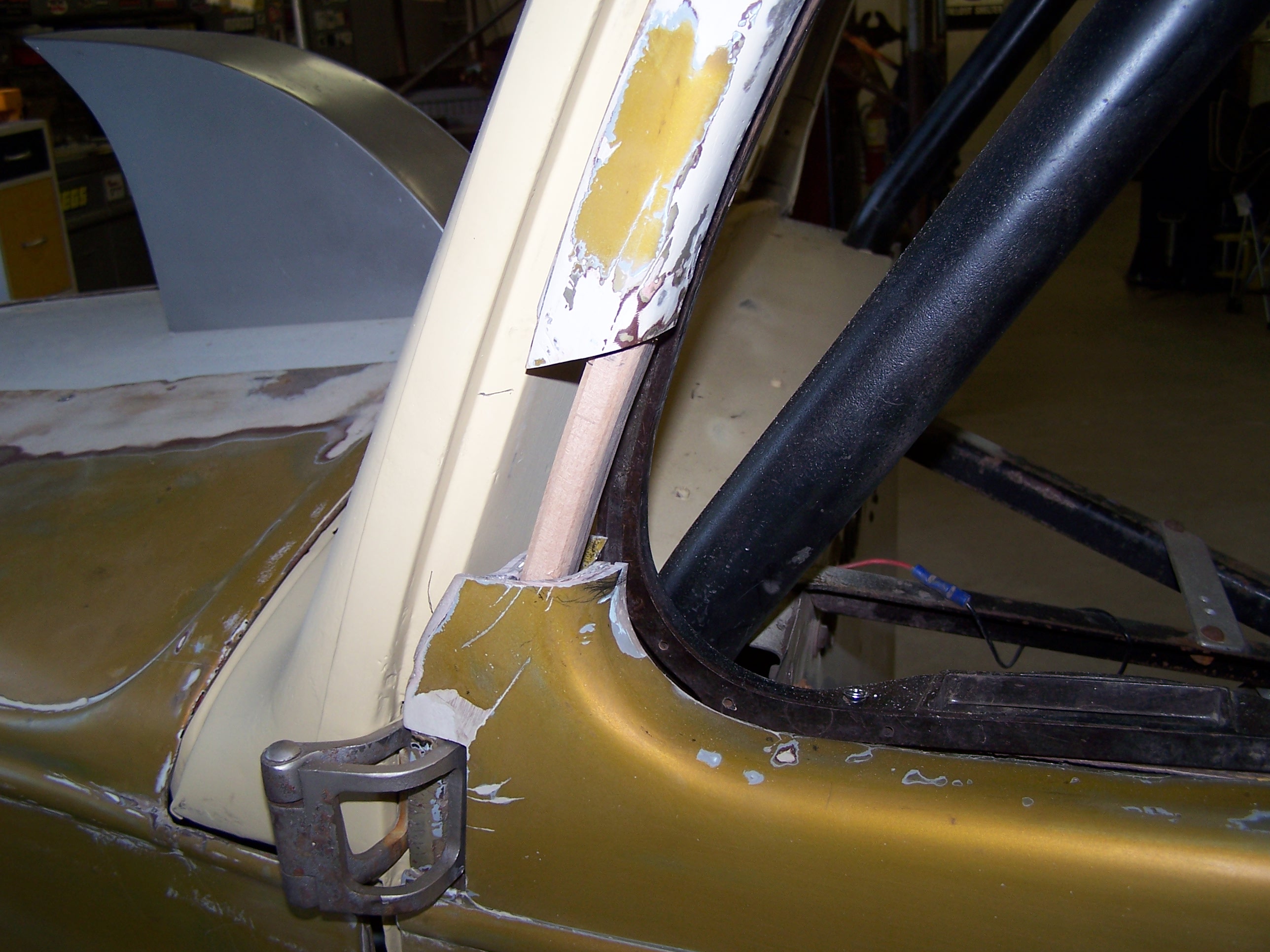

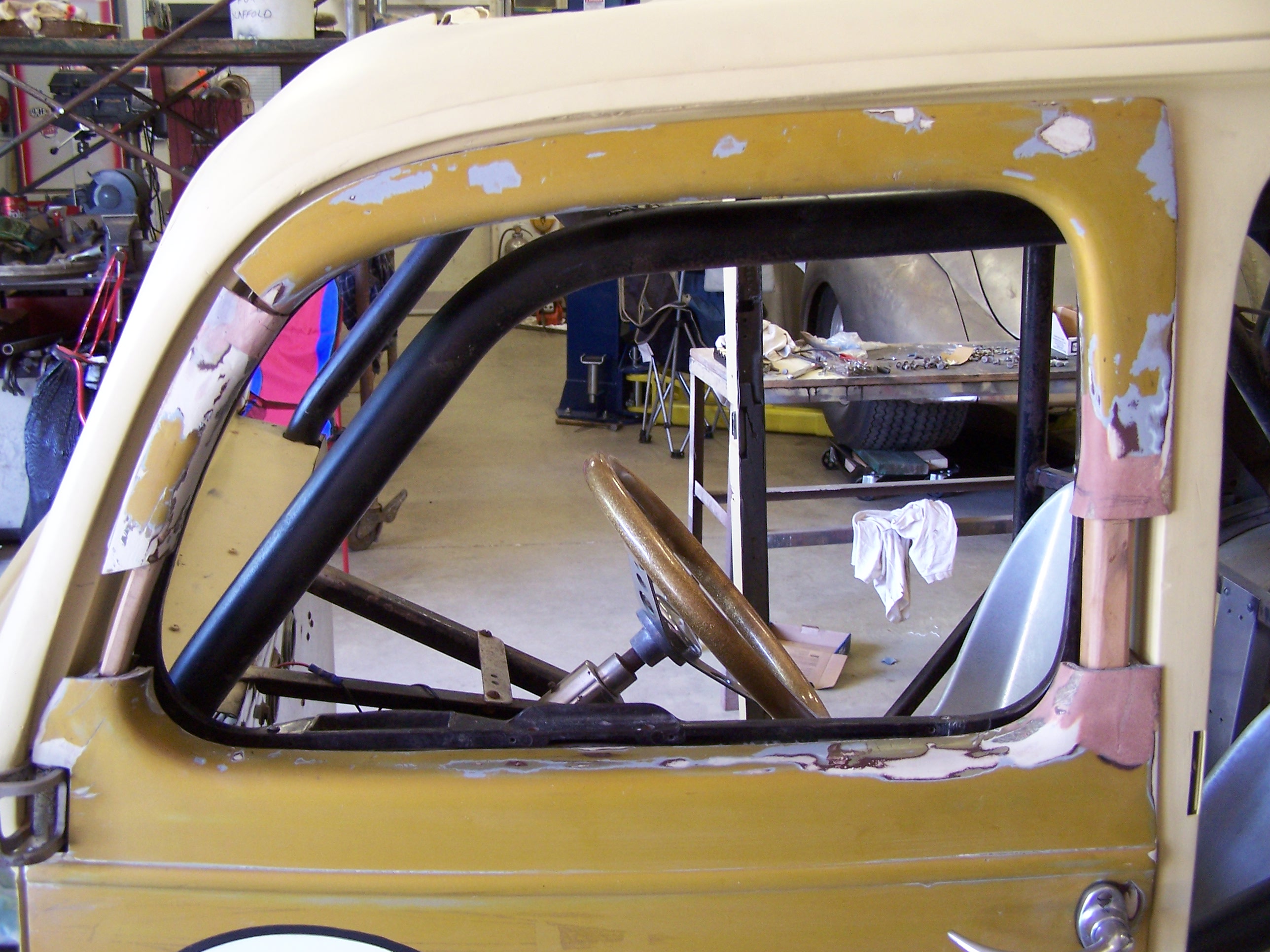

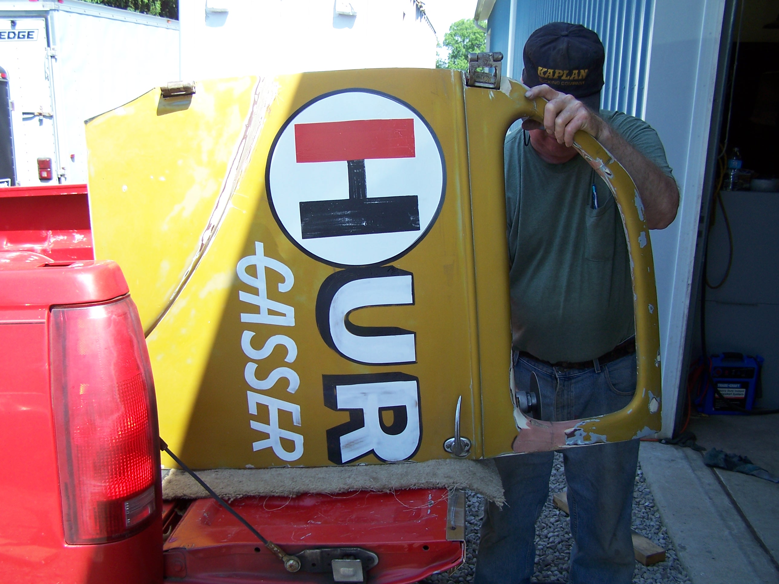

    Prepped and primed the body and started to unchop the drivers side door. Trying to figure where the door top was cut to remove the four inches takes a little time but I think it will be easier to do than the body was...... and a lot less work.

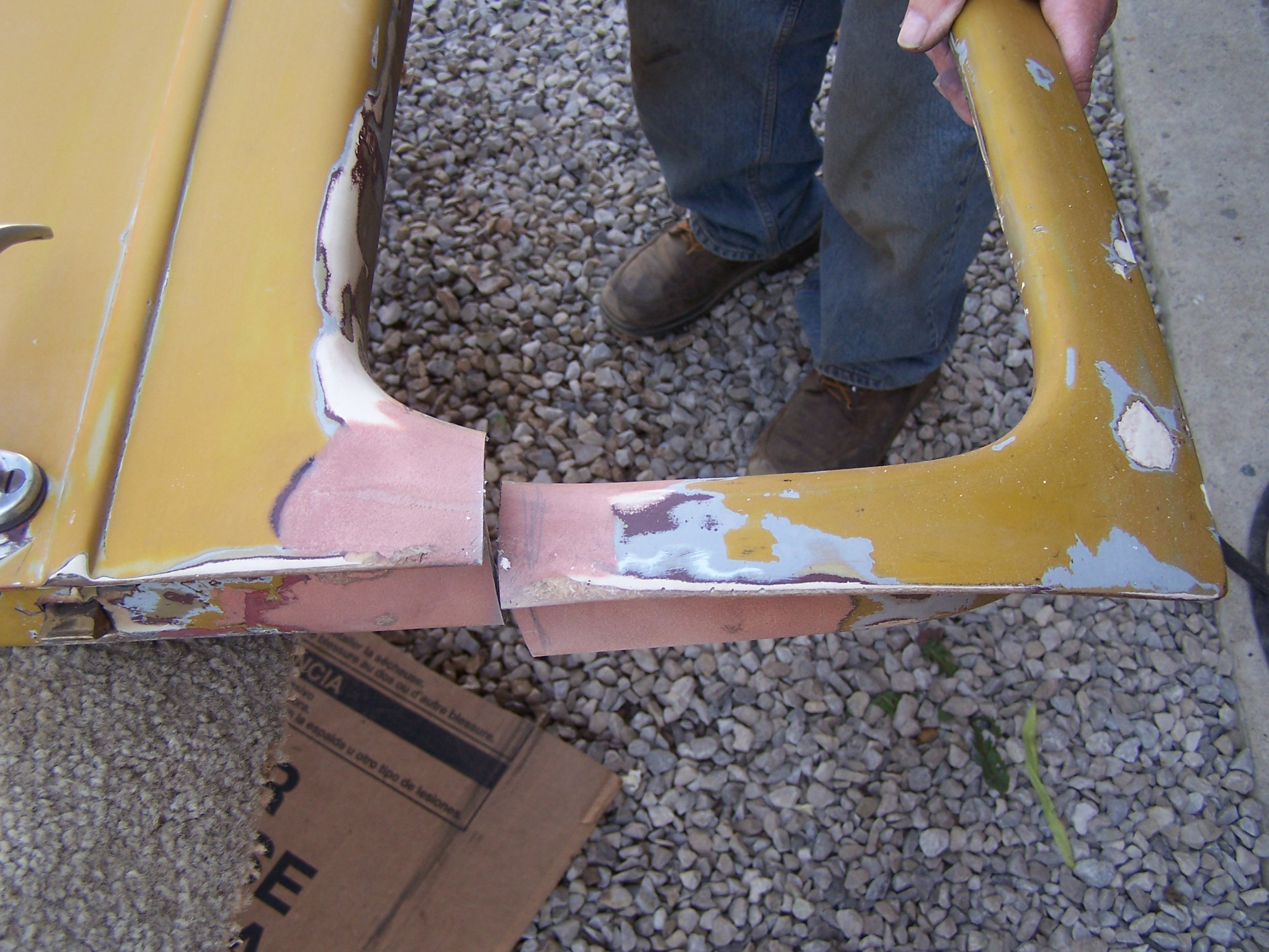

    More door work today....... cutting it apart then fabricating and installing wood pieces with drywall screws to hold it all together. The wood pieces will be cut down a little more to get a perfect fit, then gl***ed into the door to give it some added strength

  21. loudbang
    Posts: 40,346
    Using the wood pieces is a great idea.
