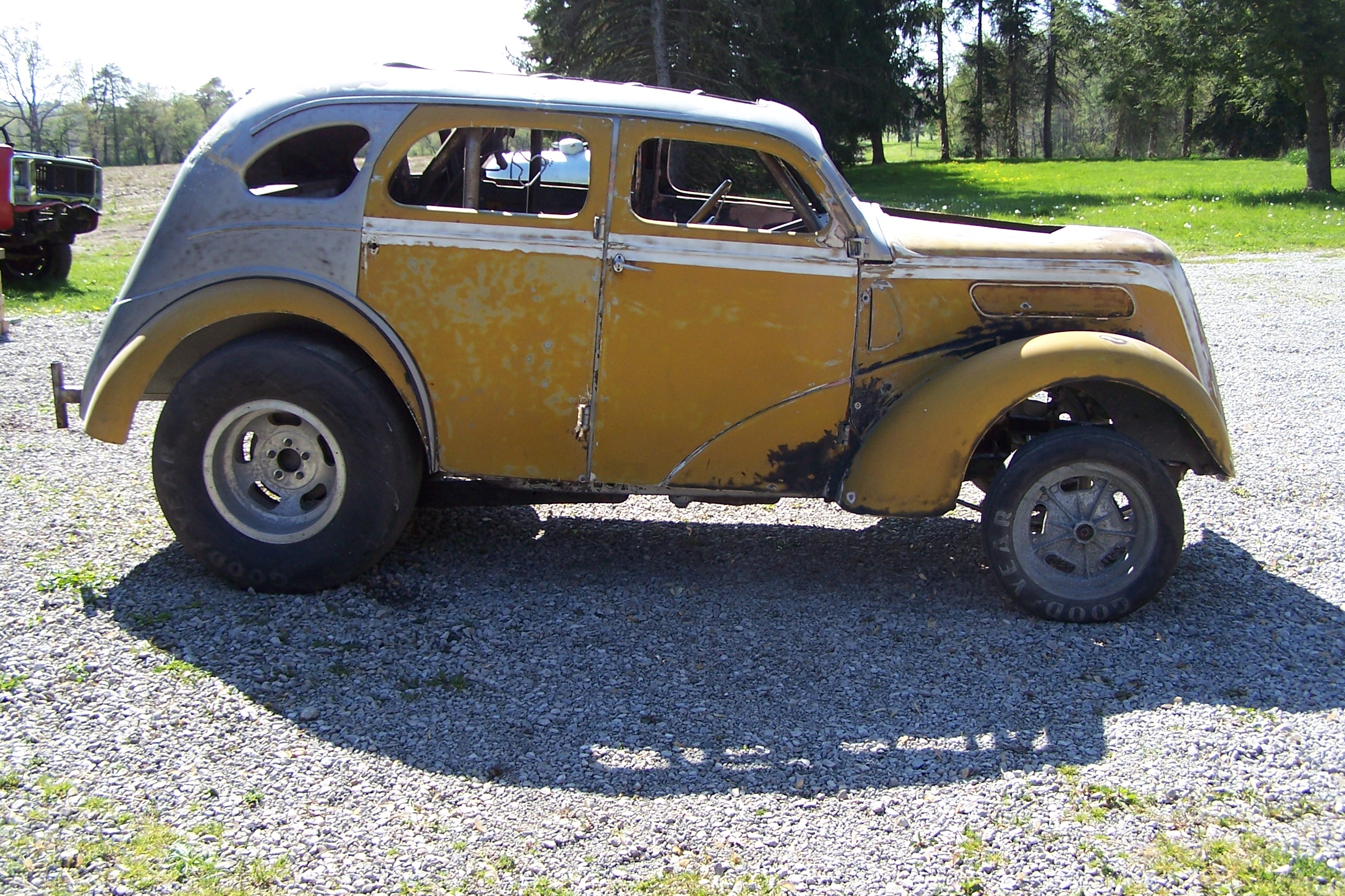

    Posts: 410

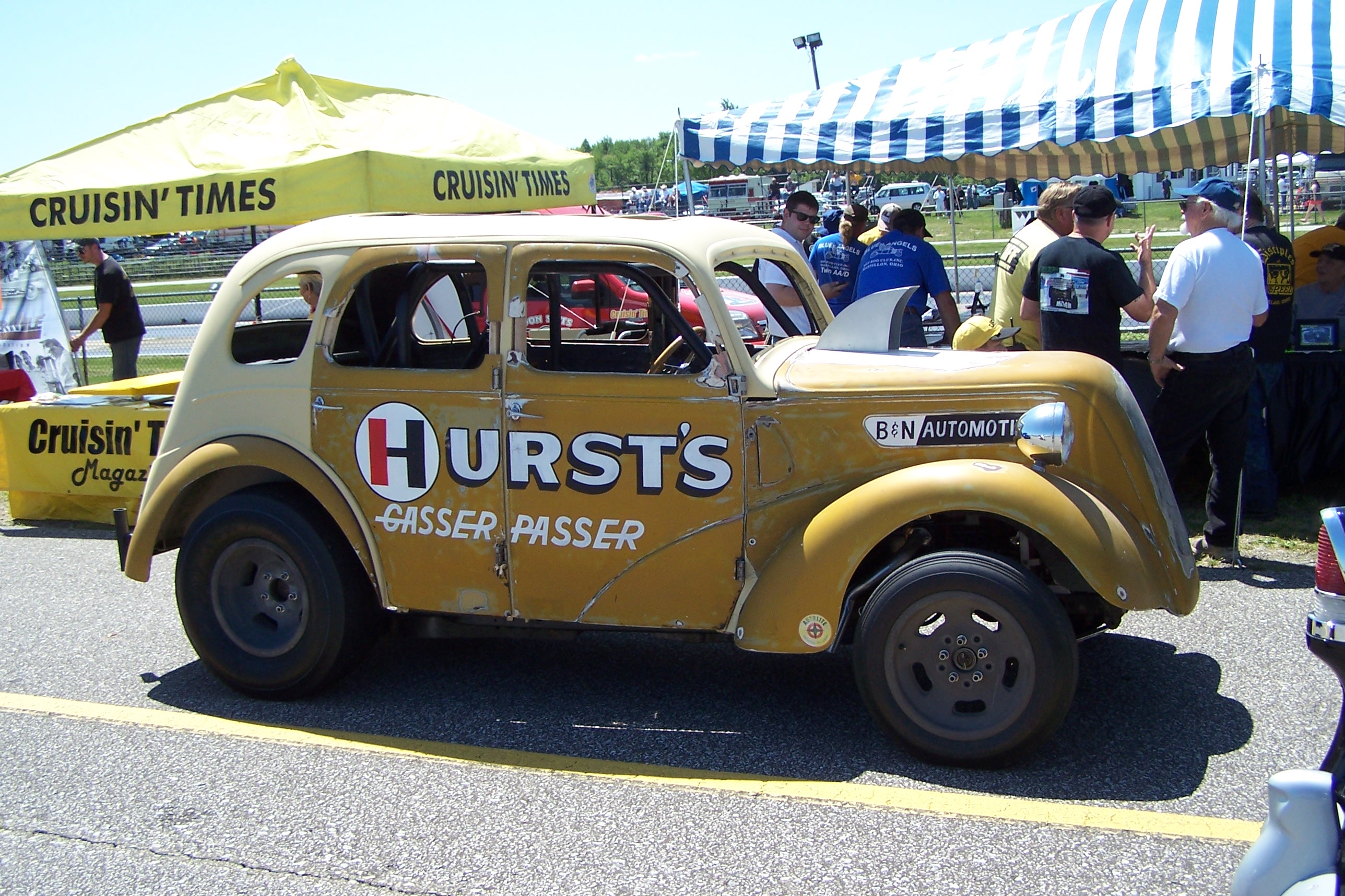

  5. Any chance this Prefect will be at the York Nostalgia Nationals @ Beaver Springs in July ???

    Last week we took the G***ER P***ER down to the Xenia " GATHERING OF THE G***ERS " event and got photos of George and his son Greg standing next to the car.
    Nice show. Thanks George and Greg.
    Gizzy and chryslerfan55 like this.

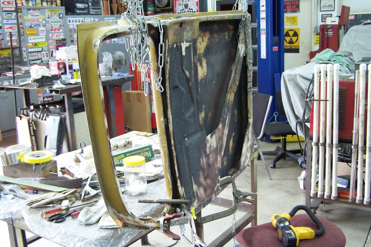

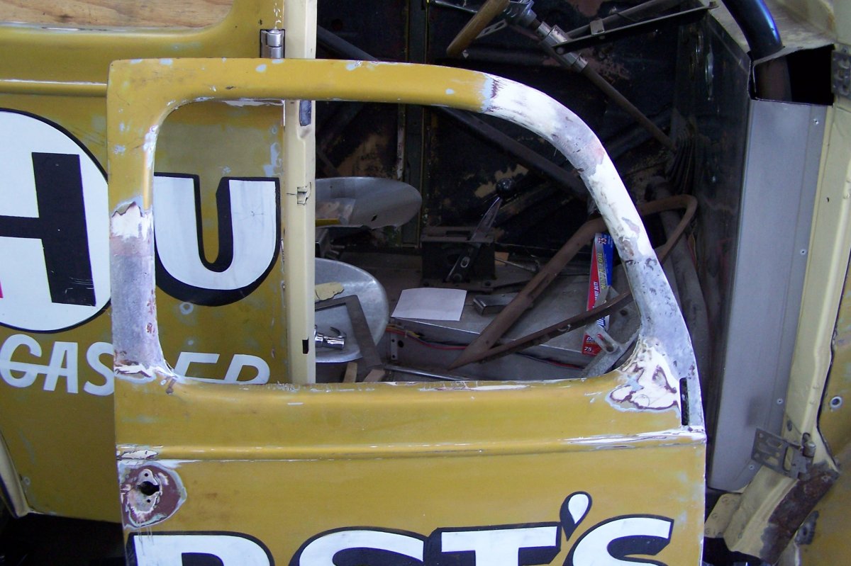

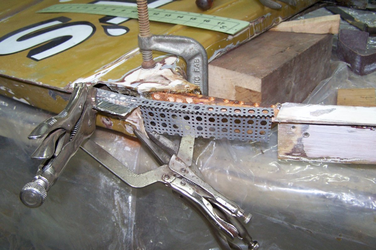

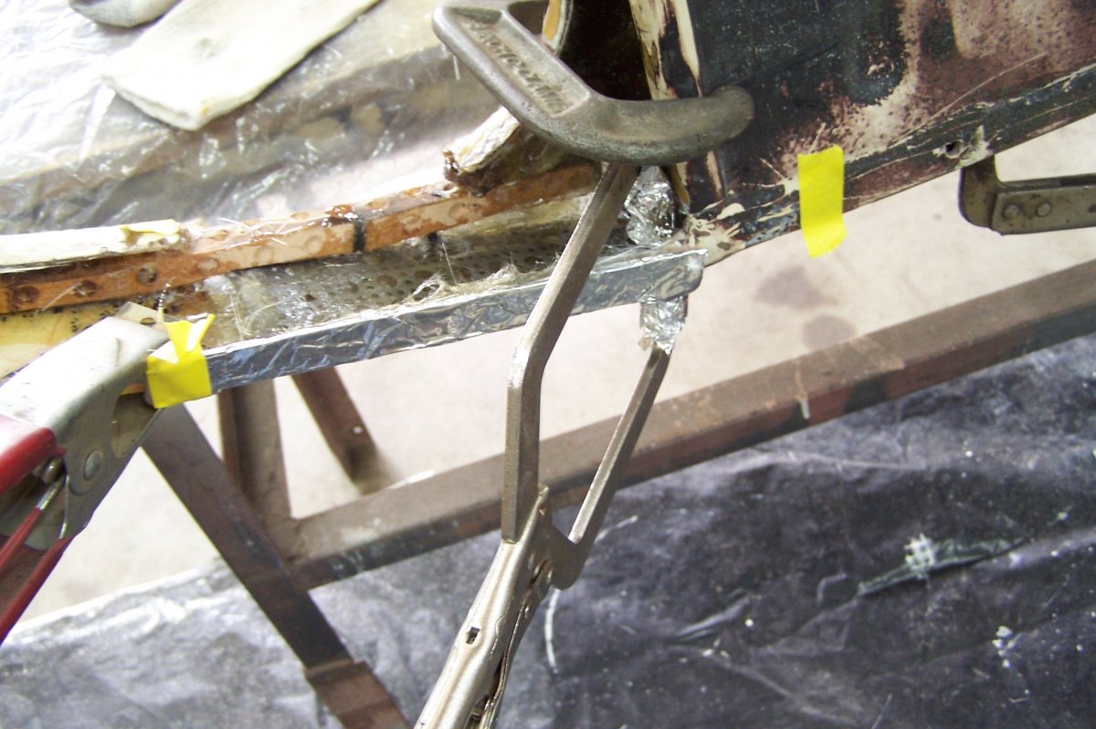

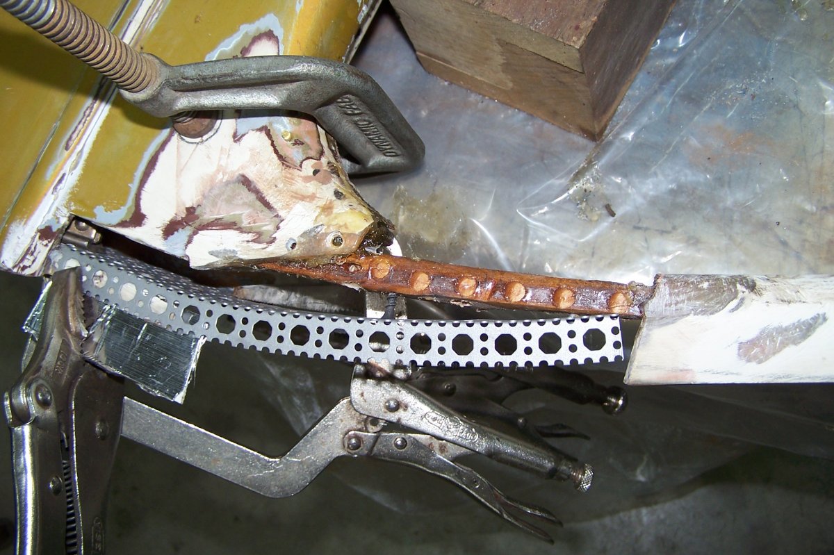

    Back at it.
    Started fibergl***ing the missing pieces of the doors back together. This right front door had been ripped off at one time and it's really been a pain to put back together correctly so that it fits like it should.
    I like working with metal....but not fibergl***. Fibergl*** is to slow to work with.
    I cut wood pieces to fit inside the doors and then screwed them to the original fibergl*** to hold the parts of the doors in the correct position. I also used some perforated metal to reinforce the top of the door where it attaches to the hinge area. A long way to go. 100_5374.JPG 100_5375.JPG 100_5376.JPG 100_5377.JPG 100_5378.JPG 100_5379.JPG 100_5383.JPG 100_5384.JPG 100_5374.JPG 100_5375.JPG 100_5376.JPG 100_5377.JPG 100_5378.JPG 100_5379.JPG 100_5383.JPG 100_5384.JPG 100_5374.JPG 100_5375.JPG 100_5376.JPG 100_5377.JPG 100_5378.JPG 100_5379.JPG 100_5383.JPG 100_5384.JPG

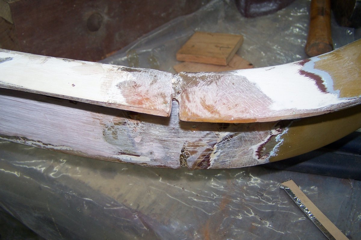

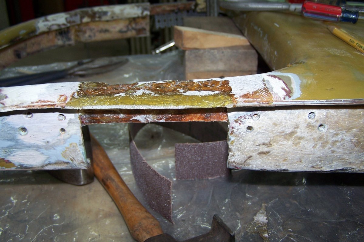

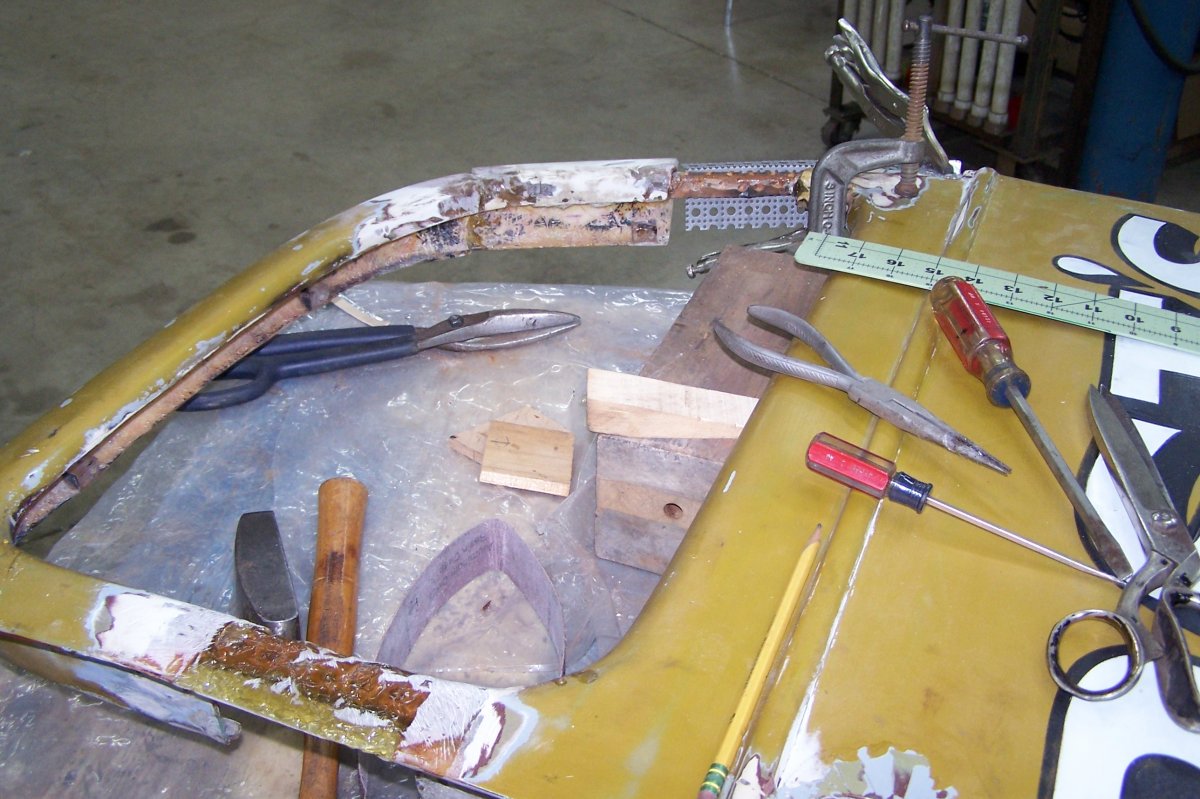

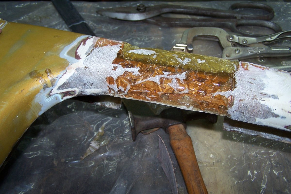

    Some more work done on the door. Inside panel was warped so bad that the window molding wouldn't fit...so had to split it in several places and fibergl*** it . 100_5402.JPG 100_5400.JPG 100_5395.JPG
