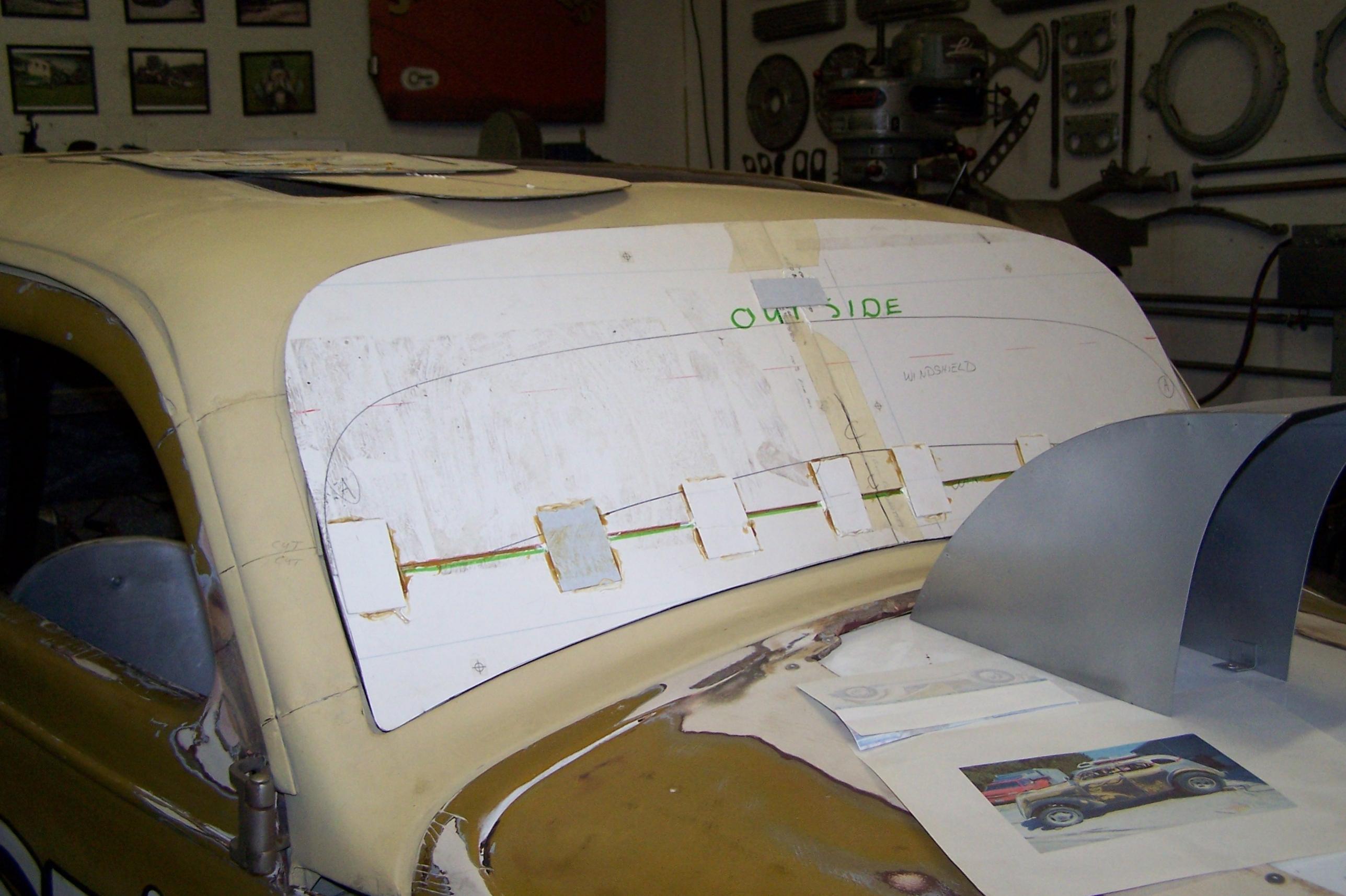

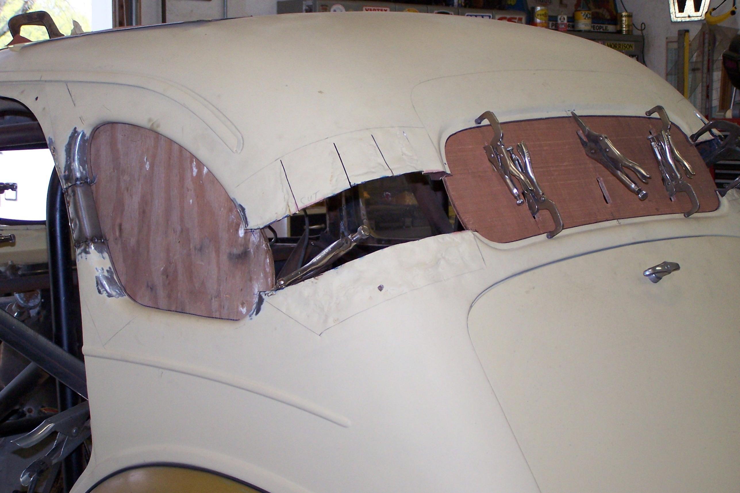

    Found a REALLY nice guy ( Jim Neel ) in Canfield Ohio, ( about an hour away ) who has a Prefect that he is turning into a street rod and who was kind enough to let us come over so we could use it to make the window patterns from. Later on, he let us borrow all the doors so we could fit the top to them. ( Had to stop work on the " T " as we were working within a time frame and had to return the doors to Jim so he could take his Prefect into the body shop ).
    We made the patterns out of poster board, then used these to make patterns out of 3/8 inch plywood.
    The doors were installed ...then the plywood patterns fitted to line the top up. We then made filler pieces to replace the metal that had been removed to chop the top.
    As brass rod had been used to braze the top back together when it was chopped ( common back in the day ) we had little choice but to braze it all back together the same way, except for a few places that there wasn't any brass left to mess with ( ever tried to weld over brass ? NASTY )
    SIDE NOTE ... The Anglia top didn't work out..after closer inspection we found out that there is a difference between the Prefect and Anglia windshield opening shapes, ( Refer back to post #249 ) , so we ended up custom making all the filler pieces by hand...no big deal...just took a little extra time.
