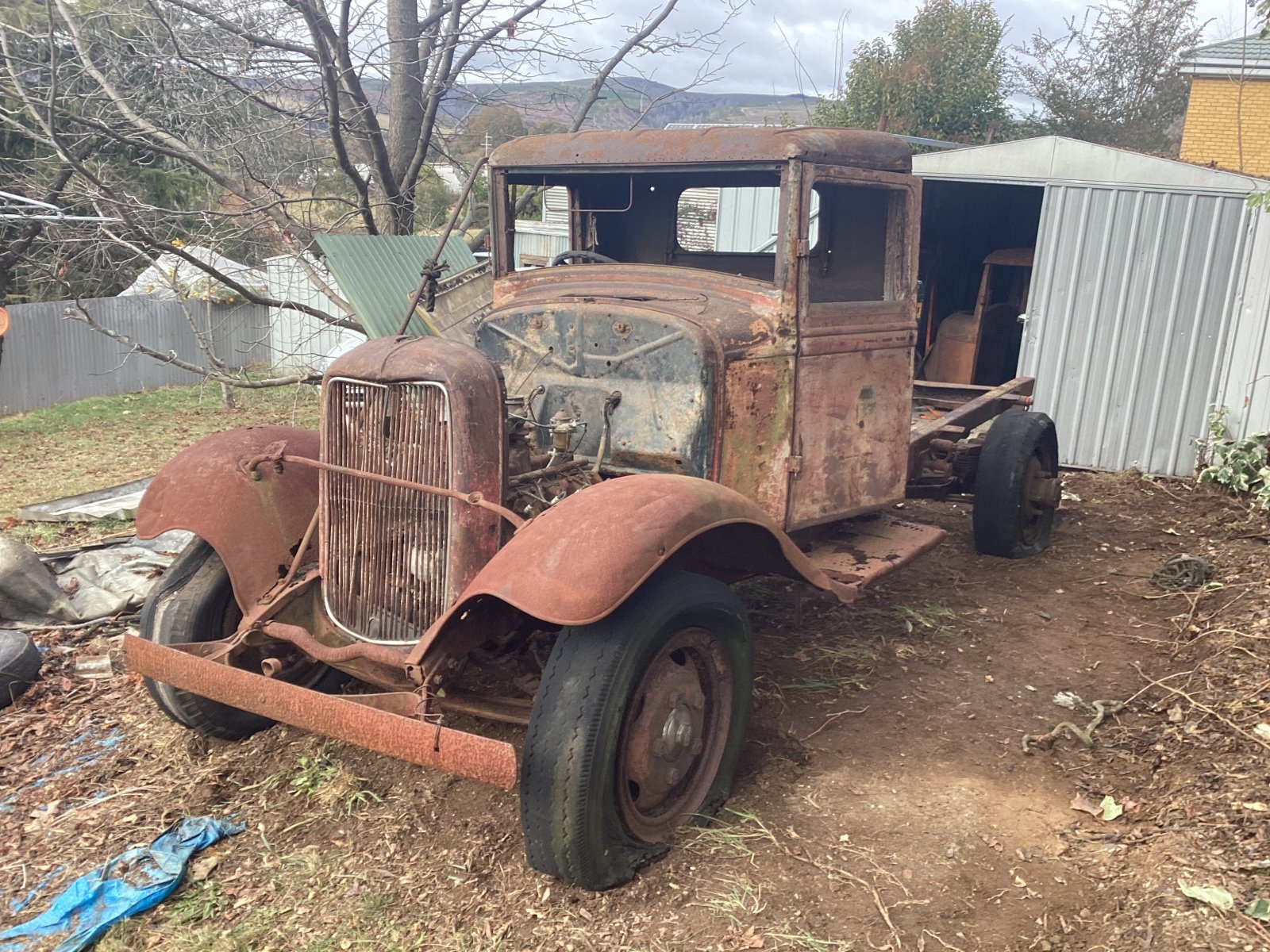

    Hey Guys.
    When I was 16 I purchased this from a property eight miles from our farm, my parents had divorced a decade earlier and rather than have it out at the old man’s place, I wanted it at my mother’s place in town.
    Neither location was ideal as neither had a garage or shed for me to store it in, but since I lived in town it made sense it would stay there. Sadly I did not have the maturity or
    motivation do anything with it and when I turned 18 and needed a car to get my licence, my mother gave me an ultimatum, if you want a car you will need to sell the truck, you can’t have both.
    Money was tight and I needed a licence, so sadly I sold it, and always regretted the decision.

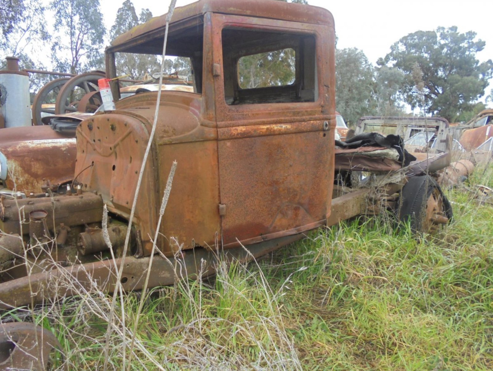

    Fast forward to 2017, I had a place of my own and a couple of early projects, but none really inspired me. I had always wanted another 1934 BB Truck, and knew of a yard with several. 60EBB626-A4CD-4E56-8A93-FBECDB04077A.jpeg

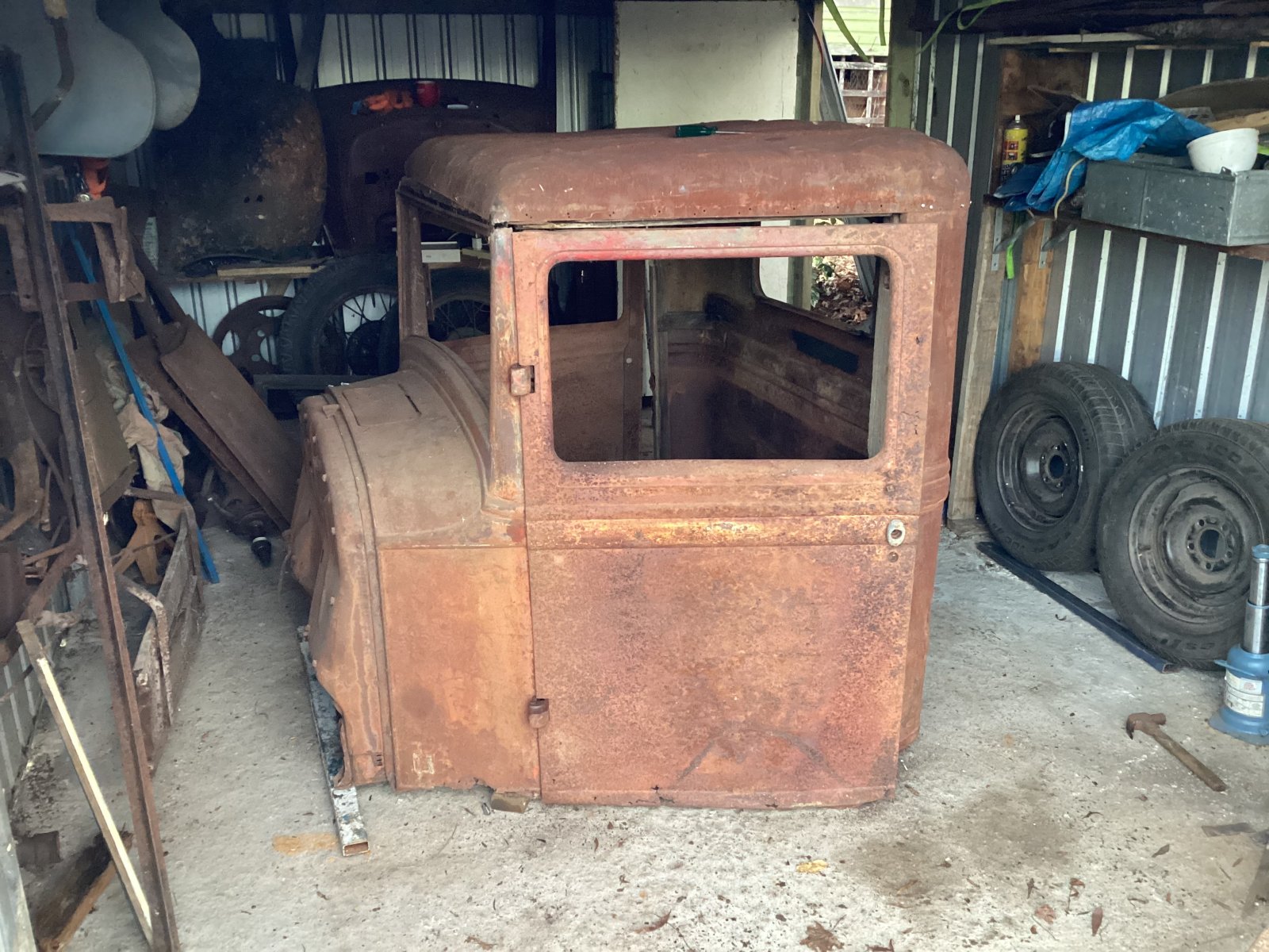

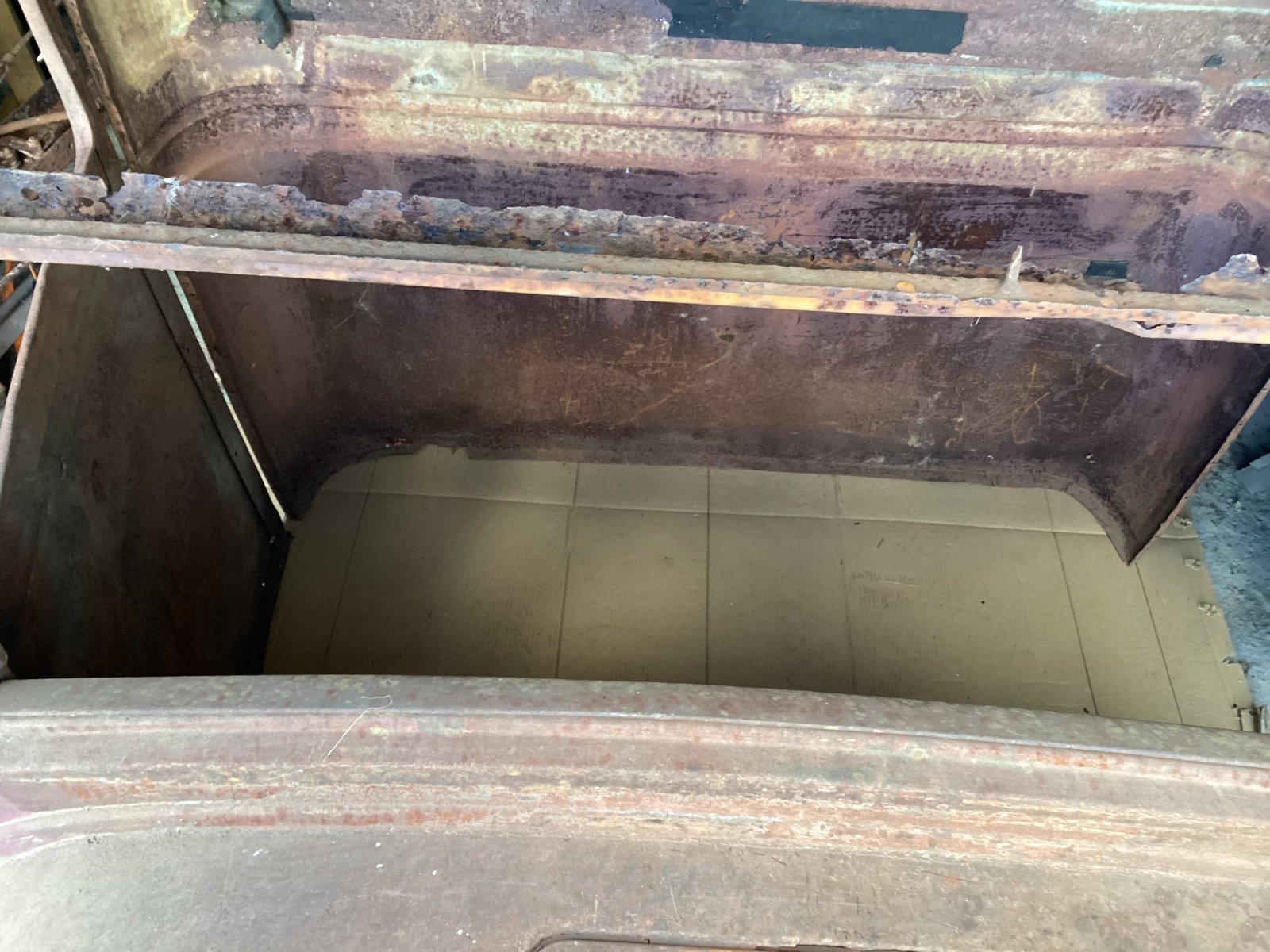

    After years of procrastination I finally got around to starting on it last year. Anyone unfamiliar with these trucks, that would be most people, I’m guessing, would be unaware that the cabs on these are completely different to their American counterparts. They were manufactured in Geelong Victoria from locally stamped panels, only the cowl is interchangeable, the doors, floor, roof and rear cab sections were framed in timber rather than steel. 67CB481B-1B47-4C36-957F-507325842357.jpeg

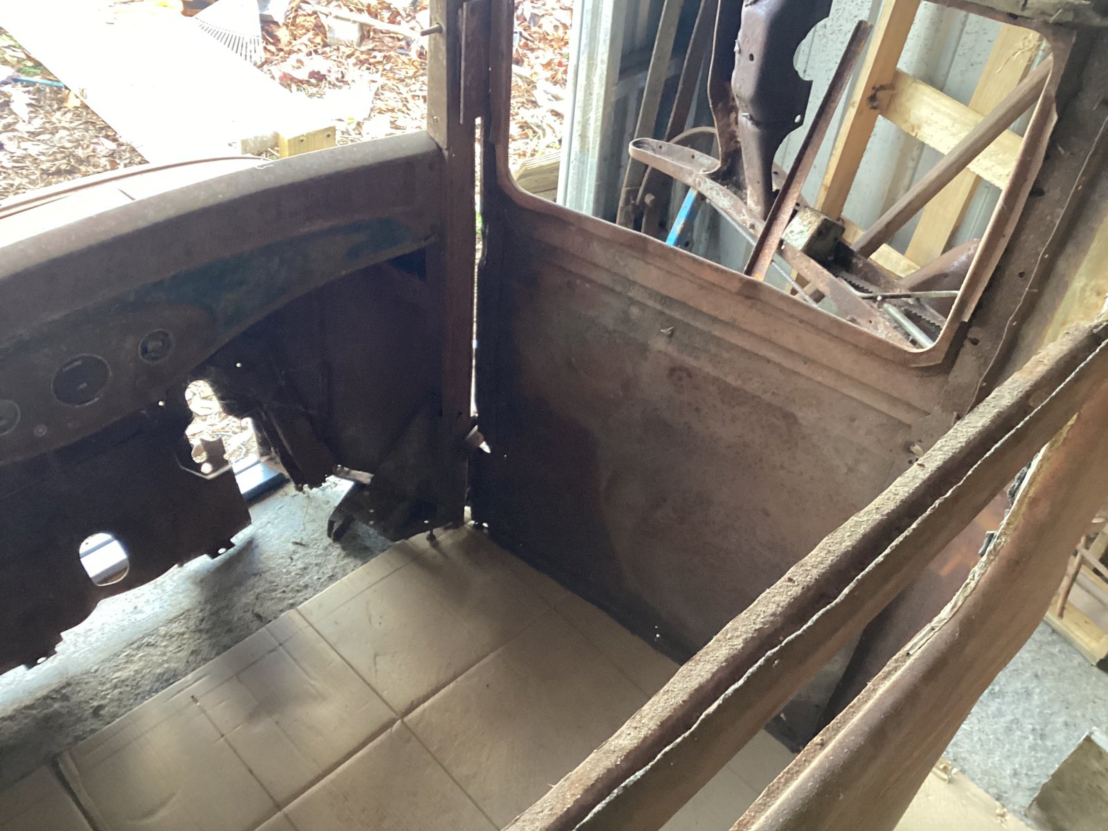

    FC45E584-32BB-467F-8C7C-AF743664E6B4.jpeg Even the sub rails were timber and sadly, they were long gone from this one, so I had to figure out a way to make a new floor. I want to replace every remaining piece of timber with steel.
  6. chev34ute
    Joined: Nov 13, 2011
    Posts: 1,525
    chev34ute
    So I squared the cab up over a large piece of cardboard, traced around the cardboard cut it out and this became the template for the subrails. F598009C-D1A9-4C57-ABD3-0FCB30C88863.jpeg

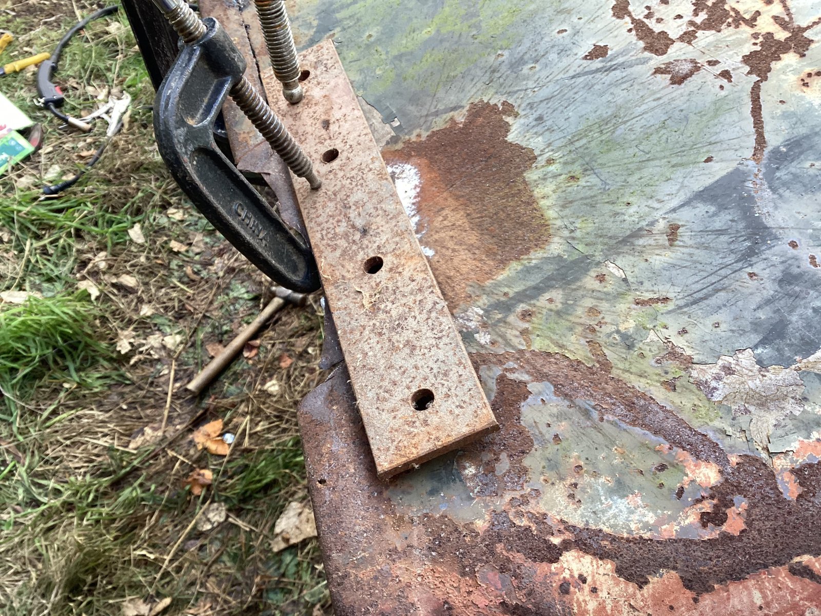

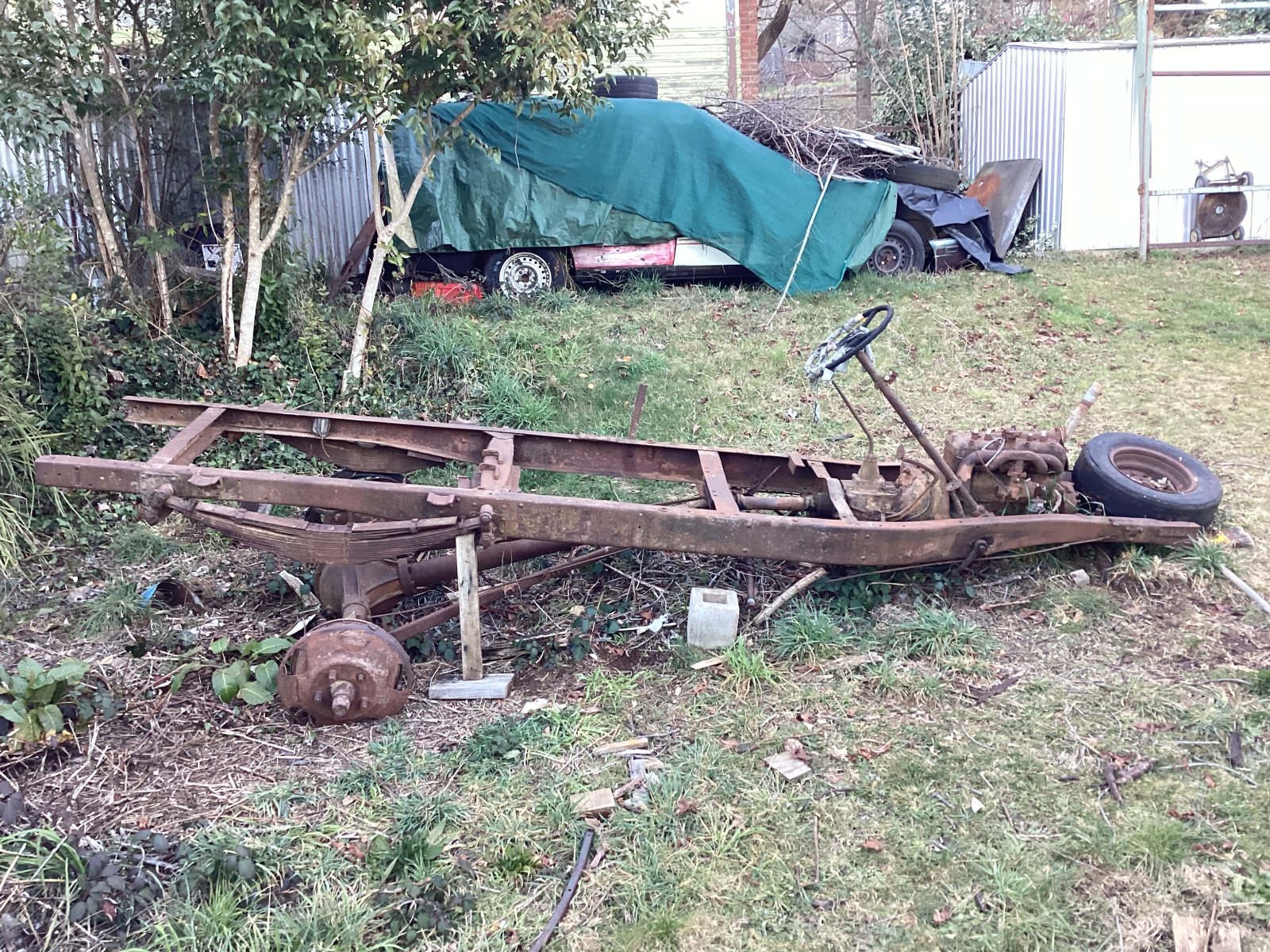

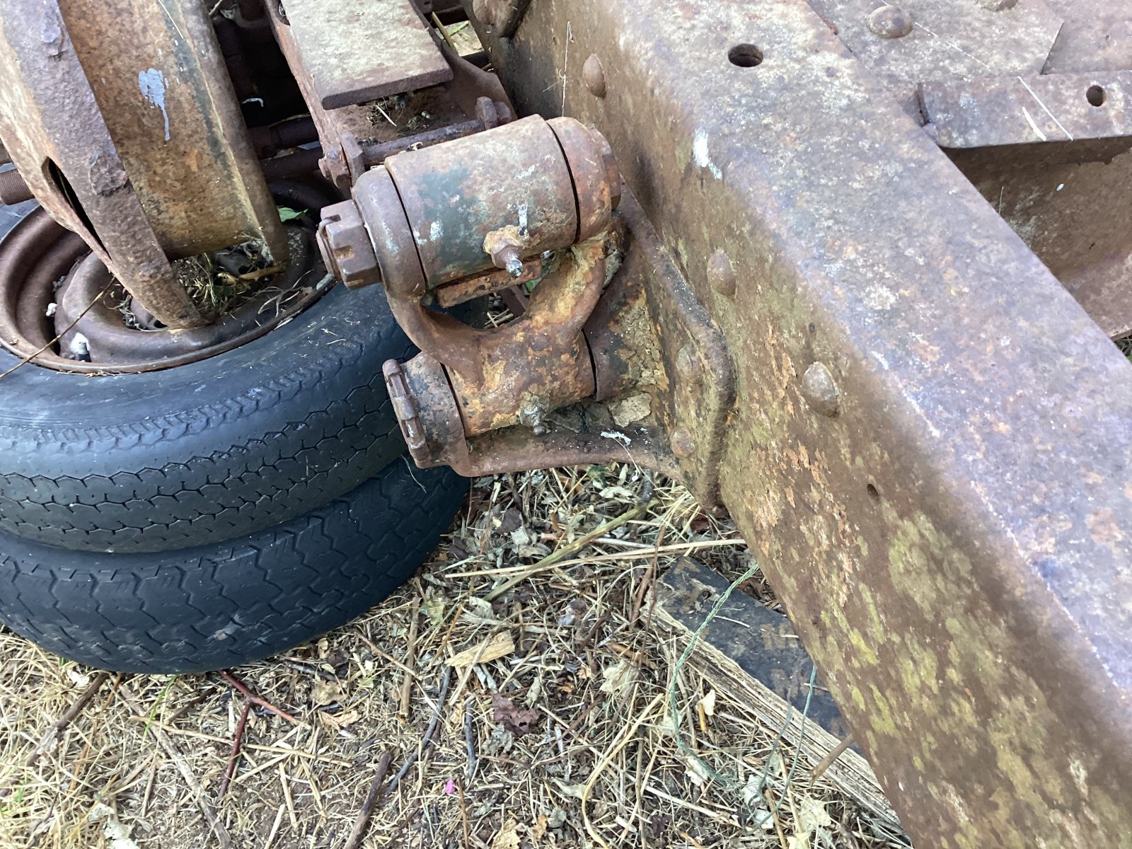

    At the same I was doing this, I was trying to figure out how I could get the frame into the shed, minus the bulky rear end, a nine inch will replace it. The bolts in the shackles are right up against the frame, so I couldn’t punch them though. 50E0B847-AFC0-450F-AC65-686140F74894.jpeg
  8. chev34ute
    Posts: 1,525
    chev34ute
    B3D7DAD8-CD3C-4E58-A858-73AC5F3048C4.jpeg So I decided it would be easier to sacrifice the U Bolts instead. I also uncoupled the front end at the same time.

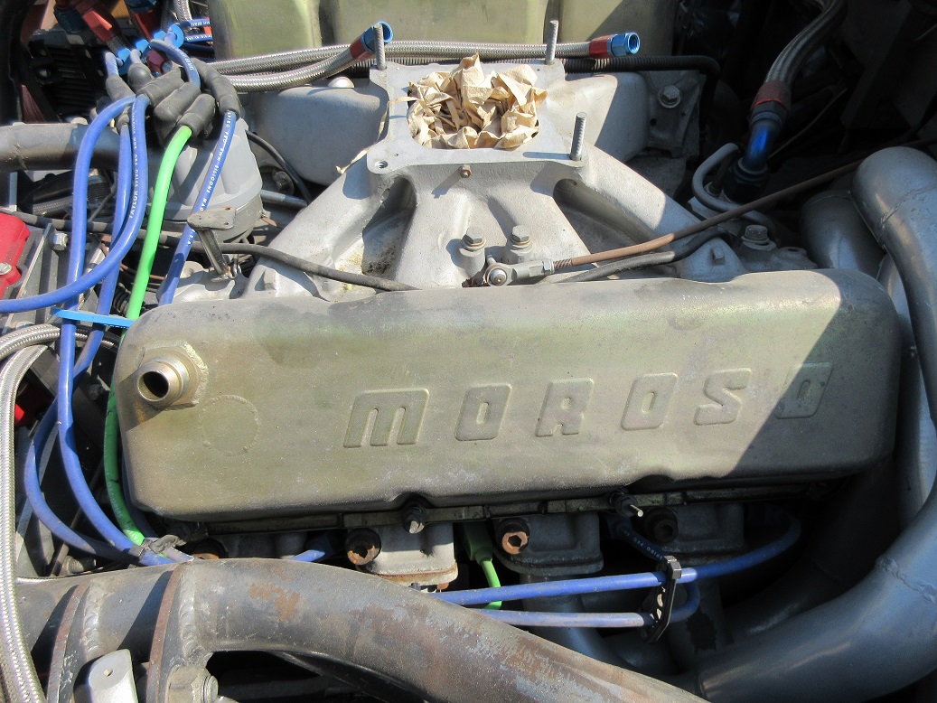

    I like your goal. Here is my destroked 310" Cleveland. 351 NASCAR XE Pillow block cast in Geelong for Ford Motorsports. (it's not one of the poorly cast ones that ended up in Aussie street cars). The big Motorsport A3 aluminum heads, dry sump oil system - just over 650 hp. (It's in my GT1 Mustang which is the SCCA club cl*** that uses the same rules as the pro TransAm series. I'd be tempted to put a 351 crank in your 302 for some free horsepower. Small chamber heads and a big carb - these things use a lot of air at 8,500 rpm.

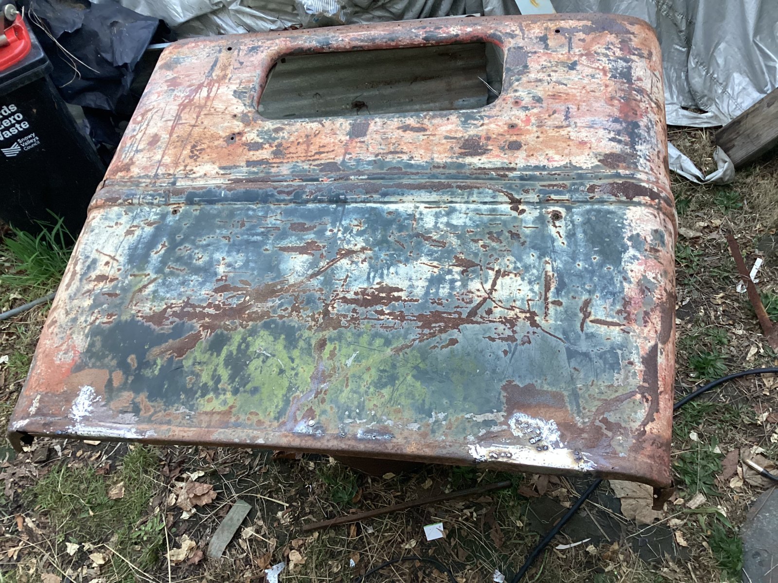

    I got a little bit more done yesterday and today. 3AF67614-E840-4D36-8AFE-C850C0B9073A.jpeg The cab had sunk down about three inches over the frame after the back of the subfloor had rotted away. Here is another view the day it arrived at my place last month.

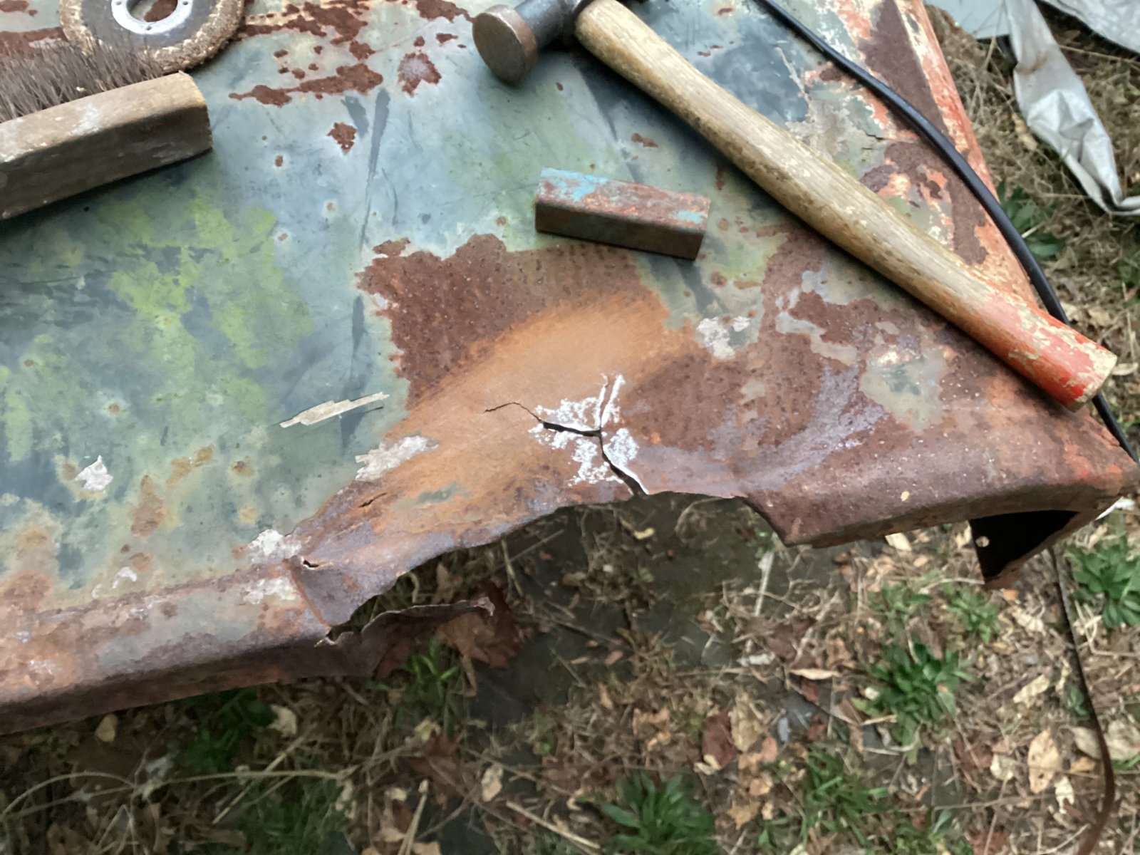

    There are several different ways I could have attacked this mess, the most obvious one would be to buy a bunch of lower patch panels, place them over the damaged areas, trace around them, cut out them out and weld in the new ones. The second and easier option would be to make my own, easier because I would not be waiting around for new ones to arrive. Instead I choose to attempt to repair what remained by pulling the bent up sections back down and s***ch welding them.
    It’s been slow and tedious as the metal is very thin and avoiding blow through is not always possible. Where it occurs, I have been cutting off strips of sheet metal and pushing it into the holes to weld in. I’m using a very simple $200 gas less Mig to do all the repairs, it has just two settings and I have them on the lowest setting for both. The results are ok, there is still a lot more grinding back and in filling to do on the welds.

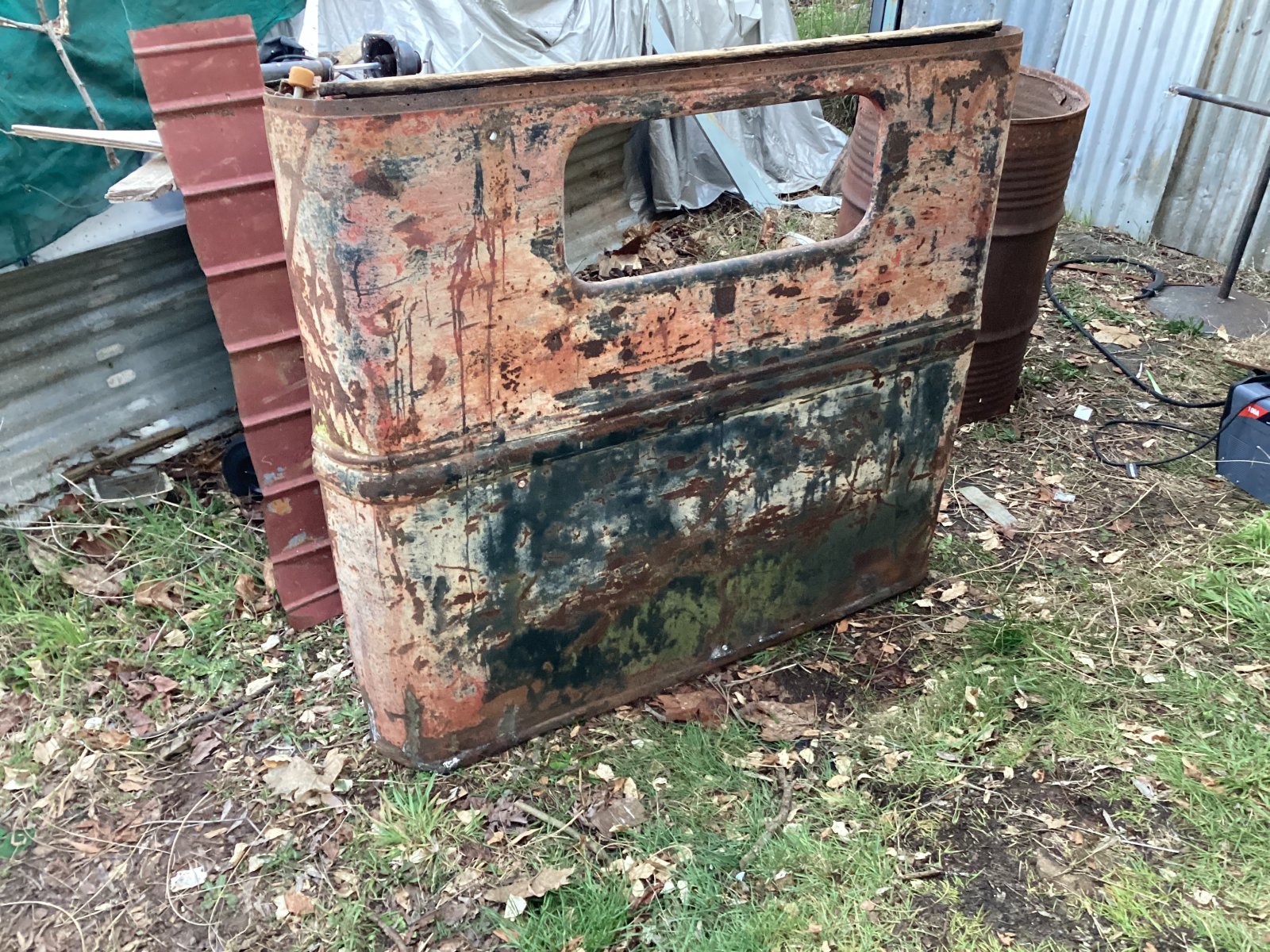

    This is what the other side of the cab looked like.
  19. chev34ute
    Posts: 1,525
    chev34ute

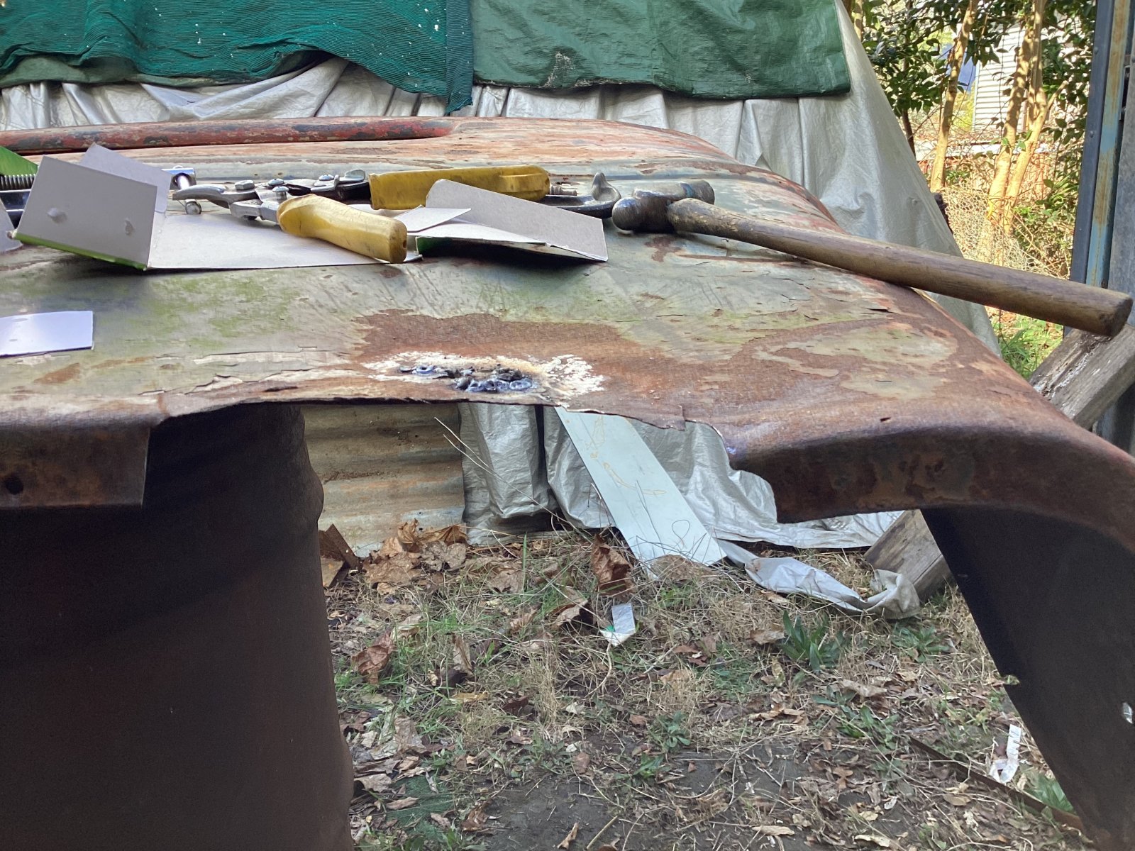

    Not only was it missing a large chunk of the bottom swage, the deficit had led to the whole edge being bent in.
  20. chev34ute
    Posts: 1,525
    chev34ute

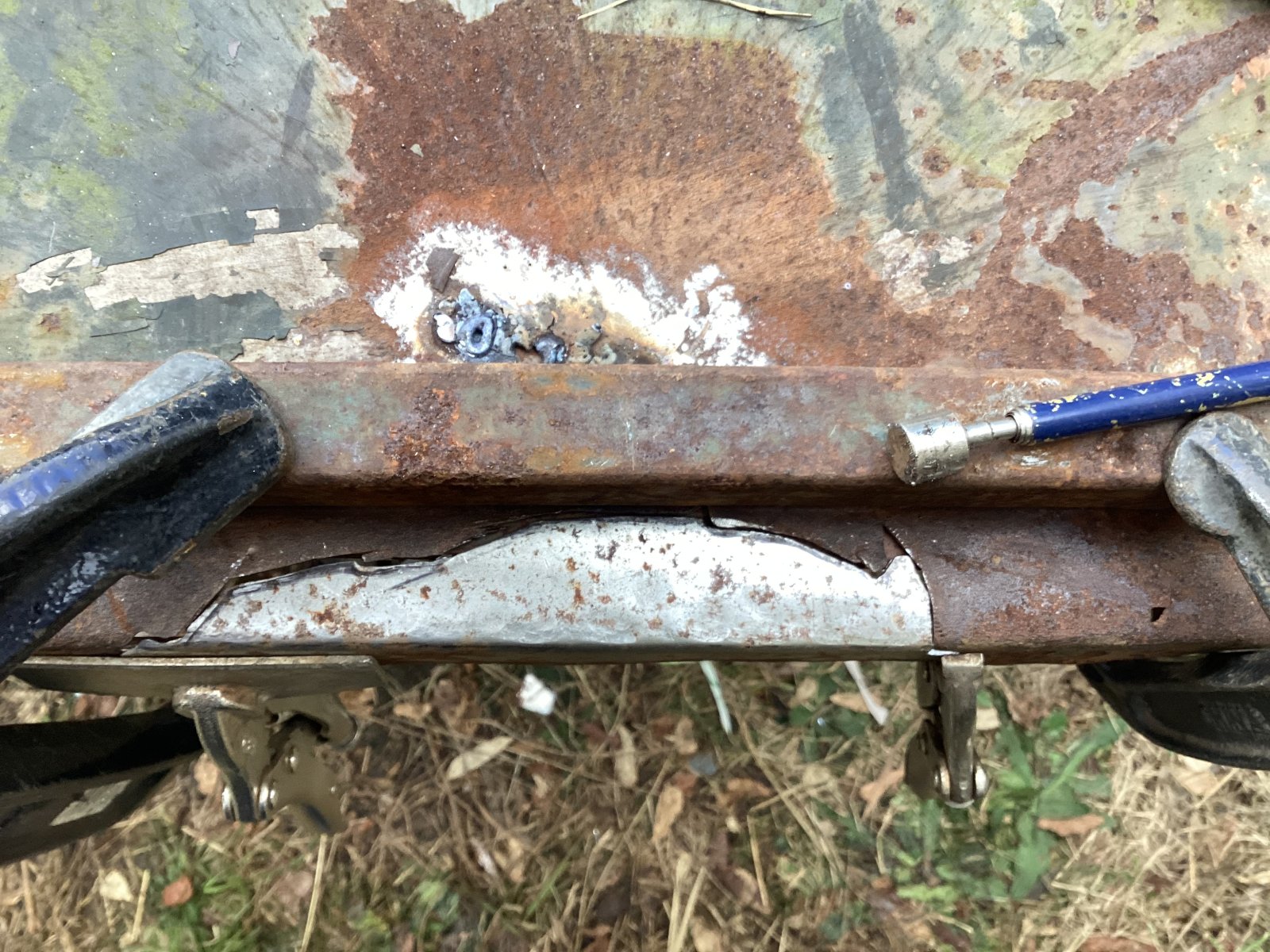

    In order to repair it, I had to first brace it up using flat plate and clamps.
  21. chev34ute
    Posts: 1,525
    chev34ute

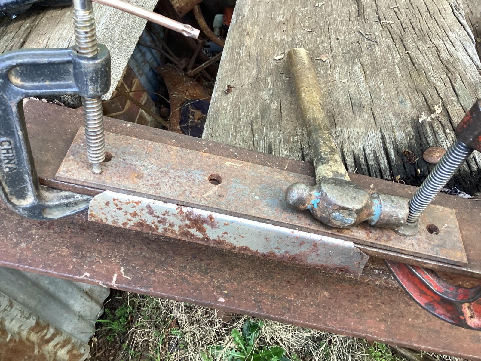

    The patch panel was formed by clamping it to the edge of the stair frame and hammering down. A7107071-CDAE-40FD-9E14-F2EEC7CA8FB9.jpeg
  22. chev34ute
    Posts: 1,525
    chev34ute

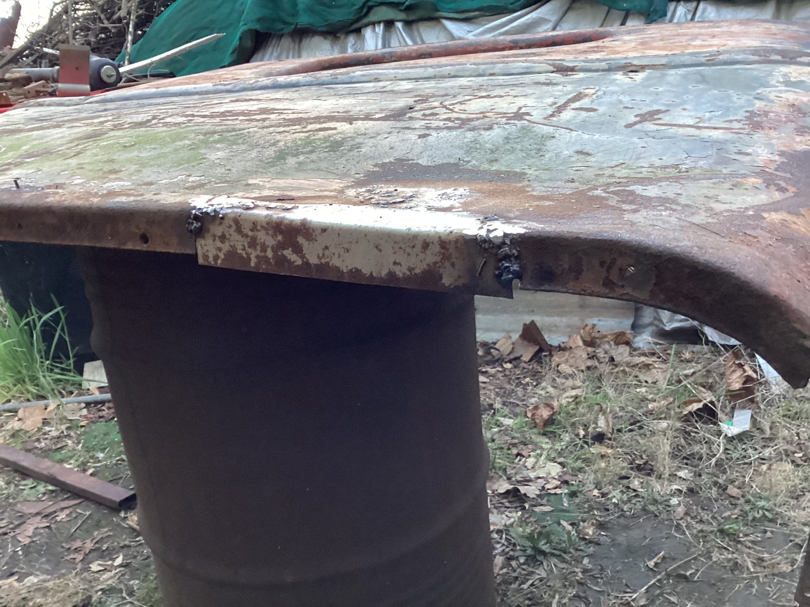

    In order to get the shape of the patch panel to matchup with the missing area, I made a cardboard template then traced it around the folded patch panel.
  23. chev34ute
    Posts: 1,525
    chev34ute

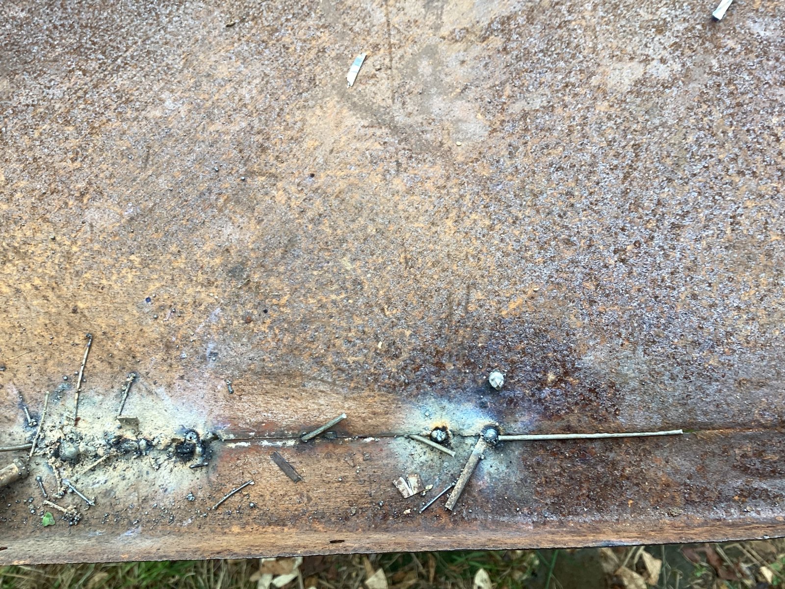

    And after slowly s***ch welding, I ground back the welds and checked how straight the edge was. A9582948-B0EA-4EAA-ACA9-F0CA8B51ADF6.jpeg 9C401DAA-1B7A-4A1F-8DF9-9ABCDE3BC5A8.jpeg 26471C60-D225-420C-9374-F87D9072C8B2.jpeg
  24. chev34ute
    Posts: 1,525
    chev34ute
    There’s still a lot of work to finish them off. Because the metal is so thin, I have been building up the welds on both sides before grinding them down. One thing I won’t be doing is using any filler, so the extra metal will be ground down to the profile swage in the areas where it got flattened out.

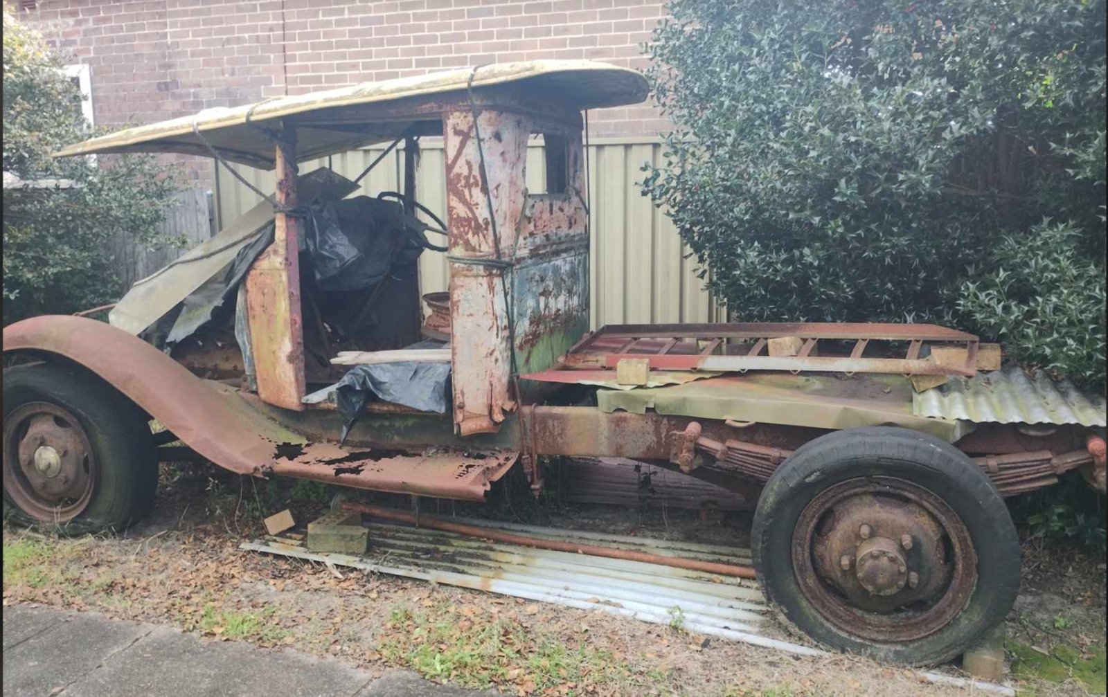

    Thanks for all the feedback, I had overlooked some important information about the truck, so I have included a couple of images as clues.
    EAD51B8A-C60C-4EE8-88EA-A7807B8A946B.jpeg C6E74595-DD42-4D66-A060-BE526237ADAE.jpeg
