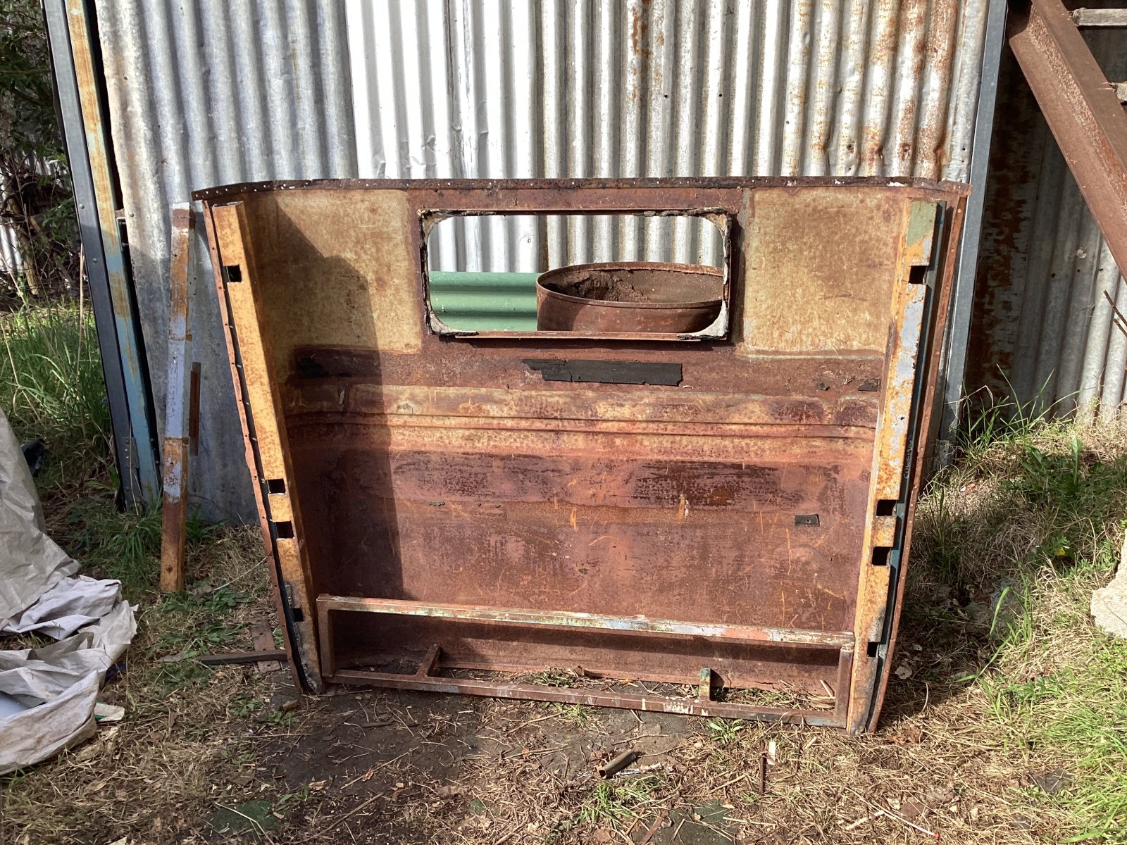

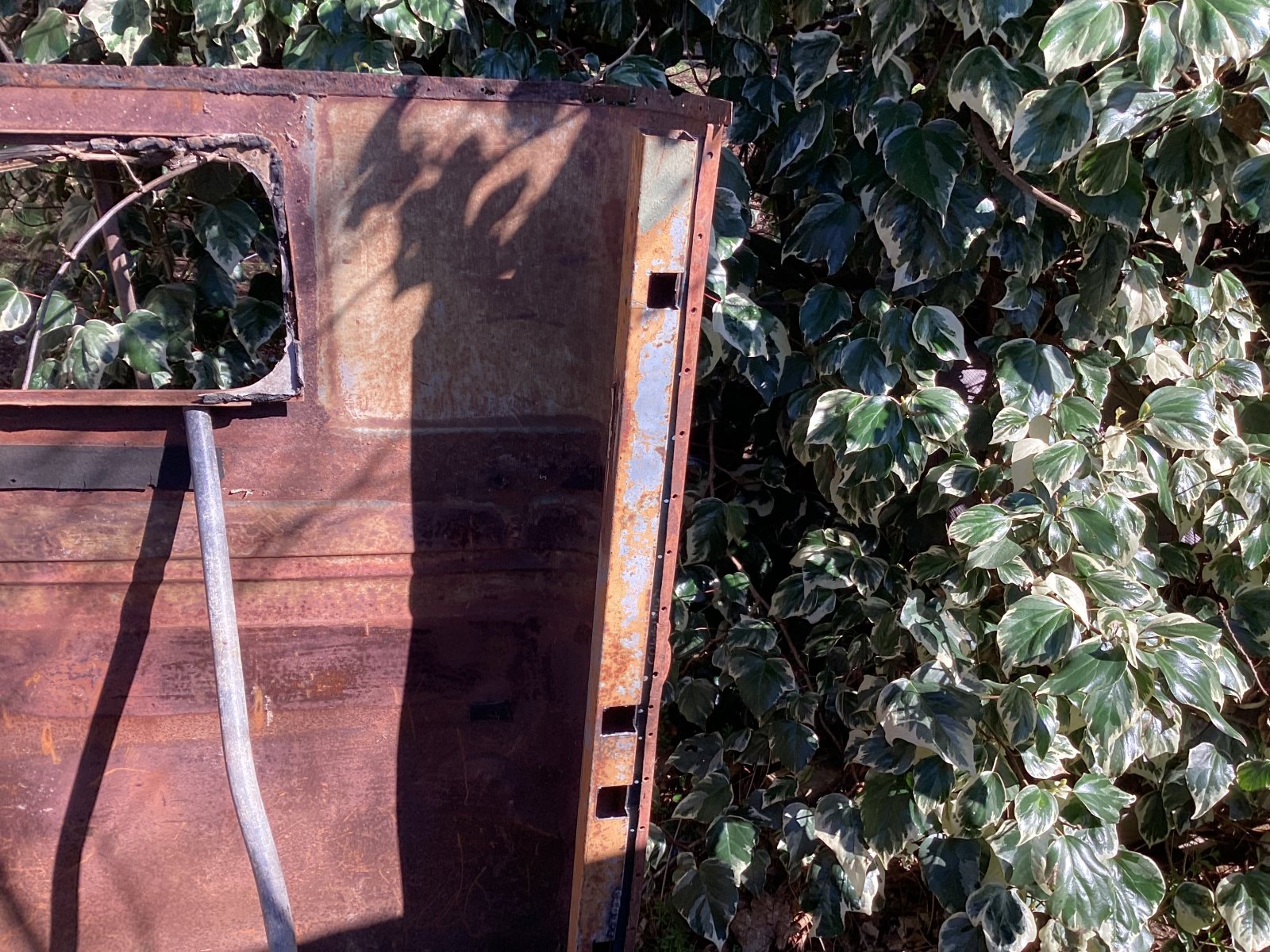

    Hey Guys.

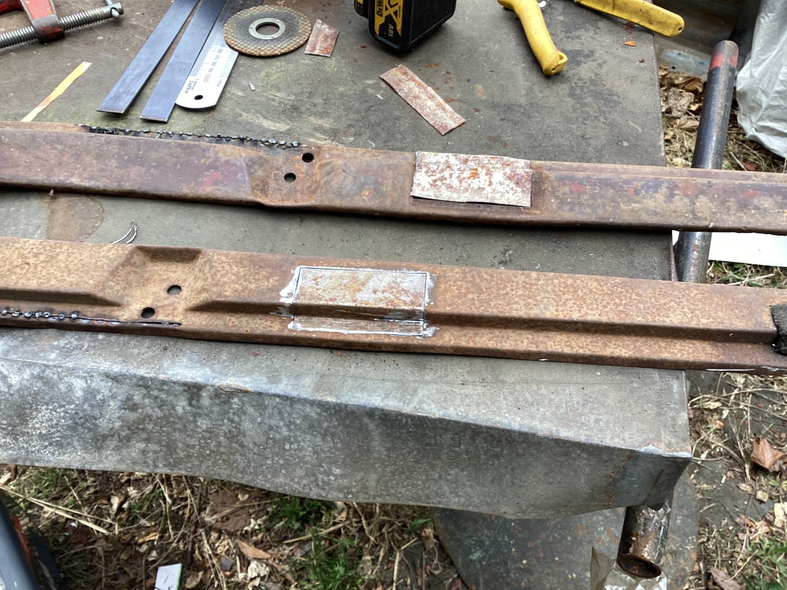

    After repairing the bottom of the cab, I was going to move onto doing the rest of the sub rails where it curves around the base of the cab.
    This is what I had in mind.

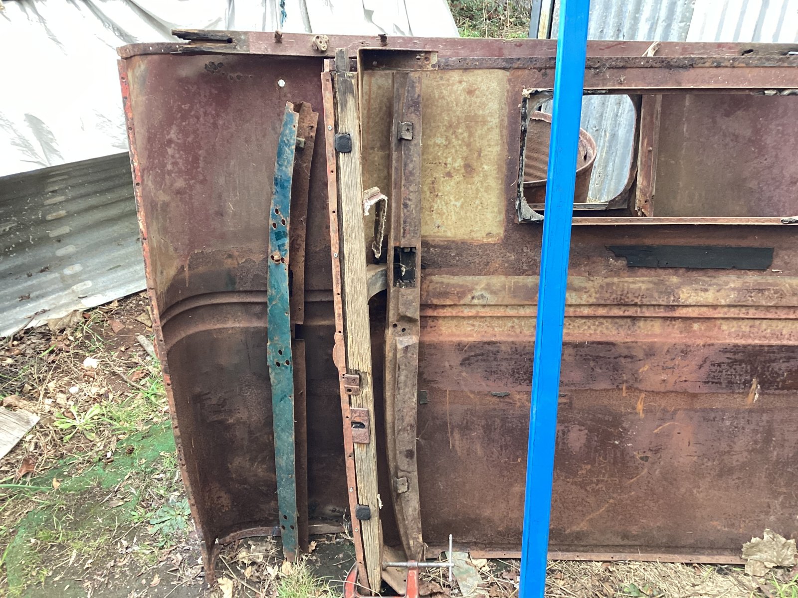

  6. chev34ute
    Joined: Nov 13, 2011
    Posts: 1,525
    chev34ute

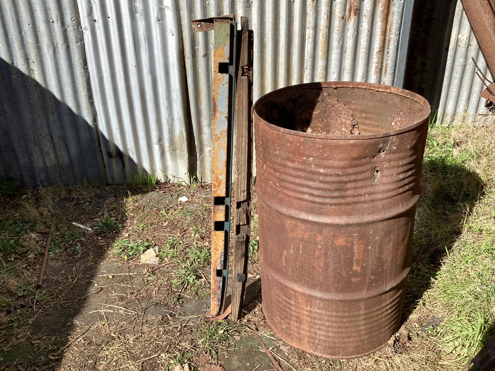

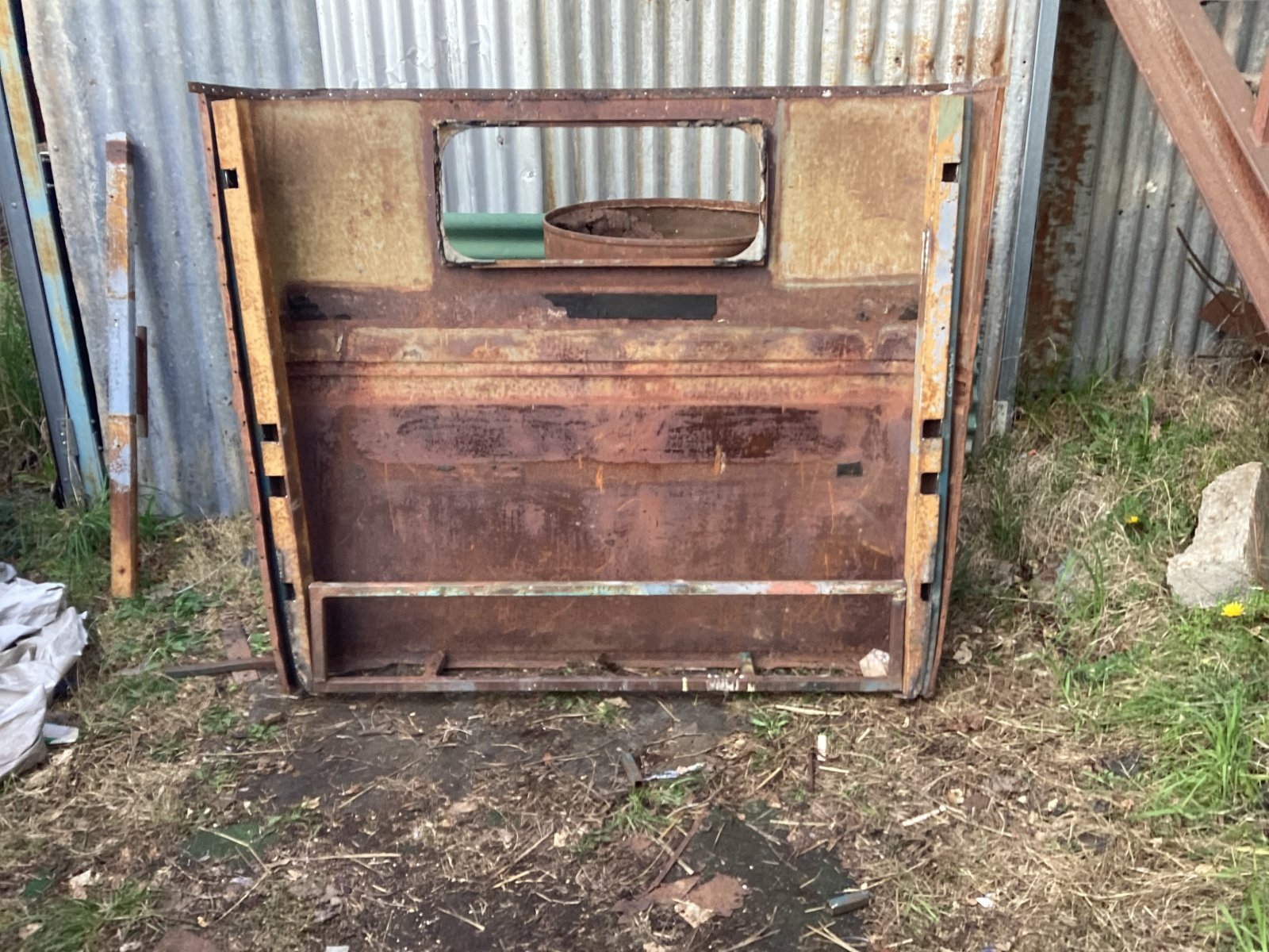

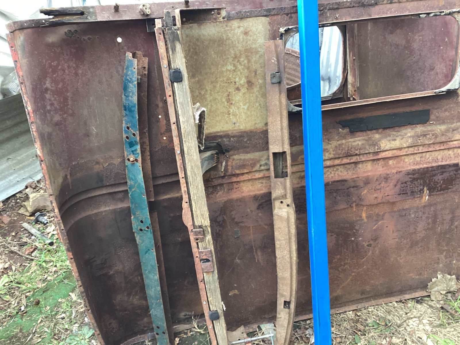

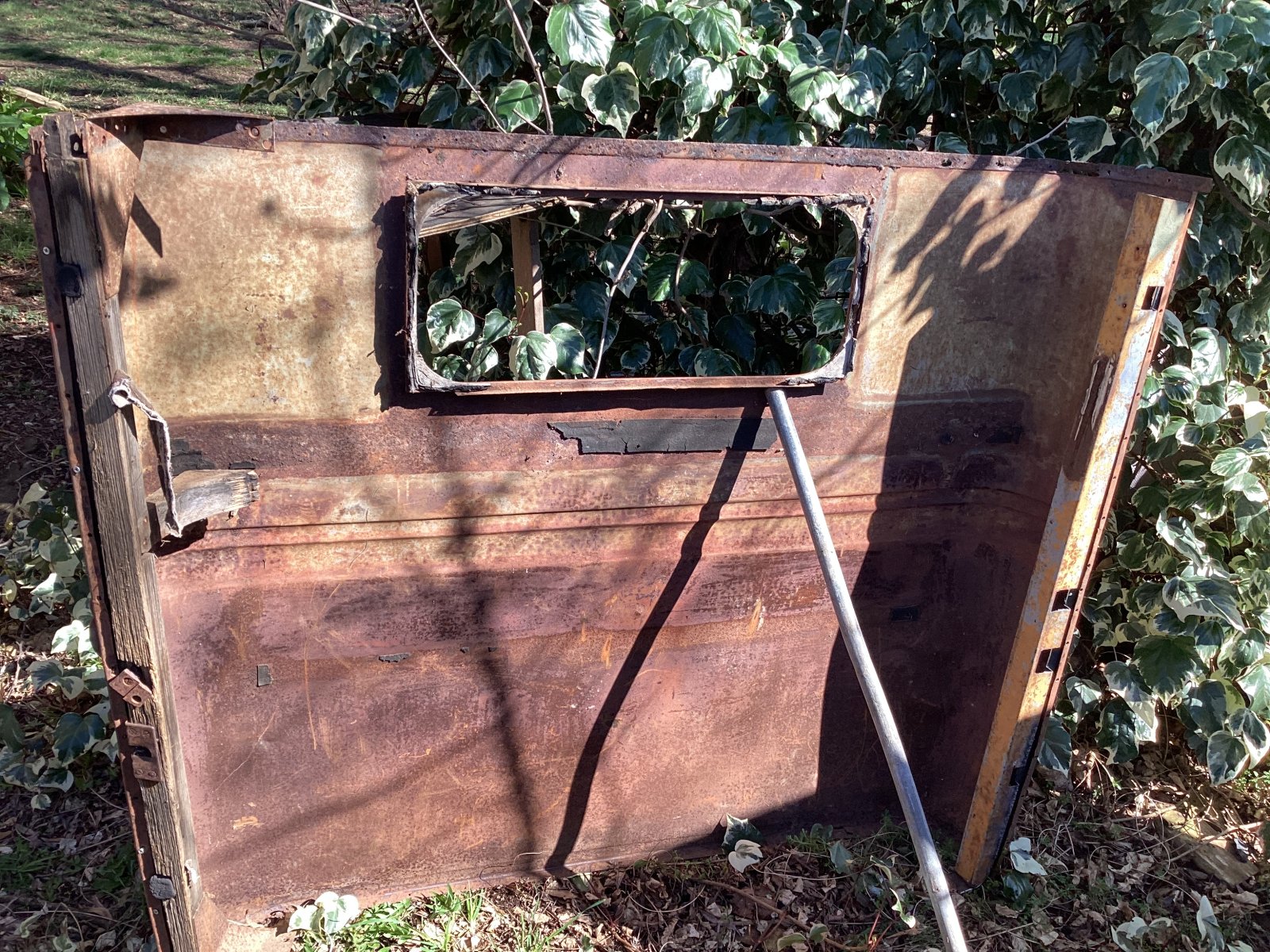

    But before I could do that there was a major problem I needed to address, so I dragged the two cabs out to make a comparison.

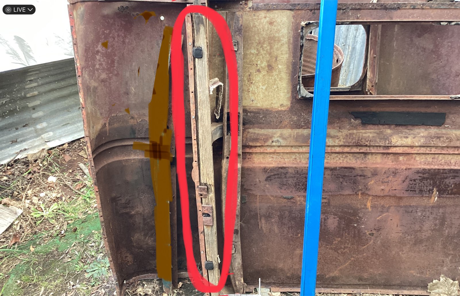

  7. chev34ute
    Posts: 1,525
    chev34ute

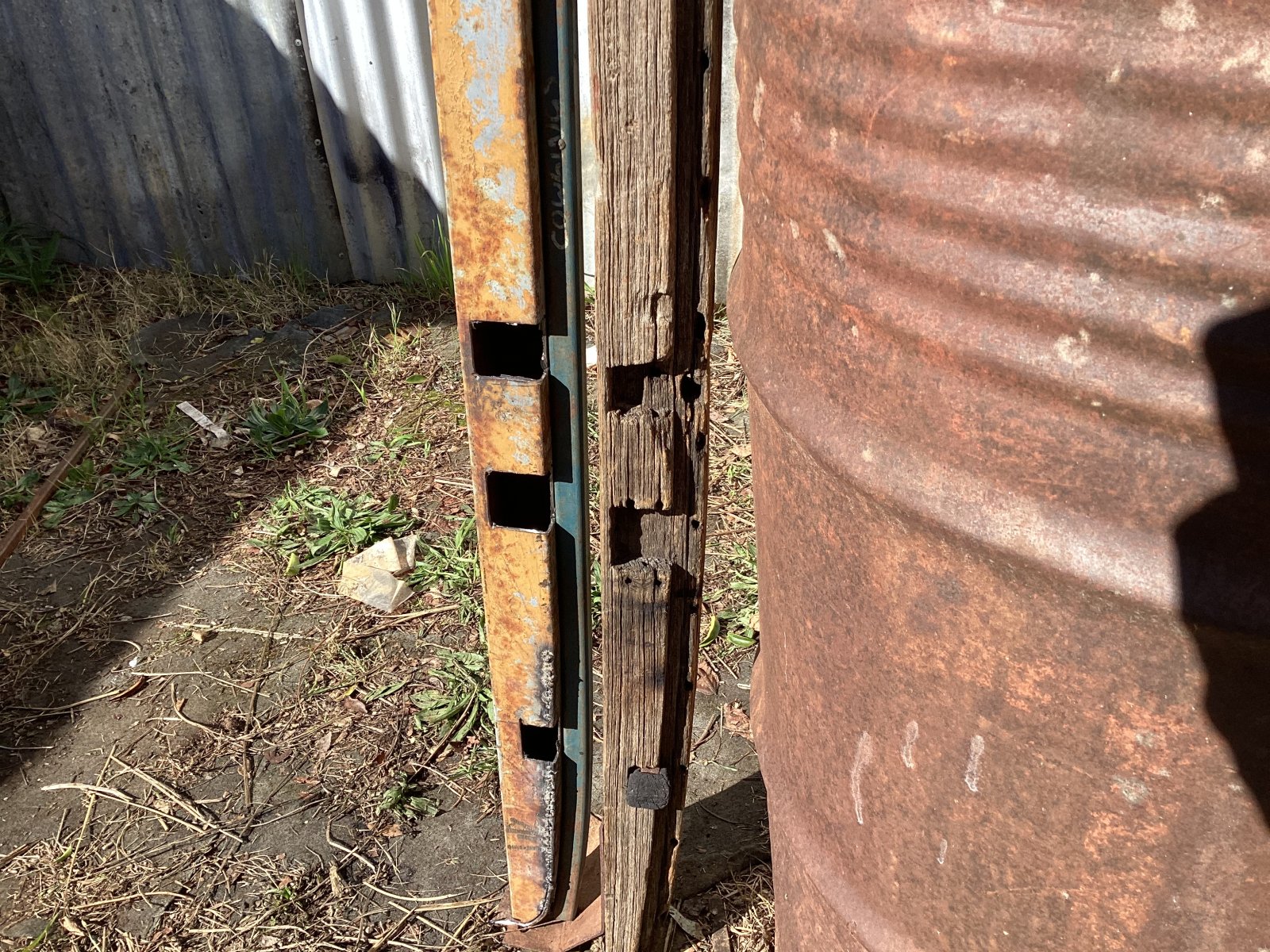

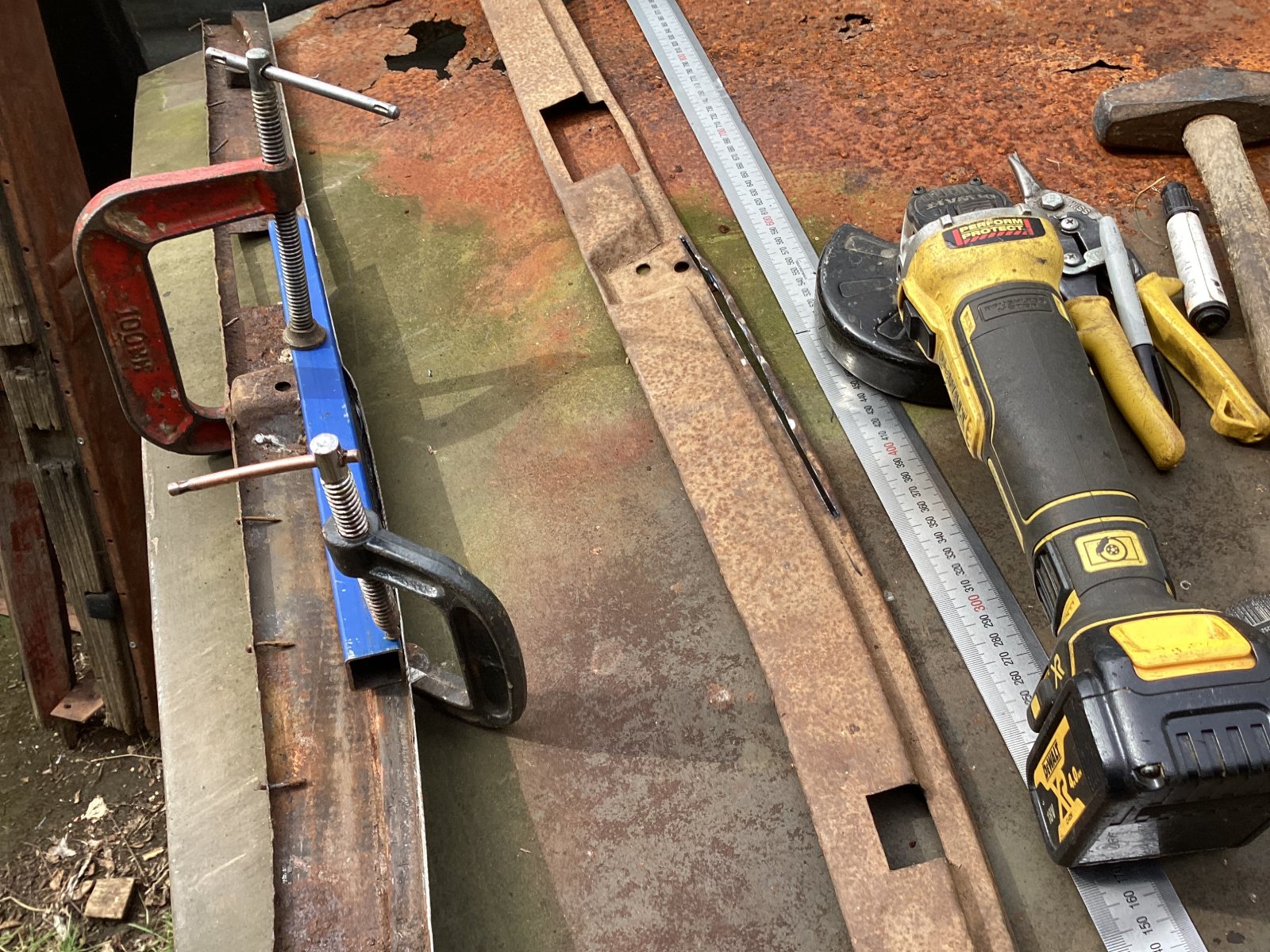

    Like their GM counterparts, Ford Australia still used mostly timber framing in their bodies in 1934. And that included in the b pillars, but the main difference between the local Fords and GM’s was The Fords did not have steel cover strips. I want to replace all the timber with rectangular hollow section, but I wanted to cover it over so I had an idea.

  8. chev34ute
    Posts: 1,525
    chev34ute

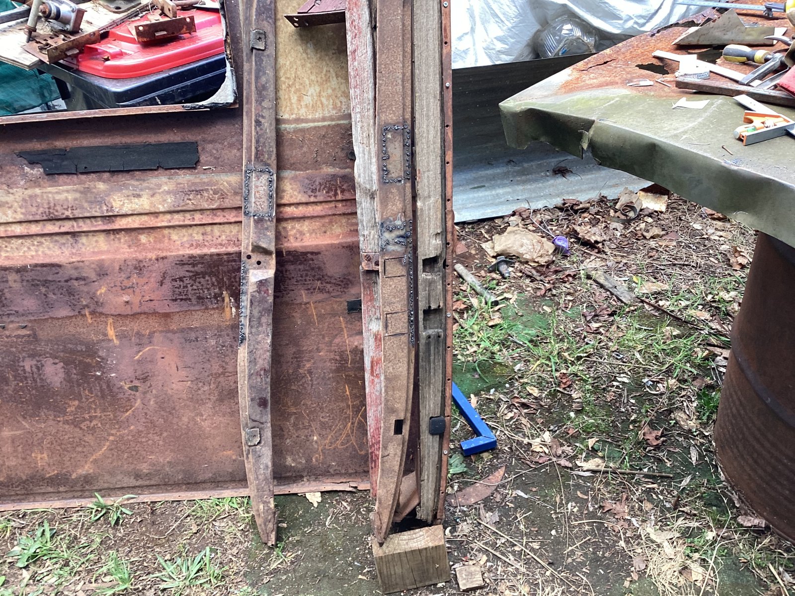

    I have a corner shed with 34 Chev and Oldsmobile parts, these were collected when I still had the Chev Ute. I always had the intention of selling it all on, but over the years I found myself using some of the panels for other project. Then I remembered the remains of the Oldsmobile body still had an intact B Pillar. Being a four door sedan, I knew I could split it to make a pair of covers strips.
    Once split I placed it beside the Ford B pillar to see how different they were.
  9. chev34ute
    Posts: 1,525
    chev34ute
    Aside from the locations of the latch housing and striker plates and tighter radius along the bottom and bulging outer edge below the swage, the two were remarkably similar. So I set about changing the Oldsmobile cover strips to match the profile of the Ford B Pillars.

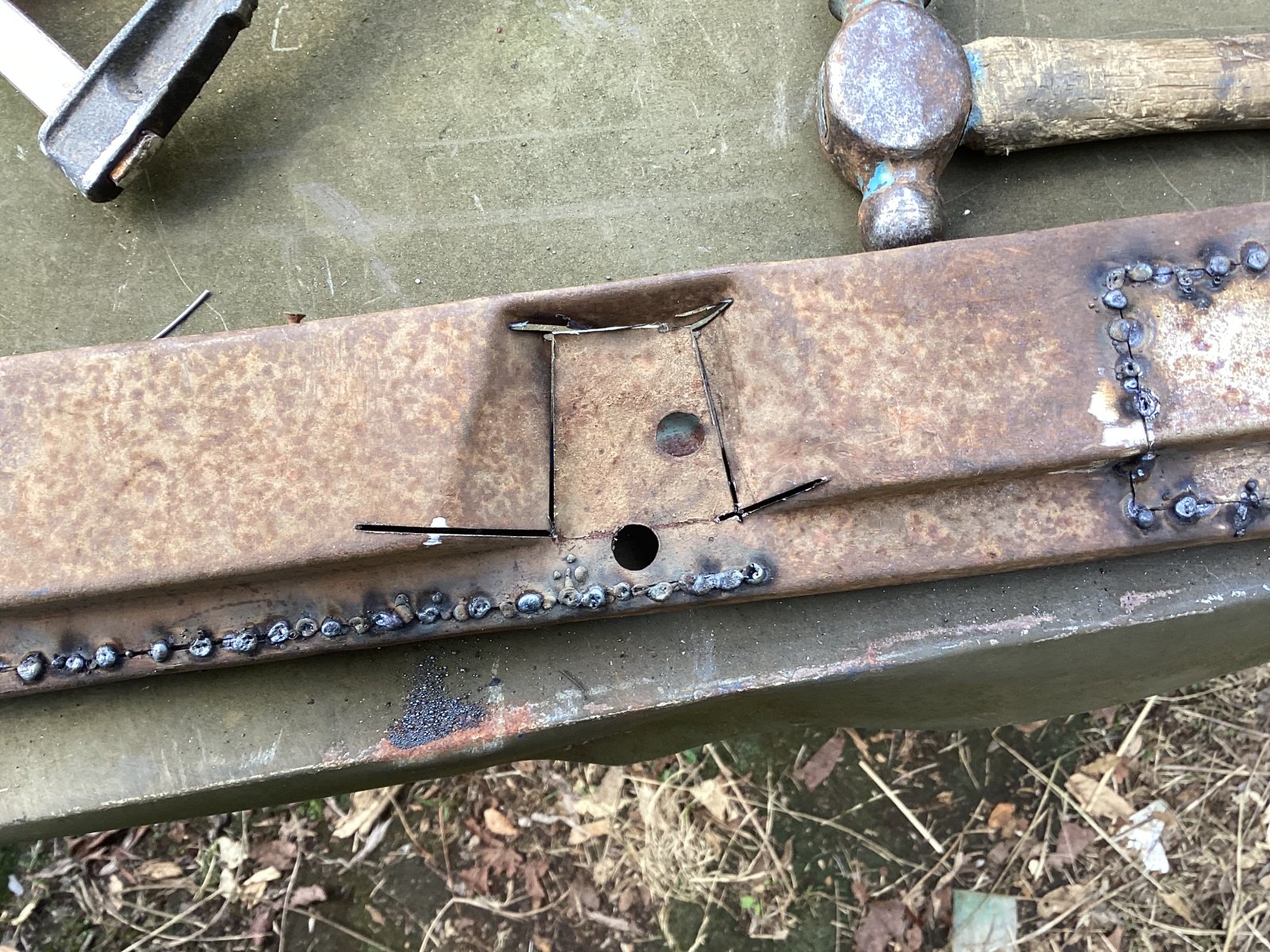

  10. chev34ute
    Posts: 1,525
    chev34ute
    The first task was to remove the bulge along the bottoms of the cover strips by grinding out a line of the metal and hammering them back in line with the upper edges. The second task was to fill the latch housings. I used a combination of clamps and vice to hold them in place while re-welded them.

    The other issue was what to do with the recessed striker plates, so I came up with an idea.

  14. chev34ute
    Posts: 1,525
    chev34ute
    By cutting along the stamping lines I was able to flatten the recess back out. I then filled the remaining hole with a fresh piece of metal. With that done, I moved onto cutting out the new housings, by using the Ford B pillars as a guide.

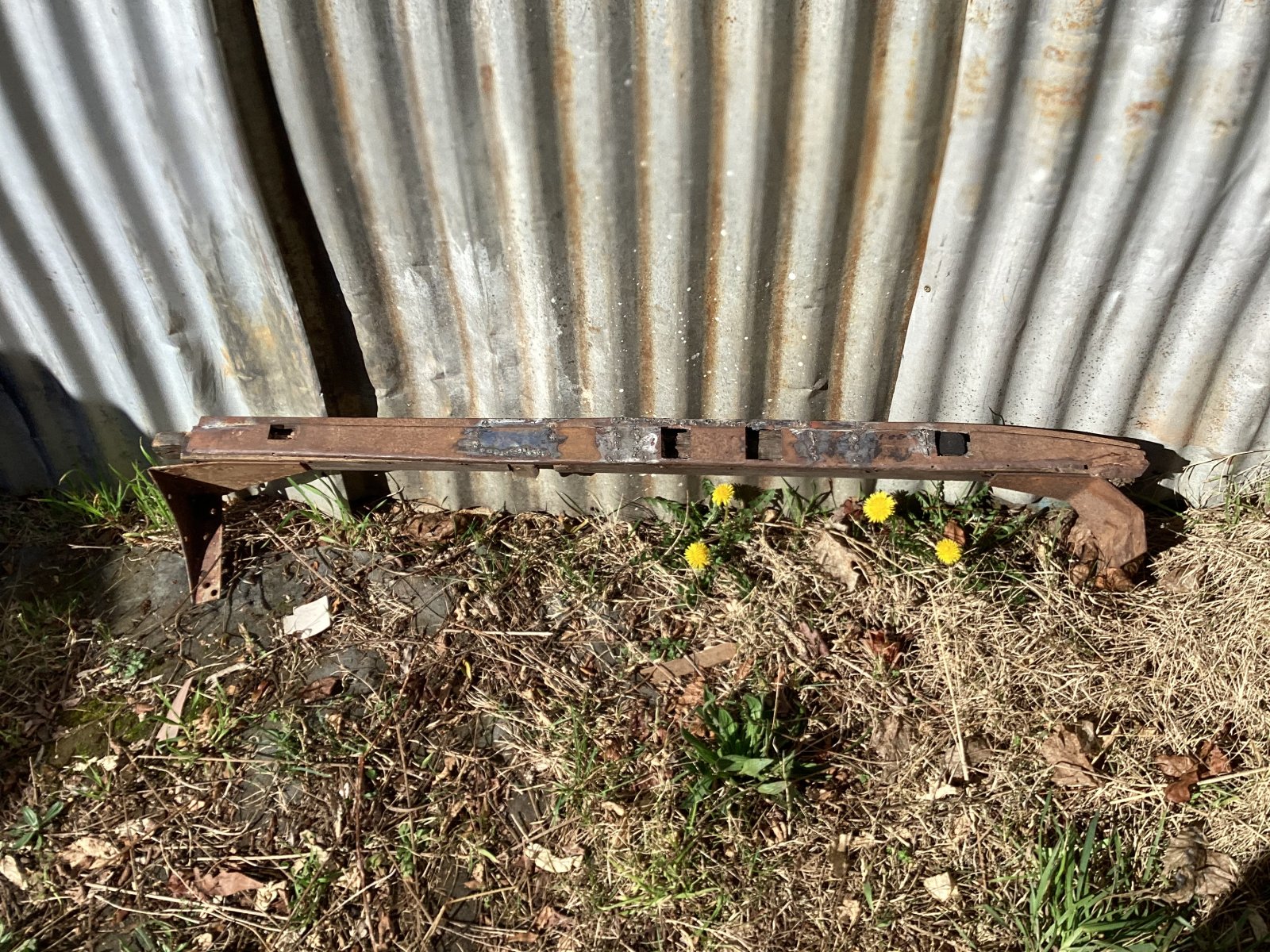

  15. chev34ute
    Posts: 1,525
    chev34ute
    The remaining task was to reshape the lower radius, so it was less severe than Ford ones. To do this I notched it on two places, placed it over the timber b pillar, clamped it an welded it. It was dark by the time I had done that so I moved it inside where I could photograph it easier. The steel one is on the right. The length of 2x2 RHS on the far left was what I was going to use as the actual pillar but 3mm, the wall thickness is too hard to work with, so I most likely purchases some 2mm wall thickness lengths.
  16. chev34ute
    Posts: 1,525
    chev34ute
    Hey Guys.
    After many hours, I was finally able to finish welding all the cuts on the cover strip. It’s now sitting inside the B Pillar.

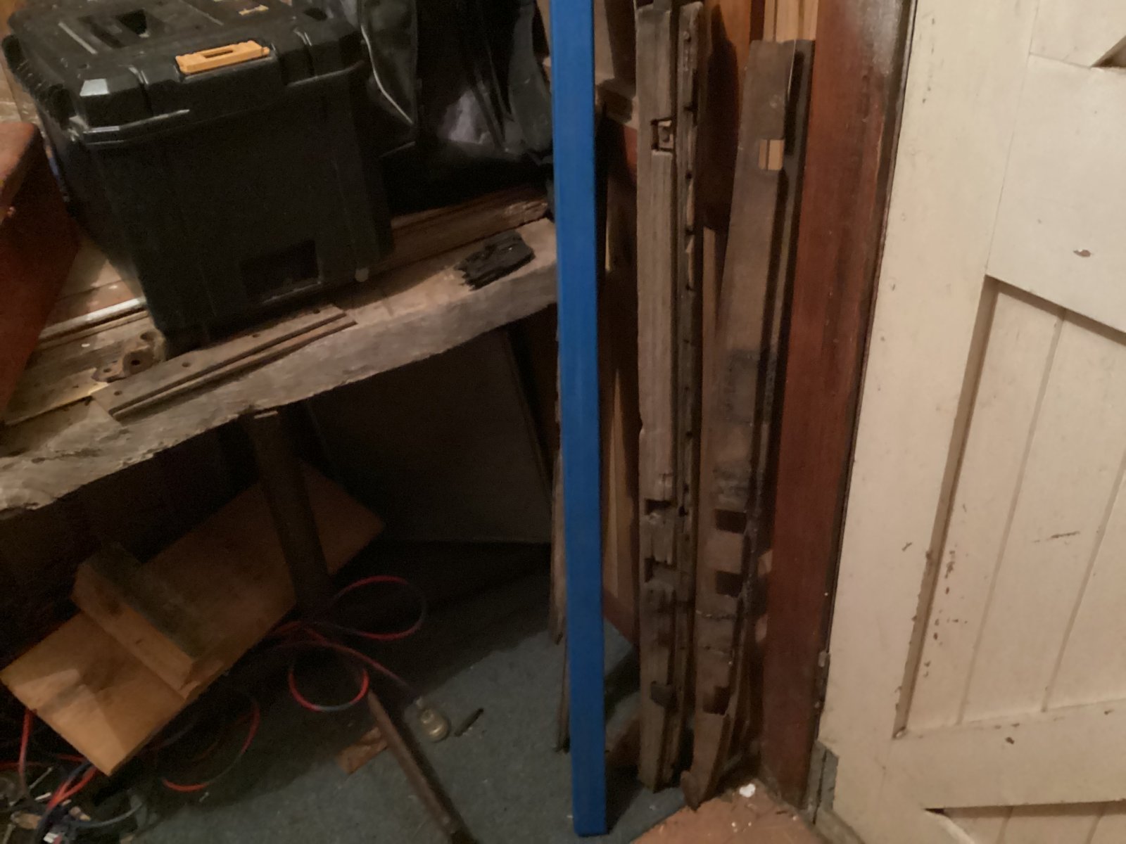

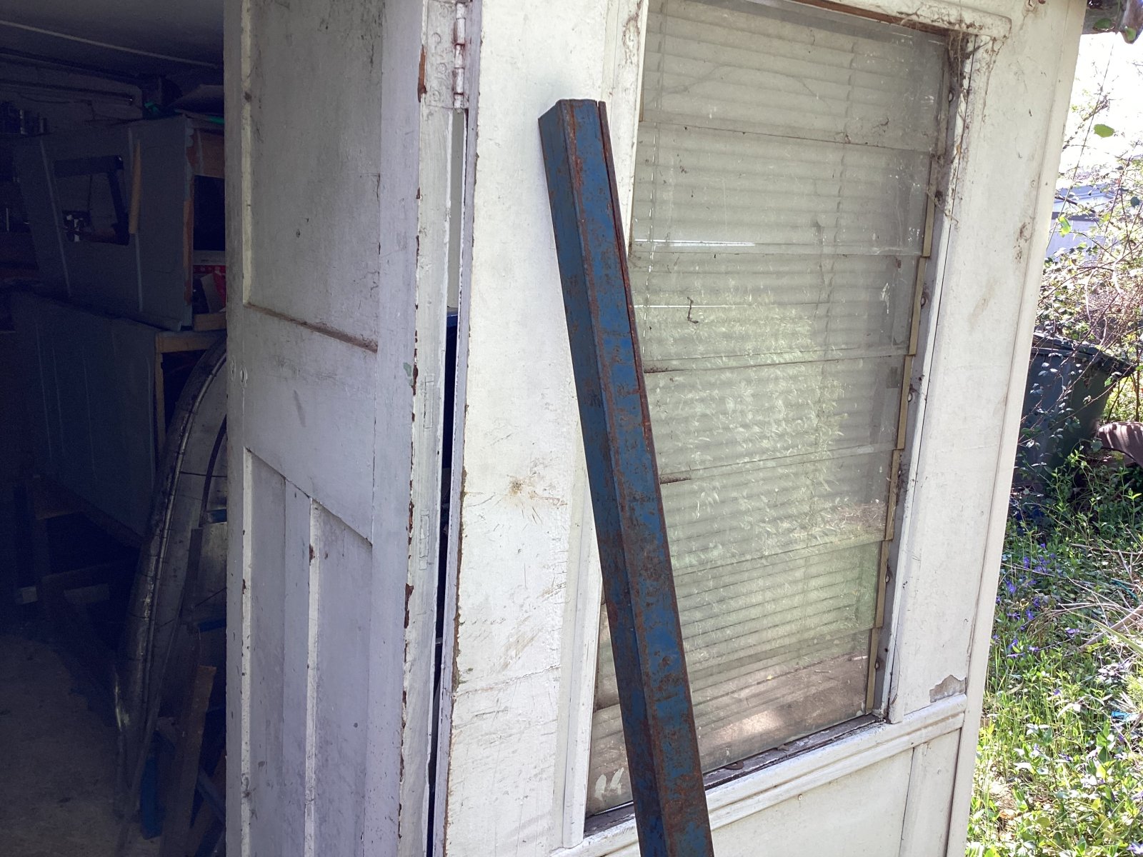

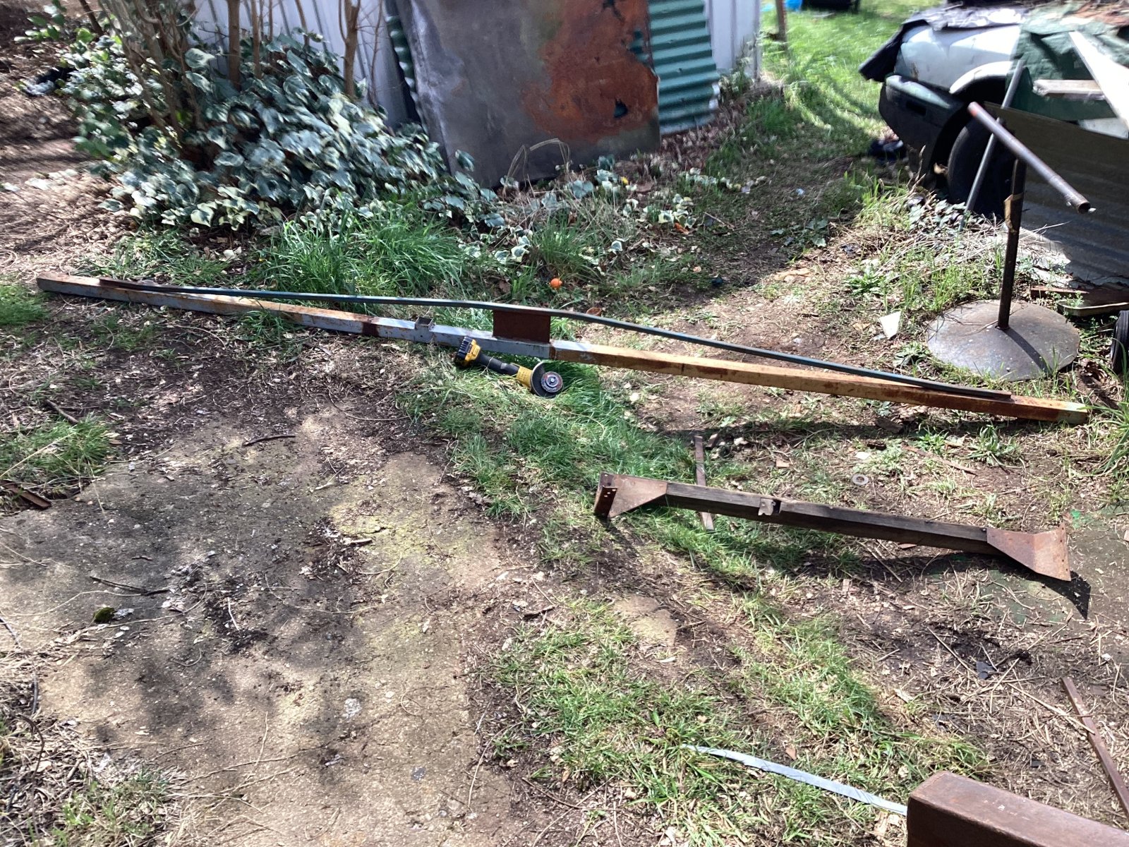

    I’m only getting at most a couple of days a week to work on it, so it’s very slow going and I still have to finish the other side. The other thing I need to do once that is done is move onto the b pillars themselves. As I outlined earlier, the original ones are made of timber, and while still very solid, especially with the cover strips fastened in place, I want to replace them with steel.

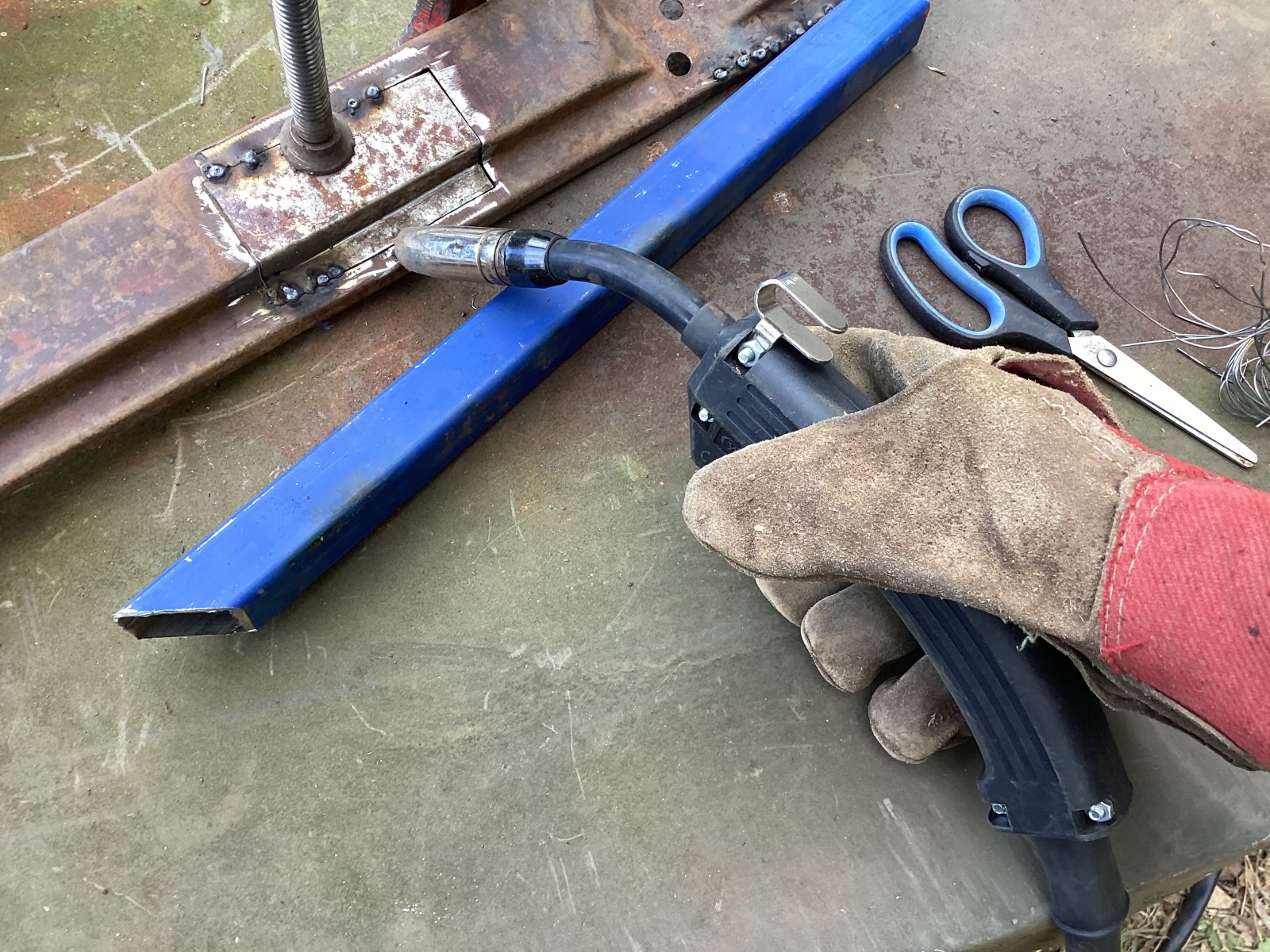

  18. chev34ute
    Posts: 1,525
    chev34ute
    I was going to use 3mm walled 2x2 Rectangular Hollow Section that’s pictured to the right until I realised it was much heavier than I wanted, and also harder to cut through, so I have settled on 2mm walled RHS instead. The dimensions are almost the same as the timber originals. The difference will be the need to notch the bottoms to match the profiles of the originals and cutting away the inside edge and reversing it to match the stepped profile of the originals. 009EDBDB-67BB-4C45-B6C9-FEE083704B9C.jpeg

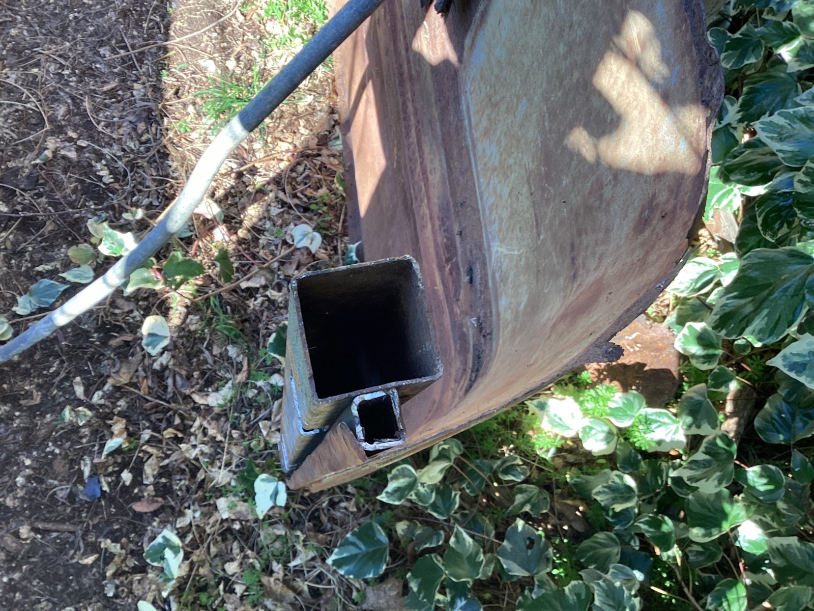

    Hey Guys.
    I am moving on to the next stage, I decided early on that every last strip of timber would be replaced with steel. And the first area to be addressed would be the B Pillars. I intended to use 2mm walled 2x2 RHS for this, but had a truss from an old shed lying around that while the same outside dimensions had a slightly thinner wall thickness at 1.6 mm.

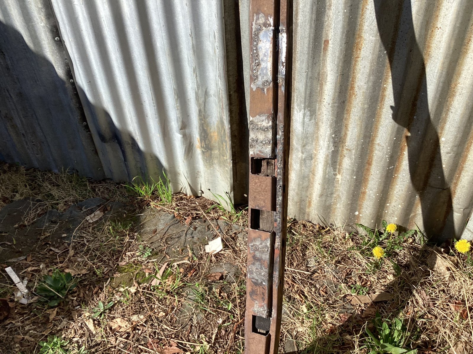

  21. chev34ute
    Posts: 1,525
    chev34ute
    After cutting two identical lengths, I marked out and cut all the holes for the latch and striker plate locations, by using the original one as a pattern. A34F2E36-BAA9-45FF-9E02-EE324E5D2C4D.jpeg

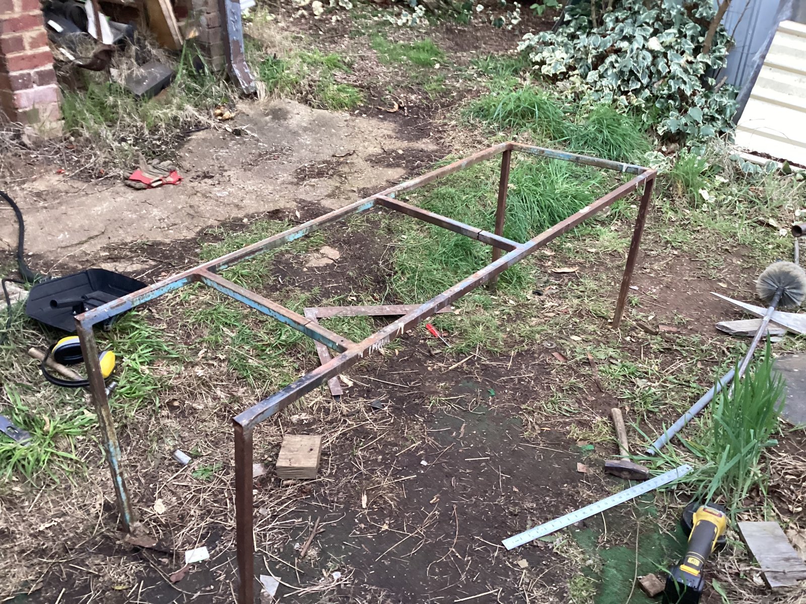

  25. chev34ute
    Posts: 1,525
    chev34ute
    Hey Guys.
    I got a bit more done yesterday. After finishing off the other b pillar, I moved onto the cross bracing. I didn’t have any RHS wide enough for the job, so I decided to repurpose this old bench frame.

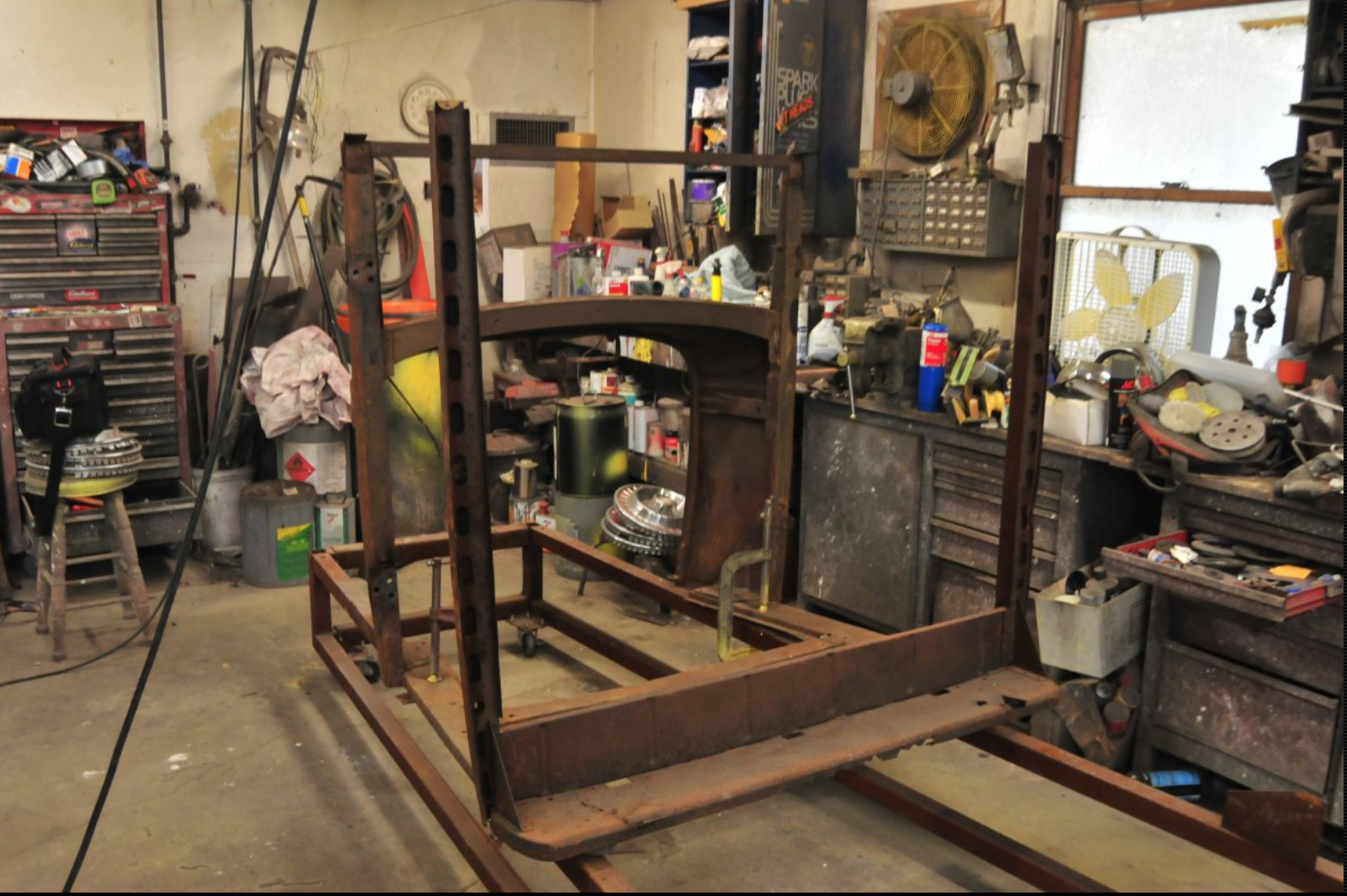

  26. chev34ute
    Posts: 1,525
    chev34ute
    A laid the cab up onto a sheet of corrugated iron sitting on top of a 44 gallon drum with the inside facing up. I then braced it up and clamped the new b pillars into the old ones, effectively creating a makeshift jig.
    Tow Truck Tom and warhorseracing like this.
  27. chev34ute
    Posts: 1,525
    chev34ute
    From there I measured the width and set on 55 at the centre belt line with a gap of 48 between the b pillars at the base. With the latter dimensions, I then cut up the bench frame to the same dimensions, welded one side of the frame up and then proceeded to weld the frame to the b pillar.
