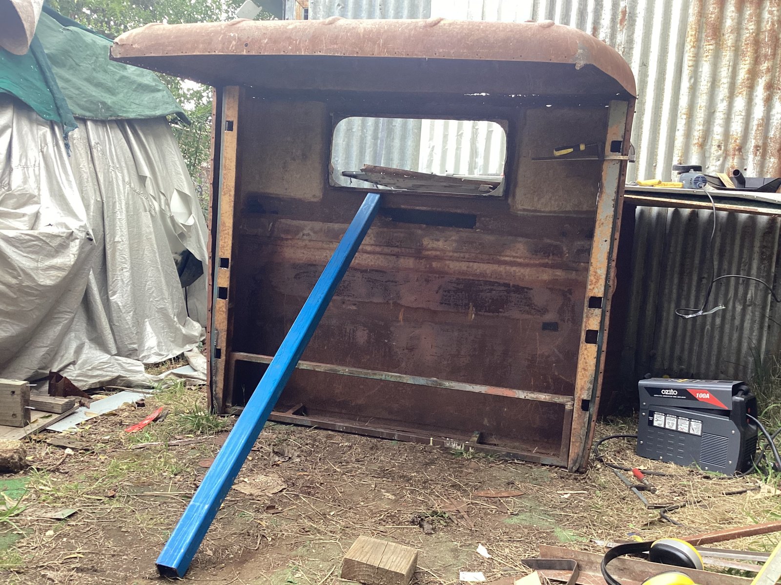

    Another update, not many photos this time but some much needed additions were added. One problem I had was when I welded the b pillars together I realised they were an inch too narrow at the top. I had the width of the cab at 55 1/2 but the b pillars were only 54, so I had to figure out how I would widen them. The other thing I wanted to do was run a piece that tied the two b pillars together. So the first thing I had to do was screw the cab back together to give it some symmetry and rigidity.

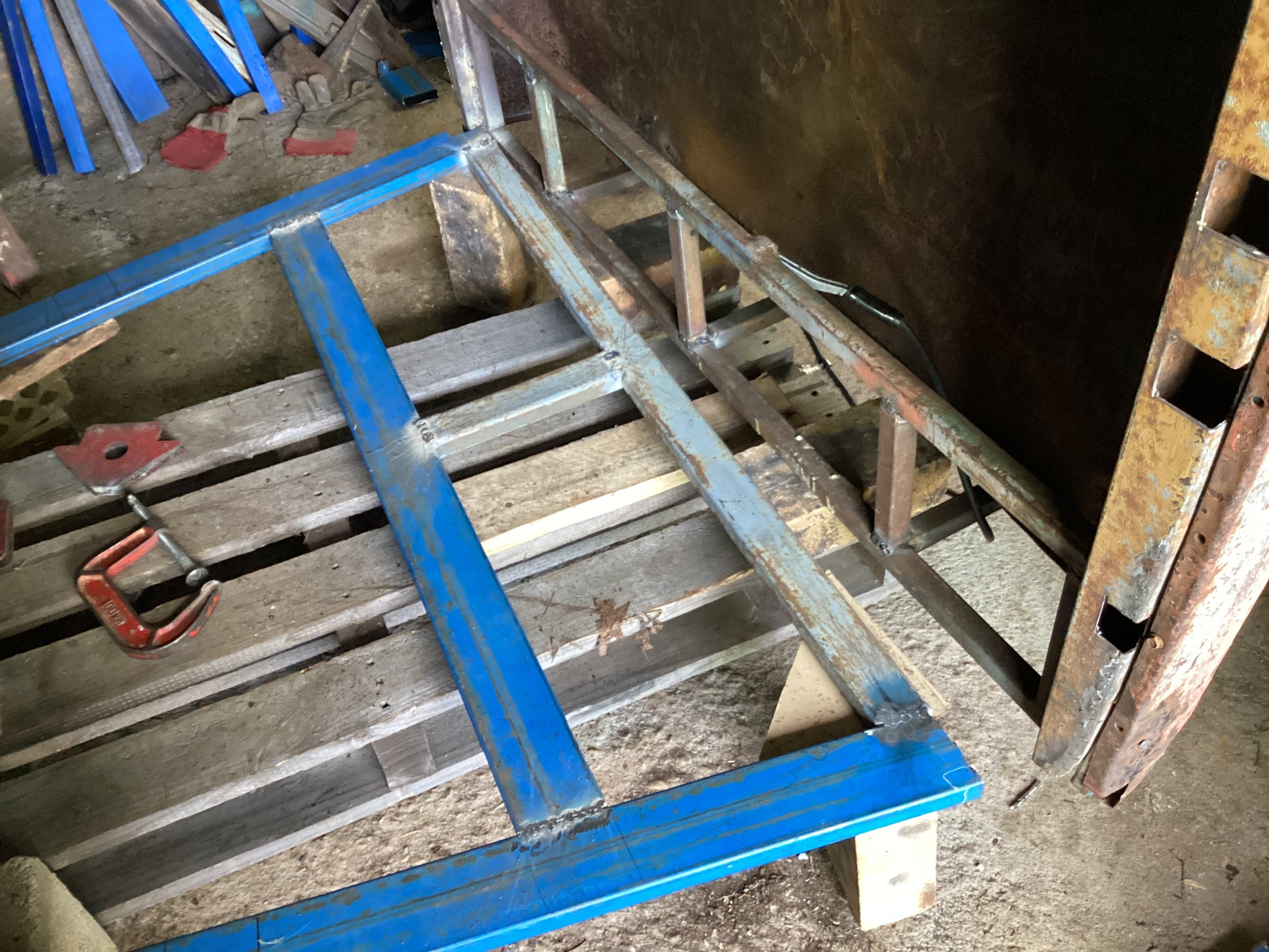

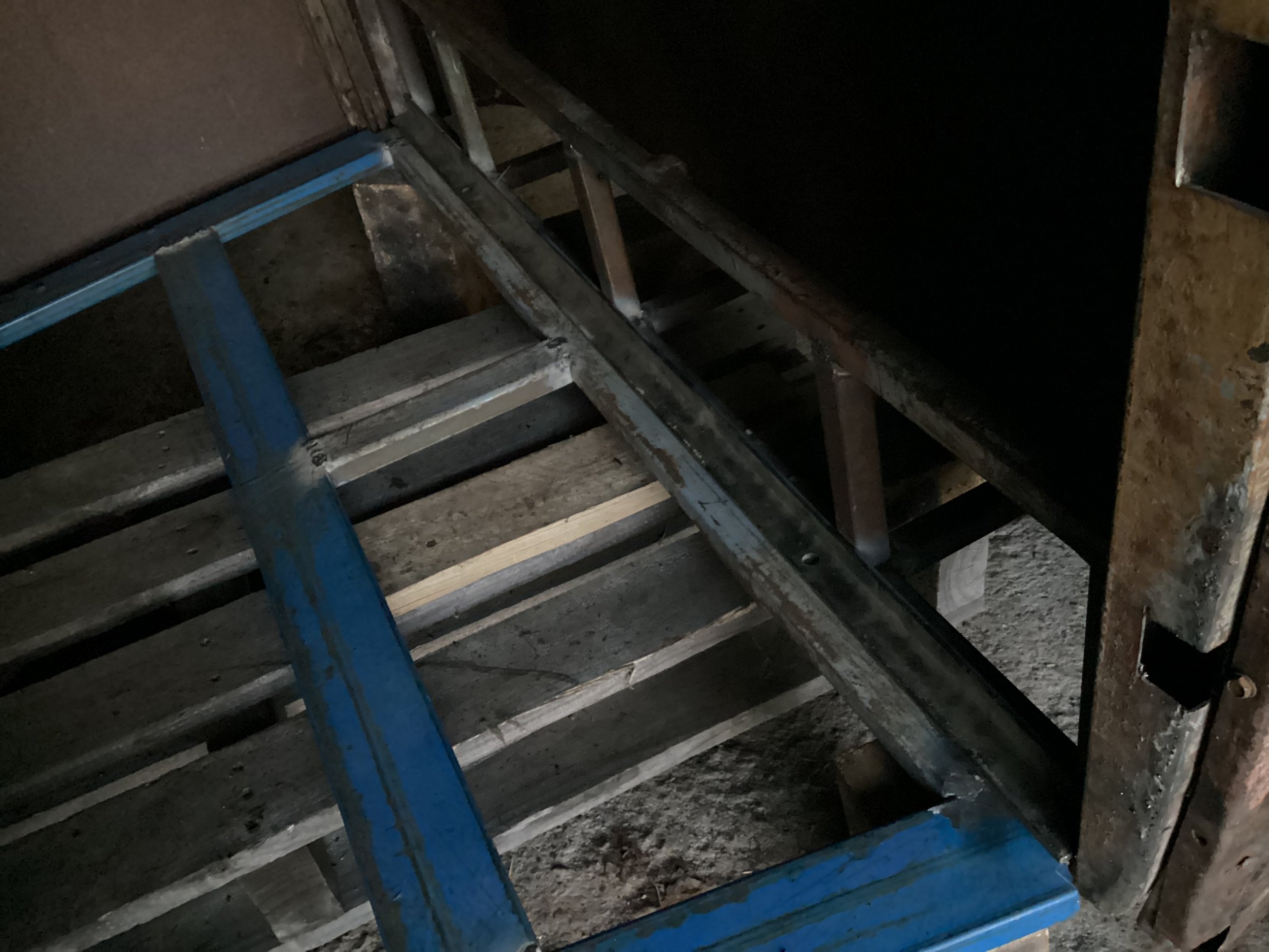

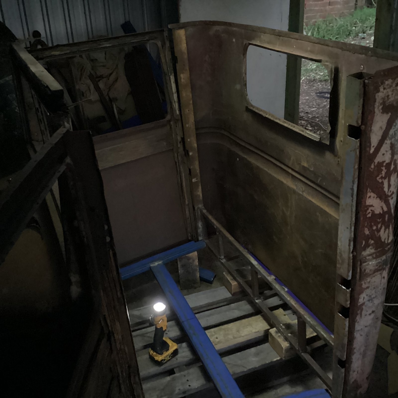

  10. chev34ute
    Joined: Nov 13, 2011
    Posts: 1,525
    chev34ute

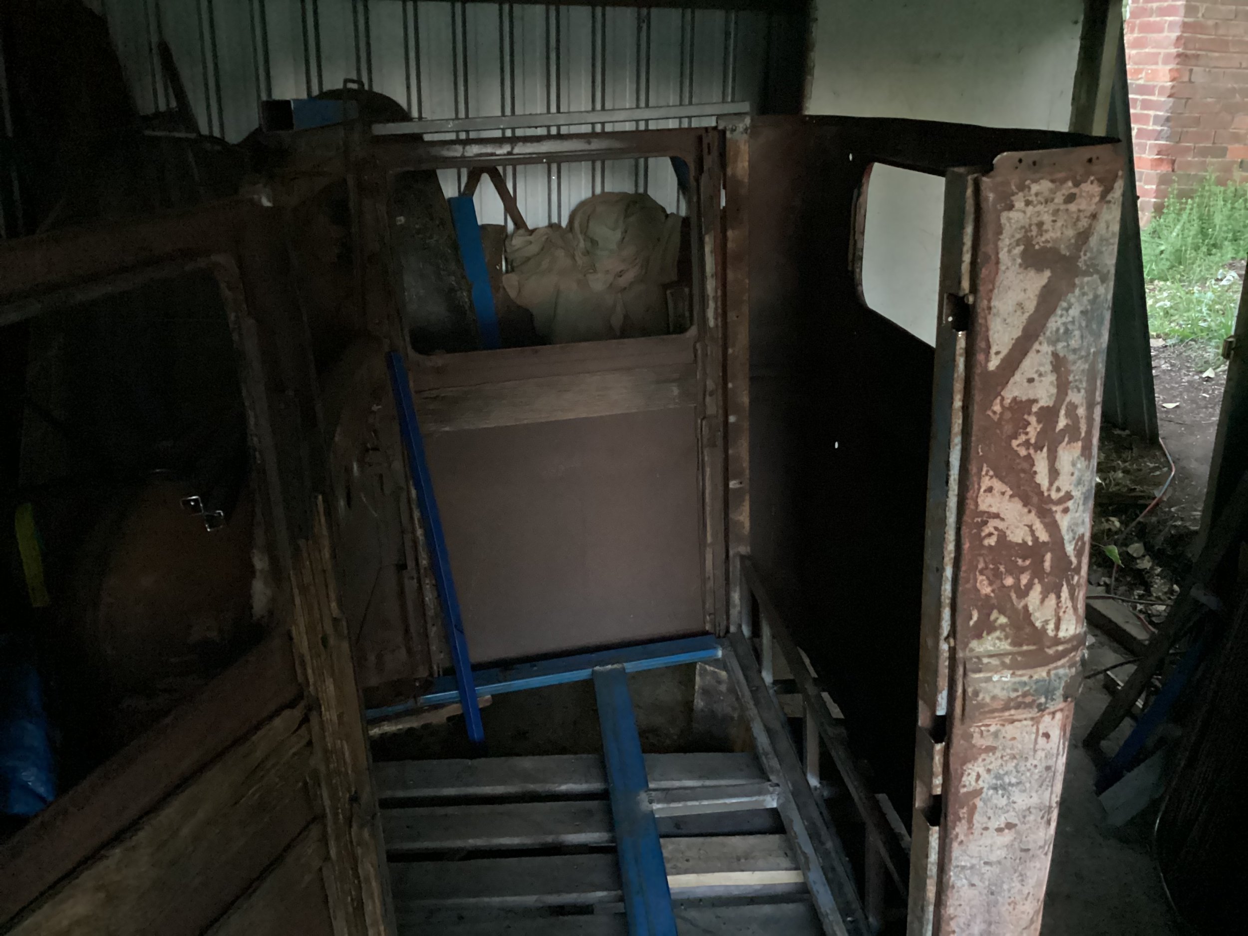

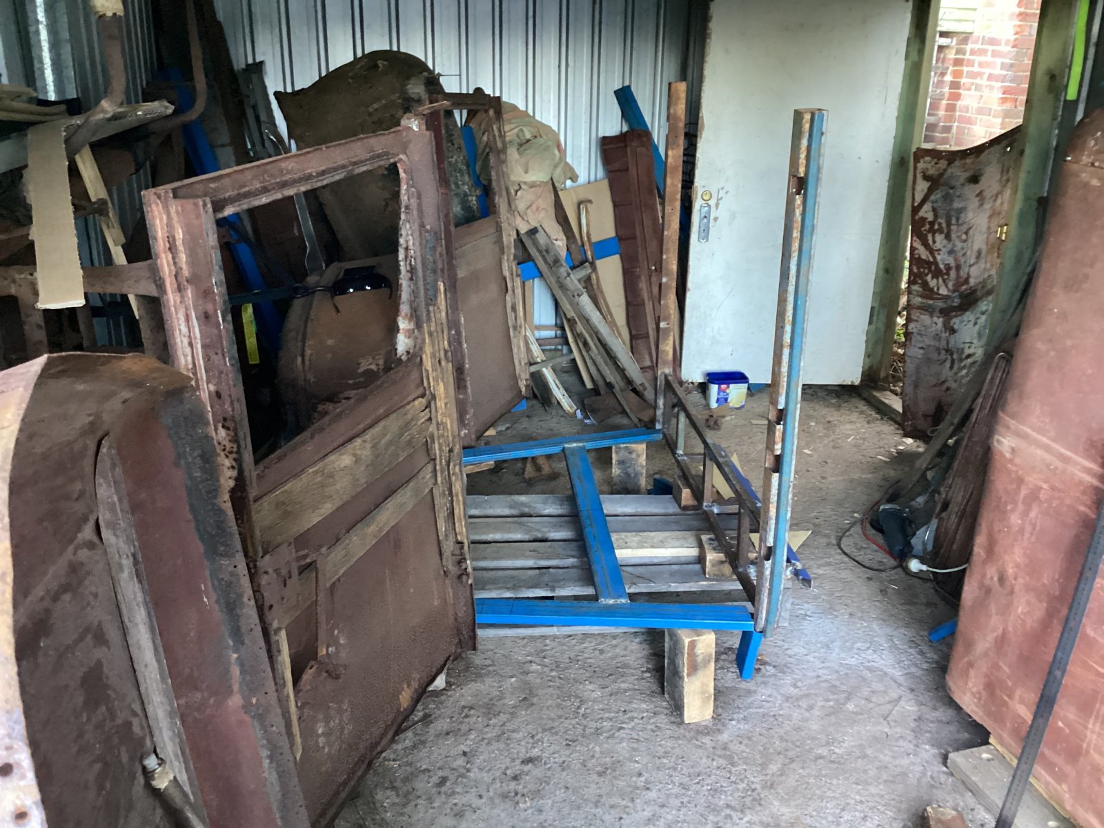

    Hey Guys.

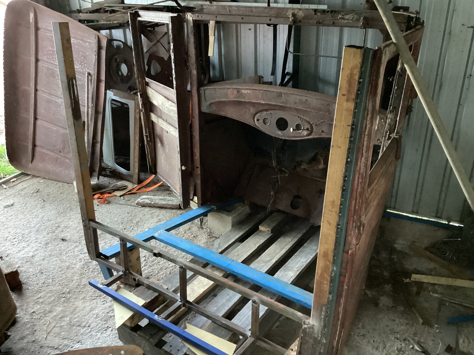

    Another week has gone by and I really wanted tackle the lower part of the frame. With the cab fastened together, I was unenthusiastic about the idea of dragging it through the door. So rather than take it apart, to get it through, I decided I would use the other dis***embled cab to test out the frame. This time around I was able to weld in the remaining joiners along the floor and the vertical ones as well.
    This is what I was aiming for.
    2CEAAB1E-EB4E-4E55-8C39-CDA87F5CF164.jpeg CC28639D-78A7-44DF-89BE-0DD0E9E110D8.jpeg
  11. chev34ute
    Posts: 1,525
    chev34ute
    This is what I ended up with.
    5BF9EA56-05BC-46D3-B656-F8AE8F6C4285.jpeg 2767651A-A249-4D45-9320-C1E61E870F3A.jpeg
  12. chev34ute
    Posts: 1,525
    chev34ute
    Yes I know it’s quite different, but it’s actually a lot stronger using RHS. I will be using sheet metal to cover the vertical frame and the floor.

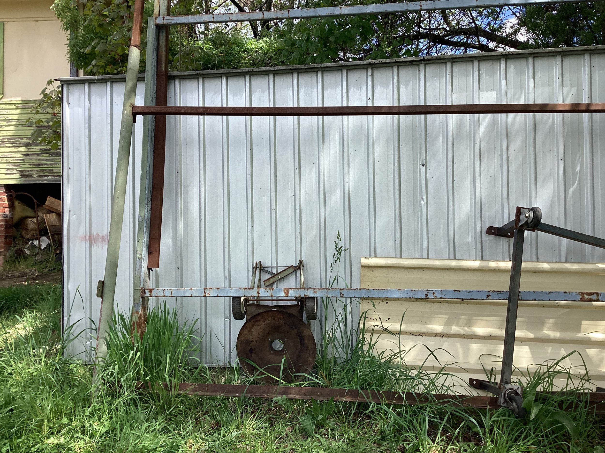

    Hey Guys.
    It seems like the only time I get to work on this is once a week at the moment. I wanted to finish off the sub rails but was scratching my head looking for material, until I remembered the shed frame I was given.

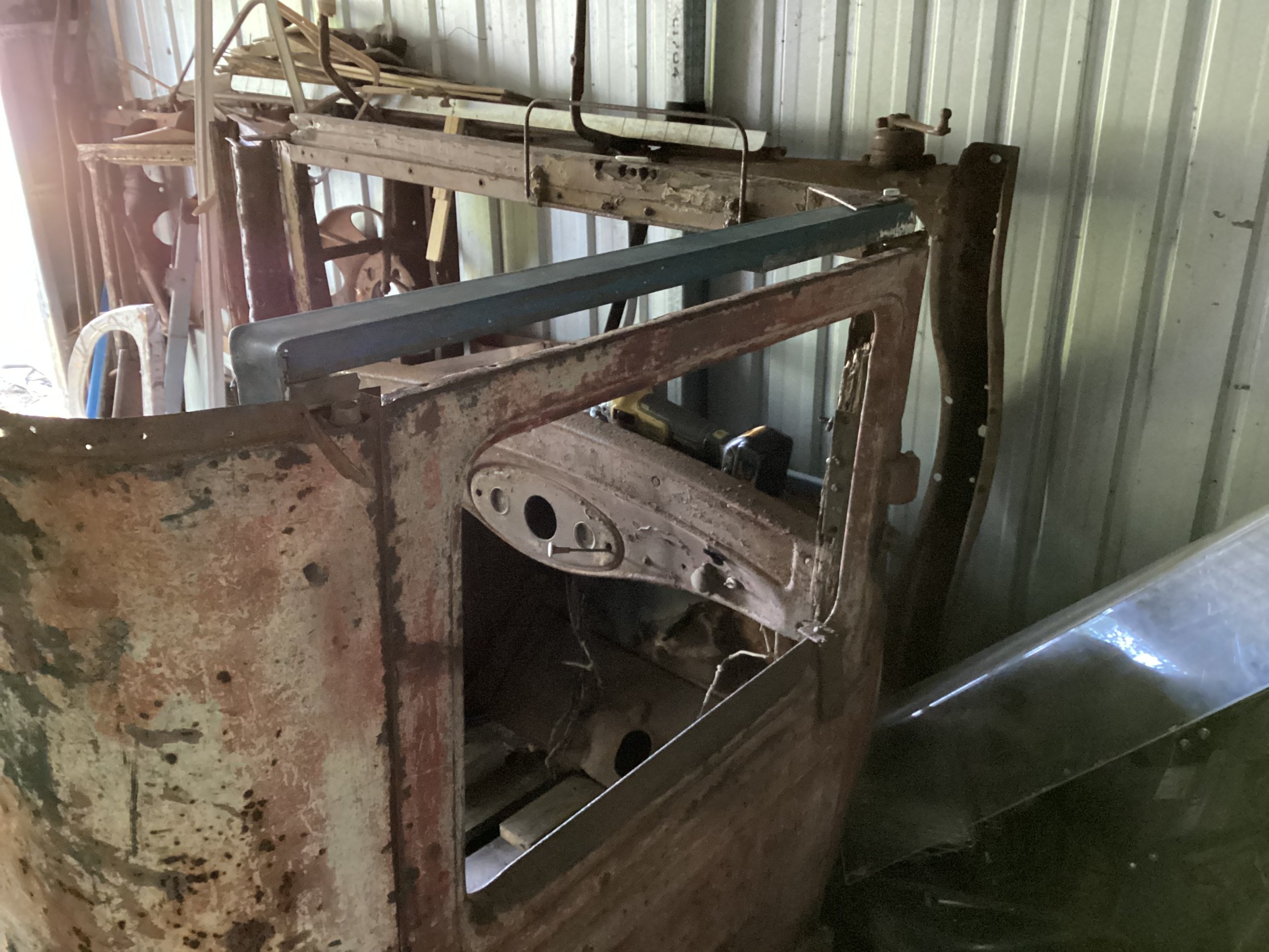

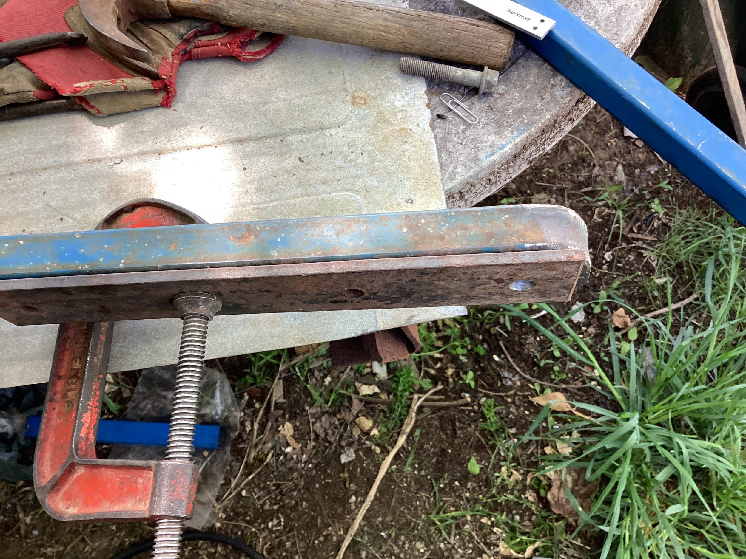

  17. chev34ute
    Posts: 1,525
    chev34ute
    I was trying to figure out how to **** the frame of the cab against the edge of the sub rails, the cab needs to unfasten from the sub rails, so a flange was needed to allow the two bolt together. I had a solid piece of angle lying up in the house that I thought might work but was worried was too short. I brought it down and the measurement was spot on. So it was welded on.
    270A309A-12FE-4967-A423-8A3B276499CF.jpeg 7543B2B6-0625-4A4B-B36E-733E8325F9C8.jpeg

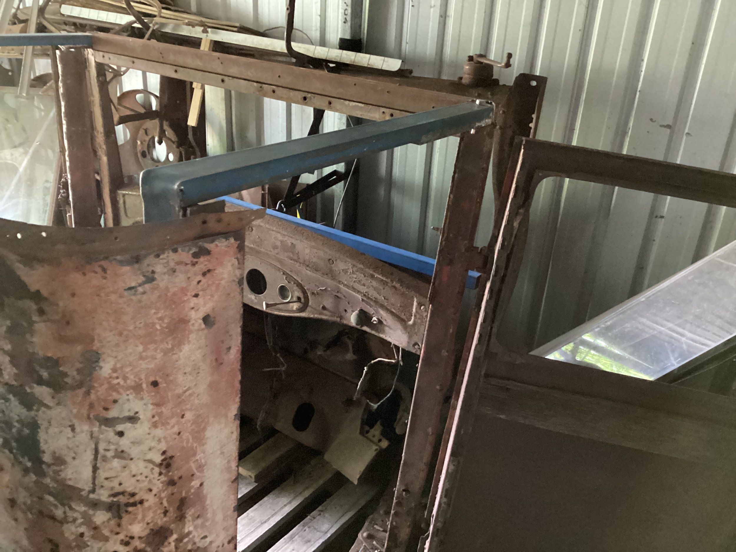

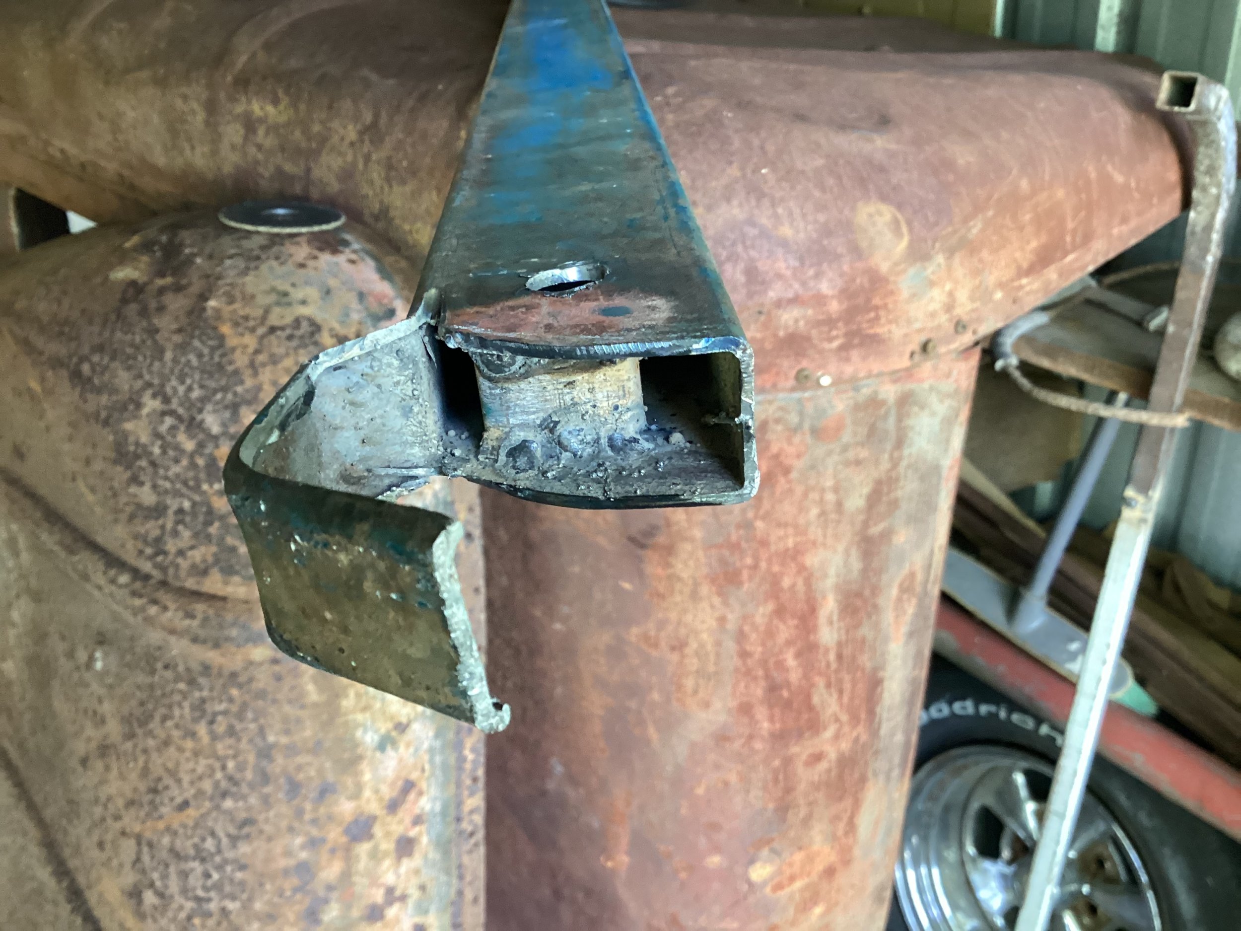

  20. chev34ute
    Posts: 1,525
    chev34ute
    So this morning I settled on the most straightforward approach and that was to use a couple of lengths of 2x1 RHS, they were tapered at the front to follow the flow of the corner. And the front was drilled to allow a 11mm bolt to fasten it to the corner brace above the b pillars. One thing I was worried about was the bolt crushing down on the RHS. To remedy this I got a length of RHS and cut it to the height of the inside of the 2x1, then placed it inside the length, dropped the bolt into it to keep it centred then welded it onto place. F0984231-3E38-446E-9D6B-790CB6773AD8.jpeg
    Okie Pete likes this.
  21. chev34ute
    Posts: 1,525
    chev34ute
    With that done, I closed the tab around the front and welded it up. There was a gap between the upper and lower A pillar corner braces, so I found a couple of lengths of 8mm plate that were pre drilled, lined them up with the holes for the corner braces and frames and clamped them.
    Deutscher and Okie Pete like this.

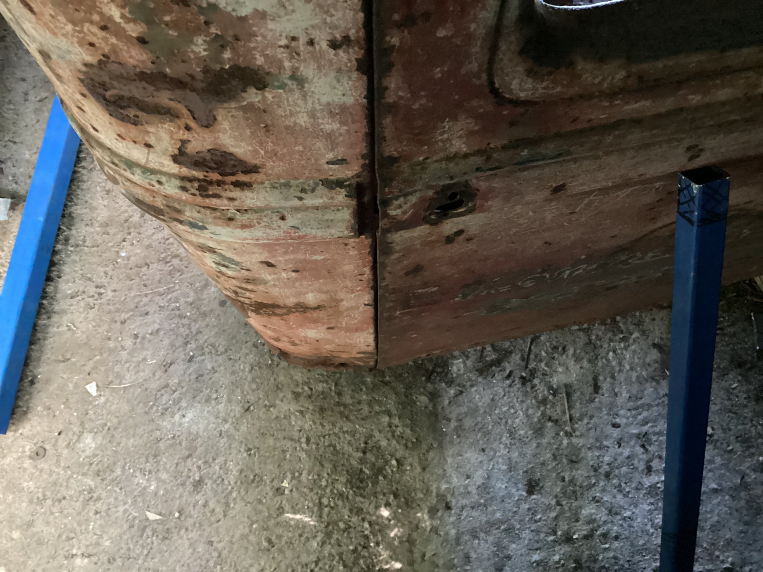

  23. chev34ute
    Posts: 1,525
    chev34ute

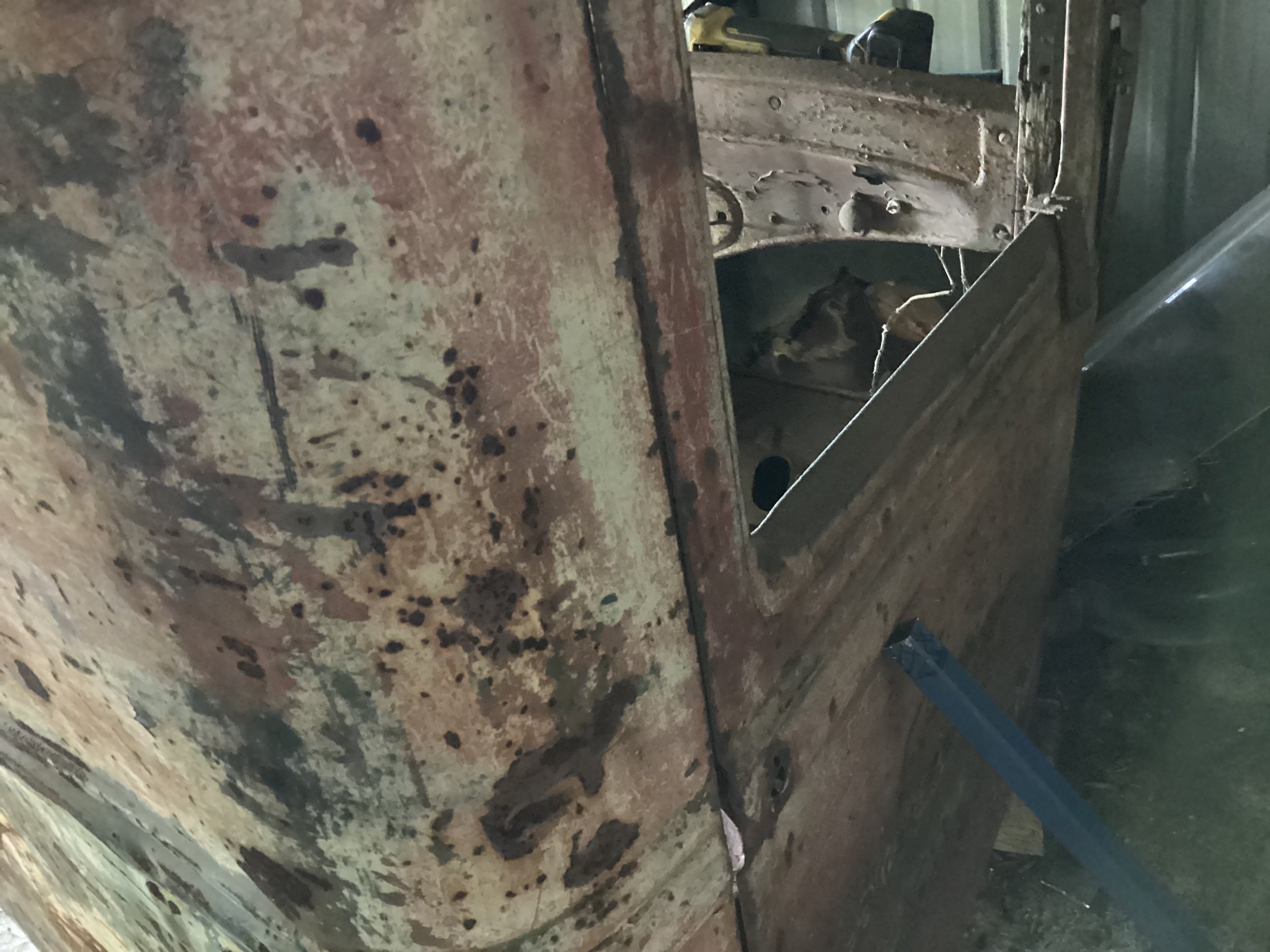

    One thing that really annoys me about these early trucks is the way the doors overlap the cabs by a third of an inch or so. I want flush fit doors for mine, so I started mucking around with gapping to see what I could come up with. My conclusion is that I can have flush fit doors.
    0ADD3138-8023-49F9-B261-E5C45FFEF07A.jpeg 39FDE427-B6A6-4235-B694-F82306DC3211.jpeg

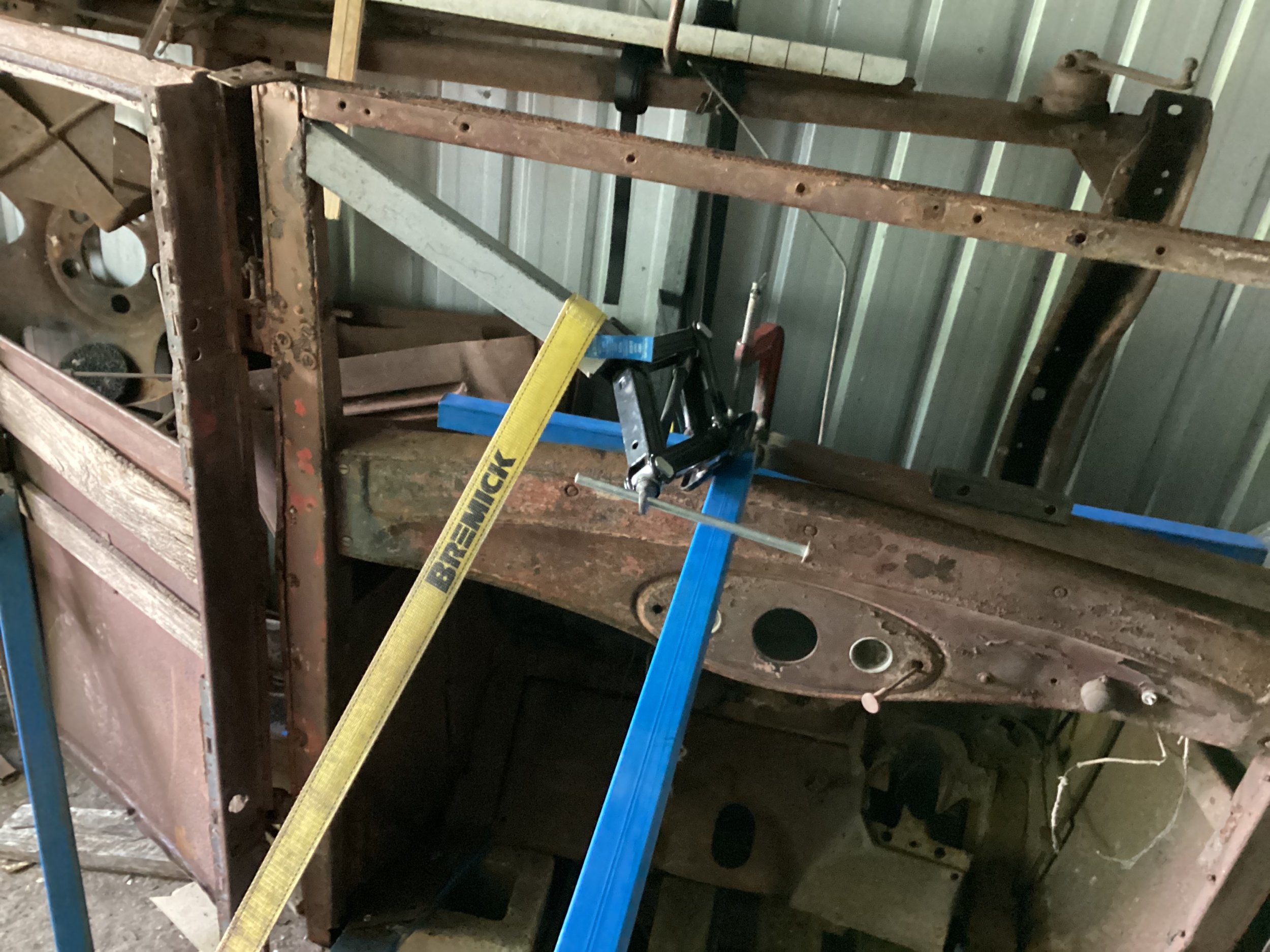

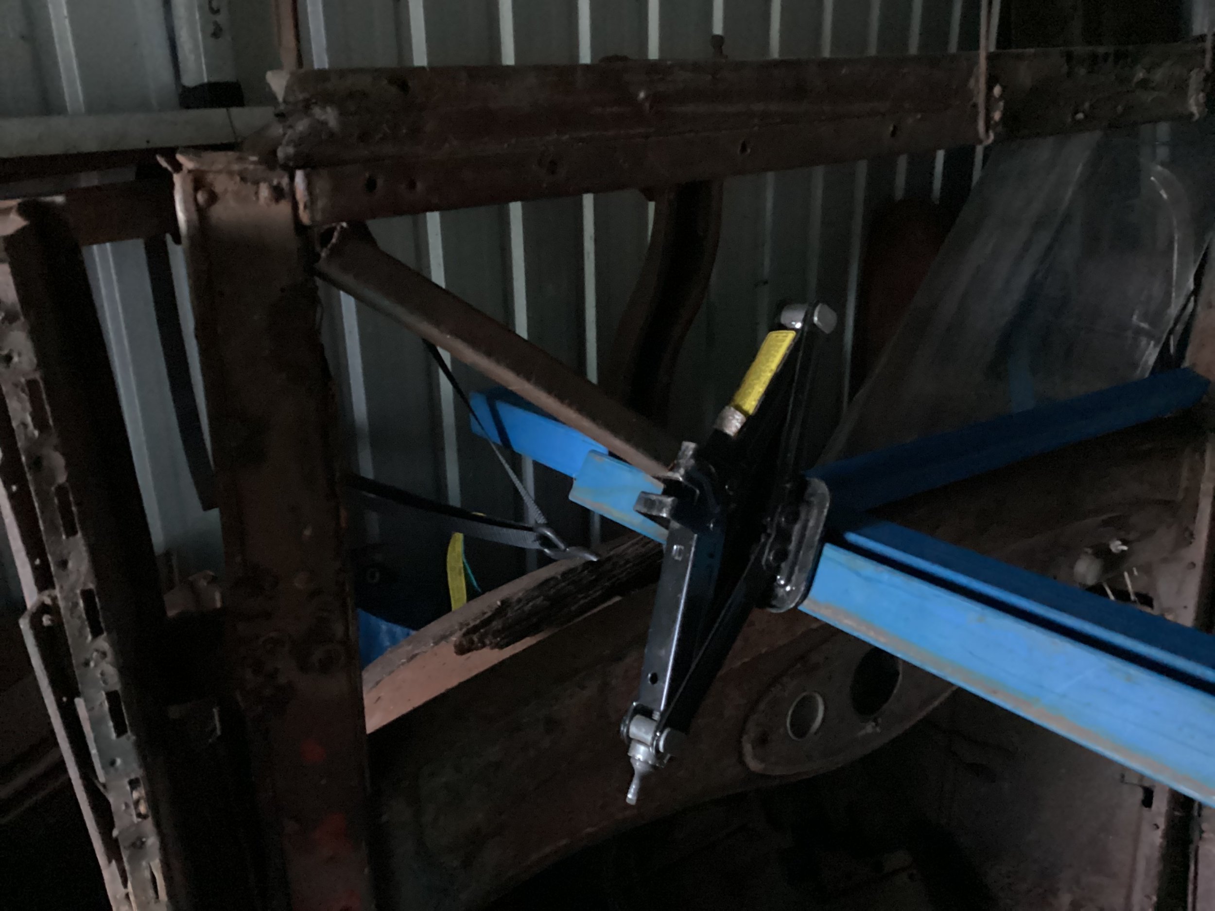

  25. chev34ute
    Posts: 1,525
    chev34ute
    Fortunately I do have a solution, it involves using the scissor Jack out of my car, angled at 45 degrees to slowly push the frame back into line. It was working and once I think it’s squared back up, I will try and place the windscreen frame back inside to make sure. 5A9CB1D6-EE6D-43A8-80B0-D360925497A5.jpeg
    Deutscher, Woogeroo, scotts52 and 2 others like this.

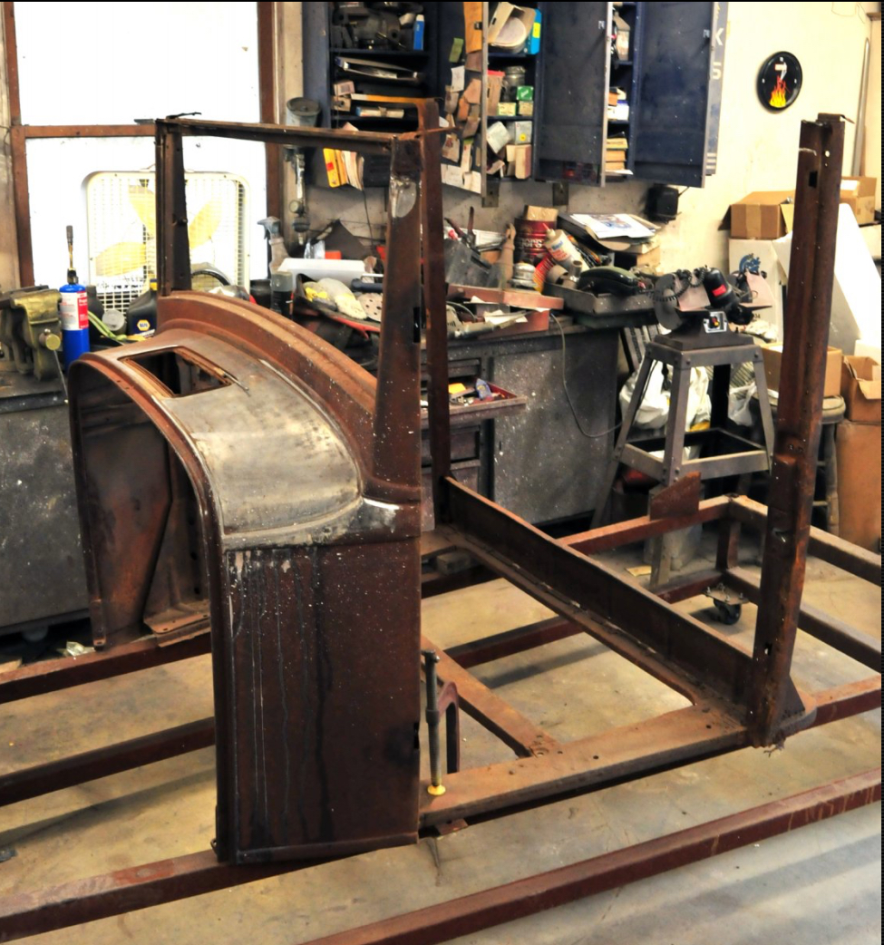

  26. chev34ute
    Posts: 1,525
    chev34ute

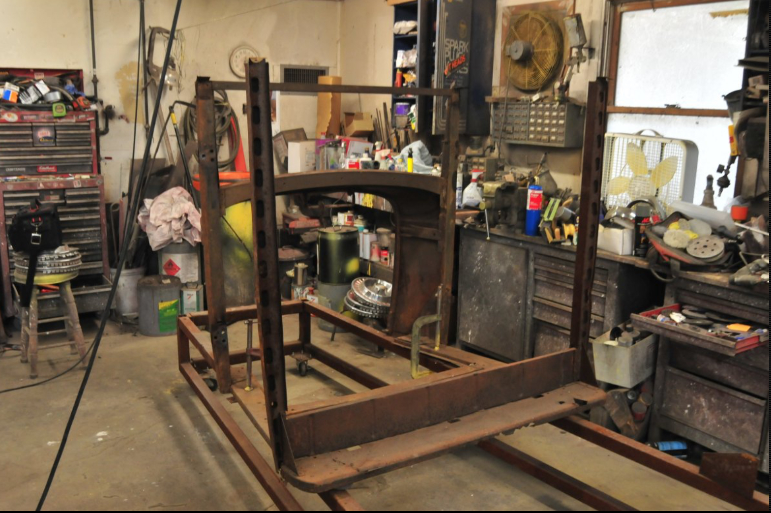

    B93CA594-14D7-4249-90D1-DABBBB746909.jpeg Hey Guys.
    Last time I posted up, I had just discovered the cowl was not square, the left A Pillar was leaning inward and the right A Pillar was leaning outward, so I set about trying to square it back straight. The first order was to build a jig to lean the scissor jack to lean against. E0A4771B-51D3-44D5-BC2F-8A760F1FEFDD.jpeg
  27. chev34ute
    Posts: 1,525
    chev34ute
    It works up to a certain point but clearly more reinforcement is needed and possibly turnbuckles. I’m in no mode to deal with it at the moment, I don’t have any turnbuckles at the moment so I will be concentrating on framing around the doors and header panel.

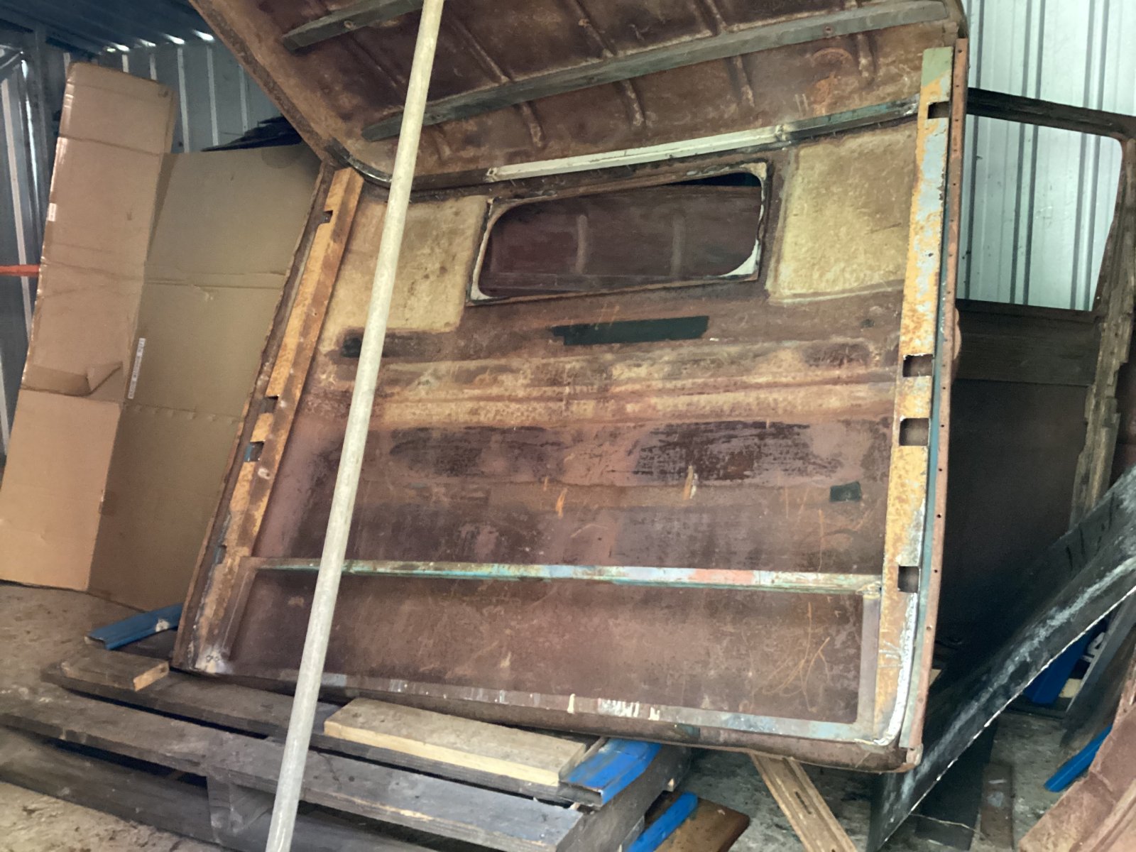

  29. chev34ute
    Posts: 1,525
    chev34ute
    The other thing I did was duplicate the framing above the p***enger door.

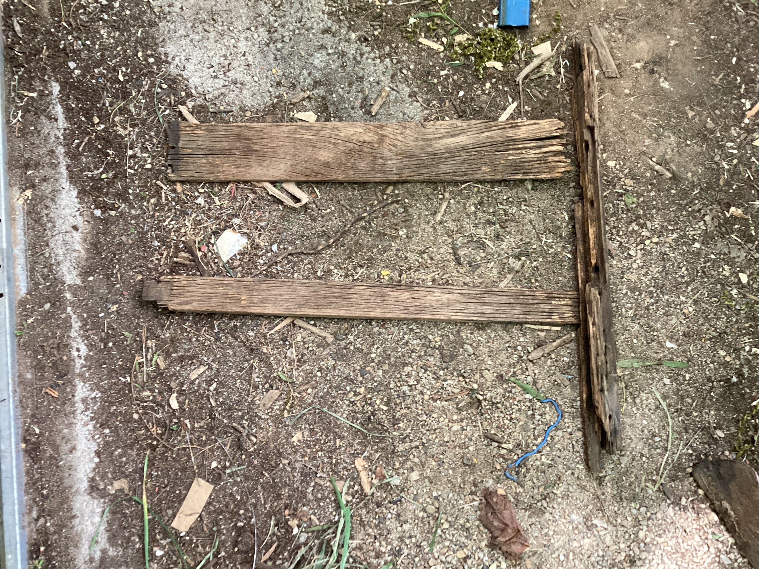

  30. chev34ute
    Posts: 1,525
    chev34ute

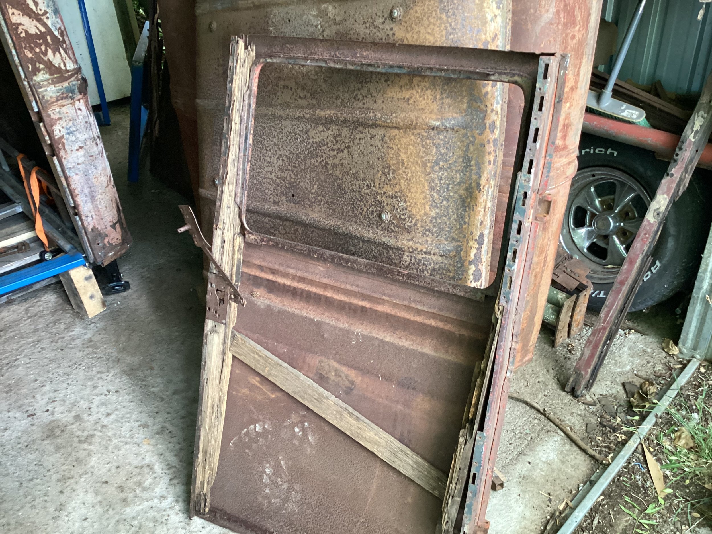

    The doors are in reasonable condition, the rotted out timber framing meant no moisture was able to collect at the bottom so rust is minimal.
