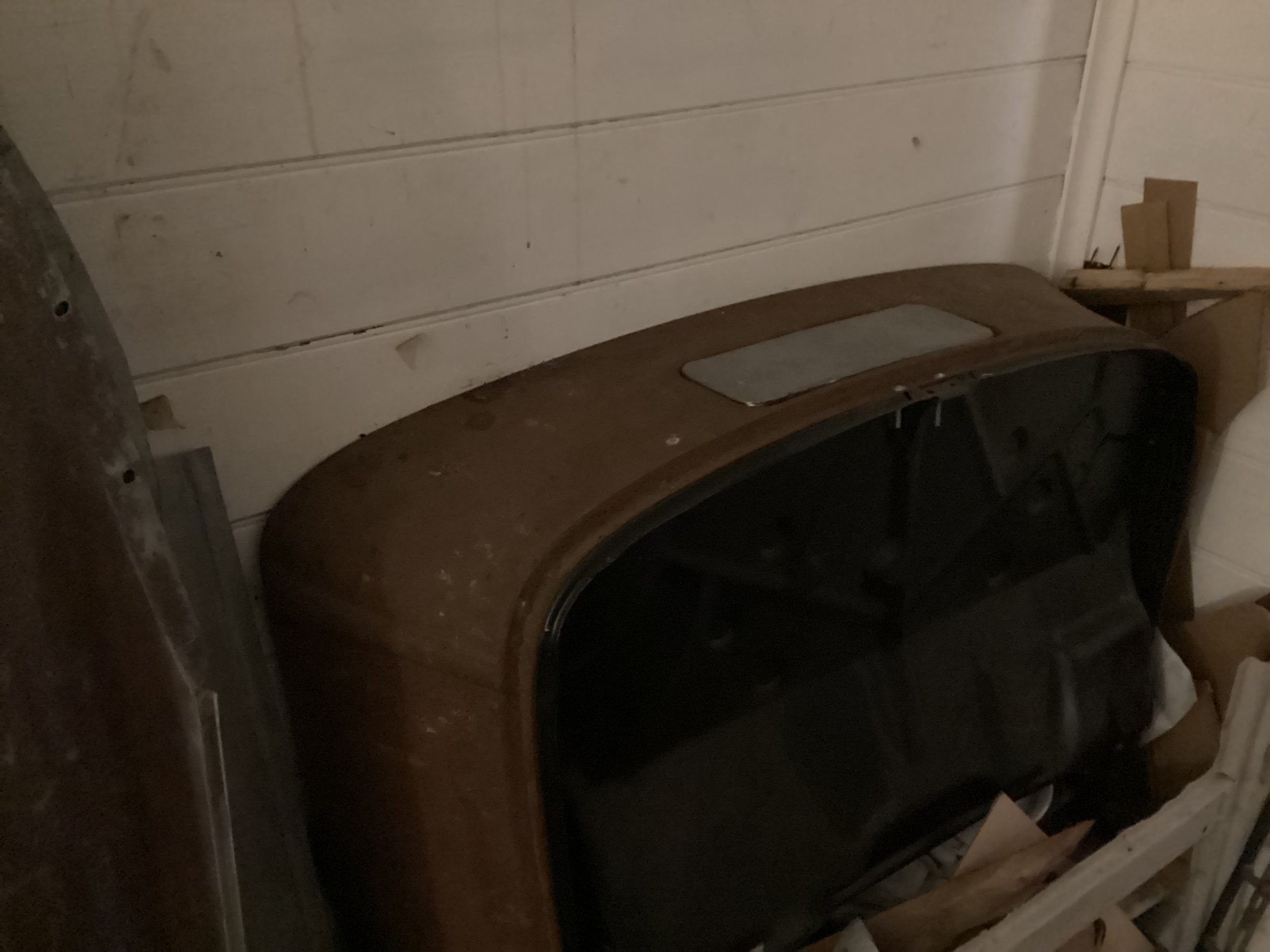

    And here is how severe it actually is. You can see the lean on the p***enger side pillar, and on the driver’s side pillar it’s almost vertical.
    1F670D04-87AD-45D4-8E89-3C6888A783D8.jpeg 41C03FEA-E4B6-4F24-B882-AD59D7941628.jpeg 41C03FEA-E4B6-4F24-B882-AD59D7941628.jpeg
  2. chev34ute
    Joined: Nov 13, 2011
    Posts: 1,532
    chev34ute
    And no that is not a distortion, the cab and cowl are sitting squarely on the sub rails. The windscreen pillars are really that twisted. The reason why none of this was visible when I first got the truck back was because the sunken cab hid the distortion and it was only when I took it all apart and rebuilt it that I first noticed the problem. And another thing I noticed was the diagonal strut on the p***enger side was completely missing, so it would make sense that the p***enger side would have sunk down even further than the driver’s side. F494836F-858A-4AF6-A1E2-D2FF05ED5BC6.jpeg

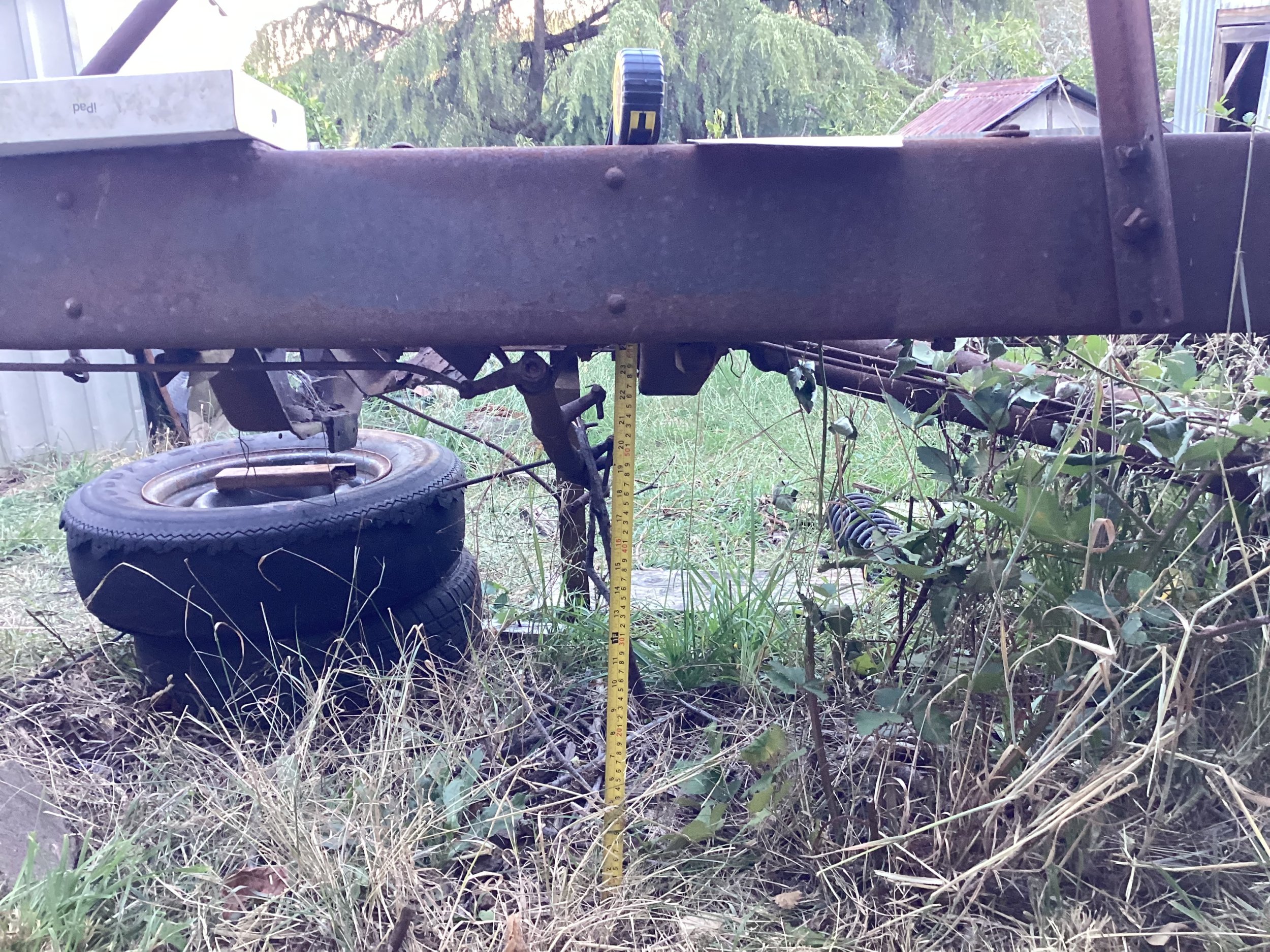

    I took some measurements and worked out the width of the trailer and the width of the frame at the shackles appears to be almost identical, the tailer is maybe an inch wider than the shackles of the frame. I also measured the overall height of the trailer and the inside height, and worked out with the frame raised up high enough the trailer will slide under it.

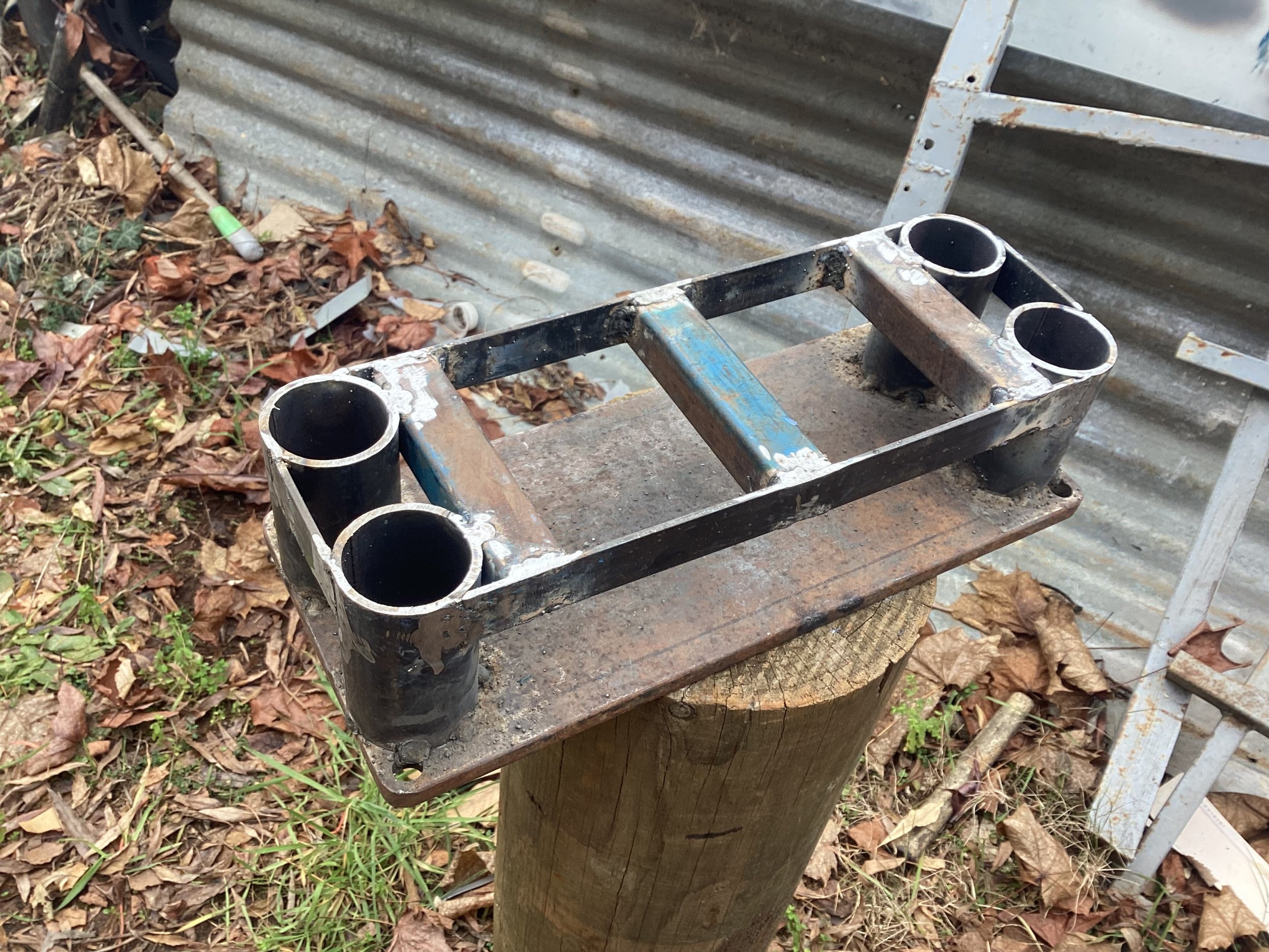

    One thing missing from the truck was the cowl vent, so in the spirit of frugalness I decided to make my own. Luckily the other truck cab had a complete one and once removed I took patterns from it. From there I was able to create the hammer form, using quarter inch plate as the base.
  17. chev34ute
    Posts: 1,532
    chev34ute
    I designed it in such away that I am able to get clamps between the base and upper level to clamp down the piece.

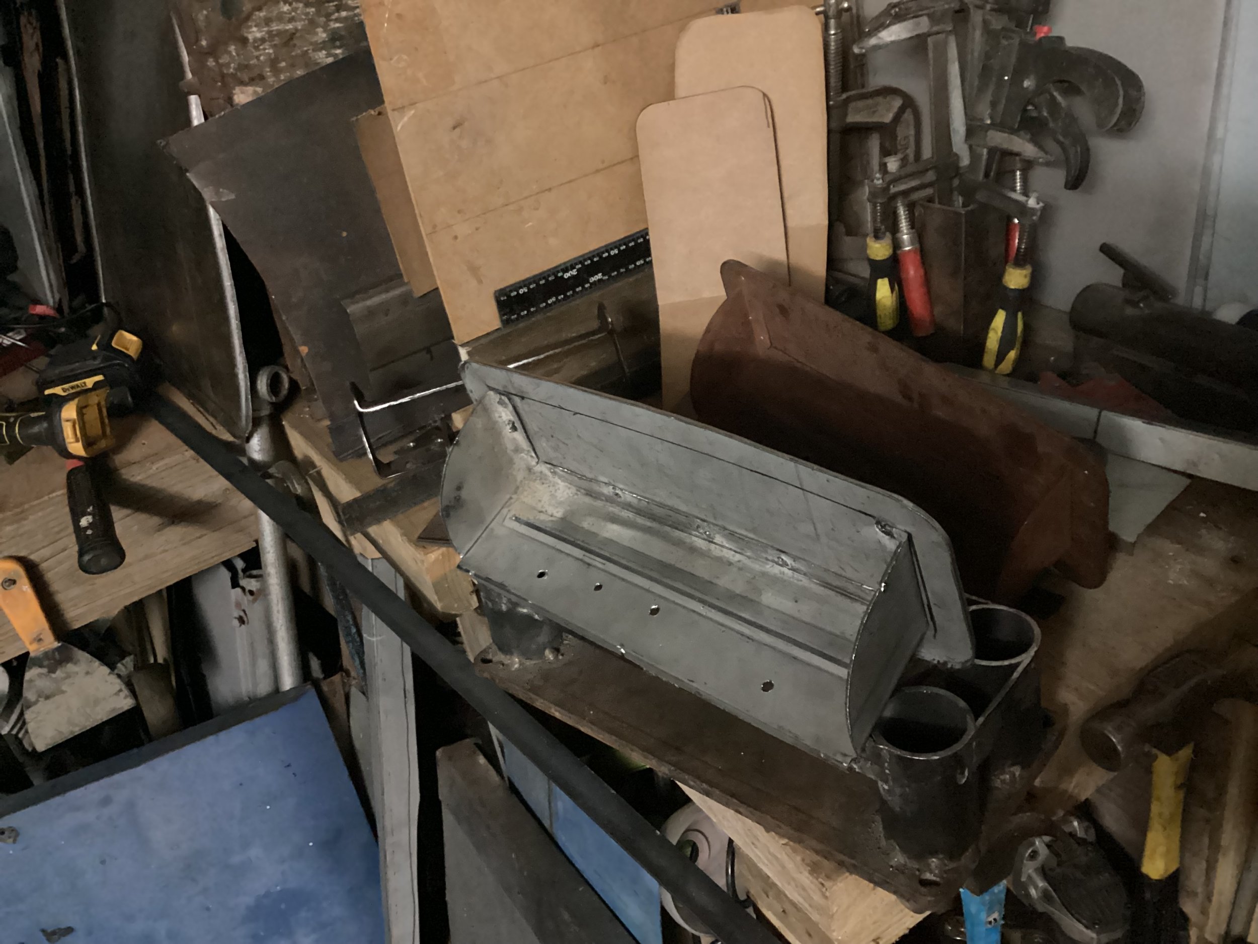

  18. chev34ute
    Posts: 1,532
    chev34ute
    This was the first one I produced.
    Deutscher, Squablow, Woogeroo and 3 others like this.

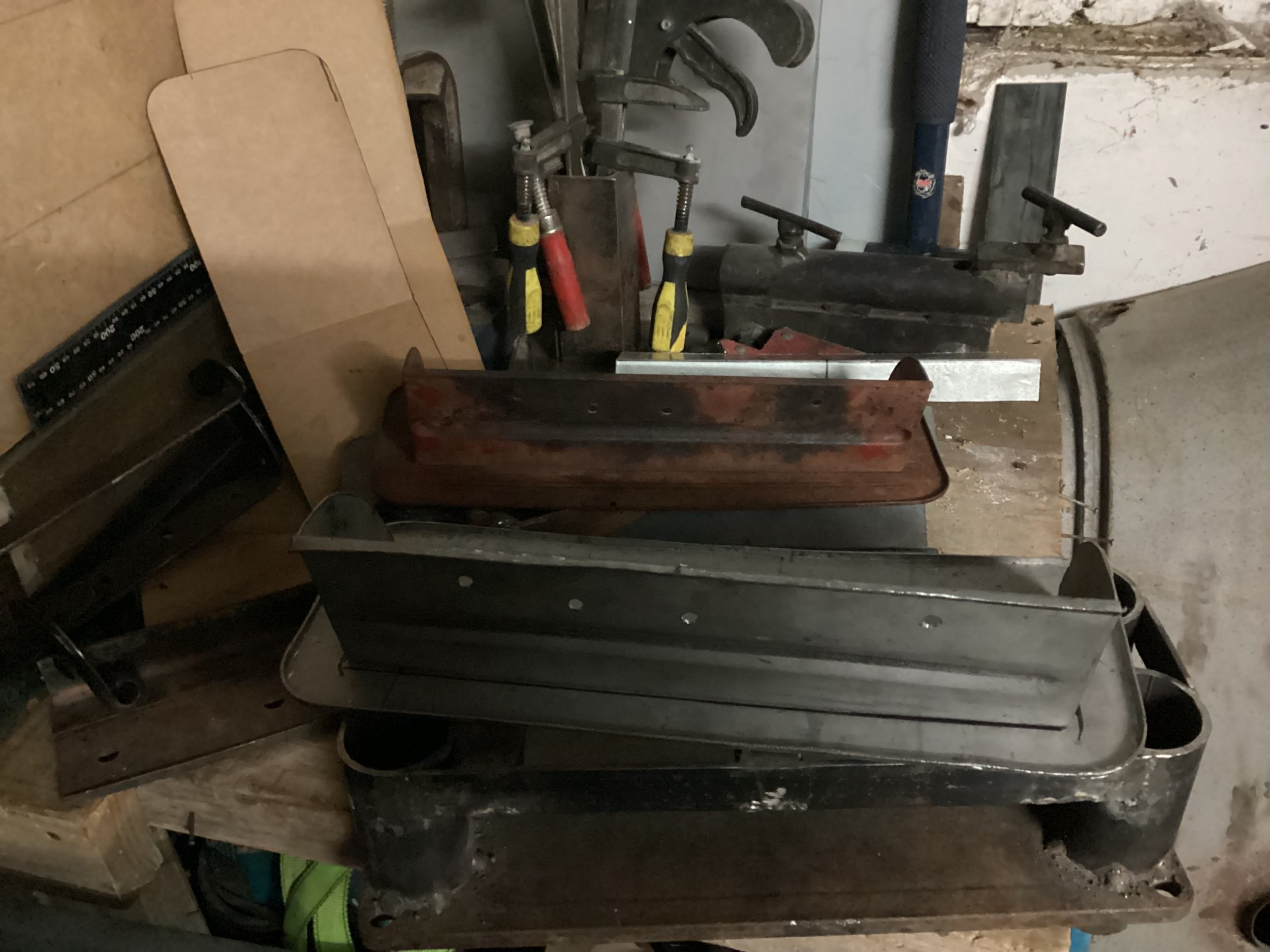

  19. chev34ute
    Posts: 1,532
    chev34ute
    Once the original cowl vent was carefully taken apart, I was better able to study the inner support and hinging and take patterns from the inner support. This section is a lot more complicated as there is a slight radius running along the upper edge.
    Deutscher, Squablow, Woogeroo and 4 others like this.

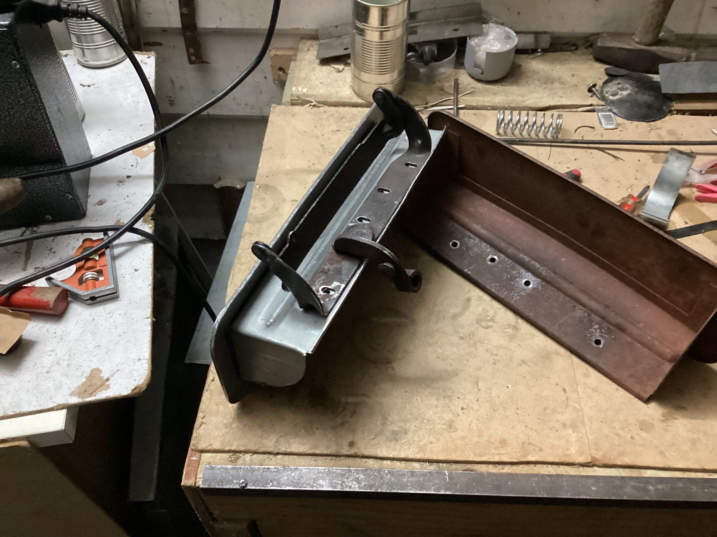

  20. chev34ute
    Posts: 1,532
    chev34ute
    Squablow, Deutscher, Woogeroo and 3 others like this.
  21. chev34ute
    Posts: 1,532
    chev34ute
    The next task will be to reproduce the hinge itself.

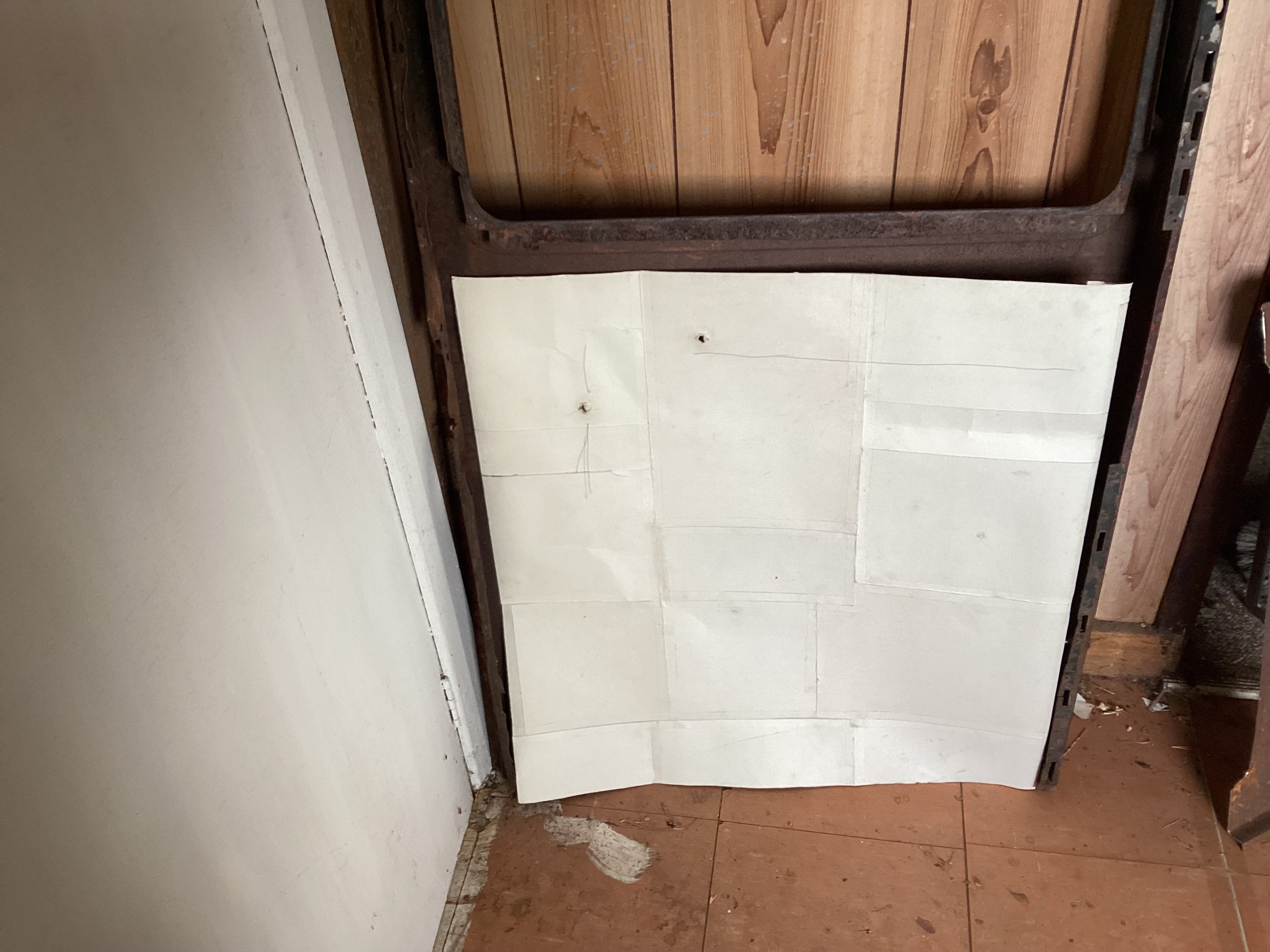

    Hey Guys.

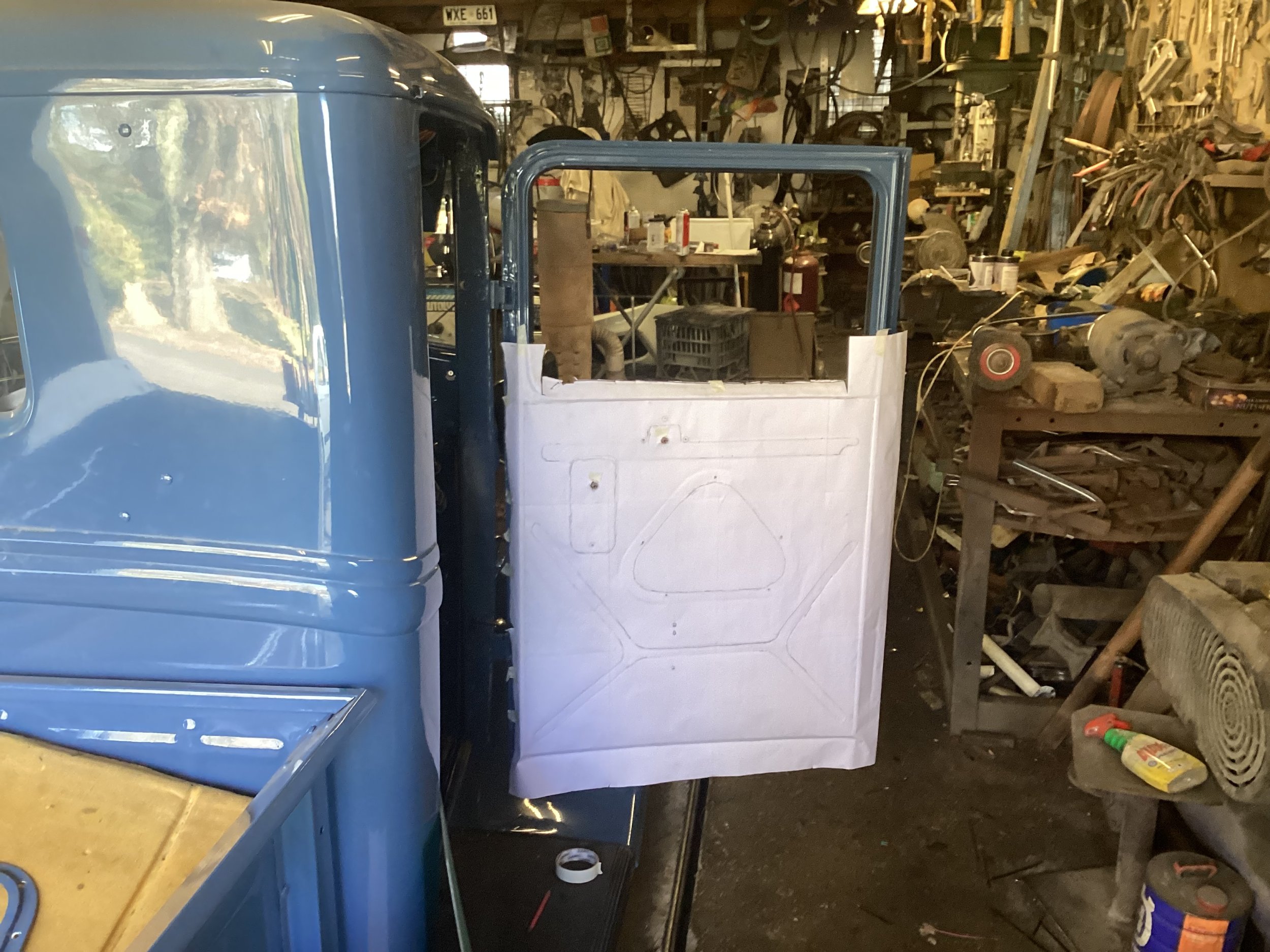

    The local rodder has the 32 pickup back in his shop to finish the wiring and get the upholstery done, so I took the opportunity to take some patterns of the doors.
    Squablow and warhorseracing like this.
  25. chev34ute
    Posts: 1,532
    chev34ute
    As I outlined earlier, the doors in mine were framed with timber and I wanted to replace it all with steel. I brought down my door for a comparison and after completing the pattern, we took some measurements of the lengths of both doors to find out mine are three quarters of an inch longer than the pickup ones.

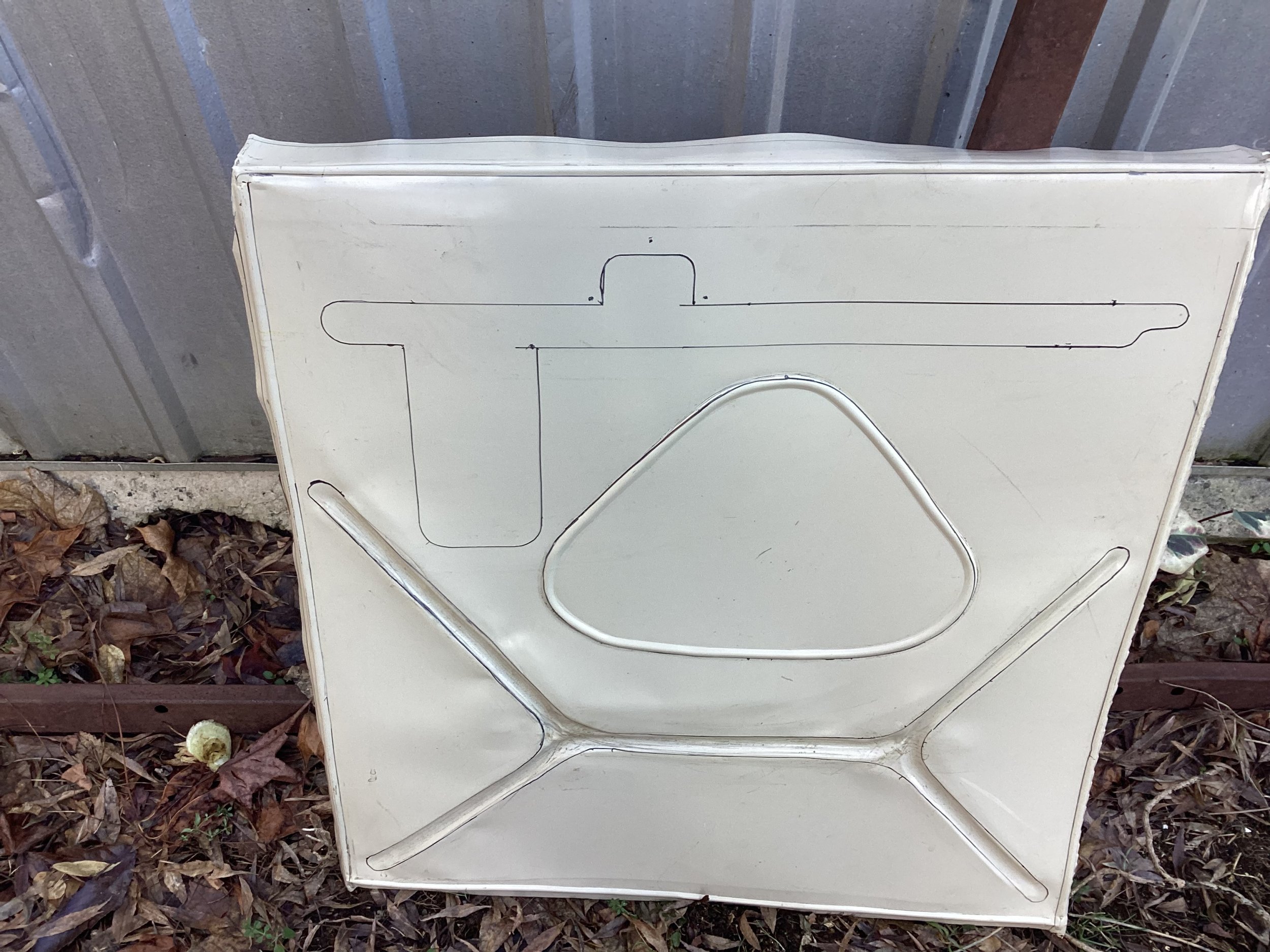

    After fine tuning the pattern last night, I fitted it up to my door for a rough idea of what it might look like.
  27. chev34ute
    Posts: 1,532
    chev34ute
    I also made a secondary pattern out of cardboard to trace over the sheetmetal.
    The three quarter inch strip will be added to the rear of the pattern before I cut the steel out.
    In the interest of keeping this one as all Ford as possible, I will be using the sheetmetal that came out of a 1970’s Ford Falcon station wagon.
