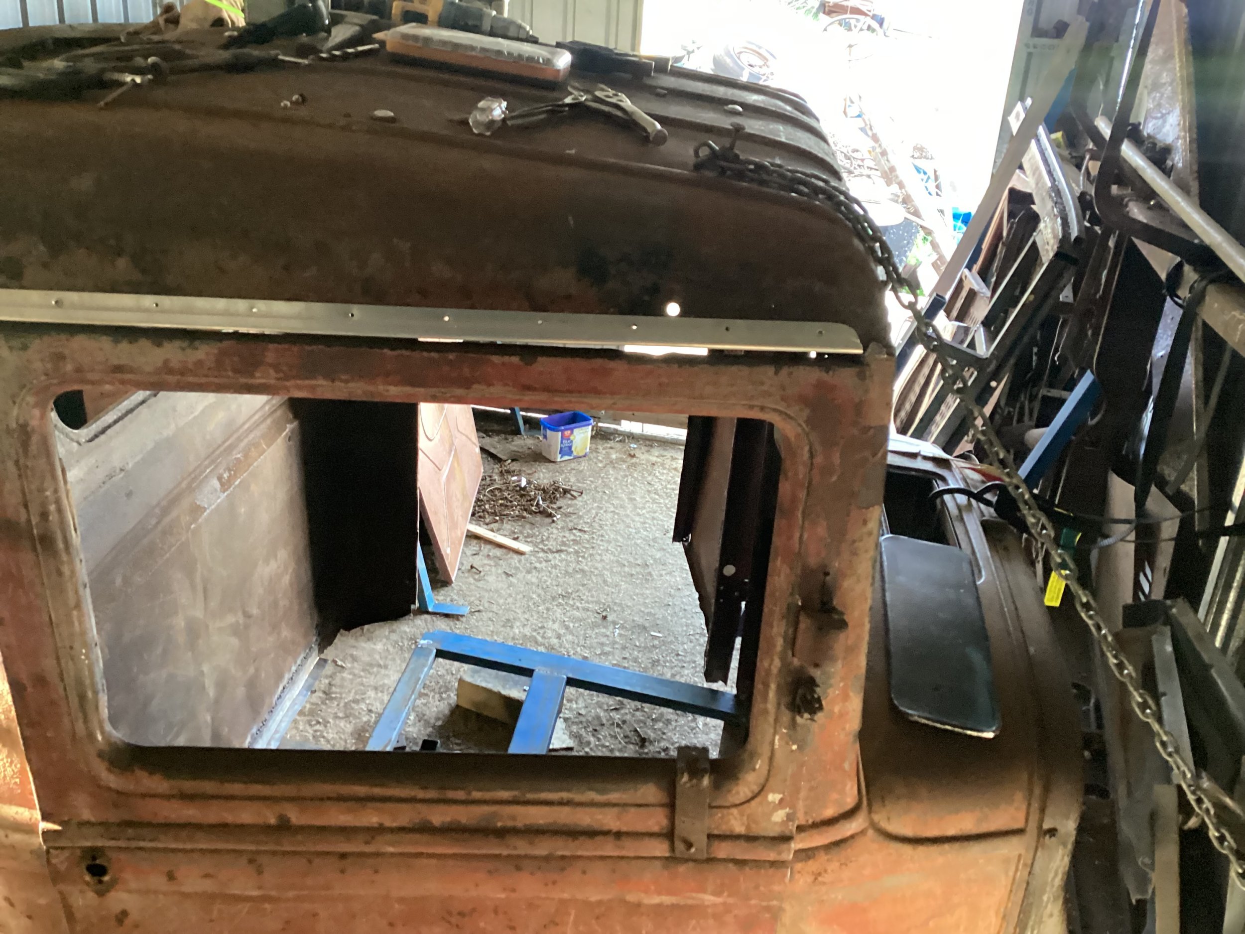

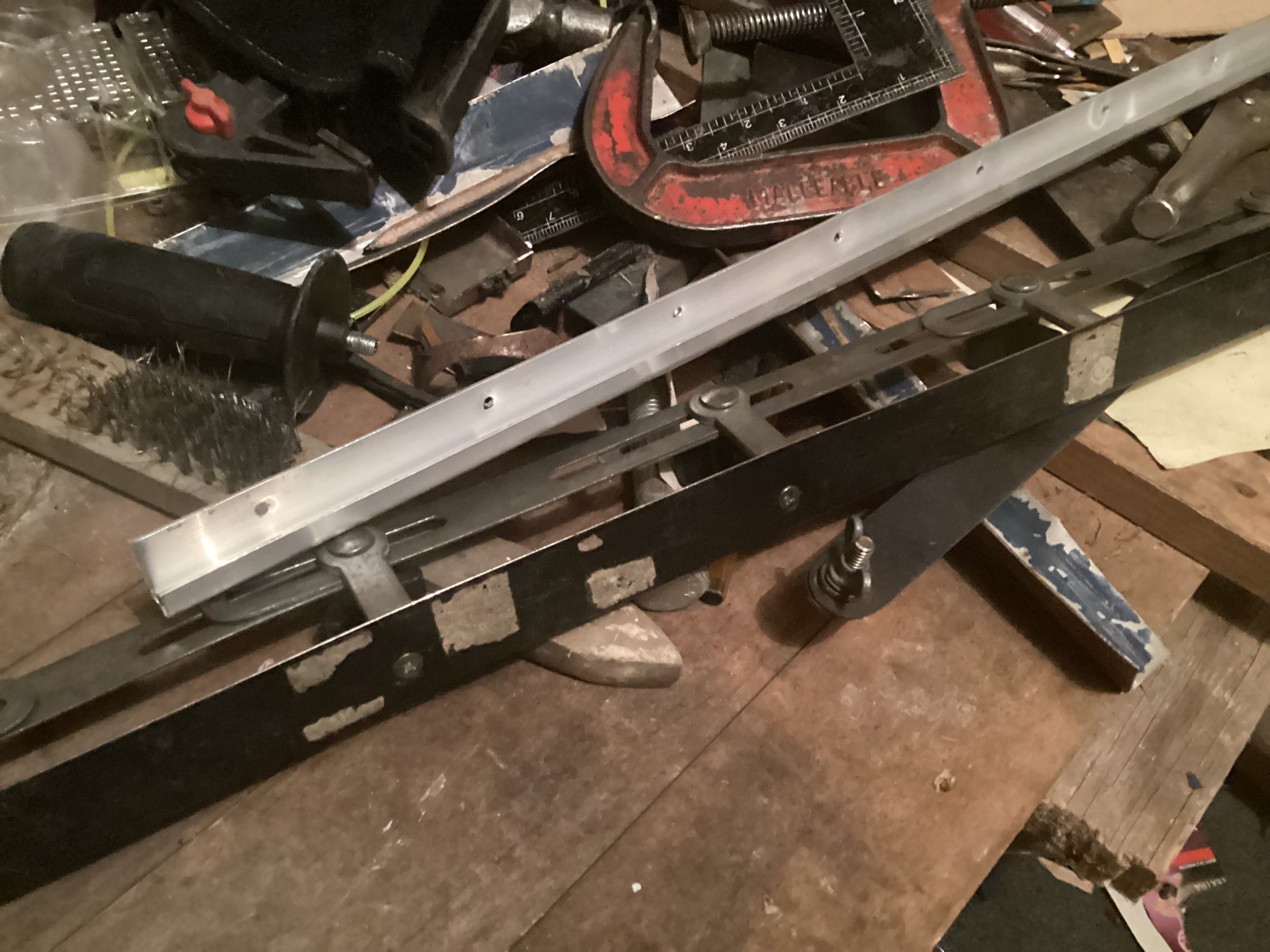

    I couldn’t find any half round aluminium cover strips but I was able get a full length of one inch high j channel. This is the same profile as the drip rails on early thirties automobiles.
    IMG_3558.jpeg After cutting it to size, I tapped and drilled the holes for the screws. These were done every three inches.
    Woogeroo, Deutscher and dwollam like this.
  3. chev34ute
    Joined: Nov 13, 2011
    Posts: 1,525
    chev34ute

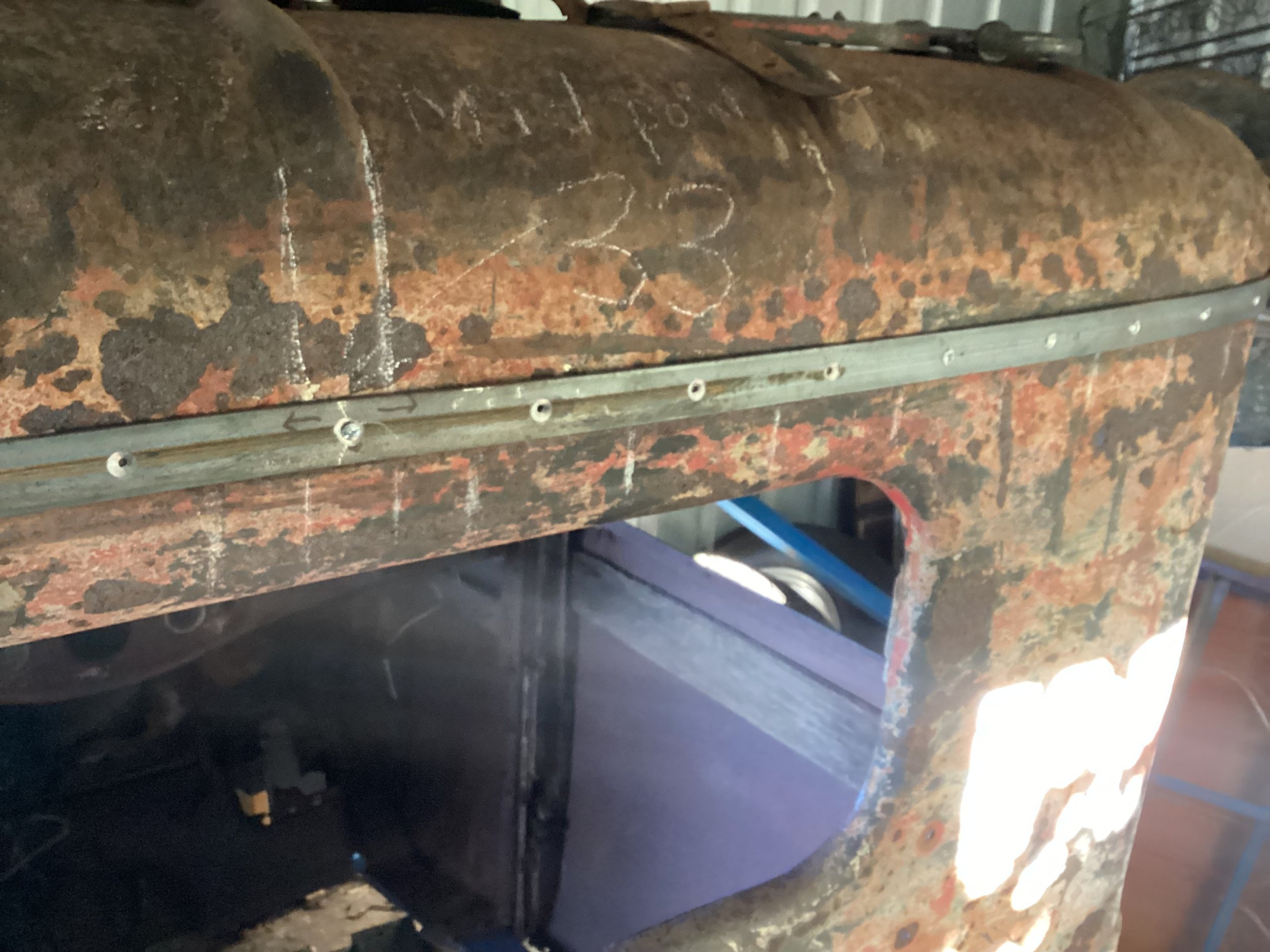

    I still had the issue of what to use for the cover strip for the rear of the cab, so I looked around the shed and found three strips of flat bar. These flat bars were the same height as the j channel making it the perfect solution. This was also tapped and drilled at three inch intervals.
  4. chev34ute
    Posts: 1,525
    chev34ute

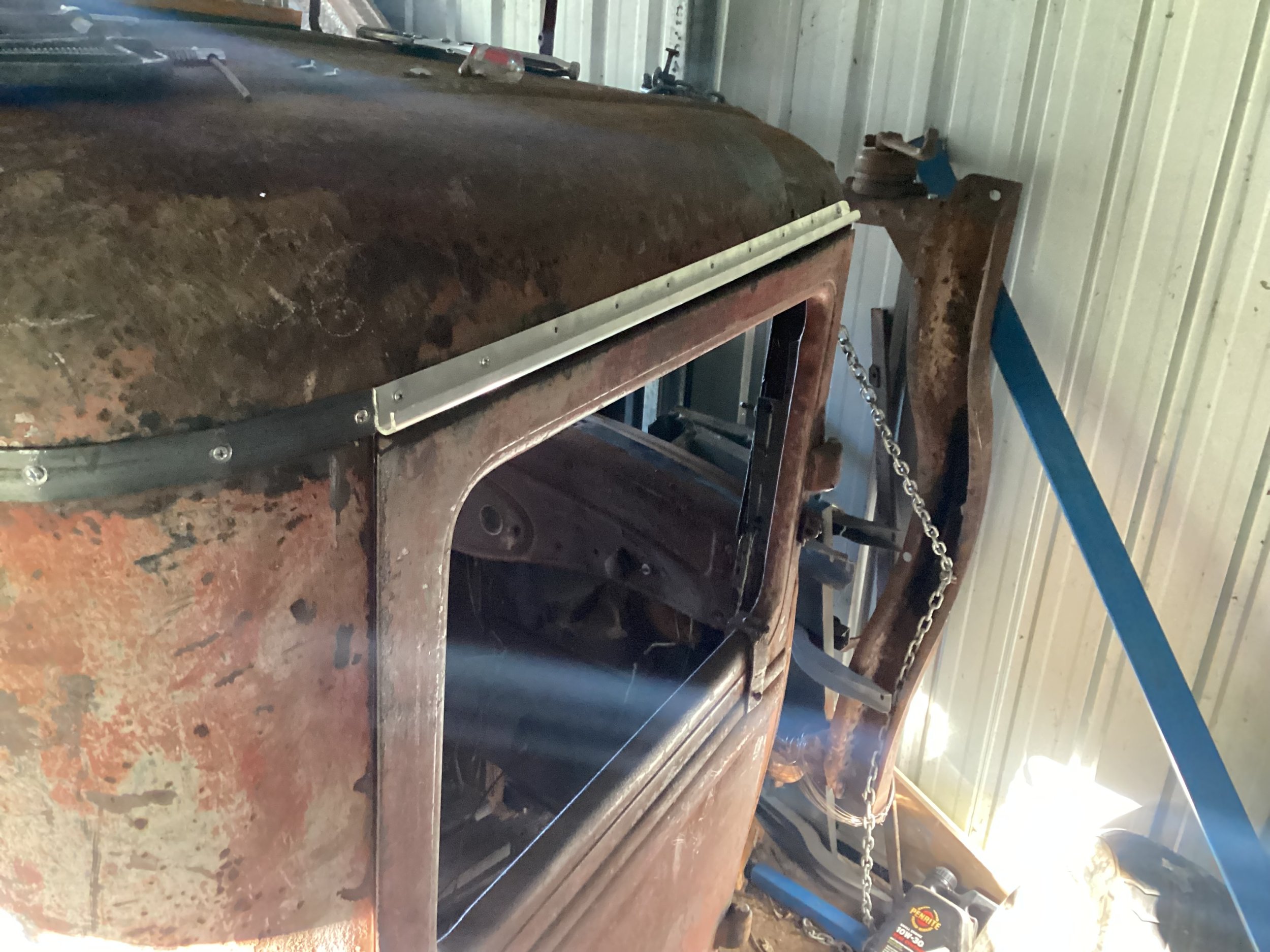

    The j channel was then attached above the doors. I was careful to round off the leading edge of the channel so it matched the profile of the roof. IMG_3547.jpeg

    And here is how it’s looking side on.

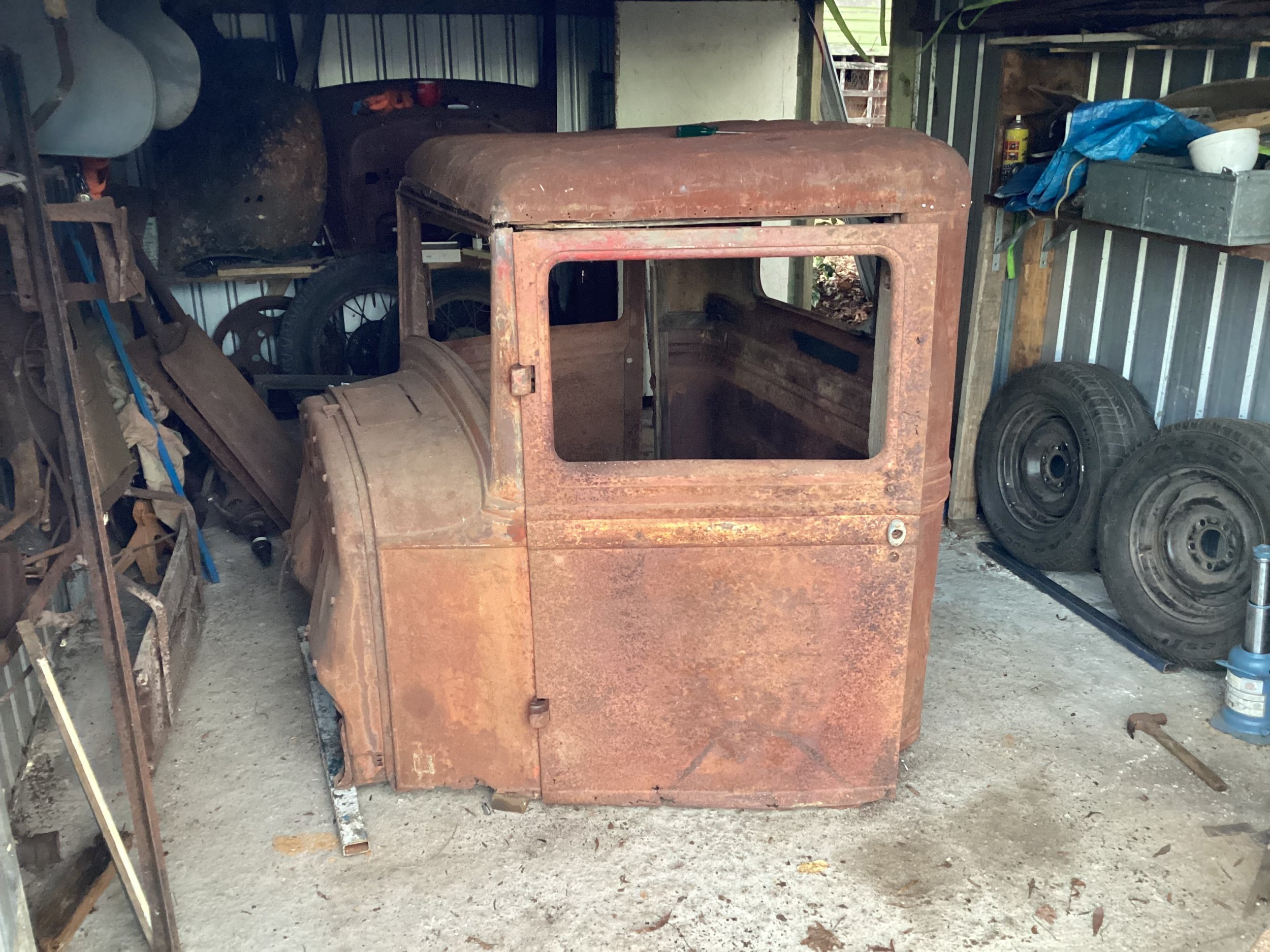

    I then looked over the cab, I’m planning on selling. This one is definitely the rougher of the two. The upper frame, the windscreen sits under is completely rotted out as is the upper part of the cowl the vent sits inside. I will really have my work cut out for me repairing this one, but luckily the other one is solid in these areas. IMG_3595.jpeg
