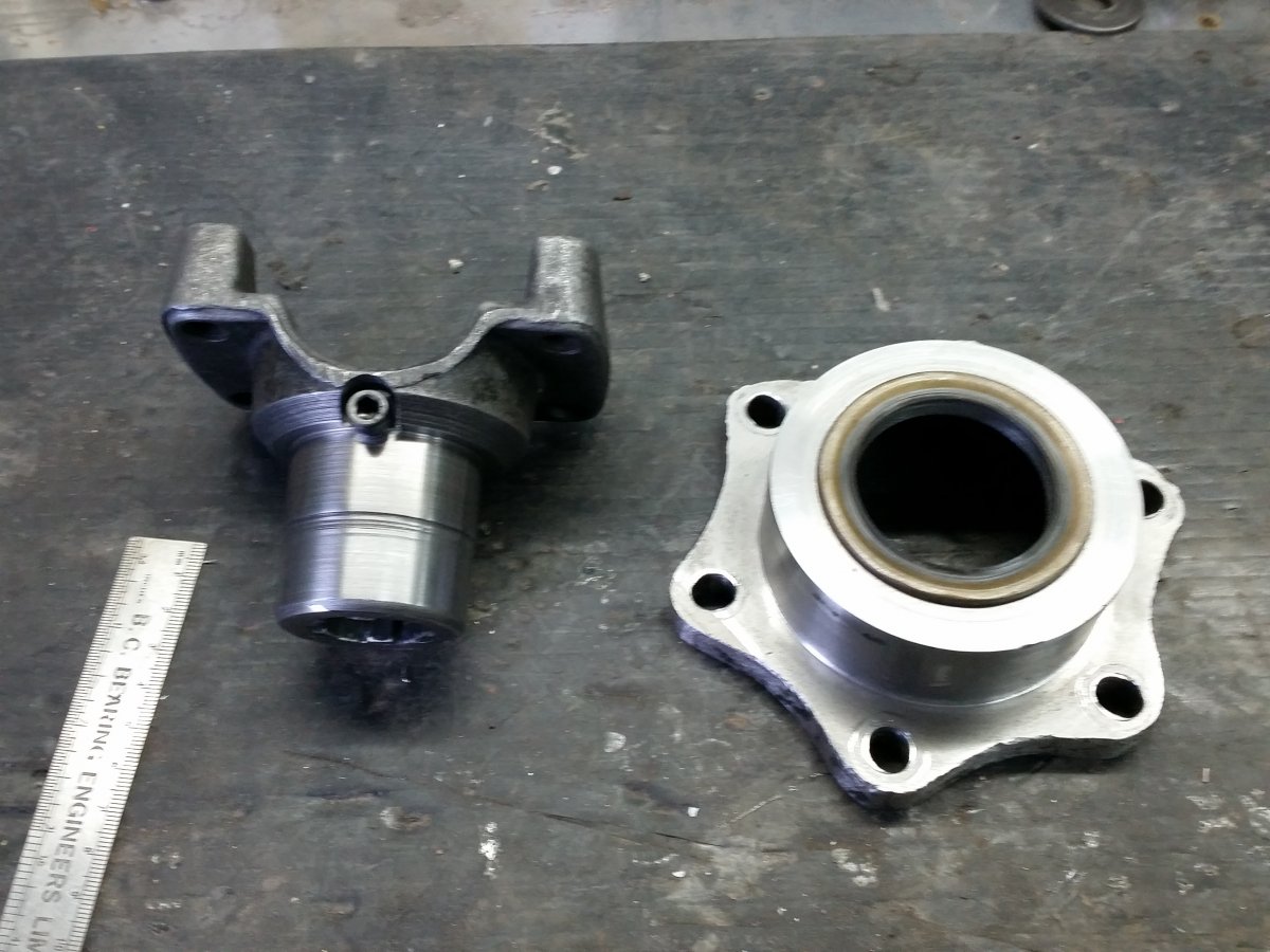

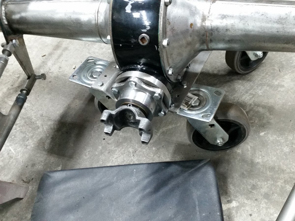

    So I had a buddy stop by the other day , he's building a model A too(29 roadster). We were talking about this and that and he mentioned that he was using a torque tube and had to shorten it. He asked me what I was going to do. I said that I was going to convert to open drive and was going to order a kit for the conversion. He looked at me and said "why not do it yourself? It's something in your wheelhouse that you can do ". I thought 'he's right' I'm just being lazy and straying from my original course of doing as much as I can with what I've got on hand.
    I went back to the house and started to research 'open drive conversion' I found a thread by Tman that guided me along (thanks Trent!) I thought I was going to have to go to town and buy a yoke and seal but I didn't want to so
    I went out to my snow covered pile and dug out an old torque tube and a piece that I saved from my firetruck build that was part of the PTO that drove the fire pump. The yoke off the PTO thing was removed and I cut off the flange end of the torque tube. I dug through my junk drawer and found a SBC timing cover seal and measured the yoke. It was bigger than the seal but I can machine it down to the same diameter as a SBC damper. The idea of using the SBC seal just presented itself but I thought if I'm in Bumhole Saskatchewan any parts place will have a seal.
    So cut , cut ,cut , machine ,weld , machine , measure , machine , fit , ***emble , dis***emble , adjust , re***emble and I got an open drive conversion that cost me absolutely NOTHING! All stuff was on hand and it's going to work....I hope!

    I know you probably know this but don't forget to put a vent in somewhere.
    Stogy and loudbang like this.

    I cannibalized a fitting from some old Ford that has the tee for the rear brakes and a vent that goes through the center to hold it down.

    When you flip the banjo housing to make a quick change it puts the drain plug at the top. I thought that this would be a good place to put a vent. I drilled and tapped the plug and now I have a vent and a tee for the brakes. 20200228_133722.jpg 20200228_133700.jpg 20200228_133952.jpg

    On your open drive conversion Is the yoke held onto the shaft with that set screw? Looks good

    I put 2 on opposite sides and made little divots so they hopefully can't slip. I'm going to use some blue Loc***e as insurance.
