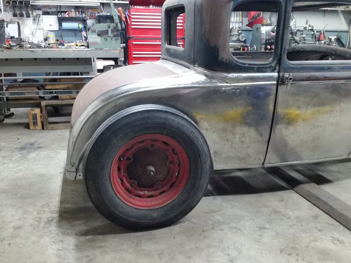

    Actually the disc does not run totally true. There is some slight wobble which seems to deliver small hits on the high spots as well as heat the high spots , so in effect heating and hammering at the same time. When I first started doing bodywork I tried doing the "pin shrinks" with an OA torch and a wet rag. I would spent hours it seemed chasing warps and oilcans all over a panel. Now I can almost get to no filler metal finishing , small dents that would just get a gob of filler now almost disappear. I still use some filler but mostly high build primer and 2k putty to get the job done.

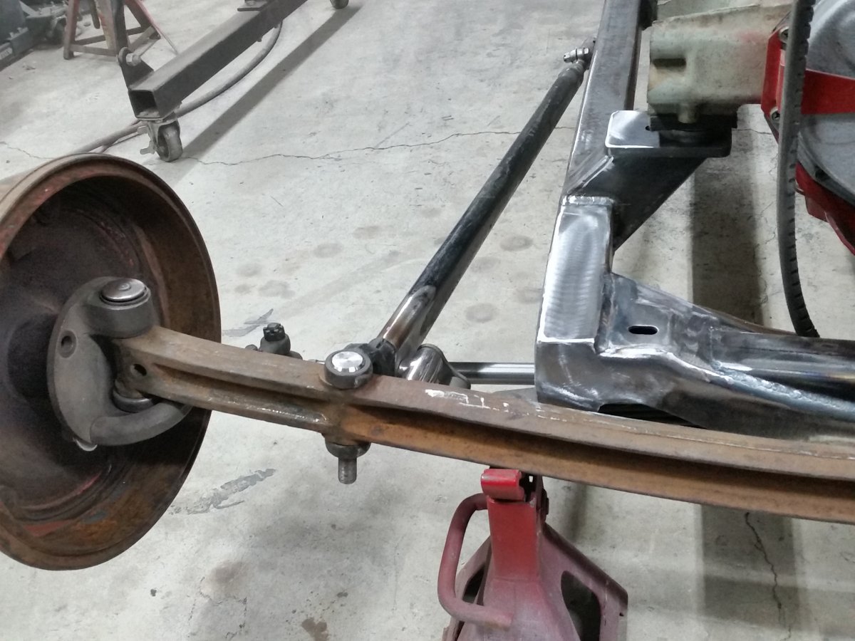

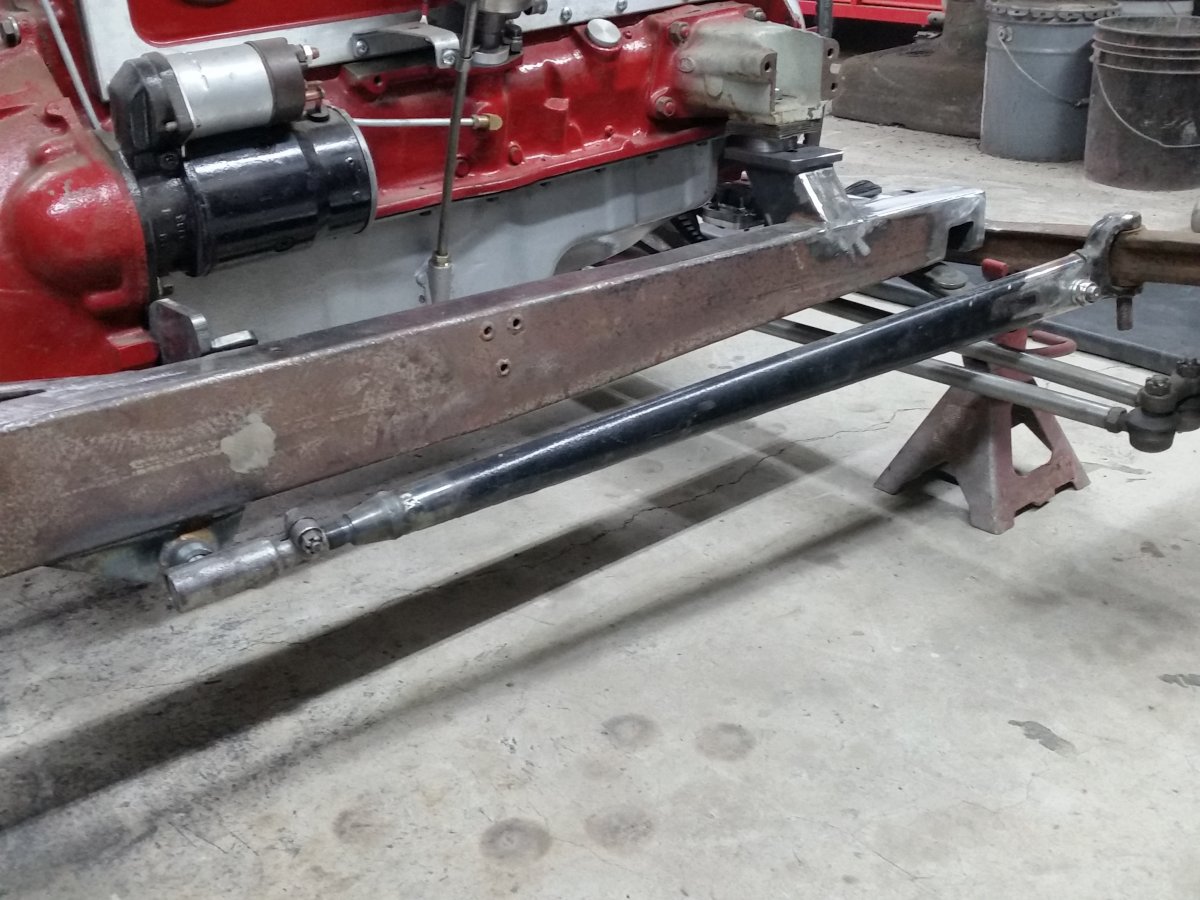

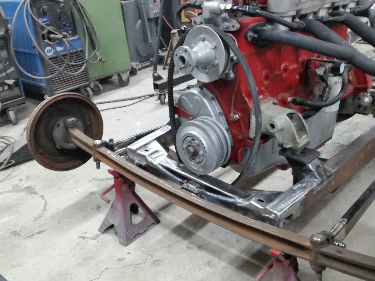

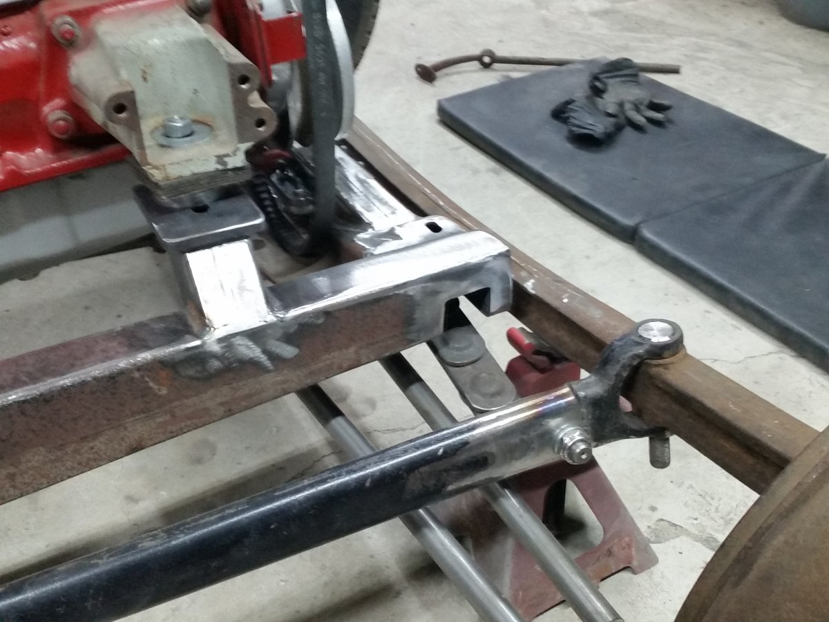

    I got tired of welding in patches and wanted to see what it looks like on the ground. the tires are 650 -16 and I'll be using 750's
    I put the front axle in place at ride height
    Did some work on the subframe crossmember to tunnel the driveshaft

    It looks like engine is pretty far forward, are you moving the Radiator forward as well. I'm in the process of figuring out where my motor mounts are going on my 30 Tudor, want it as far forward as possible but worried about fan hitting Radiator.

    Yeah , I'm going to have to move the rad forward. If I can find a shorter water pump and a single groove damper I may not have to move it too far. The military block has a quite long snout on the WP , there's lots of room in a 6x6 though.I'm limited moving the motor back because of my carb setup . I don't want to cut my cowl top to fit.
