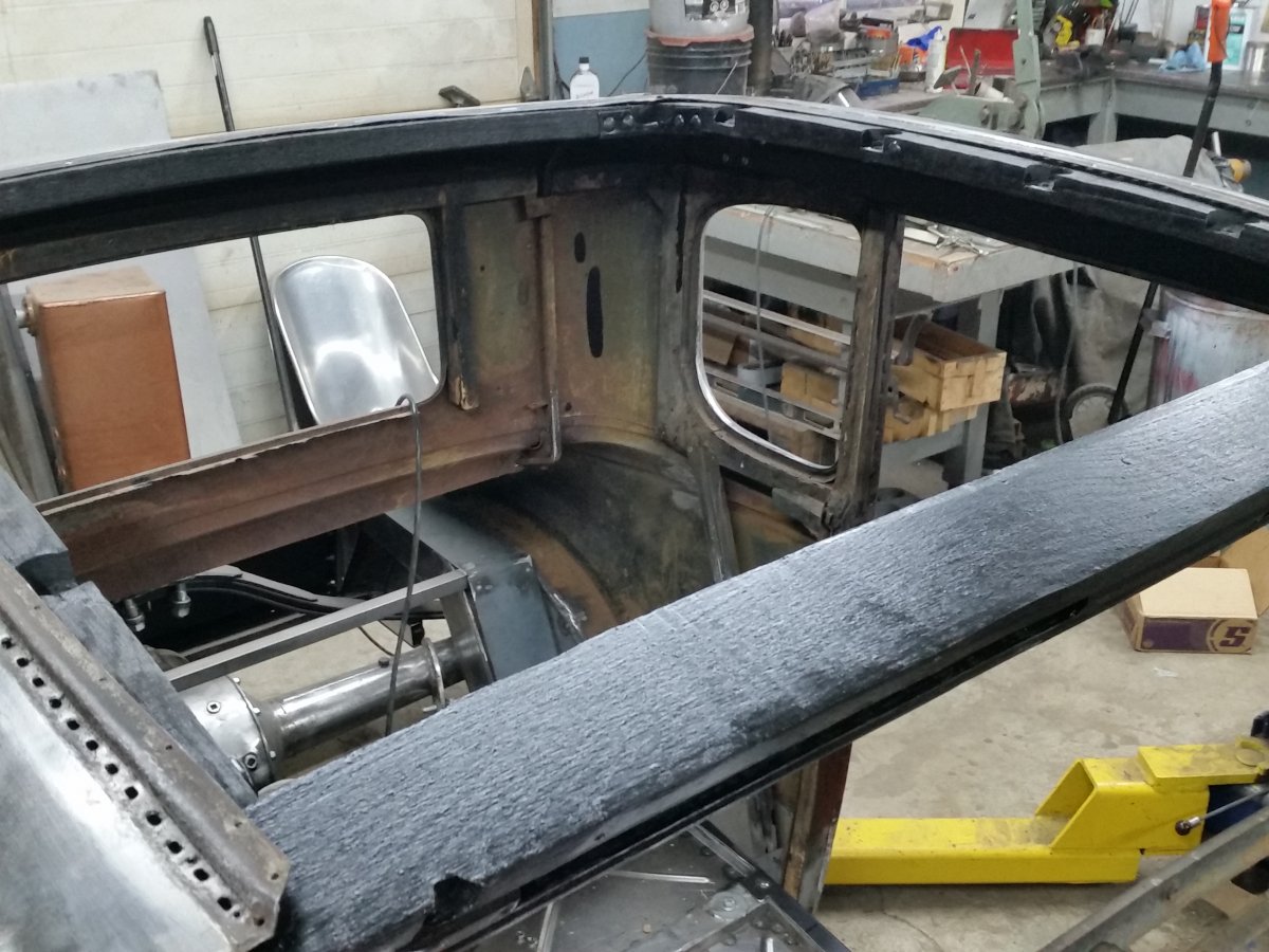

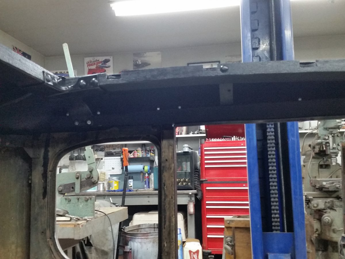

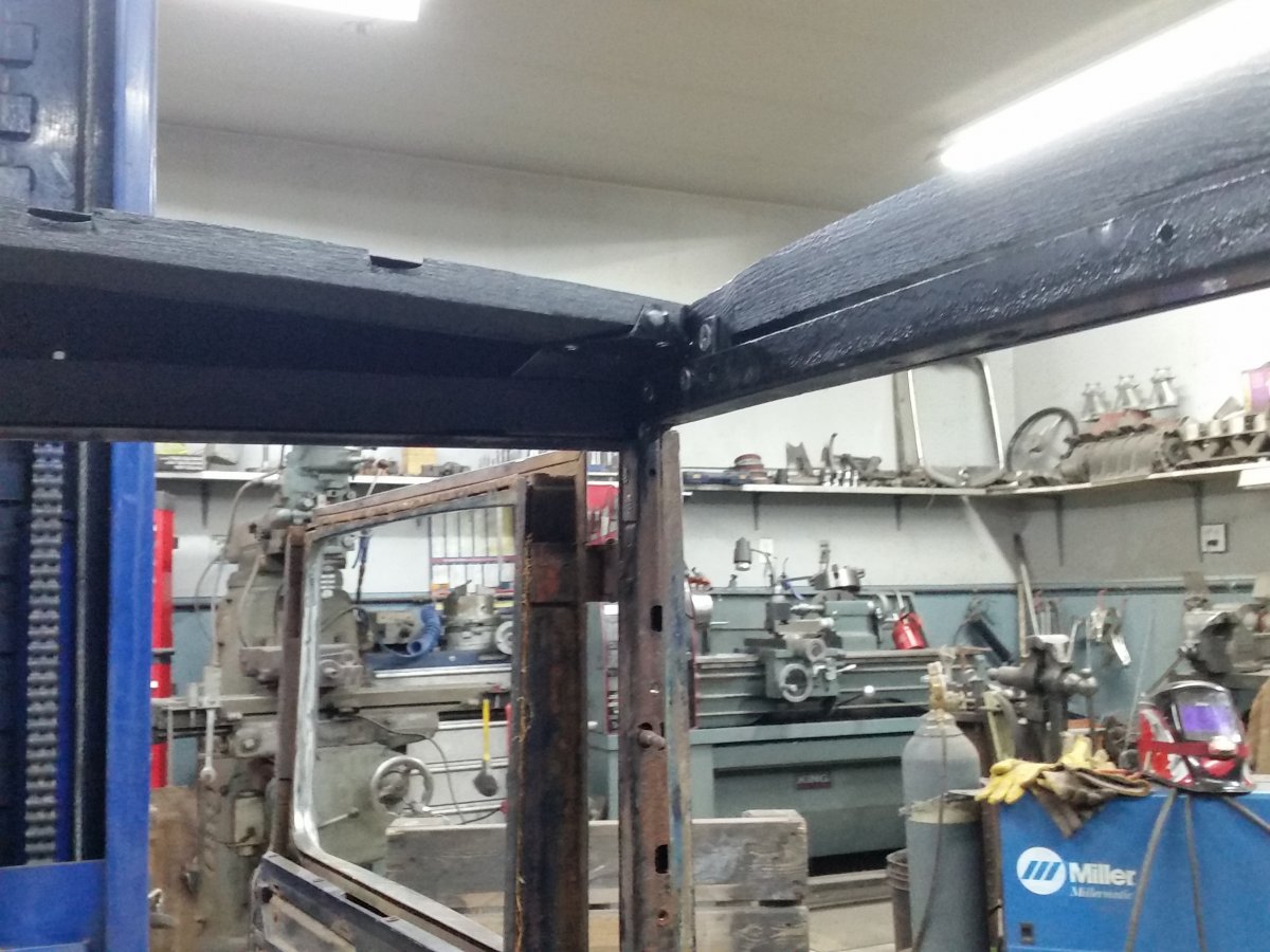

    Right now I'm moving on. I started to replace the roof wood. I took out all the old wood and surprisingly most was not in too bad shape. The ends of the header are rotten and the tips of the side pieces have a little dry rot too. I could probably get away with the side pieces but the header needs love. About ten years ago I bought a roof wood kit at a swap meet. It looks like a homemade kit but it seemed to be fairly well done. Well I started to put it all together and it's not very good at all!. I've been sanding and chiselling and saying bad words. I am going to give it another try today but I may just end up getting a kit or at the very least a new header. It's all getting covered anyway so my poor woodworking won't be seen , but I need the header to be accurate or the rest won't fit worth ****.
  7. Jethro
    Joined: Mar 5, 2001
    Posts: 1,955
    Jethro
    Now I know why Henry got into the charcoal business. What a pile of work making these pieces fit!
    I was able to keep and reuse most of the hardware except for those stupid square nuts! I replaced all the nuts with regular hex and I used those flanged looking locknuts on the 5/16 carriage bolts 'cause I had them. I am fortunate to have a big belt sander and bandsaw so reshaping the header went better than I anticipated. I used black polyurethane stain on all the pieces and painted the carriage bolt heads black. I POR 15'd the metal behind everything I even managed to POR15 my hair and back of my neck. Washing your head with gun wash is a special task I don't want to do again. I'm glad to get that out of the way , I have learned to hate woodworking. You'd never know that I used to enjoy it. 20201203_150932.jpg 20201203_151005.jpg 20201203_151010.jpg
