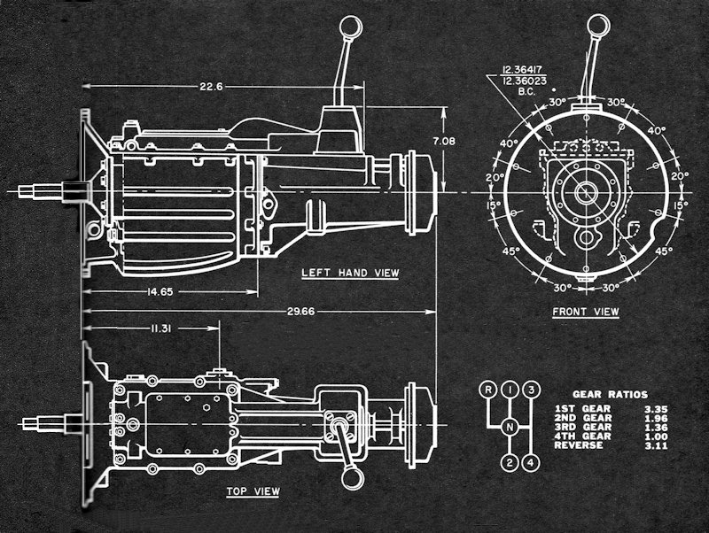

    I don’t remember the exact ratios but the trans is a wide ratio so it does have a low first gear. We are using that to advantage to be able to run a tall axle ratio and not have the car be a dog from a stop. Luckily it will have one of those axles that can change ratios easy so we’ll be able to fine tune it.
    It did not come from a Chrysler powered car, it was behind a 105 Hp Flathead in a Comete and is designed to bolt directly to the Flathead engine. See the picture I showed.

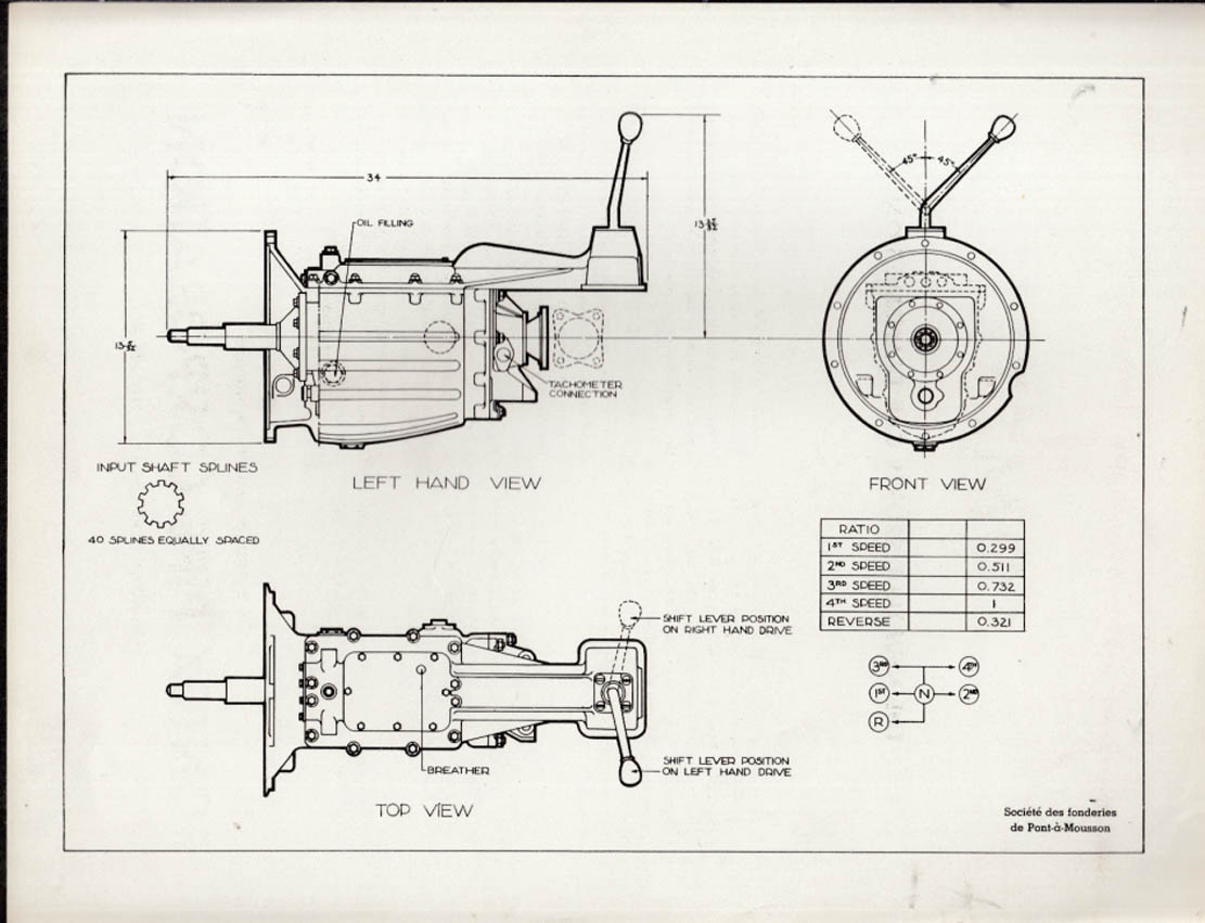

    The Pont A Mousson transmission was designed by ZF in Germany and build in France. Im not sure of the first gear ratio which may be a 2.99 or 3.35, in either case it works out to be a fairly wide ratio and is fully synchronized in all gears.

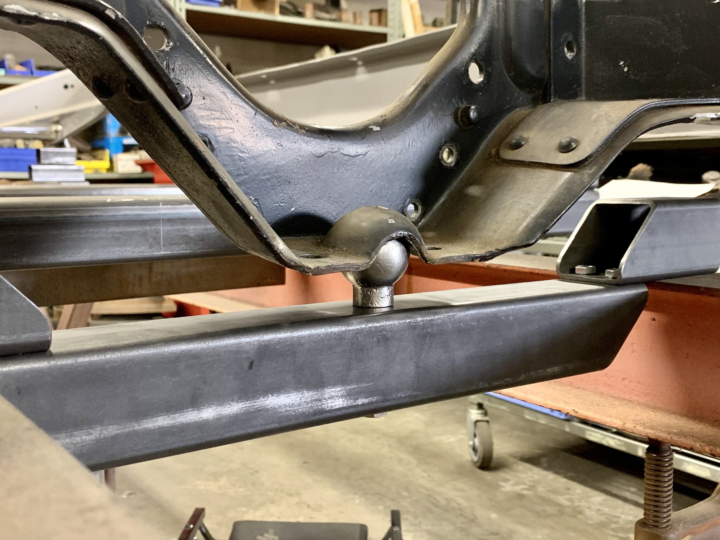

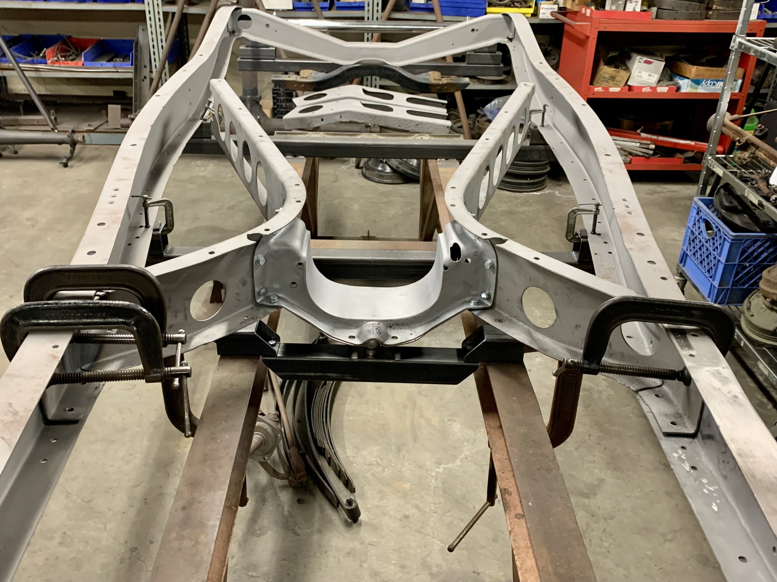

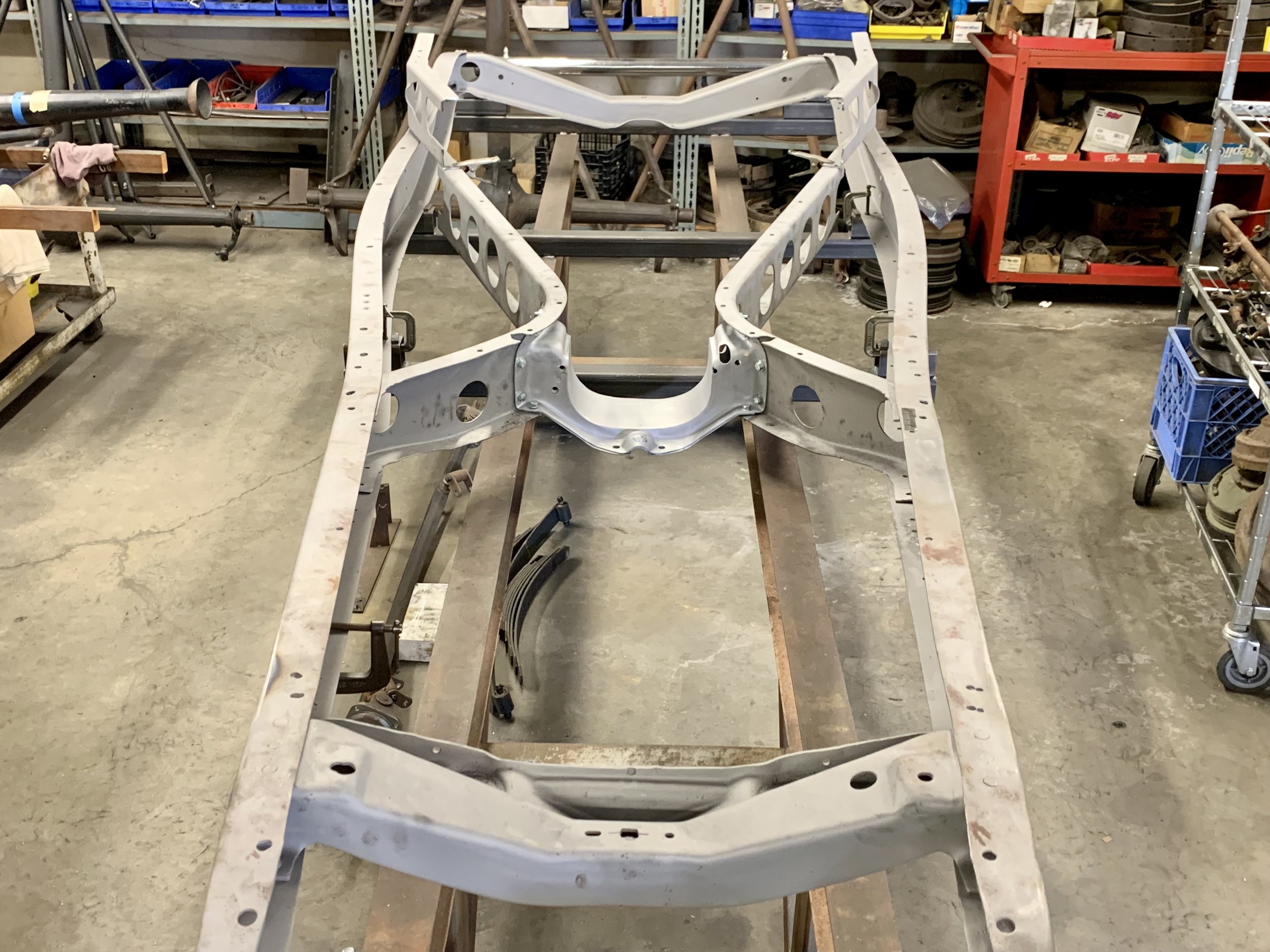

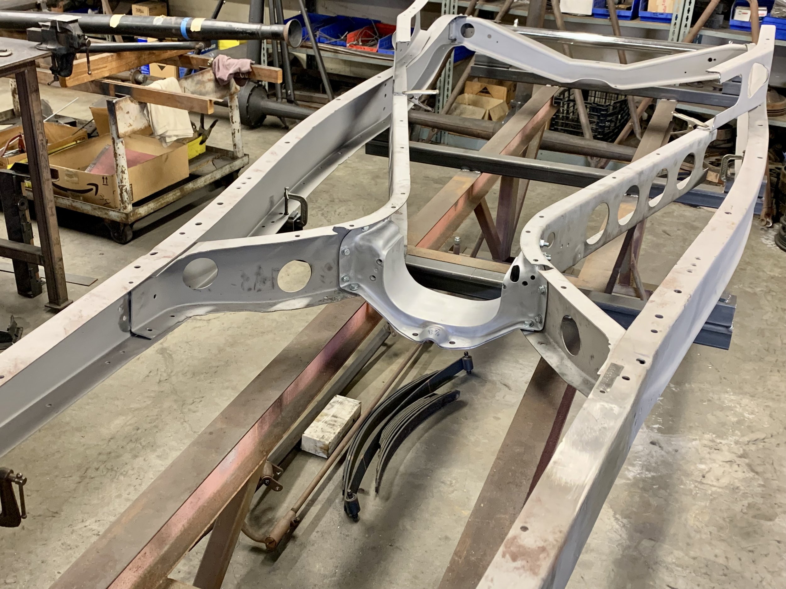

    PART 8 (Finally!)
    With the center saddle modification finished and bolted back between the X legs, the****embly was set on top of the frame to determine the next move. As it was, the 33/34****embly was wider than the 32 frame and too long to the rear.
    I decided the best path was to amputate the rear legs of the X and set them aside while I focused on fitting the front. It is still too wide and while the front of the X is set inside the frame rails, it is too far to the rear but it was great to see it actually IN the frame rather than laying on top of it.

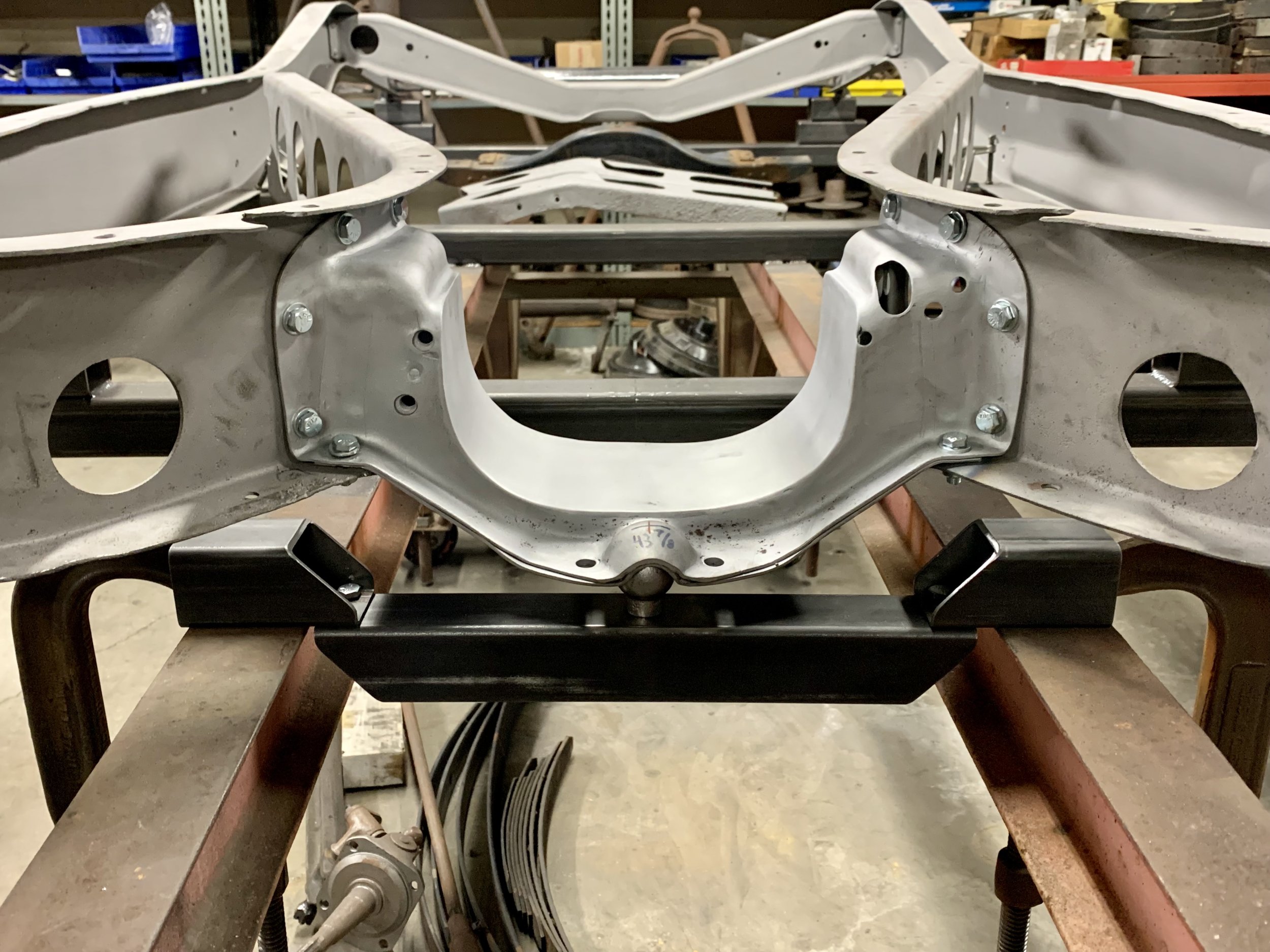

    Since the front axle will have the original, non split wishbone the location of the X will be determined by the wishbone ball and socket in the saddle. The best way to accomplish this will be to create a ball fixture off of the original 32 K-member so it was bolted back in place. I then made a 3-piece cross member out of leftover 2 x 2” tube.

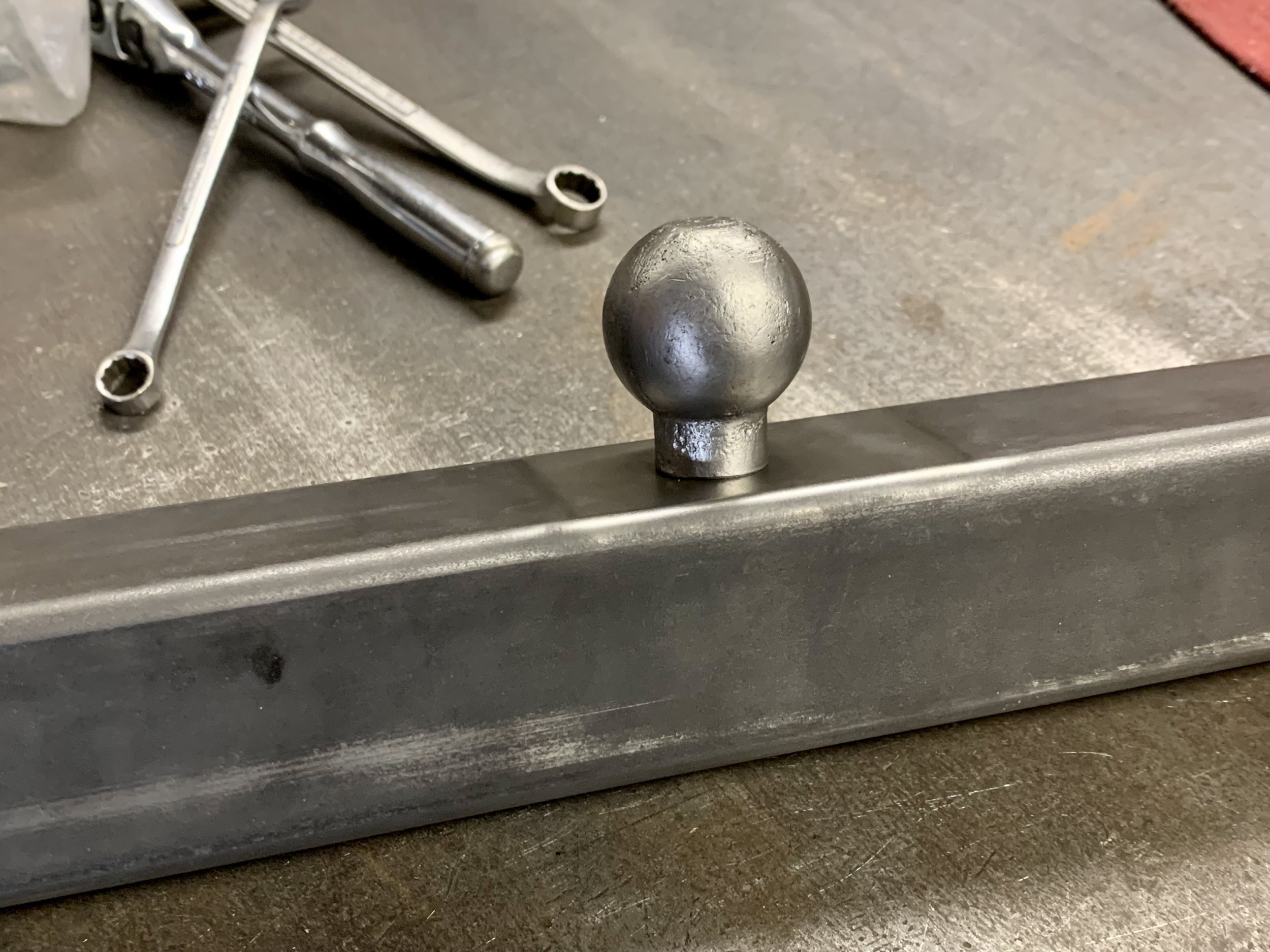

    On a parts shelf I had a scrap wishbone yoke and ball leftover from a split 37-40 wishbone. I cut the ball off, drilled and tapped it then bolted it to the cross member I had made previously.
    The cross member was then clamped tight with the ball engaged in the K-member socket. The reason for making the cross member 3-piece is so that the main center section can be unbolted and removed (if need be) without disturbing the end pieces that are clamped to the frame jig. This way it can go back into exactly the same place if removed. Once happy with the fit the K-member was removed.
    In order to get the X****embly far enough forward to line up with the wishbone ball it was necessary to pie cut where it converges into the frame rails to adjust the width and angles.
