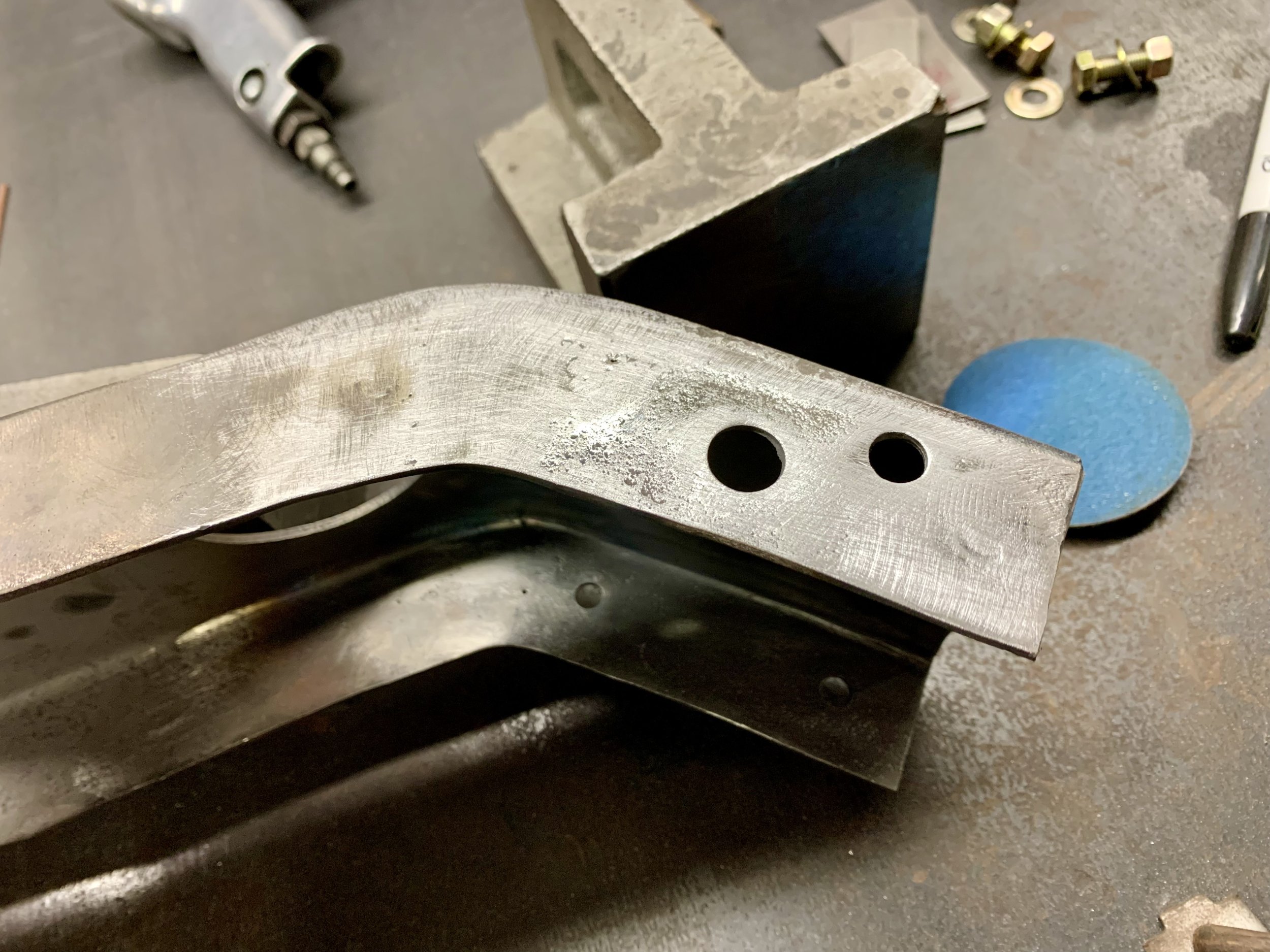

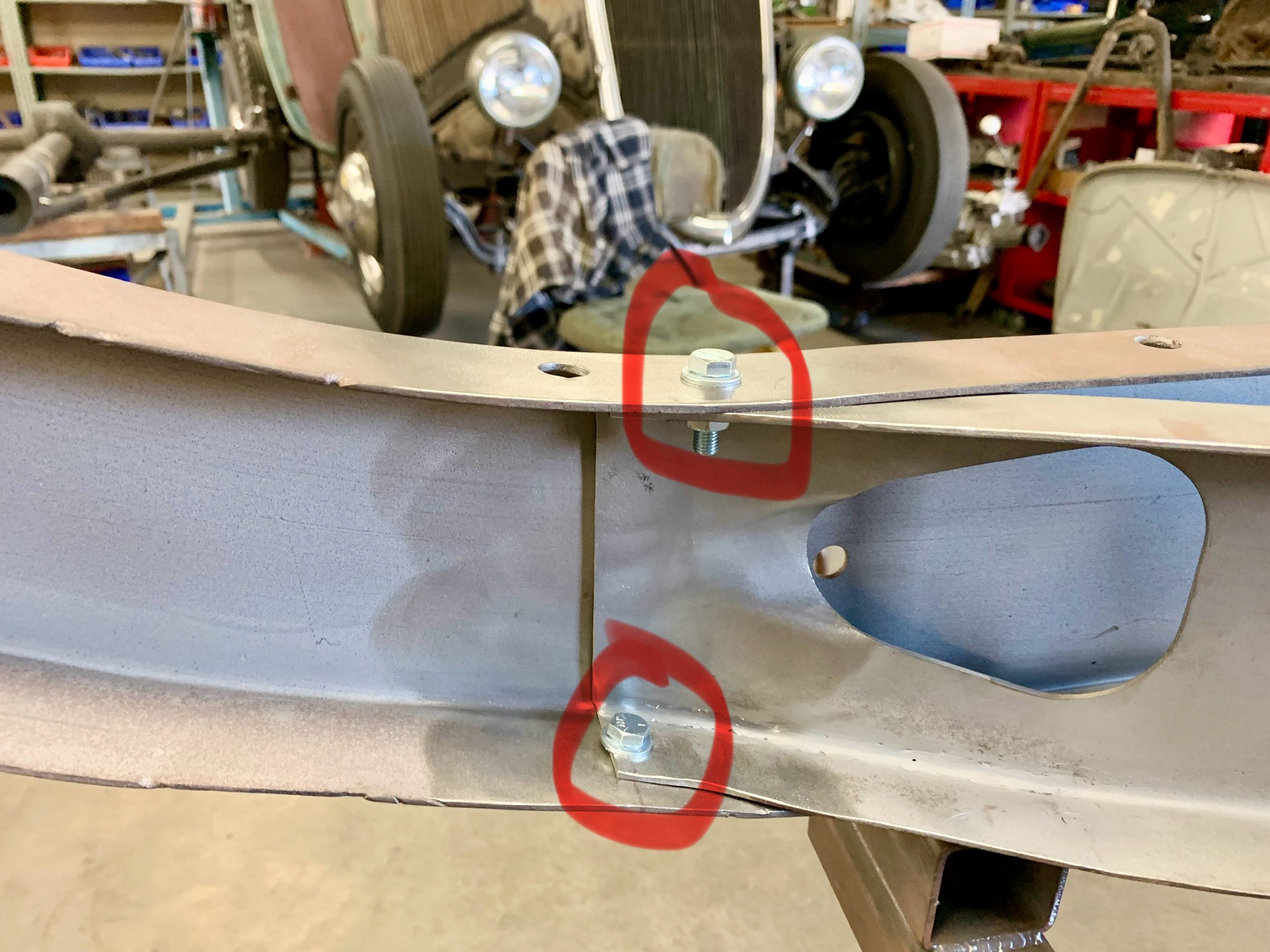

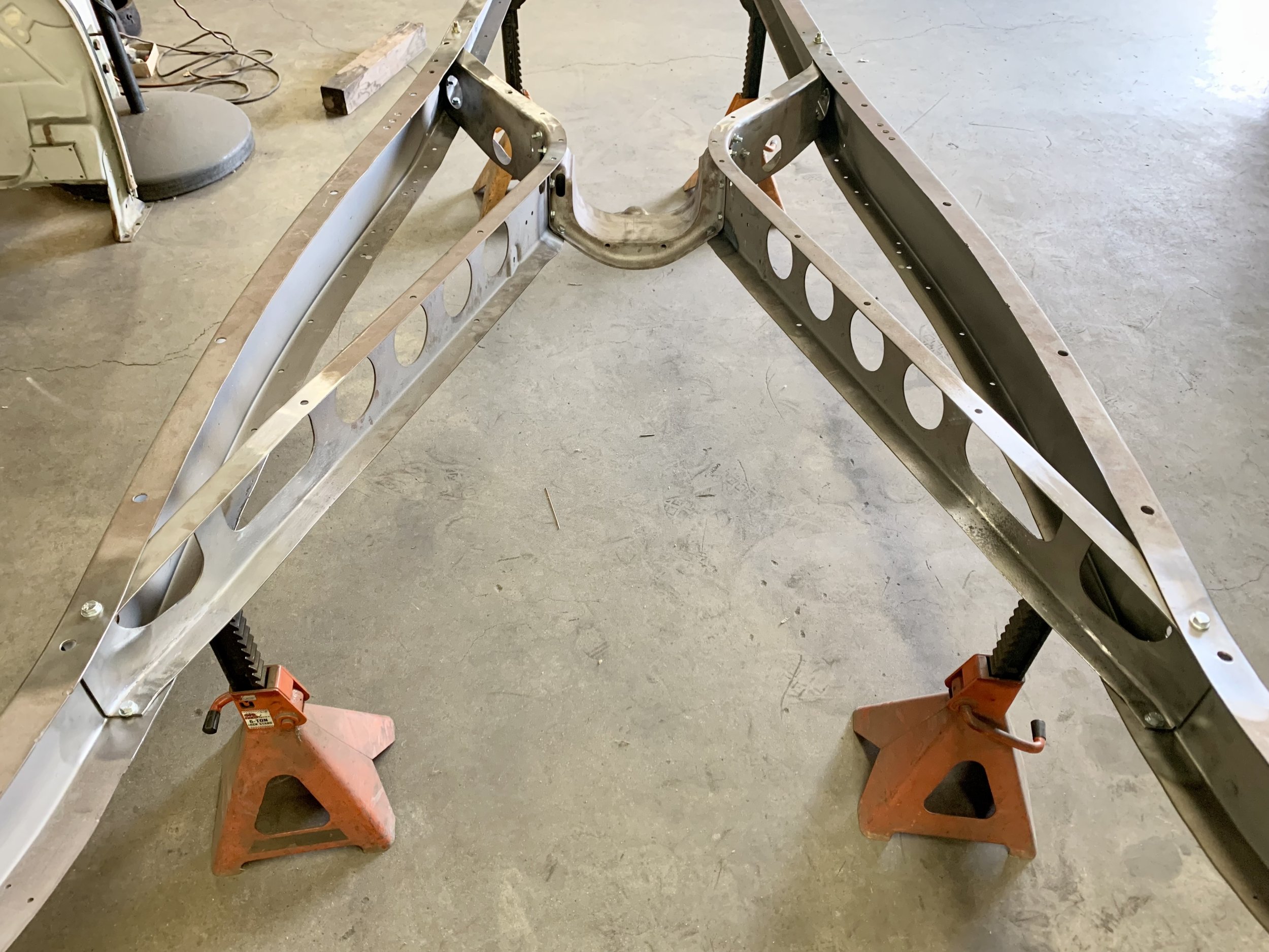

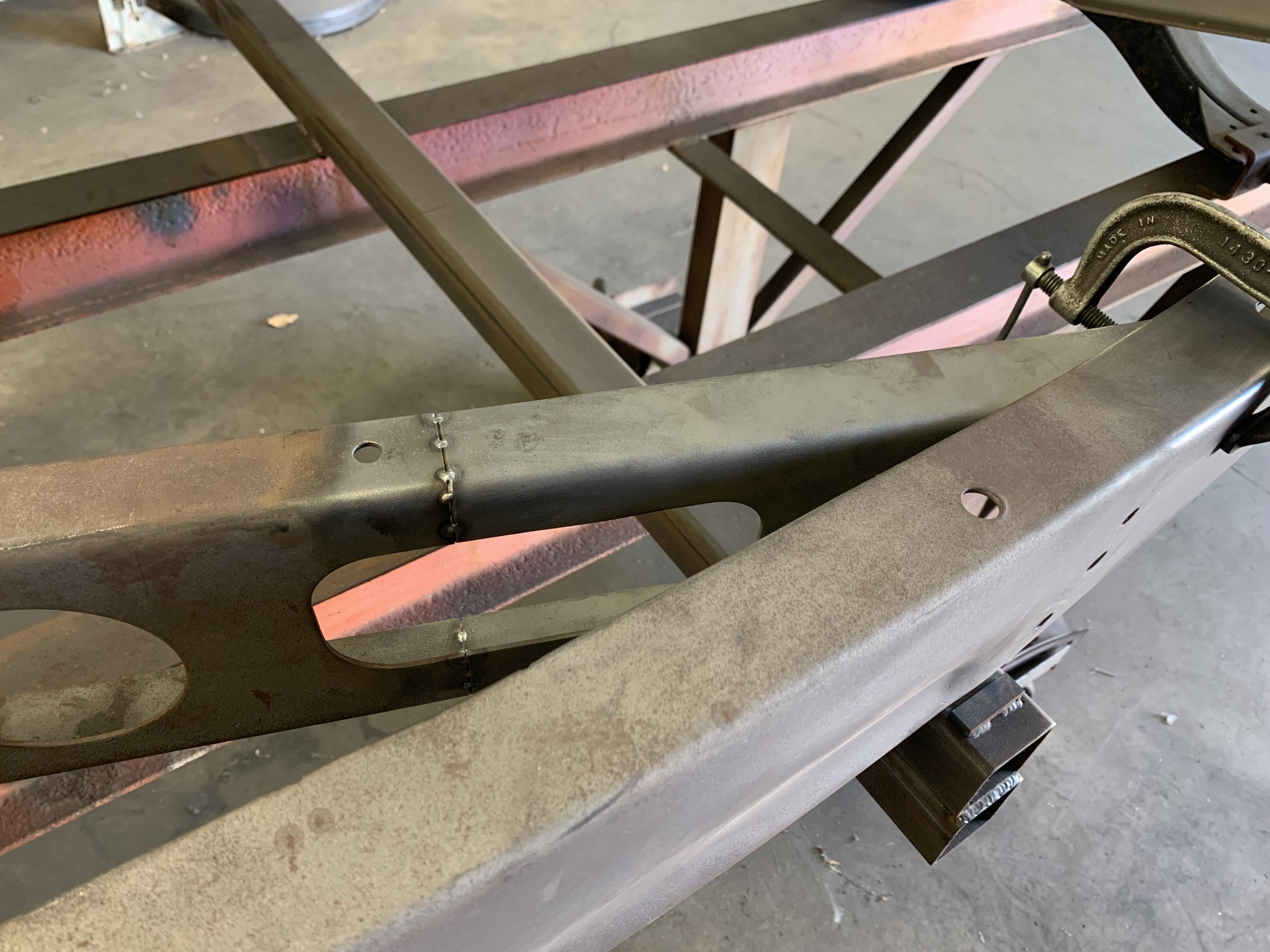

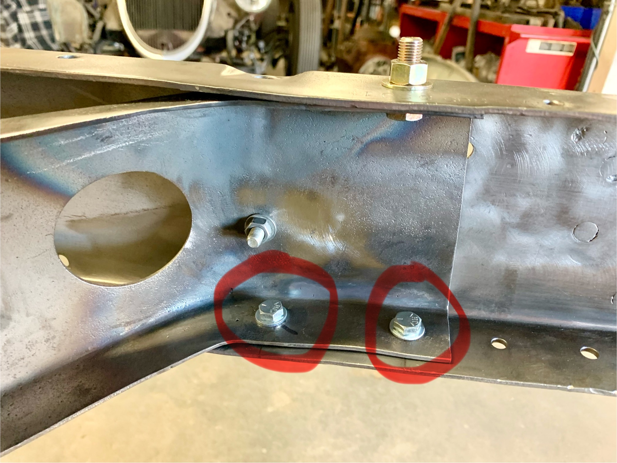

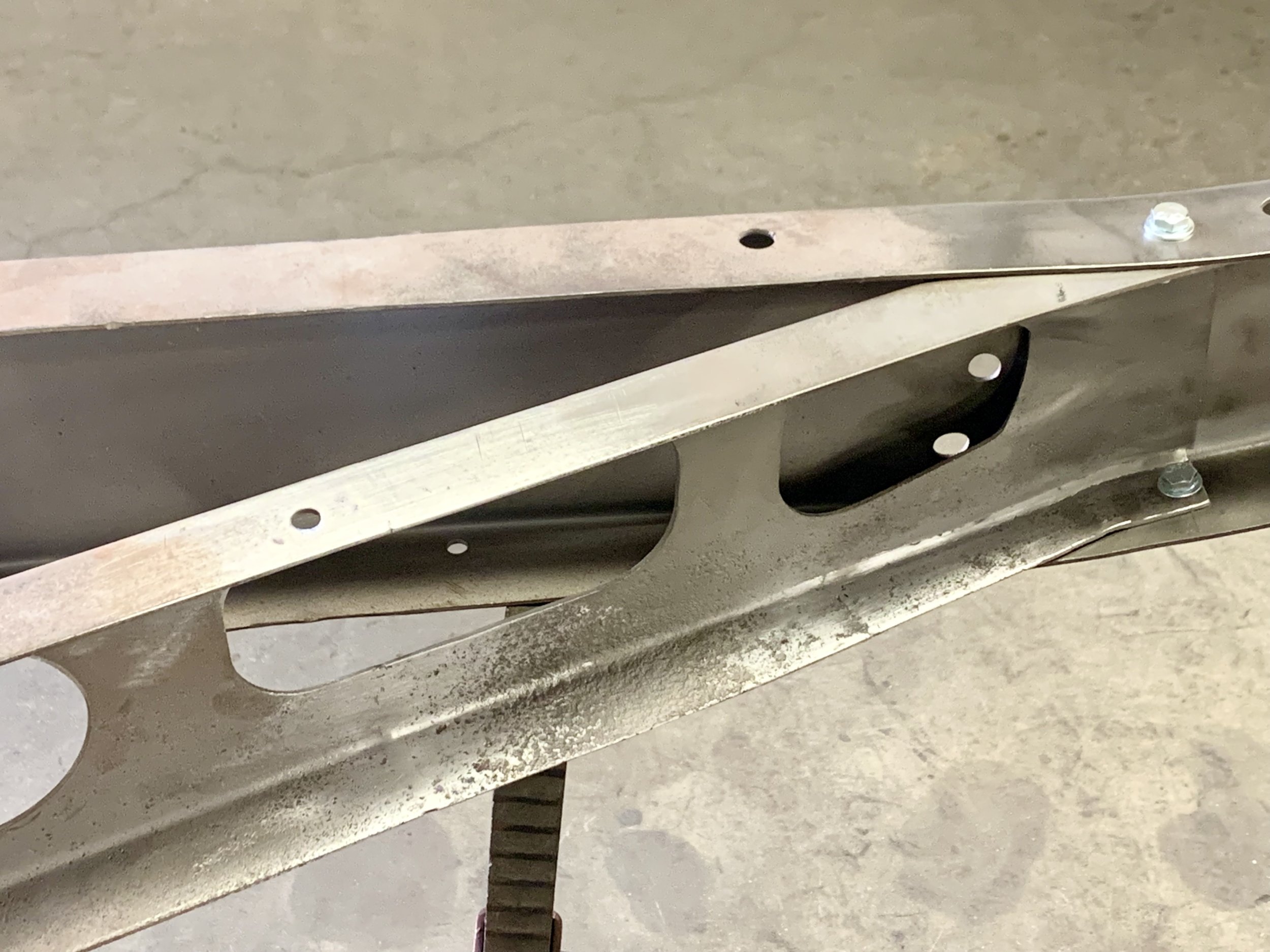

    After pie cutting the X legs as necessary I also used heat to fine tune the fit into the frame rails. This is one of those times where things have to get a little ugly before they get pretty. Just keep in mind if you’re doing things like this, it’s only metal! Once satisfied with the fit and verifying the X****embly is centered I match drilled 2 holes on each side that will be used when the car gets****embled. On top is the forward firewall foot bolt and on the side is one of the front fender bolts. After tightening the bolts, the clamps were removed and I began tacking the cuts and for the larger gaps making little filler wedges to weld in. The idea here is not to completely weld all the cuts that were made but to do enough that everything will stay put so the X****embly can be removed to work on outside of the frame.
    At this point the X****embly is removed from the frame and all of the remaining welding, sanding and smoothing is done. As these X pieces were stamped by Ford there is extra, uneven material left in the 4 inside corners of the channel. They were marked and ground into a smooth radius.
    The X****embly was reinstalled using the previously matched bolt locations to check fit which, thankfully, is right-on.

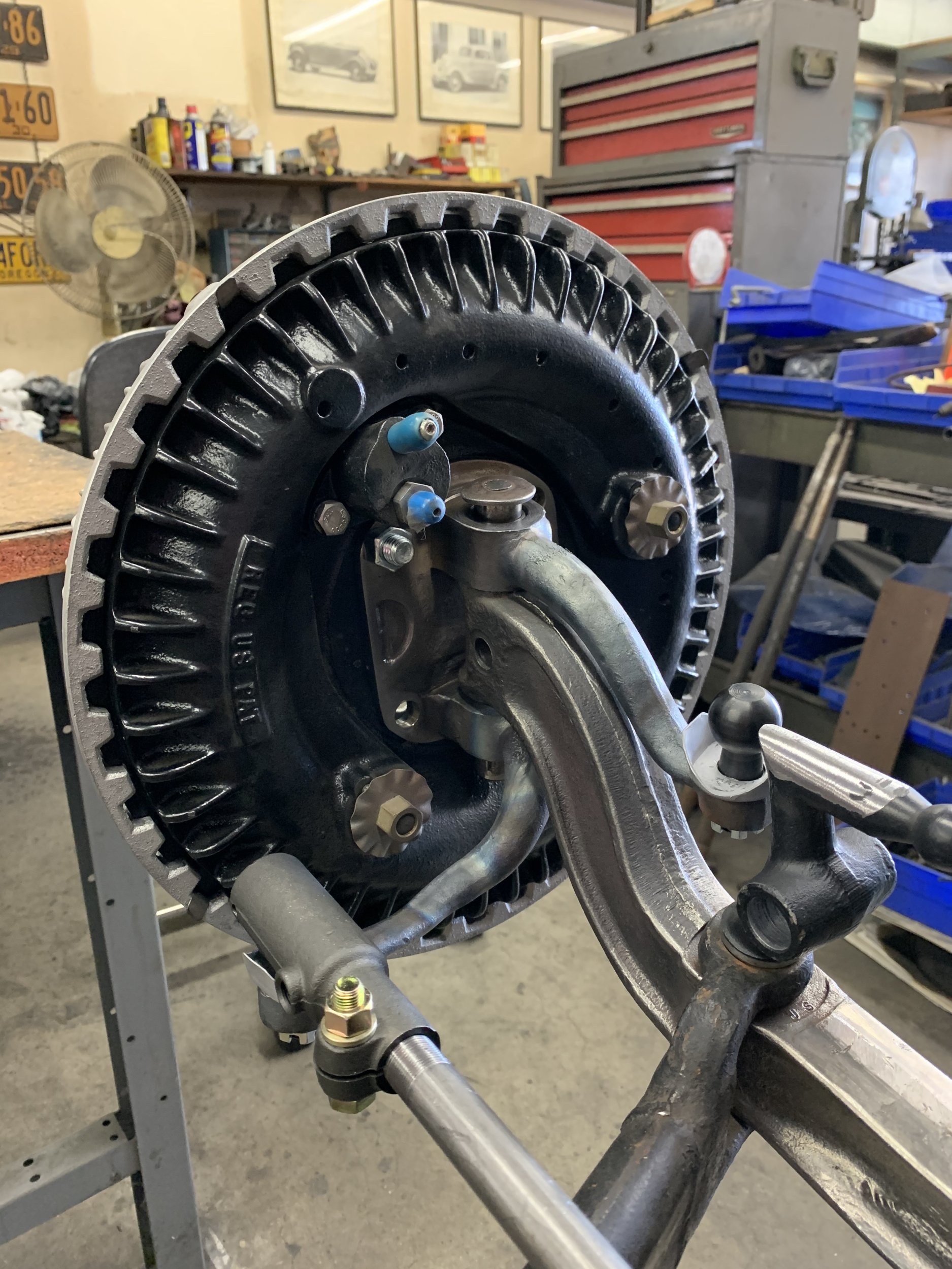

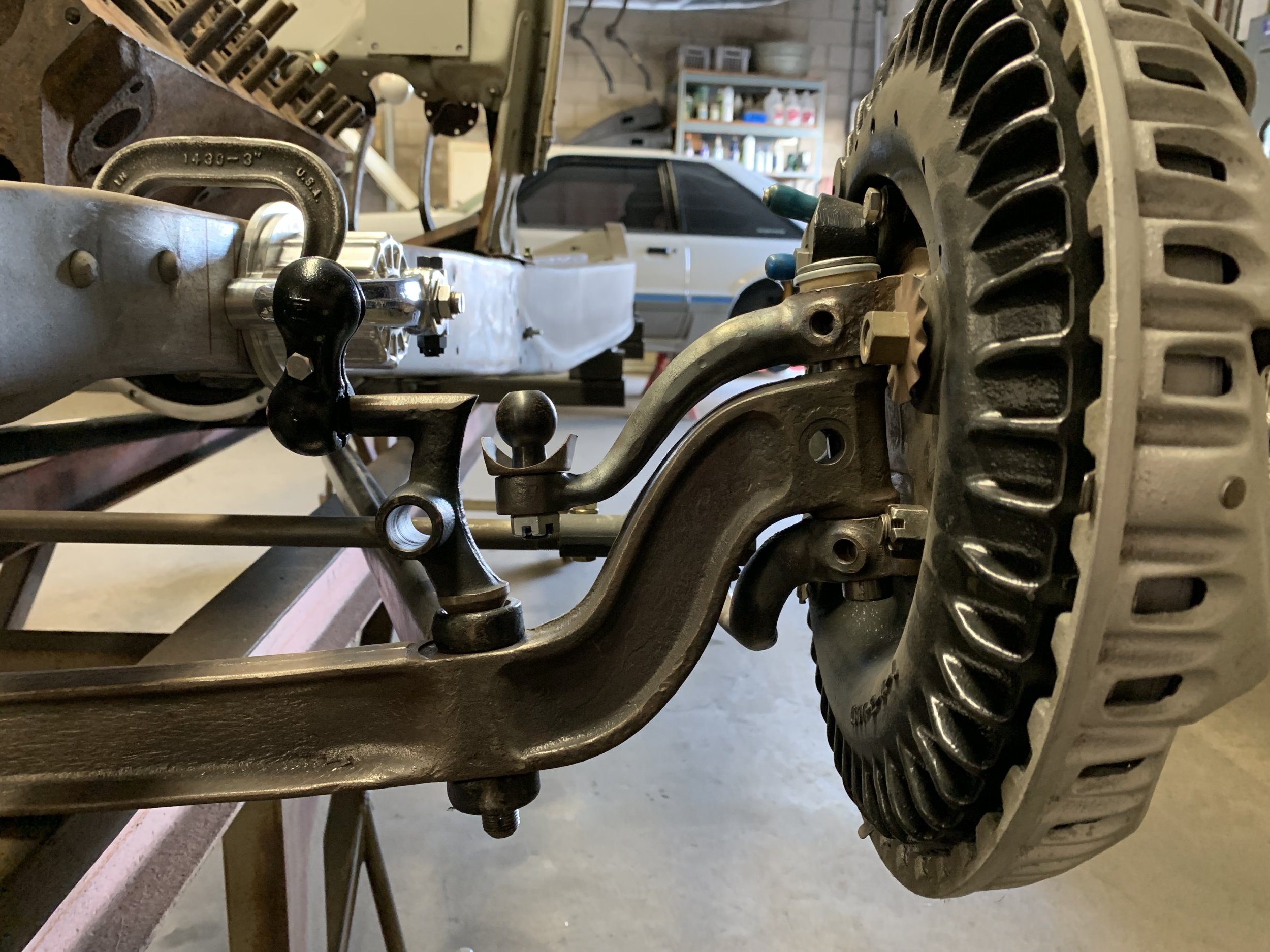

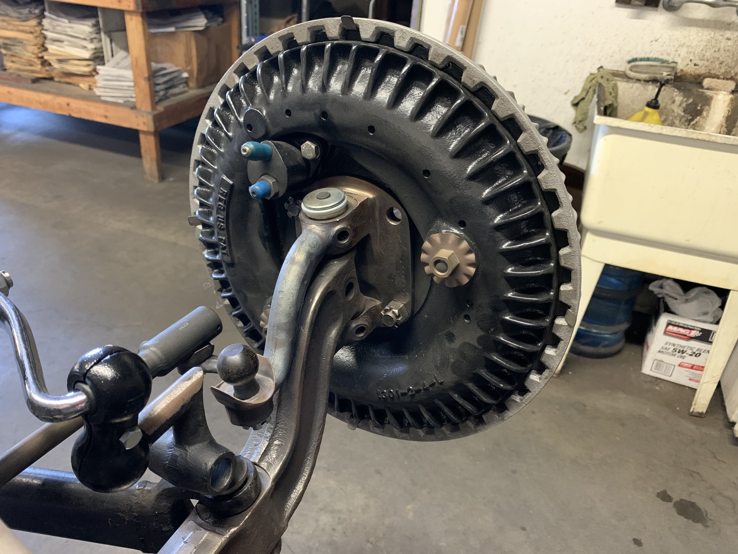

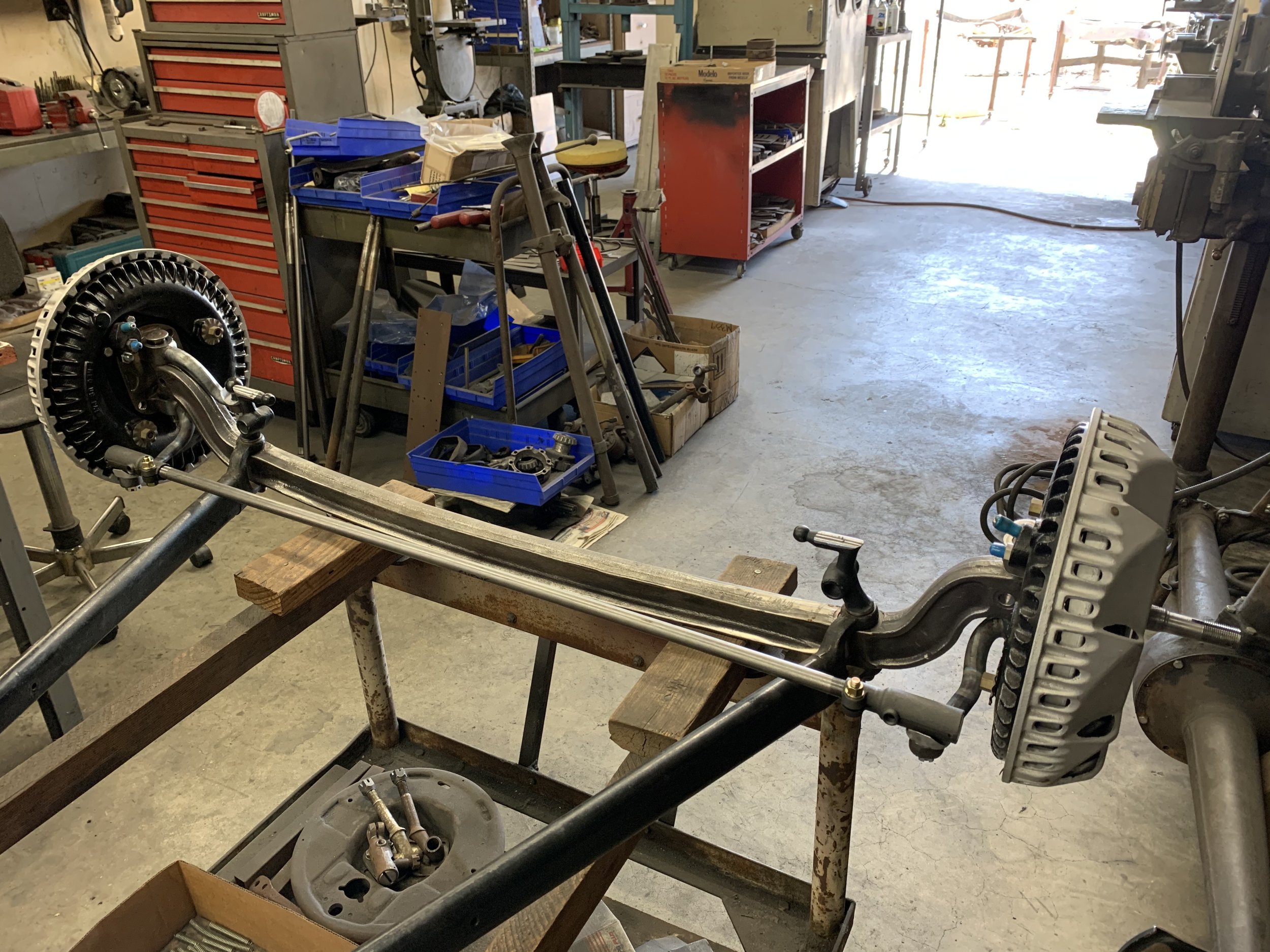

    This part actually happened before any of the frame work began. This is the front axle setup that will be used. I didn’t get any pictures during the process but below is a description and pictures of the finished setup.
    - Dropped original 32 axle by Greg Haynes / Anson Axle
    - Original 32 spindles. Steering arms modified to fit axle by me. Brake mounting flanges modified by adding material, welding original 3/8” brake plate holes and drilling new 1/2” mounting holes in the 1937-1948 pattern by Neil Jennings.
    - Original 32 style tie rod.
    - Original 32 spring perches with mechanical brake supports removed and sculpted.
    - Original Kinmont brakes.

    Looks good, thanx for keeping us updated. Where did you source the tie rod ends, are you happy with the quality?
    Tom
    chryslerfan55 and Dennis Lacy like this.
  6. Dennis Lacy
    Joined: Apr 27, 2008
    Posts: 1,457
    Dennis Lacy
    Hi Tom. The tie rod ends are from Snyders Model A in Ohio. Very high quality and look identical to the originals. There’s others on the market that are just awful.
  7. alchemy
    Joined: Sep 27, 2002
    Posts: 22,637
    alchemy
    Is the tie rod itself from Snyders too? Is it a thick wall tube?
  8. Dennis Lacy
    Posts: 1,457
    Dennis Lacy
    Yes, the tie rod is also from Snyders, it is solid bar like original Model A’s. One could use tube like 32-34 but you will need to install 2” long plugs in each end like original so that when the tie rod end clamp bolts are tightened it doesn’t squeeze the tube.

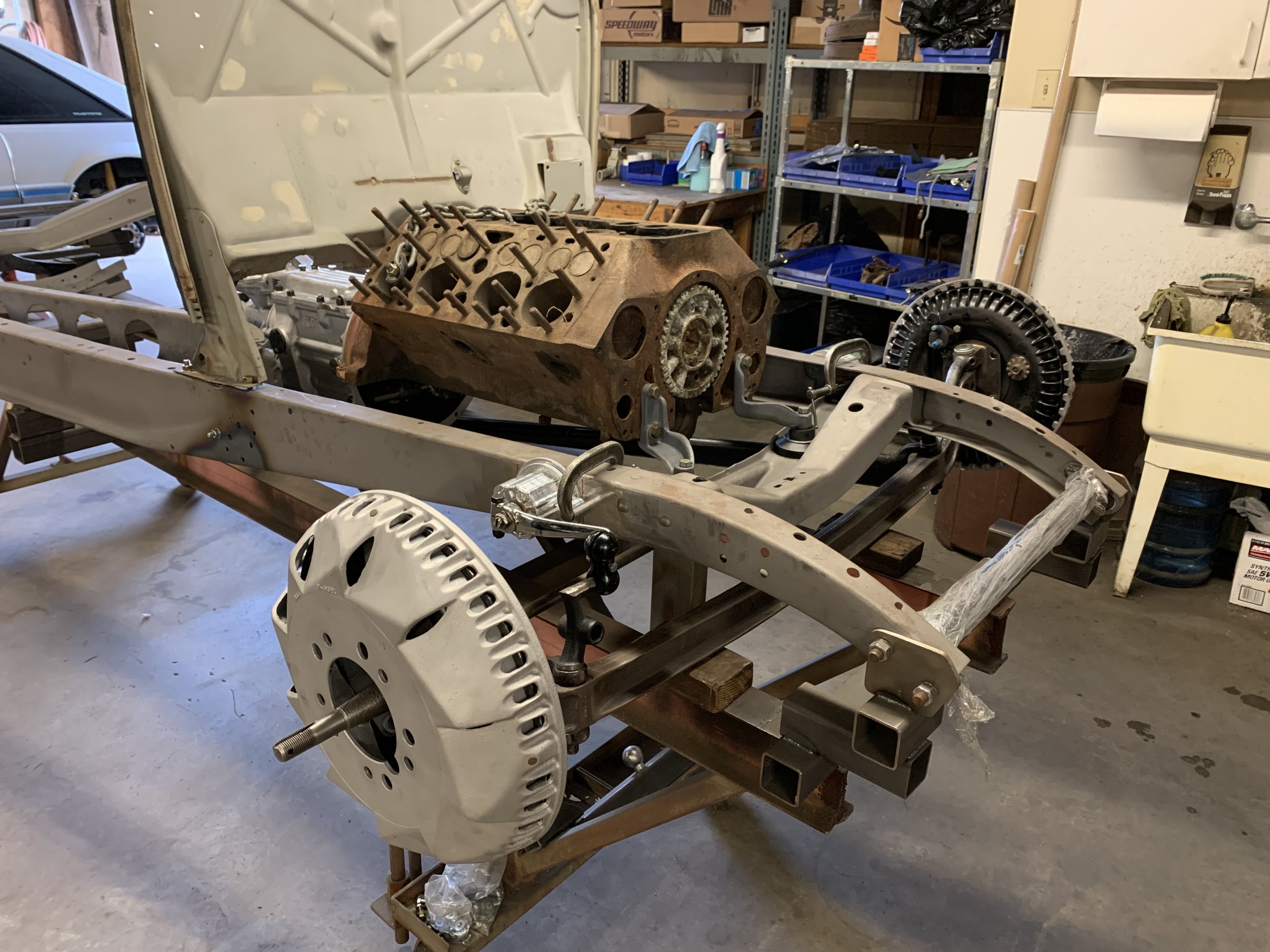

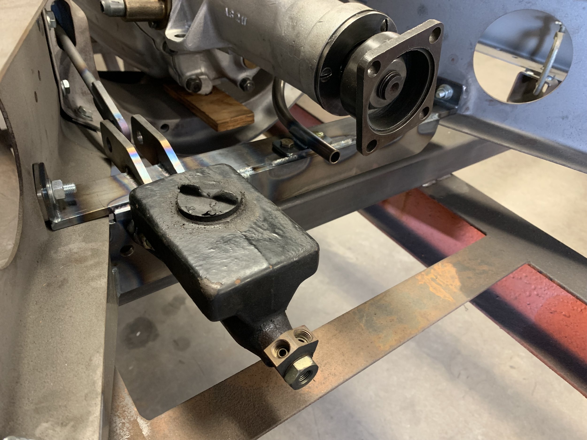

    PART 11

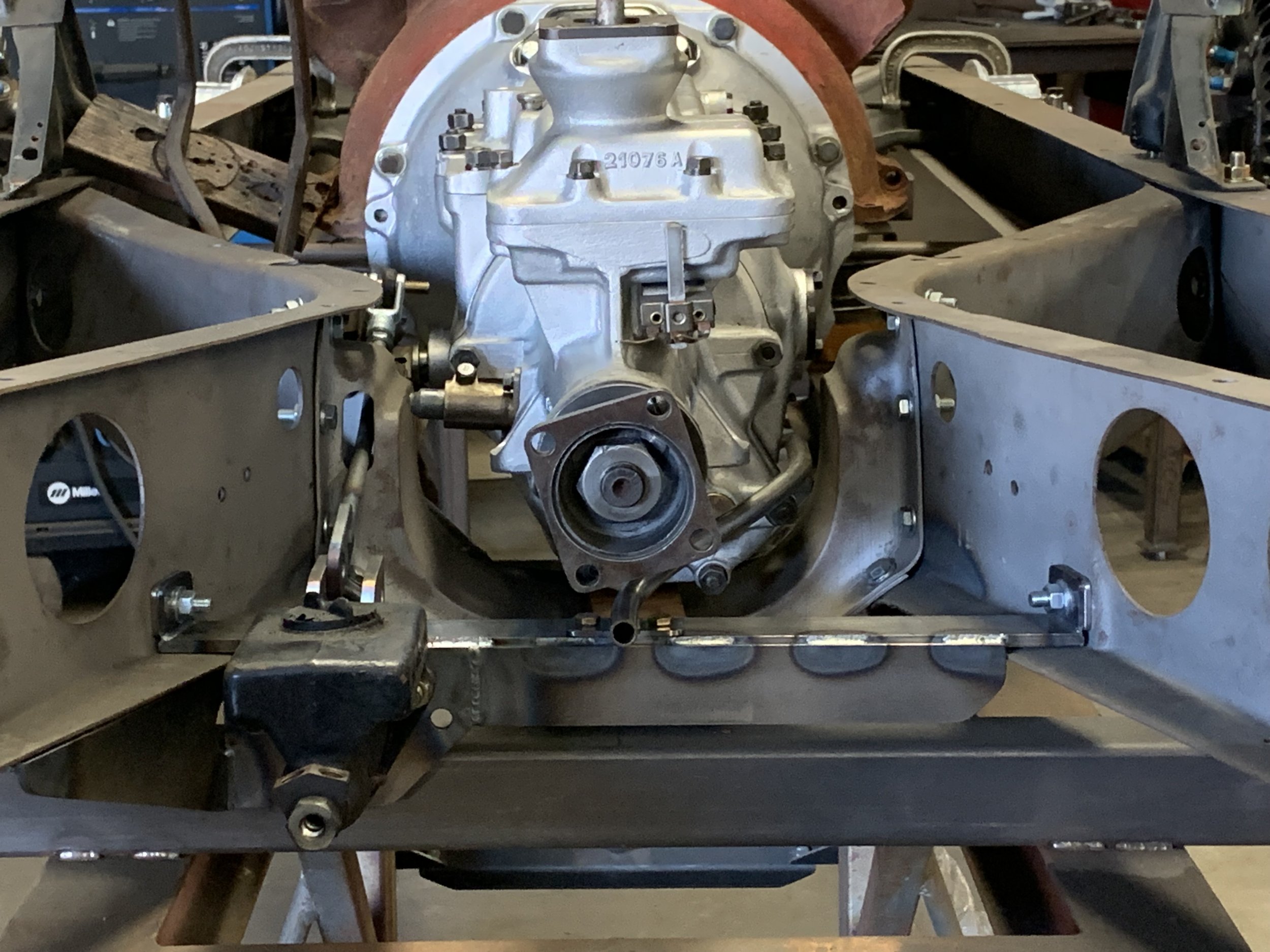

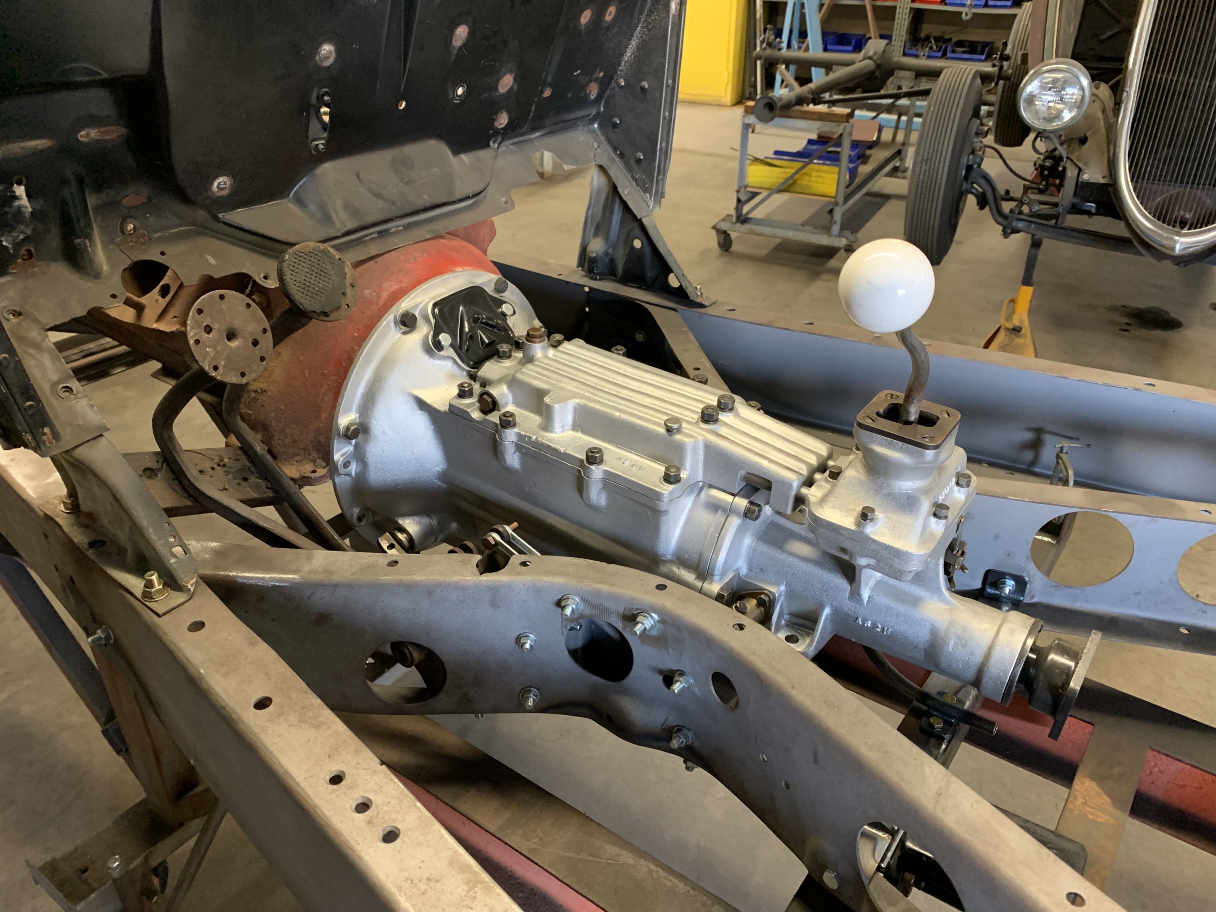

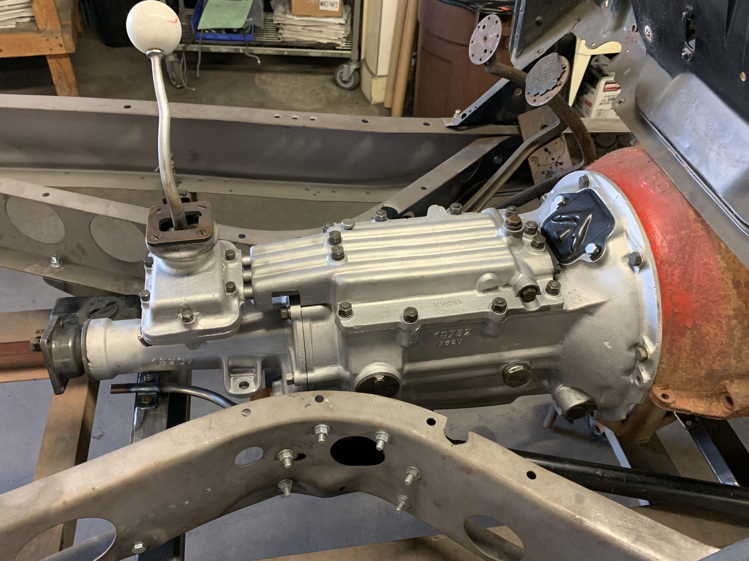

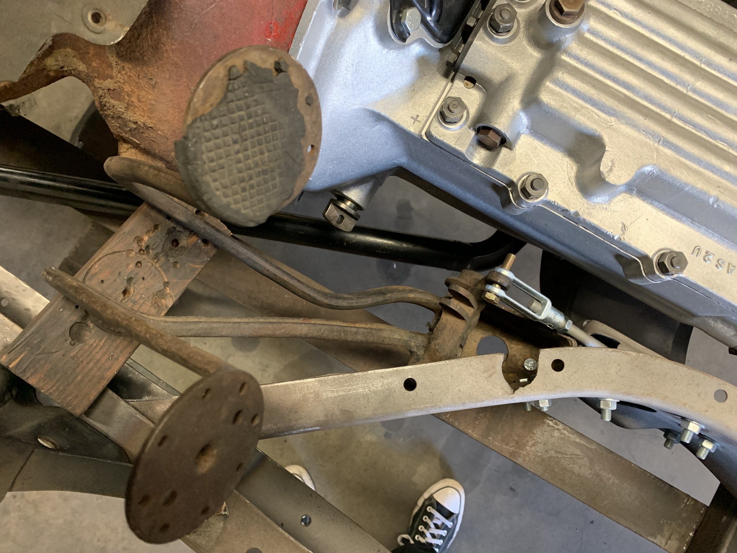

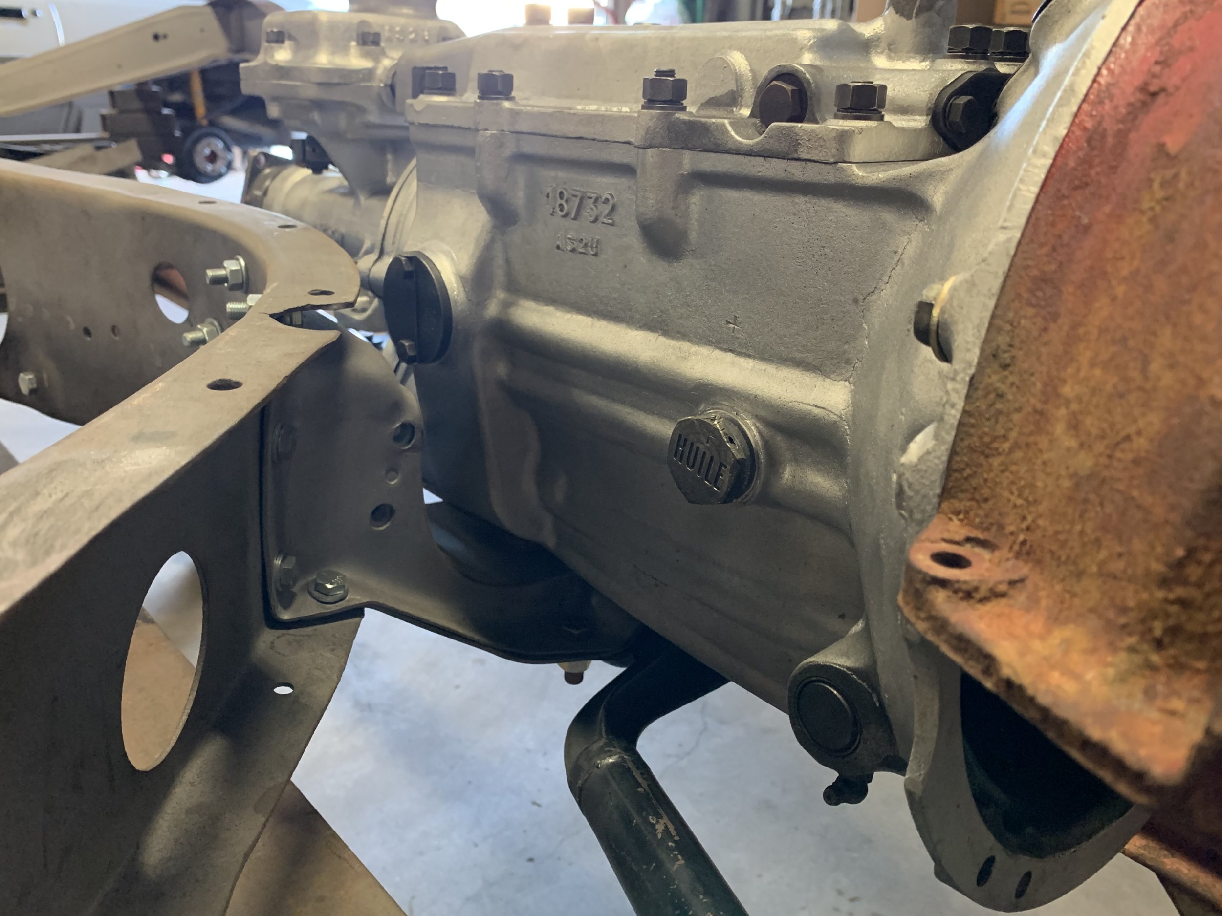

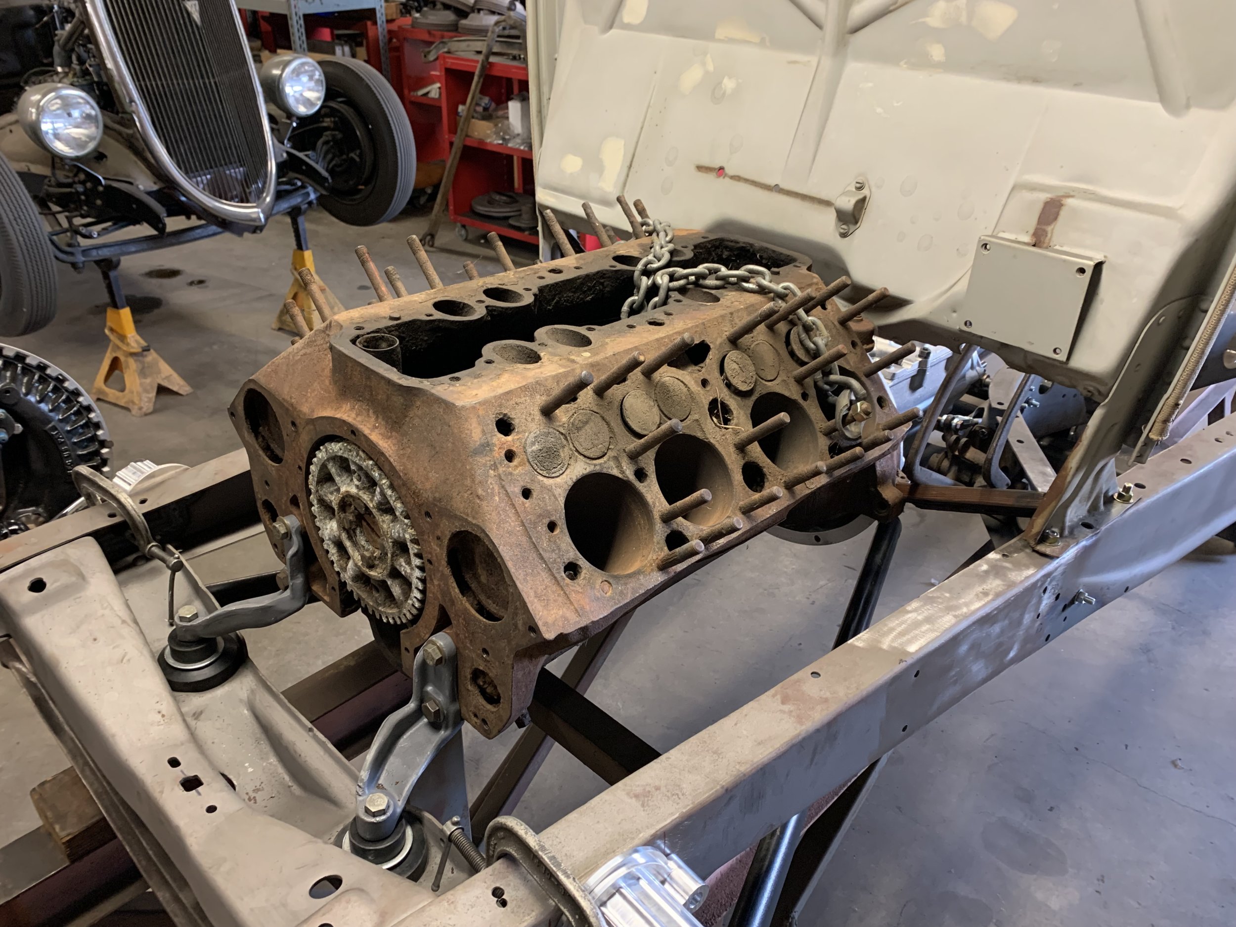

    With the front of the X now fitted and the front axle****embly mocked up I felt the best next move was to offer up the front end, a mock up block and the transmission to see how all this stuff would play together. You can plan and plan and measure and measure but you just never know until you put it all together. Big thanks to my friend “Hudson Joe” Buffardi for donating the crusty mock up block!
    I was very happy to find that everything I’ve done so far looks like it will work nicely just as I had envisioned. The transmission fits perfect through the X and modified saddle. For now I have installed a pair of original 1932 front motor mounts as a means to properly locate the engine fore/aft and am using the smaller parts of the motor mount biscuits that would normally go on the underside of the cross member to space the engine upward 1” which helps fill out the under hood and provides lots of clearance for the tie rod. The bottom of the firewall will require some trimming as expected.
    The pedals are 1934 making them a bolt-in with the X and aside from some minor tweaking are already well positioned. I also mocked up one of my 1933/1934 master cylinder brackets which fits beautifully but after some discussions about rear suspension design with friends Derek Bower and Peter Eastwood, this will likely be abandoned.
    The shocks are going to be a full set of reproduction Roto-Flo. As this project continues it will become apparent that there will be a prominent aluminum parts theme.

    So cool that the pedals lined up well with the floorboard, just by positioning the X with the stock wishbone. I’ve got a 40 frame that could donate its X, and wonder how well the pedals will coordinate with the firewall and floor.

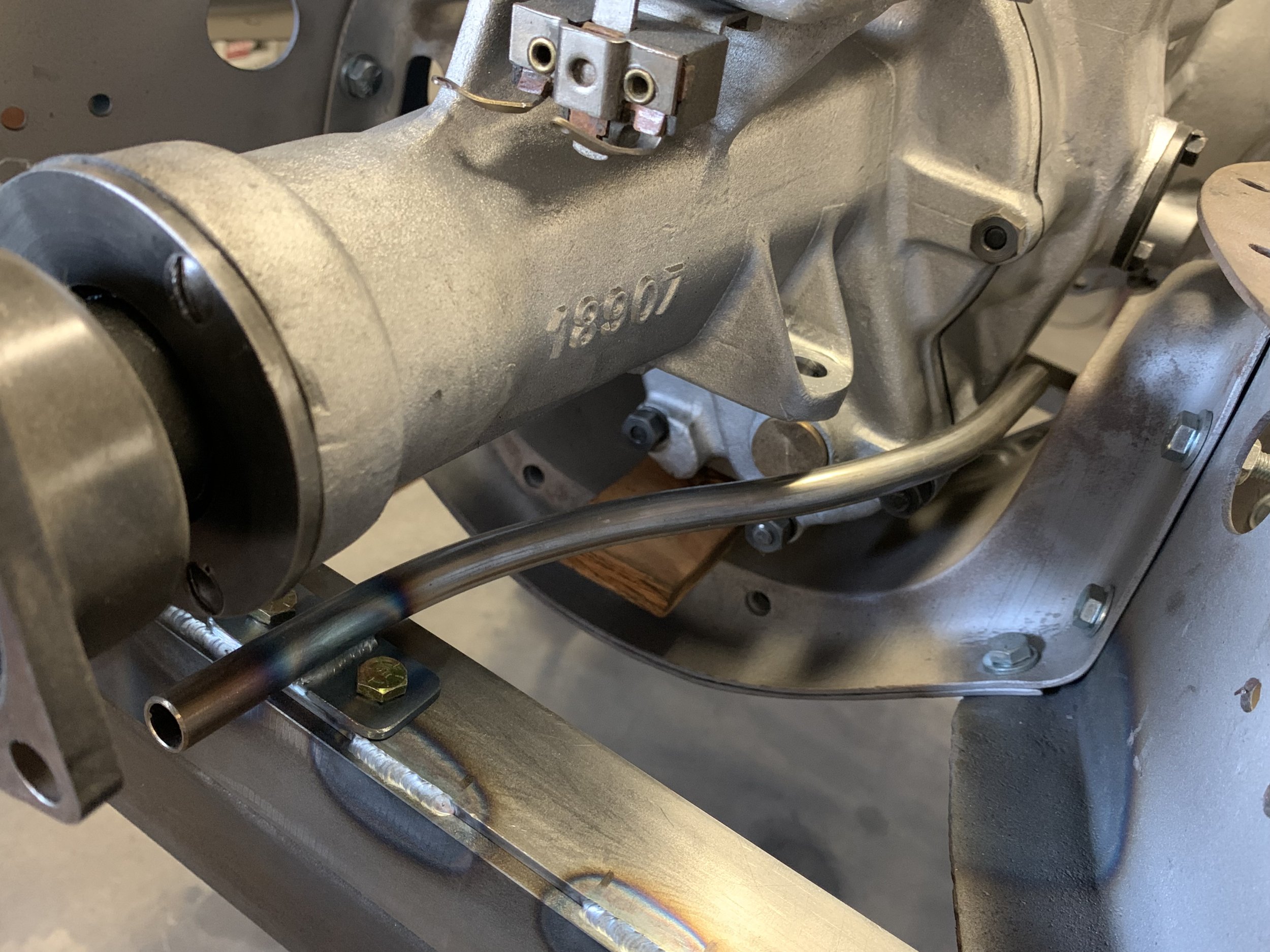

  14. @Dennis Lacy is that at vent tube, coming from the pass. side?
    Dennis Lacy likes this.
  15. Dennis Lacy
    Posts: 1,457
    Dennis Lacy
    That tube is part of my 33/34 hydraulic conversion bracket kit. The front parking brake cable runs through it. I had it there to see if it would fit around the trans.

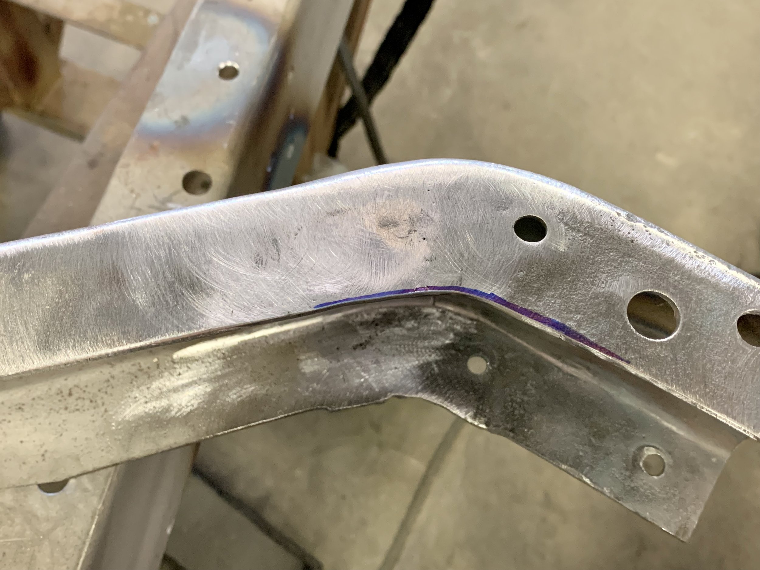

    PART 12

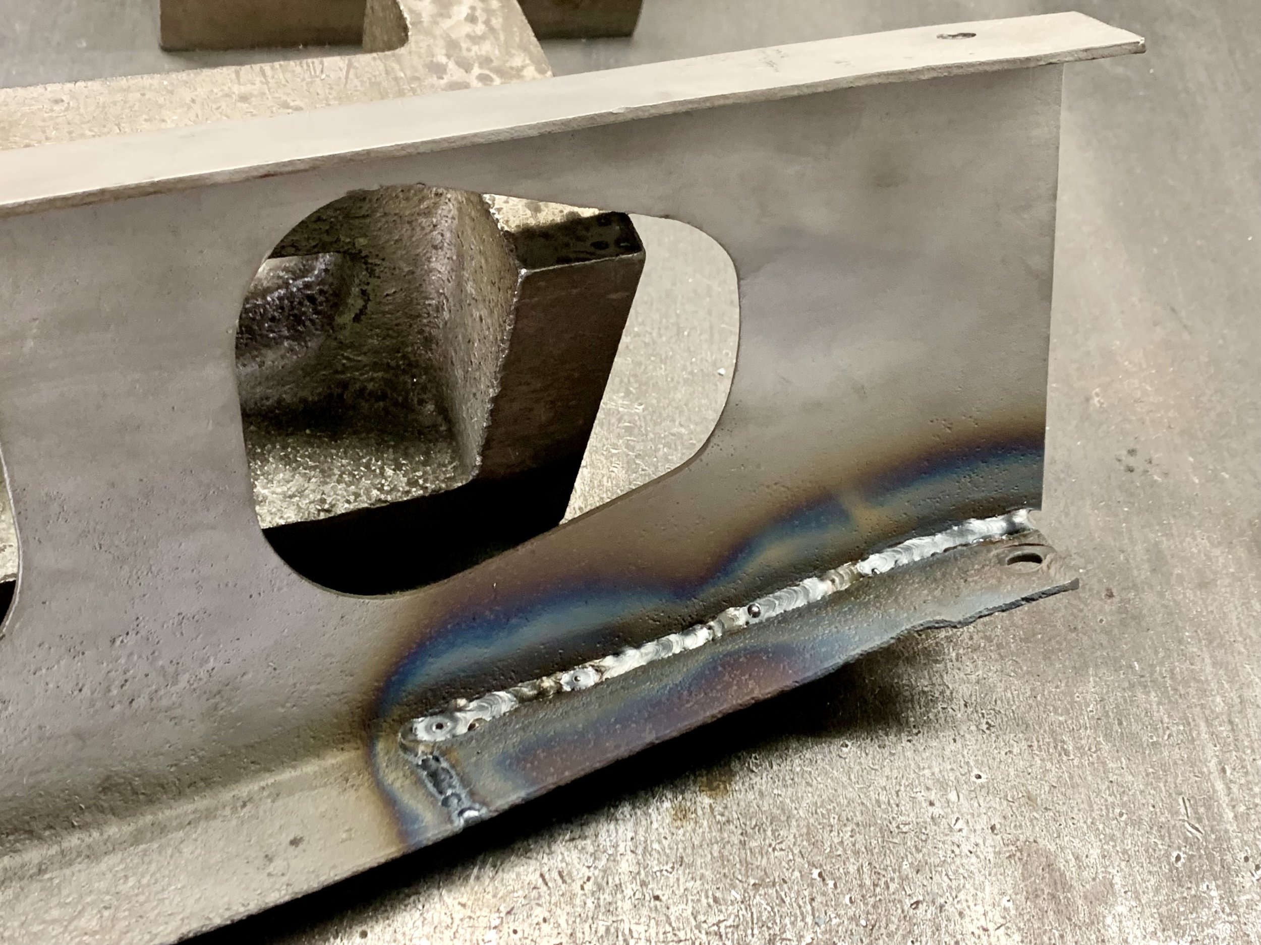

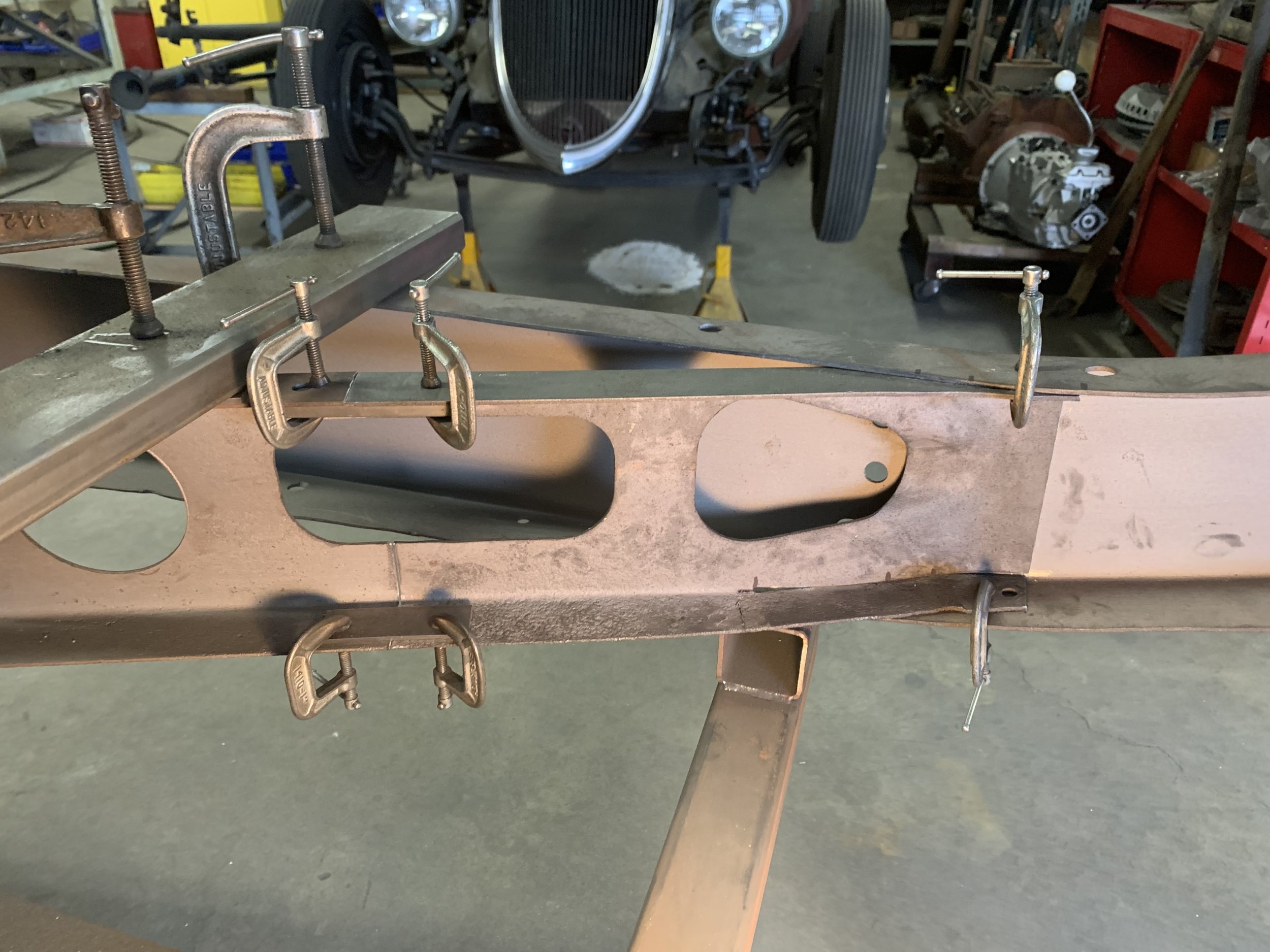

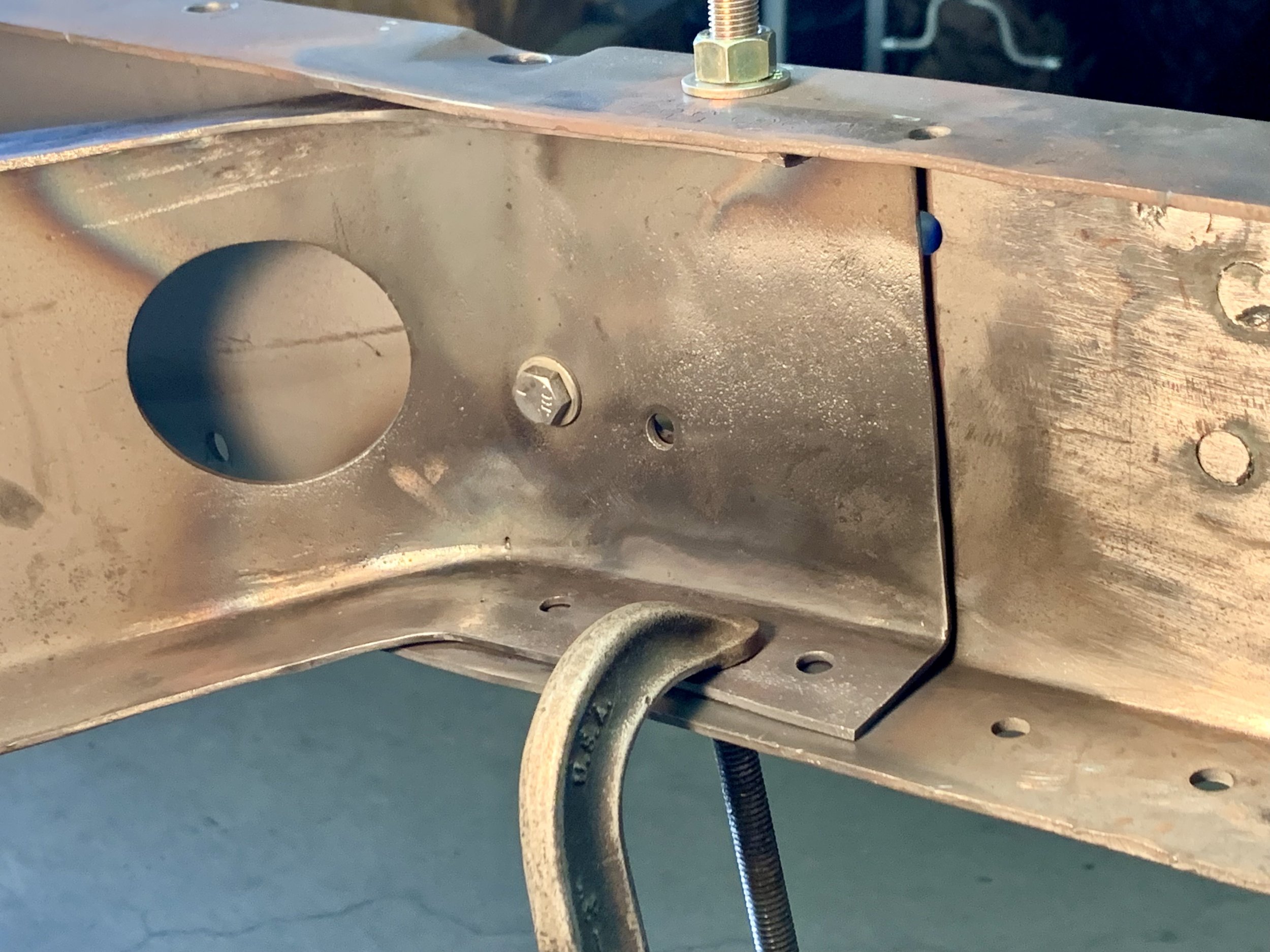

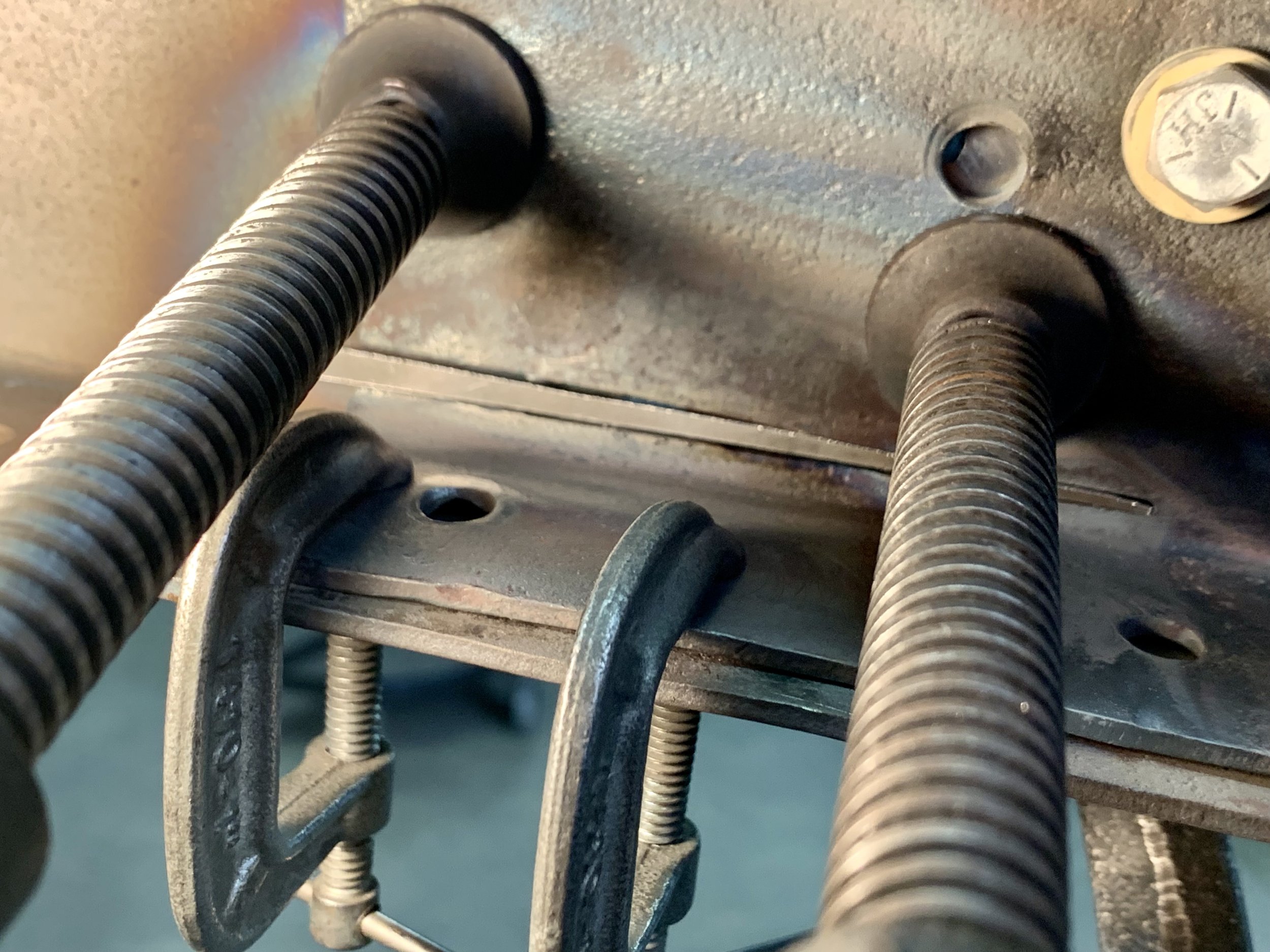

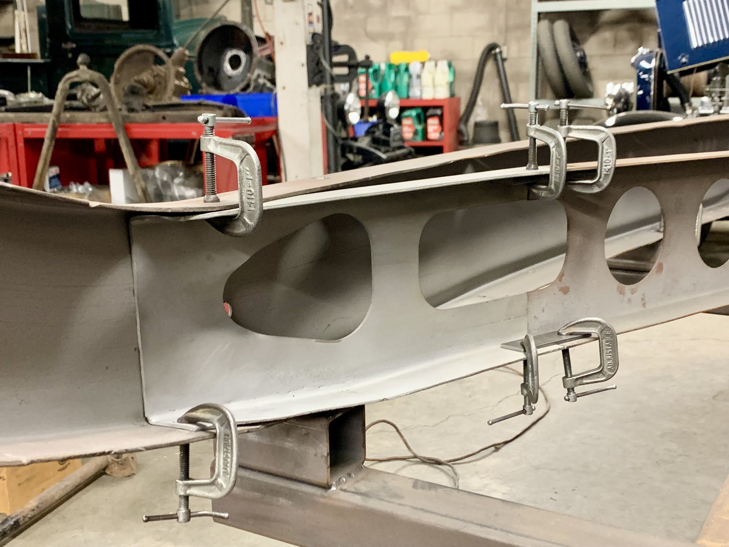

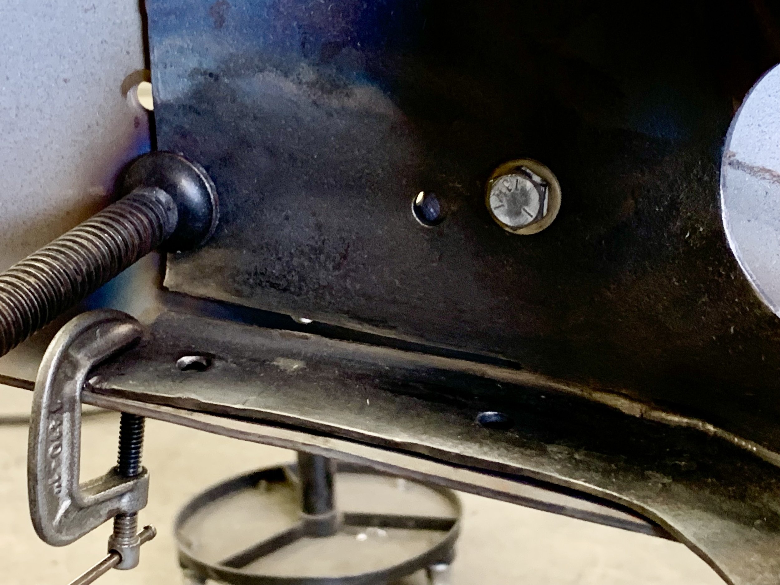

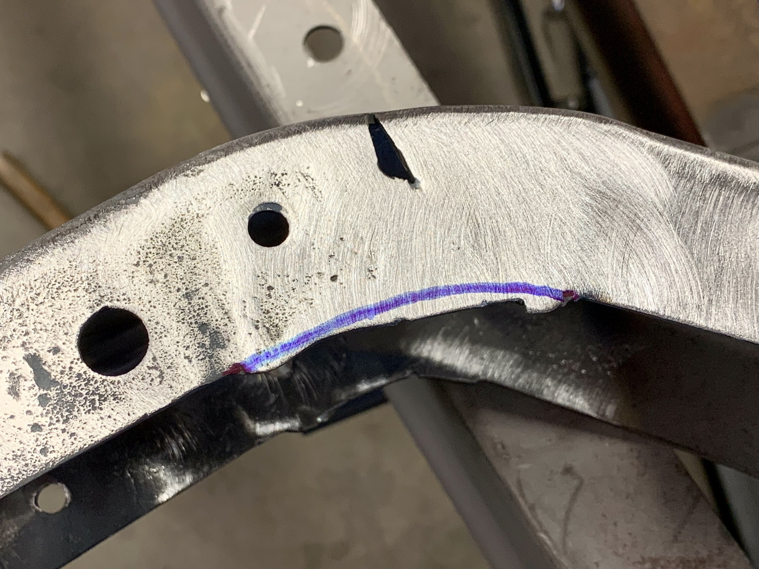

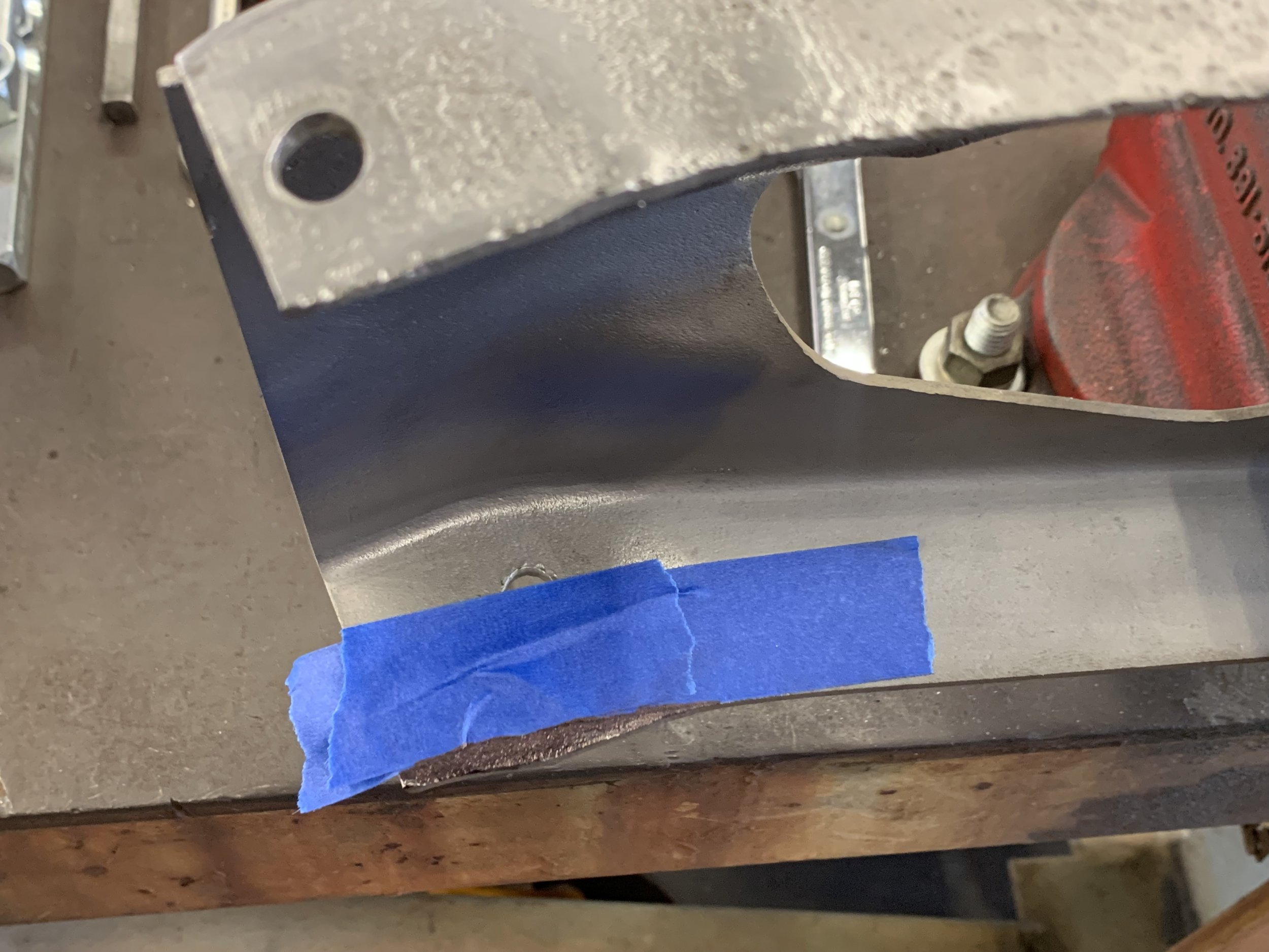

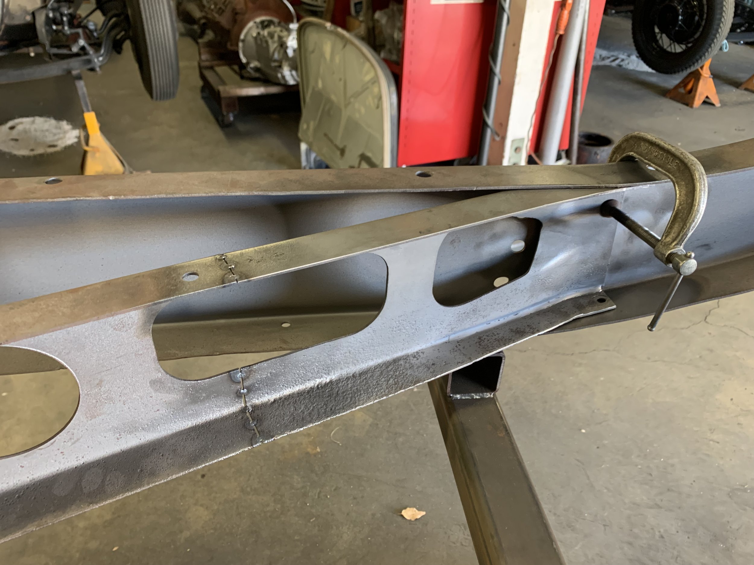

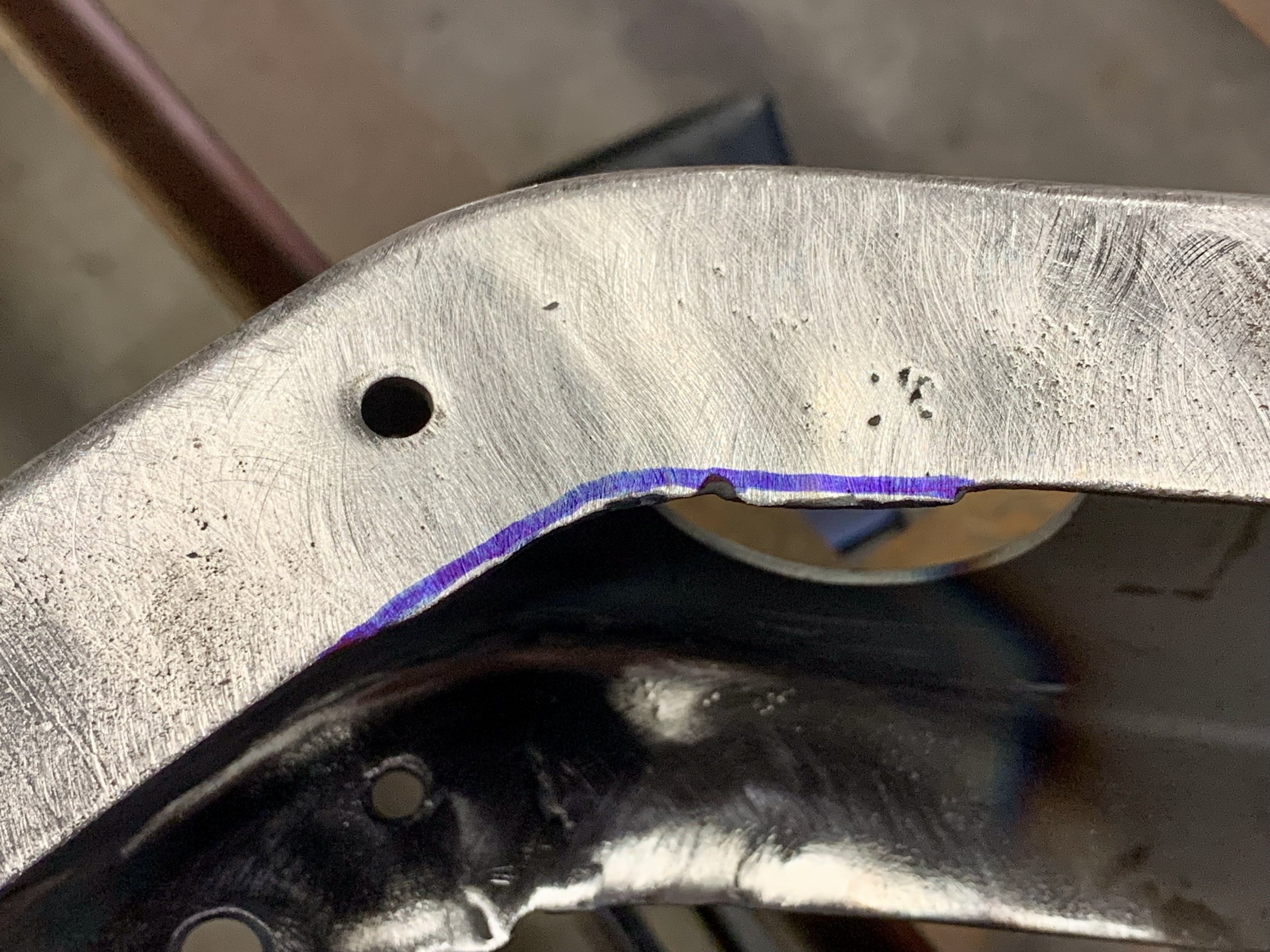

    After breaking down the mock-up it was back to working on the “X”. Where the front legs converge with the rails I needed to slice above the lower flanges and spread them down to fit the rails exactly.
    After taking a slice on both sides the flanges were spread down and clamped in place.
    I made some slivers of filler material out of some scraps of 11 gauge sheet.
    I tacked the filler pieces in place then removed the X so I could fully weld and finish the areas.
    The X was then reinstalled to check the fit.
    Finally, the front legs of the the 33/34 “X” are a factory-like fit into the 32 frame rails. :cool:

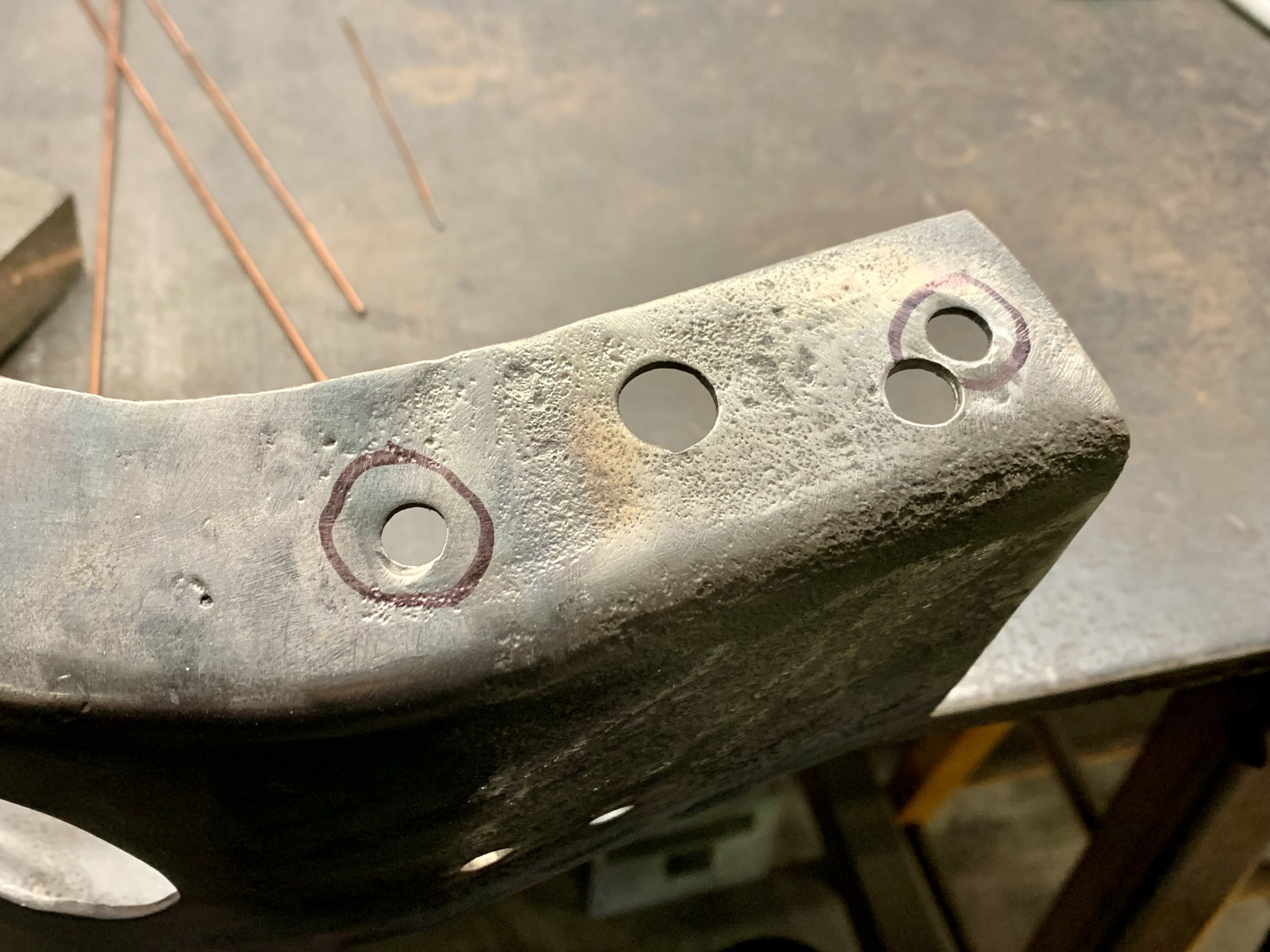

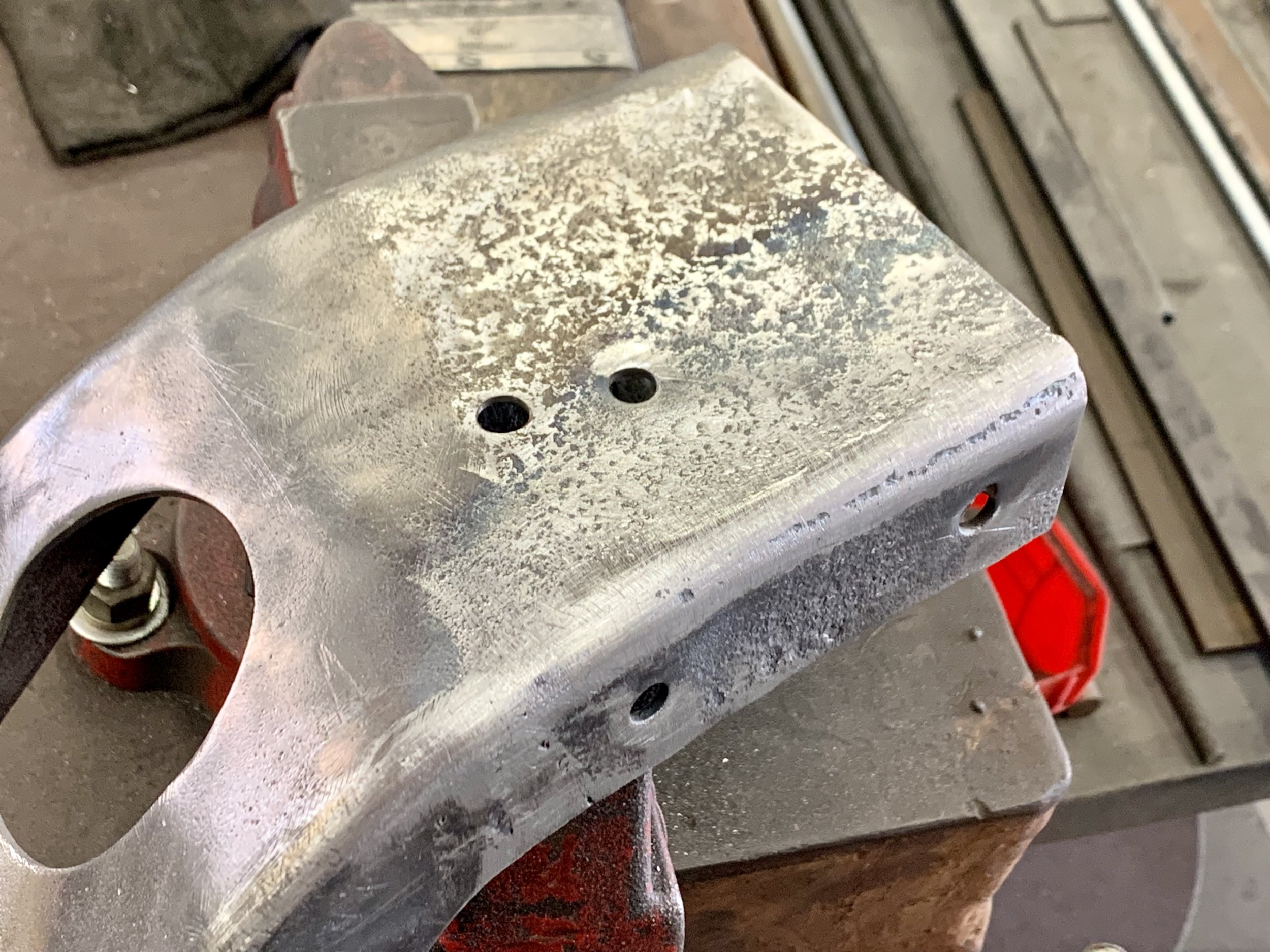

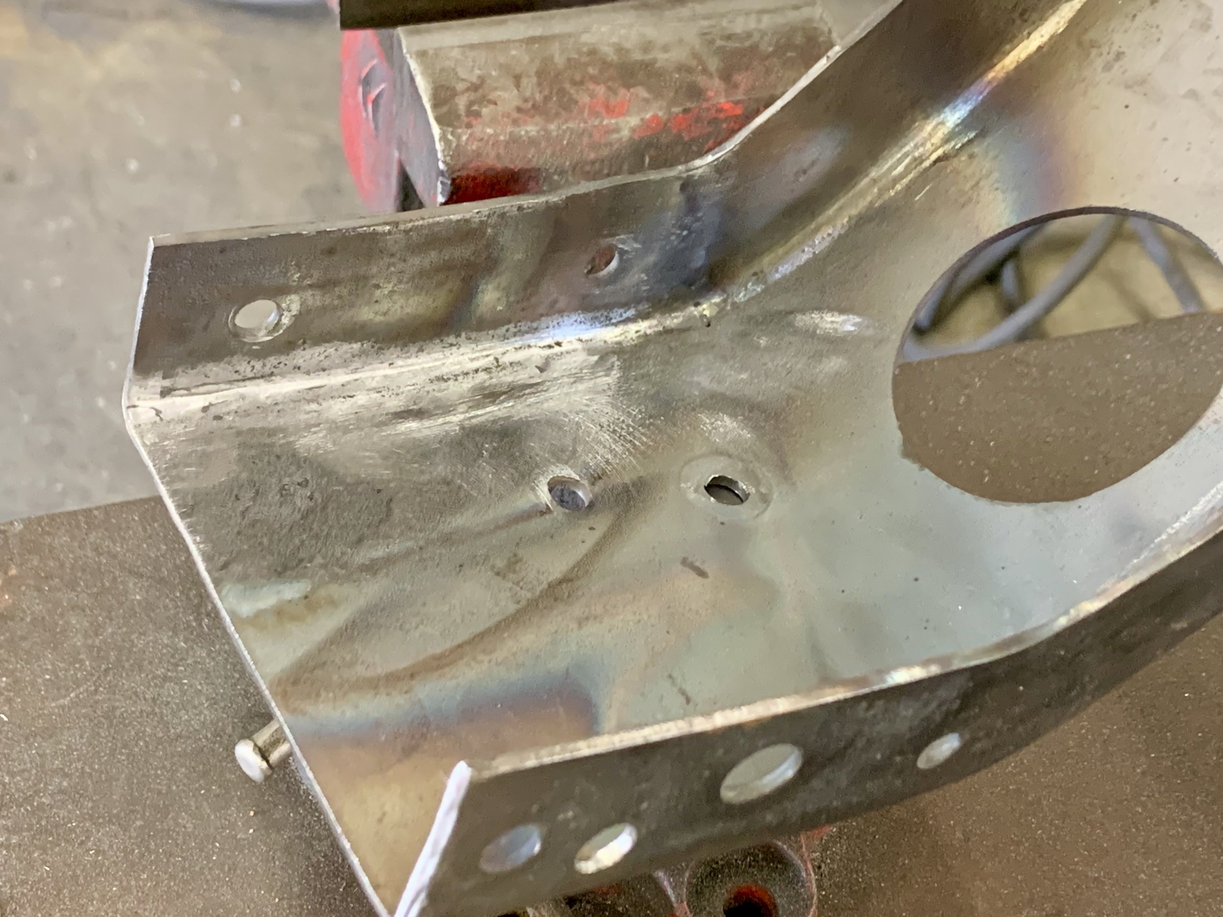

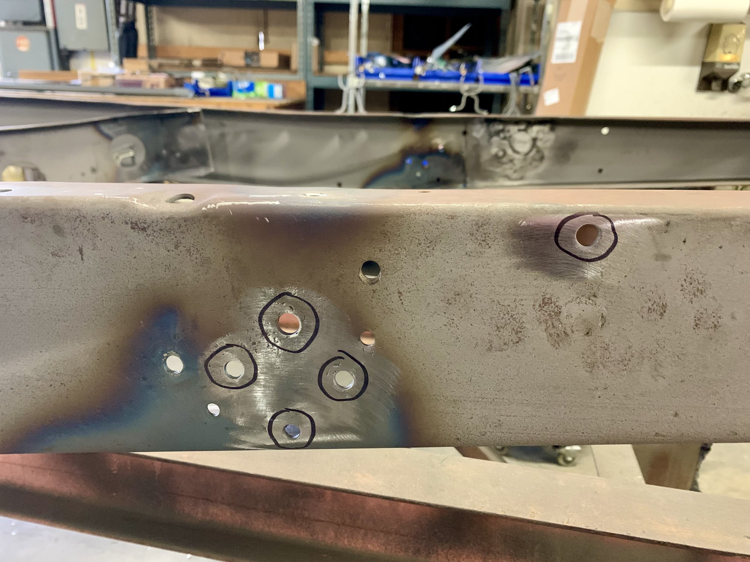

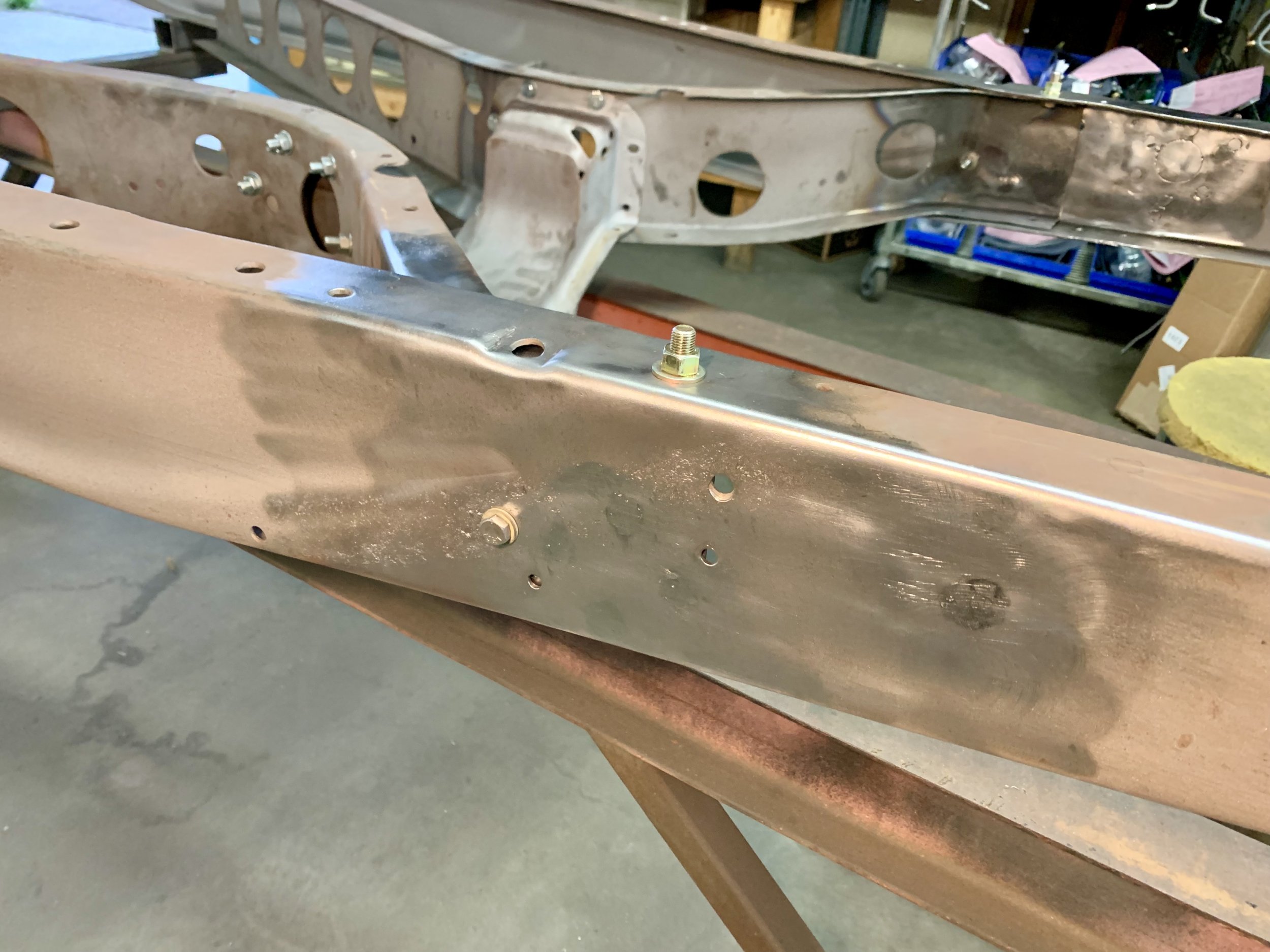

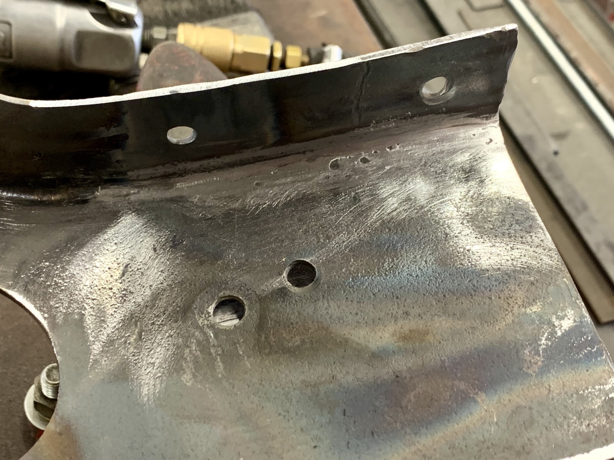

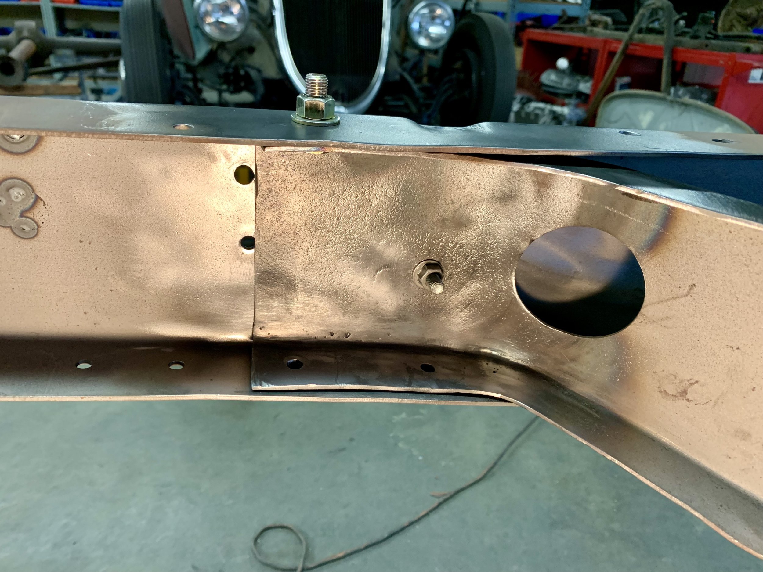

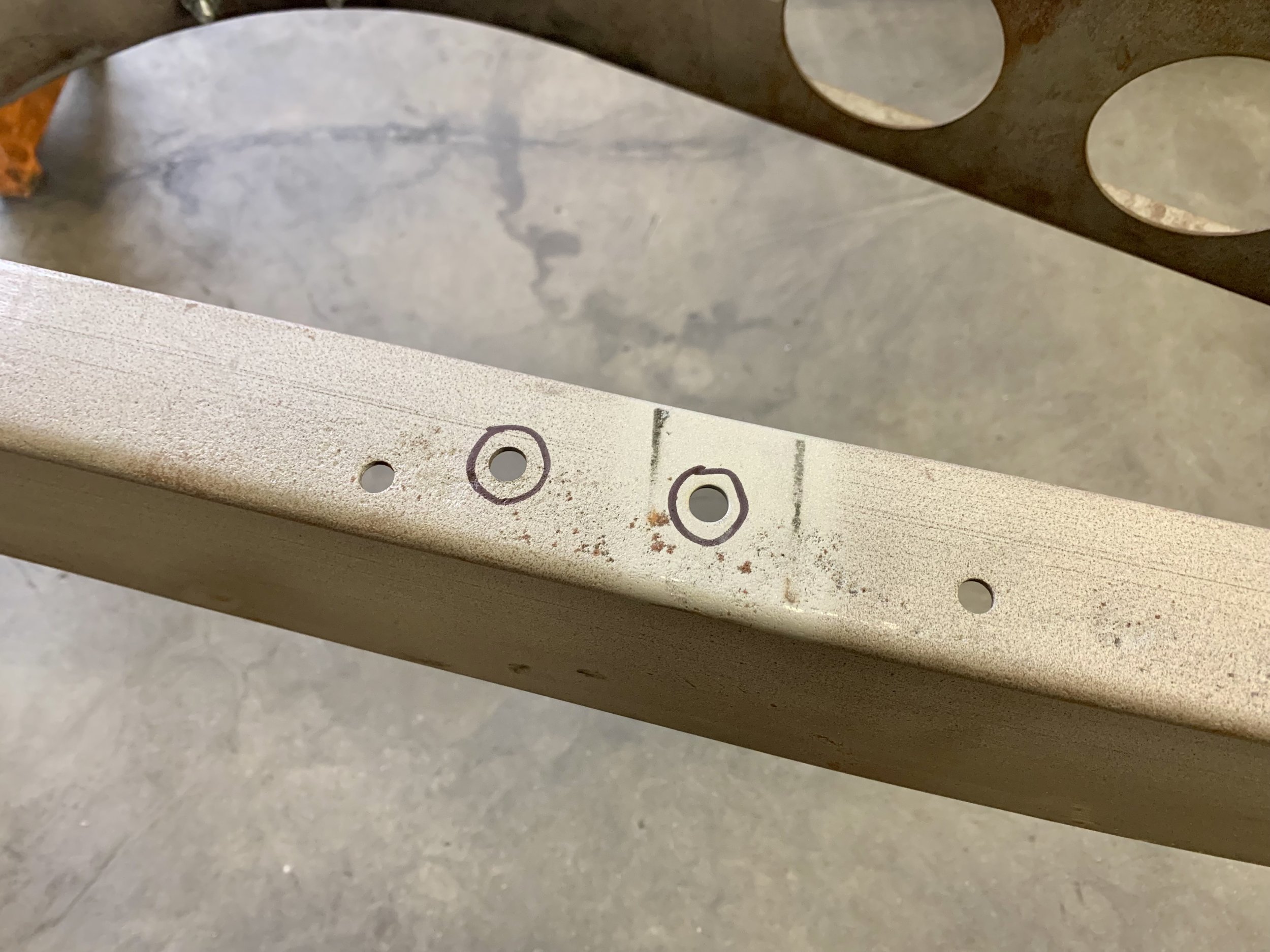

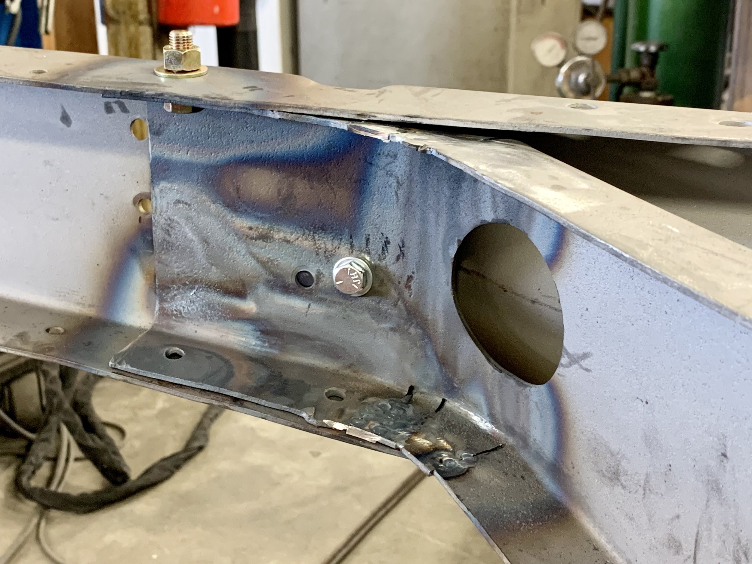

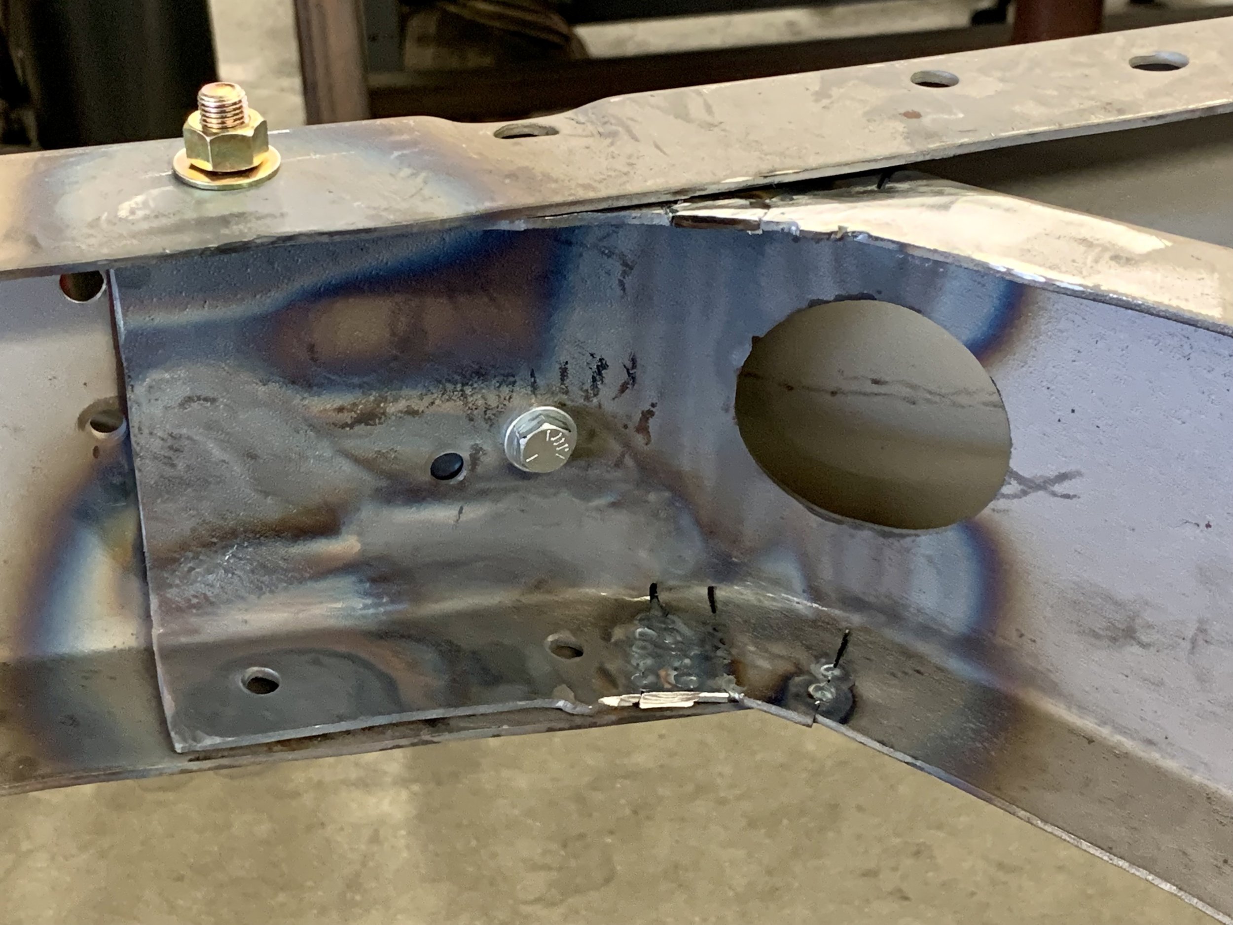

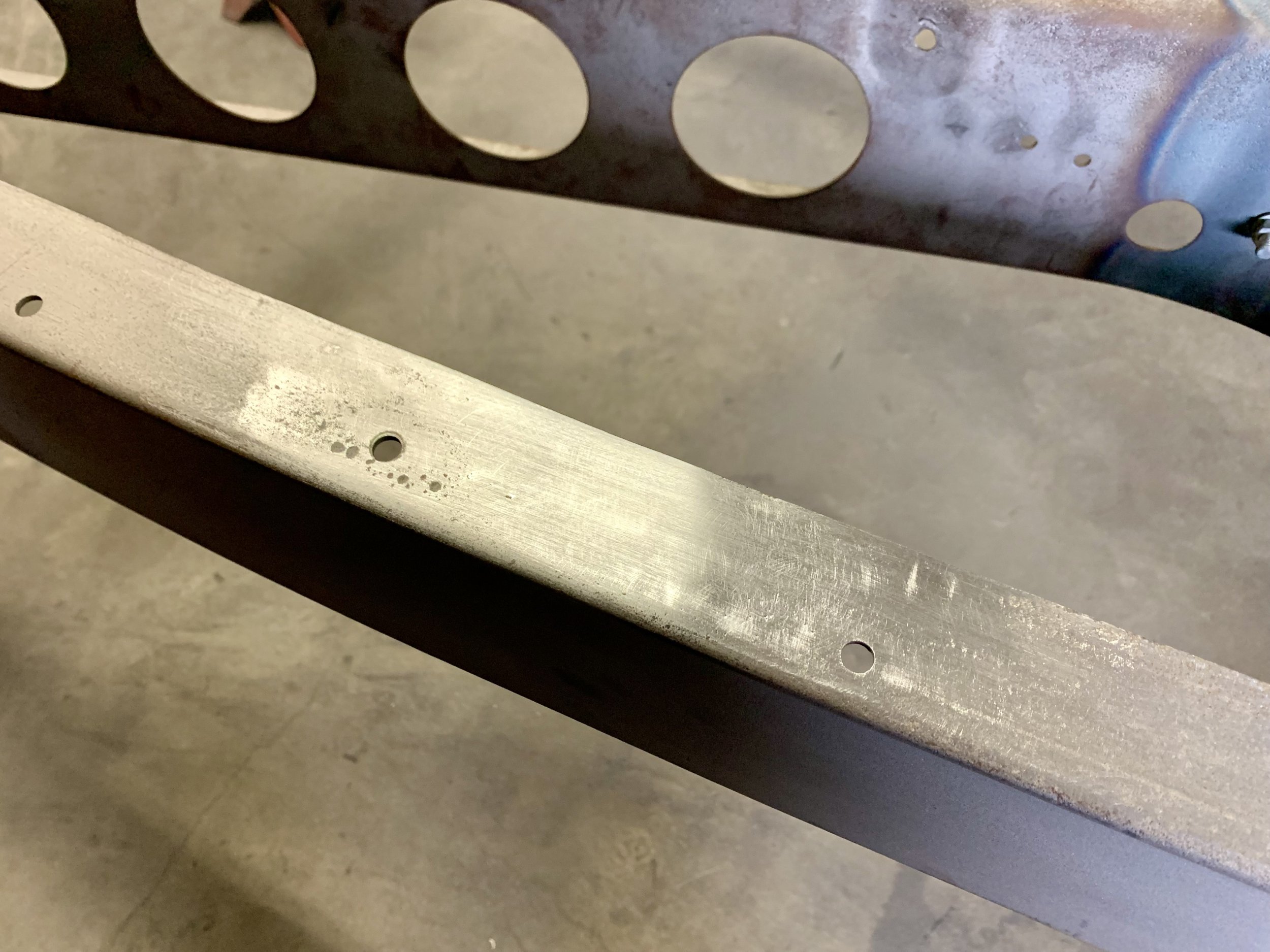

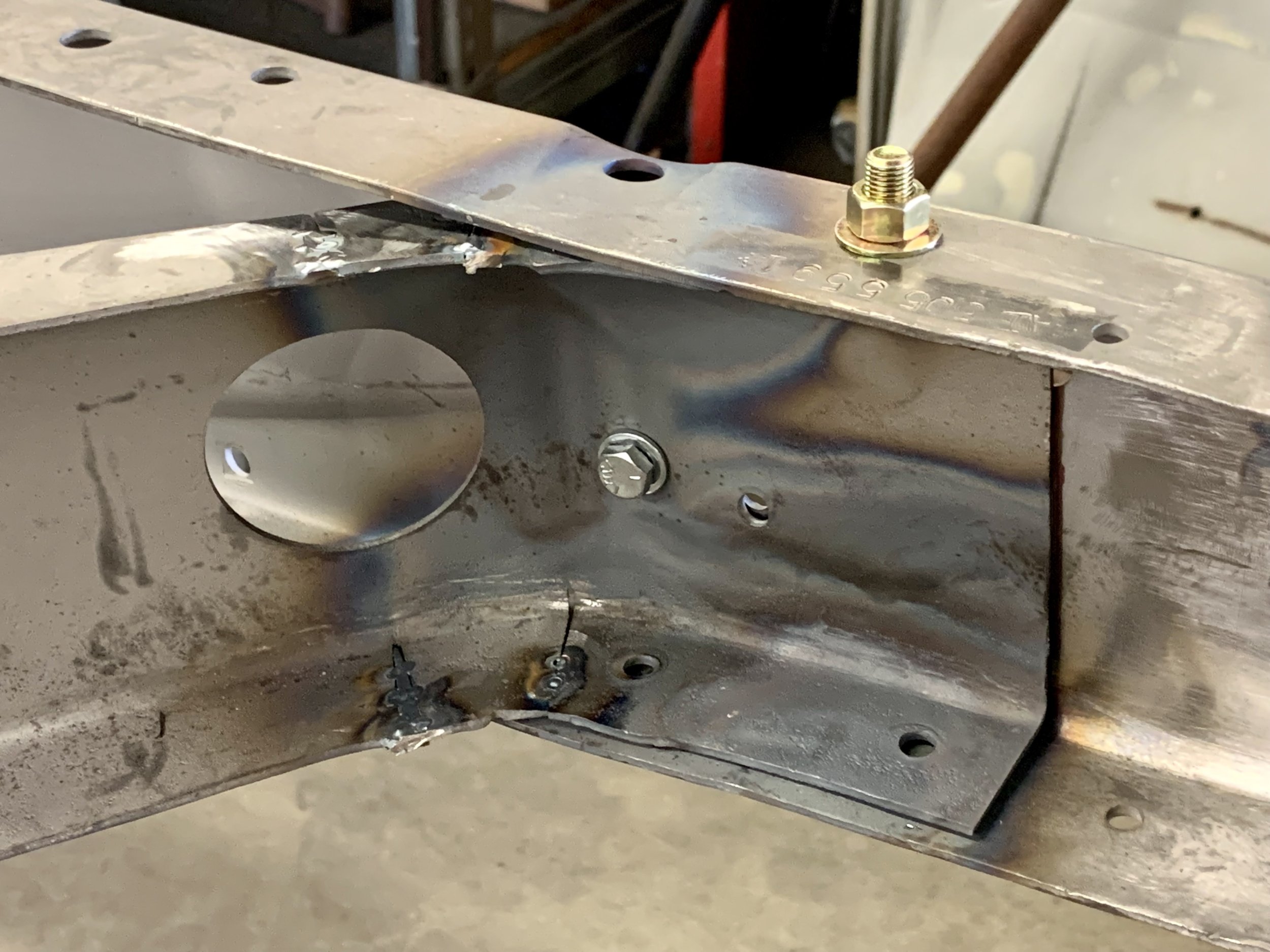

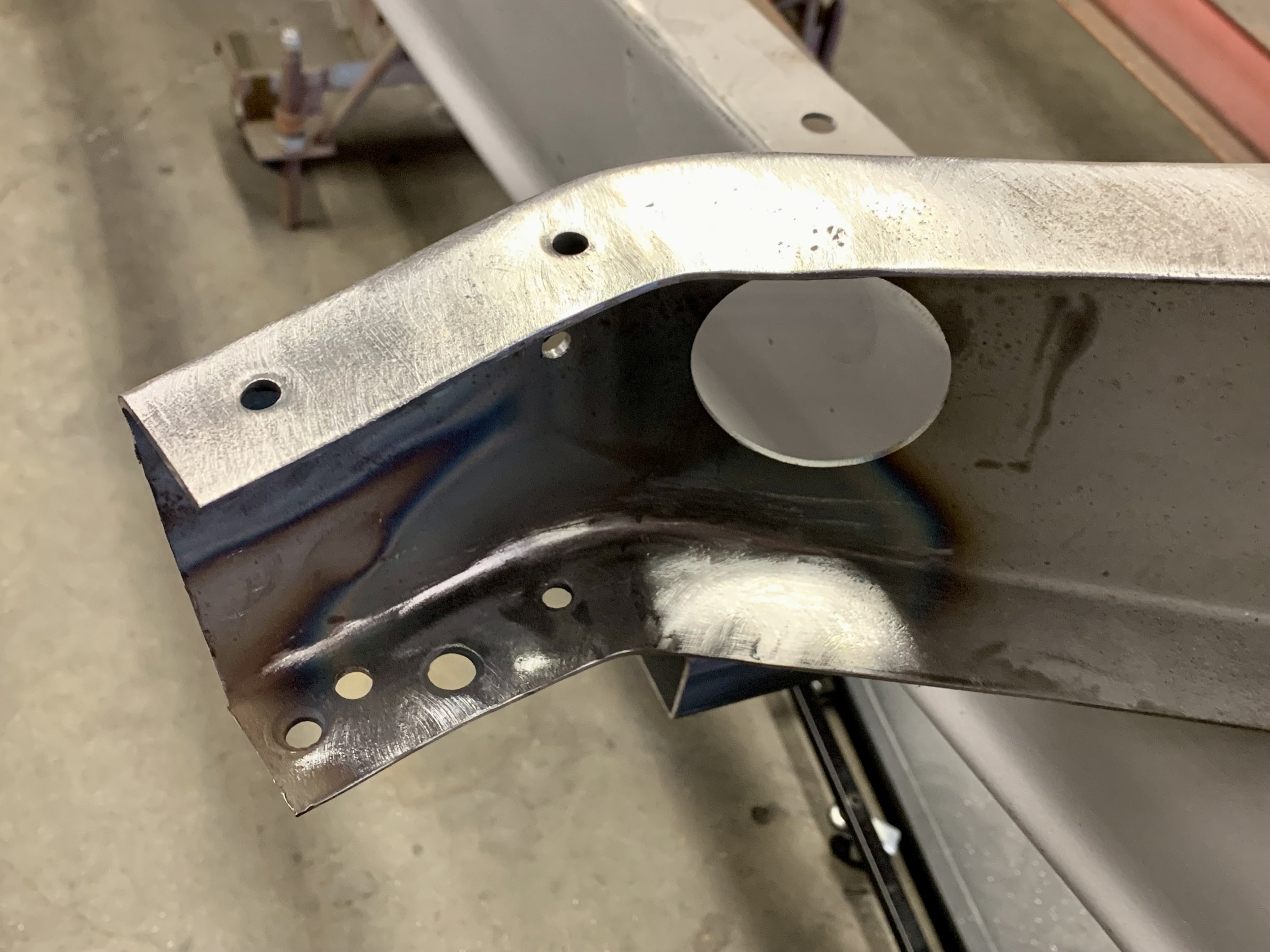

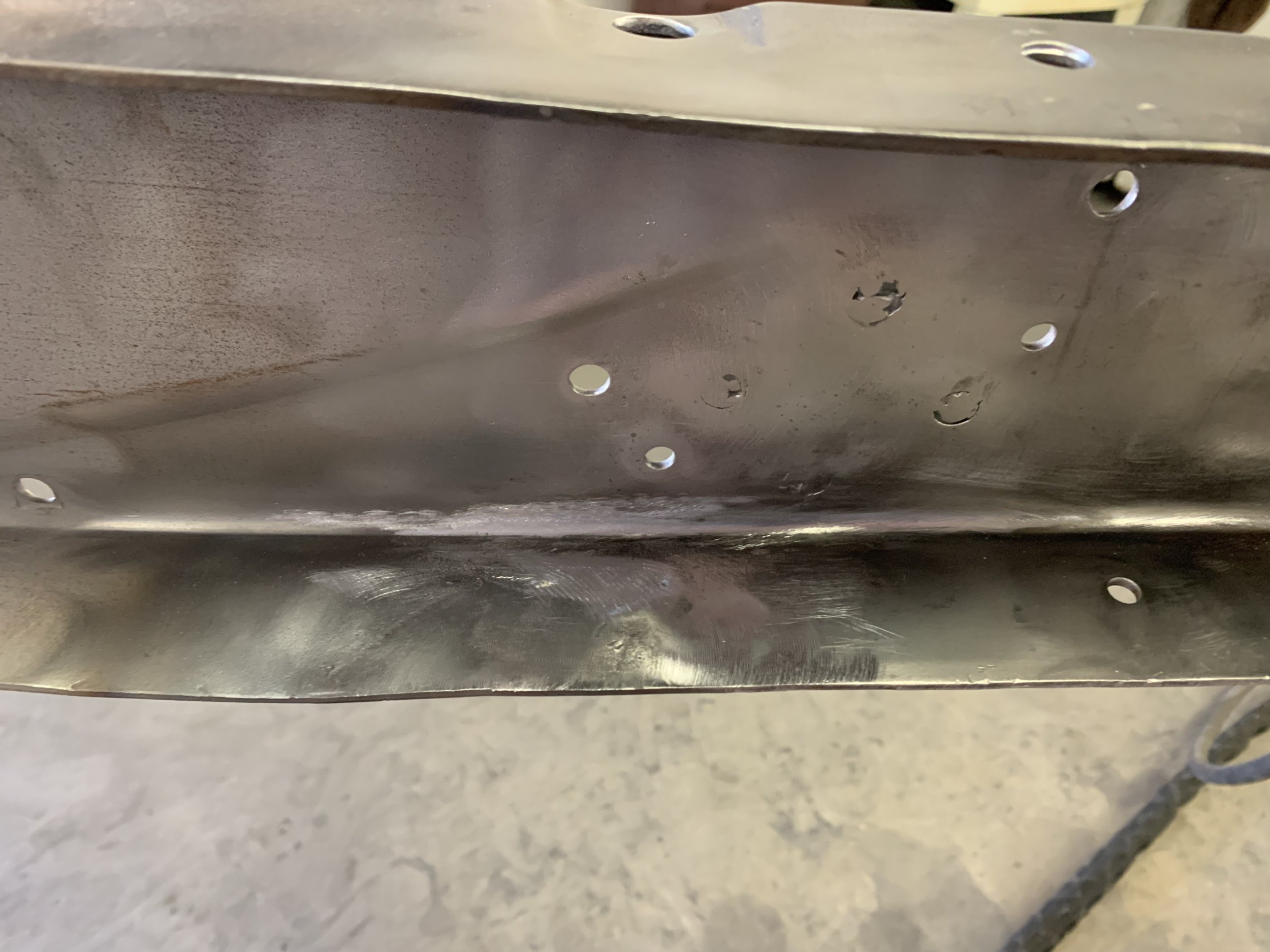

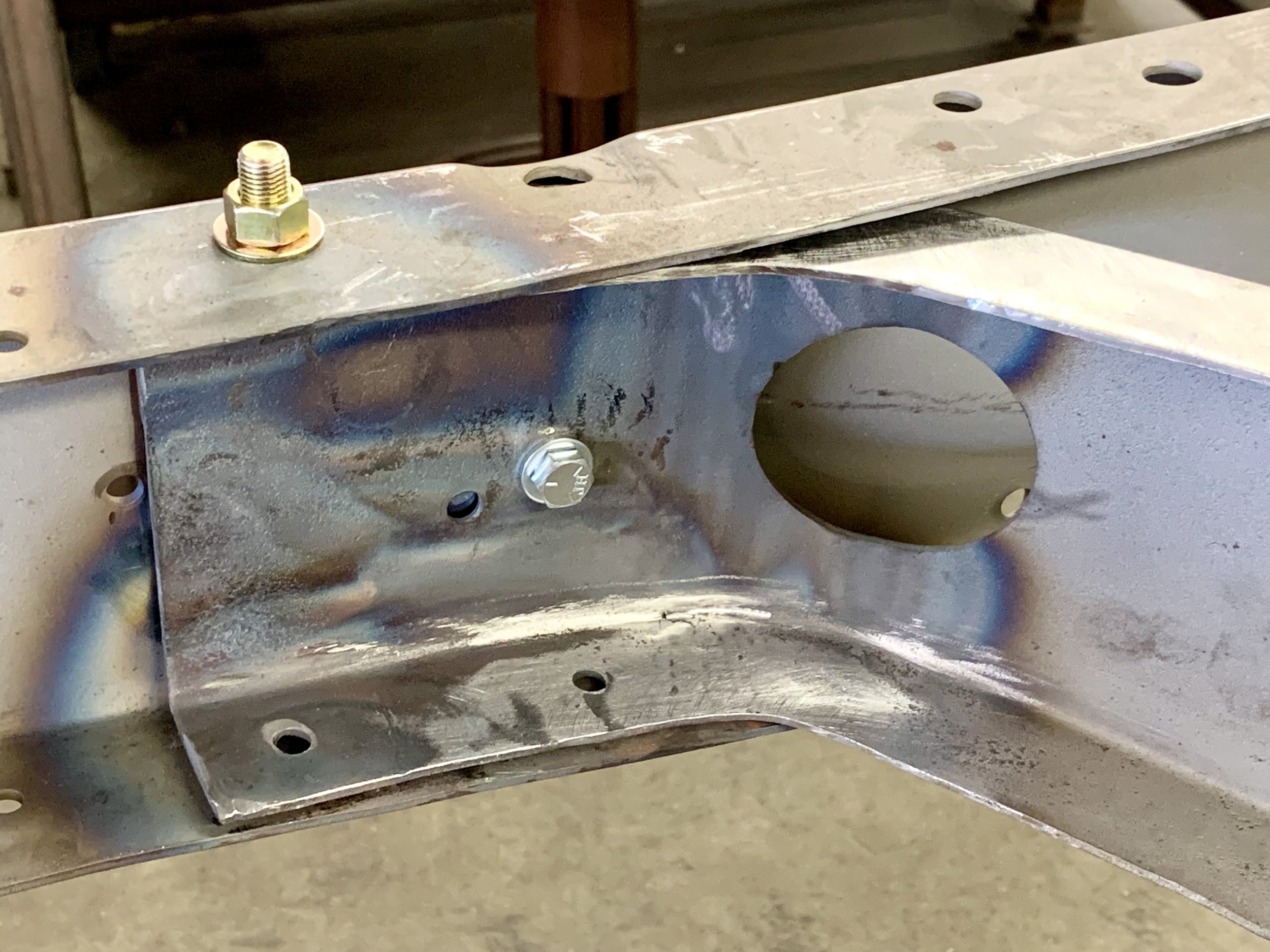

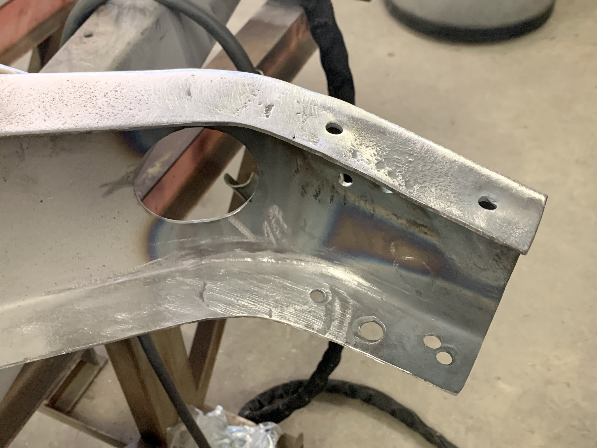

    With the front legs of the “X” fully fitted I needed to address filling some unwanted holes in the frame rails where they converge, before committing to final installation. Here are the holes circled in black. Four on each side are original (in a diamond pattern) for mounting irons for cars with fender mounted spare wheels. The other 3 holes are non factory that didn’t have to filled at this time but I figured I might as well while I was at it.
    All gone!

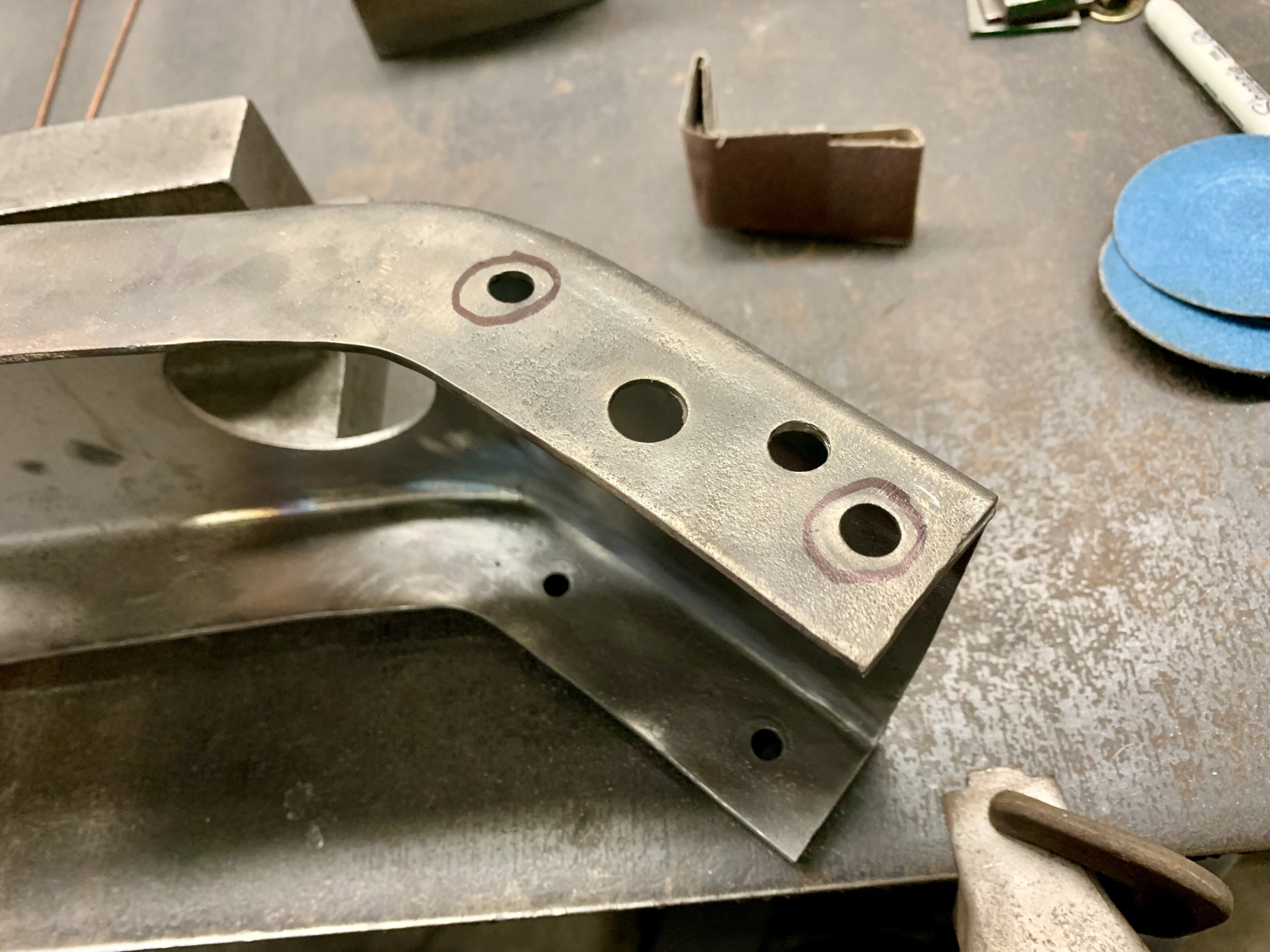

    There are also some holes that needed to go away on the top flanges of the X legs as these are right in the area where the firewall and cowl will bolt through. (I forgot to picture them but I also filled one hole on each side of the X legs, just ahead of where you see the bolts through the sides in the finished pictures later in this post.)
    All cleaned up and the X bolted back in place.

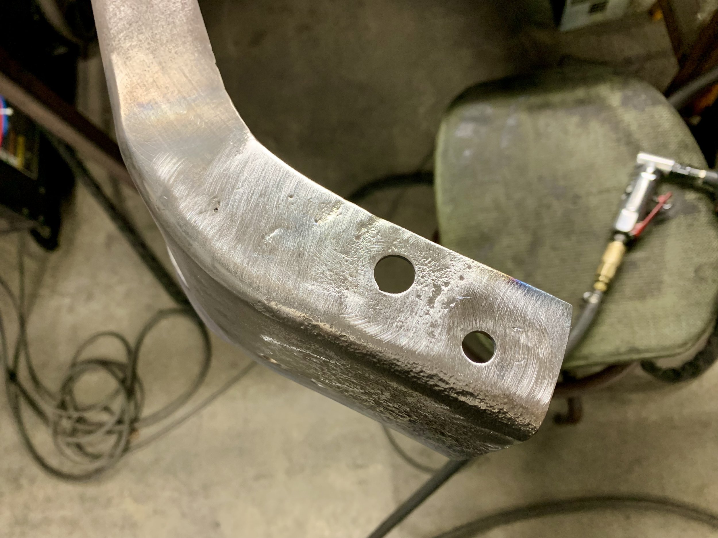

    I thought I was finally done working this area, just kidding! On the bottom flanges of the 33/34 X legs there are two original rivet holes which will ultimately be riveted again. You can see by the drawn on arrow that at the rear rivet holes there are holes in the 32 rails underneath that partly overlap. They will need to be filled so matched holes can be drilled later.
    Almost there! :cool:

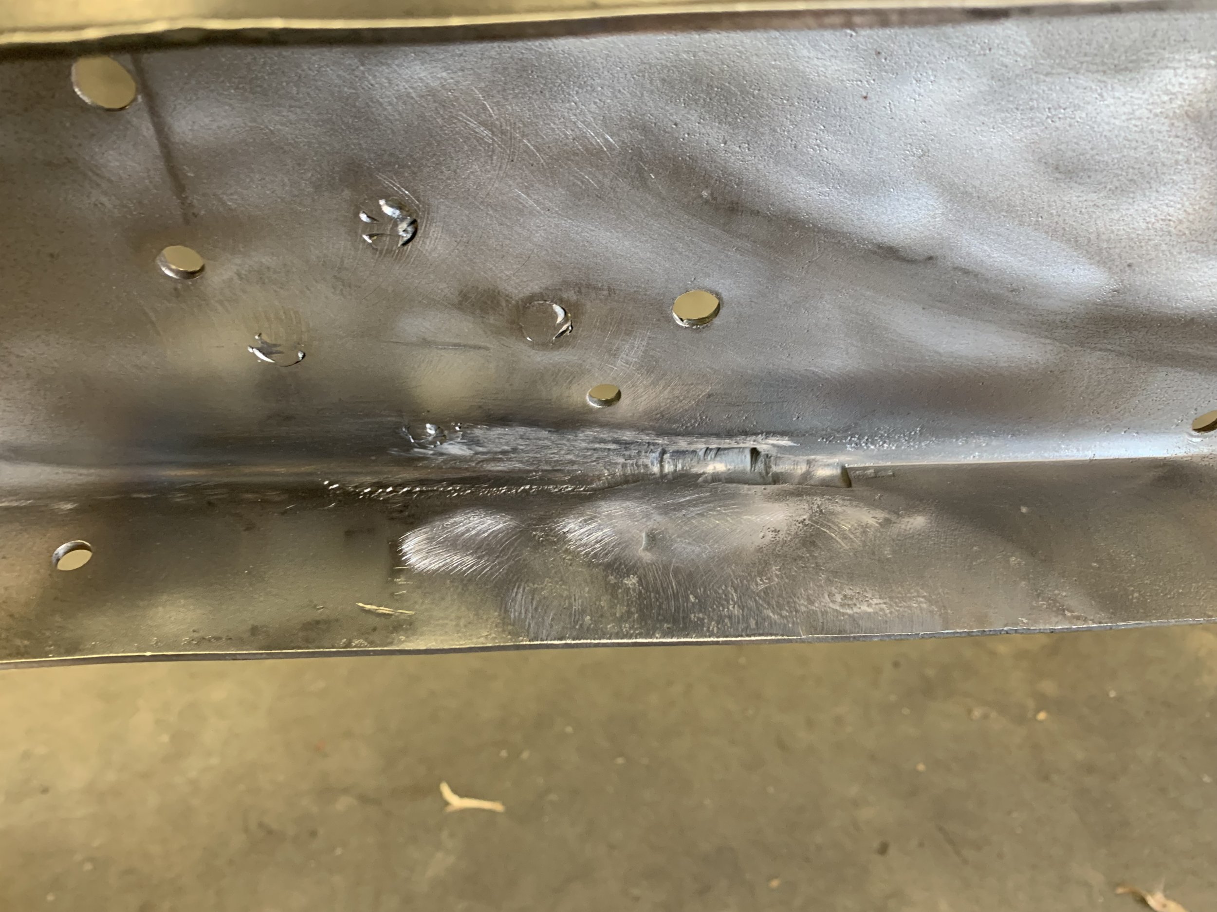

    PART 14

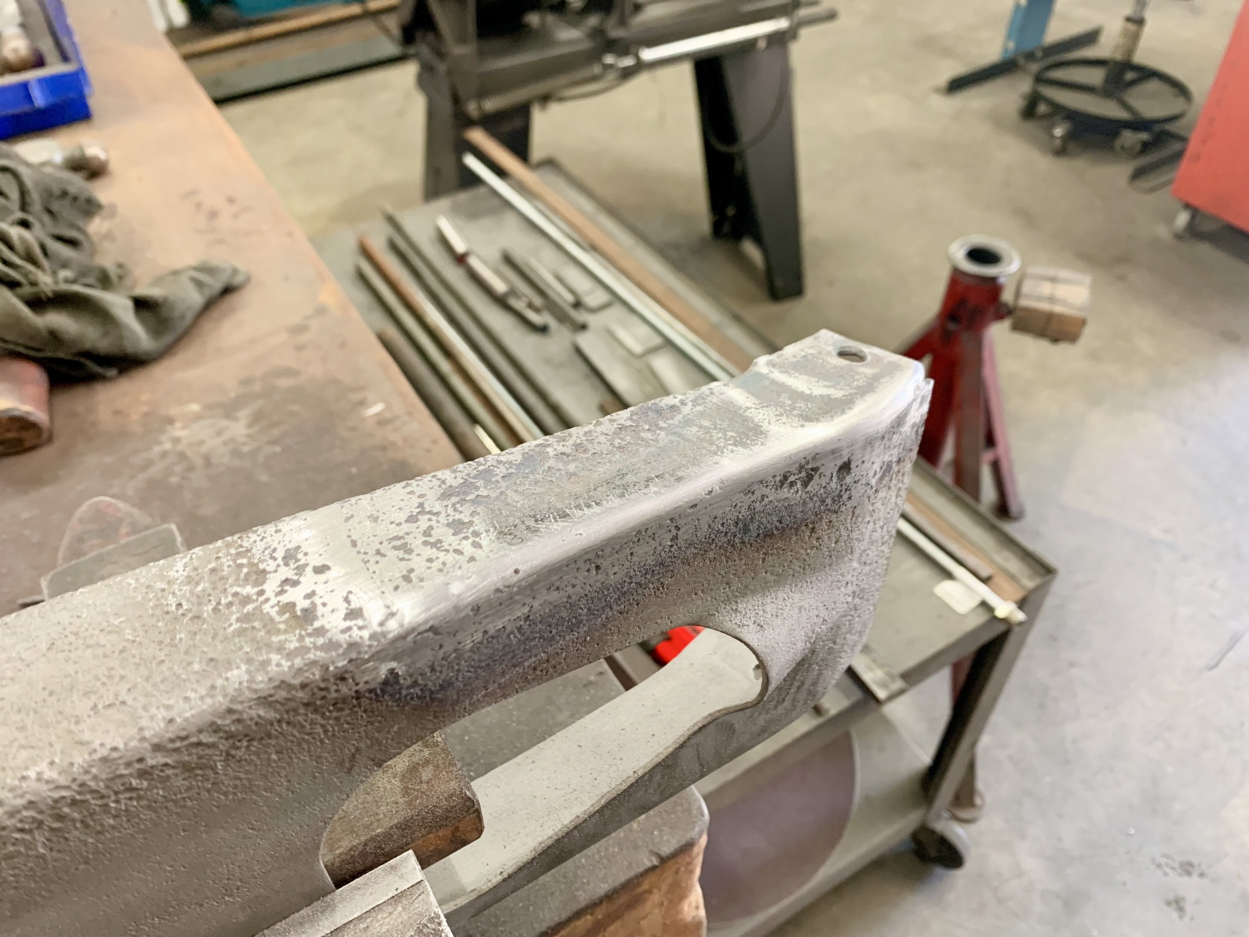

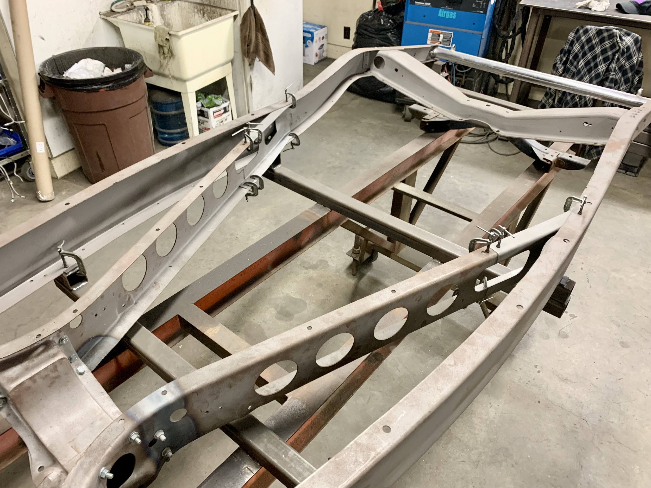

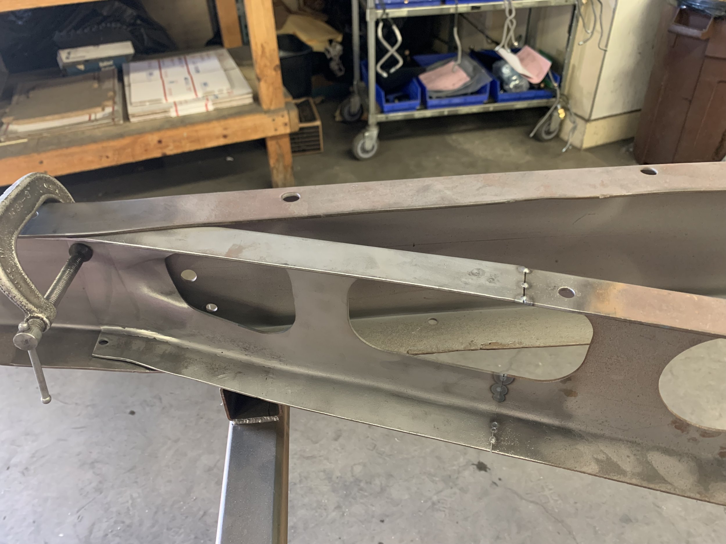

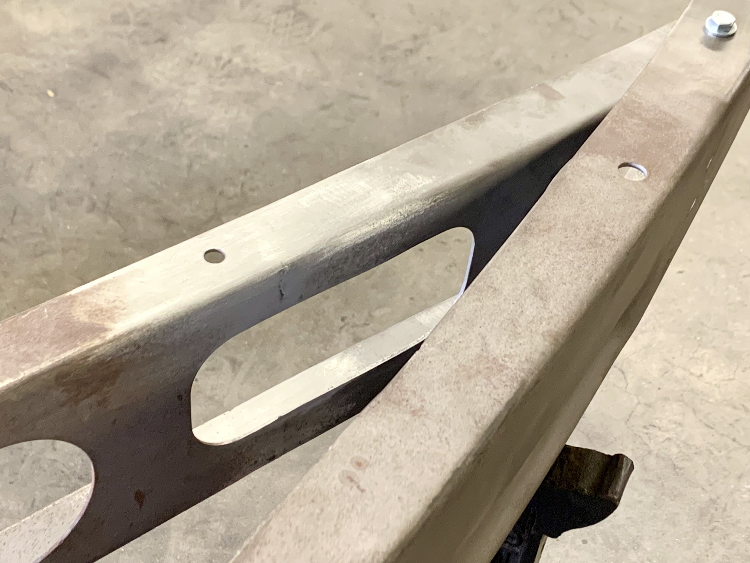

    I still need to fill those last couple of holes but I needed to switch gears mentally to something else for a minute so I decided to finally start addressing fitting the rear “X” legs. Initially, I was thinking I would make the whole section fit into frame rails and that would require tons of pie cuts, filling those large, round holes and general manipulation. Then, I realized I was making it way more difficult than it needed to be trying to fit the whole thing. I’ll be making inner continuation channels anyways so why not just cut most of the leg ends off? They were marked and cut off accordingly (left of pic below.) I also marked and trimmed the front ends roughly an inch where they will reattach to the rest of the X (right of pic below.)

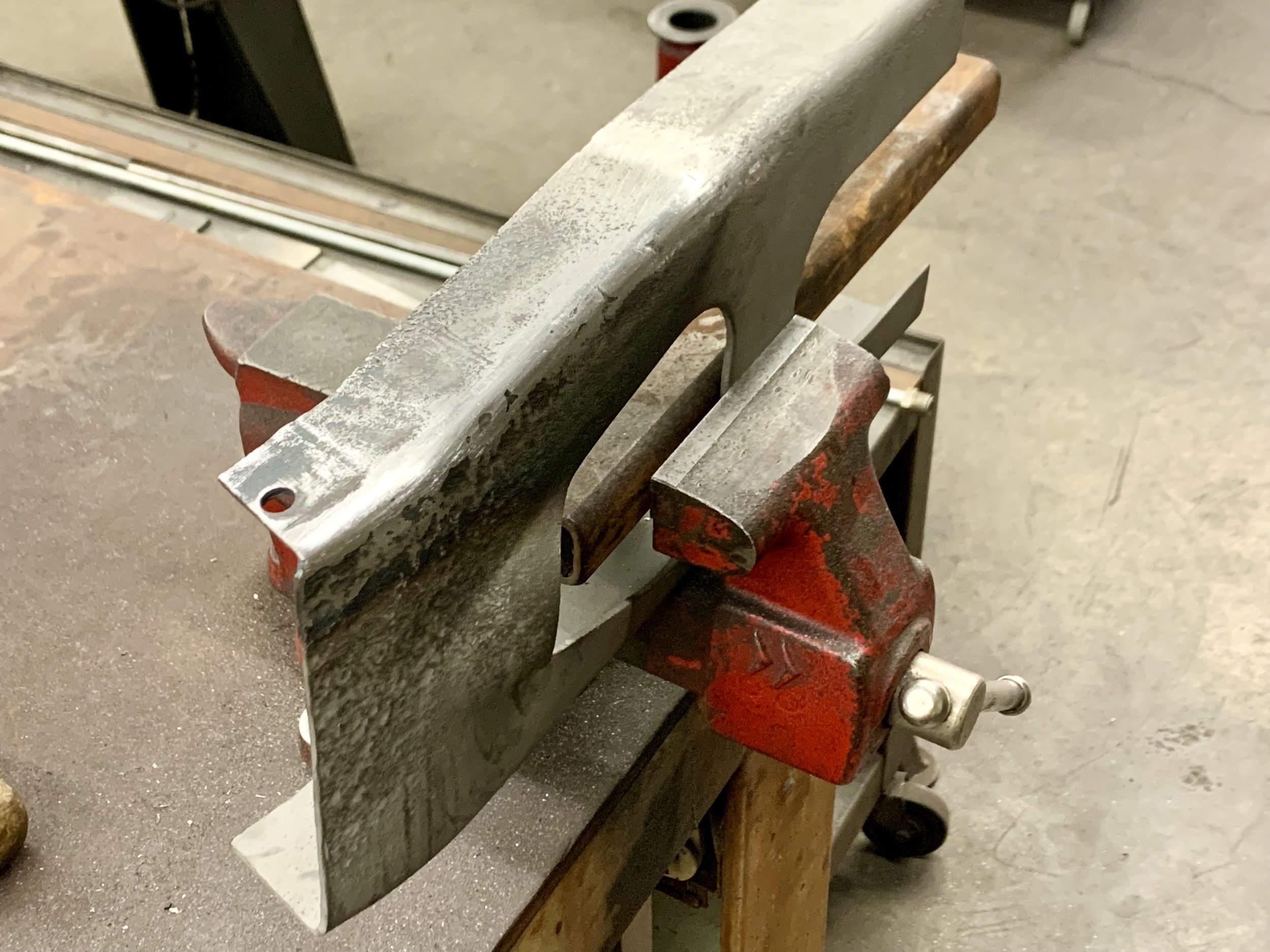

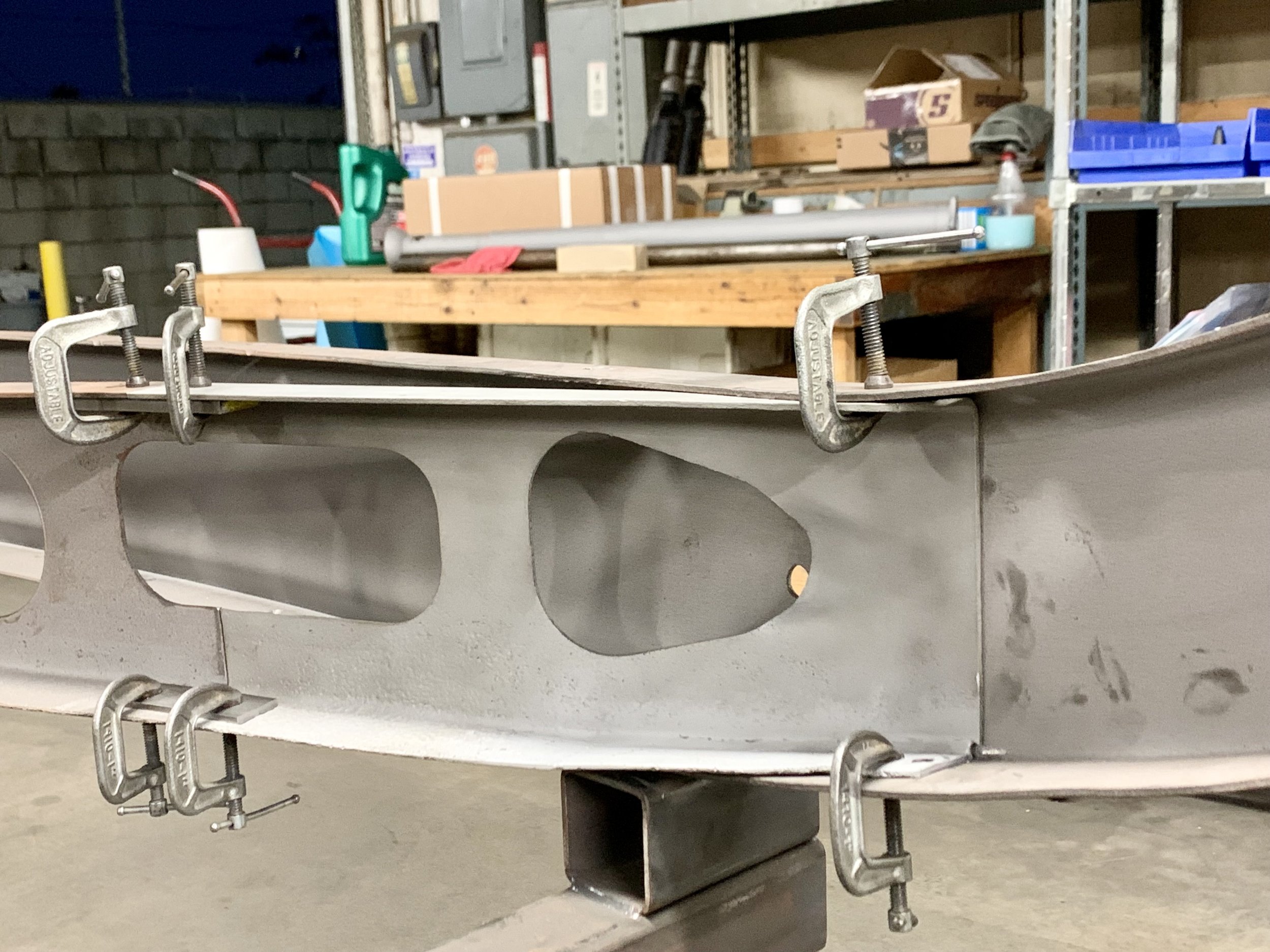

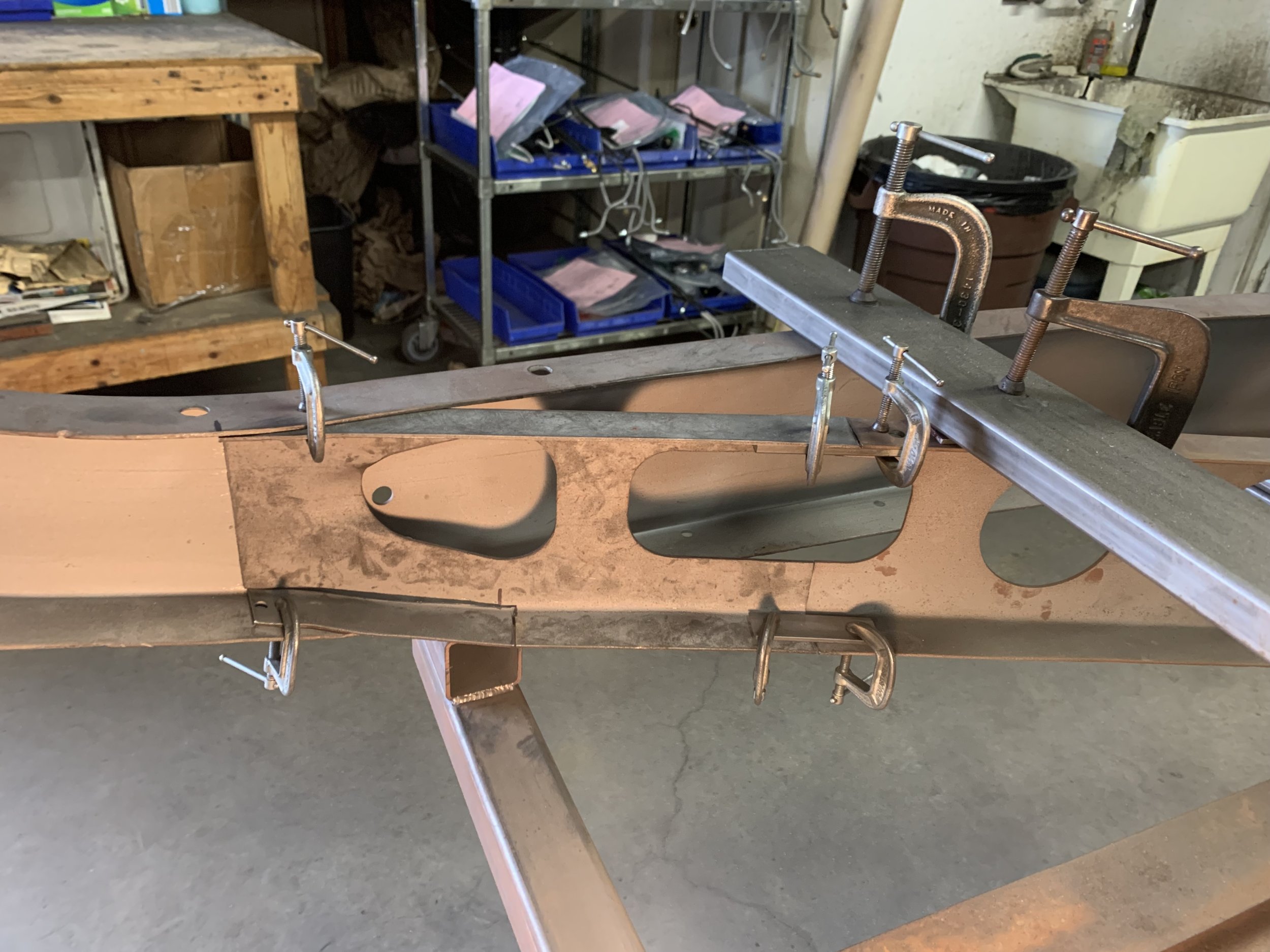

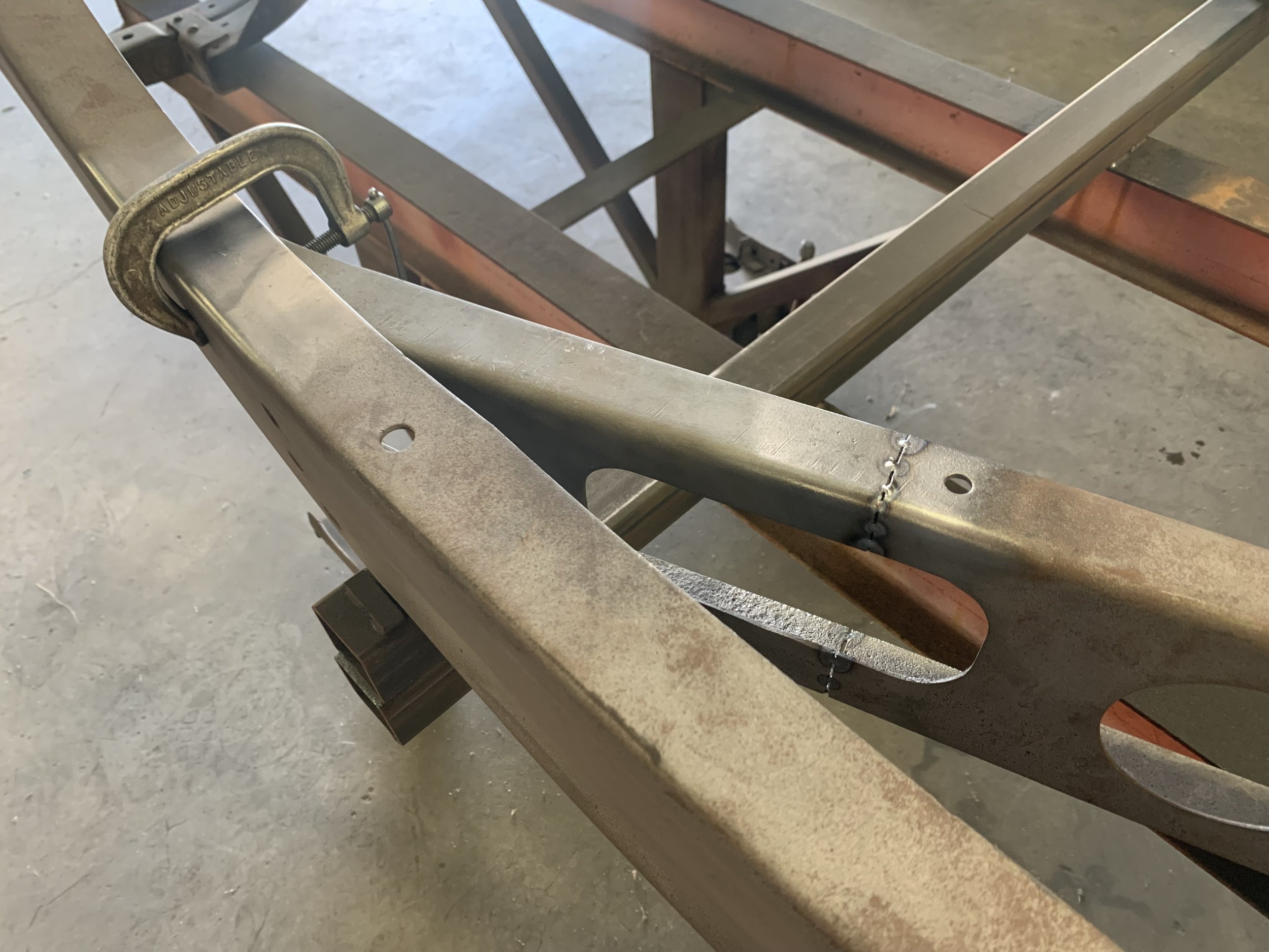

    I braced the loose rear legs of the X with a piece of 1x3” tubing and put some 1/8” spacers between it and the X legs to simulate the thickness of the top flange of the frame rails.
    I then went through the process of pie cutting the loose rear pieces just above the lower flanges. I snuck up on this a little at a time until the fit into the frame rails was just right. I got a little over enthusiastic cutting on the left side but that’s what the TIG machine is for.
    I made a few tacks on each side then removed the pieces, fully welded and finished them inside and out.
    Then finished pieces were ran through the sand blaster then fully clamped into place. I’m quite pleased with the results!
    At this point I think all that’s left to address are those couple of holes up front mentioned at the end of the previous post and I can commit to welding the rear leg pieces to the rest of the X. I need to make darn sure I’ve addressed everything because once those rear pieces are welded the X is captured permanently. :cool:

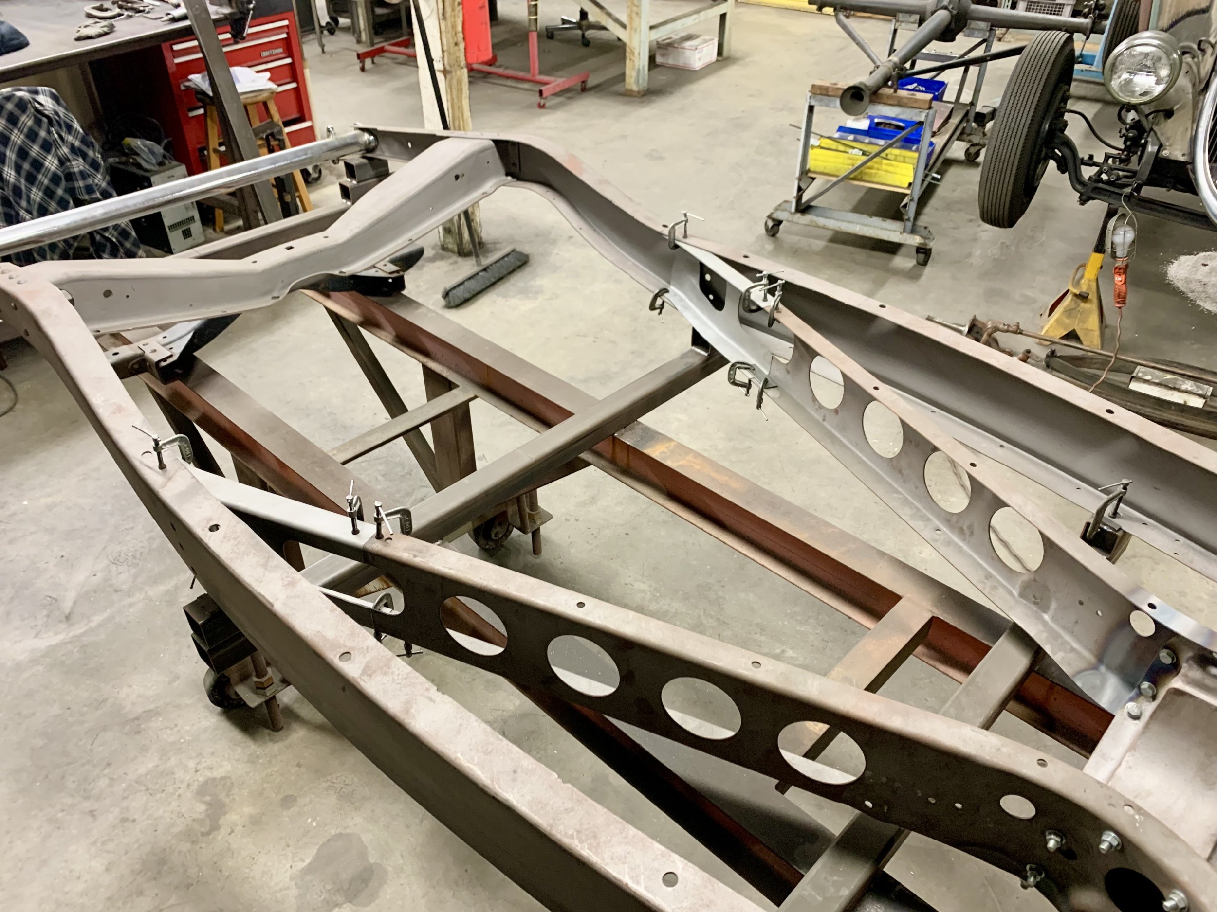

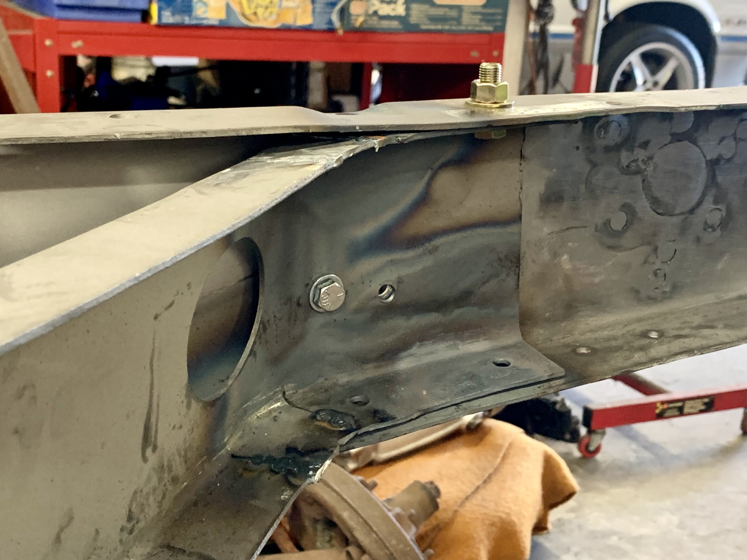

    PART 15

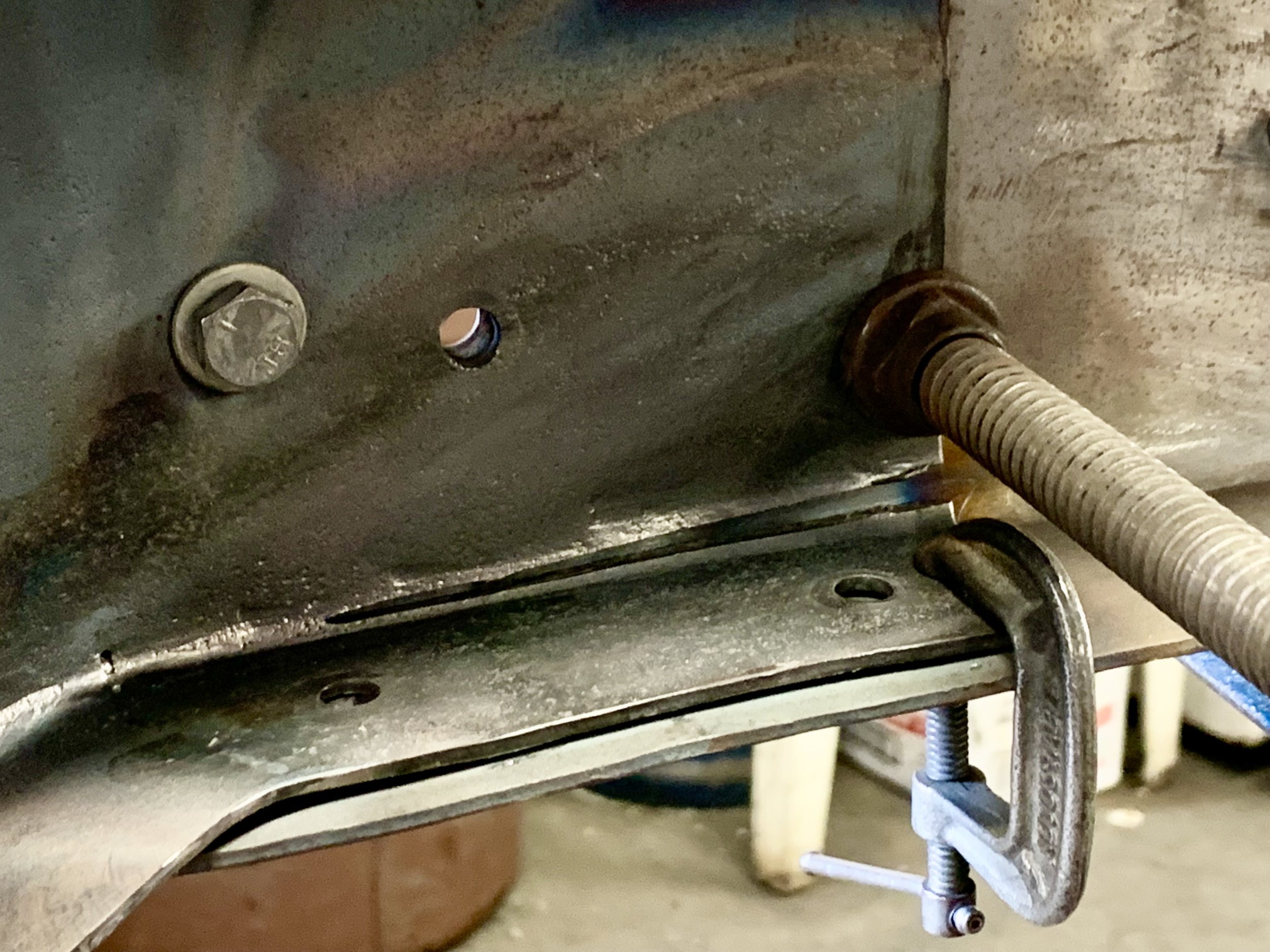

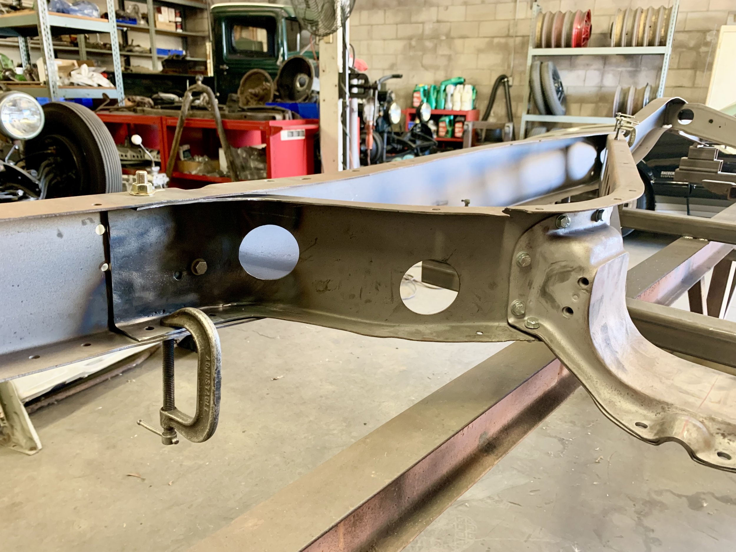

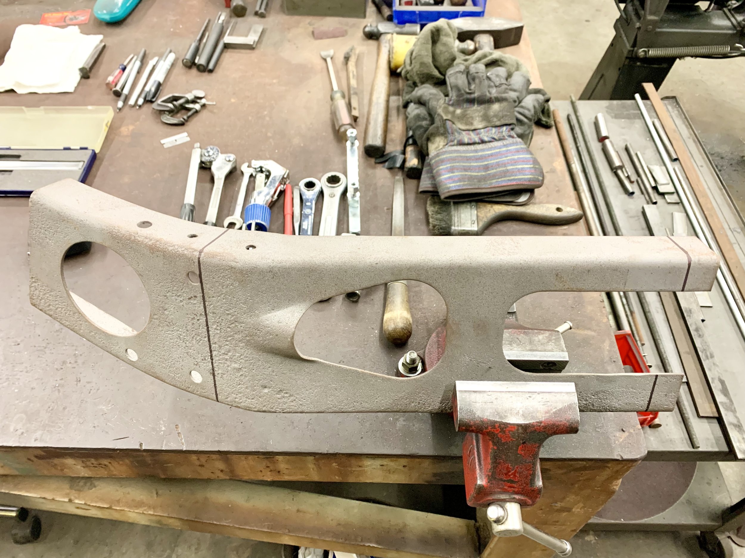

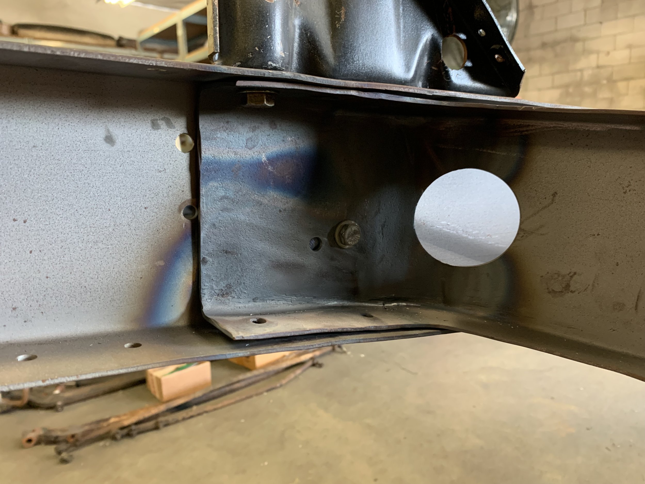

    Pulled the X out one more time so I could address filling those last 2 holes on the lower flanges of the frame rails.
    With that done I cleaned the areas to bright, shiny metal where the front X legs fit into the frame rails and put the X back in.
    Before installing the rear X sections for good I cleaned up the inside radii like I did at the front by removing the excess material that results from the stamping process. This makes for a smooth radius and keeps the width of the flanges consistent.
    At this point I wire brushed the ends of the main X and ends of the rear pieces where they will weld together, as well as chamfered the ends of the filler pieces, clamped everything tightly in place and tacked all 3 sides. This was a Friday afternoon so I decided to leave it tacked for the weekend in case I thought of a reason the X might have to come off.
    Although it’s not finish welded and smoothed yet this is a major milestone for this frame project, finally seeing my vision come to fruition. :cool:

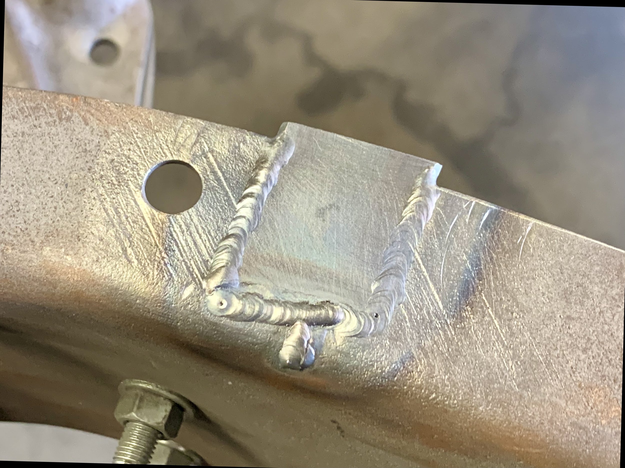

    PART 16

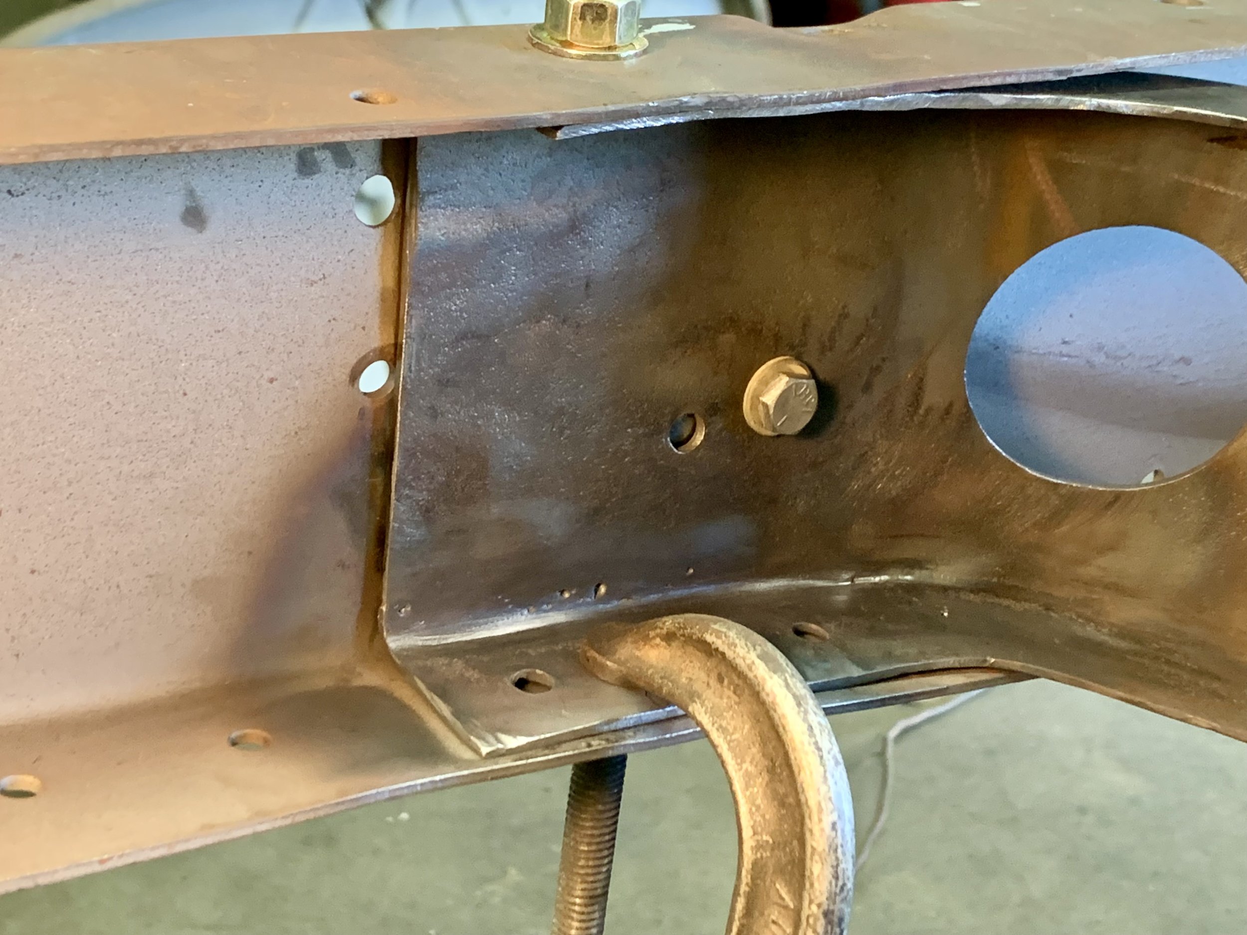

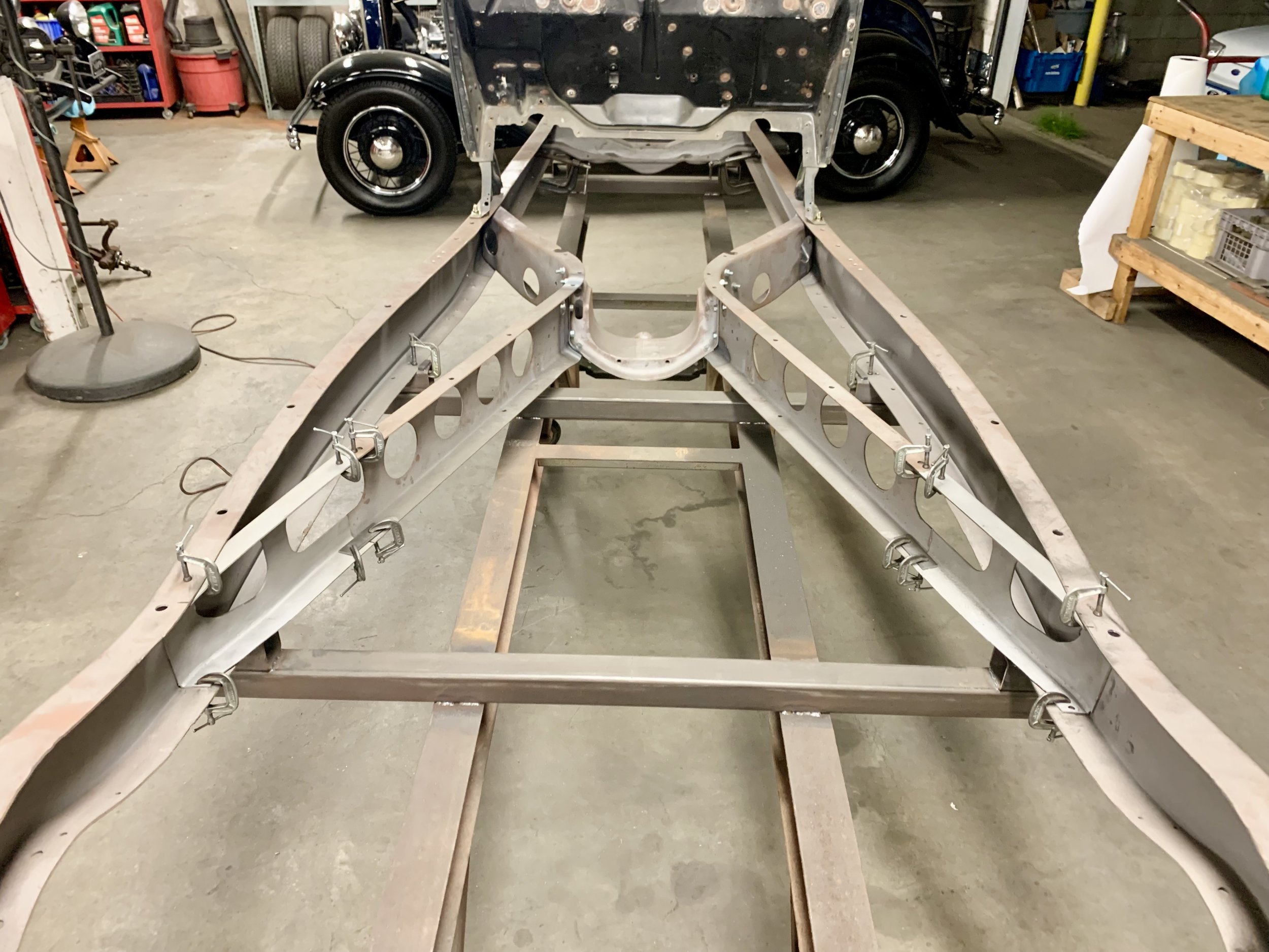

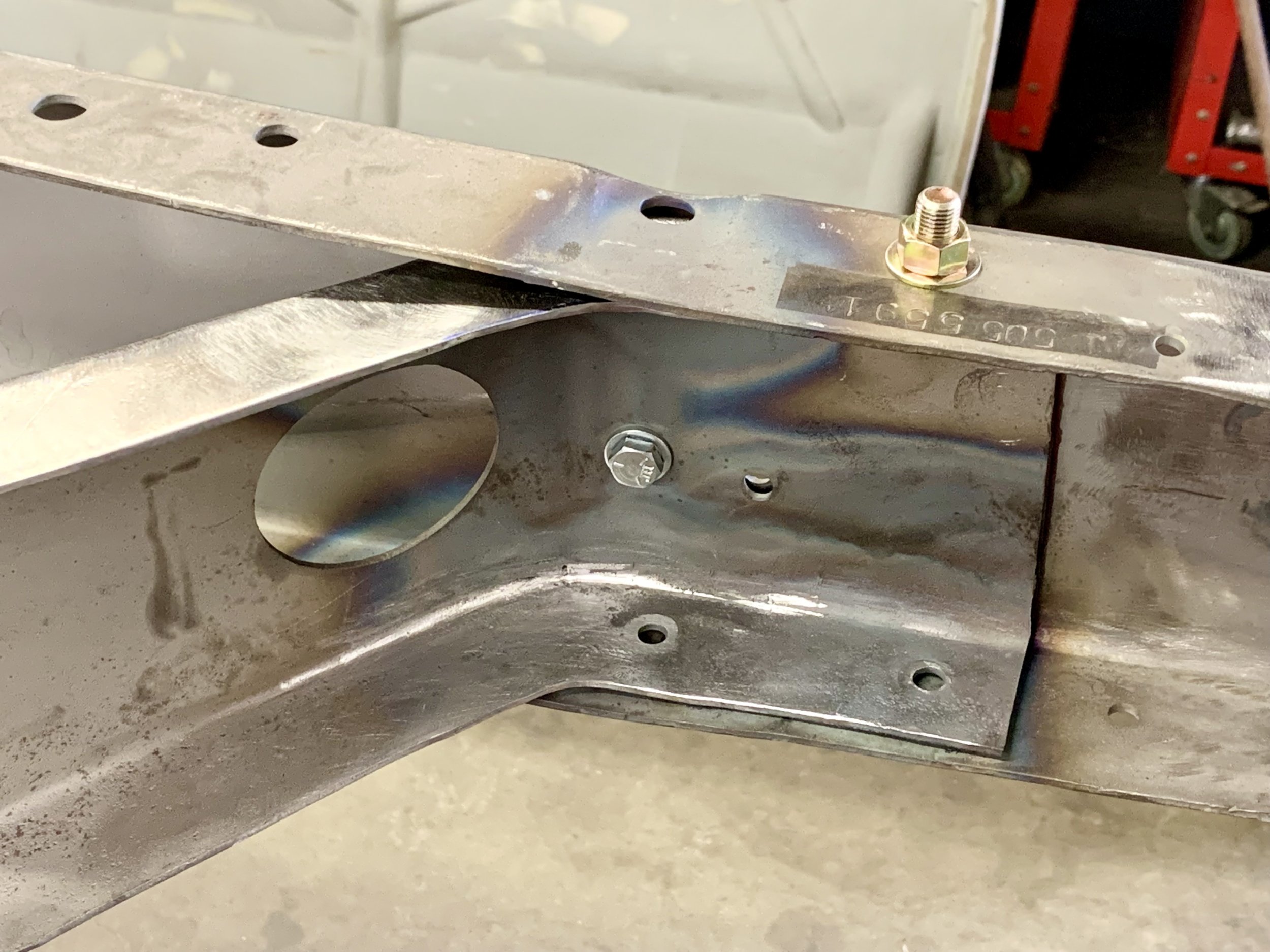

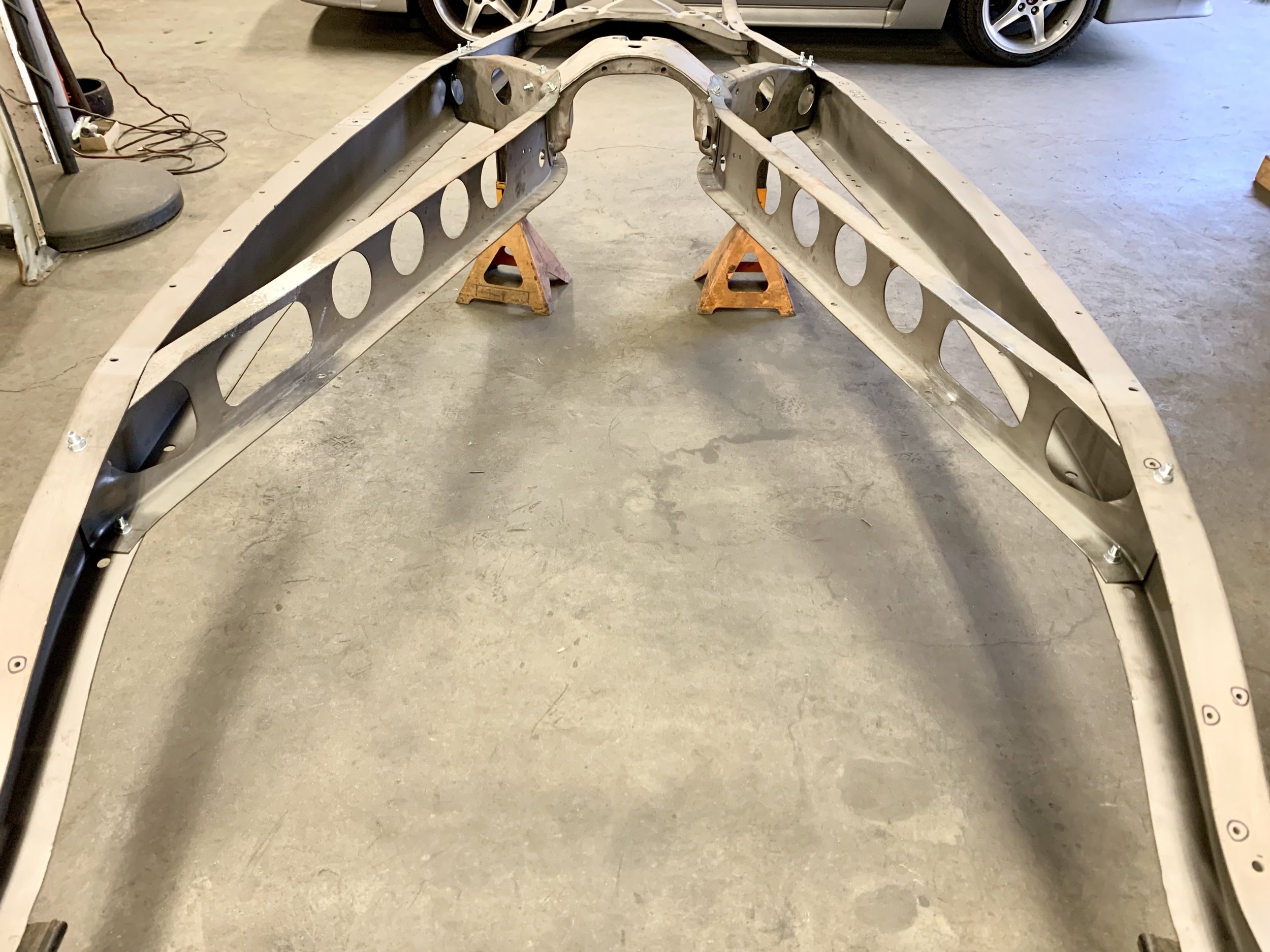

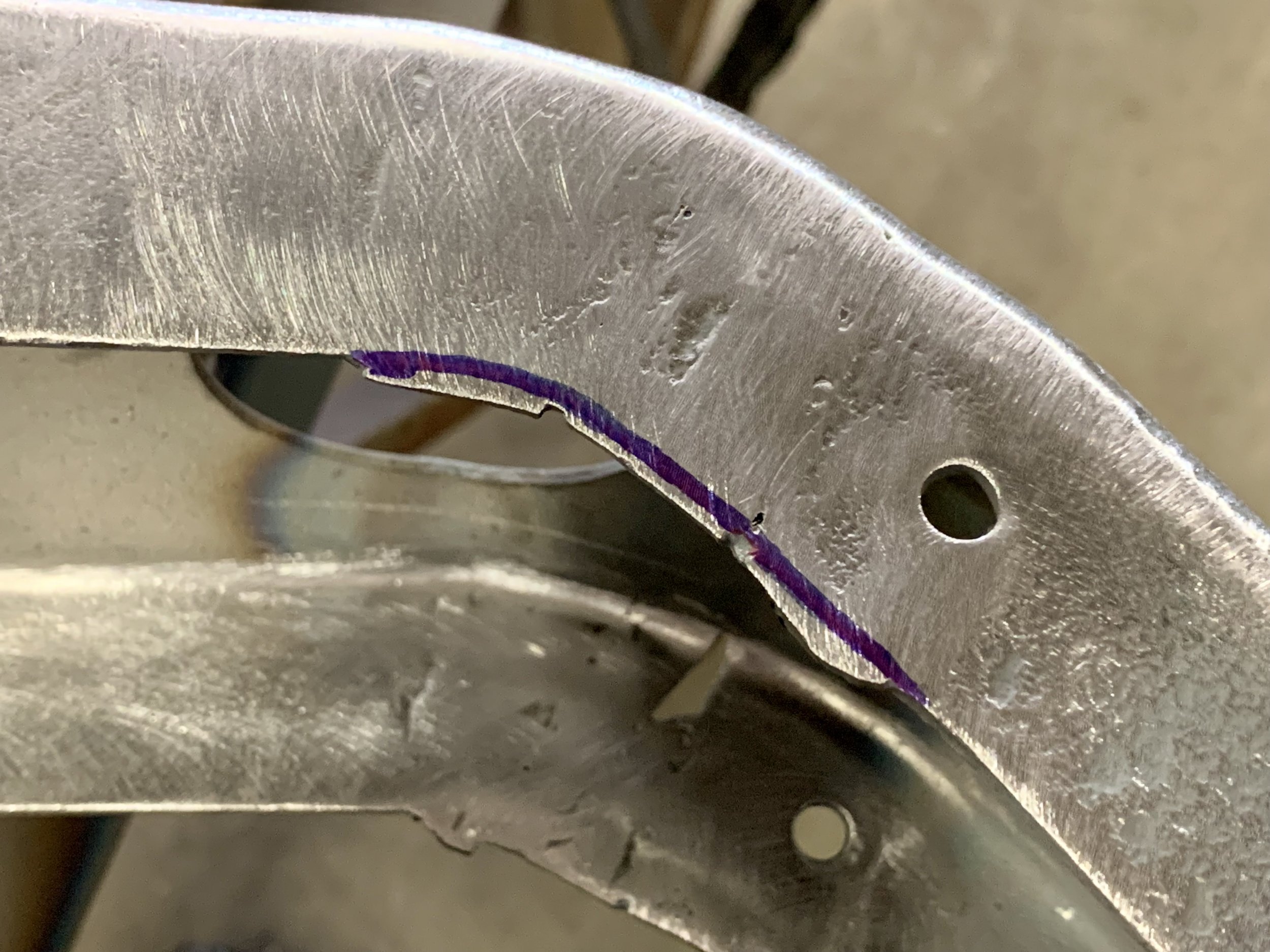

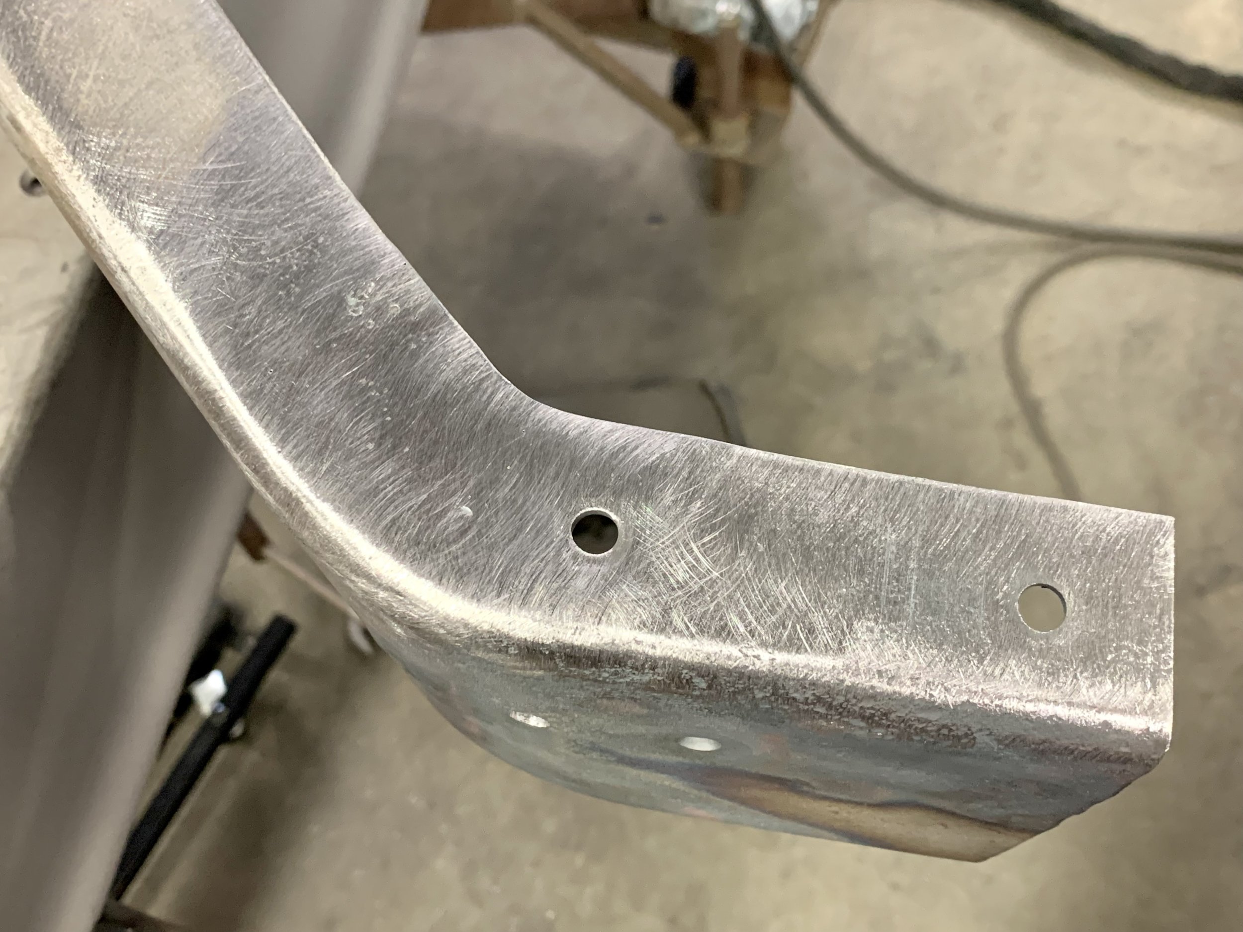

    With the rear leg pieces tacked in place I match drilled the frame rails to the original rivet holes in the 33/34 X. Since a drill won’t fit into the channels to simply used the existing holes as a guide I had to carefully lay out, center punch and drill through the frame rails and (hopefully) land inside the holes in the X. I took my time and thankfully got them all right-on. For now bolts were installed but ultimately these will be replaced with actual rivets.
    At this point I was ready to final weld the rear X legs but wanted to address one more thing since the frame will be coming out of the fixture to be able to flip over or stand on its side as needed to get at the bottom and inside surfaces.
    The “one more thing” is that someone in the past cut out the engine chatter rods from the top flanges of the front X legs. Most likely because they couldn’t get the square socket, counter sunk bolts to come out of the rod ends, which is a common issue. In this case I’ll simply be installing smooth patches because the chatter rods aren’t needed as with an open driveshaft there’s no forward thrust on the trans/engine.
    I trimmed the areas to a more regular shape and made a pair of patches out of some 11 gauge scrap. The patch edges were chamfered, clamped in place and welded. Note that I left them a little long. This makes it easier to weld up to the edge without burning material away.
    Lastly, the welds are sanded smooth and the excess material sliced off for a nice, straight edge. By doing this now I can finish the undersides while the frame is flipped over and I’m working on the rear X joints.
    Next up it will finally be time to fully weld and metal finish the rear X legs. :cool:

    And now for the big moment! Unfortunately, I didn’t get any “in progress” pictures but all that would look like is a bunch of weld seams and showing the frame precariously propped up in different positions. I’m very happy with the final fit and finish. Fitting this X the way that I am was A LOT of work but it sure paid off. I have one or two minor low spots that need a splash of filler rod and then sanded to perfectly level off but for all intents and purposes, this part is done!
