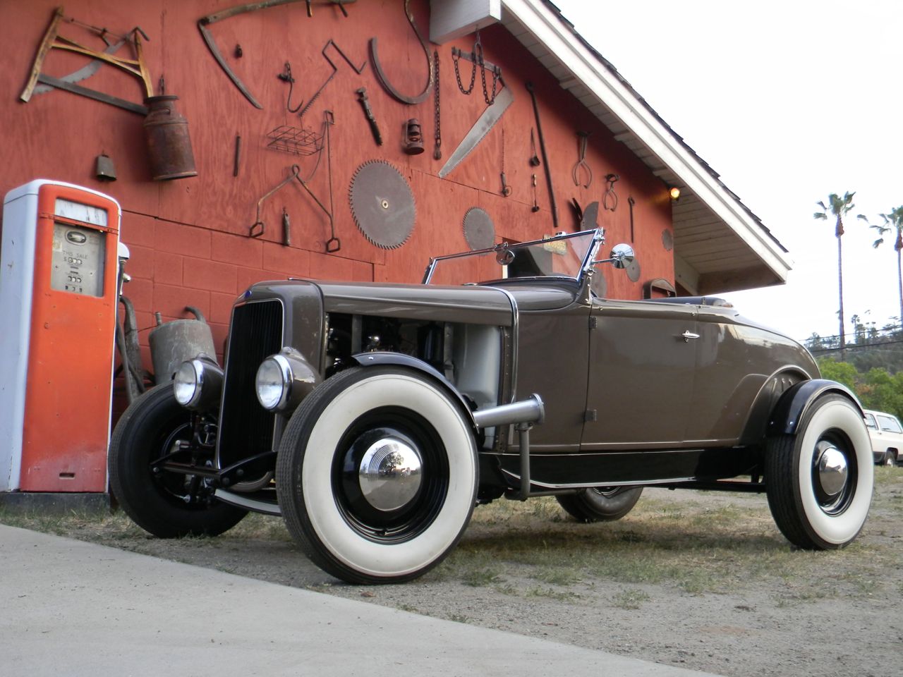

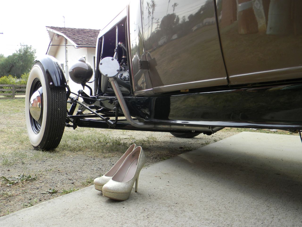

    Yes the grill is 34 Ford truck and the ****on was little messed up, so when we fixed it, we flattened it a little, to give it more a 32 look, It was a ***** to fit the stainless after that. The cool thing about the 34 grill is, that it is deeper. So we actually had to shorten the hood. Usually if you run a 32 grill with 32 frame 31 body configuration, you have to lengthen the hood.
    The grill gives the roadster a little tougher look, that helps especially because it's all shiny and painted.

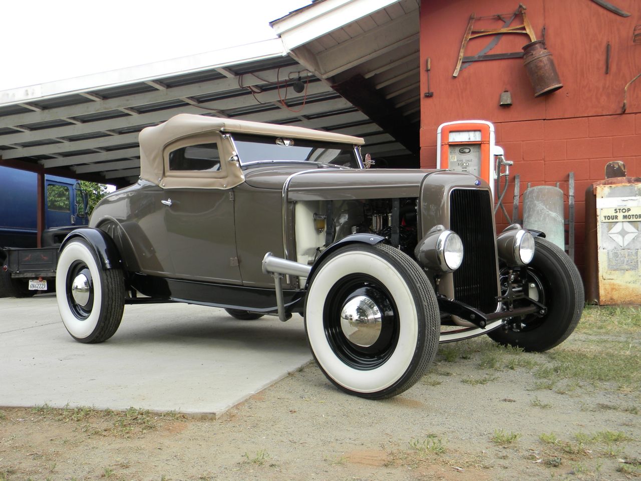

    At the suede palace GNRS. At that time we didn't have the fenders made and Richie came over from Germany to see his car at the show. After the show it took a lotta work to get everything dialed in. The back part of the top was later redone for a better look.

    Getting the car over to Germany is easy, getting it street legal is something else. We built the roadster specifically for the german DMV rules. Fenders, turnsignal, e brake, windshield wiper, rear view mirrors, H4 headlights with the parking lights perm on when the low beam high beam light are on. Hazard lights need to have priority to brake light.
    Anyway, when any car is getting registered first time in Germany, it has to undergo a very major inspection by the TÜV. After that, every car has to be inspected every other year to get the stickers to be legal. The 2nd checkup isn't too bad anymore. You need good tires, not old or worn, they will check the date of production. Brake lines, brake performance, shocks, suspension and rust. No rust holes are ok.
    After the car p***ed his first inspection the ***le is created and all the specs are listed in the ***le and registration, so that the cops can see any afterward modifications. That means tickets, points and suspended registration driving without insurance. Crazy ha?
    In Germany the VIN is mostly part of the ch***is, not the body. We used the Vin from the real 32 Frame and got the car registered as a 32 Ford, what helps in Germany to explain the cops, why the car has a V8 instead of the 4 banger.
    In other words, to drive a hotrod in Germany, you gotta be a little bit of outlaw. Crazy extreme rods with major frame modifications are pretty much out of luck.
    Our roadster is pretty mild and period correct. Most inspectors would consider the car as an antique, not a hotrod.

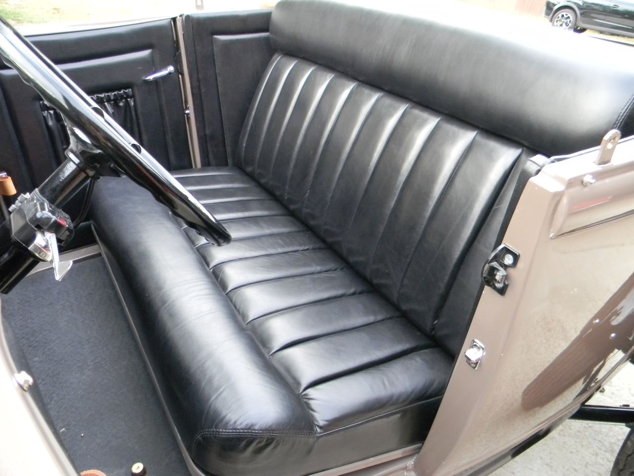

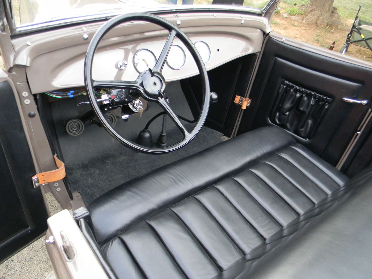

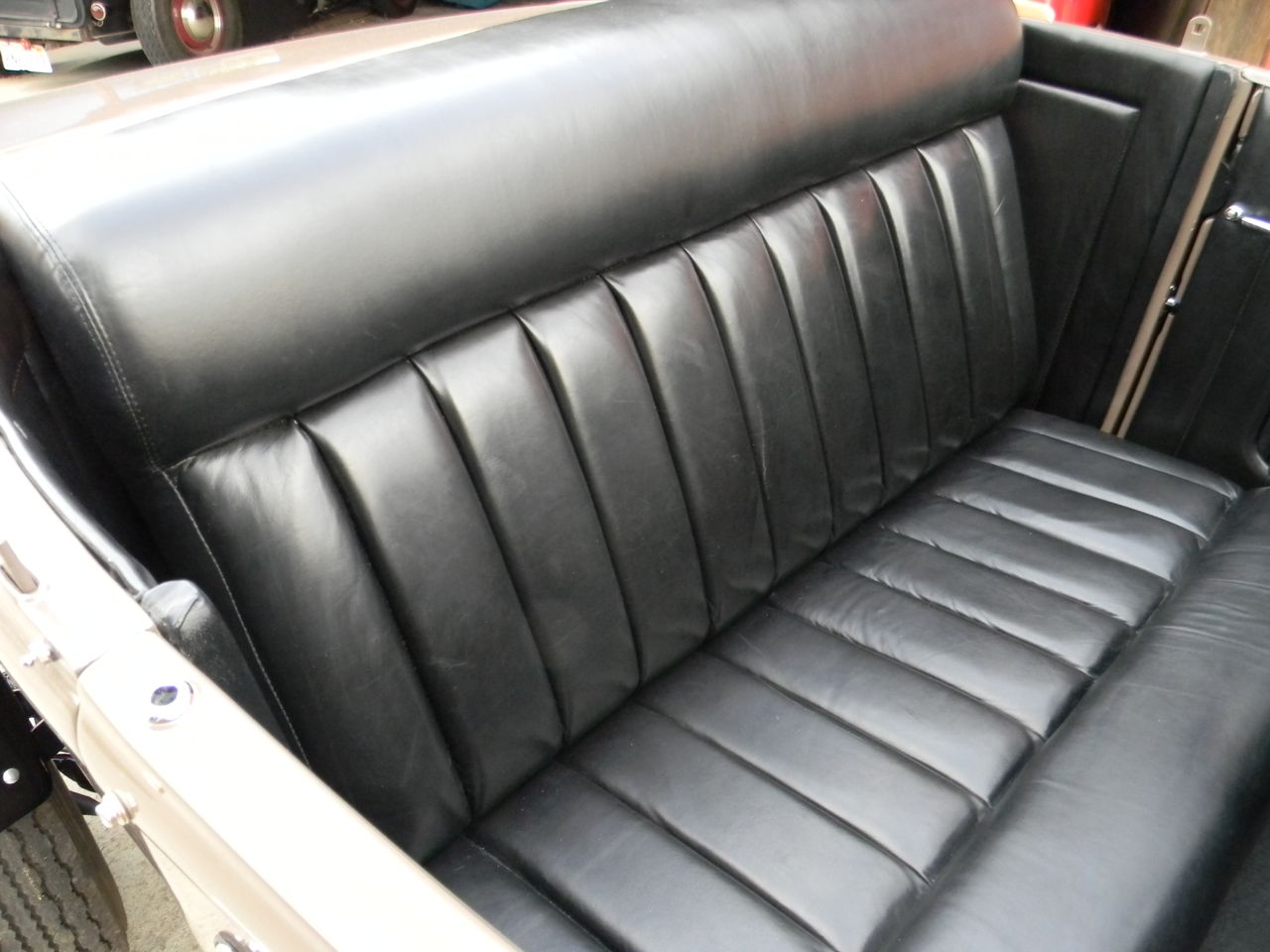

    some pics from the interior. Tijuana leather
    The gauges are 50 Plymouth and fit perfect in the 32 dash. All functional. The temp gauge was converted from mechanical Mopar to electrical Ford.

    40 rear end was freshen up and center shaft was cut down and resplined, rear end has 3.78 gears and with the tall rear tires, it should bring it down to 3.54 gears which should at least get the car in the slow lane of the autobaun. The ****** was rebuilt with 41 to 48 pasenger gears which gives you a nice long secound , to get the car up to speed.
    The face of the stock A gas tank was dimpled so the 50 mopar gauges would clear.
    34 pedals were used on the 32 crossmember and the brake pedal modified for hydralic brakes.

    After grand national, Richi told me he wanted side curtains added to the car, I thought it was going to give the car the old man, weezer look, but with the chopped top, the curtains have turned into an ***et and give the car a pissed off kubelwagon look and a *****en at***ude.

    In the late forties, except for the lakes or at the strip, the guys had to run fenders, the fronts were usually 35 to 36 spare tire covers and the rear were the stock fenders but were bobbed . Back then, cops did'nt like hot rodders and this was the perfect excuse to pull them over.
    As Stefan mentioned, the fronts are 36 units and the rears he scored on , there old motorcycle fenders that had once been on a hot rod but they were set up for 15 inch wheels , so we redid the wheel arch and the brackets. The trick was to make them so you could dismount the tire with out taking the fenders off, but not leaving too much gap between the tire and the fender, so they did'nt look like an after thought. I think the motorcycle fenders work well in the rear and they help fill the rear wheel well area and are in proportion to the bigger rear tires. The left front tire brackets are different than the right, this is because you have to clear the left steering hoop.
