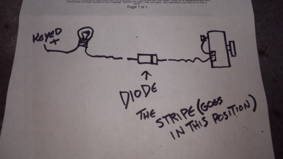

    This is just a quick simple solution to that car won't shut off issue...

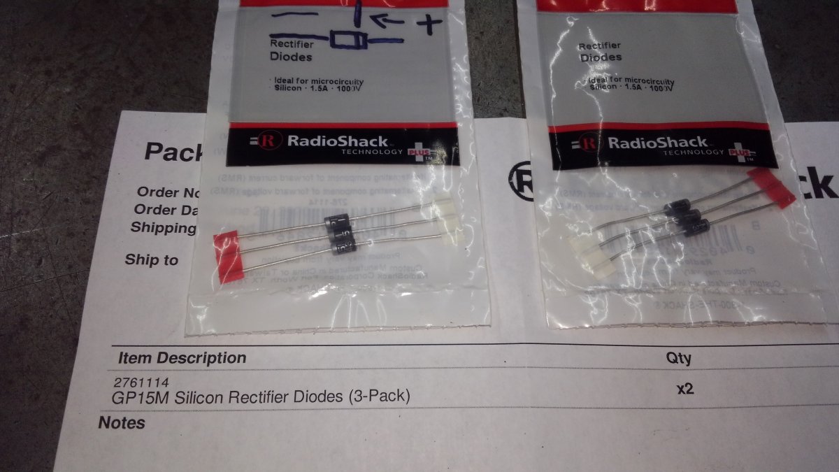

    I was working on a O/T Gm powered that had this very issue... Realized I only had one Diode left for said fix..
    I still had the store bought package when radio shack was still brick an mortar, Searched the part # , Sure enough it was still available
    Soo I thought I'd shoot you guy's needing help in this department the fix, splice/solder one of these in the keyed wire going to the alternator , Slide a piece of heat shrink on before, Done! KIMG7301.JPG KIMG7300.JPG

    Or....you could hook that wire to the acc side of the ign switch, does the same thing.

    If I wired my ignition like that, I might not get it started when it is time to leave.
    Diodes are cheap, and easy to install, and are much better than getting yelled at by the wife.

    Crazy-town! I thought they were long gone.
    I just bought 30!

    Any electronics supplier will sell you gobs of 1N4004 diodes for anywhere from a few cents to a half a buck apiece, depending on brand, quantity desired, etc.

    Exactly my point.... First ya gotta know what ya need... Only point.. nothing more... I wouldn't know if a electrician friend didn't tell me.... Why.... I thought I would put it Out there... Squirrel I know you can build robot's... Not all of us can.. h-hee... Cheer's

    If your car has a acc terminal on the switch just wire the alternator to it.
