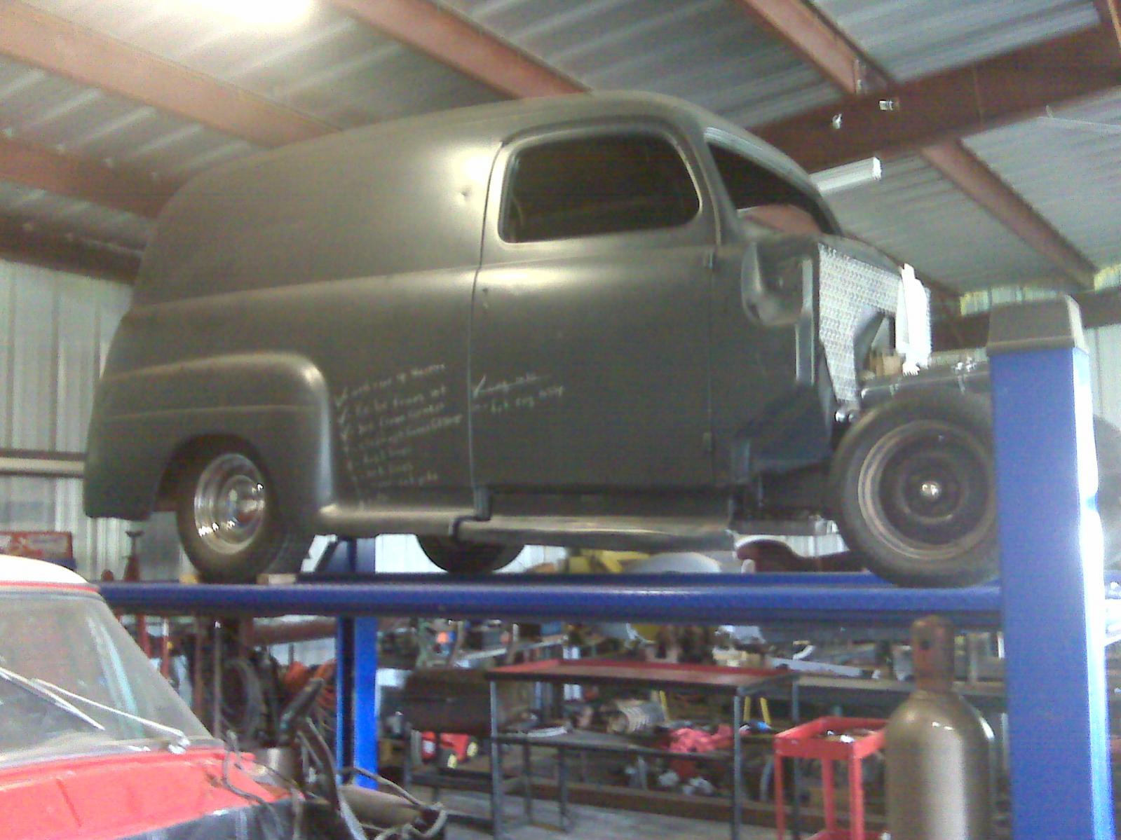

    The first few pics are from when we got it in February. The ones with the panel on the lift are from this weekend. I will keep posting pics as we go along until The Goon is cruising in his new ride.

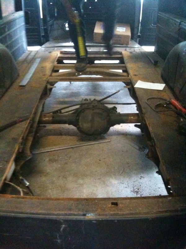

    I went to SCHR after a couple weeks after dropping it off and I found they have been working on the floor. The ramp will be set just behind the rearend. The biggest clearance issues are in the entrance of the Panel. The Goon is only 5'4" if he were to be standing. He measures 52" from head to floor while sitting on his chair so there will not be much need for head clearance after he is passed the threshold.
    I will be adding more pics as my son recovers more and he can get out to the shop.

    UPDATE!!!! Woo Hoo! The Goon Wagon build is coming ali
    long just fine. The floor is almost done. The Goon is very excited.

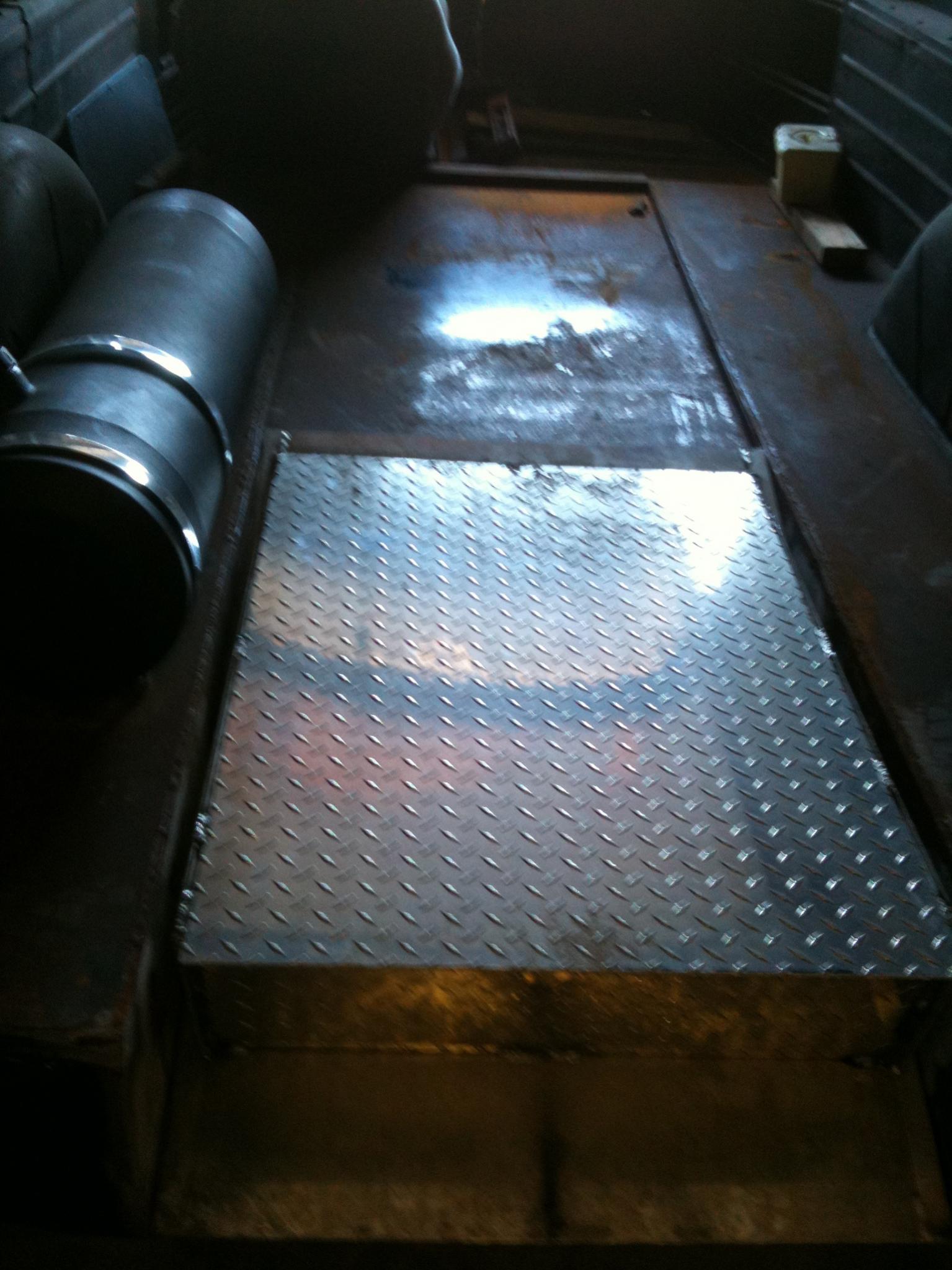

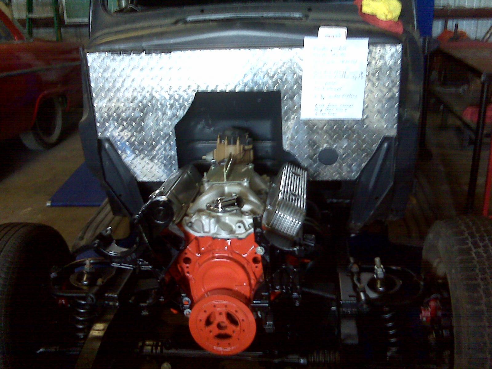

    Quick update....We've been getting all the parts together to button up the engine and trans. Things are starting to move a little quicker. Here are two pics of the ramp.
    The third is a rendition of how Goon wants his ride to look, done by his good friend Craig Wilderman.......with a little tweeking by The Goon.

    Well it has been a while since the last update but here we go. The Goon has had a slow recovery over the past few months but was recently able to get out to the shop for a trial run on the ramp.....and he didn't fit in the panel. Even though the floor has been dropped.
    Not many more options that we can think of but here are some pics of the ramp.
    We are open to ideas/suggestions on how else we can go about fitting this guy into his ride.
