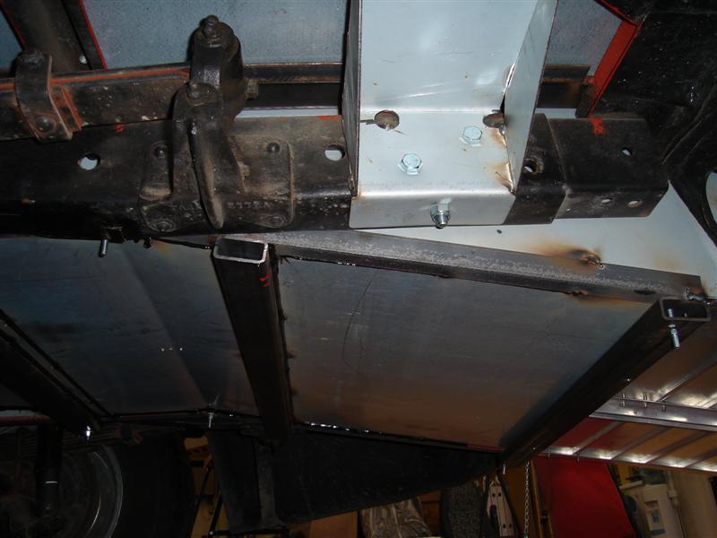

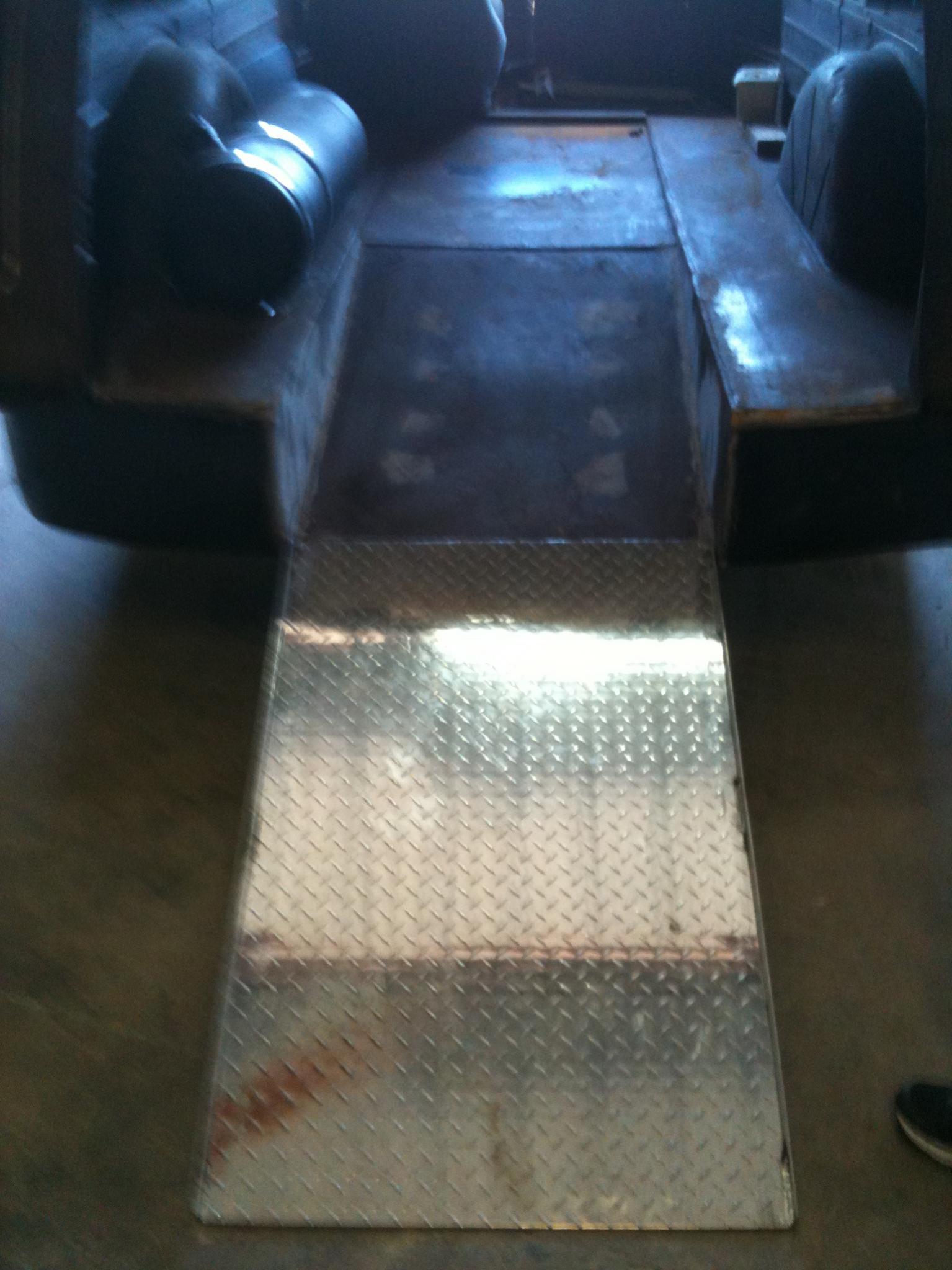

    Jesus H Christ on a sidecar, that ****s big time my friend! But hopefully, from looking at the pictures you've posted, all is not lost. I can only compare the difference between what we did and what you've done but rest ***ured there is a difference and I'll do the best I can to explain it. It looks to me like you're ramp is pretty much spot on and looking good, but from what I can tell you haven't dropped the floor low enough further up the "runway". Take a close look at the attachments below and you'll see that the floor in the kripple kart is dropped a full 6 inches right up to the front seats, thus giving an extra 6 inches head room all the way through the rear of the truck. We managed to achieve this by cutting out all the cross members and remounting them Underneath the ch***is rails using 2" x 1" box section, first bolted then heavily welded in place.
    This then presents the problem of the differential sitting too close to the dropped floor and knocking when you go over large bumps. However if you look at the picture showing the inside of the truck you will notice a square of black rubber mounted to the floor over the top of the differential. We have actually cut a square hole in the floor which allows the differential to bounce up through the floor going over bumps and the rubber is covering that. If you were to look in the back of the Kripple Kart you would notice that the high point of the differential casing is permanently one inch above floor level making a "hump" in the rubber diaphragm. Also, our ramp is not designed to fold flat to the floor but is located at 90° from the floor and held in place by two heavy duty spring bolts in an upright position leaving the runway clear through to the front seats.
    I'm not sure of the difference in depth between the ch***is rails on an F1 compared to an F 100, but by mounting the cross members underneath it should give you a few extra inches headroom. I hope this clarifies things a little bit and give you that little bit of extra room to work with. Don't panic, man, it us several attempts before we got it right.

    Nearly forgot, we also had to reposition the shock absorbers in a more upright position on the outside of the ch***is rails, you can see that in the first thumbnail. I hope the Goon is doing okay, and if you drop those cross members he'll get in there one of these days.

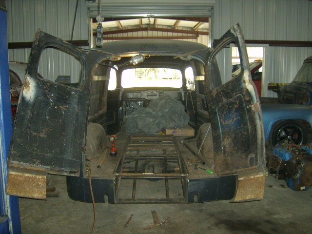

    We lowered the floor several inches but, it was not enough my son is too tall. We need about 4 more inches so he can get in. The floor is pretty much on the rear end. We currently have a '90s Ford Explorer rear end. KripFink used a Ford 9 inch rear end from a Grand Torino. I wonder if the Ford 9 inch has a smaller yoke [i don't know if that is the proper term for the center part of the rear end].

    The builder is suggesting we drop the floor 4 more inches and using an Air Ride suspension. His thoughts are that if we drop the floor some more. The Goon will fit better and in order to avoid the rear axle from hitting the floor when driving we drop the panel Goon can drive in and park. After he is settled in we can inflate the bags and have more clearance between the floor and the rear axle.
    He suggested we go with one of the kits sold by Speedway but said to look around first.
    Any suggestions? There is not much room for large bags between the ramp sides and the wheels. see pic.
