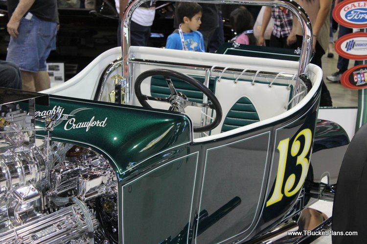

    I’m planning on using these master cylinders on my t but I need help identifying them. I found an article stating they are mounted to an ansen swing pedal but that’s all they say. These are off the Geraghty & Crawford T Roadster recreation. Does anyone recognize them? If so what make and model are they off of?

    Picture is a little hazy; but they look like early Ford cyls. '39-'48 car and '39-'52 pick-up. Here is a picture of the one on my old car to compare. Ansen pedals were available for a pair of Ford masters as well as the Chev & IHC dual masters.

    In an old primed picture it does show 4 bolt masters like that. Flash of the chrome firewall hides that detail in the pictures of the finished car.
