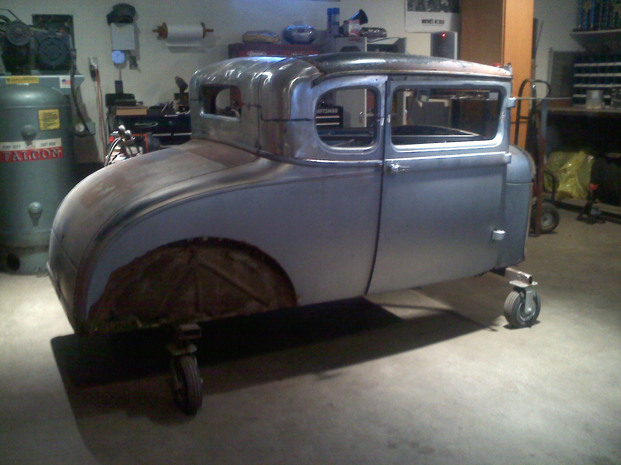

    Kind of a late intro on this build but better late than never.
    So I asked my long time girlfriend Sammy to marry me in Bonneville this past August. So with the wedding plans in motion, why not throw in another build to keep me on my toes! So we decided that the 29 coupe would be the wedding car. HA! Cool. I'm into that idea. Plans call for a ful fendered, low, aggressive looking mid sixties look. Not too glammy, but just enough bling. I have a pretty cool little 283 and a 4 speed, early Bronco 9 inch rear. And I'm thinking gloss black paint.
    So this is where I'm at thus far.
    The body is a pretty fair piece to start with so the actual rust repair is not too terrible bad.
    I started with pulling the body and rolling the rest outside. I braced the body up and, after much mental debate, went with a 5 inch chop. And I'm glad I did. I think the proportions are just right. The shape of the quarter window is actually what made up my mind. Not pinched looking but just a nice sweep in the rear line.
    I then drug the body to work as I had access to our sandblaster after hours. 20/30 silica sand, standing way back, and just pepper the panels at a 45 degree angle. This works very well and have had very good results in the past.
    I brought the bod back home and started the knockdown process with 100 grit on my polisher. So her is where I'm at. Going to finish up the chop and start on the rust work. I'll keep posting my progress.

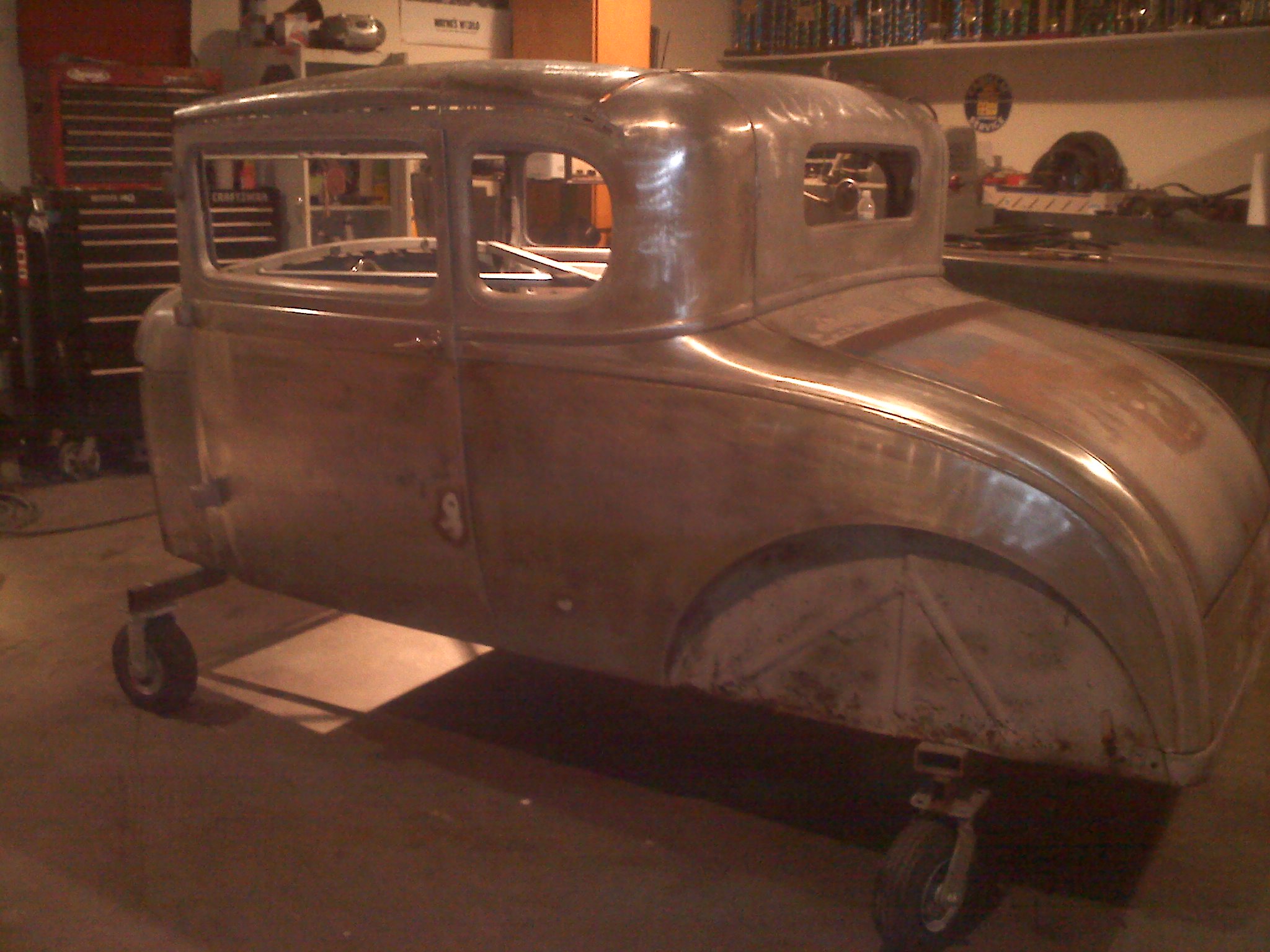

    More Pics
    I was able to get all of my gaps pretty nice and tig them up.
    The last pic is as of tonight
    Hack

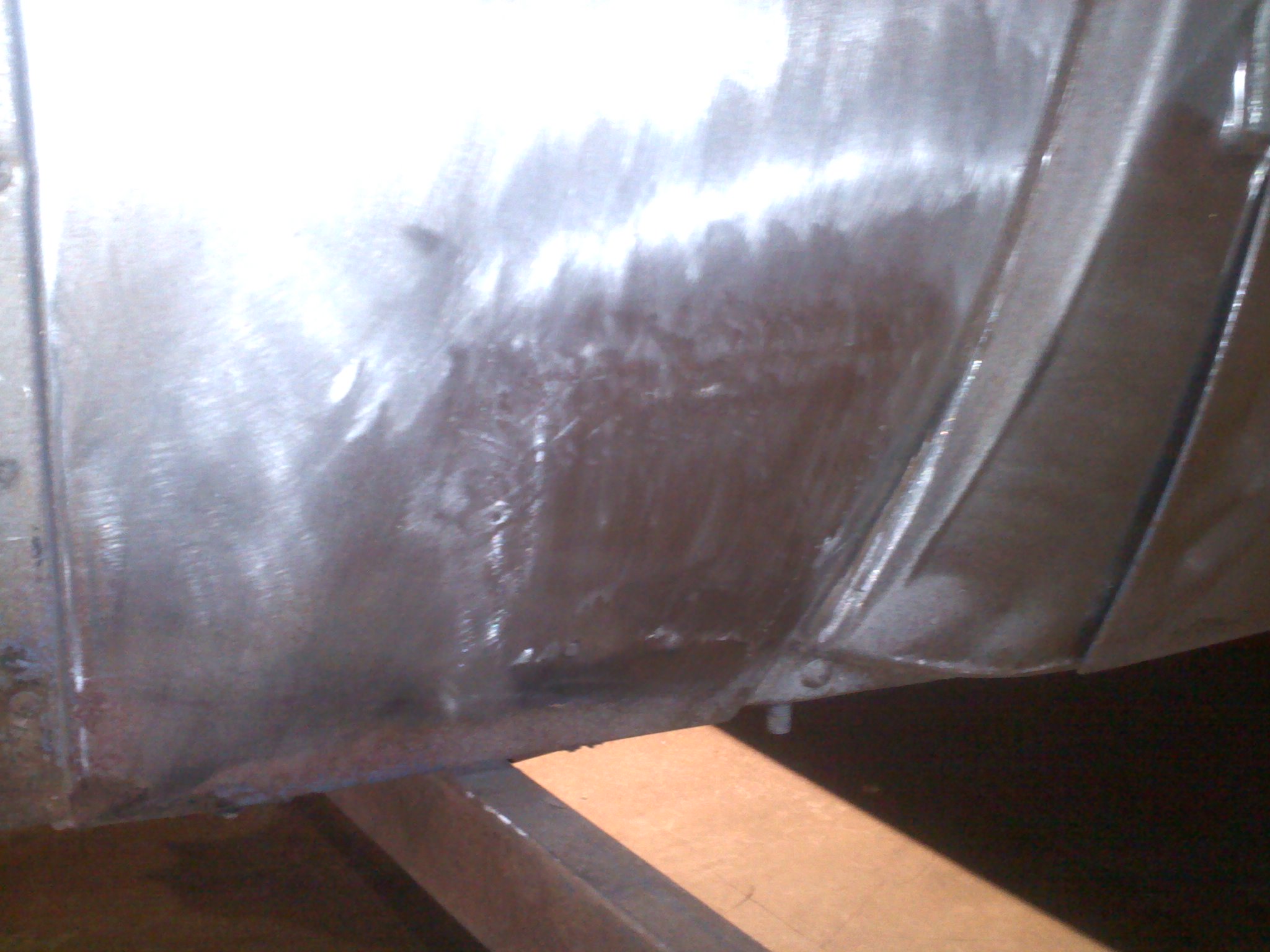

    Update, well kind of. I was able to get the cowel patches pretty well hammered out. I'll keep up on the pics and post as I go. Still on track for having the body finished up by the end of Dec.

    Ok guys. So I have been woking on the door window channel allignments and little things like that. Making good progress with steady work nightly and on the weekend. I hope to be starting on the frame mods and engine/trans install pretty quick. I will most definately be posting my progress. These pics are of the window channel area and how I went about straightening that out.
