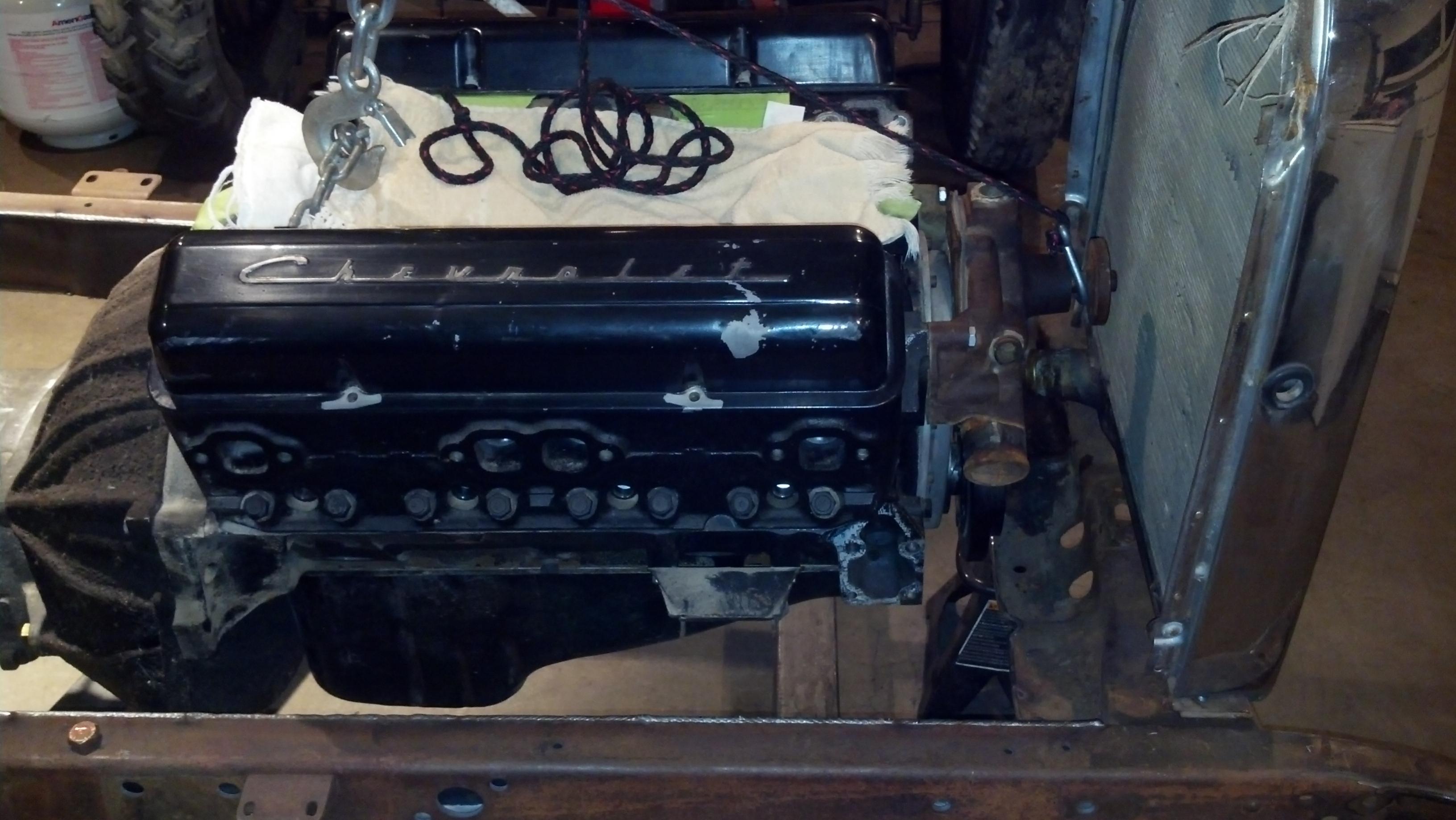

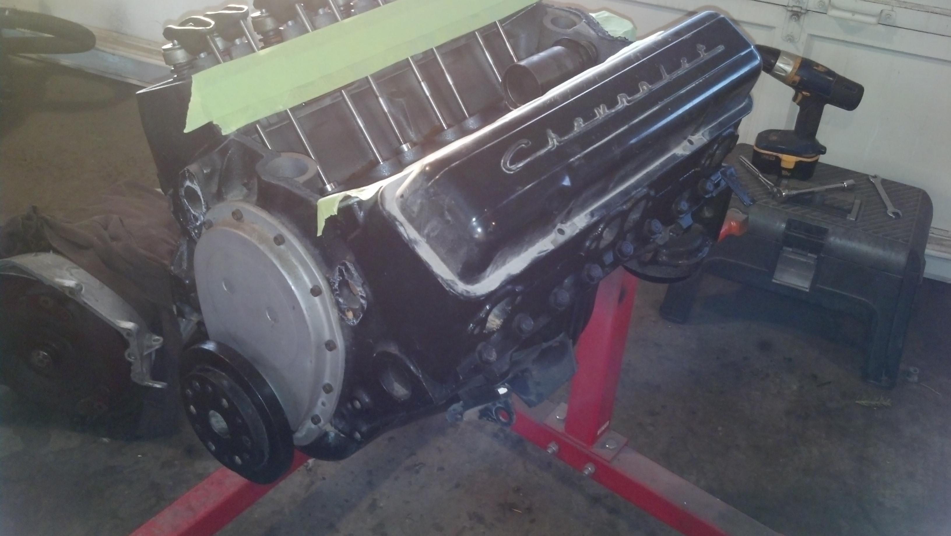

    Ok guys so its been a while since my last update. I was able to finish up the body repair work as scheduled so I thought I would check on the engine.
    So the story with this 283 is kind of neat. It belonged to my good friend Matt's grandfather and was originally in a 61 Biscayne. The engine was rebuilt by a local machine shop about the time I was in high school and was destined to be installed in a way channeled 64 Ford pickup that belonged to Matt at the time. So the engine remained stored for years untouched. So this is the cool part. No one including me, ever really payed much attention to what this little engine really was. The pistons are .040 over flat tops and upon my casting number search I found out that it has quote "dual quad, fuel injection, or 4 barrel Vette" heads. Also ended up having a forged crank. I pulled it down just to make sure that everything is ok inside and I am pretty pleased with how clean it still is.
    Pics to fallow.

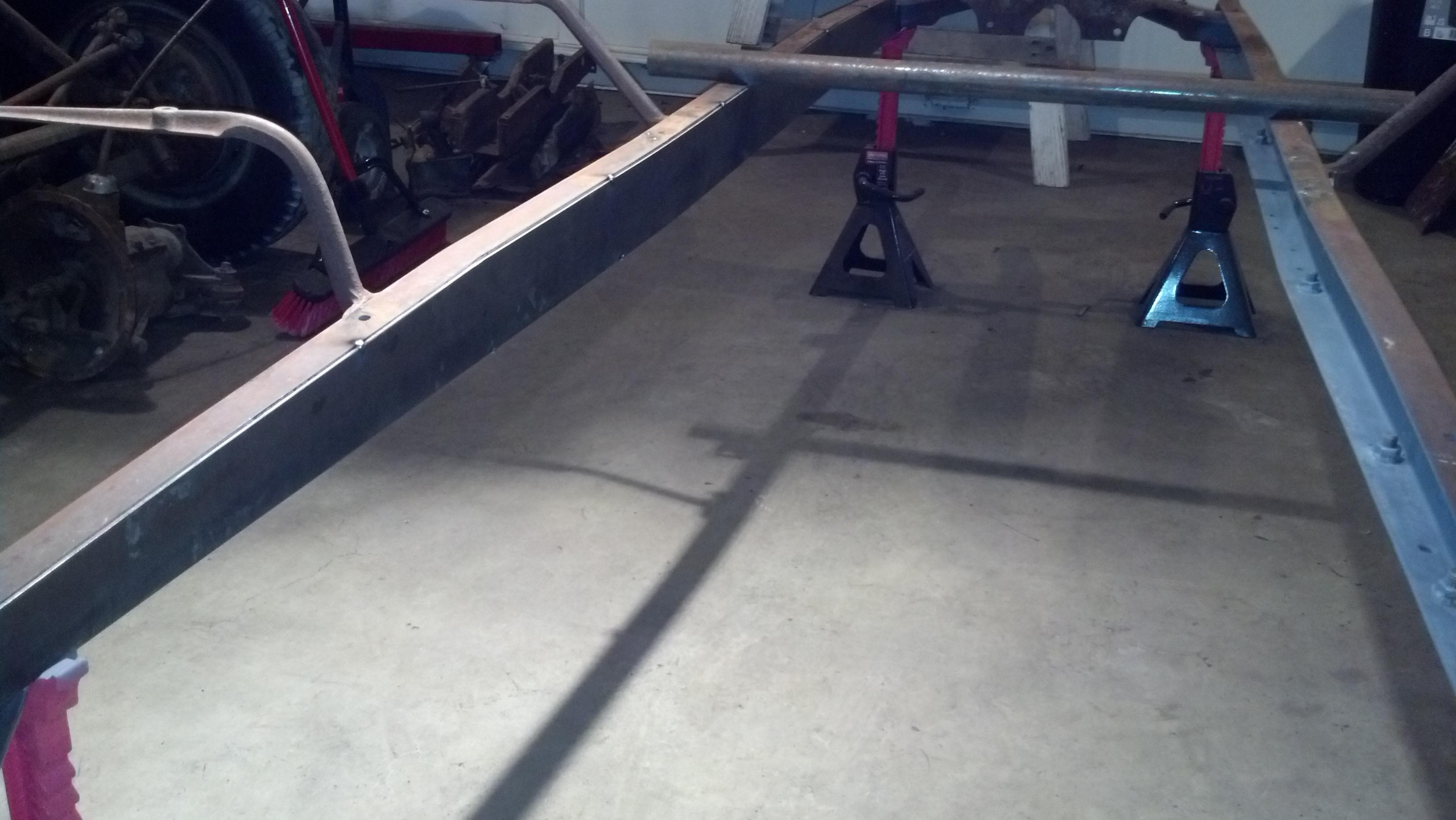

    Well I got started on the kick up today. I went with a 3 inch total drop. I will cut my boxing plates and install them tomorrow. The full inner boxing plates are next on the agenda.
    Here are the pics of tonight's progress.

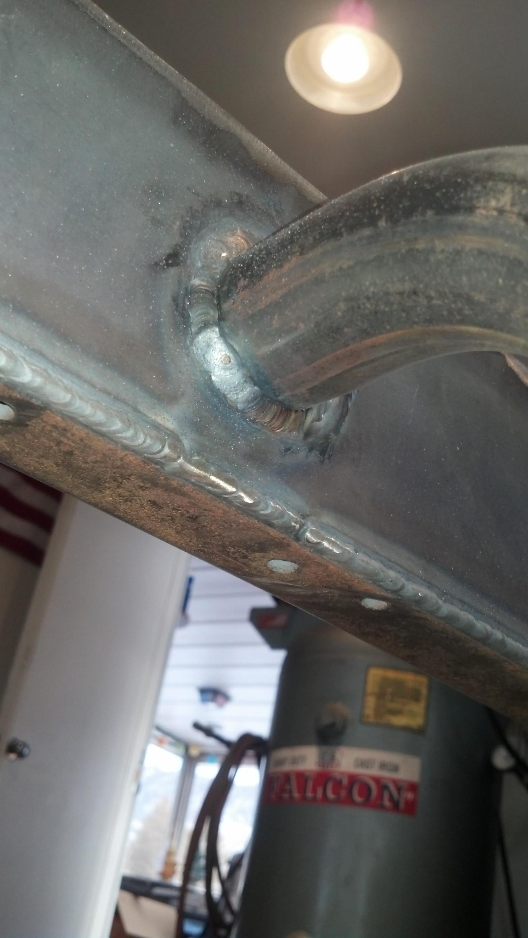

    I managed to get the rear frame step finished up. Not too much this week due to family stuff. My sister is in the Marines and is stationed in Hawaii so we dont get to see her very often. Anyway, here is a pic of the boxing plate. I added the rosette welds just for added strength.
    Thanks for watching

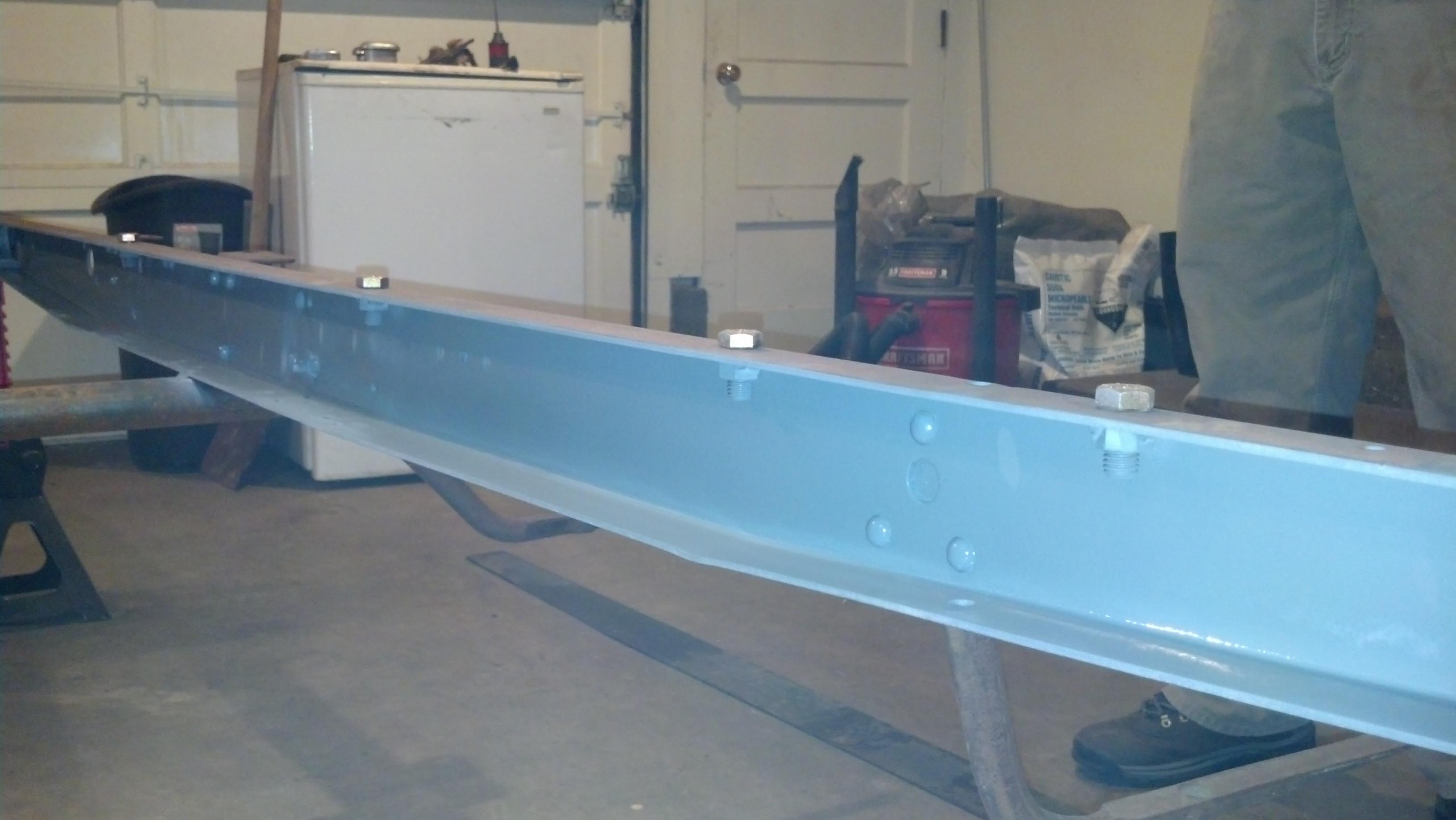

    Update,
    So today was pretty productive. I started by adding a brace and removing the middle cross member. I had help from my future father and law, a great dude, and my buddy Ben so we knocked some good work out. I was able to clean up the inner channel and weld in the body mounting nuts. I shot some rust inhibiting primer inside the frame and the inside of the boxing plate. I sheared up the boxing plates at work from 1/8 inch material and after some t*******, we had them fitting nicely. A full outside corner front to back to ensure proper penetration. Next I will mount the engine and trans. Thanks for checkin it out.

    Update,

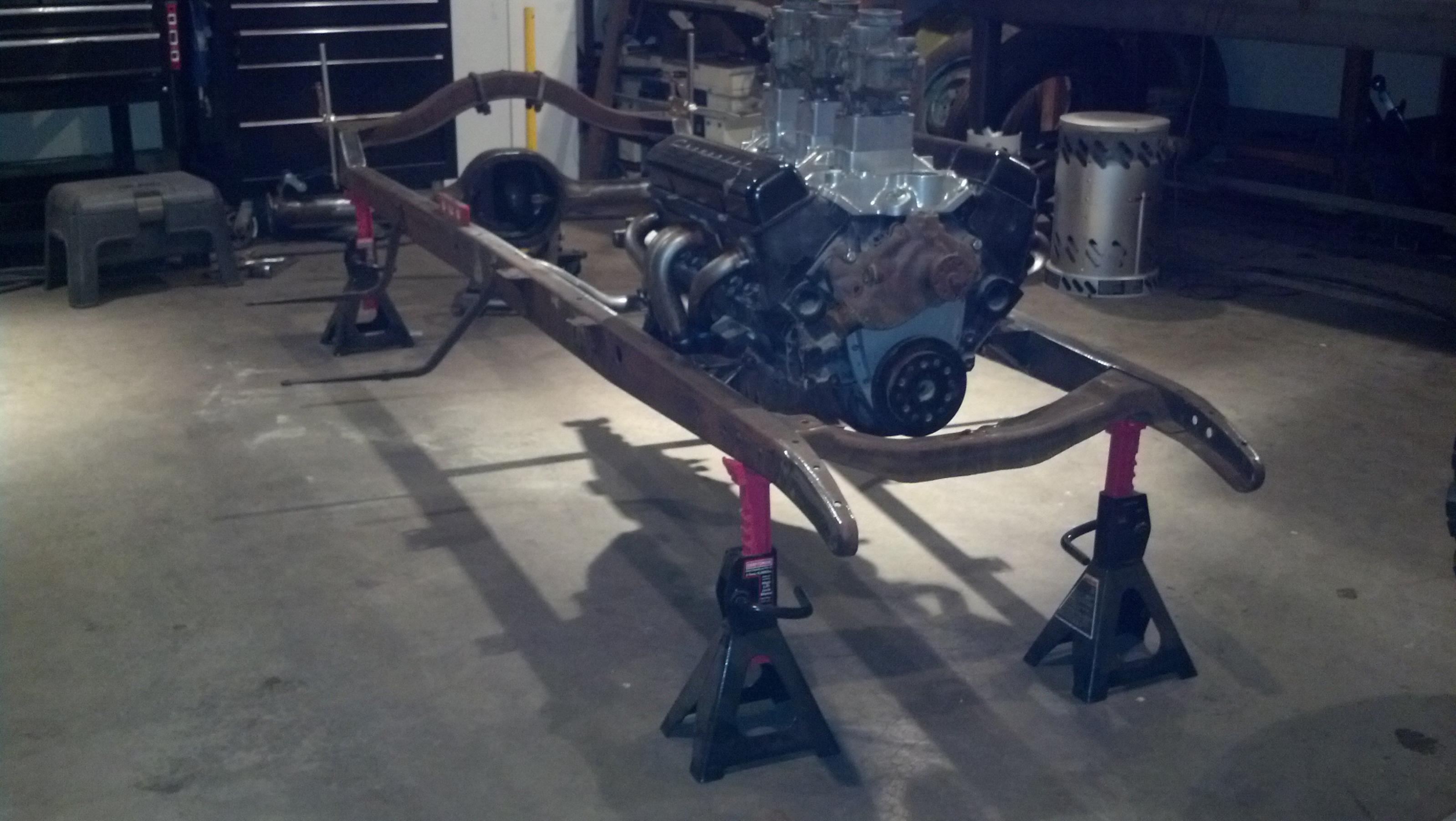

    Well guys I have pretty much finished up the frame boxing. I fully tigged up the boxing plates and the cross members. I machined the steering box as well and I am ready to install the engine and trans. The problem I have now is that the guy that I made the deal on the trans with is kind of giving me the run around. It is an early 60's T-10 and he keeps telling me that he wants to sell it and we have even agreed on the price. But every time I call him he is busy or something. I mean I have been chasing him around with 100 dollar bills! So I have given him the benefit of the doubt up to now. If he cant come up with it by tomorrow, I'm going elsewhere.
    Anyway, here are some pics of recent progress. I may or may not have made a change on the engine of choice. But if I did, you wont be disappointed.
    Hack

    Ok fellas,
    I finally got the magic trans! I went over to the guys house and saw the deal through. He was pretty cool about it. So with that said I was able to mount up the engine trans. Here are the pics of my progress. I bent up the trans cross member at work and tacked it all in place this evening. I mounted the rad and shell to ensure enough fan clearance.
    Thanks
    Hack

  20. Hackman
    Joined: Feb 4, 2009
    Posts: 646
    Hackman
    from Butte, MT
    I forgot to add that I trimmed and repaired the cross member. I also welded the seams to the frame rail for added strength.

    Since my last update I have finished welding all of the mounts and set the engine and trans back in the frame to have a sit back and look session. I also ground the top weld on the rails so that the body will sit flush. I tigged up all of the remaining areas on the ch***is where there were temp cross members and finish ground them. I think that its all sitting together nicely. As soon as my front end shows I will post my progress on that as well. I will be using another early Bronco 9 inch for the rear and I am currently cleaning the housing up. I will also be fabricating the ladder bars from 1 inch d.o.m. this week I hope. I will post as I go.
    Thanks for checking it out. And thanks for the responses.

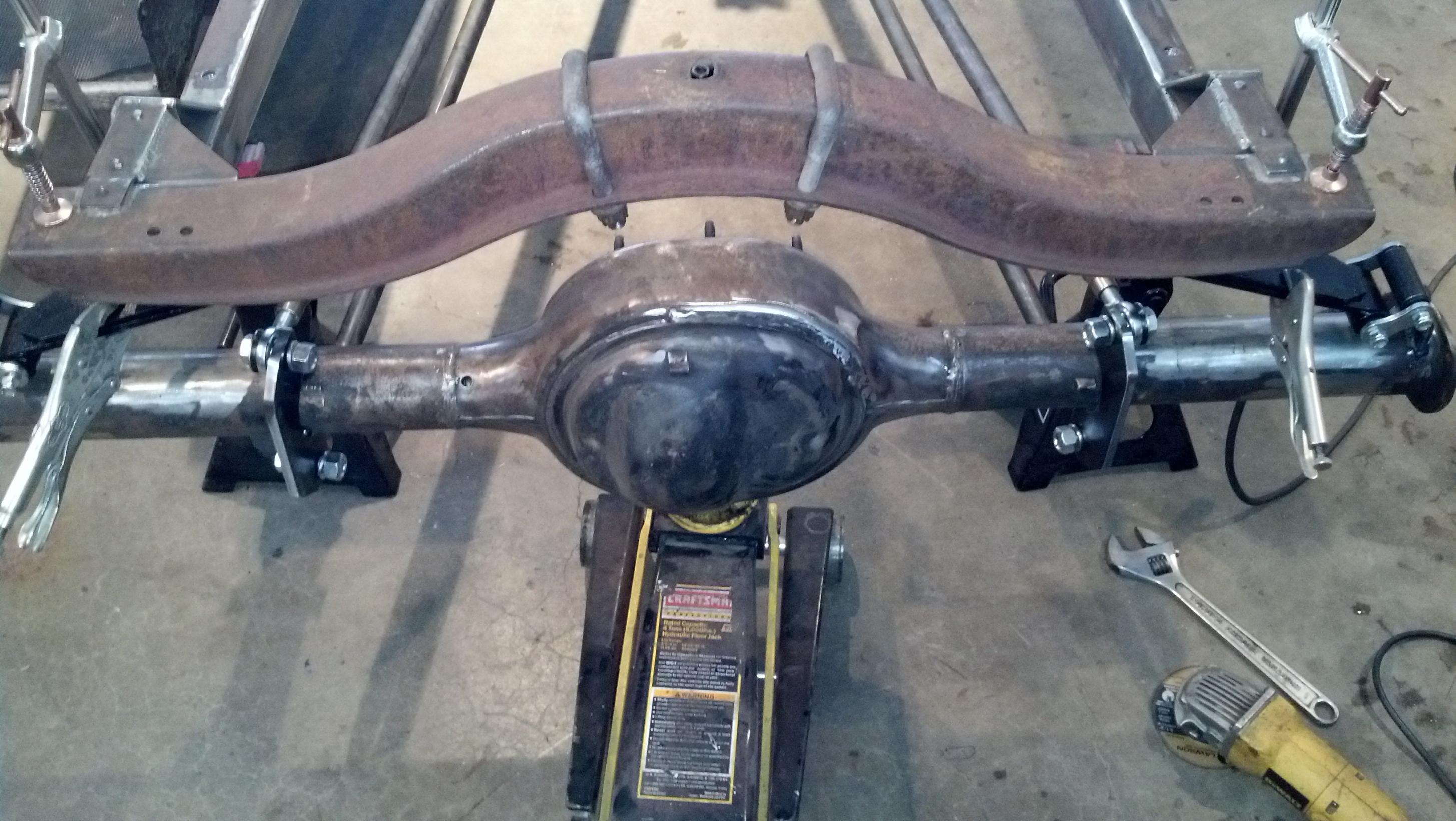

    So I have been working on the rear suspension this past week. I fabricated the rear spring perches and zapped them on the rear axle in the stock locations. I also built a rear spring from an old truck spring I had. It now has the same leaf count as a coupe would have stock. I may end up removing whatever I will need to nail "the look".
    Anyway, I set the pinion angle at 2 degrees up as per my ch***is book but the ladder bars will be adjustable for a couple degrees + or -.
    I compressed the spring with a couple of HD Bessey clamps and I think the shackle angle looks about like it should.
    I ordered my 1 inch DOM for the ladder bars and it should be in tomorrow. I will update as I go.

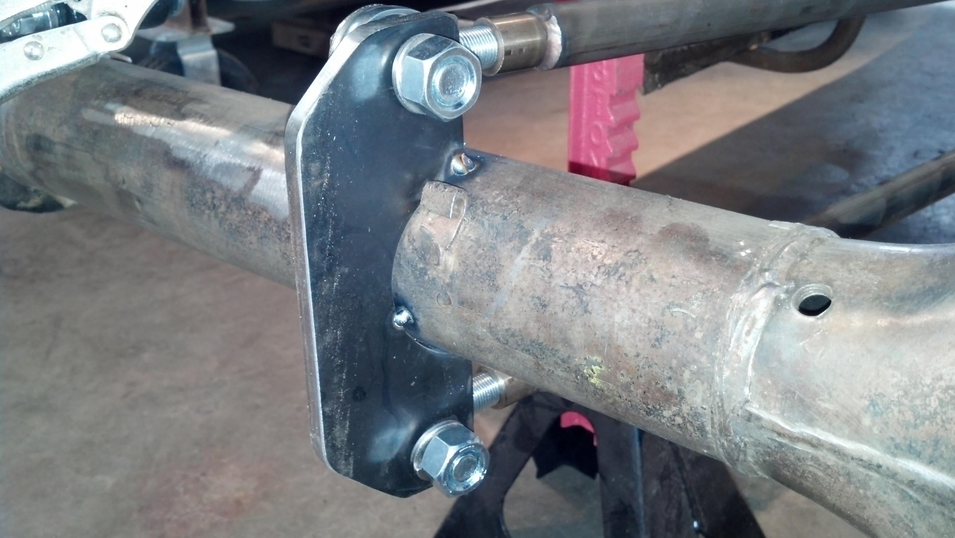

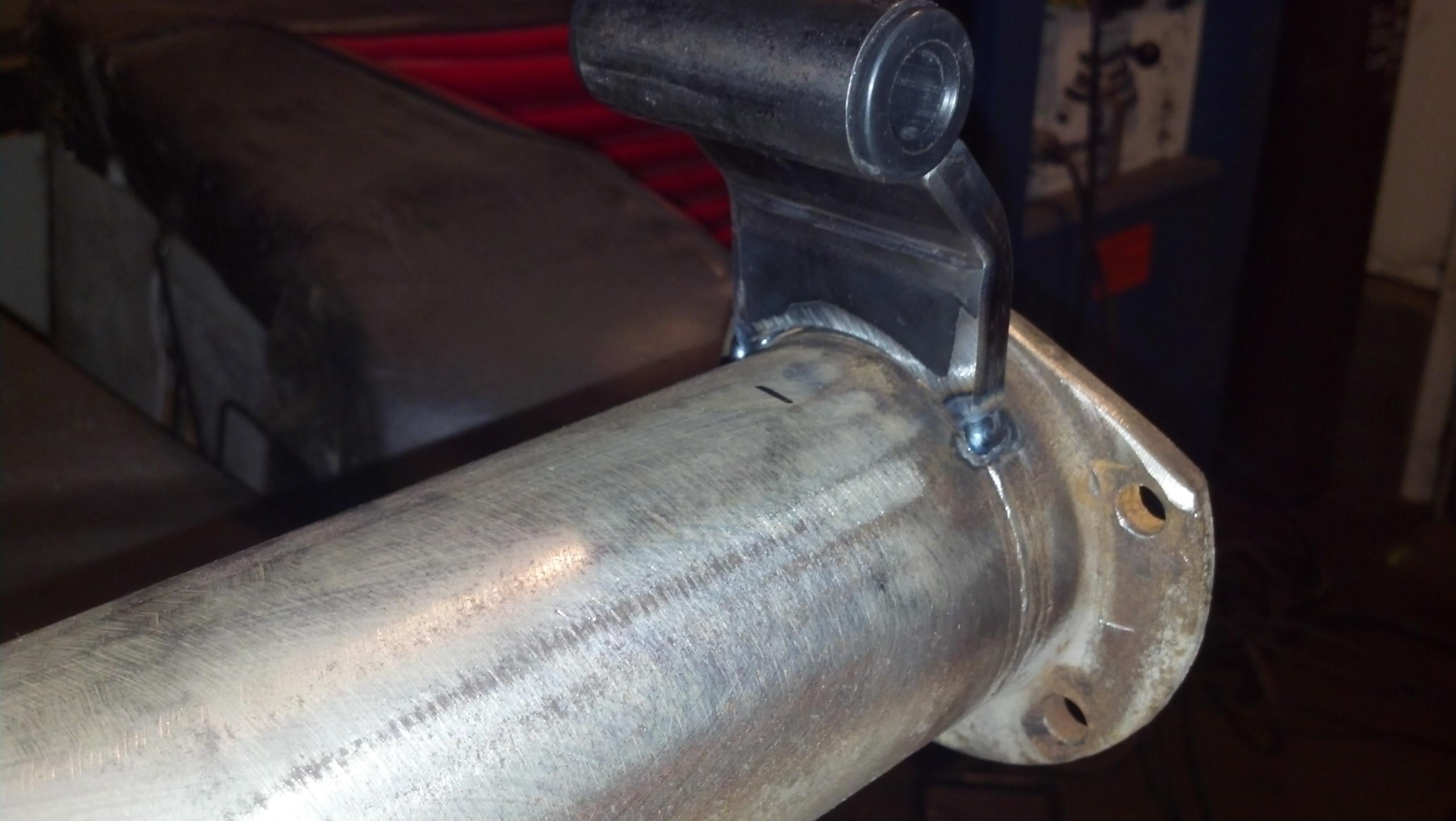

    The past few days have been pretty productive. The first pic shows the inserts I machined up for the DOM for the ladder bar ends. I also made up the axle brackets for the rear and tacked them in. ( I know I have to blow that brake line clamp off. ) I am currently making the front bushings and center supports for the ladder bars. I also got the front suspension installed but I failed to take some pics and ill post them next time.
    I have a little medical deal going on tomorrow so Ill be down for a couple days. I will post some pics as soon as I get my *** back in gear,
    Let me know what you think guys,
