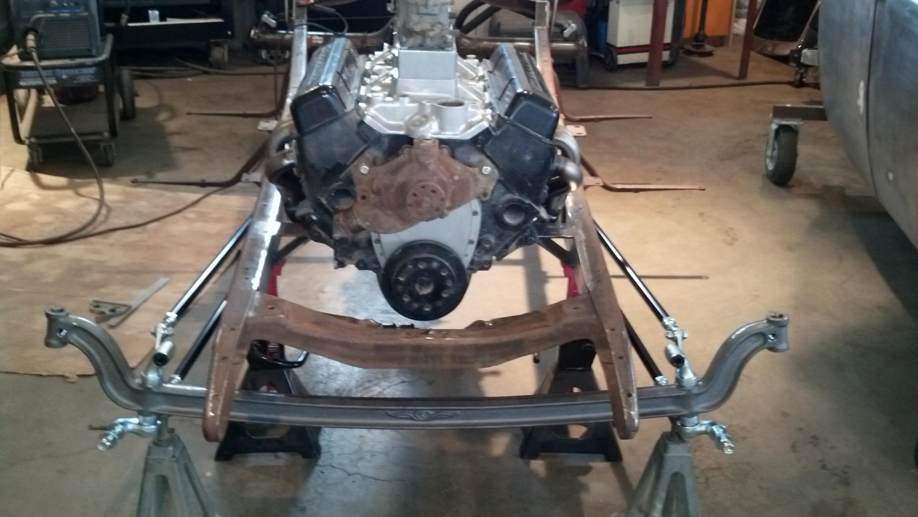

    I uploaded a pic of the front suspension. I opted for the 4 inch drop Super Bell axle and hairpin set up. I think this will aid to the 60's vibe.

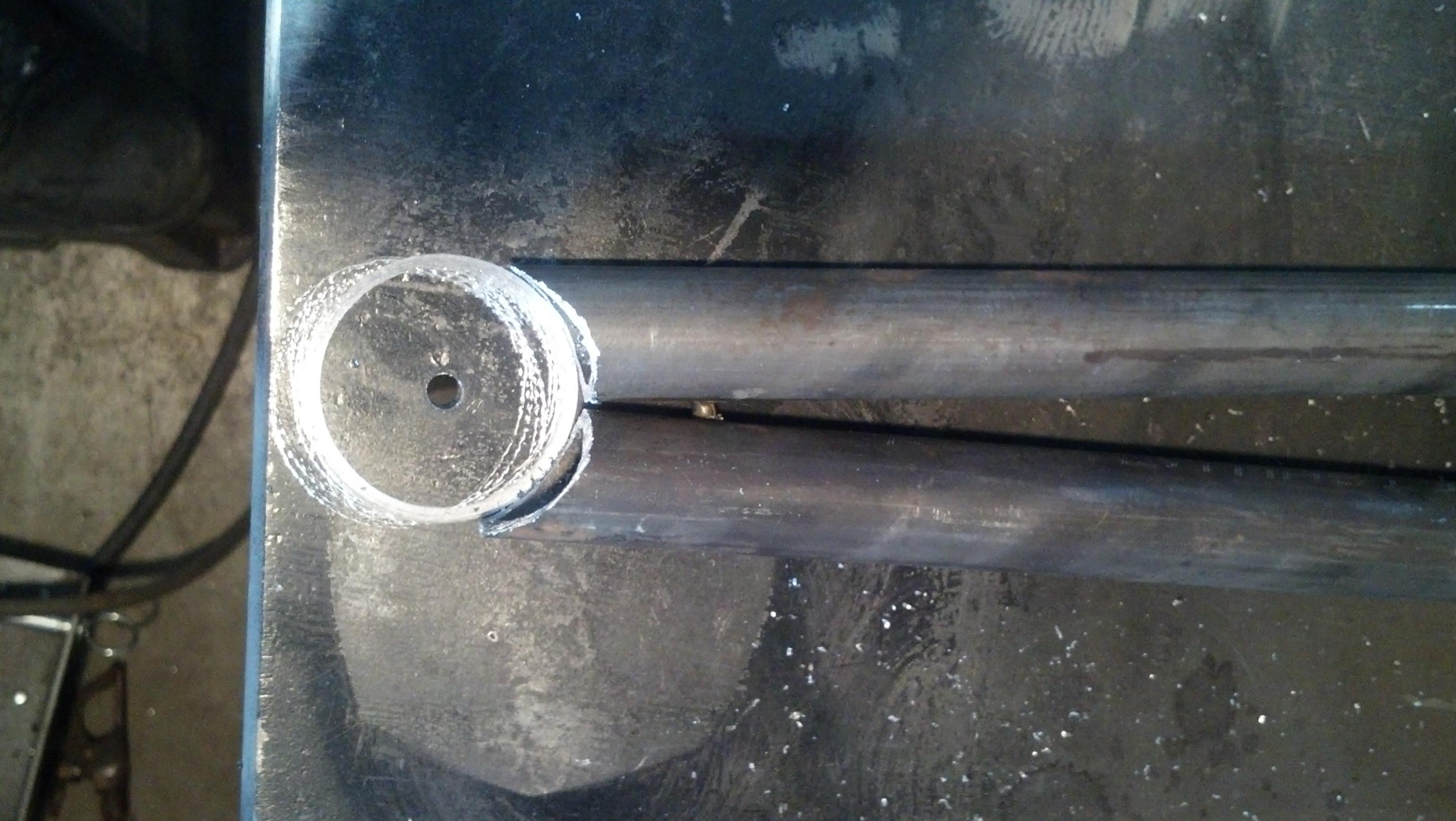

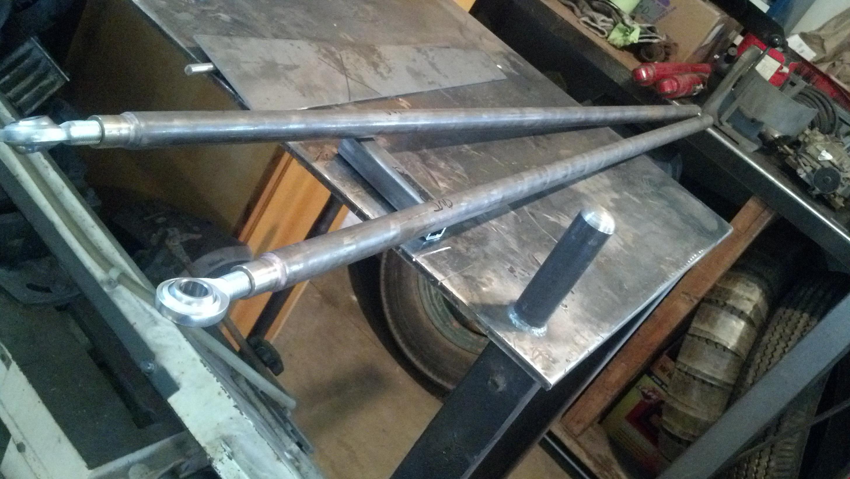

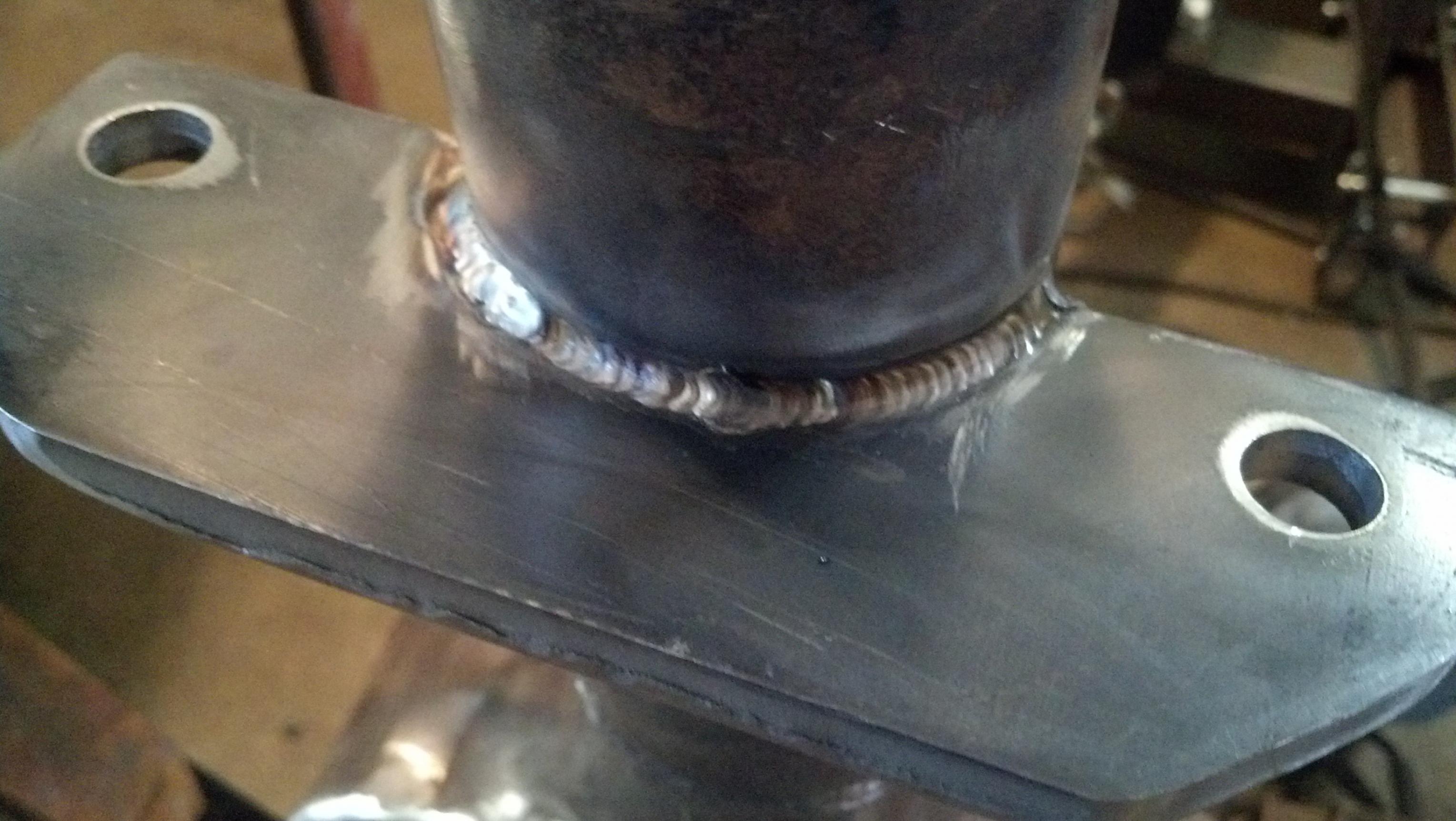

    Update on the ladder bar project.

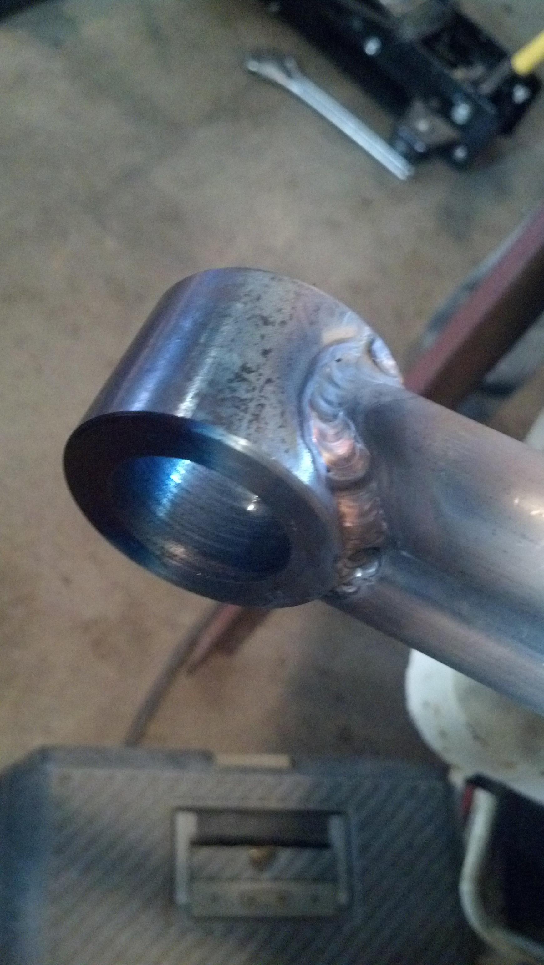

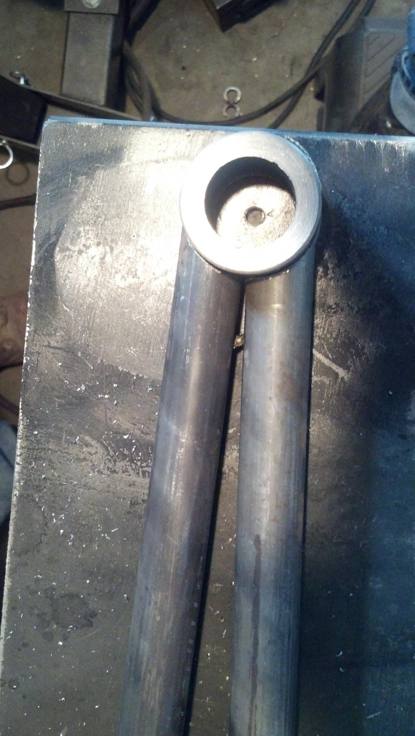

    So the plan is for this ch***is to be able to handle a lot more power than the 283 would ever make. Hence the over building of the ladder bars and brackets. So the task of the past couple days has been to complete these parts and final weld them in place. So I machine up the bushing ends, bushings and inserts for the bars. The notch in the tubes was done by drilling a pilot hole in my table, clamping the ladder bars in place and using a hole saw to notch the tubing ends. Pretty simple but sometimes being clever is more important than having a bunch of machinery. I also welded the center supports at this time. Anyway, I snapped some pictures along the way. Thanks for checkin it out,
    Hack

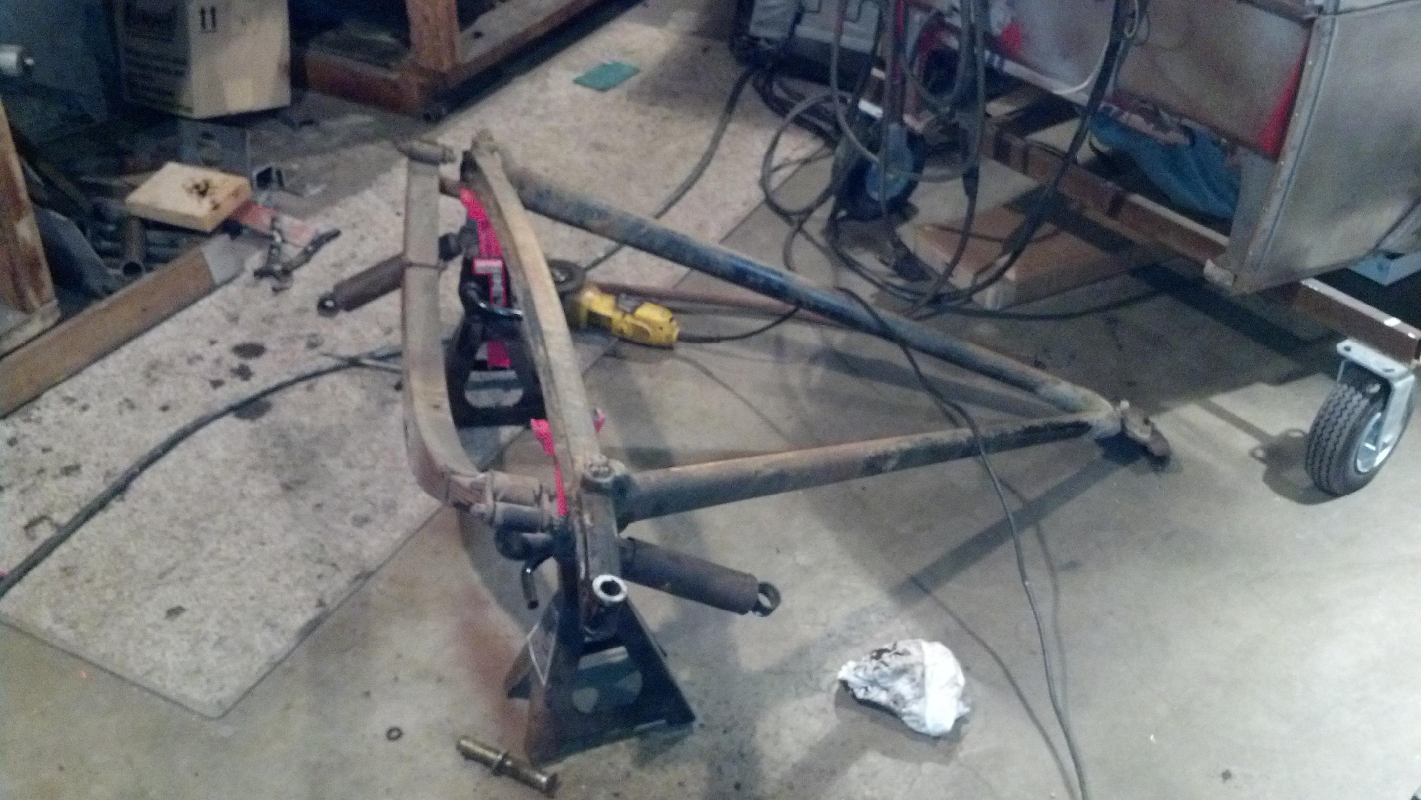

  15. Hackman
    Joined: Feb 4, 2009
    Posts: 646
    Hackman
    from Butte, MT

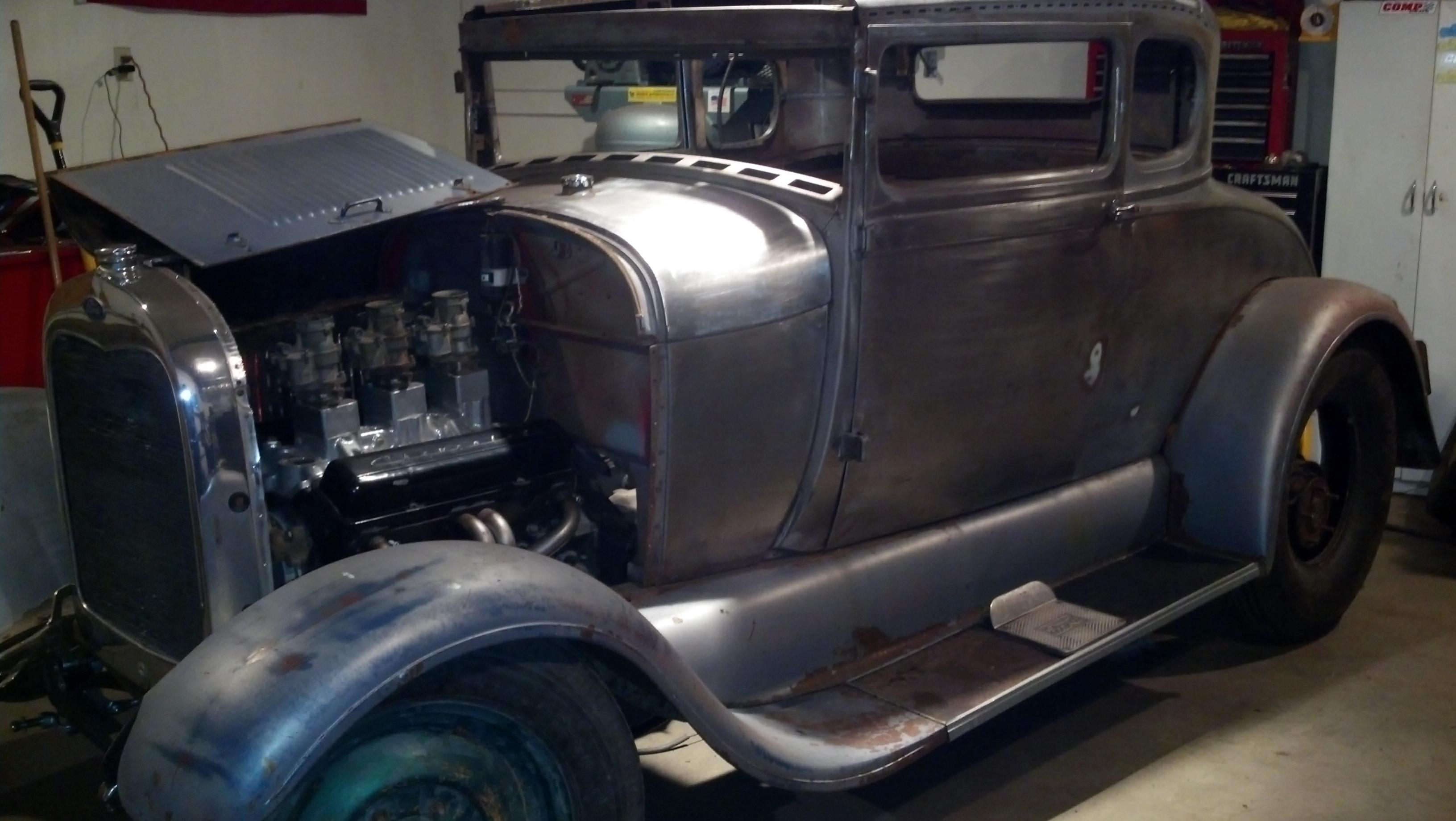

    Update,
    Tonight I was able to get some time in the garage so I decided to strip the donor front end (39) for its spindles and steering arms. SO with that, I couldnt help but install a fender and a spindle and have a look at the much anticipated "tuck". I think its going to look pretty slick. I know the hub isn't correct but you get the idea. The tire in the pic is a 5.50 16 and may end up being a 5.0 16 but ill make the call when its on the ground.
    What do you guys think,
    Thanks
    Hack

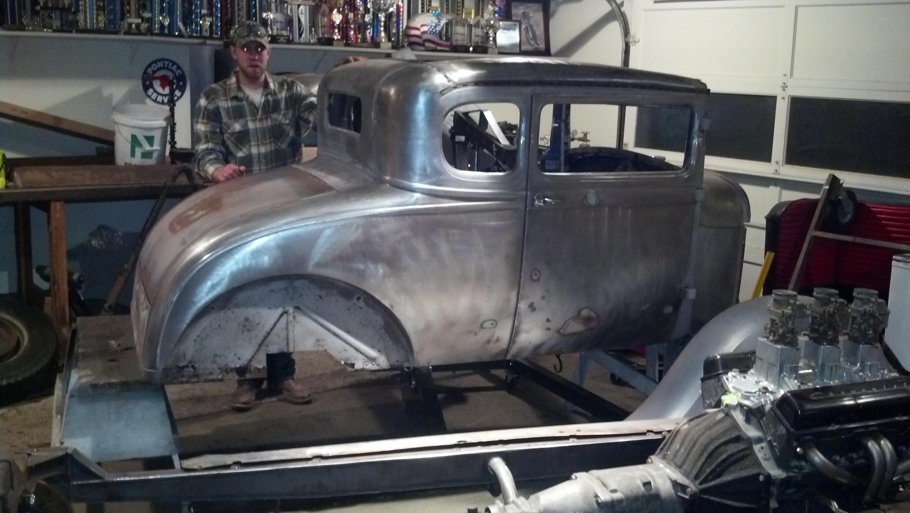

    Update,
    This past weekend I had a huge help on the project. Firstly I want to thank my friend Brian for the 9 inch parts that I desperately needed. My good friend Conor, the photo bomber, (T top builder and wood working phenom) also was a huge help the past few days. So with that being the case, we got a lot accomplished. The body received its final t*******, both in the rear and firewall, and was placed on the ch***is for the first time. We also put the body together and ***embled the front suspension and set the weight on it. So this is what she is going to look like. I envisioned just exactly what I am seeing and with the help of some great people, its starting to take shape. I will get the rear tires mounted and have this baby rolling pretty quick. On to steering, pedals and seating as well as the wood install coming up.
    Thanks for checking it out,
    Hack
