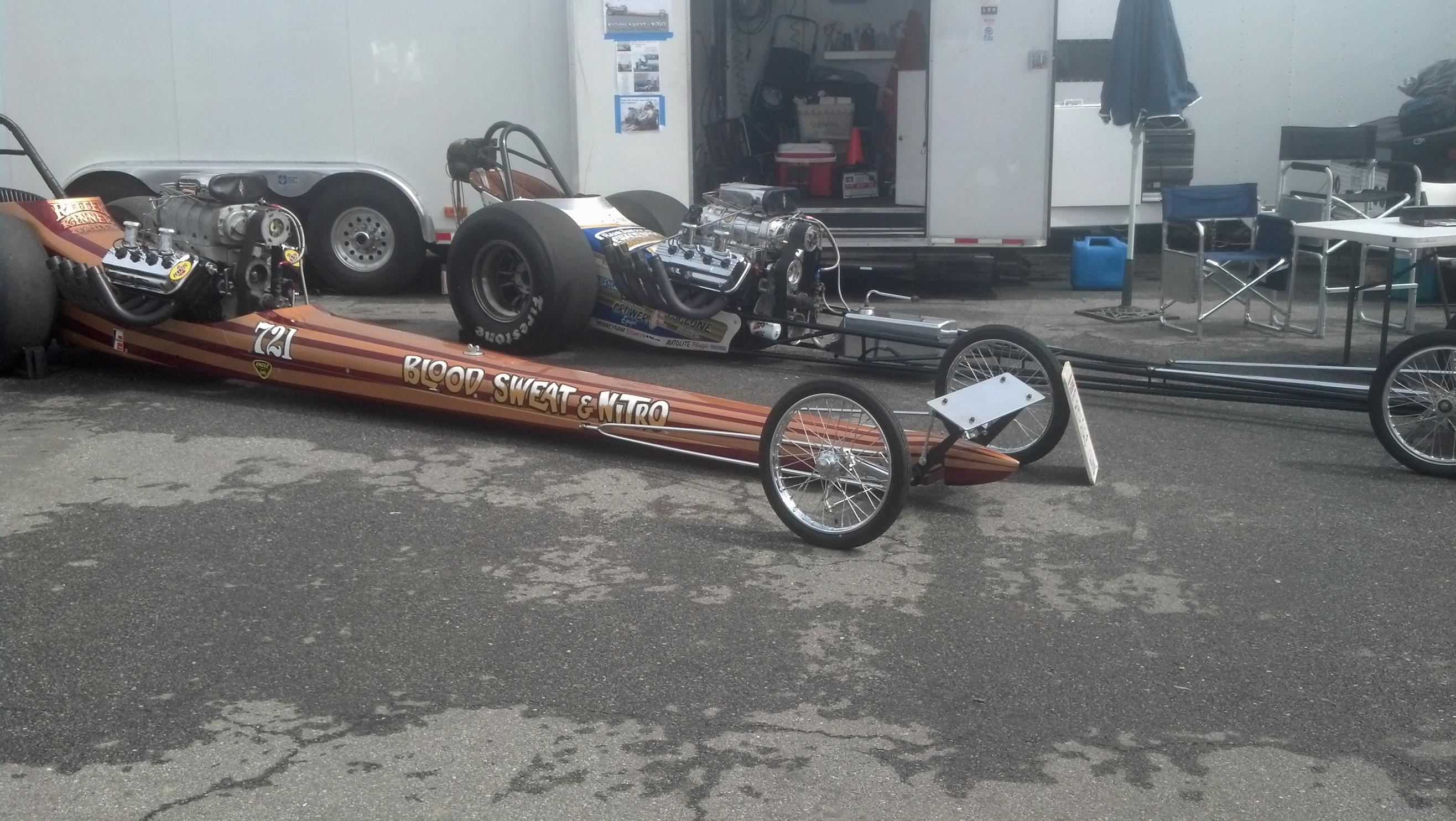

    I took a break from the car to drive 1120 miles, one way, in one day to the March Meet with my good buddies. What a neat experience. Lots of neat cars and more vintage diggers and door slammers than I have ever seen.

    Here is a couple shots from the Big Show.
