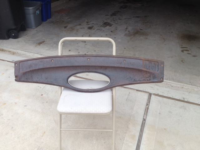

    If you've been following this thread or peeking in on Instagram, you'll know that I've agonized over my dash layout for months. I have a dash-disorder to say the least. After buying and selling a number of different clusters and wasting 2 different sheets of 1/4" plywood for mockups - I stumbled across this '32 pickup dash my new buddy (and virtual next-door neighbor @dwest999) had leftover from a former project;
    Measurements were taken, a deal was struck, and the dash came home with me. After some study and careful measuring, I whittled away at the T dash, leaving only the mounting flange and the surrounding 1" of metal. The stock T dash rolls 'in' (toward the firewall) across the top at a slightly tighter radius - and altogether different arc than the '32...leaving this section intact seemed to make the most sense and would allow for an easier transition to the bottom half of the '32 dash.
    What remained of the T dash was clamped to the top of the '32 panel and a preliminary cut line was scribed into the latter. Then the ultimate apostasy - the '32 dash was cut, Lord forgive me! Complimenting sections were clamped together and mounted in the car;
    While not a bad fit, the '32 dash is quite a bit 'shapelier' than the original (flat) T unit. Not only is it concave along the vertical axis, it's also concave along its width (horizontal axis). A relief cut or two along the bottom edge and a few hours of hammer & dolly work got her pretty close;

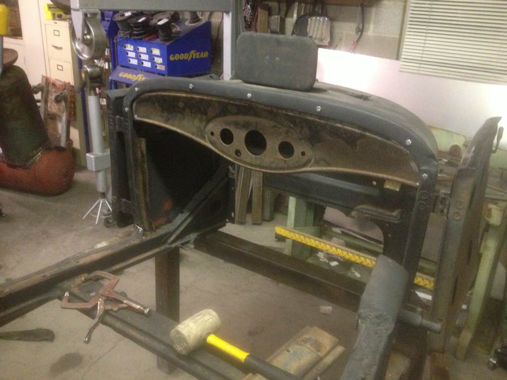

    [​IMG] [​IMG]
    Still have a few high & low spots to even out before welding, but not bad for my first 'real' metalworking project. Here's what it looks like bolted into the car...I think the curves really work with the shape of the T tub;
    Now I just gotta find a 2 3/8" back-mount SW ammeter & temp gauge and an Auburn speedo to go with! Will probably make an under-dash panel for the hand pump and fuel pressure gauge.
