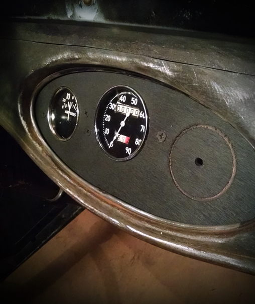

    Still waiting on some ch***is parts (some in transit, others I need to make a day trip or two to pick up) - once those are in-hand, I'll get the suspension installed and fab up my body mounts. Then it will all get blown apart, blasted, refurbished, and painted. Until then, I'm busying myself with little projects - restoring/refinishing my '37 banjo steering wheel, finalizing instrumentation, and building a proper seat pan. This is going to take forever, but I'm really enjoying the journey!
    My OCD over the dash has continued...I managed to dig out a grubby '32 Speedo and scored a 2 3/8" back-mount SW ammeter (date coded April 1944).
    The ammeter is NOS - no signs of use/mounting and the face & gl*** are perfect! As with most wartime SW offerings, the bezel was painted black, but years of 'shelf wear' reduced it to a scuffed and chipped up mess. After careful dis***embly the paint was stripped, revealing a VERY thin nickel plating over br***. Not crazy about the color difference between it and the chrome speedo bezel, but I can live with it.
    Now I gotta find a matching temp gauge!

  11. gwhite
    Joined: Sep 1, 2007
    Posts: 3,136
    gwhite
    SUPER MODERATOR
    Spent some time this evening with some graph paper and some old fashioned drafting gear making a template for the instrument support panel (I'm not using a '32 dash tunnel). A s**** of plywood and a hole saw gives the gist of it;

    Found an SW temp gauge! Postman should be delivering it toward the end of the week!! Funny thing is that it's an EXACT match to the ammeter - same black bezel, br*** case, and funky mounting bracket. Even has the same "20 22" inspectors stamps - unfortunately the date code is illegible, so I'm ***uming it was probably manufactured at approximately the same time. Supposedly it's NOS and functions perfectly. Only downside is that the capillary tube is ridiculously long. Oh well - guess that just gives more flexibility to route it cleanly and place the probe exactly where I want it.

    And here's the final mockup; time to tear it apart, do a little finish work on the metal, weld 'er up, and engine turn some aluminum for the gauge panel. The matching 2 3/8 temp gauge should be arriving mañana (it'll go to the right of the speedo).

    Thanks guys! The postman dropped off the last remaining bits to complete the instrument panel; a nice, freshly serviced '32 SW speedo and a SW temp gauge (matches the ammeter perfectly)!
