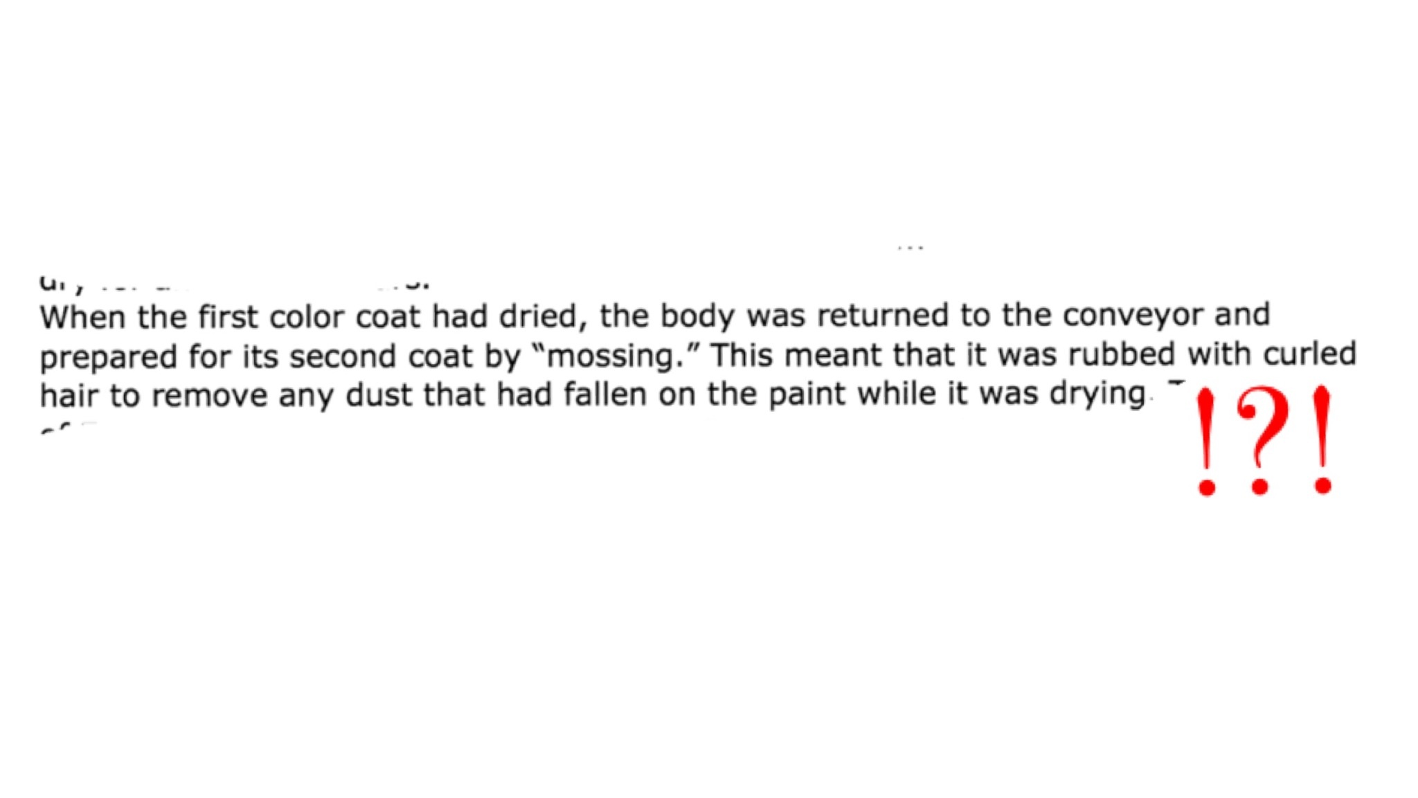

    Maybe totally off the grid for this thread.I found this tidbit on Fords Painting techniques and theory.
    Some reading is needed, but a bunch of very interesting insight.
    http://www.mtfca.com/discus/messages/118802/126638.html

    Thanks for the link, Jeff. Was a fun read w my Cheerios.. it helped me identify exactly when my body was built. An "improved" 1925. Woohoo. The article also provided some chuckles. Short and curly hair? Interesting that there was a form of clear coating going on back then. In our metal fab shop we used to use a 50/50 blend of Penetrol and denatured alcohol over gun blued, sanded of flat painted projects. Slow drying but gave it a nice depth without looking too plasticy. Brushed on then wiped off as it started to tack up. Looks great on old stuff (like pitted paint) and provides a little water proofing. image.jpg
    Jeff Norwell likes this.
