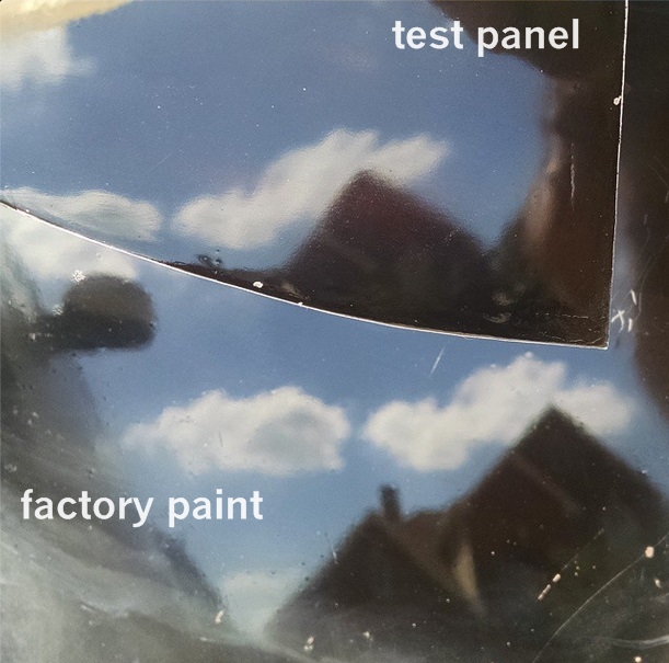

    Still trying to figure out how to reduce the gloss with this asphaltum paint (to match Henry's frame coating).
    This photo shows the original semi-gloss 'sheen' - brackets would have been higher gloss (dipped in enamel), while the radius rods were sprayed with pyroxylin;
    I also reformulated my concoction somewhat and got a better match to Henry's T-era paint (cut the Japan drier by a tsp). Don't think it's possible to get closer than this...may end up painting the body with this stuff :). Will leave my test panel out in the elements for a few weeks to see how quickly it chalks/oxidizes.

    You might be able to hit it with a de-gloss agent after it's dry? I saw some at lowes by the quart.

    I wonder if adding some talc to the mixture would take away some of the gloss?

    Gary i have had good results making non catalyzed paint look "old" by using rubbing compound on a rag by hand while the paint is not all the way cured. it smooths it out but alters the "flowed out shine".

    Thanks fellas, I'll try each of those suggestions. Perhaps using decent spray equipment will help as well...I can mist the last coat on so that it's nearly dry as it hits the surface - that usually gives a nice semi-gloss tone.

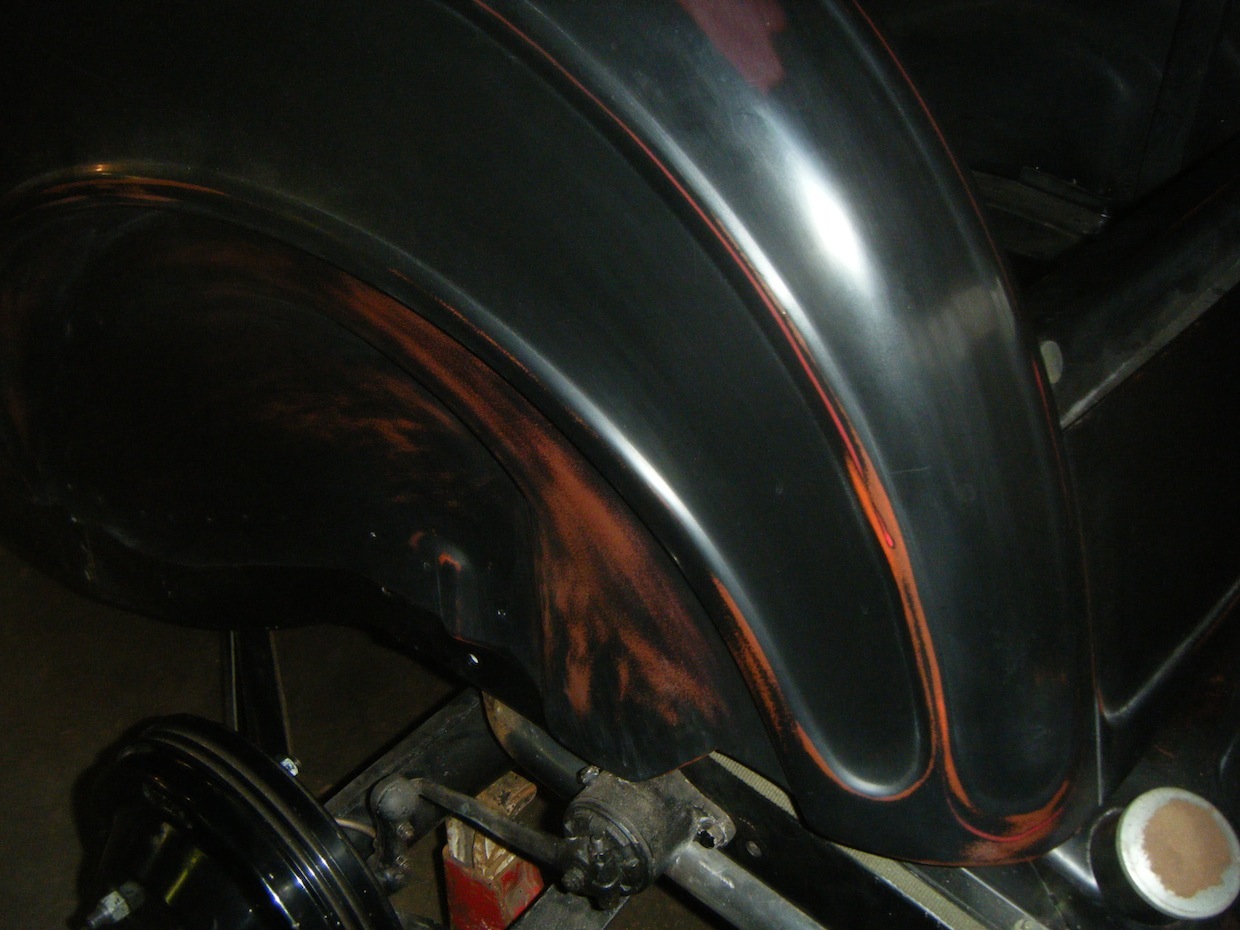

    I used Comet powder on a wet rag, but mine is laquer paint. It looks and feels exactly what I had in my mind.

    Try spraying Eastwood Pre on a rag and wiping it lightly until you knock down the sheen.

    I don't really see the problem. It will dull with time. That factory paint Is 80+ years old. It's bound to have lost some sheen.
