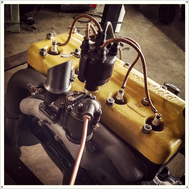

    Great build, very cool thread. Looking at your fuel pipe, could it be that there is too much tube on the far side of the ferrule? I've seen that prevent Yor and Swagelok fittings from sealing as the tube bottoms out in the female fitting before the ferrule fully seats? just a thought.
  2. gwhite
    Joined: Sep 1, 2007
    Posts: 3,136
    gwhite
    SUPER MODERATOR
    Thanks! Yeah, that fitting is altogether wrong (it's a -5AN); doesn't thread in far enough to compress the ferrule onto the tubing, so that's why it looks the way it does...ferrule just slides up & down the tube.

    Nope, I was able to get a correct "Ford nut" (1/2-20 inverted flare fuel fitting) and ferrule from Jerry Grayson...to make a long story short, the ferrule and fitting didn't work either. Upon further examination, the inlet casting was worn or 'wallowed' out too much for the ferrule to compress to the fuel line and seal effectively - the ferrule would get stuck in the inlet casting before it would compress to the line. Solution; leave the ferrule stuck in the casting, flare (*45) the fuel line, and re-tighten the fitting.
    Works perfectly now - tested up to 10 psi without leaks. Looks like I'm good to go. Hope to get the motor test-run in the next week or so. Video to follow;

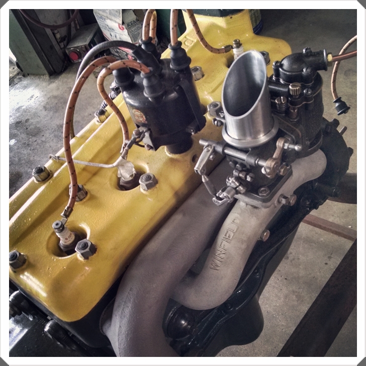

    In the meantime, I made a new carb stack and am trying to finish up the polish job - just lack the underside of the back 'leg' and a little finish work here & there.

  14. gwhite
    Joined: Sep 1, 2007
    Posts: 3,136
    gwhite
    SUPER MODERATOR
    Thanks Johnny! I originally polished it up thinking that I'd use it with an adapter and a chromed-out Stromberg as a back up in case I couldn't get the Winfield working right - still might end up doing that.
    The idea for the stack came from this 1937 shot of Pat Campea...I had my local muffler shop put a 2" flare on a section of 1 3/4" exhaust tubing. Then I cut it & polished the steel. Not sure if I'm going to keep it (if I do, I'll have it chromed) or if I'm going to make another one - maybe 'frog mouth' style.
