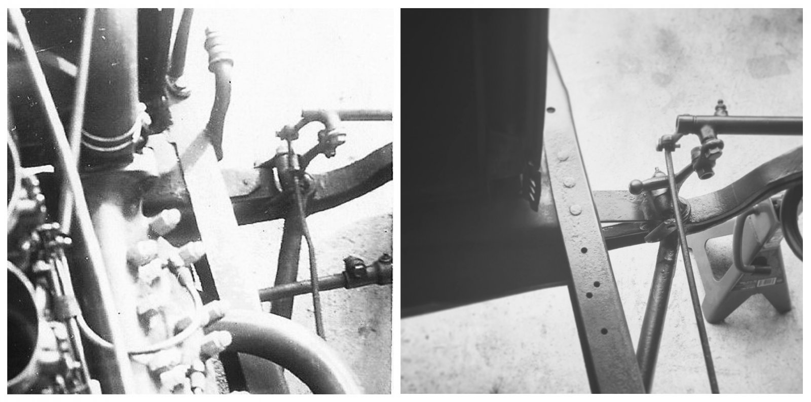

    Here's a shot of the Dago axle & mechanical brake setup (I'm using '39 Ford shackle plates I got from my pal @Rainier****** as spacers to align the 32-4 brake actuators);
    A (circa 1946-7) shot of the Wilmer McNatt roadster front suspension and my mockup...need to remove the shock mount on the spring perches for brake clearance and heat & bend the steering arm for clearance, but it's virtually identical!

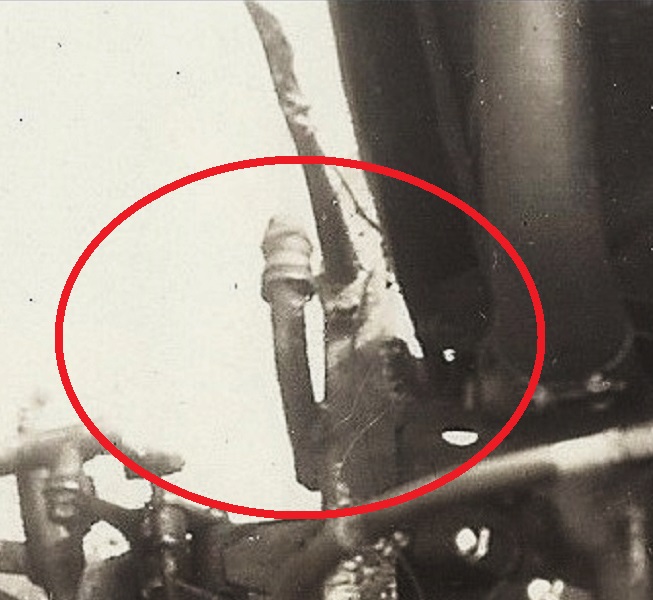

    Lookin' Good Gary. Just a suggestion on those mechanical shackle plates that are spacers off the top of your 32-34 perches for your brake actuators.
    You may want to gusset the side of those against the perch so that they bolts can't wiggle loose, the plates roll inward and pull the actuators out of the kingpin cup. That would be a mess going down the road to suddenly have no brakes.
    Here is a picture and you can see the little triangular gusset I did on the side.
    gwhite likes this.

    Good stuff, I think I'm going to tack weld the plate to the perch in addition to the bolt & lock washer.

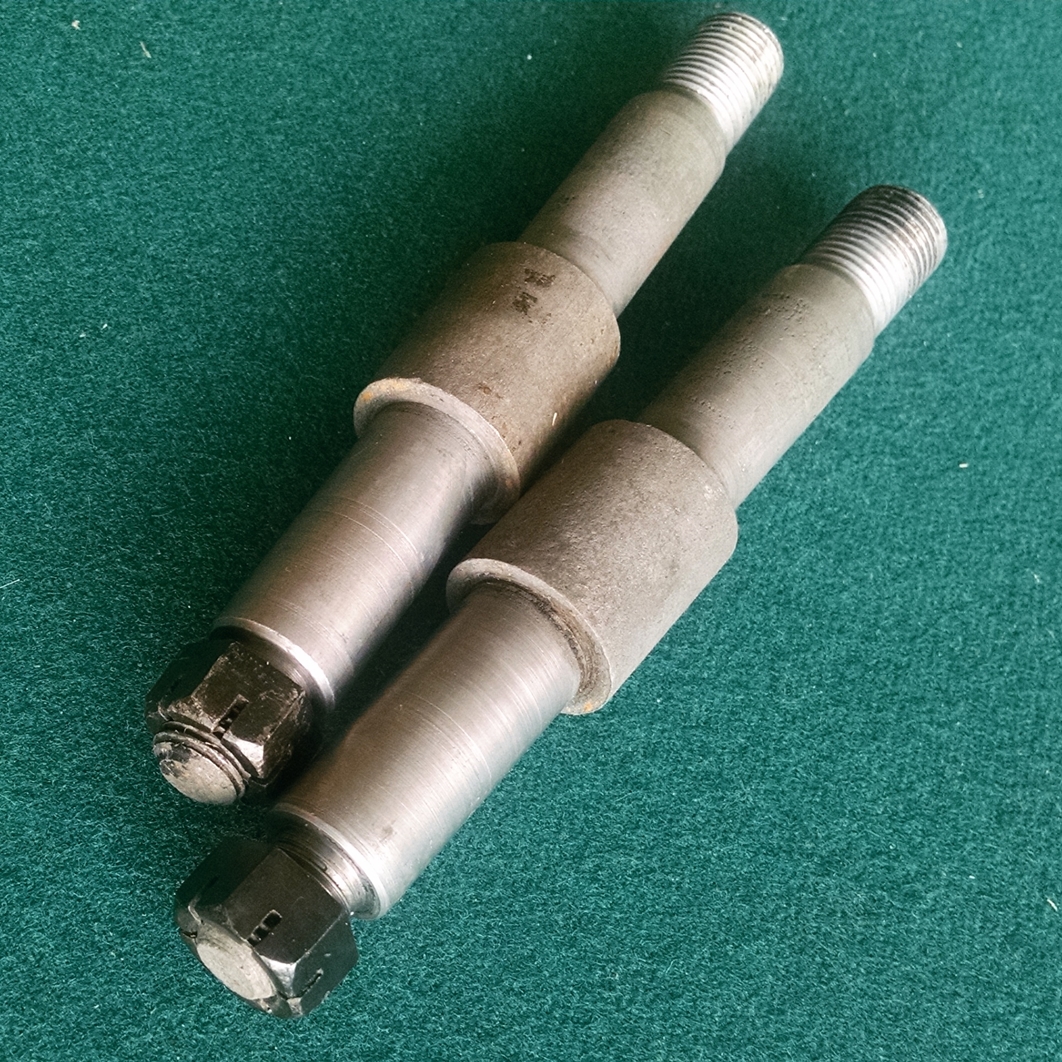

    For the 2 other detail nerds out there, I finally figured out the best way to mount the shocks with the help of vintage photos and parts from @FLAT-TOP BOB (Owens Salvage in Wellington, TX) and the folks at Moore's Auto Salvage up in Rapid City, SD.
    Bob supplied me with a nice set of 39-50 Plymouth/Dodge upper shock mounts that will be trimmed (about 1/4" past the big part of the body) and welded to the axle at the perch boss. These mounts are perfect, as they space the shock out just far enough to allow the shock body & dust cover to clear the grease fittings on the shackles.
    The crew at Moore's found me a nice set of 37-8 Plymouth front upper shock mounts that I'll trim & bolt/weld to the frame as shown throughout @woodiemike's thread (pics attached below). These upper mounts are an inch and a half or so shorter than the later F1 units and appear to have been the "go-to" pieces in the mid-late 40's

    I did not know about those Plymouth shock brackets, thanks!

    No sweat! I started noticing brackets that looked a lot like the F1 units in Don Montgomery's books, but dated 1946 & 47...a little too early to be F1's. Then Mike posted his pictures on the "Lakes P.R.C." thread and there were more from the same period. About a month ago, I came across a 1937 Plymouth promotional video and saw the mounts...they can be seen at the 5:57 mark and again in more detail at about 8:18;

  28. Those are the same shock mounts as what I have on my roadster. The later Mopar mounts don't have the thin lower bolt boss, they are thicker around the bottom mount boss. I will get a photo later.
