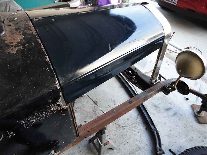

    Work on the Hardscrabble Hop-Up has been small & incremental...
    Did some measuring for my windshield chop...somewhere around 3 1/2" feels right (see bottom of tape line).
    Got a decent 28-29 Fordor hood, removed the side panels and did a little 'hand fitting'. Still need to do a little more, but you get the idea. Wasn't sure if I'd like the bead (specific to Fordors), but it's growing on me.
    Apologies for the horribly messy garage.

    Are you gonna remove the bead? I would recommend it or pehaps locating an open car hood....as those tend to fit the '26-'27 bodies better. I believe the hood you have located is from a Briggs bodied fordor sedan on account of the rib.
    The open car hoods and I believe the Murry body cars don't have the rib.
    Just a thought... :D

    I had read that the Fordor hoods are dimensionally different than those off open car/coupe/commercial/Tudors, but I'm not seeing it...I have a beat up rusty hood (half) off a coupe and they're identical as far as I can tell except for the bead. The rear portion of the hood fit the cowl almost perfectly...the front just needed a bit of adjustment.
    I'm actually kind of liking the bead at the moment, but I may take the hood (with side panels) up to Chickasha next month to see if anyone wants to swap.

    Couple more hood pics;
    There's a little crease in the cowl right where the bottom of the hood top fits up (it's the bare spot); at certain angles it makes the hood fit appear sloppy. Should look good when the dent is removed.
