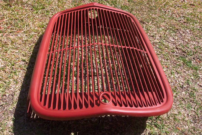

    The long hours of sitting and staring brought me to the conclusion that the T shell I have is just not nice enough to go with. A little wheelin' & dealin' and I brought home this (32 commercial shell)...couldn't p*** it up.
    Damn-near perfect - almost nice enough for chrome plating :D

    I like the looks of the T grille too, but mine is way too junky.
    I'll need to cut down the '32 shell about 4 1/2" or so to get the right look.

    Love the commercial shell! I have one getting painted for my '26 right now. I think I spent 10 hours beating mine back into shape and welding in missing bars and bottom sections, I only wish mine was as nice as yours is!
    I notched mine to fit down lower over the crossmember like your second pic (I think the odd headlight bar is throwing off the look of that particular car).
    I love the look. I know they're kind of a victim of their own popularity but they're popular for a reason, damnit! 32 shell says hot rod. I bought a '34 commercial stainless trim to go in mine from Drake and I cut up a 30-31 cowl band to go over the windlace channel on the back side for a little extra flash, I like it that way.

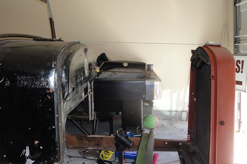

    Sorta mocked up. I already have a '32 "B" radiator, so I mounted it up then carefully jacked the body up 'til it looked right. 4 3/8" seems to be the magic number.

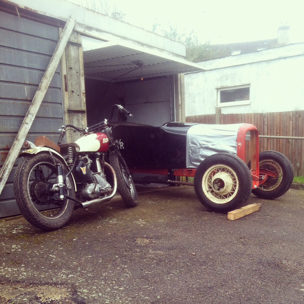

    T - 32 grill shell - just makes sense to me, same way im going with my roadster with a big Connie Weidell theme, what length hood are you gonna run, i've measured mine out to 26" and it'll look just right, not a fan of the lengthened look of a T on Stock A rails

  21. As I PM'd you the Tourer is around 770mm lip to lip - 765 bonnet length. Going to try and get the Coupe to the same if I can.

    we measured mine up and with the "26 hood length the wheelbase will be 100" so stock T, i'm building mine front first then gonna make the rear axle fit the body as i want the tight front look.

  29. Equipped28
    Joined: Mar 30, 2007
    Posts: 619
    Equipped28

    Nice! How much did you drop your grille shell?
