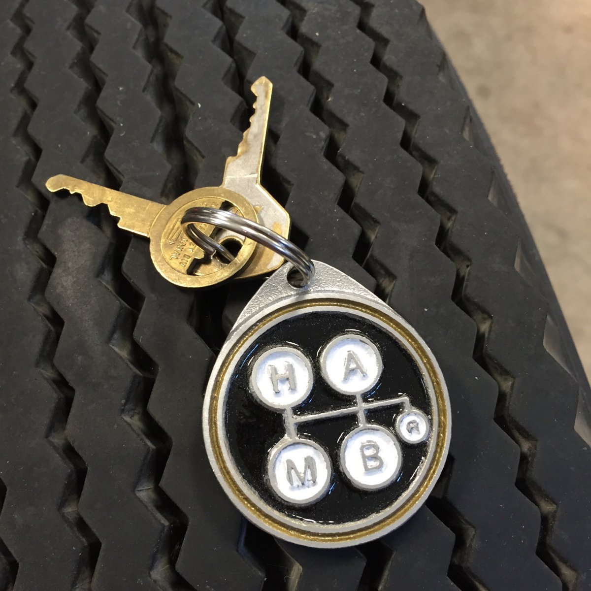

  15. Well, I managed to get the carb adjusted so now it doesn't die off idle so that's a plus, ha! I took her around the block and onto the highway near the ranch and got her up to about 70mph. The OD seems to work and she goes down the road straight so that's good. I dolled up a keychain for her. I try to keep them color coded for easy identification...:)
    Needs a little touch up work :oops: but you get the idea!

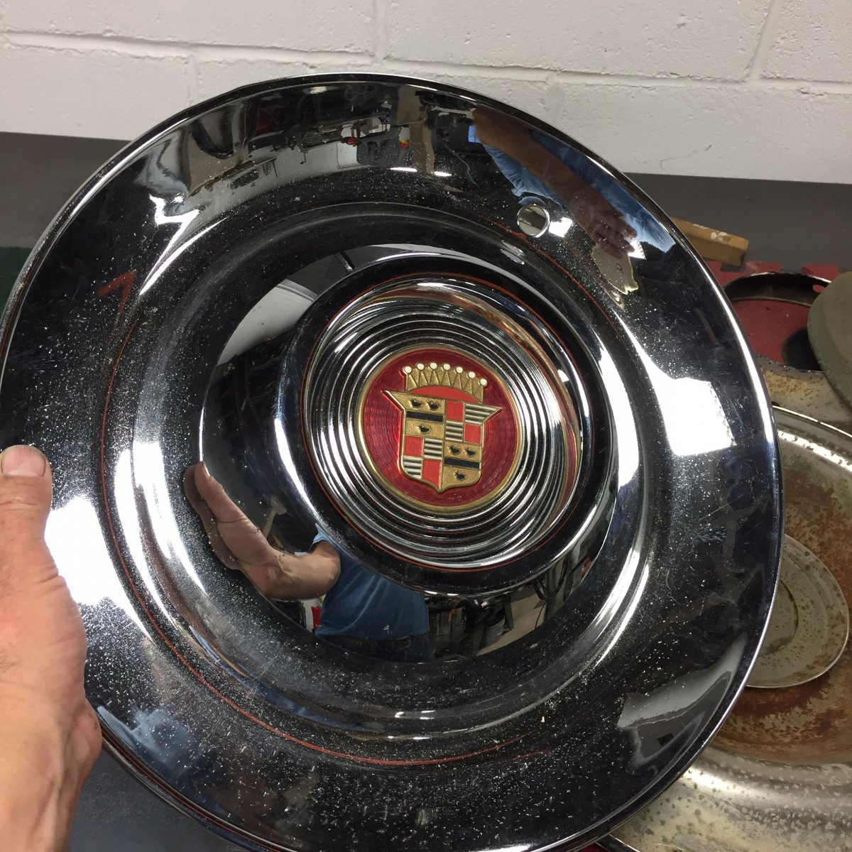

  29. I'm not sure? I have a nice set of Caddy Sombreros I had planned on adapting but the merc wheels are too shallow and they wouldn't let the caps sit flush. Plus, they are so big that they covered the gold on the rim. image.jpg
