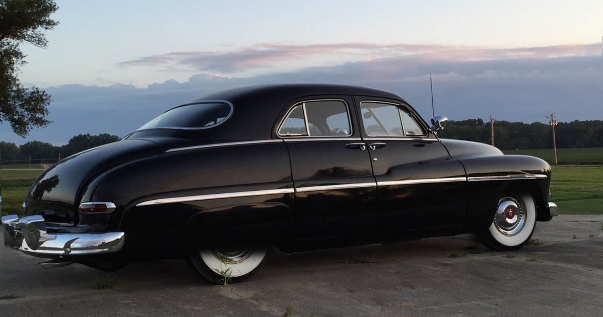

  12. Here is another small update on the old merc. I was having trouble keeping the Lincoln caps on even just riding around the block. I did a little fussing with them but still not working so I grabbed this set of Packard covers that popped up on the Hamb for sale. [​IMG]
    They have a bit of a nautical theme which reminds me of my wife as she has always fancied herself a bit of a salty sea dog since we met! She digs the caps a lot.
    Another milestone is that she is finally transferred over and tagged for the road. Whoop whoop!
    Since it's finally leagal I decided to run my Saturday errands in the old girl and well that didn't go so well :oops:. She didn't want to start after getting gas. It's 6v still and turning over slowly when hot. I think I have a combination heat soak/ vapor lock condition as the battery seems to be up to snuff when checked out.
    Also, that damn clicky OD cable is annoying. I took a little slack out of the cable but it has not cured the condition. Any ideas or suggestions are welcomed!
    I did manage to grab this shot down the road though.

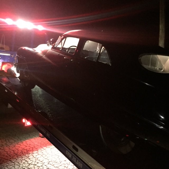

  18. I'm still chasing problems here and there. I've been trying to at least start her every couple of weeks which seems to be going well. I had to replace a couple of fuel lines as it was ****ing air and losing prime.
    I was hoping to drive it to the hamb drags last weekend but it kind of snuck up on me so that didn't happen. I didn't want to take the chance on being the one who screwed up the trip, ha! Good thing too because I took it out for a drive tonight and came home on the tow truck :oops:.
    I don't think it's charging. I got it jumped but then couldn't get it in reverse to get out of the spot that I was in.
    It's still making that clicking noise and frankly I'm at a loss as to what it could be? I did discover tonight that it goes away when I depress the clutch (at speed) and will return when I let it back out. I'm convinced it has something to do with the OD still but I don't know anything about them. If anyone has any insights please speak up! I may start a dedicated thread to that effect. image.jpeg

    "It's still making that clicking noise and frankly I'm at a loss as to what it could be? I did discover tonight that it goes away when I depress the clutch (at speed) and will return when I let it back out."
    -Sounds like a T/O bearing to me...
