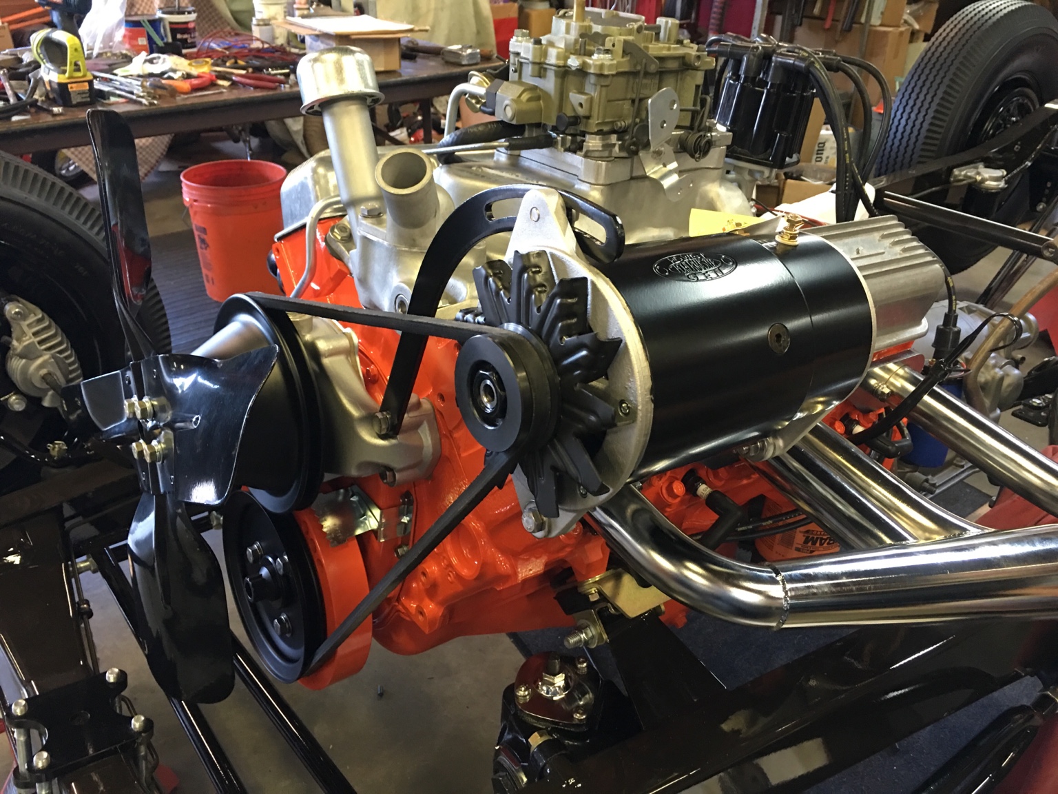

  29. HelmuthBrothers
    Joined: Oct 11, 2007
    Posts: 791
    HelmuthBrothers
    from New Jersey
    Huge day for us today. Got the motor started for the first time. Absolutely in love with the sound of this engine. Only thing we really did to this engine was add the comp cam, weiand intake, and Geardrive headers. It sounds like there's a lot more done to this motor while listening to it run in person than there really is. I was trying to run a small denso alternator down next to the fuel pump. We made the correct brackets for it and looked great, but I couldn't keep the belt from hitting lower radiator hose where it connected to the water pump without spacing out the crankshaft and water pump pulleys. So I bit the bullet and bought a powergen and used a stock gm generator bracket that mounts off of the header bolts. Got the bracket and belt off of an old 57 Chevy wagon we used to have and it worked perfect. I ended up buying some delco remy tags to put on the powergen to backdate it a little more. All in all I'm glad we went this route instead of the denso alt. Really ties together the original SBC look I'm trying to pull off. Here are a few pics of the engine and hopefully a video of the engine running. Still needs to be tuned and timed a little more but it sure sounds good.
  30. BLACKPRIMERFAN
    Joined: Oct 4, 2009
    Posts: 114
    BLACKPRIMERFAN
    from OH/MI LINE
    Sounds good! Is that with baffles or without?
