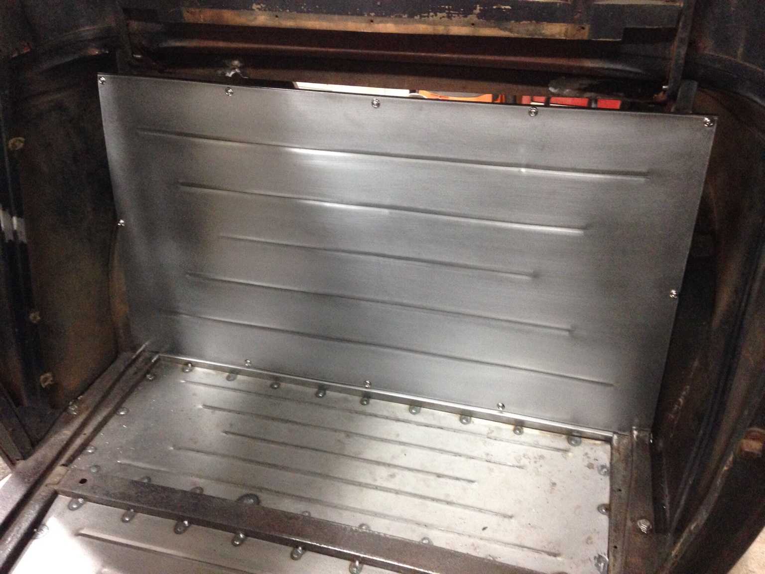

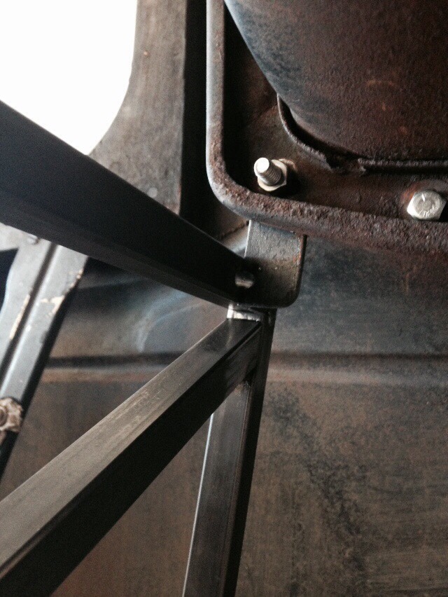

    Yeah that brace is used to stiffen the body, mount the rear side of the gas tank, and split the trunk from the interior. I have a metal cover for the brace that we'll be insulating.

    Cool I like what you have done. Mine is the same basic idea. I built a solid frame that the tank is bolted to then I welded tabs to that frame where the bulkhead attaches to. I used wood so I could shape it easily as a tight fit to the body contour sealing the cab from the trunk. Using rubber seal on the edge of the wood where it meets the body. It's one thing I really like is seeing different approaches to the same task. Great way to get ideas! [​IMG][​IMG][​IMG]

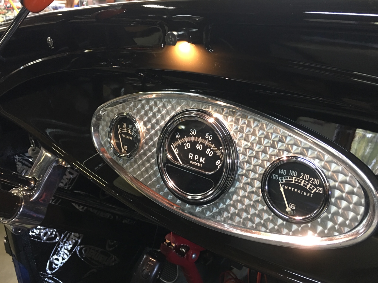

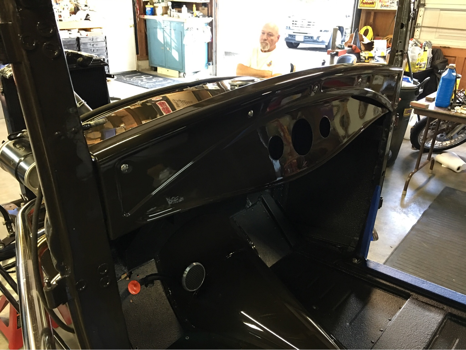

    Boring updates. Little by little just knocking away at it. Cowl, dash, gauges, and steering all done.

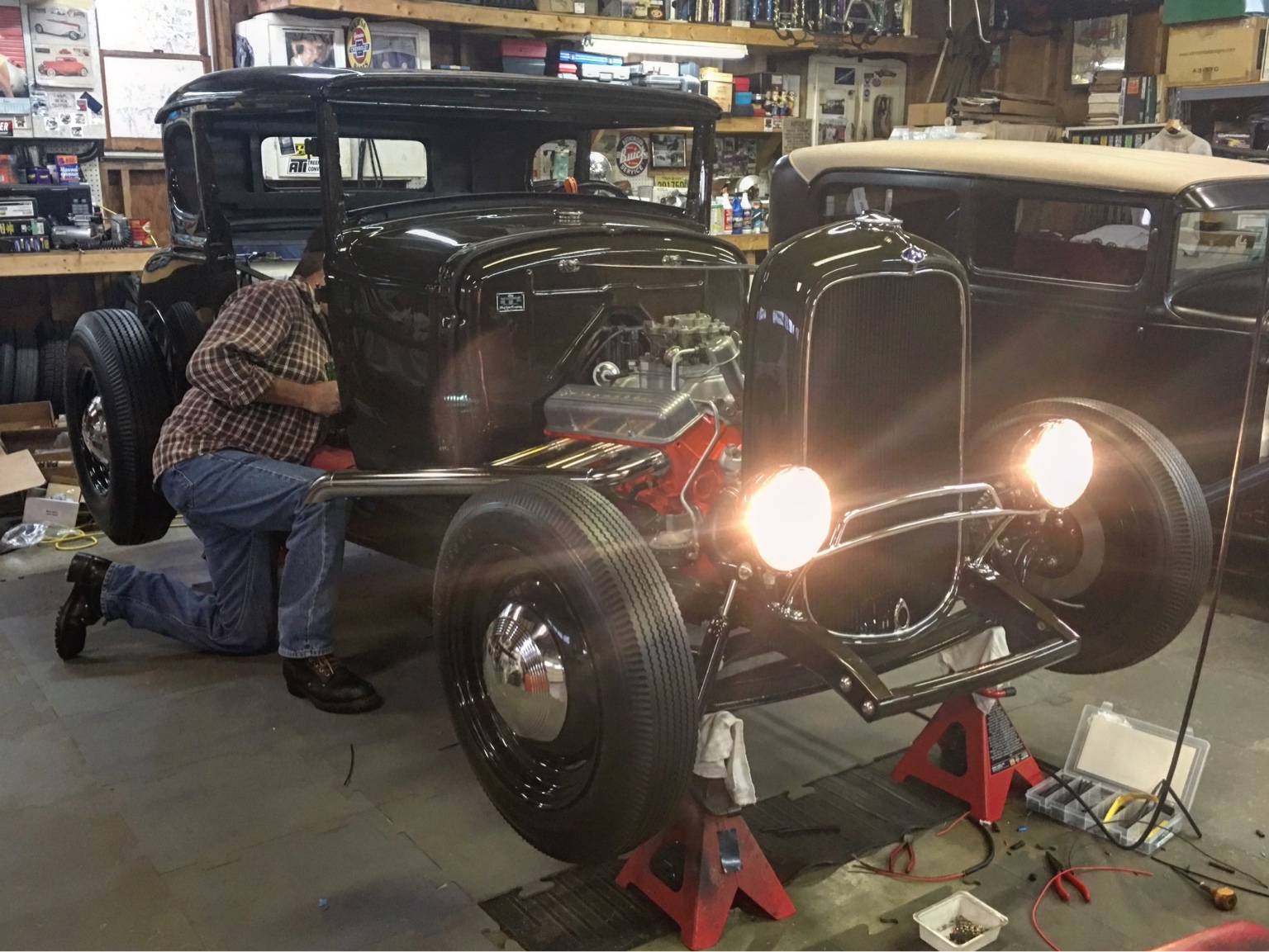

    Great day today. Put the face on, headlights and headlight bar, radiator rods, cowl and grille lacing, and some other small things like the battery box and trans dipstick. I painted the vintique insert gloss black this week. After about two hours of taping and another hour or so painting it came out great.

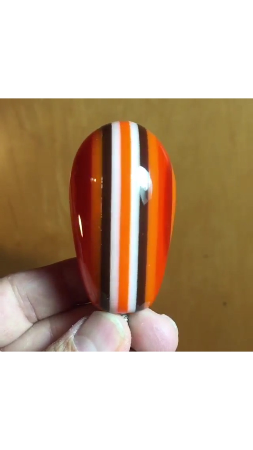

    Nothing crazy but we're about the start wiring this weekend coming up. Lot of small stuff out of the way. Most not even picture worthy, but ran all the wiring from the battery to the starter and killswitch. Started to dynomat, mounted my new shiftknob courtesy of @44tooth on instagram, riveted the headlight / firewall / delcoremy gen tags, and since I have no gauge lights I decided to use a motorcycle license plate bolt light to replace the center bolt in the dash rail. Also mounted up the Ron Francis Bare Bonz fuse panel behind the dash, and mounted the ignition / headlight / turn signal panel. The turn signal is a Ron Francis 3 position toggle switch.
