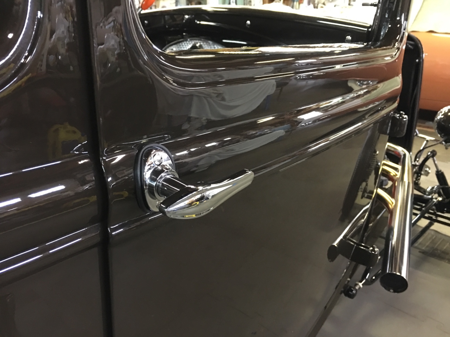

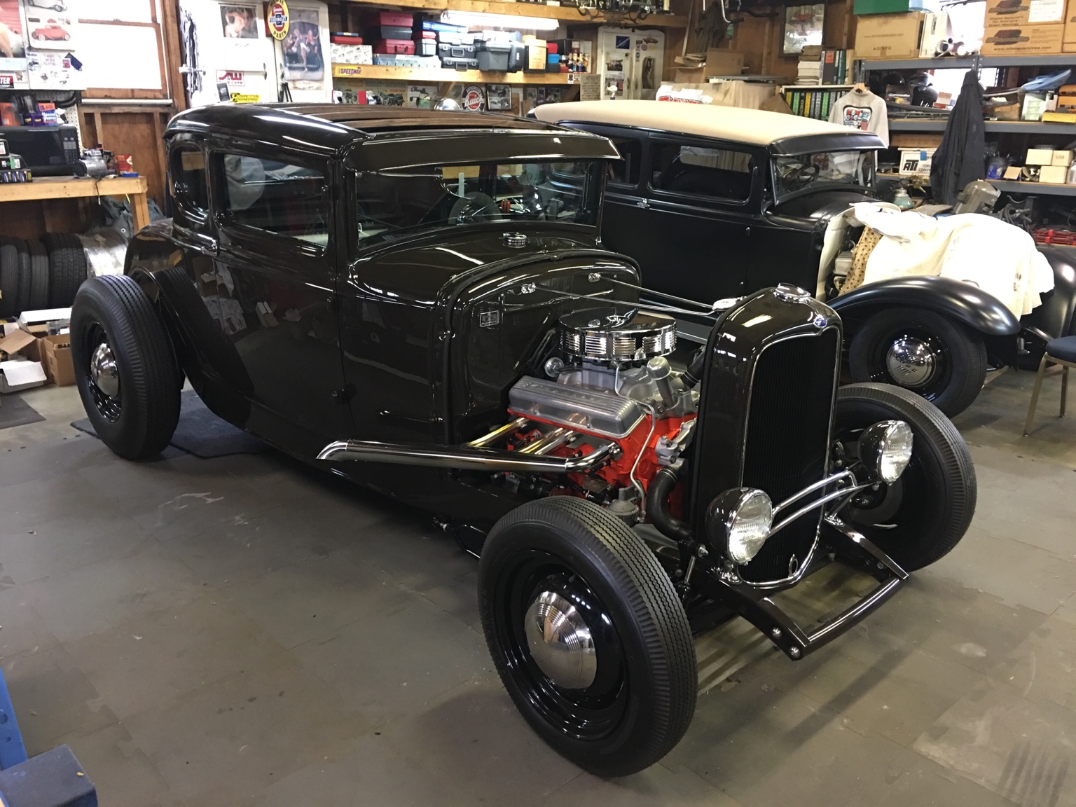

    Got both doors on today. Let it down on the ground to start adjusting the latches and striker plates. Really happy with the gaps. Just need to adjust the new rubber door bumpers to get a nice and even fit. Doesn't look like a damn jeep anymore lol.

    Today we finished the door latches, handles, and gl*** templates. We had to send the quadrajet back to the guy who sold it to me for repairs and got that back yesterday as well. Doors fit great, gl*** templates are good to send out, and the engine runs great now.

    While we're waiting for the gl*** shop to cut the gl*** we are tinkering with stuff. Back of the car settled way too low so we stuck another leaf in the rear buggy spring. I was also able to finally "drive" the car. In and out of the garage at least just to set the idle a little better. All that's left is to install the gl*** and the seat. Then it's going back home.

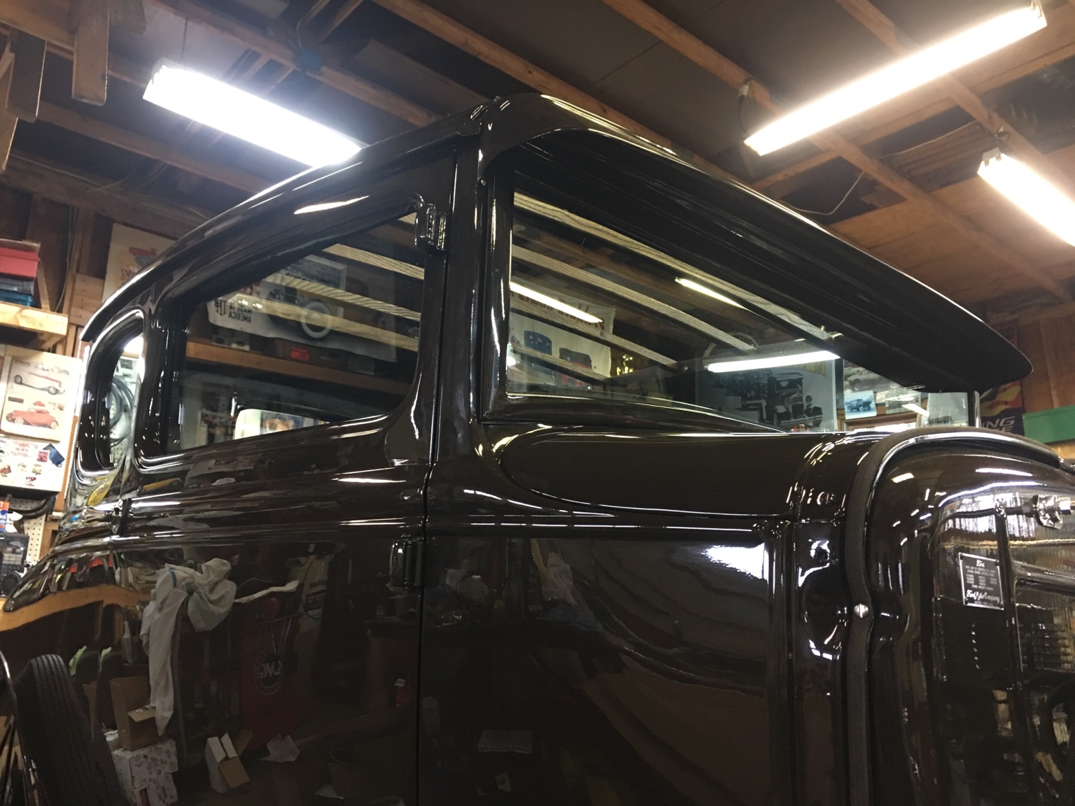

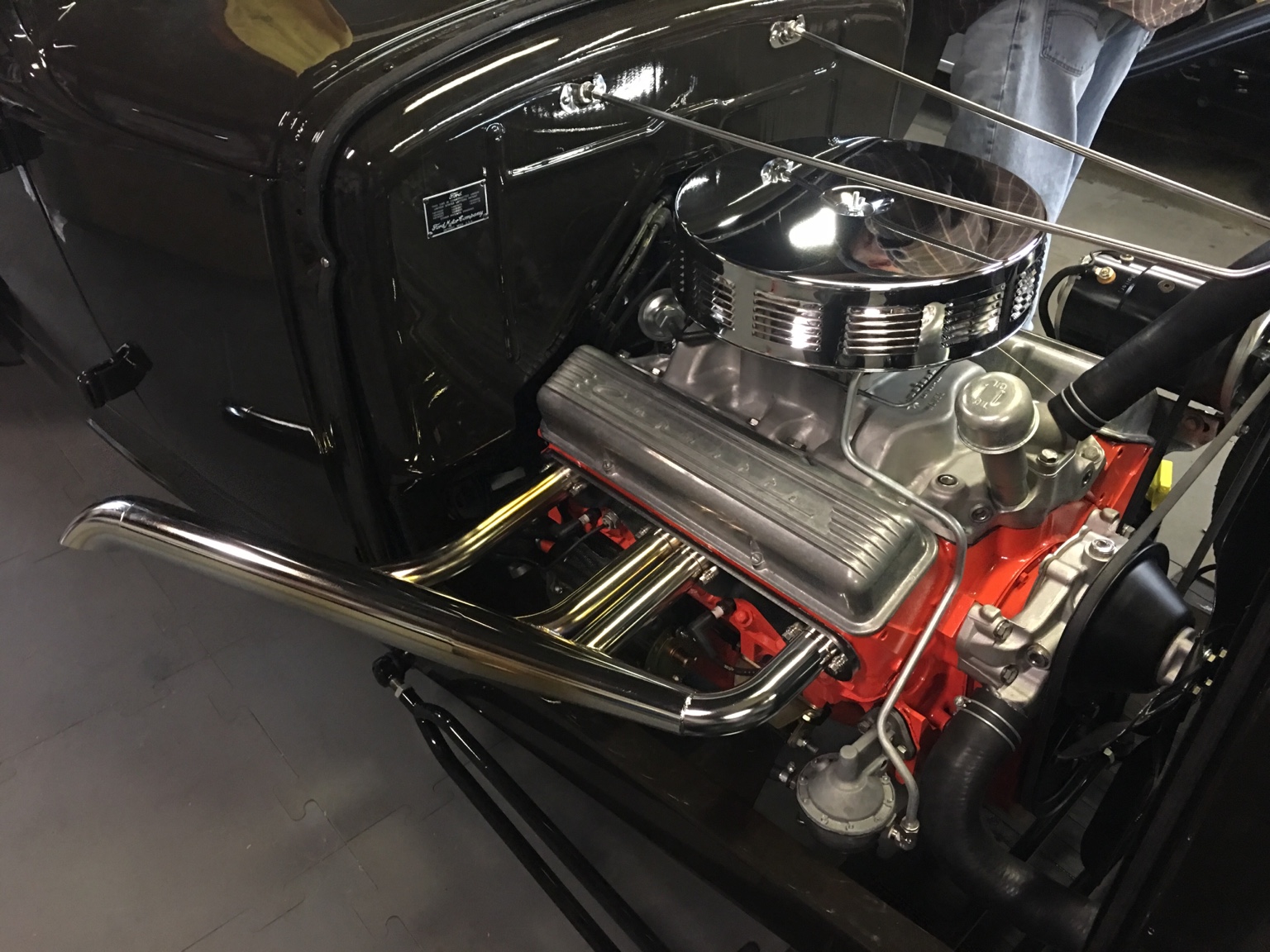

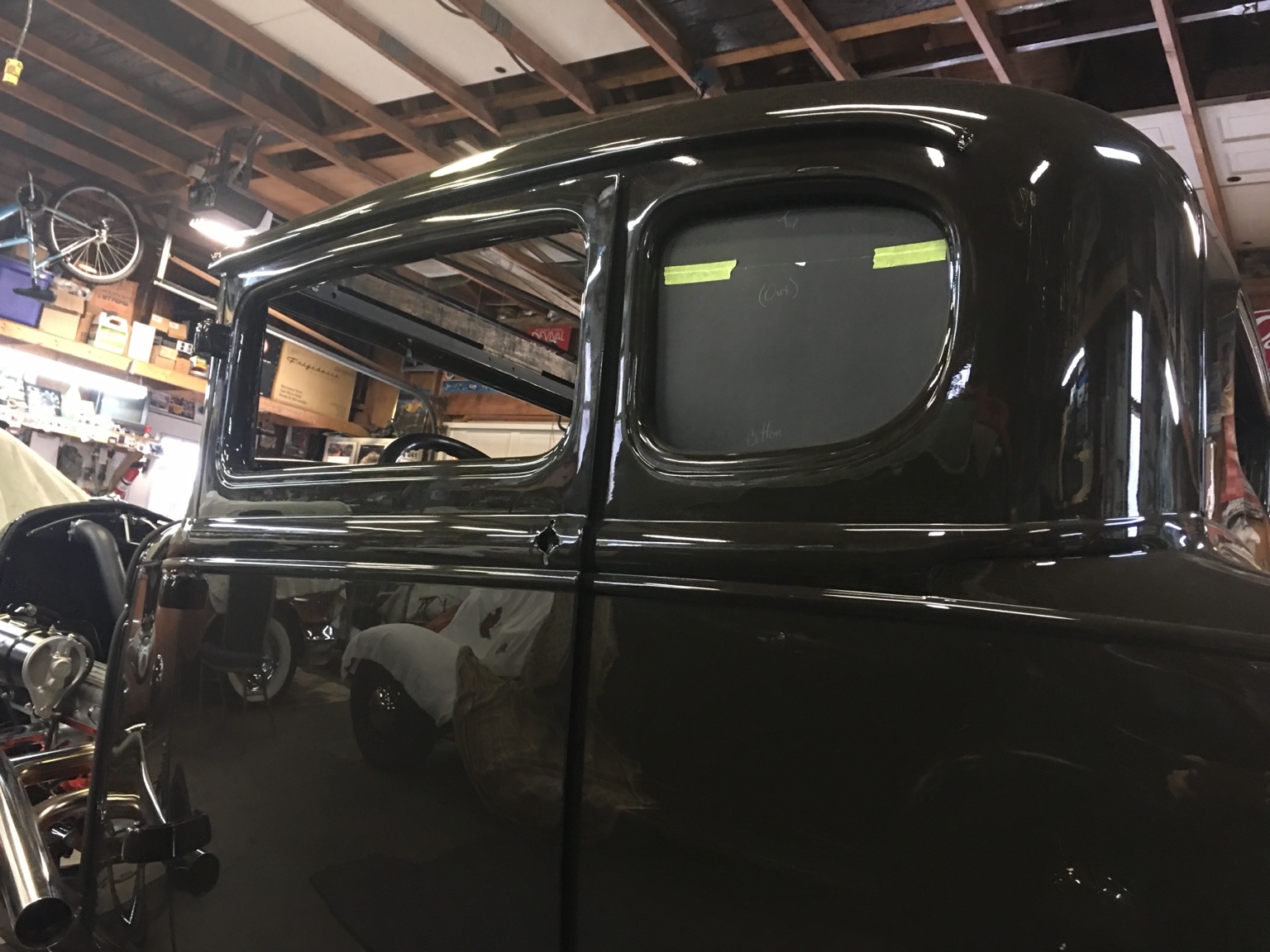

    We started installing the gl*** this weekend but I didn't snap any pics yet. We also finally figured out the air cleaner situation. I tried an original 58 corvette 4bbl air cleaner and since I have a Qjet on top of an adapter plate the air cleaner looked like a top hat. So I found a corvette "style" air cleaner that's 3.5" tall instead of 2" and uses a drop base so it covers the whole carb. Pretty happy with it. Here's a photo of the windshield gl*** installed. Most nerve wrecking project ever. I'm using a factory GM green tinted gl*** too. I think it looks great against the brown paint. I was worried it would add too many colors but it's so subtle it's not screaming green.

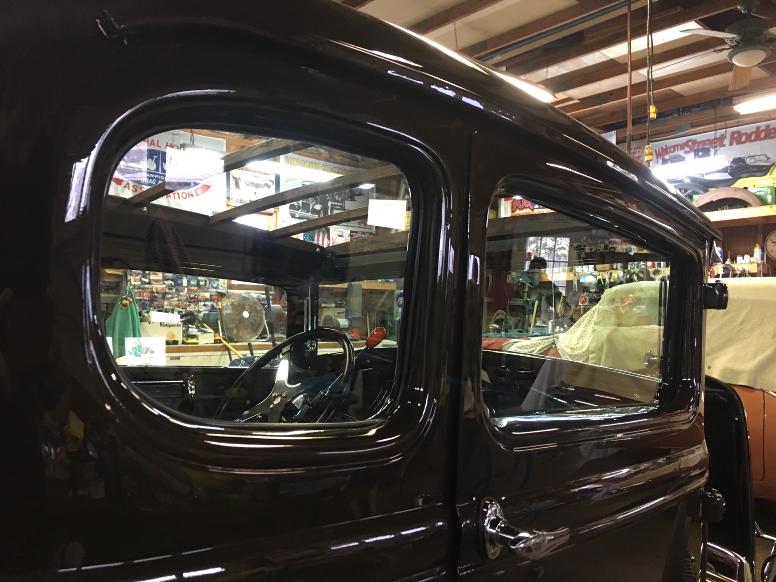

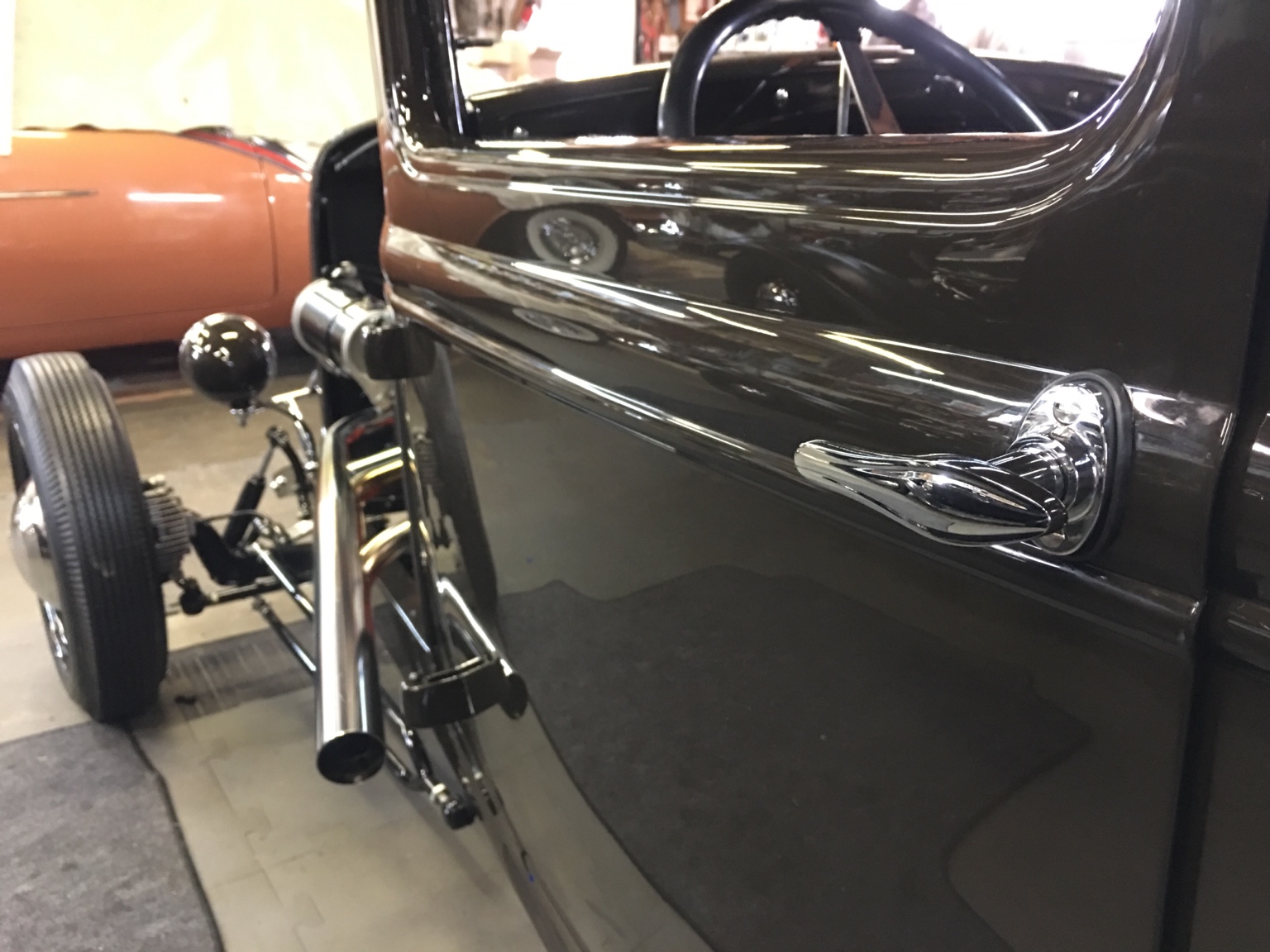

    Thanks it's actually an ididit 1.5" hot rod column with the limeworks 3 speed style shifter and limeworks 32 style column drop.

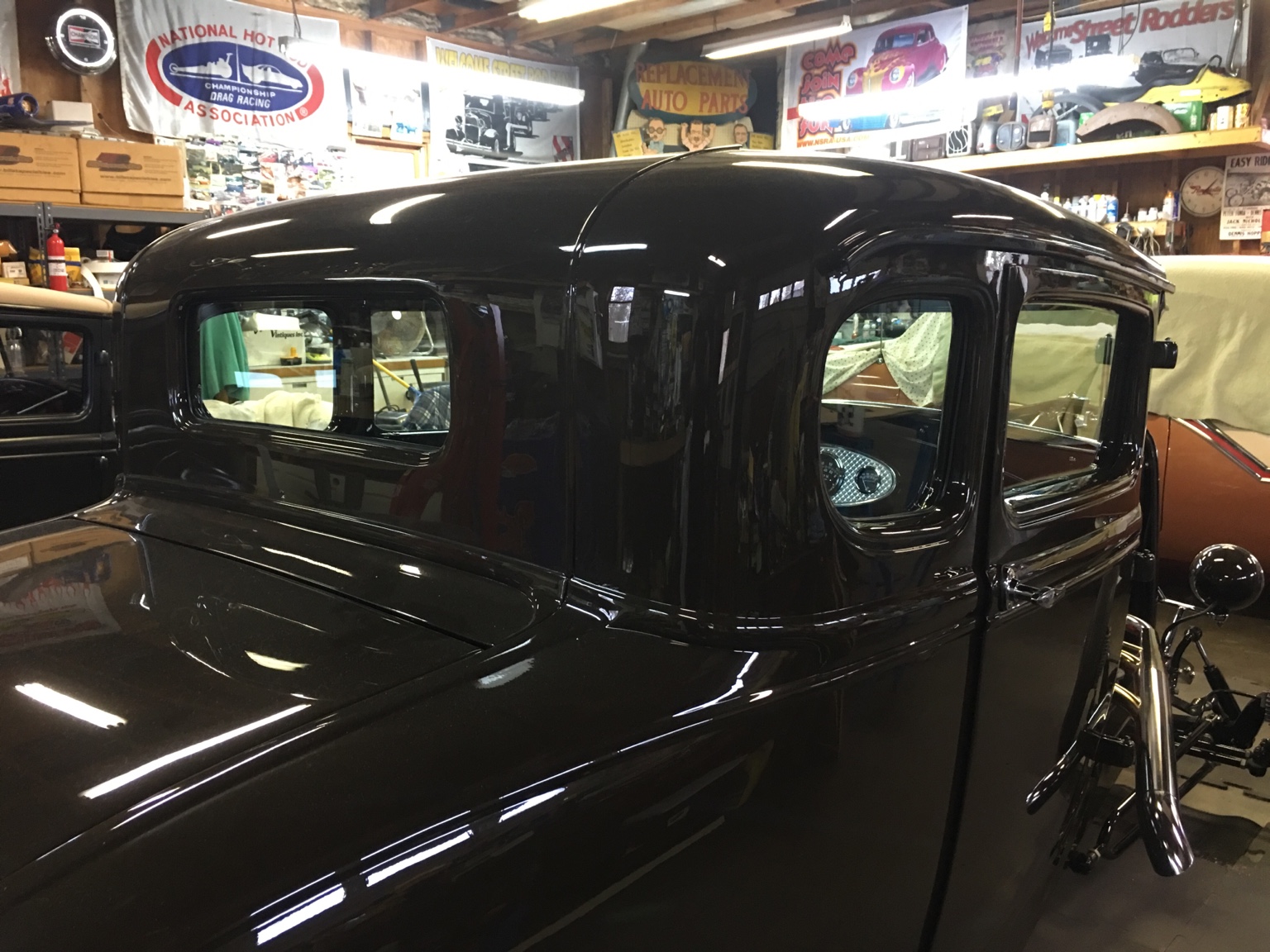

    Gl*** DONE. What a nightmare. Never again. Next time it'll be a roadster.

    Did ya get the gl*** locally? Any tint?
  22. HelmuthBrothers
    Joined: Oct 11, 2007
    Posts: 791
    HelmuthBrothers
    from New Jersey
    Yep right down the street too. American Auto Gl***. It's a factory GM green tint. Really subtle. Looks great against the brown.
